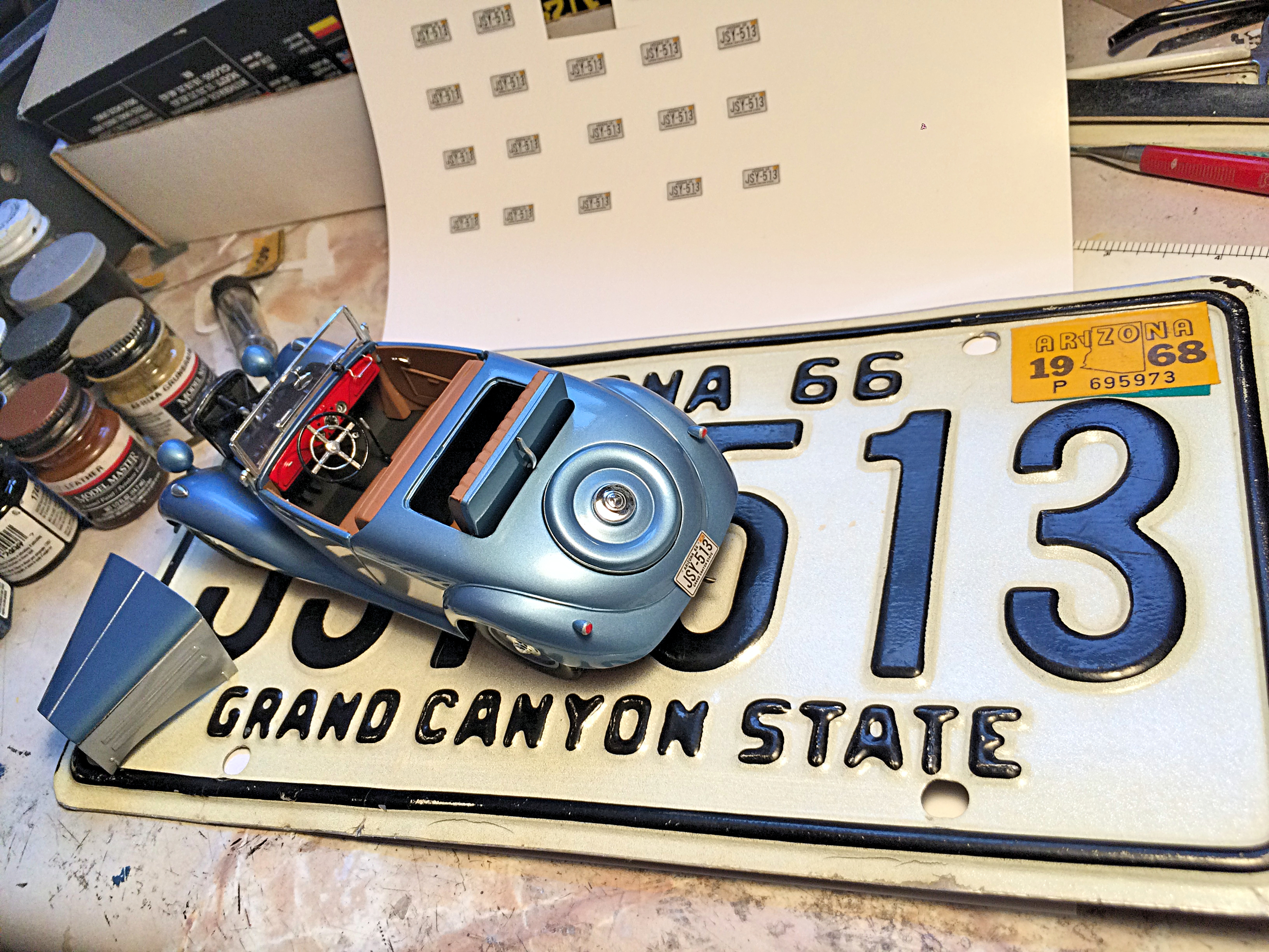

peteski Posted May 23, 2019 Posted May 23, 2019 LOL, that sure brings back some memories. Back before digital cameras, when I was using my 35mm Nikon SLR, I figured out what distance (with specific lens) I had to be from the plate to get the correctly sized plates on a 4 x6 photo. I did that for all the popular scales from 1:8 to 1:43. It was not 100% perfect (becuase of the way the lab set up their enlargers), but it was close. I still have bunch of 4 x 6 photos with those plates, ready for use. But nowadays, computers make this task so much easier, more accurate, and repeatable. Here is one of those photo-reduced license plates with a Detail Master photoetched frame.(in 1:43 scale).
