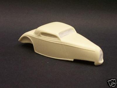

Does anyone have this Flintstone body? I've got some that are very thick almost slush cast while others are very nice and uniform inside.

When looking at Flinstone products, it all depends on when the masters were made and the bodies produced. He has made strides over the last 10 years or so to keep the thickness of the bodies down. But, he deals in volume to keep his prices lower, so concessions are made to enable him to pop out bodies very quickly. The best way to buy his stuff is in person, so you can see exactly what quality you are buying.
I think I'd describe my 34 as thick and a bit slushy inside. It's perfect on the outside which is the important thing. I have had it for years and the more recent Flintstone products I have purchased are cleaner inside.
The body pictured might be described as "slushy", but "inconsistent thickness" is a more accurate description.  Slush molding is entirely different: it's using essentially half a mold (outside surfaces only; no inner core) and literally "sloshing" the resin around in it.  That method results in inconsistent thickness also.  Most slush-molded stuff is paper thin in some areas.  Slush-molded items will often collapse (sides and roofs will pull inwards) and, with few exceptions, are generally useless.
Every Flintstone body I have seen is produced from a two-piece mold.  Some have the thickness inconsistency pictured, which can be ground/sanded out if you wish to do so.  Generally, his earlier bodies and some with more extensive alterations are like this.  Still, if you know what you are getting into, they are good considering the price.
This isn't as bad as some I have seen. I think you have to remember that 99% of Resin cast bodies are not going to be a direct fit replacement body for any of the production kits. They will all need a little finessing. I have built only a few Resin bodied kits in the past and I just have to remember going in that there will be frustration and a LOT of fitment problems. As long as the exterior represents what you want the rest is just is just some fine tuning.
Thats all true Mark. I've always been perfectly happy with every Flintstone body I have purchased and at his price point I wouldn't be complaining about a little clean up on the inside which in most cases will not be seen once everything is together anyway.
All of  the bodies I have purchased are perfectly acceptable on the outside and every one is nice and square with no twists to them.

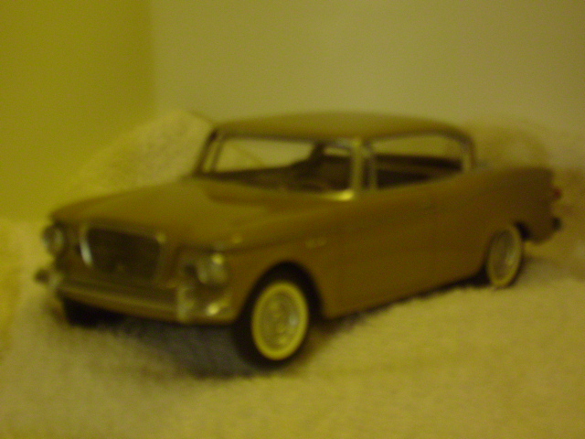

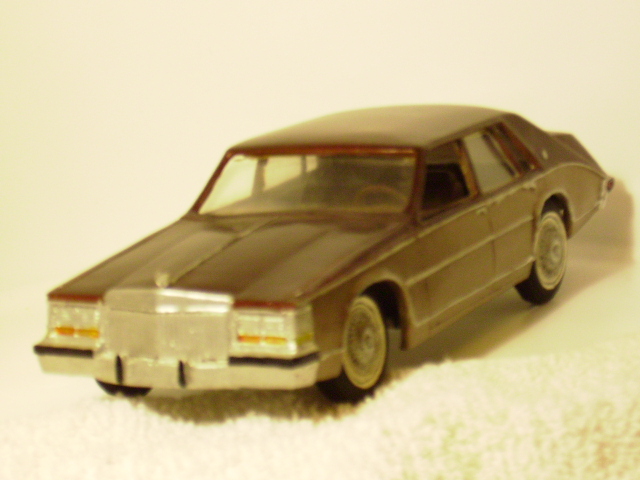

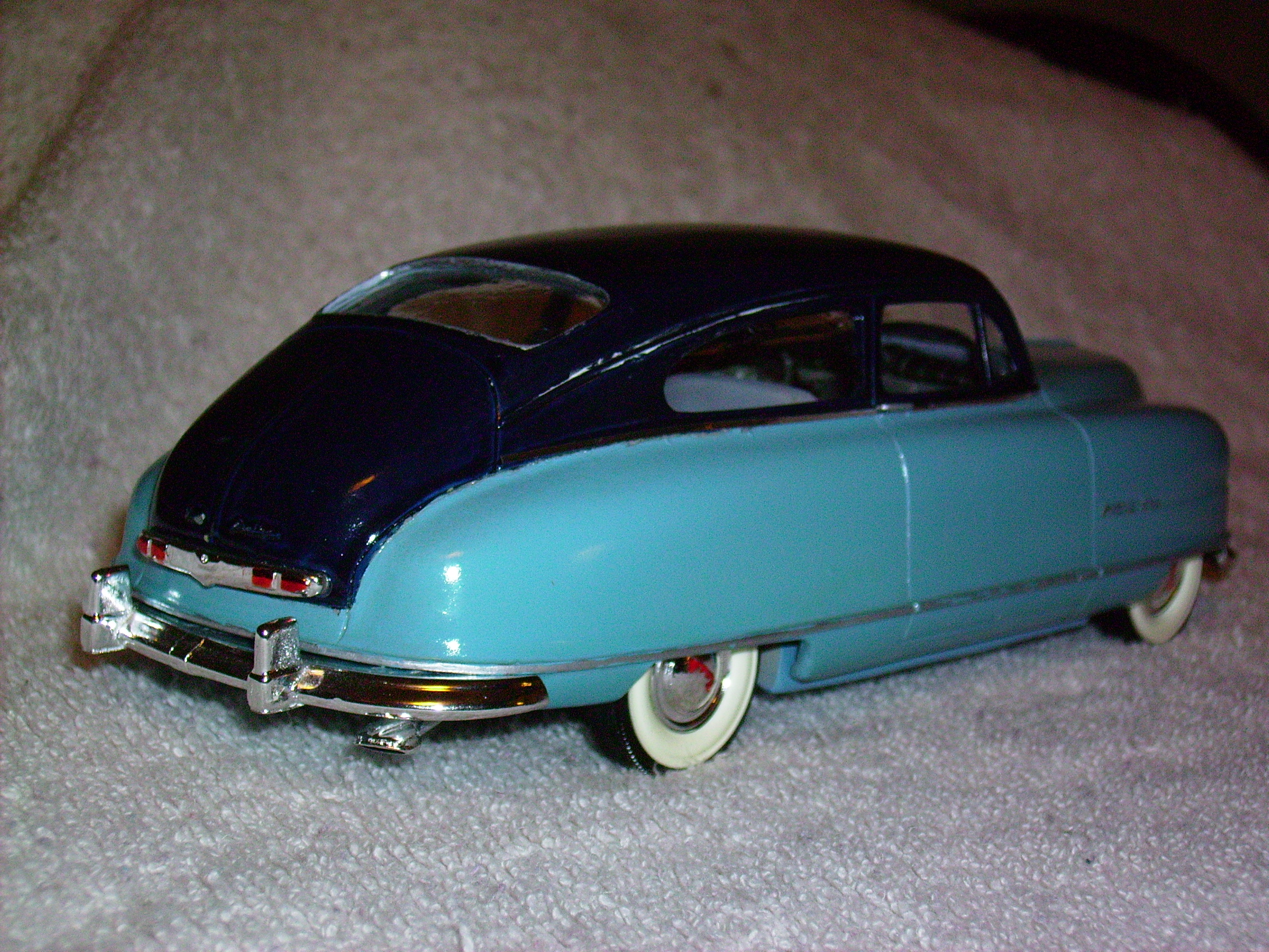

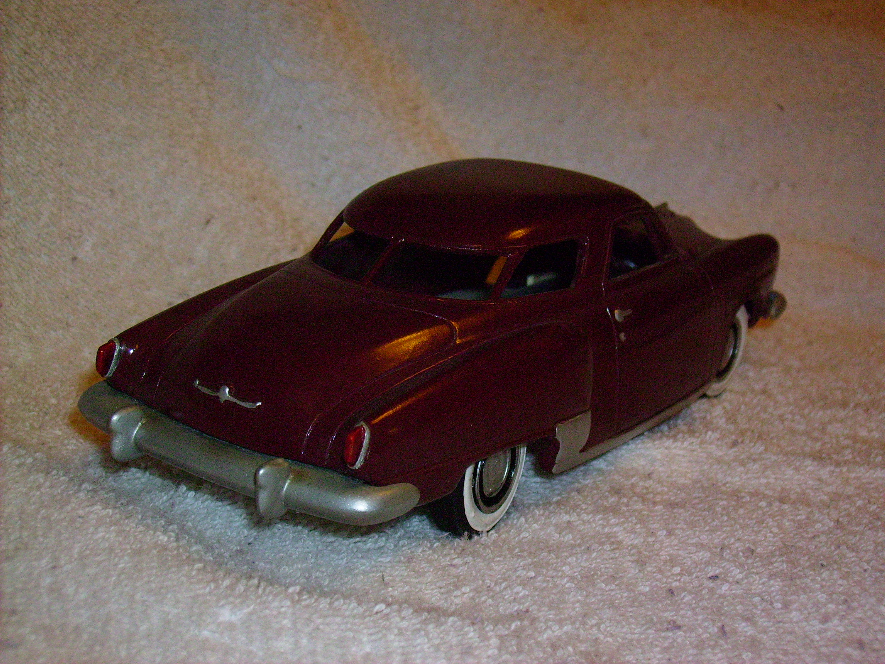

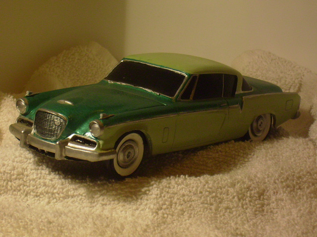

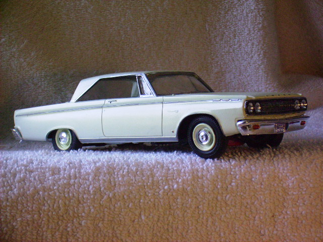

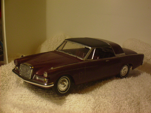

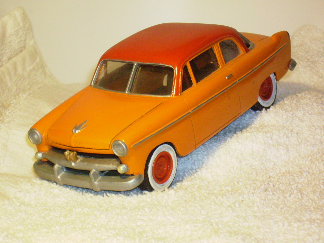

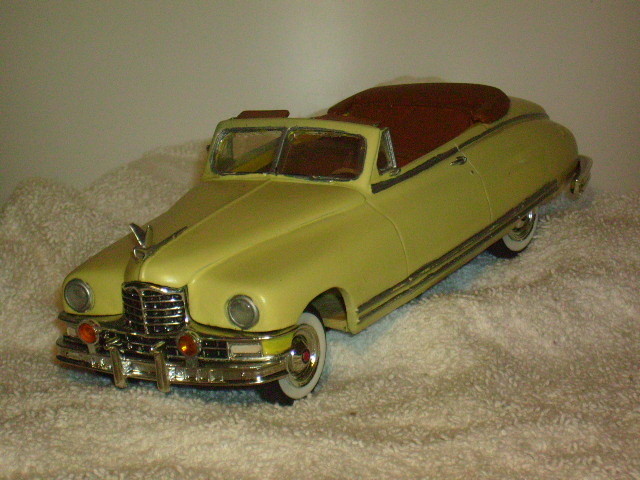

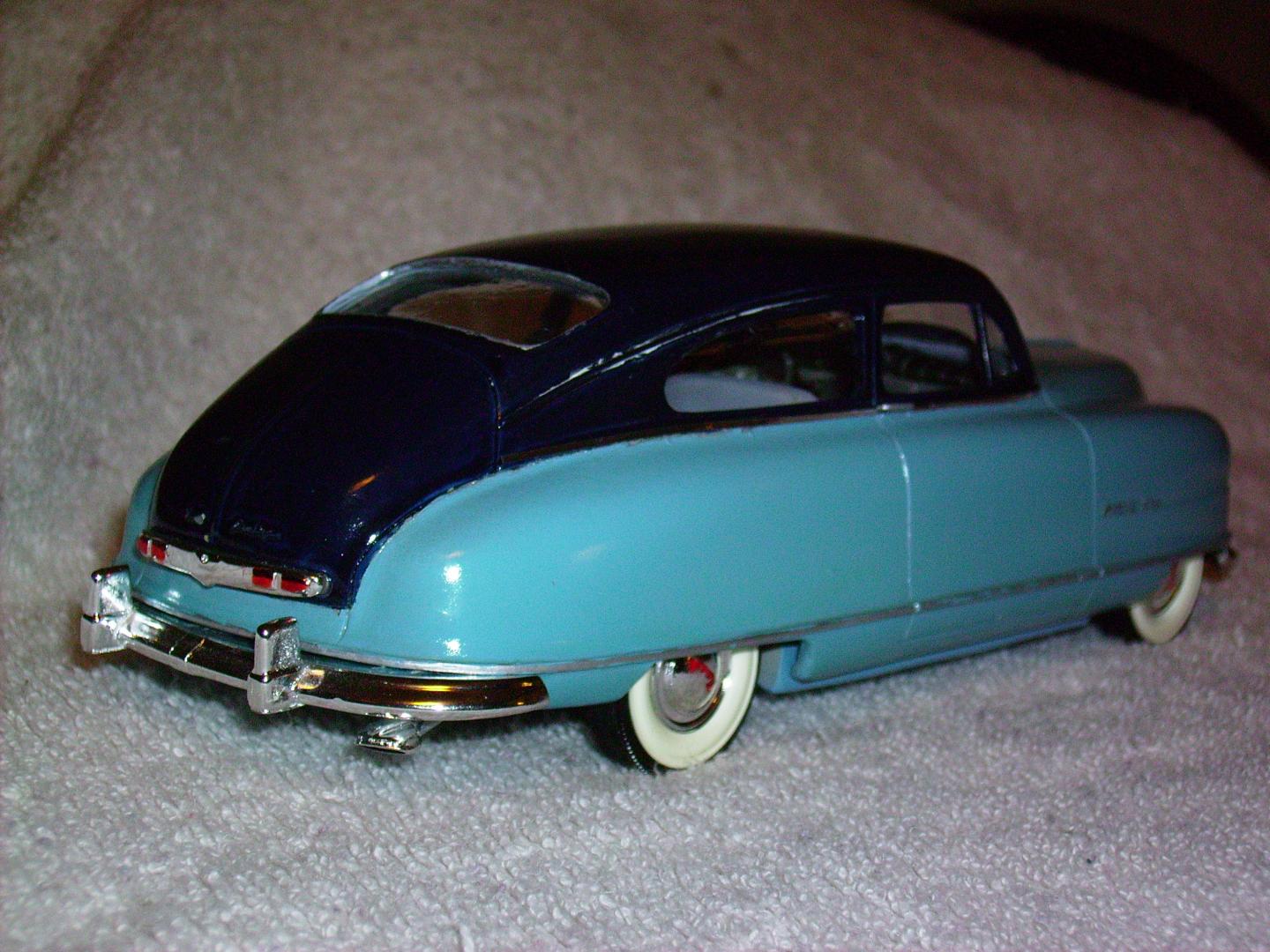

I was here at the start of Model Car Resin Castings . This is an SK Miller '56 Studebaker Hawk slush cast . This is a TKM Slush Cast Seville . This is a F&F Resin Packard . This is a AAM conversion '54 Conestoga . This is a  John Heir '64 Hawk conversion . This is a  ?? (Mike) Willis Aero . This is a Very early Jimmy Flintstone '51 Stud . This is a MCW  '60 Lark . This is a Modelhaus Nash . This is a Perry's Resin '65 Cornet .
    To me , it is a matter of how much work you are willing to do for your WIP's . To see your desire in 3 D .  A hand built Model . If you recognize the names , some of these have been built in the '80's and '90's . These sit on shelves enclosed in Glass Cases for me to admire . Questions welcome .. Thanx ..
