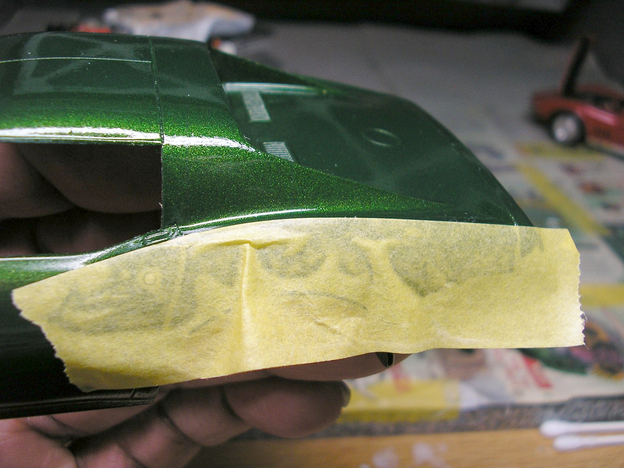

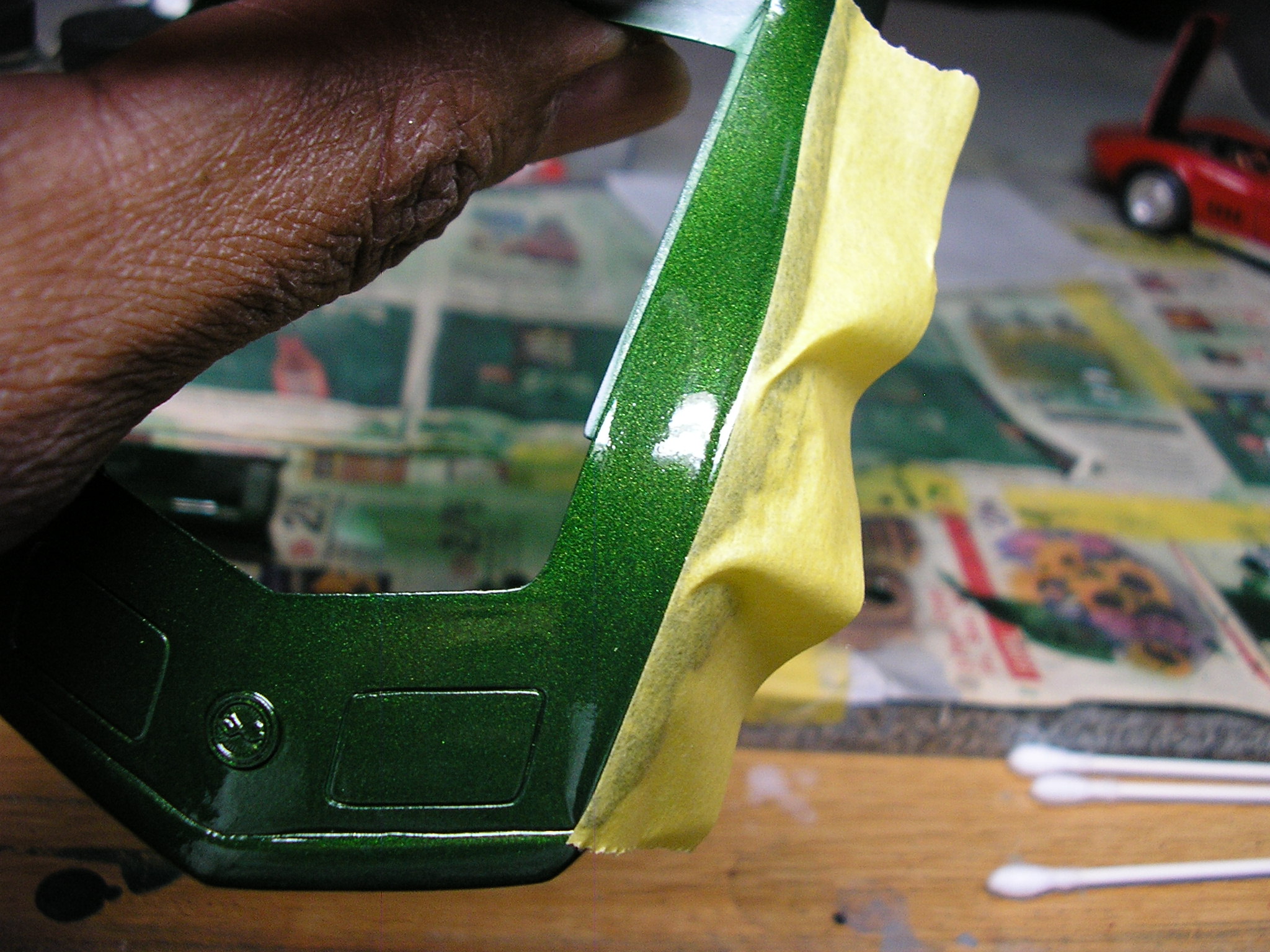

This looks great from where I sit! Like a lot of '60's cars, this one has a fair amount of creases on it which can make polishing a bit difficult. One of the things I do when I have a model that has sharp edges and I need to rub a section out, is cover that edge with either Parafilm or Tamiya masking tape.
Here are a couple pics of a Corvette build I did not long ago showing this................
Hope this helps!
