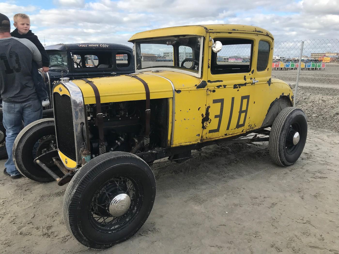

Tom Geiger Posted May 21, 2020 Posted May 21, 2020 You got me thinking about the missing character line below the side windows. I have an old built up of a coupe sitting right above my bench and never noticed. Now you have me obsessed! ? I’m thinking Monogram left it off because the kit was the coupe / convertible combo and the convertible didn’t have that detail?
Straightliner59 Posted May 21, 2020 Author Posted May 21, 2020 1 hour ago, Tom Geiger said: I’m thinking Monogram left it off because the kit was the coupe / convertible combo and the convertible didn’t have that detail? That's what I figured, too. Weren't we discussing the yellow variant of this kit, just a while back? At that time, I don't think I had realized, yet, that it was missing! ?
Straightliner59 Posted May 22, 2020 Author Posted May 22, 2020 4 hours ago, Tom Geiger said: And why oh why is this car calling my name? You'd better hurry! ? I can see exactly why. Neat piece!

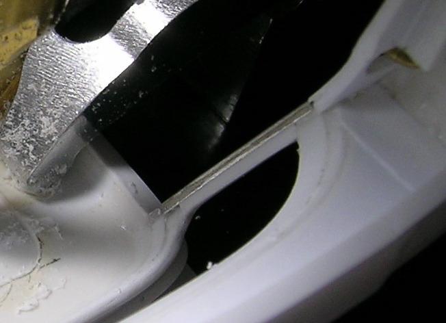

AmericanMuscleFan Posted May 24, 2020 Posted May 24, 2020 On 5/22/2020 at 8:36 AM, Straightliner59 said: Thank you, John! I agree, that 'a' pillar is the main reason I haven't dived into that part of the project, yet. I like your suggestion of fabricating the inner door structure, prior to hacking the doors open. With those in place, it should provide a bit more rigidity. I have all the hinges made. I'm just waiting to build up my courage! ? I don't want to put you more pressure about opening the doors because your car is fantastic anyway and don't necessarily need this feature. However, if you decided to proceed with the cuts, I just want to tell you that I had this problem (with the «A» pillars) on my '64 D100. As you know my donor kit was an original 62 FORD body so the plastic was very brittle and the windshield frame had to by modified to match the shape of the Dodge truck. They are very thin already so they broke on both sides not counting that I dropped the body on the floor a couple of times on the early stage of the build. I glued them back several time with Bondene liquid glue or Cyanoacrylate but they were simply too thin to endure any manipulation. To fix the problem I folded a thin piece of aluminum in a «L» shape and glued it on the inside of the «A» pillar where the door window frame meet the pillar. In the unpleasant but possible event that a break happen on you car, you could try this trick with thin brass instead of aluminum depending on what you have on hands. I attached a picture that show partially the fix, but I don't want in any way to hijack your thread Daniel!

Straightliner59 Posted May 24, 2020 Author Posted May 24, 2020 3 hours ago, AmericanMuscleFan said: I don't want to put you more pressure about opening the doors because your car is fantastic anyway and don't necessarily need this feature. However, if you decided to proceed with the cuts, I just want to tell you that I had this problem (with the «A» pillars) on my '64 D100. As you know my donor kit was an original 62 FORD body so the plastic was very brittle and the windshield frame had to by modified to match the shape of the Dodge truck. They are very thin already so they broke on both sides not counting that I dropped the body on the floor a couple of times on the early stage of the build. I glued them back several time with Bondene liquid glue or Cyanoacrylate but they were simply too thin to endure any manipulation. To fix the problem I folded a thin piece of aluminum in a «L» shape and glued it on the inside of the «A» pillar where the door window frame meet the pillar. In the unpleasant but possible event that a break happen on you car, you could try this trick with thin brass instead of aluminum depending on what you have on hands. I attached a picture that show partially the fix, but I don't want in any way to hijack your thread Daniel! Ah! Thank you, Francis! That is a brilliant idea! I now know exactly what I am going to do. I appreciate the photo! It's a big help. Broken and lost stuff just comes with this territory. There isn't a one of us, who hasn't spent hours of work on something, only to have to do it again!

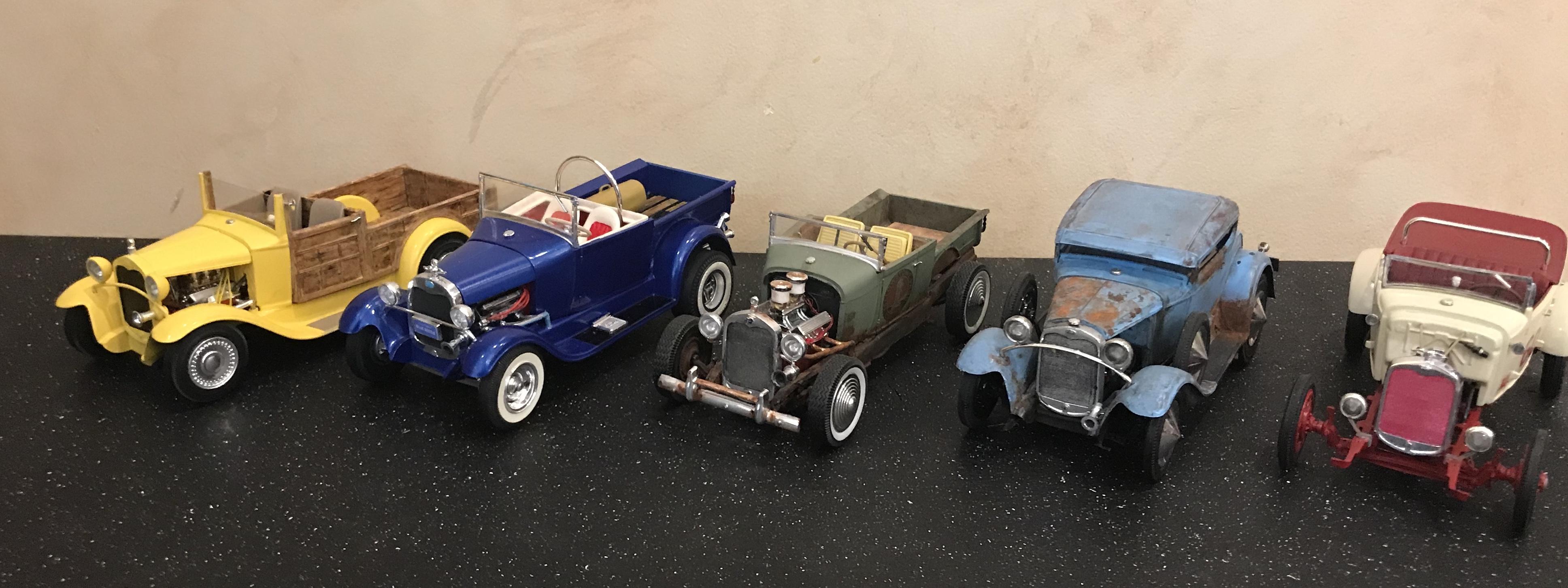

Straightliner59 Posted June 5, 2020 Author Posted June 5, 2020 5 hours ago, Flat32 said: That is very cool, Ray. That blue is close to the color I am leaning toward. I like the catch can, too! At least I guess that's what the red and white cylinder is, at the base of the radiator.
