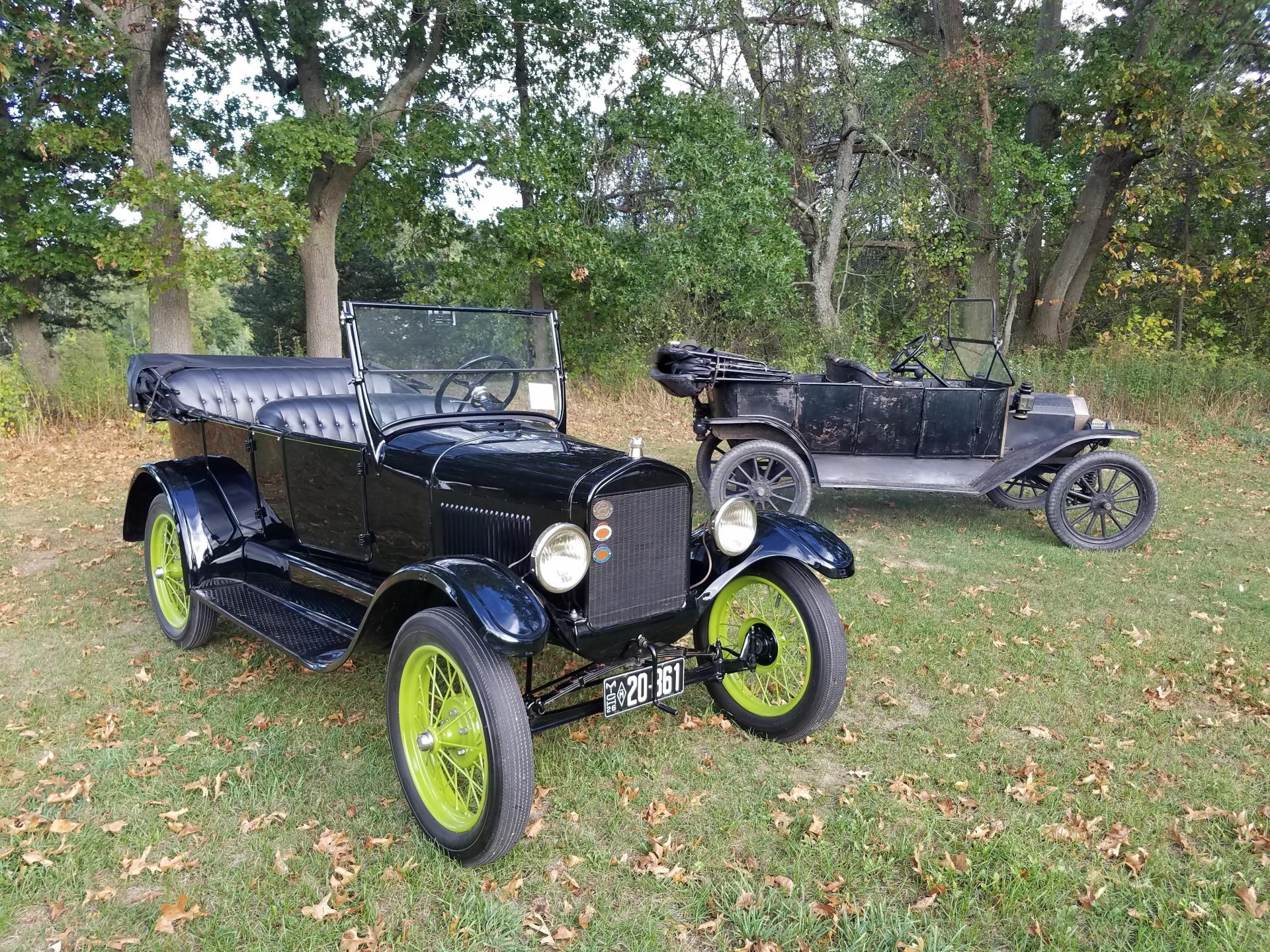

On 9/12/2019 at 11:26 AM, Eric Macleod said:
Just to be clear here there are a number of inaccuracies here which lead me to believe this was a pretty cobbled up car.
A '26 Model T Fordor (not a typo) sedan had a gas tank under the front seat while the rest of the Improved Fords (as Ford called them) had the gas tank in the cowl area (basically in the driver's lap) The cowl gas tank holds about 9 1/2 gallons and the under seat version holds 12. Gas tanks were only in the rear part of the car when it was a home made speedster or in the case of the 1910-12 Open Runabouts or Torpedos.
The starter became available in 1919 as optional equipment and they were fairly universal by 1926, though one could still purchase a car "unequipped" with crank start, kerosene lamps (on the cowl and as a tail lamp) as well as non-demountable rims. I built a model of such a car a bit ago.
The horsepower of the 176 CID 4 was 20 hp in 1926. My Fordor has been clocked at 52 MPH with my father behind the wheel, though I have never been that brave in that car, though my Touring will go 55 pretty easily, so long as the top is down.
Mohair interiors were introduced by Ford for use in closed cars beginning in 1928. Prior to that the closed cars used a woven wool material pinstriped in white, green or red and seemed to be at the whim of the supplier, not the color of the car.
Sorry, I don't mean to tear your post up, nor do I doubt the car may have been as you describe, but I want to be accurate about how Fords really look and were equipped instead of perpetuating inaccuracies.
Attached is a photo of two of my Fords, my '26 Touring in the foreground and my '13 Touring in the background. The '26 was the 2006 winner of the Stynowski award, which is given to the best restored Ford Model T in the country.
All the best.
Eric
