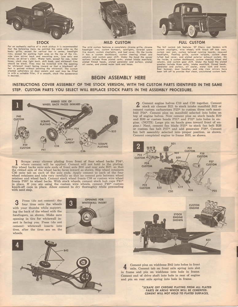

Here's a pic of the engine espo was referring to. This is from the original instruction sheet, but the engine hasn't changed since the 60's.

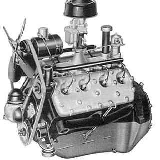

This is the engine a 34 came with from the factory,the one I found in my parts stash is one like this with finned heads and dual carbs and would like to know what kit it came from as I never built one with the first generation flathead that had speed equipment.
Yup, water pumps on the heads should be right for a '34.
IIRC they lived there from '32 -'36, and in '37 moved down to the lower block.
The connections for the upper water hoses could be in the center of the heads, or in front. I honestly don't remember all the possible permutations...so do your research.
