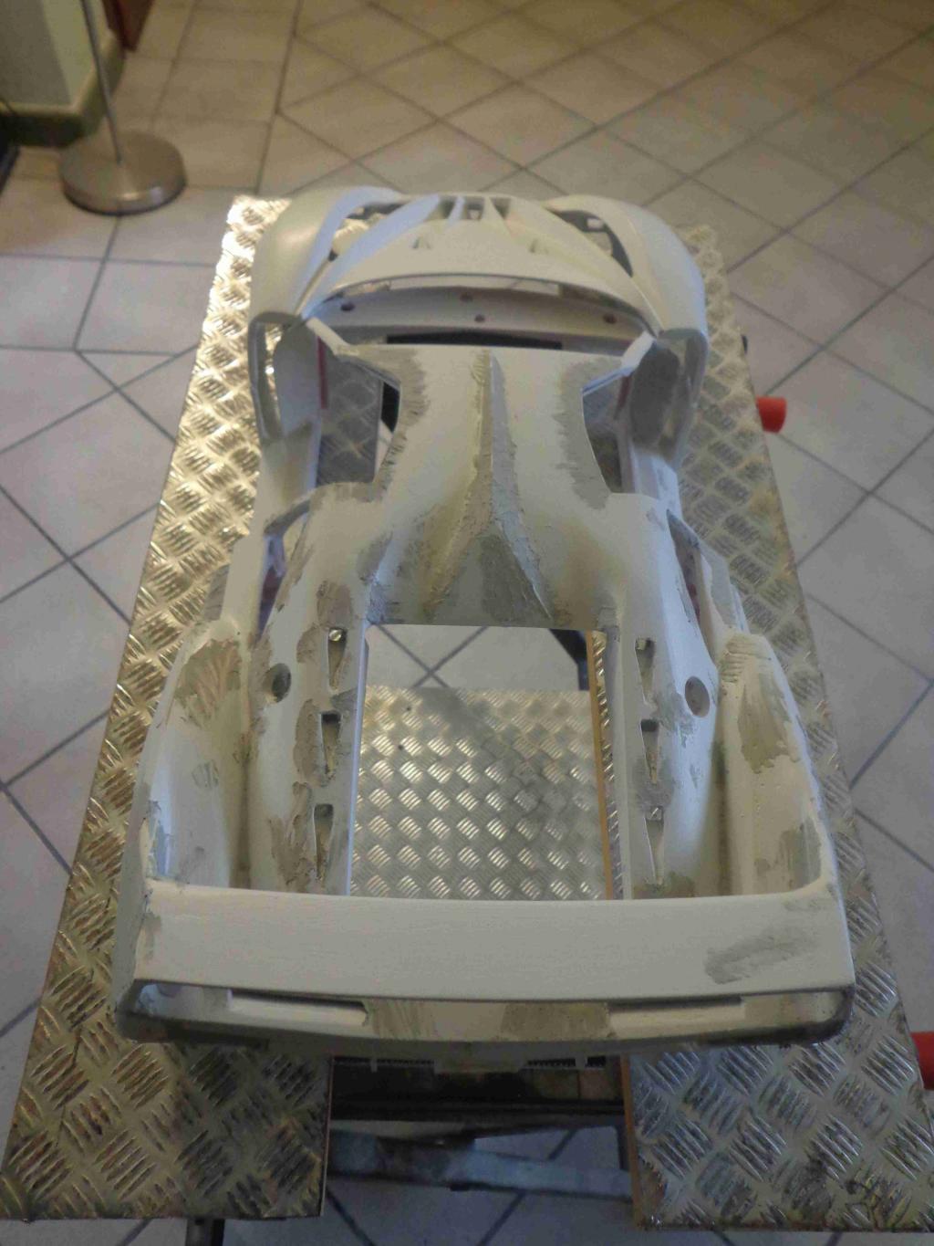

I took a bit of Bugatti, a bit of Lamborghini and a little bit of mine, this is basically how it will be: the aluminum part will be in pyramid shape and will connect with the roof, while the 3 parts in glass plasticard, all openable.
339213d1569568606-ferrari-f40-pocher-1-8
339214d1569568606-ferrari-f40-pocher-1-8
339215d1569568606-ferrari-f40-pocher-1-8
his is the definitive shape to be finished of the bonnet with the 3 glasses that I will install when the model is completed.
339623d1570024348-ferrari-f40-pocher-1-8
339629d1570024348-ferrari-f40-pocher-1-8
339698d1570105065-ferrari-f40-pocher-1-8
339703d1570105065-ferrari-f40-pocher-1-8

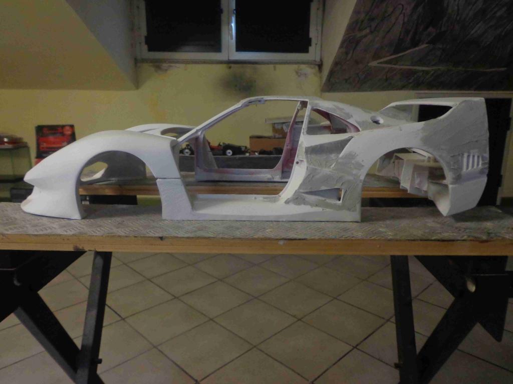

the opening of the doors I decided to make them with seagull wings which led me to modify the roof and door, the latter I had to cut because it hit the wheel arch ...
339858d1570357656-ferrari-f40-pocher-1-8
339859d1570357656-ferrari-f40-pocher-1-8
339860d1570357656-ferrari-f40-pocher-1-8
339861d1570357656-ferrari-f40-pocher-1-8
339862d1570357656-ferrari-f40-pocher-1-8
339863d1570357656-ferrari-f40-pocher-1-8
339881d1570383519-ferrari-f40-pocher-1-8
339884d1570383519-ferrari-f40-pocher-1-8

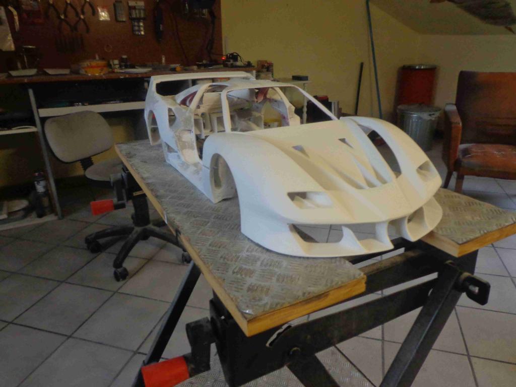

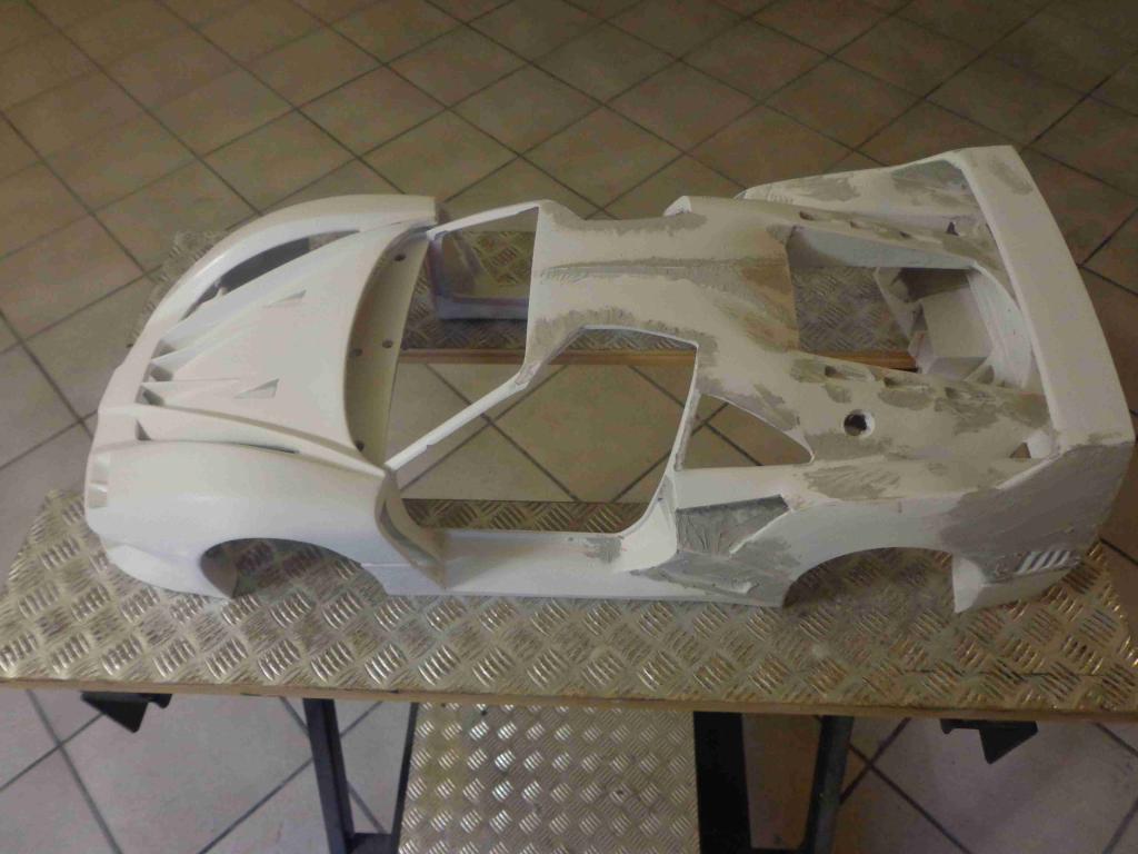

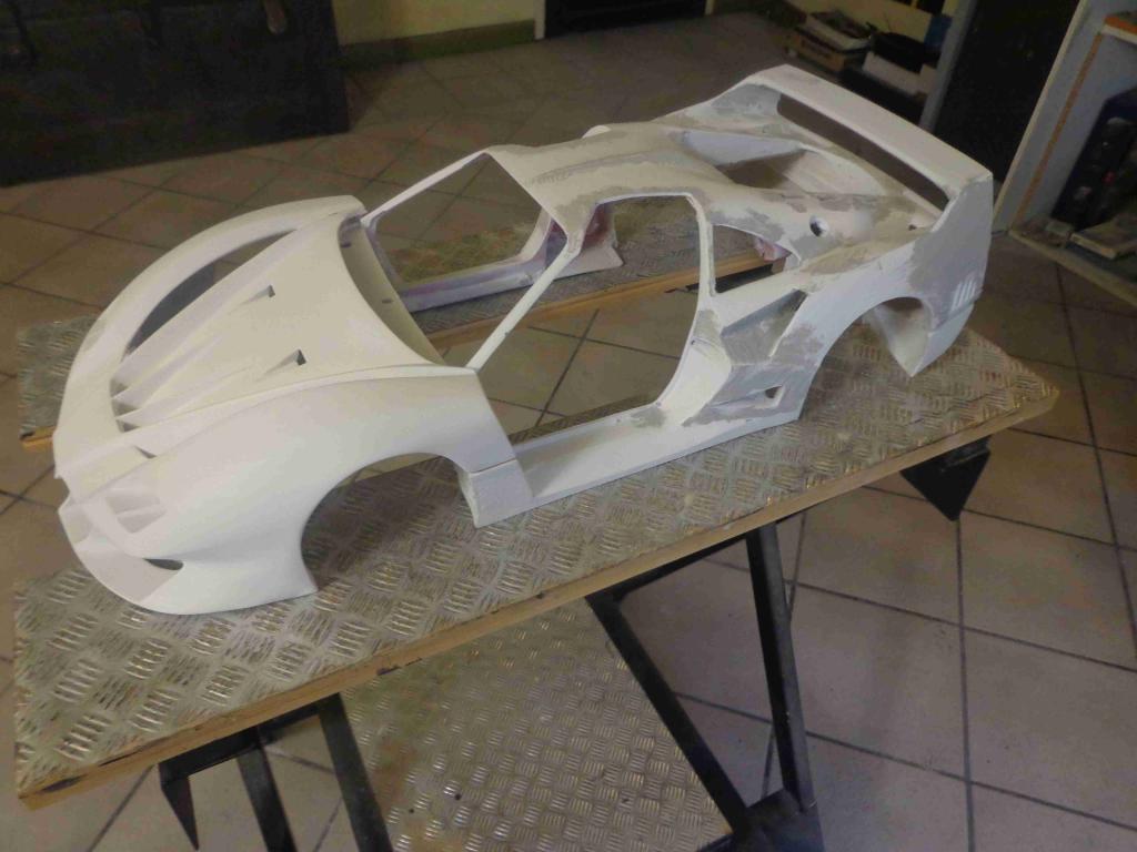

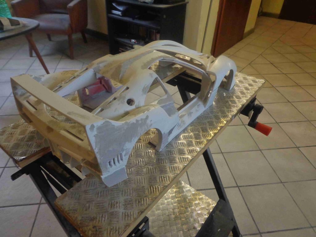

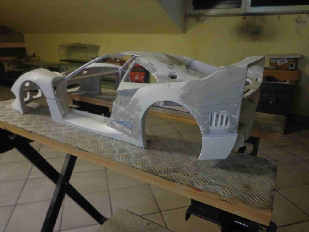

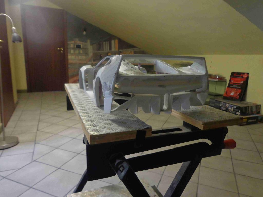

ok guys, i'm proceeding in step to finish, first of all the front hood. After a week of plastering and smoothing, I applied a coat of spray putty. There are still a few dishes here and there,and finished.
343206d1573939496-ferrari-f40-pocher-1-8
343207d1573939496-ferrari-f40-pocher-1-8
343208d1573939496-ferrari-f40-pocher-1-8
343209d1573939496-ferrari-f40-pocher-1-8
343210d1573939496-ferrari-f40-pocher-1-8
343213d1573939496-ferrari-f40-pocher-1-8
343214d1573939496-ferrari-f40-pocher-1-8
3 hours ago, wisdonm said:
Not sure which is more impressive, your skill or your patience. Thanks for showing all the different steps.
Or how his brain work ...to think ...and model...and modified.....but you make an amazing work.!!!
I'm generally not a fan of most of the modern exaggerated-form exotic car designs.  So while I might not like what you are creating, your modeling/scratchbuilding skills are absolutely amazing!
I am watching this build with amazement at your techniques and precision.  I was not really sure what your vision was until you put some paint on it.  WOW, that is an impressive change.  Never been a great fan of the modern day Ferrari, so any change has to make them look better.
Absolutely mind blowing, Luca....... this is scale model car engineering at it's highest level........ precision, professional, quality, accurate and beautiful really. These 1:8 scale Pocher kits are wonderful pieces of automotive technology, and for someone like you to go one stage further and actually modify one of their model cars...... is marvellous, incredible, fantastic..... there you go, I have run out of BIG words  !!!

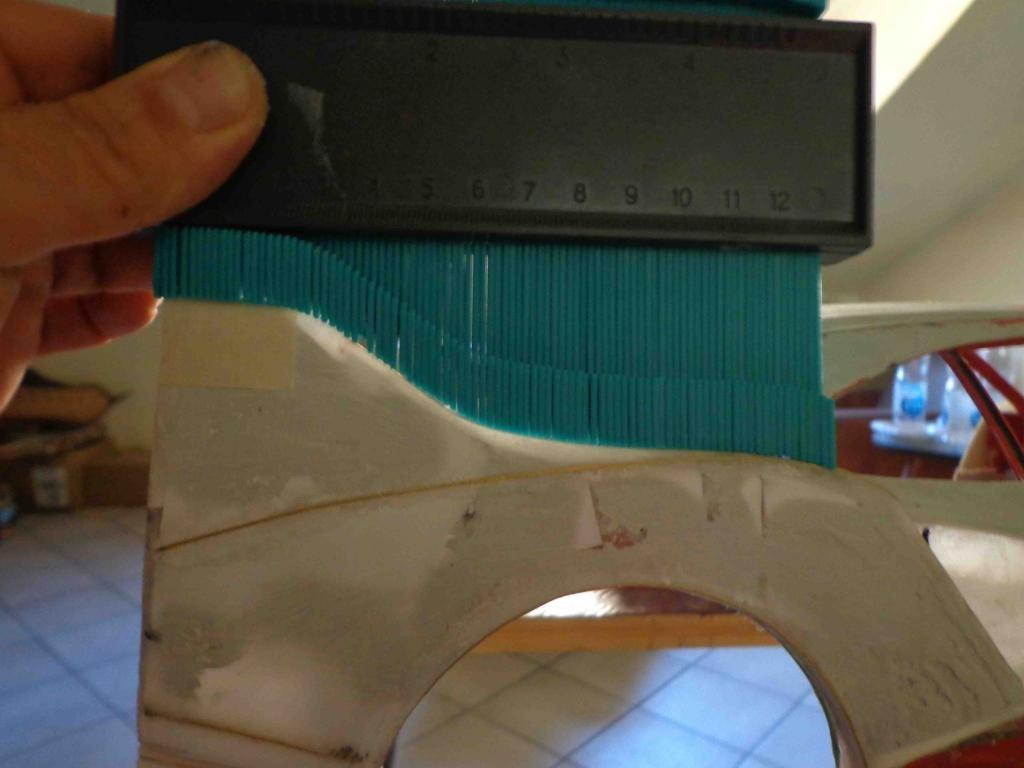

One question, Luca....... I see that you have a special tool, which looks like a steel bar, or a plastic bar with blue vertical pieces, and you were using this tool to check that a complicated shape of the car body was the same on both sides...... what is this tool called, please? Would it be something that we can order, or is this tool only available in Italy ?
