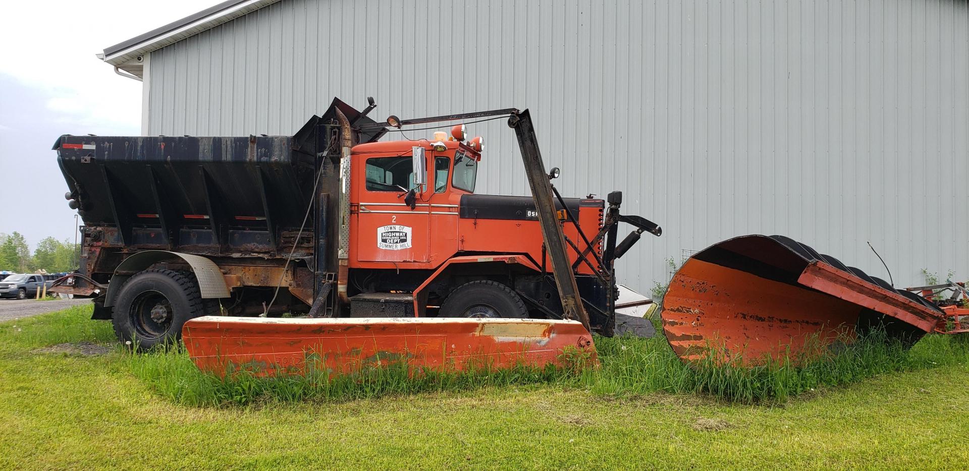

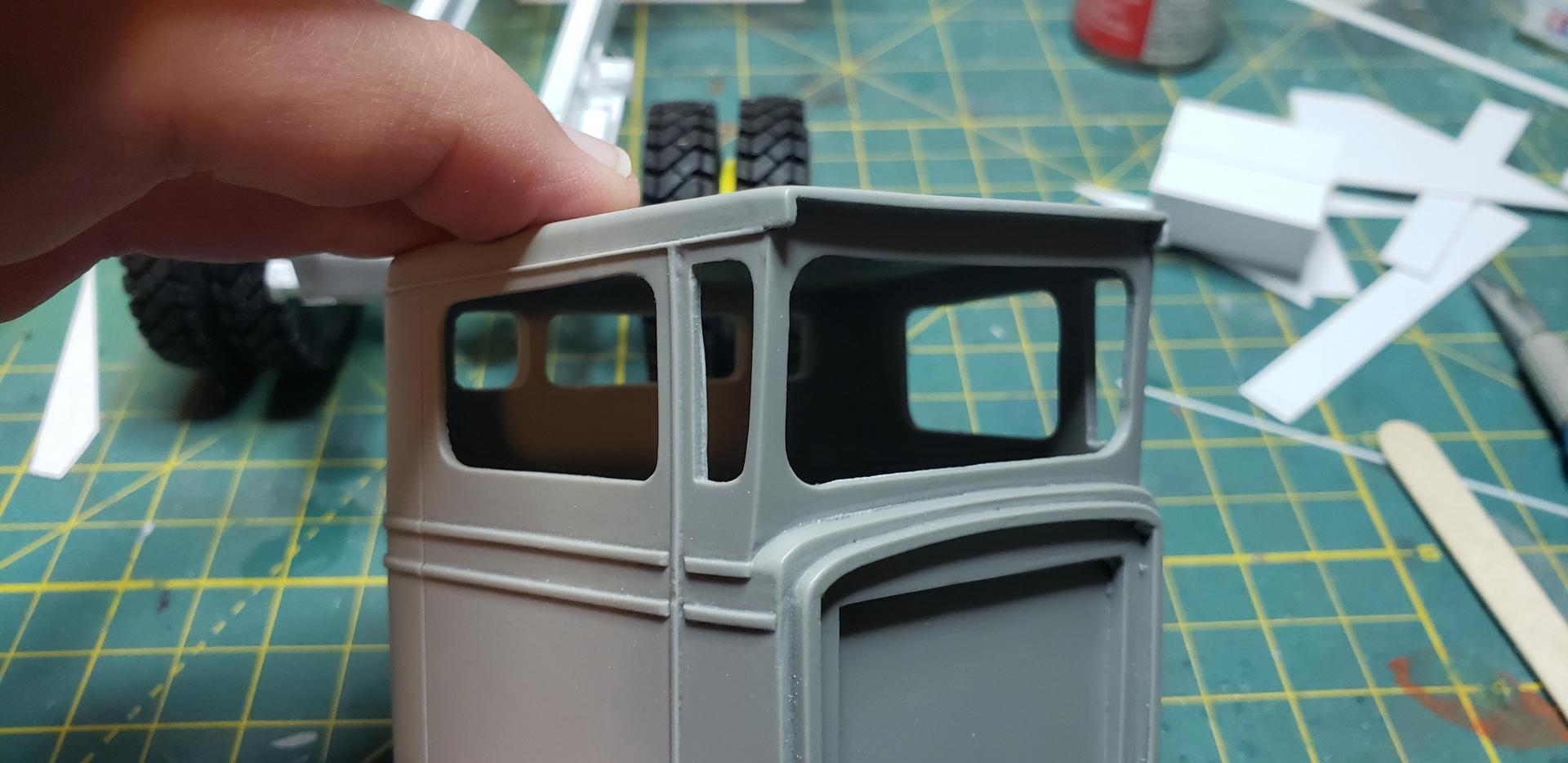

gotnitro? Posted December 13, 2019 Author Posted December 13, 2019 3 hours ago, Sergey said: Nice project, Jeff! Well done! Good luck with it! Especially with the cab. It slightly wrong as I compare to first photo. Thanks..guess I'm not sure what your referring to about the cab. It's a P series cab usually used on cement mixers, but will work for the plow..especially since it's the only available option ! I'm not aiming for 100 percent accuracy

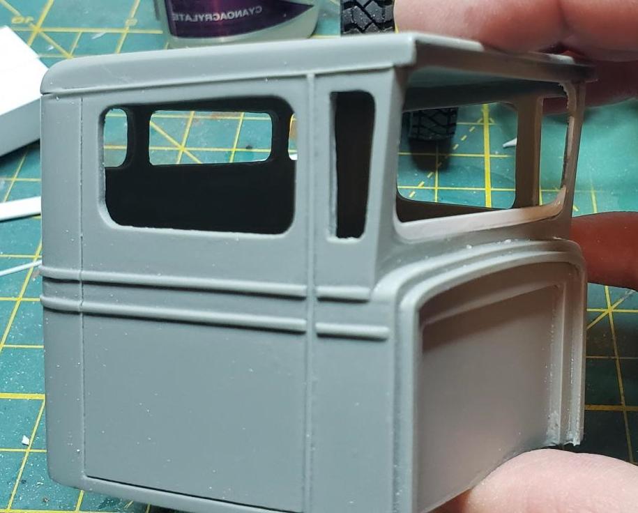

Sergey Posted December 14, 2019 Posted December 14, 2019 11 hours ago, gotnitro? said: Thanks..guess I'm not sure what your referring to about the cab. It's a P series cab usually used on cement mixers, but will work for the plow..especially since it's the only available option ! I'm not aiming for 100 percent accuracy Side trim lines are too thick for me. Upper trim is not exist on a real machine. Beside upper cab corners are smoother on truck, then on a model. The hardiest thing to fix are windows: the windscreen sits higher, then side windows. But as you are not aiming for 100 percent accuracy and you have much things to do - it's O-key.
gotnitro? Posted December 14, 2019 Author Posted December 14, 2019 Okay I see what your referring to on the cab . Still being the only available Oshkosh cab, its gonna make for an interesting project ! Thanks for input though, I may decide to tweak it , or the next one that's gonna have a Sicard snowblower

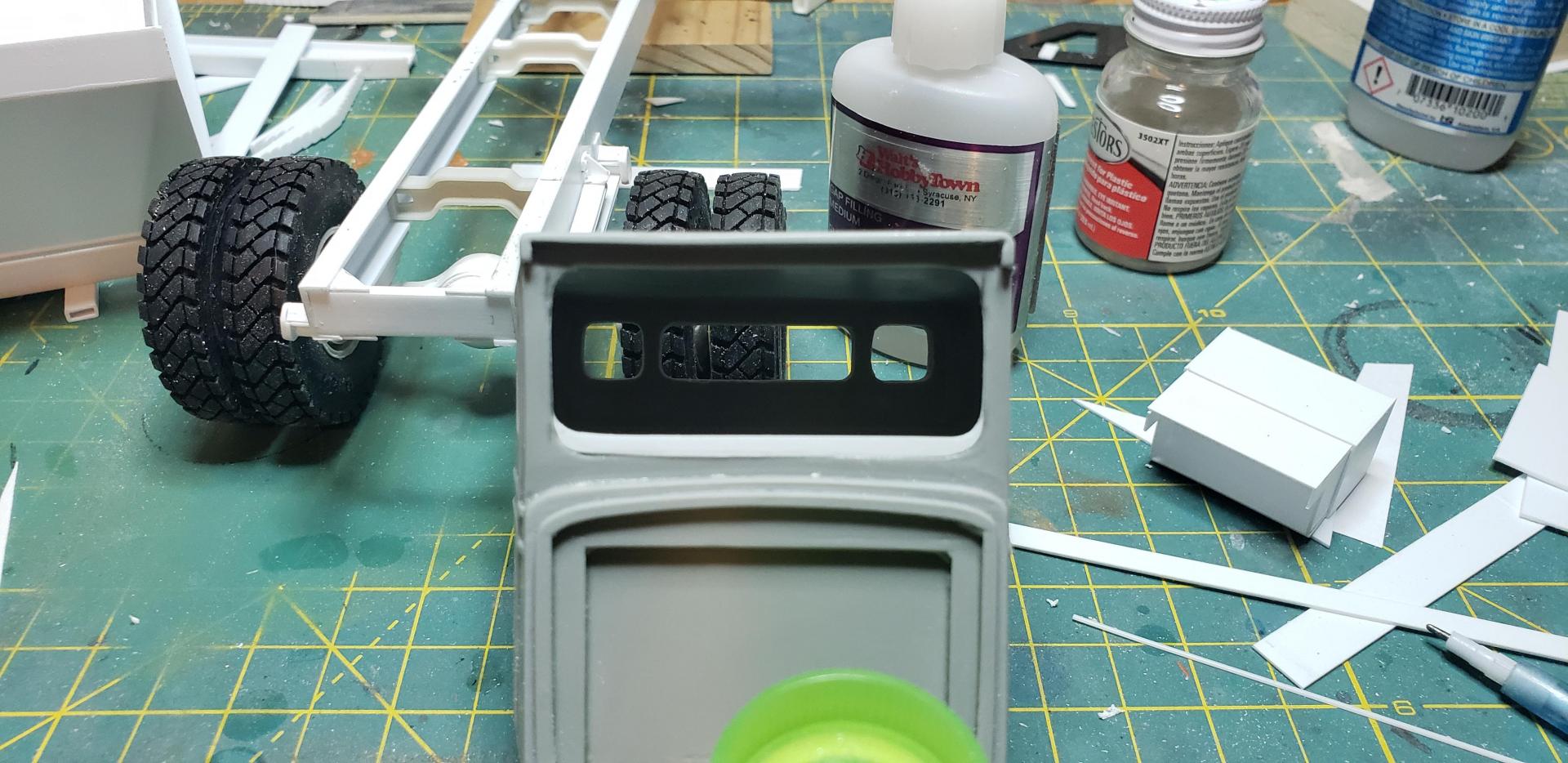

Chariots of Fire Posted December 14, 2019 Posted December 14, 2019 I was looking at the cab after reading the comments above. The cab is easily modified if you are willing to do a bit of sanding. Take off the two out of scale trim strips and replace them with smaller half round Evergreen. You can even adjust the windshield with a piece of sheet stock glued to the inside of the windshield opening. Fill it right in and use some Squadron putty or putty of your choice to fill in seams. After that is done re-mark the windshield opening in the correct orientation and cut away the sheet plastic accordingly. The rubber gasket can be formed afterward.

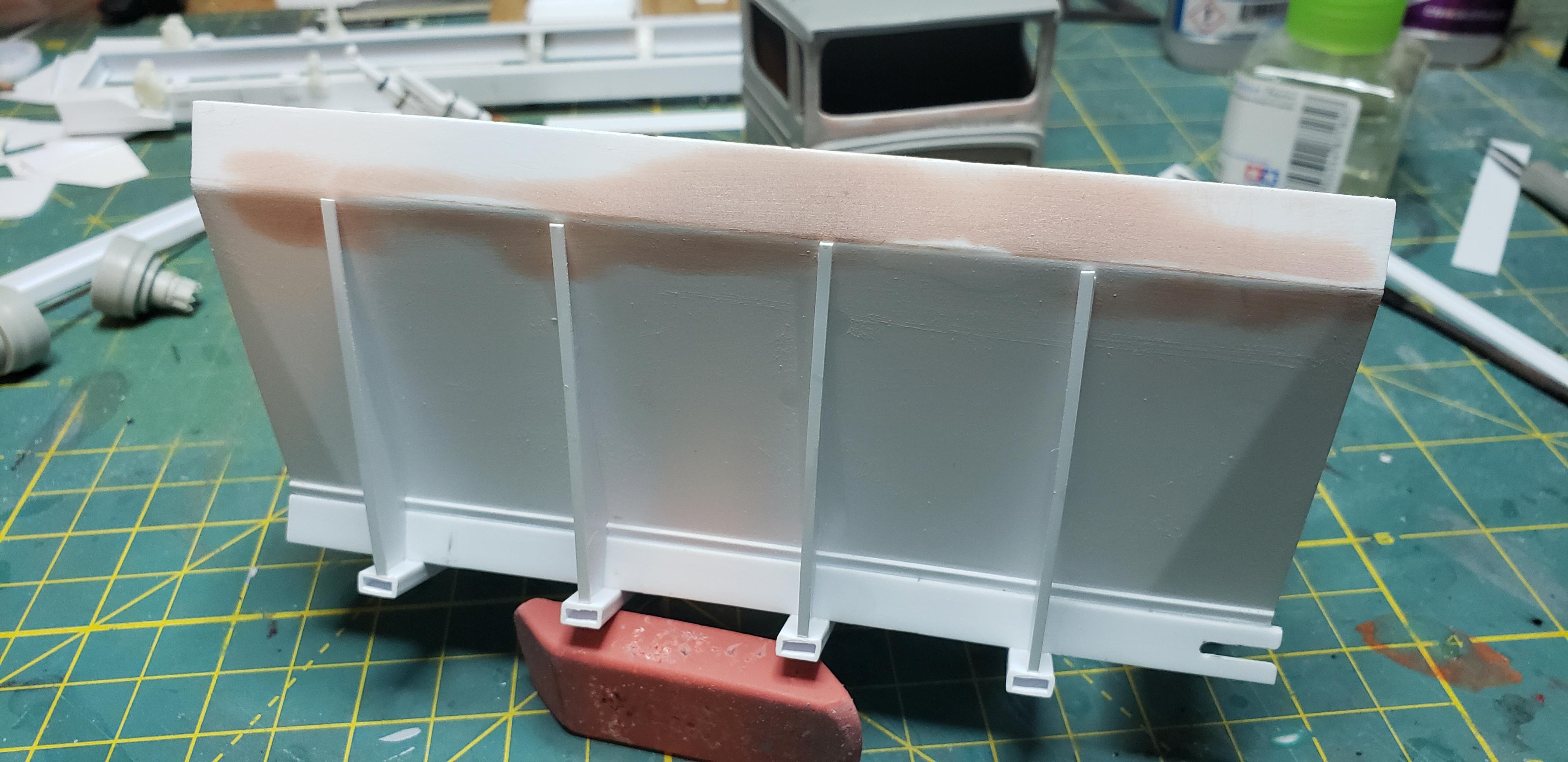

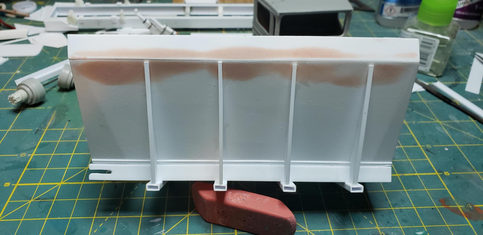

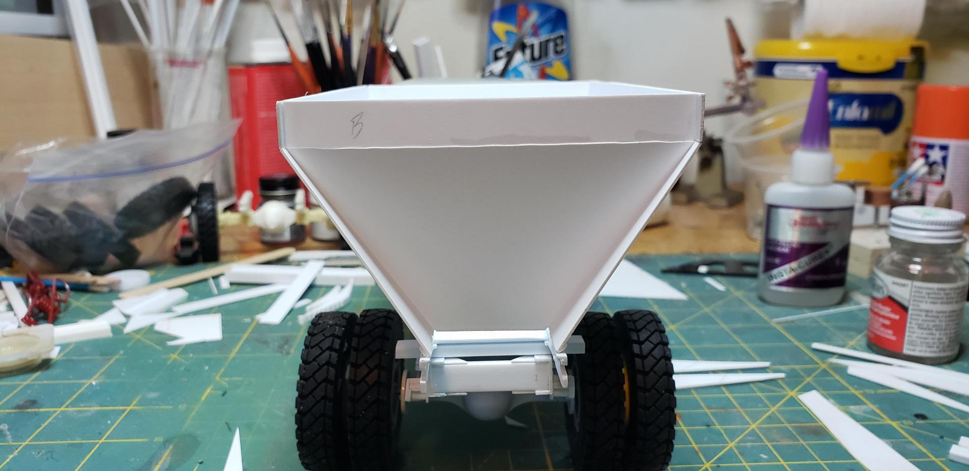

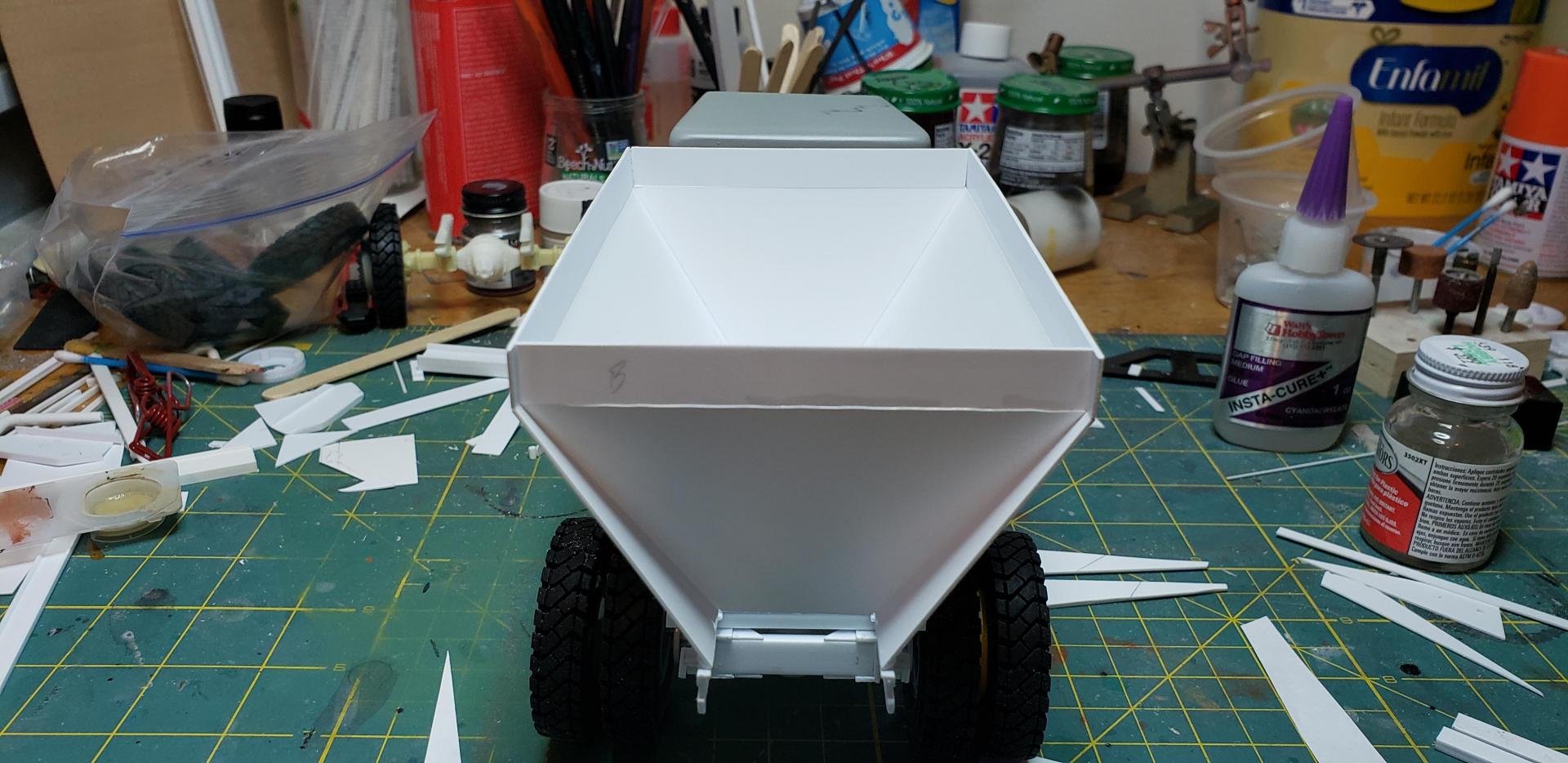

gotnitro? Posted December 14, 2019 Author Posted December 14, 2019 Yeah looks like I could tweak the windshield location, and the trim would be easy to remove and replace . I'll putter w when I finish the sander , I rebuilt the body w wider angle . The supports still have to be installed . heres the hopper behind the cab , definitely looks better ...no more anorexic model now !
gotnitro? Posted December 15, 2019 Author Posted December 15, 2019 1 hour ago, Chariots of Fire said: That looks just right.? Thanks Charlie ! Broke out the angle finder from my remodeling tools to make both sides symmetrical, worked awesome

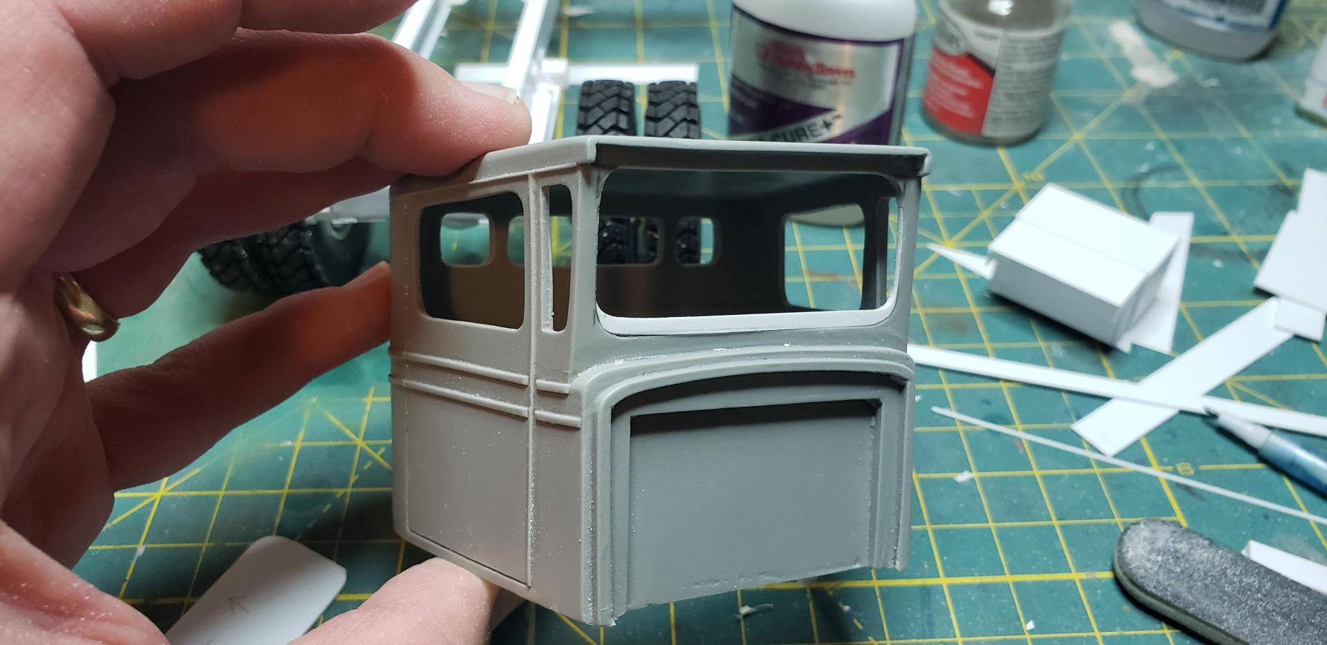

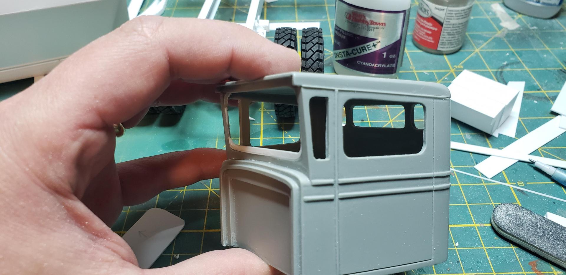

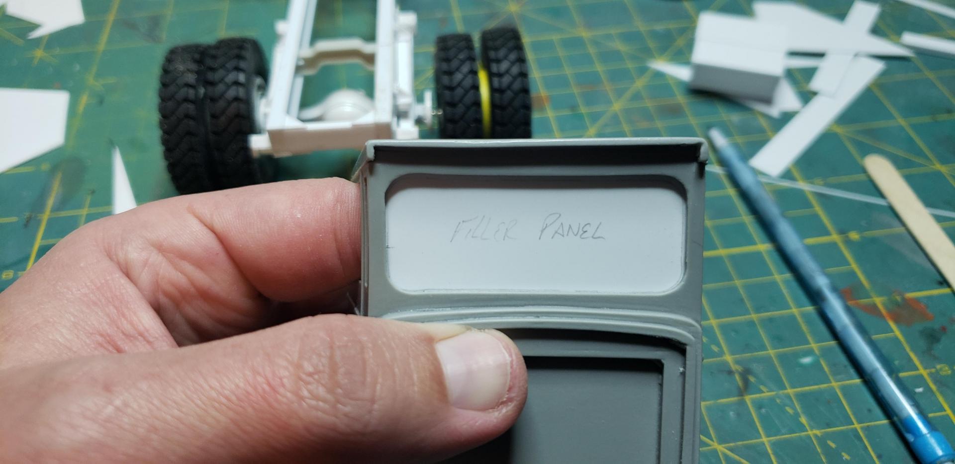

gotnitro? Posted December 15, 2019 Author Posted December 15, 2019 Ok I broke out the power tools and modified the windshield location. Its roughed in right now without any filler , but wanted to share and get opinions. Before making the insert pattern After gluing into the opening, drilling the corners and cutting the new opening I havent tampered with the trim yet, as the 1-1 has both strips, these just run short. The top molding should extend to the hood and be lower Any feedback welcome

Flat32 Posted December 16, 2019 Posted December 16, 2019 (edited) Looking at top of cowl relative to bottom of side windows. Original windshield relative to cowl wasn't too bad actually. Side window bottoms and beltline moldings (relative to cowl) is more prominent inaccuracy. Model will look good regardless. Edited December 16, 2019 by Flat32 Added cowl ref
gotnitro? Posted December 16, 2019 Author Posted December 16, 2019 Thanks for input, the issue was discussed on social site, and was determined that Oshkosh had changed cab after 1971. The wipers location changed to above glass instead of the cowl. I didn't check the truck serial number when I visited, but now curious . As far as the model goes..I'm gonna move the belt line trim down and get the windshield opening cleaned up and move forward. Thanks for all the feedback helping make it more accurate Stay tuned !!

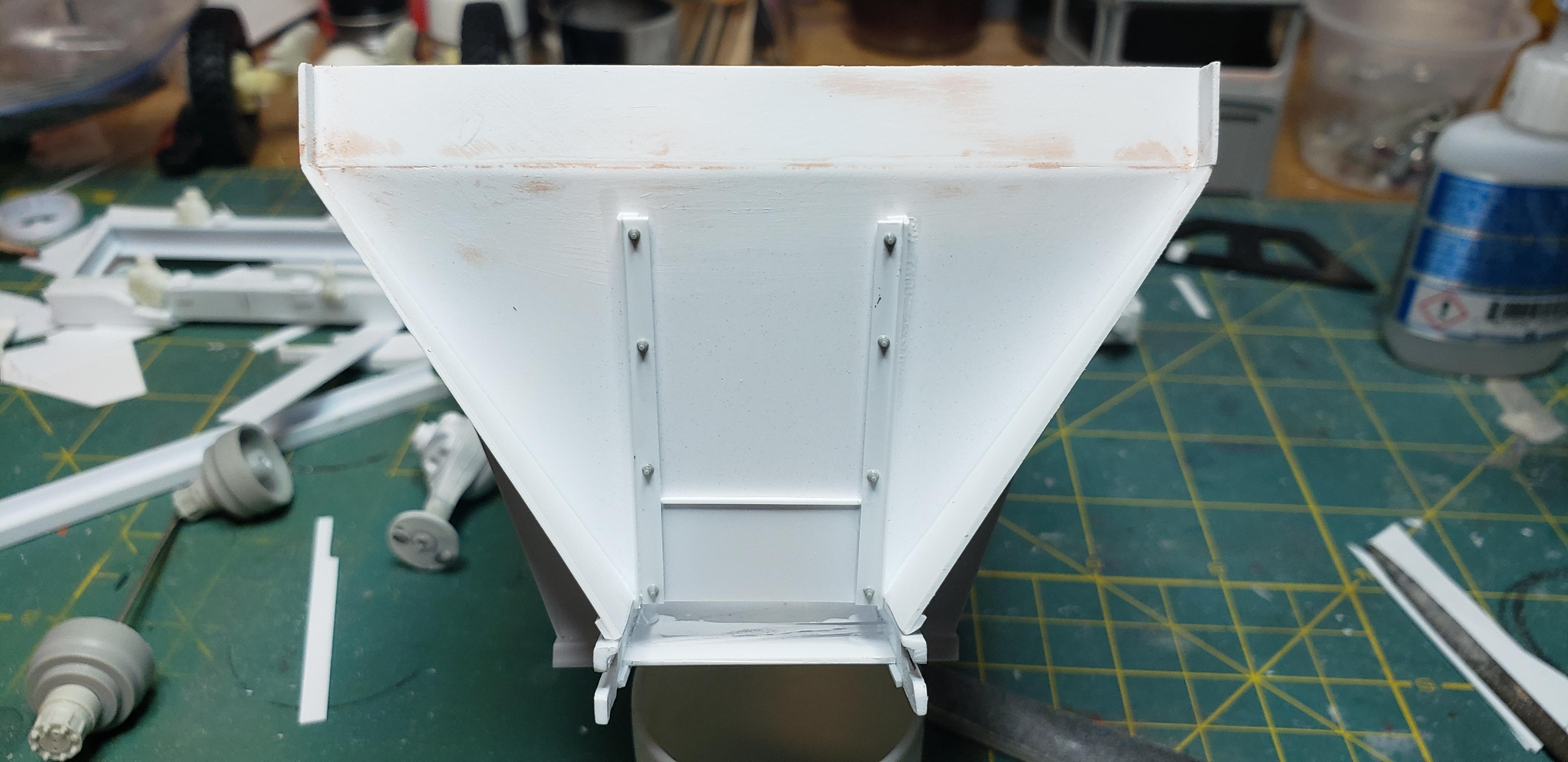

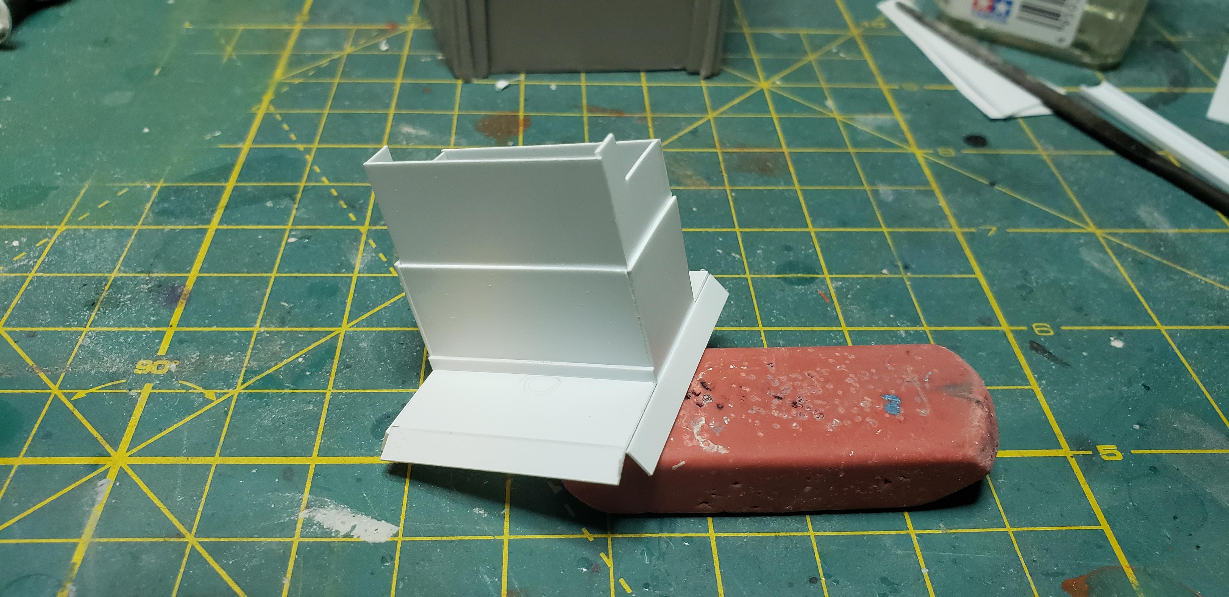

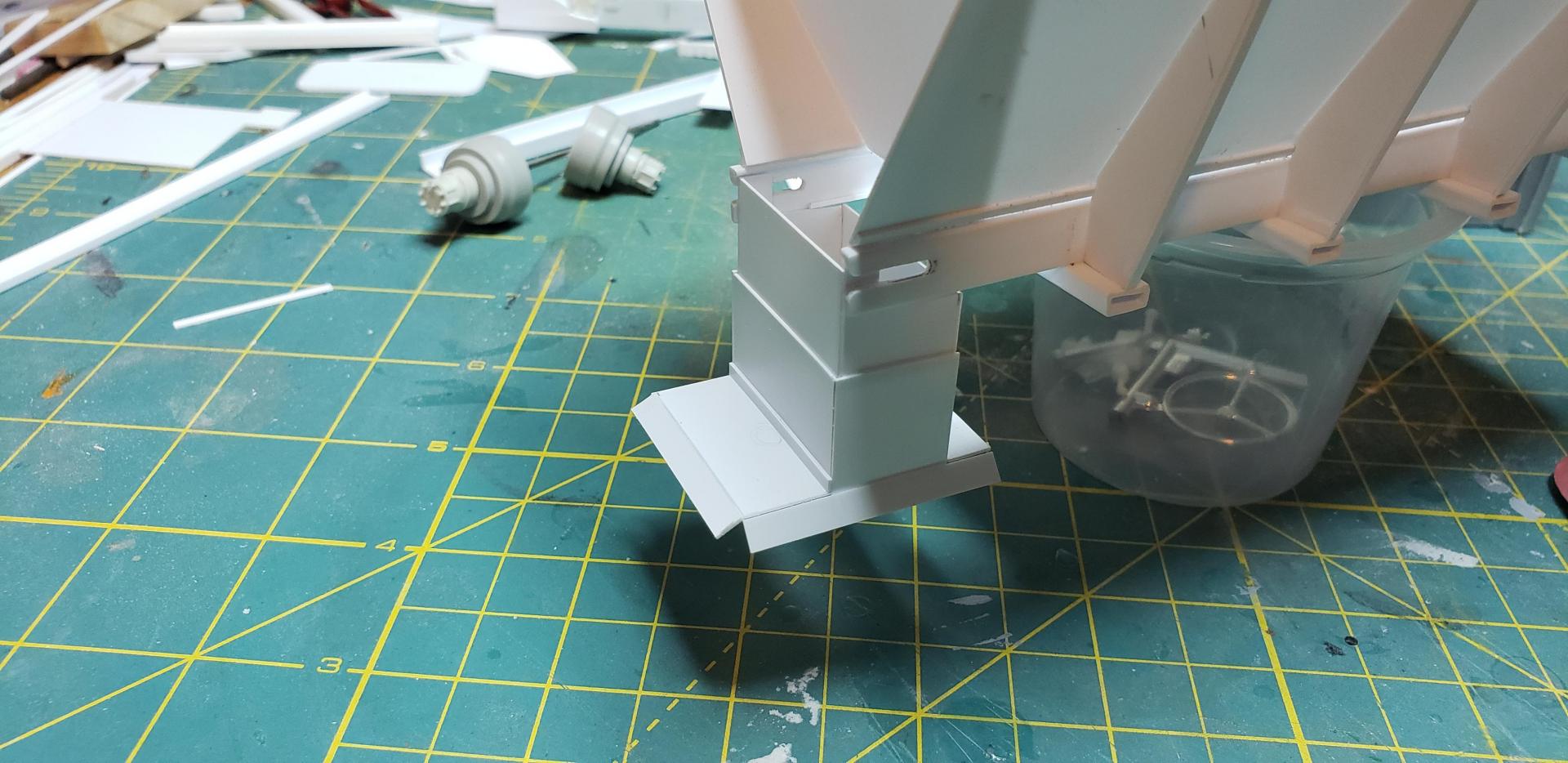

gotnitro? Posted December 18, 2019 Author Posted December 18, 2019 Thanks Bob ! Added the side supports last night and roughed in the spreader chute. While the tamiya was curing I started detailing out the product door and rails. Meng bolts and angle finished the door track thanks for following
