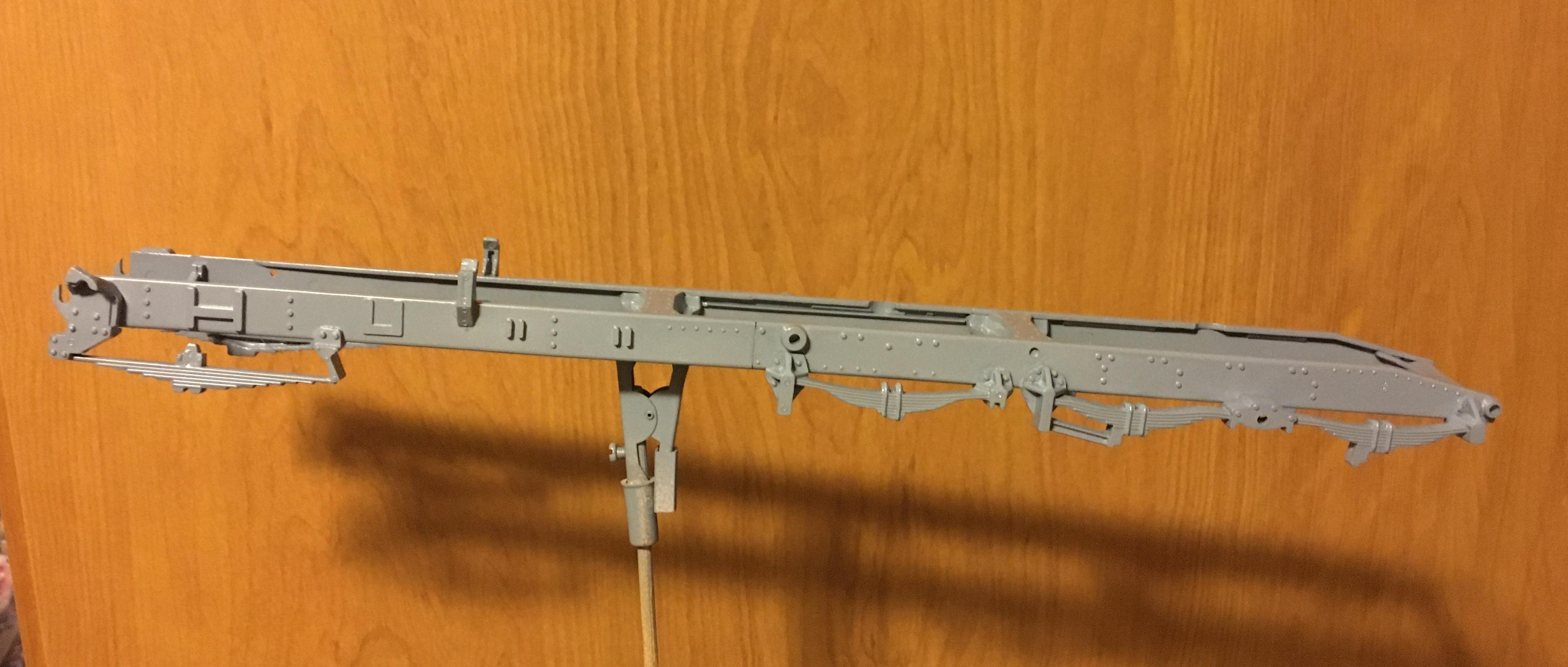

Bills72sj Posted January 3, 2020 Author Posted January 3, 2020 I have a bit done. The engine in pink and a few other bits painted. Due to an unfortunate choice of black paint, the frame has spent more time in the purple lake and brake fluid than it has been worked on. The rectangular head light conversion is done.

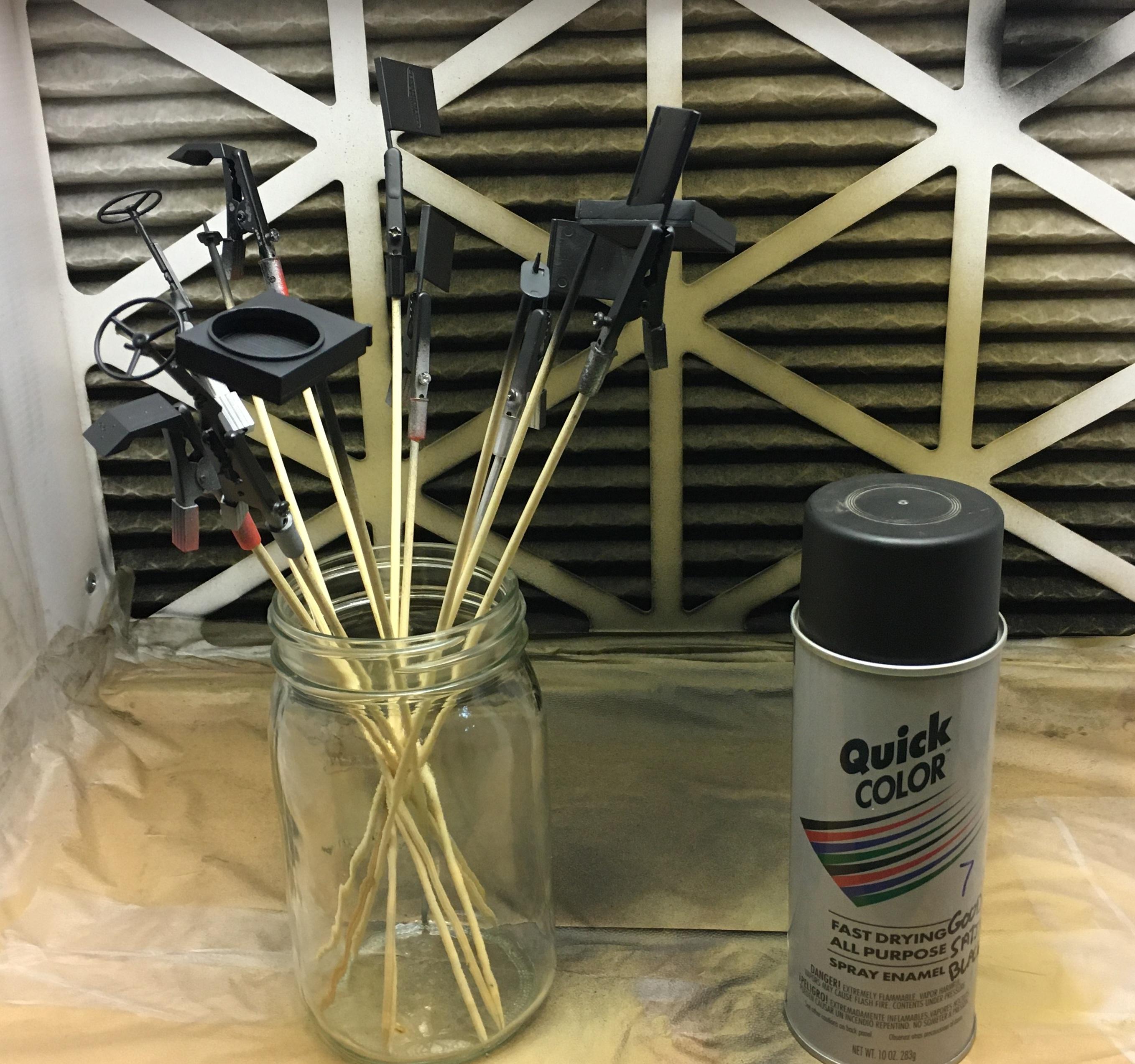

Bills72sj Posted January 4, 2020 Author Posted January 4, 2020 FINALLY! The humidity was low enough today to paint. I have been waiting since Thanksgiving. I really put my new paint booth to the test. I sprayed 8 different rattle cans of paint in the spare bedroom WITHOUT my wife's sensitive nose going off. ☺️ If I can resist the urge to fingerprint my parts, I may make some progress this weekend.

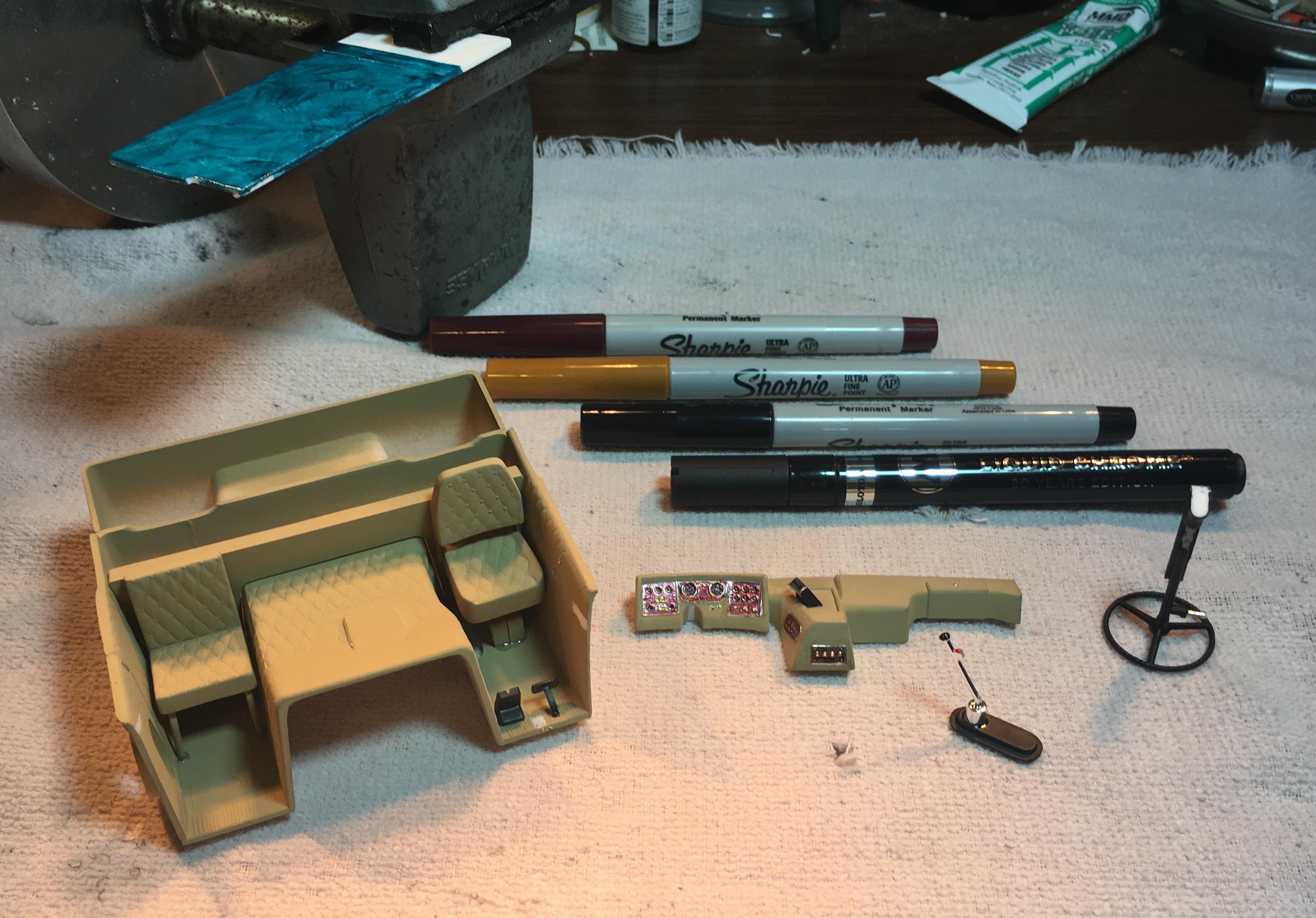

Bills72sj Posted January 6, 2020 Author Posted January 6, 2020 (edited) Made a bit of progress this weekend. Interior started. Wanted to work on the frame but my ancient primer is still a wee bit tacky. Spent all Sunday afternoon blacking out the grilles for both of my Freightliners. Edited January 6, 2020 by Bills72sj added pics

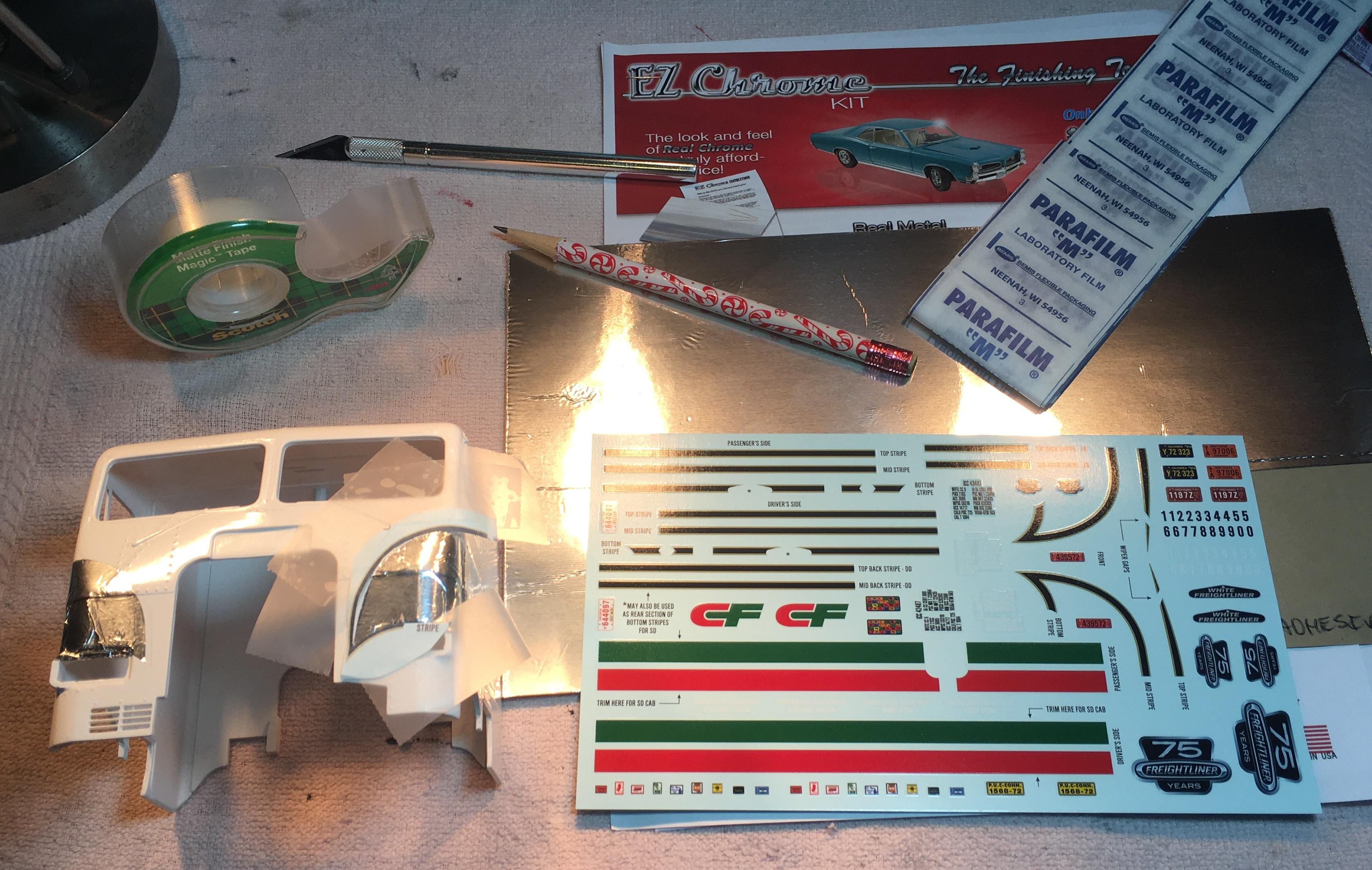

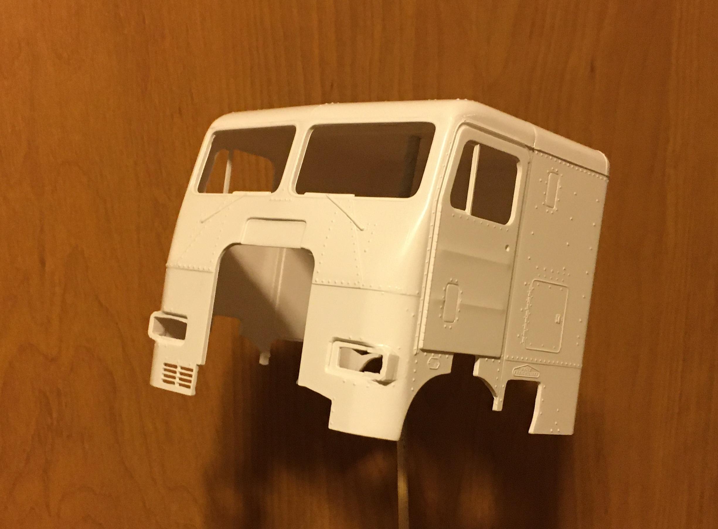

Bills72sj Posted January 12, 2020 Author Posted January 12, 2020 Made a little progress. Cab base color is cured so I had to figure out how to mask it for second color. The kit decal stripes are thin and have no instructions on where they go. Besides that the artwork on the box is actually off. I am also doing a swap of the red and white on the bottom half. I copied the decal sheet on my printer copier so that I could cut the stripes lengthwise. I then used some off brand BMF (which has too thick of glue) and laid it on the front of the cab. I scotch taped the paper decals in place then cut the foil to use as a mask. Once that was done, I used Parafilm to mask off all of the straight lines due to its SUPERIOR masking abilities. The cab is now ready for the 2nd color. (Now I have to wait for the humidity to be low again). I have the interior detail painted and am waiting for paint to dry before final assembly.

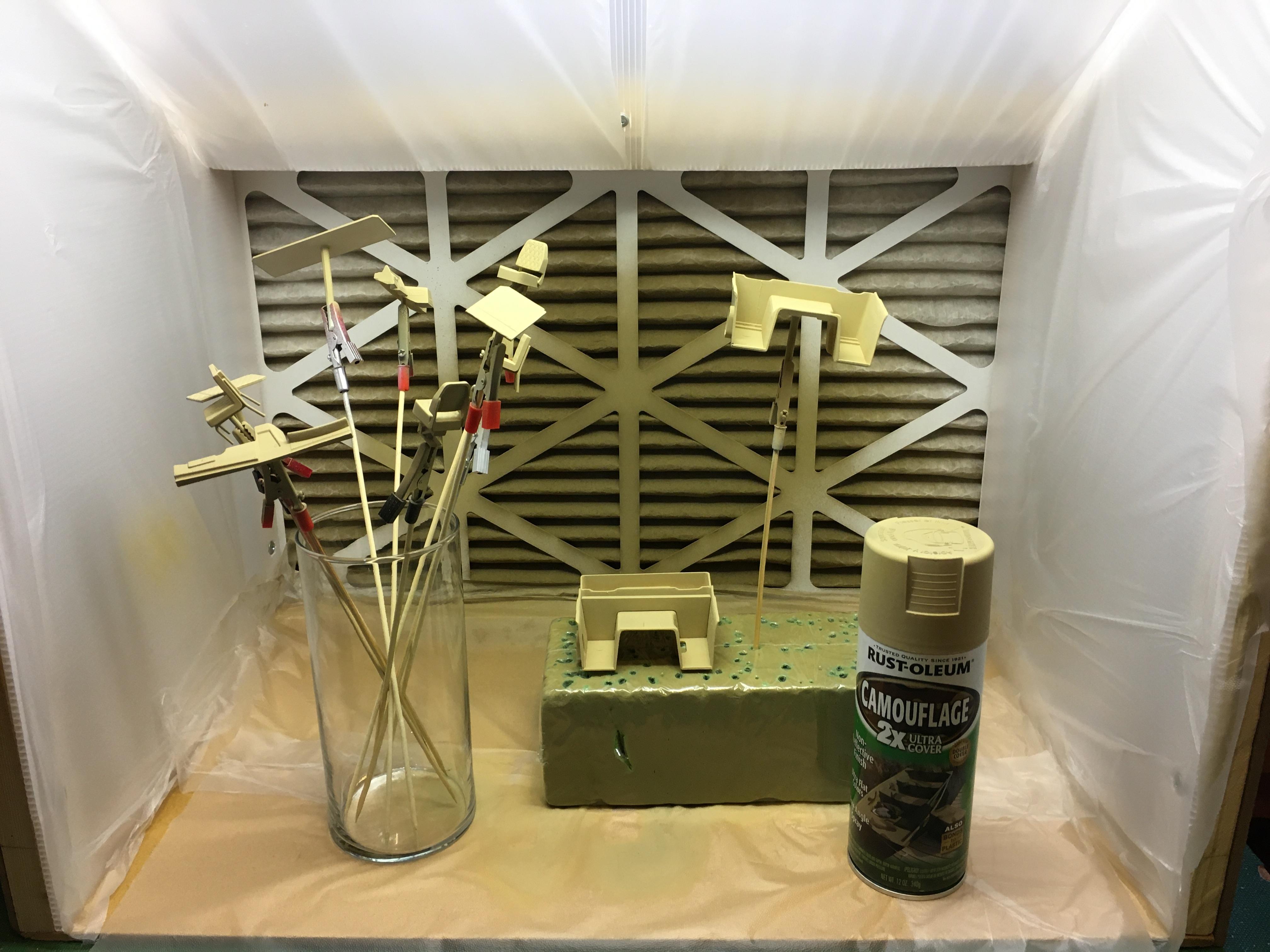

Bills72sj Posted January 21, 2020 Author Posted January 21, 2020 Made a little progress while waiting to be able to paint. Assembled interior and just masked it off to spray the bottom.
