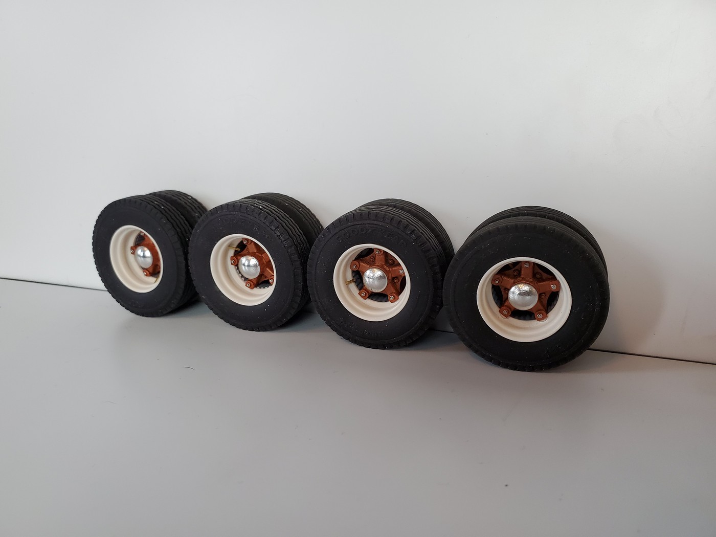

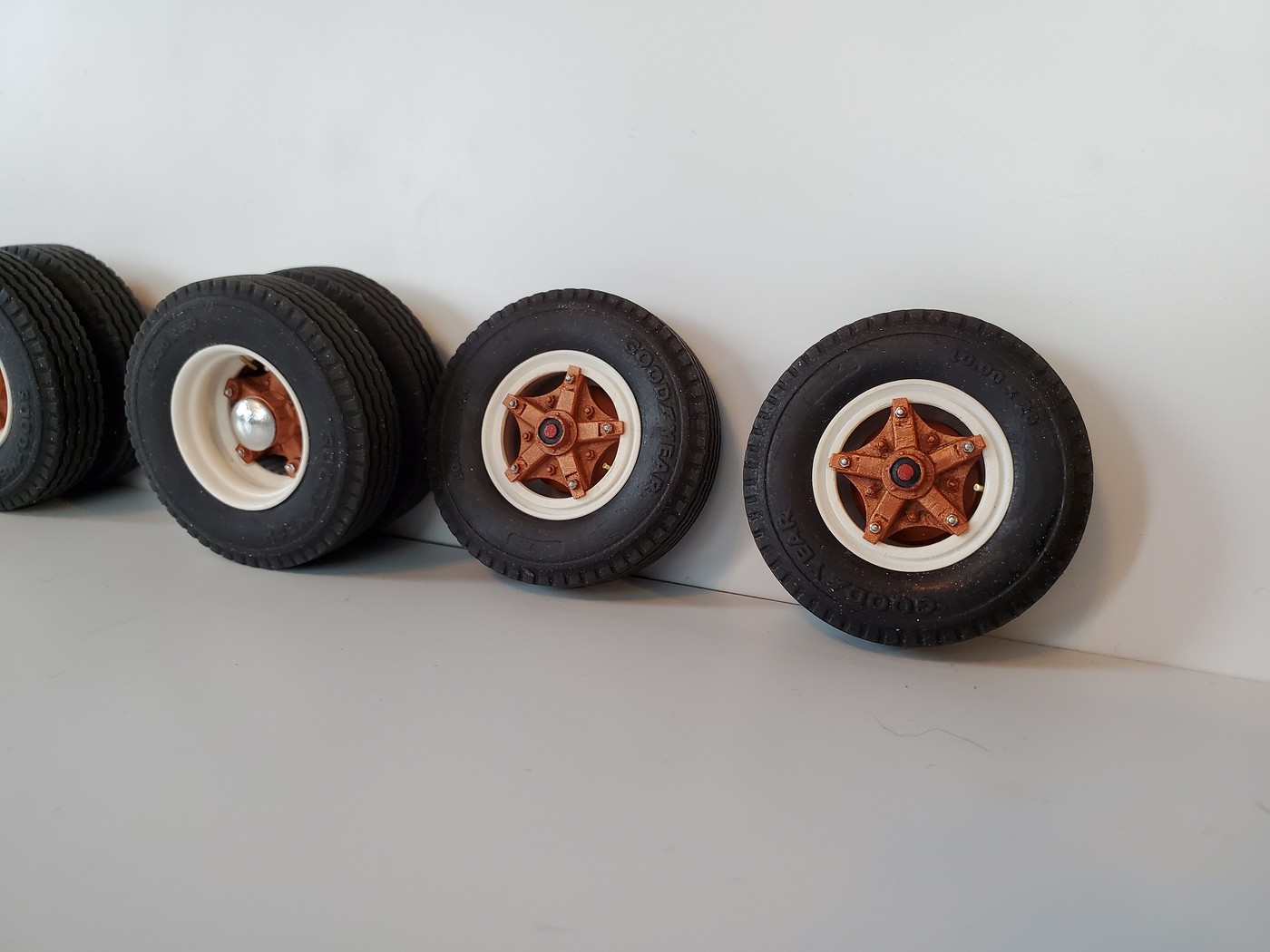

KJ790 Posted January 10, 2020 Author Posted January 10, 2020 Thanks guys! I am a weirdo and almost always start my builds with the wheels first. For this build the kit wheels are going to the parts box. I had some old blemished dayton hubs that I had held onto from when I used to cast them. I had to make new molds for my tubeless dayton rims and cast up a set for this build. Some rubber tires and baby moon hub-caps complete the wheels. I still have to do some light weathering. This gives you an idea of the main color of the build, a metalic brown with a hint of red added.

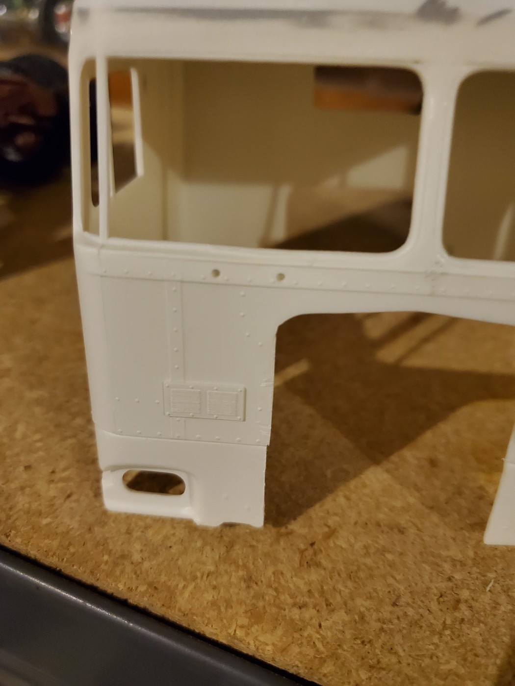

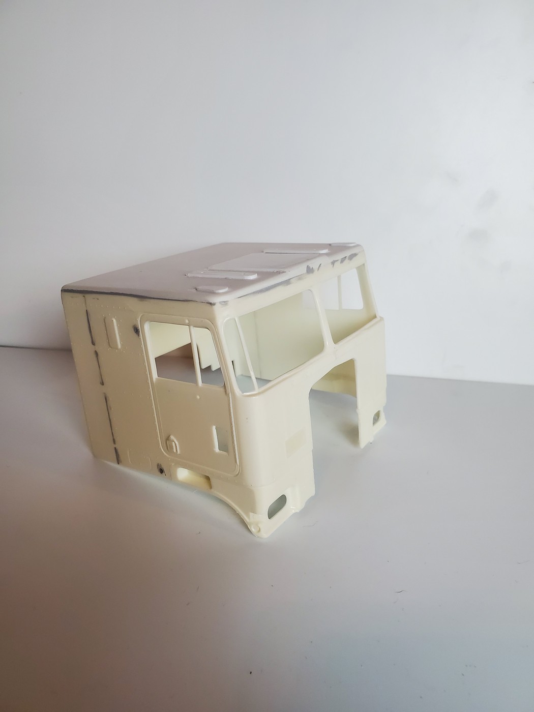

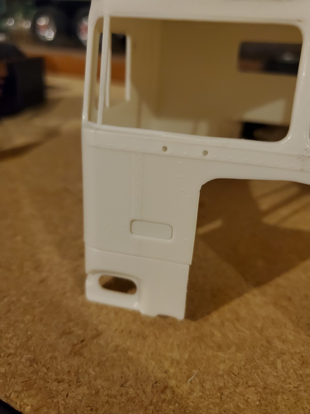

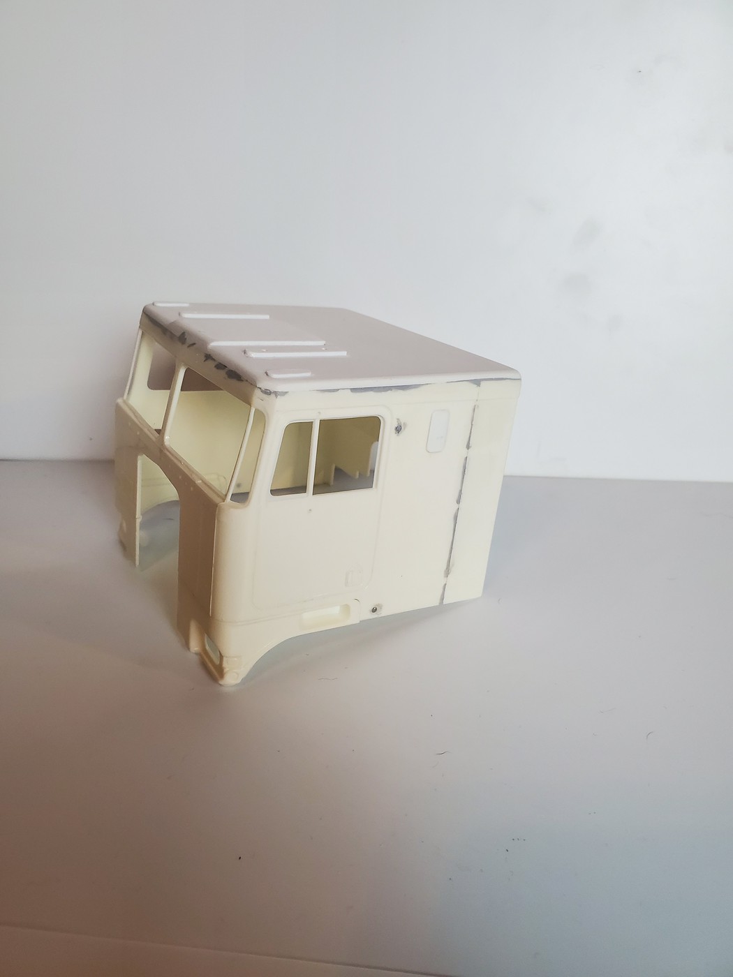

KJ790 Posted January 11, 2020 Author Posted January 11, 2020 I worked on the cab a bit. I cut off the roof and shortened the length to 86 scale inches. I made the seam int he side line up with where the rear grab handle of the step ladder will go to help hide it. This way I could try to preserve as many of the kit rivets as possible. I made the new roof out of some .060" thick styrene sheet. The raised areas in the roof were cut and sanded to shape out of .040" styrene sheet. One thing that has always bothered me about this kit is the lack of the heater vent detail in the front. There is a weird oval indent like the vent was a separate piece at one time, but it does not seem to be included in the kit. I made some 3D printed vents a while ago to rectify this. This will be my second build using one. Here is the kit as supplied: And here is the 3D printed vent in place: The panel seem is in the wrong place on this kit, as it is not supposed to be going through the middle of the vent. That will have to do for this build though.

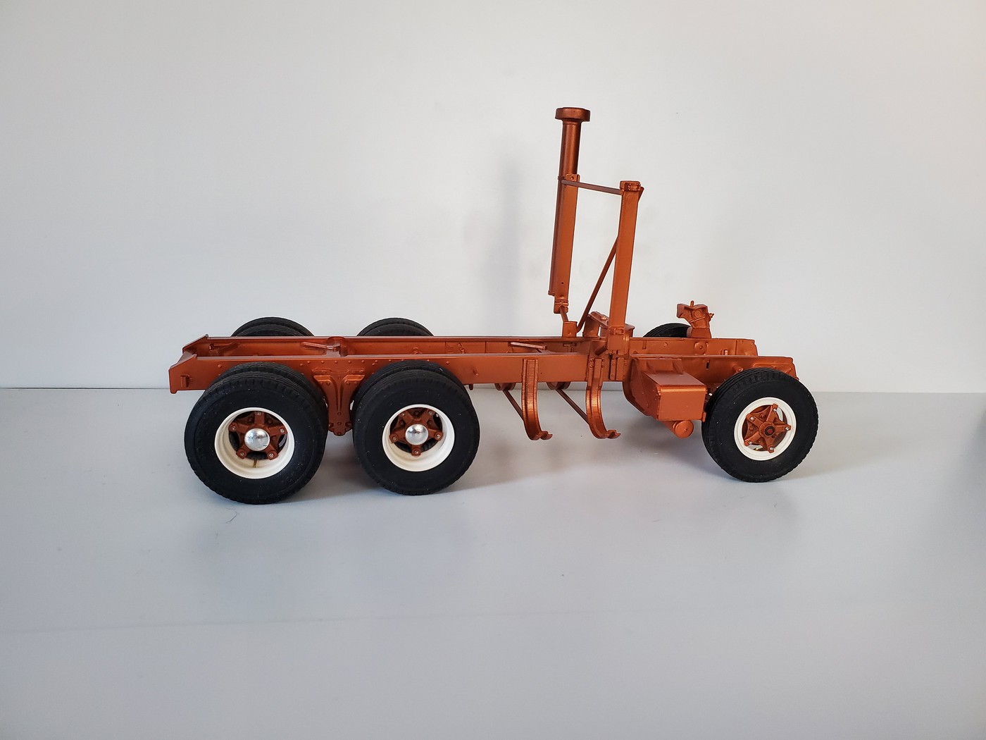

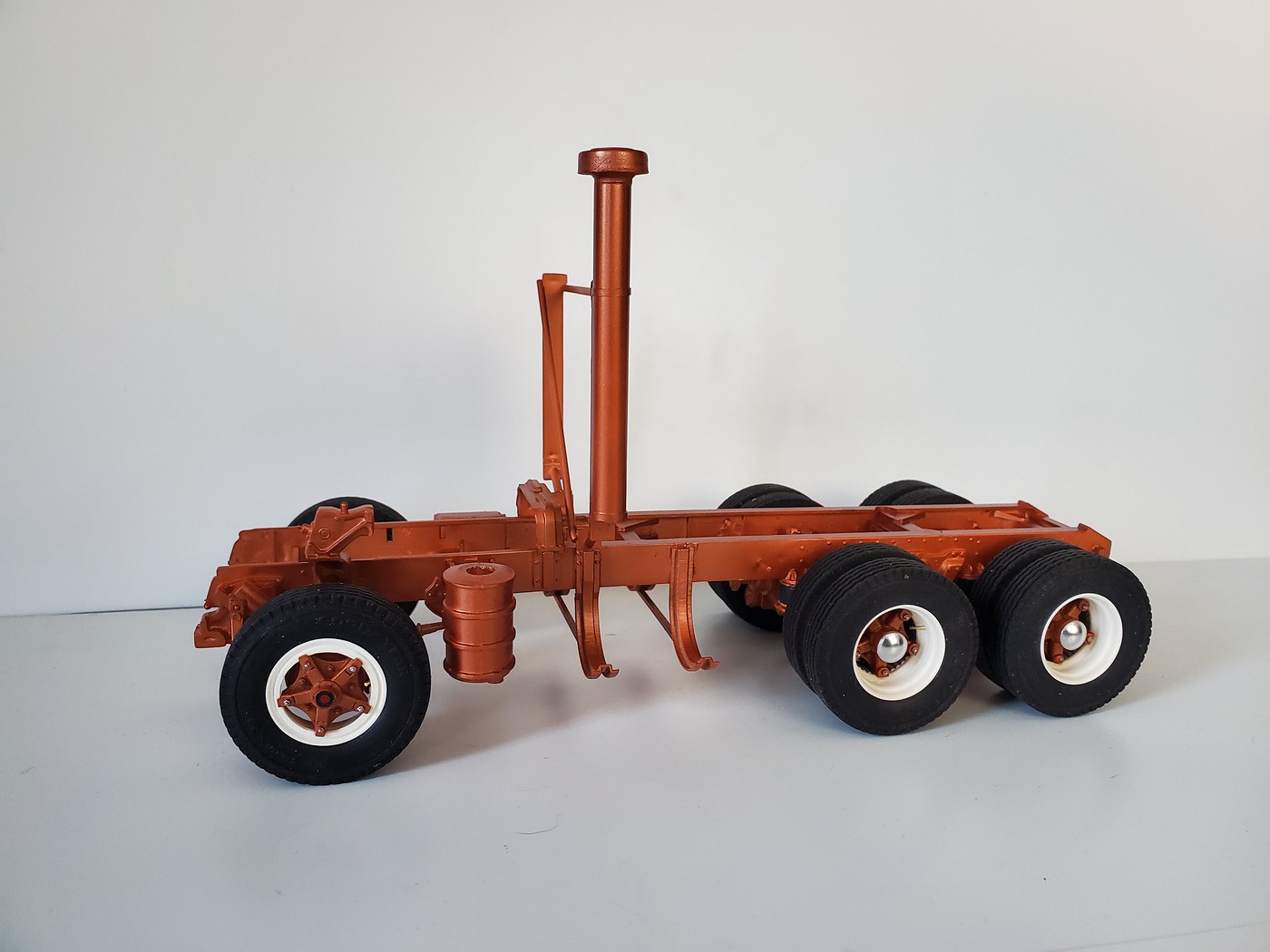

KJ790 Posted January 21, 2020 Author Posted January 21, 2020 I was able to get some color on the chassis this weekend.
