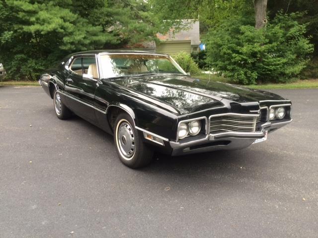

One of the cars I remember fondly from my childhood is the 1971 Ford Thunderbird. My Aunt and Uncle owned one and I had occasion to ride in it many times. It was fast and powerful. The body styling was almost as cool as any Batmobile and the interior followed suit. The high-back bucket seats and center console gave the interior a feeling of performance, rather like the cockpit of a fighter jet, while wrap-around rear seat gave the car a custom feel. Overall a very cool car and if I had my own "Jay Leno Garage", I would definitely have one of these in it.

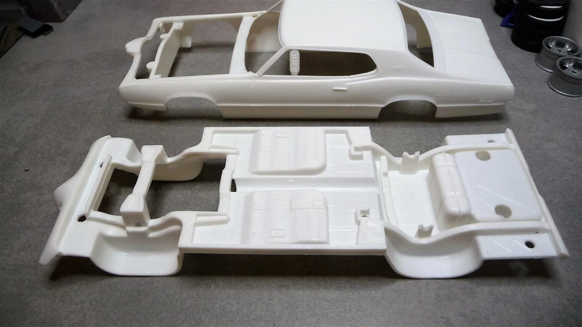

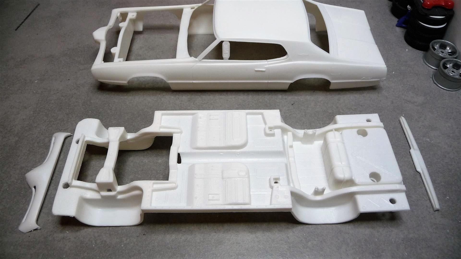

Great start, I really like these cars. The front pan under bumper Can cause fit issues when completing it. I removed mine from the chassis and fit it prior to paint. Rear may also be done similarly. I'd also think about elongating the axle holes in front, and it sits nose high, and T-birds usually did not. If you're doing a wheel swap, perhaps even more. Cool stock colors available too exterior and interior.
Good luck, watching
I'll second that about the pans. I don't think you'll ever get a really good fit with them still attached to the chassis plate. It holds them from going into place properly.

Thanks for the comment Duke. During some of the test fitting sessions I did, I noticed that the front bumper piece attached to the chassis plate was going to require some adjustment to fit properly, I just hadn't determined what yet. Cutting it loose seems like a very viable option.
I had also considered lowering the front suspension a bit too, probably about 1 or 2 mm. I think I'll go ahead on that one. Thanks for the tip.

Thanks for the input Steve. Since that part is a chrome bumper, I had planned on spraying it with Alclad. Having it loose will make that easier.

It's not actually part of the bumper, it's just a sheetmetal pan.
On the '70 cars they're painted body color but, yes, on the '71s they seem to be either plated or painted bright silver.
This is a '70.

I had no idea Duke, I don't recall ever seeing one painted like that. The cars I remember seeing had that bit chromed so I assumed that it was a bumper. There were some massive bumpers during that era after all.
In any event, I plan on chroming that part and that will be easier to do with it separated from the chassis plate.

Here's the first thing I did:

OK, hunted my usual suspects, Tbird club of America, some hole in the wall parts places that have zero repro parts (easy, there are none )
It seems it was a plated front valance that was dealer installed in place of the standard metal one. The N-M cars had it (they were 71's listed in 70 catalog. A random few had it, I saw one 70 thinline grille car with it, and a couple Landau coupes and 4 doors with them. I guess people wanted them to look like the sweet new crash bumpers.Riiiight. It really kills the front end, makes it look ordinary. There were also some of the ugliest GIANT bumper guards added on.by dealers. Thankfully the fake convertible top silliness hadn't hit Ford until 74-75. Bleagh.
Build it as you wish, but I like the 70 grille best followed by the 71 grille with the fake hideaway headlights and body color pan. I've got a 69 Radio Promo sitting here ready to sacrifice it's rear deck for a Landau. A complete 70 Motor City from Ebay, like new, a reissue 71, and a builder 71 for the Landau swap. Nice way to kill a sunny afternoon with the dog and a Torano 1959 burning.
PS, our friend Casey resuscitated an 8yo dead thread to bring us that thread. Kudos to him.
Edited by DukeE
casey
Well, all I know is when I do a Google image search for "1971 Ford Thunderbird" all the pics of them have the bright front pan
and when I do a google image search for "1970 Ford Thunderbird" all the pics show then with a body color pan.
So, I'd say David is %100 correct with the bright pan on his build.
You're right.
I couldn't find any replacement bumpers from either year, so no idea what factory parts numbers were. That shape is begging for dents, and since scarce to start with, I'd think there'd be something either repop or repaired. Factory literature really doesn't show that or even mention it. Just odd.
