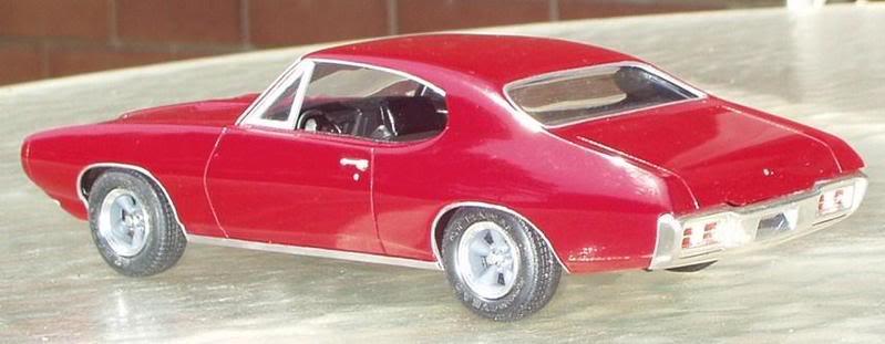

Snake45 Posted January 27, 2020 Posted January 27, 2020 I don't normally use Krylon for a final finish on model cars, but I did paint this glue bomb rebuild '68 GTO with their red. This is NOT clear-coated; it's just 3 or 4 coats of the Krylon red polished out with Wrights's Silver Cream. I tried to paint a Chevelle Wagon with a Krylon blue, but didn't like how it was turning out. I found the stuff strips right off with 92% rubbing alcohol, so, no harm, no foul. Currently I'm working on a dune buggy I just painted with Krylon Shimmer (metalflake) blue. It was pretty shiny right out of the can but I'm rubbing it out with the Wright's for a little more shine, and it seems to be polishing up nicely.

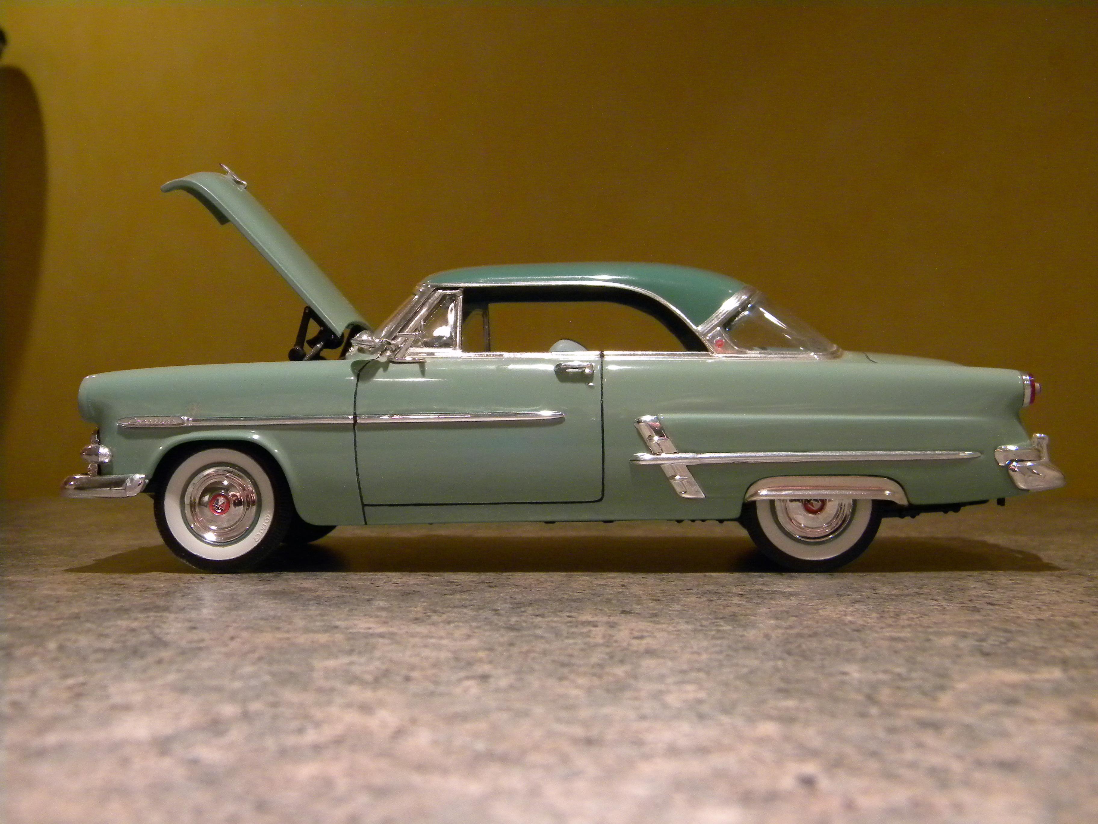

StevenGuthmiller Posted January 28, 2020 Posted January 28, 2020 (edited) One option, although it might not be viable for you as it requires an airbrush, is to mix your own colors using Testors jar enamels. I have used Testors flat enamel in the past and clear coated them with either Testors enamel or lacquer clear coats. Flat enamels are nice for spraying because they are less prone to running or sagging, don't hide detail, and dry very quickly. Be wary of spraying enamel clear over light colors though as it is very likely to yellow in very short order. I'm sure that you could use flat sprays just as effectively as an air brush. Just some thoughts on a technique to try. This '53 Ford was sprayed with custom mixed flat enamel and clear coated with Testors lacquer and polished. Steve Edited January 28, 2020 by StevenGuthmiller

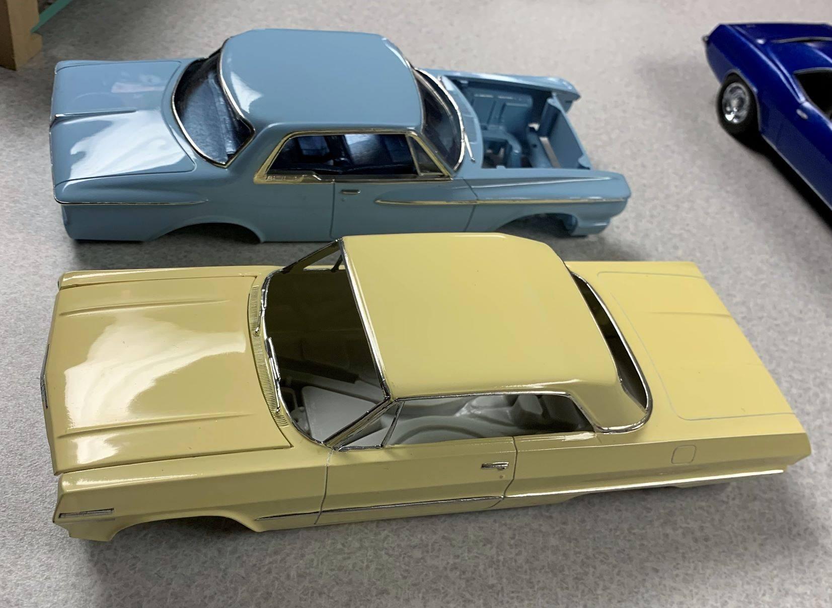

moparfarmer Posted January 28, 2020 Posted January 28, 2020 13 hours ago, JollySipper said: I'm needing to find a cheaper alternative to the DupliColor that I've grown to love because the stuffs $11 a can now.... I'm thinking of giving Krylon a try. Does anyone have pics of models with Krylon as the final paint? I'm a slick and shiny person, so those kinds of paint jobs would be the most helpful.... Just out of the can, the enamels seem to look kinda 'rubbery' to me. Would wet sanding then clearing help with the look of it? What kind of variety do they have as far as colors go? Any help will be greatly appreciated! Thanks.... Here is a 63 Chev I did with Krylon Fusion enamel..Cleared with Duplicolor Acrylic Enamel..Polished with 4000 wet the done with Meguiar's Scratch X2.0 then finished with Meguiar's Gold Class Paste..I was leary of the Krylon because of the bad stuff I've heard..I usually can with Duplicolor Perfect Match..$17.95 can in Canada then clear with the same as described..To me its hit and miss with Krylon..I've bought a Panther Pink look alike I'am going to try on either a Challenger or Duster using the same technique..
