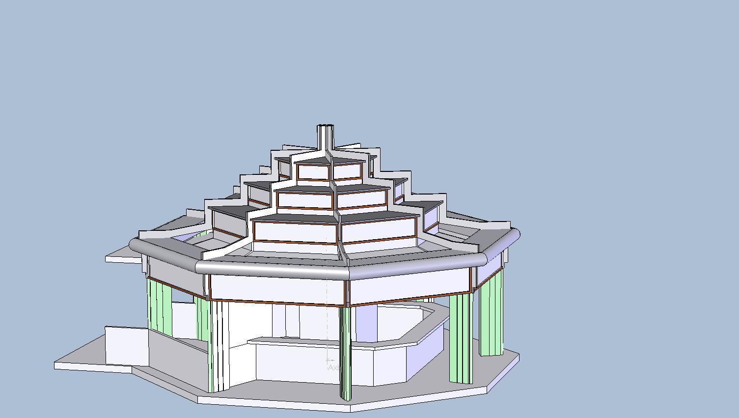

Flat32 Posted March 23, 2020 Author Posted March 23, 2020 A bit of progress on the computer model. Turns out the funny looking ribs stepping up the roof levels are not structural, purely decorative.
Anglia105E Posted March 23, 2020 Posted March 23, 2020 Impressive computerised 3D structure that you have produced, Raymond........ and that should translate quite nicely into a styrene sheet, or balsa sheet scale model. For my first 1:24 scale diorama building I made use of plywood, foamboard, acetate sheet and also good quality thick card. Any materials that allow you to create the shape and contours of the particular building you are constructing will be of use in the right areas. Although foamboard is very nice to work with, it does seem to present problems later with warping, and it is easily damaged. David
Flat32 Posted March 24, 2020 Author Posted March 24, 2020 I can see why you like the 1:43 scale. This building sits on an octagon shaped concrete slab 15 inches across. Would use 1/4 inch tempered Masonite. The scene will have to be 4 foot square most likely 1 inch thick Formular pink foam insulation. Same material can be used for the tiered roof. Interior walls and tiled walls can be 3D printed as well as the columns and roof decoration ribs. The whole counter top with it's supporting tiled walls can be printed as one unit. All of the sign frames can be printed. The rounded overhangs can be formed from aluminum flashing. Sounds almost like a plan. May sound stupid, but I won't attempt building this thing until I have printed signs in hand. I don't want to create the artwork myself because it's not my forte and I don't like doing it. Much rather pay a skilled graphics guy like a decal maker.
