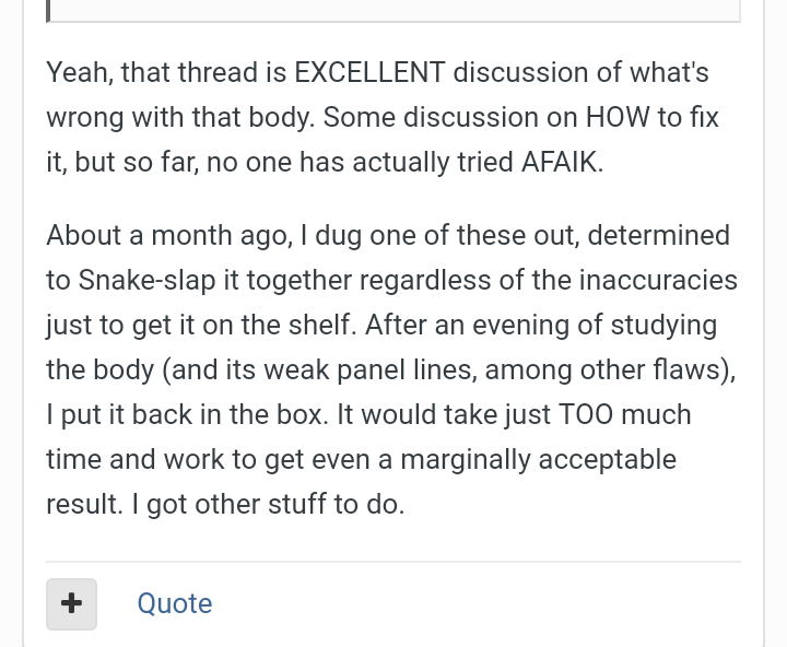

It all started a few months ago with a statement Snake45 made regarding how bad the MPC/AMT 69 Firebird kit is:
That was the motivation I needed to attempt a project I had been planning for a long time.

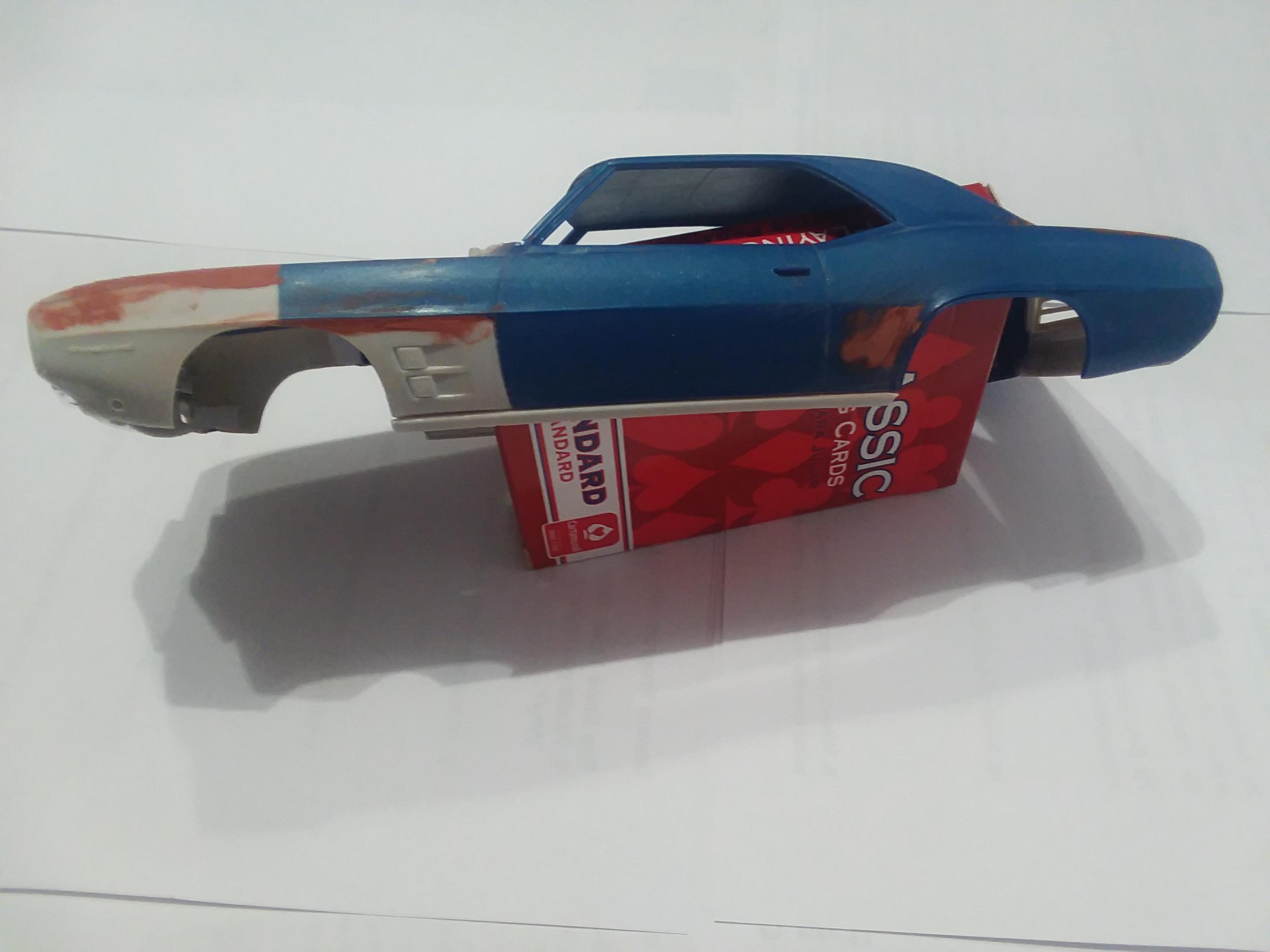

Blue parts are Revell 69 Camaro, light grey parts are 69 Firebird, white is scrap plastic.

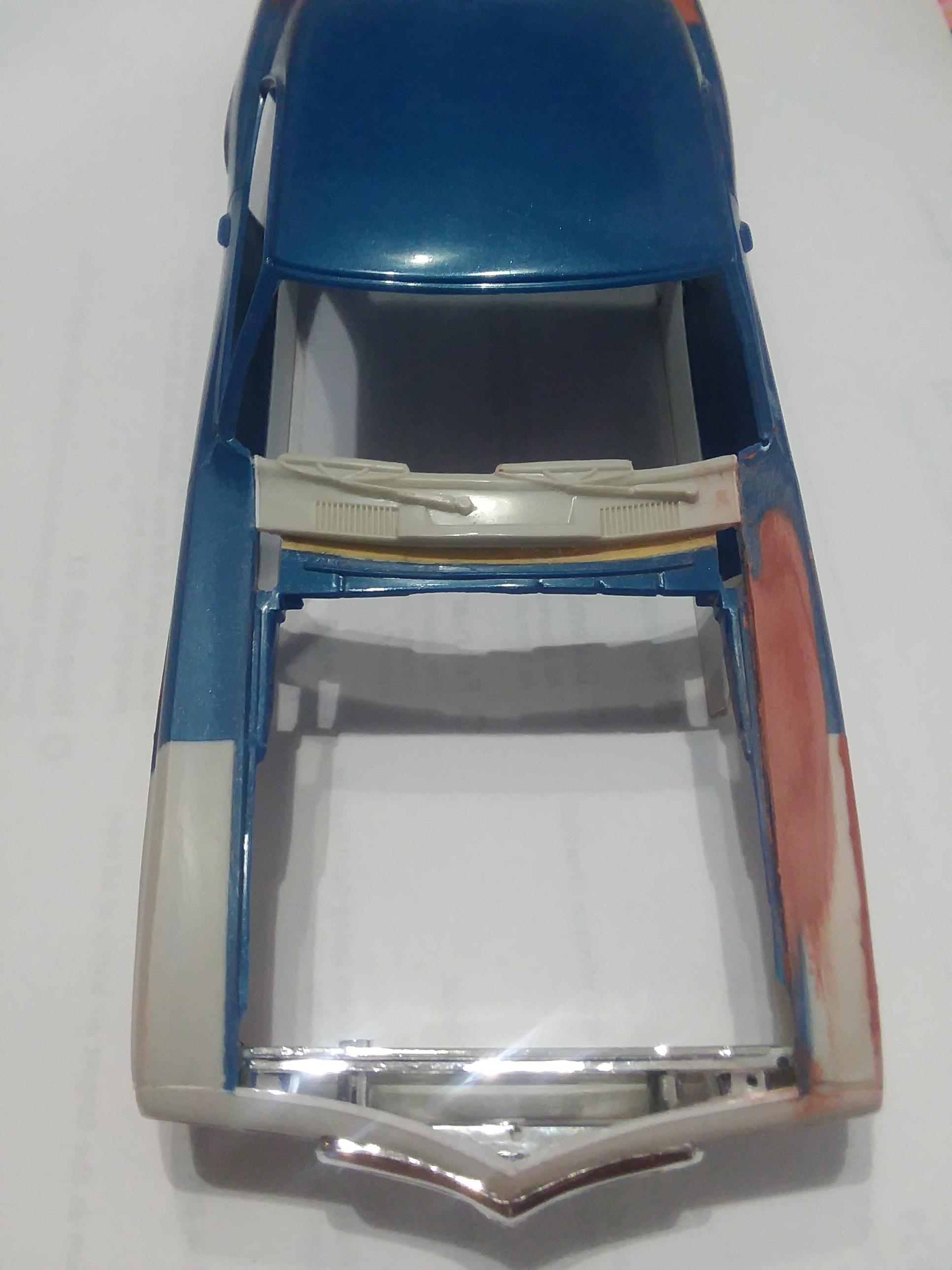

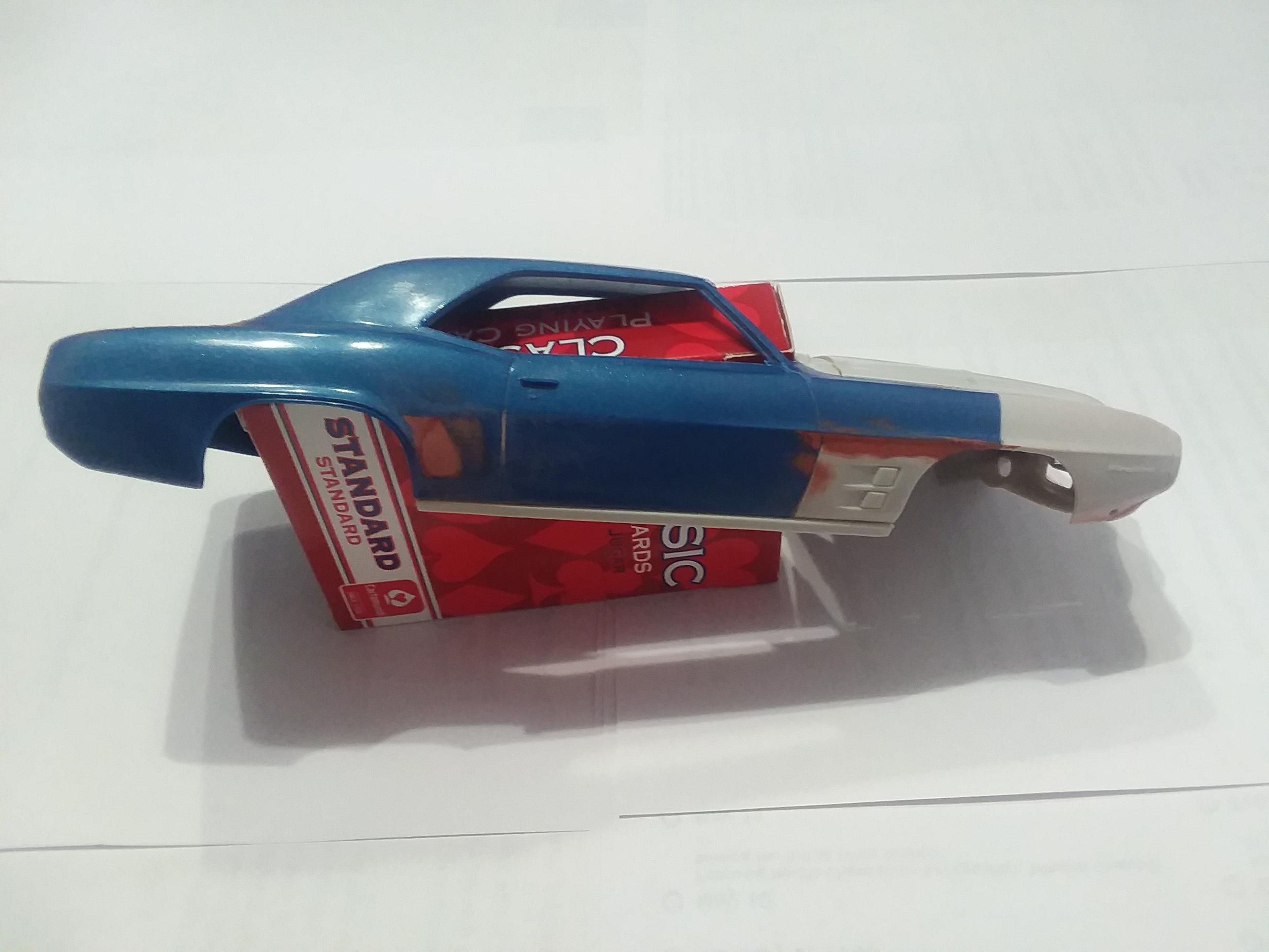

First off, I cut off the nose portion from both kits. I lined them up along the fender eyebrows. Funny thing was, the driver side fender on the FB was 1/16" too tall and I had to section out that much from the top to blend it into the Camaro fender. However, the passenger side fender lined up almost perfectly.
I cut away the lower part of the Camaro fender, just under the eyebrow to graft in the vented parts from the 'Bird.
I filled in the Camaro vents with putty, being careful not to damage the details.
To save the rocker trim, I cut off the trim from both cars first to swap over when the fenders were finished.
Next was to correct the lumpy transition between the nose and the passenger side fender. This was simply done by backing the area with scrap plastic and filling with putty.
I replaced the cowl vent area and the 400 hood from the FB, which took some doing.

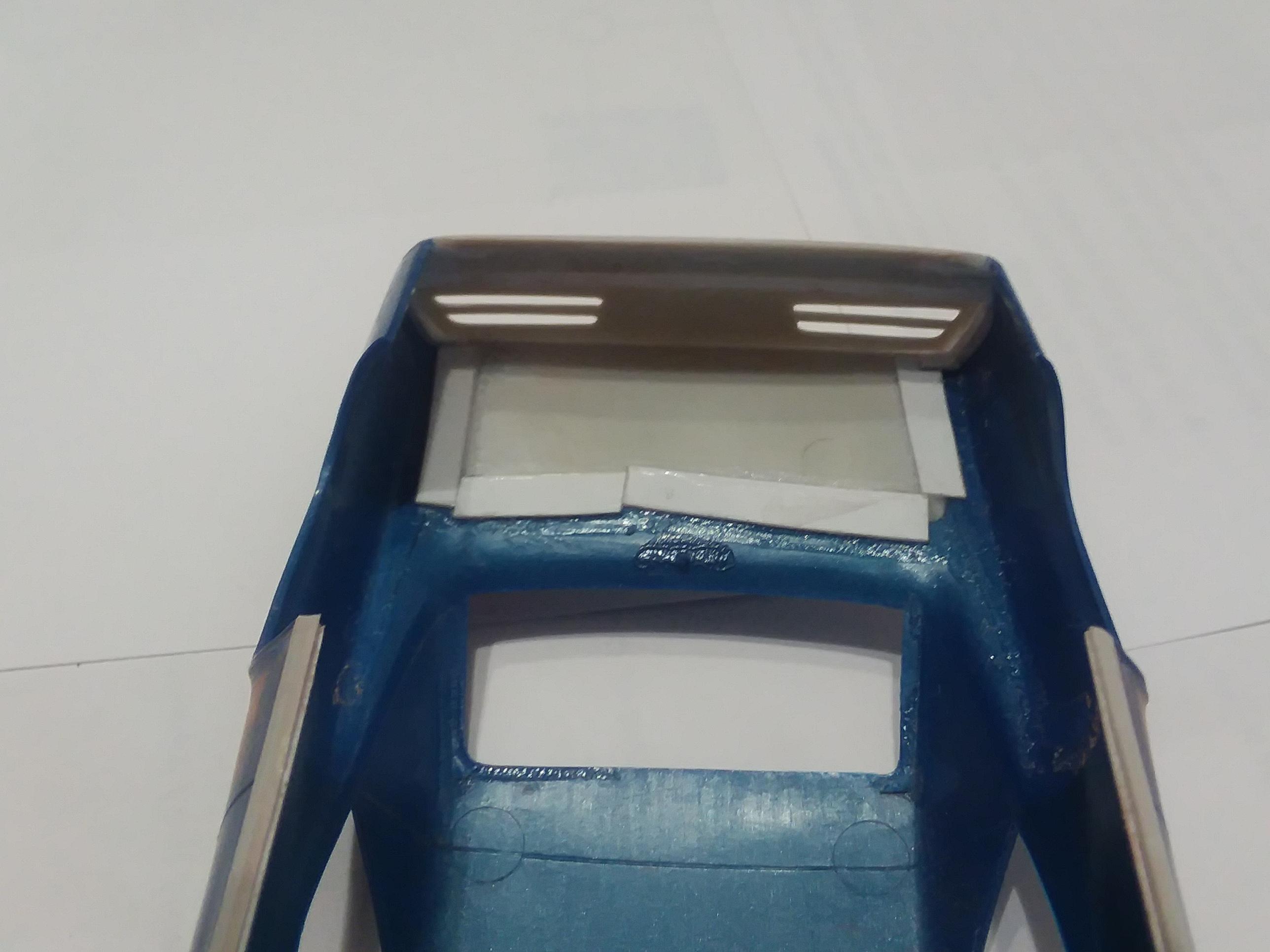

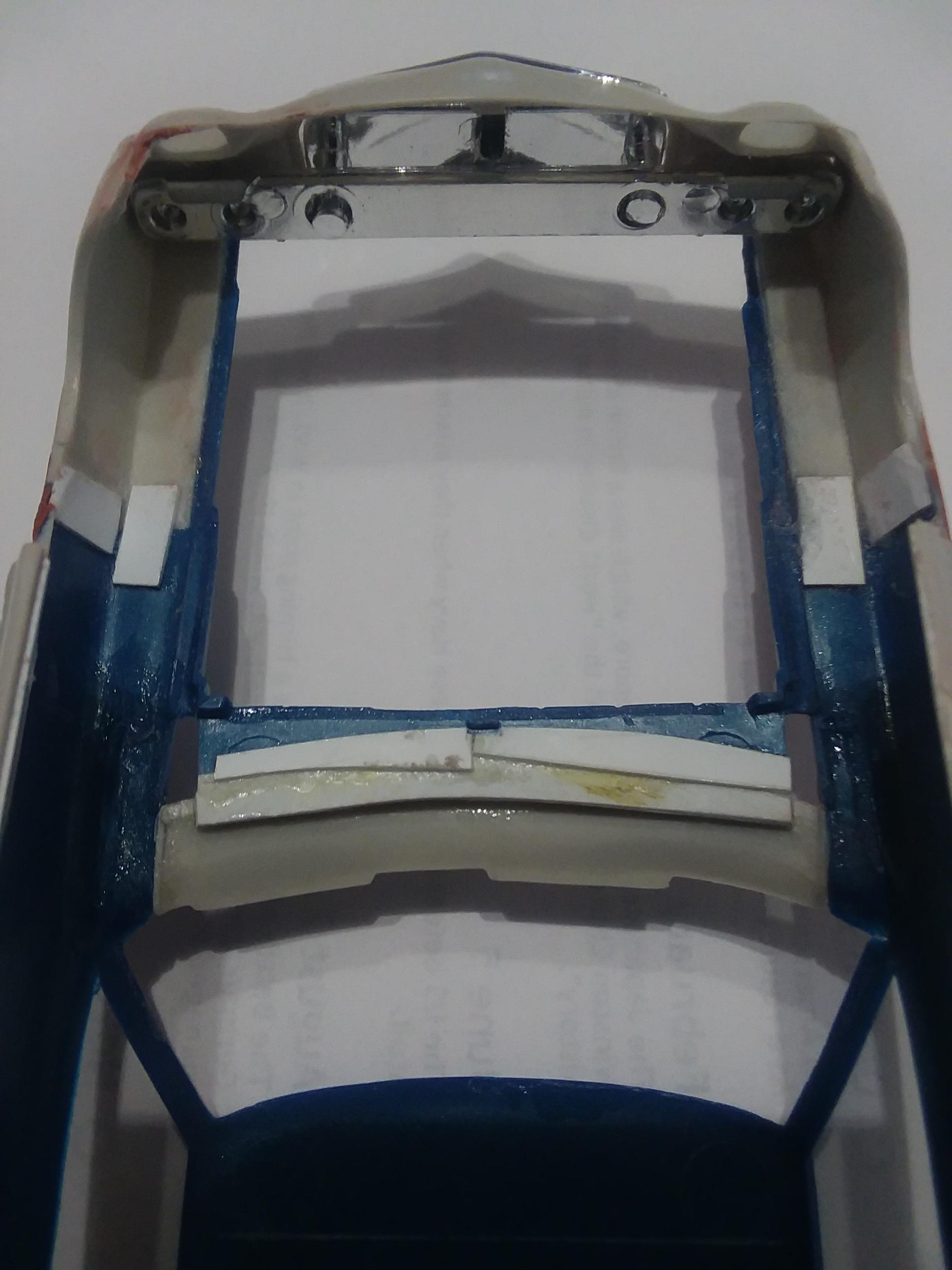

The Camaro cowl is slightly wider, so I added strips of plastic to each side and blended in the plastic - before gluing to the body.
Firewall area was filled with plastic  (including a filler crescent piece under the cowl vent. I blended in the plastic before I installed the cowl vent panel in place.
I prepare the inaccessible areas prior to adding final parts.

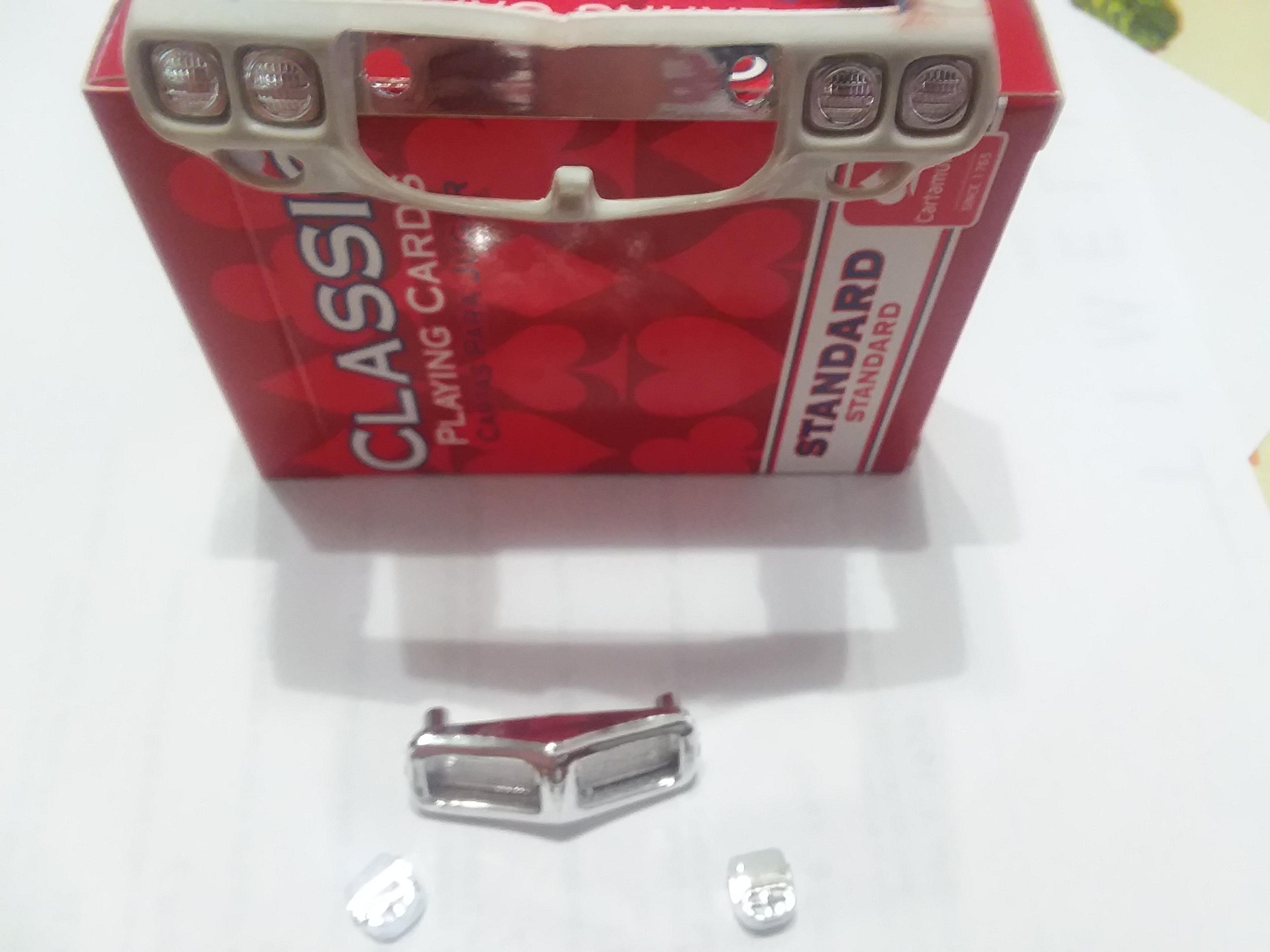

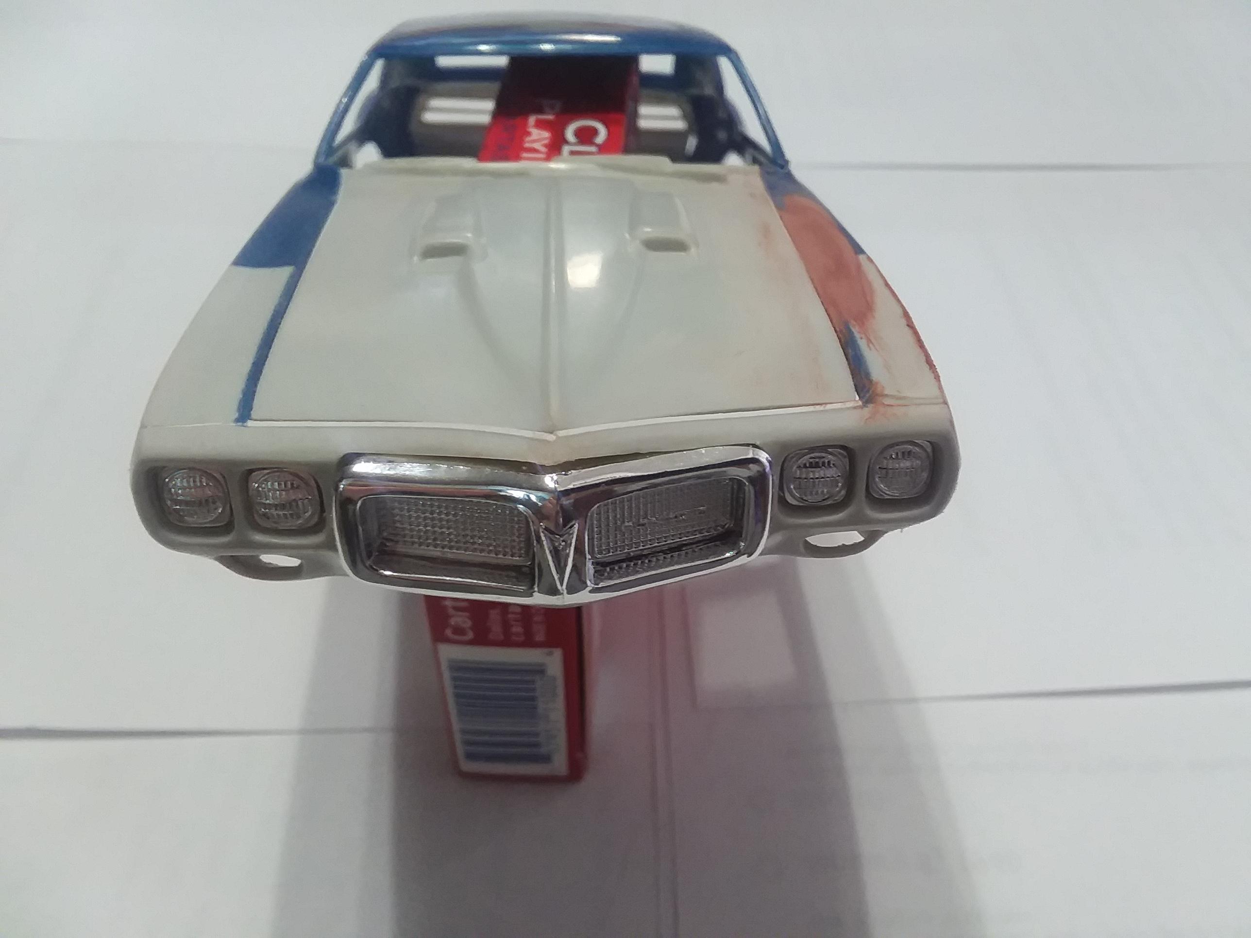

I reduced the tunneled effect on the headlights by cutting off the lower turn signals and pushing the headlights forward. I will leave the turn signals in the proper position by adding some plastic where I cut off the lights.
The grille is going to be recontoured to minimize the blunt look that it currently has and slim down the bulky chrome frame around it. More to come.

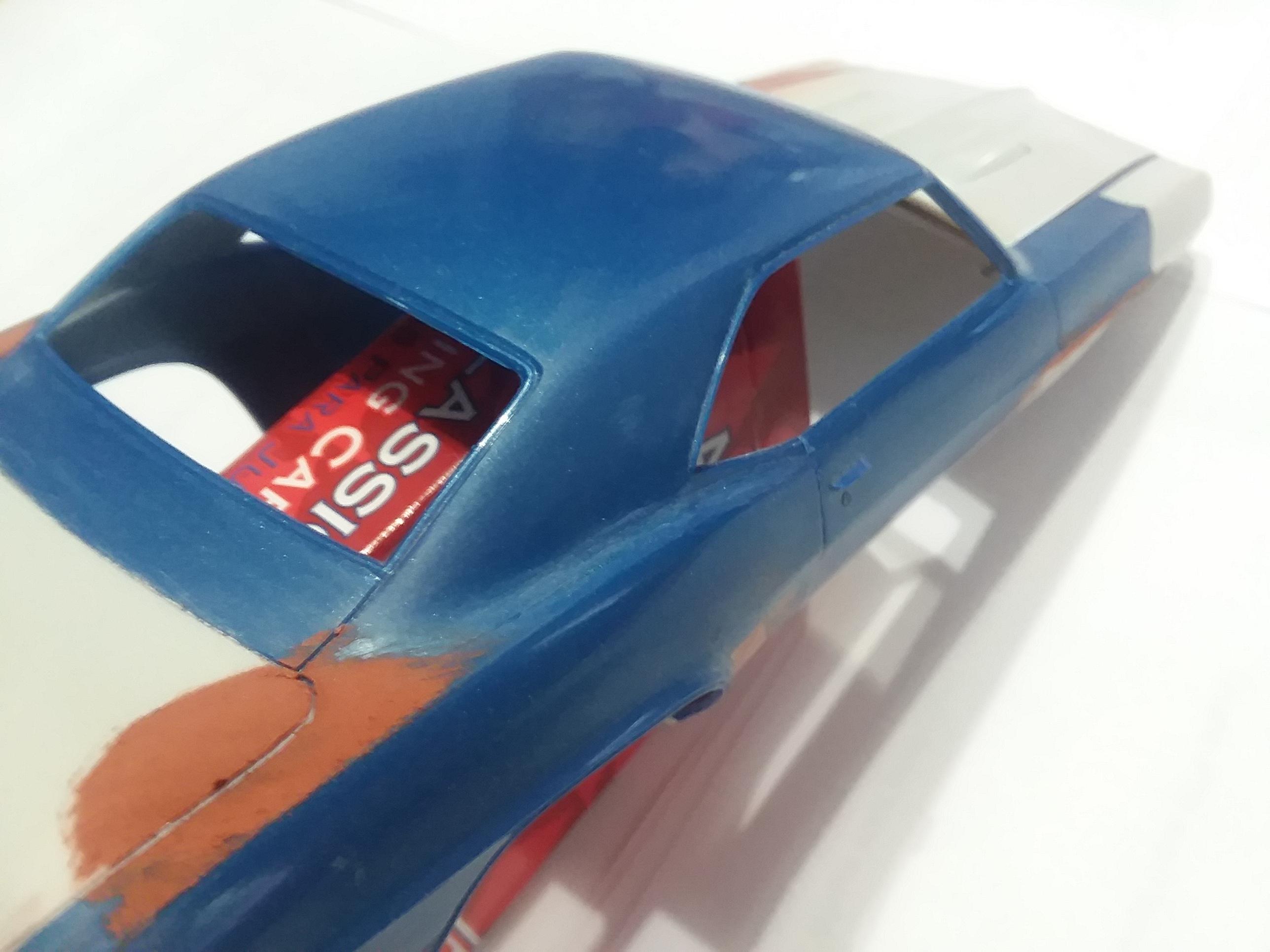

One thing that has always bothered me about an otherwise perfect Camaro body, is that Revell squared off the roof contours too much.
However, it is an easy fix by rounding the corners carefully with a sanding stick.
Expand
The only thing that bothered me is that the rear corner of the drip railing is just a leeeeeeeetle too squared-off/angular, instead of a hair more rounded.
I've never bothered to fix it, but prolly will on my next one. All it would take is a dab of filler (or Superglue Gel) on the underside, and then rounding off the top edge.

This response might come off as snarky, but I assure you that is not my intent.  It's just a building issue I can't get past.  After seeing what you've accomplished body-wise with some meticulous craftsmanship, I'm just curious why you would settle for those mediocre chromed headlights?
IMHO using them would only serve to detract from the realism you've created with all that amazing styrene surgery.
IIRC Steve Millbury (?) and others have posted ways to drill out the housings and install kit lenses for a much more authentic appearance.  Just a thought...
OTOH, it's always nice to see someone take up a challenge, as you did, and knock it out of the park.  Can't wait to see how this comes out.

Yes, Snake's post had me thinking about this project too. , , and you caught the problem with the front bumper too.
I do agree about the headlights but I'd scrap the kit parts completely and make new bezels and all ,, but like Snake says, you ain't done yet.
Expand
I may have to replace the lenses, but as of yet, I can't figure out how to redo those tiny bezels to make them more accurate.
Any ideas, anyone?

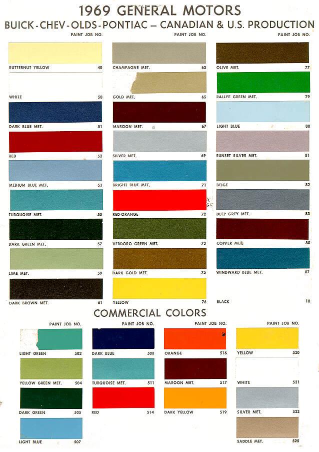

I'm trying to decide which color to use from this chart.
I'm liking subdued, like these...
It seemed like many were painted these colors when I was growing up, so that's what I remember.
