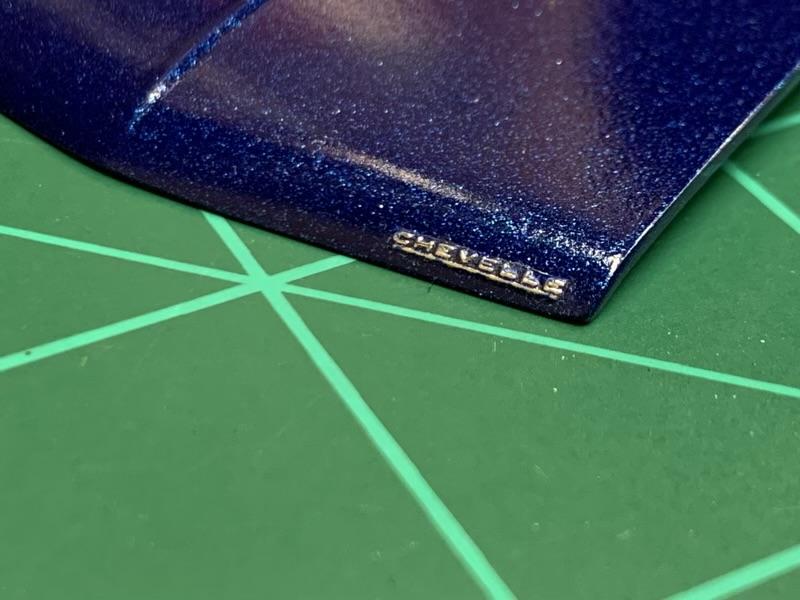

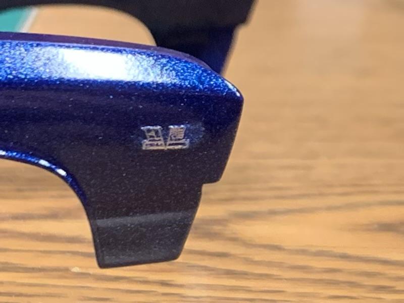

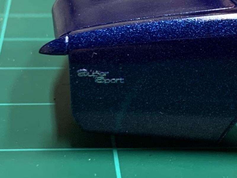

atomicholiday Posted September 26, 2023 Share Posted September 26, 2023 This is nowhere near as good as many others can do on this forum, but since we’re on the subject and I just finished cleaning the paint off this one, here you go. This hasn’t been clear coated yet but that’s my next step. I don’t think it’s too terrible, especially considering it’s only the second time I’ve tried this technique. It’ll get easier with practice. I’m starting the body emblems next. Quote Link to comment Share on other sites More sharing options...
StevenGuthmiller Posted September 26, 2023 Share Posted September 26, 2023 5 minutes ago, atomicholiday said: This is nowhere near as good as many others can do on this forum, but since we’re on the subject and I just finished cleaning the paint off this one, here you go. This hasn’t been clear coated yet but that’s my next step. I don’t think it’s too terrible, especially considering it’s only the second time I’ve tried this technique. It’ll get easier with practice. I’m starting the body emblems next. To the contrary. It looks very good! Steve Quote Link to comment Share on other sites More sharing options...

jaftygas Posted September 26, 2023 Share Posted September 26, 2023 4 minutes ago, StevenGuthmiller said: To the contrary. It looks very good! Steve X2! Looks great. Quote Link to comment Share on other sites More sharing options...

atomicholiday Posted September 26, 2023 Share Posted September 26, 2023 Thanks guys. To my eyes it actually looks better with the naked eye. Many of the imperfections disappear without the magnification. 8 minutes ago, jaftygas said: I wounded what some panel liner, or wash would look like now?? I don’t see any reason this wouldn’t work. The one I’m working on now has the crossed flags on the front fenders. Could probably get the right look with some thinned paint dropped into the flags and then use the same technique to clean up any excess. Last two pics. Those double SS’s were a bit scary… But they’re better than I expected them to look. The other side didn’t come out as clean as I’d like. Paint was a little thicker on that side and buried the details a little. Lesson learned. Now I’m really excited to get some clear on this bad boy and get it polished up and under glass!? 1 Quote Link to comment Share on other sites More sharing options...
StevenGuthmiller Posted September 26, 2023 Share Posted September 26, 2023 1 hour ago, atomicholiday said: Thanks guys. To my eyes it actually looks better with the naked eye. Many of the imperfections disappear without the magnification. I don’t see any reason this wouldn’t work. The one I’m working on now has the crossed flags on the front fenders. Could probably get the right look with some thinned paint dropped into the flags and then use the same technique to clean up any excess. Last two pics. Those double SS’s were a bit scary… But they’re better than I expected them to look. The other side didn’t come out as clean as I’d like. Paint was a little thicker on that side and buried the details a little. Lesson learned. Now I’m really excited to get some clear on this bad boy and get it polished up and under glass!? Not only does it work, but in my view, it’s the absolute best way to detail badges! Steve Quote Link to comment Share on other sites More sharing options...
