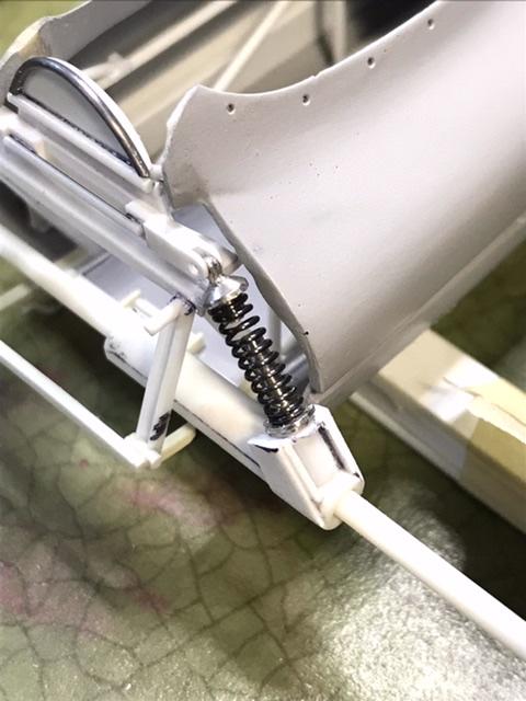

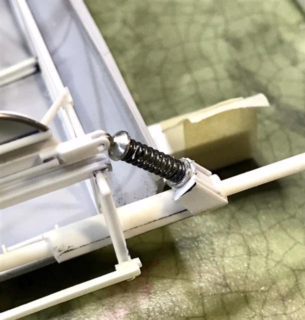

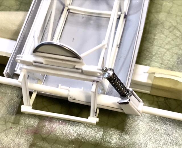

Bainford Posted August 15, 2024 Posted August 15, 2024 (edited) The lower shock mount is a curious arrangement. Not sure I've seen this anywhere before. The two components must be designed in concert. Edited August 15, 2024 by Bainford

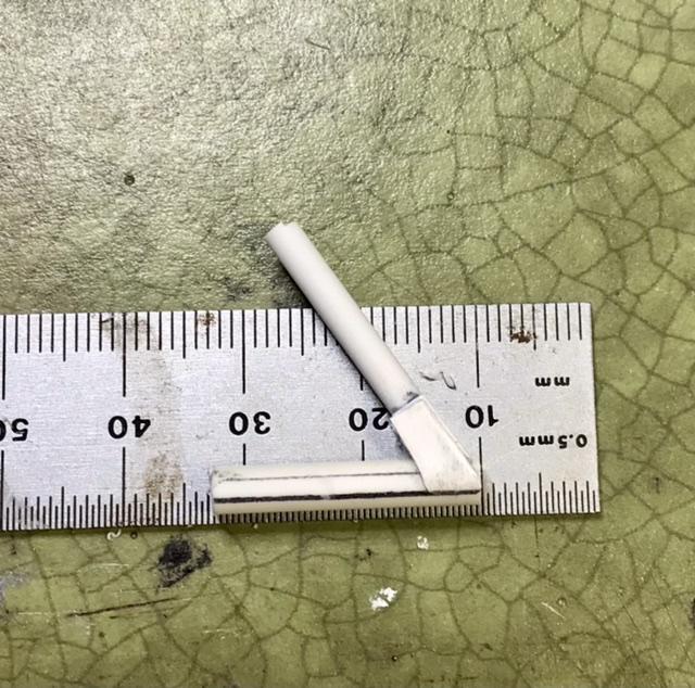

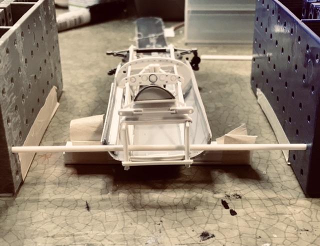

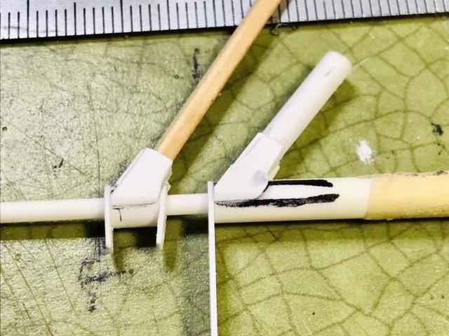

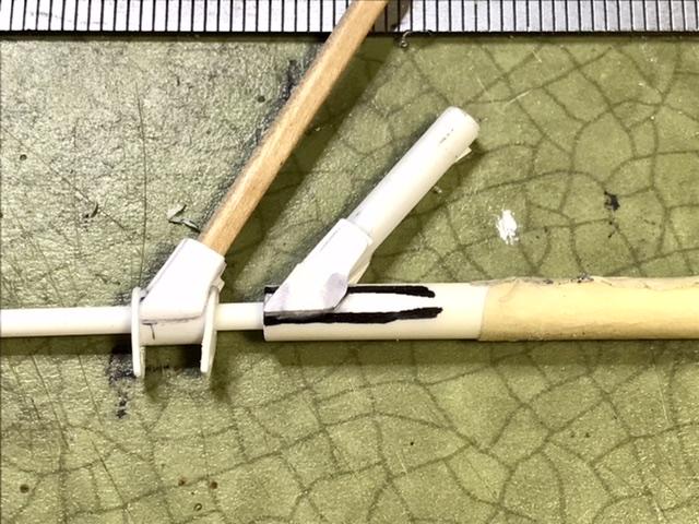

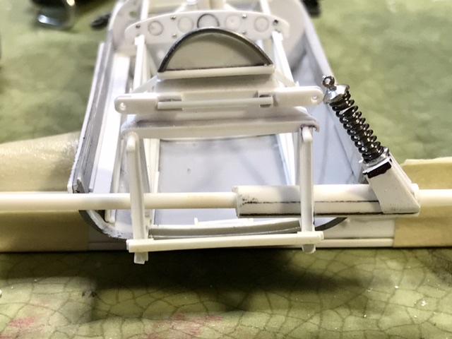

absmiami Posted August 15, 2024 Author Posted August 15, 2024 But the parts had the wrong included angle - because i was sort of winging it - so plan B was to cobble together a jig to secure an imaginary rear axle at the correct height / location - the jig was made from a couple of drill bit cases -
absmiami Posted August 15, 2024 Author Posted August 15, 2024 Bford - the design was unique to the Lotus 12 - 15 - and 16 - the reason you haven’t seen it before is because no one copied it - thats because everyone began putting the engines in the back in ‘59 and ‘60 - so even Chapman discarded the design when he drew up the 18 - as we will see - at some point …

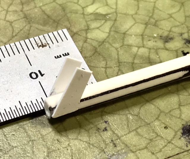

absmiami Posted August 15, 2024 Author Posted August 15, 2024 With the jig i got the correct angle and scribed it on the flanges that sandwiched the tubes - the joint is strong - lots of other parts will break before this does … 1

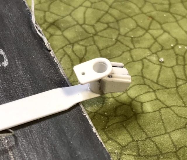

absmiami Posted August 16, 2024 Author Posted August 16, 2024 Now i’ve assembled the shock and i can measure the length of the hub assembly to the frame pickup - and then reduce the height of the part …

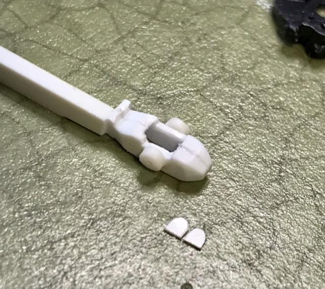

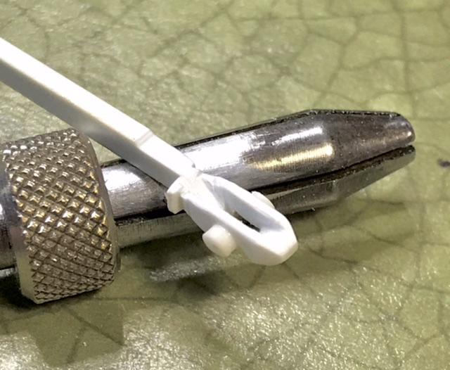

absmiami Posted August 16, 2024 Author Posted August 16, 2024 Then: saw away the excess length of the horizontal tube and glue on flanges that form a bracket for the trailing arm - the Sixteen had single trailing arms left and right … OK - now rinse and repeat for the other side … 1

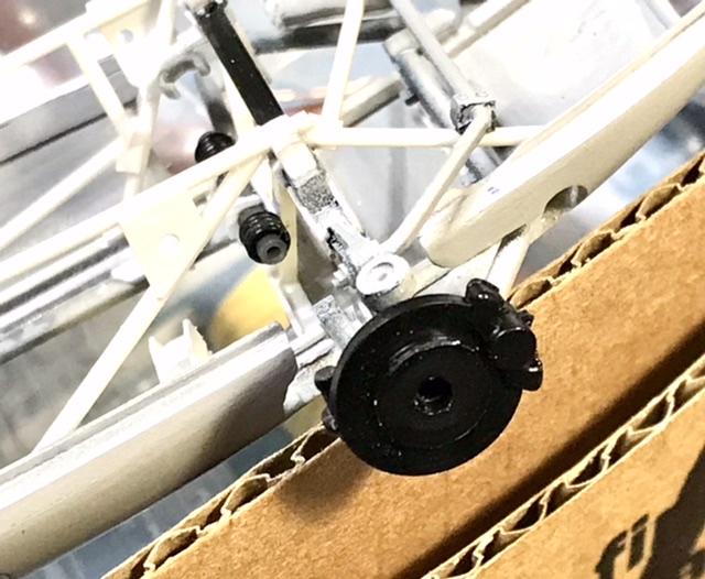

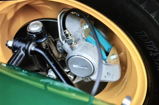

absmiami Posted August 18, 2024 Author Posted August 18, 2024 The brakes on the Matra kit are OK but not great - here’s a good auction house shot of the Girlings on the left front wheel of the Halford 16 …

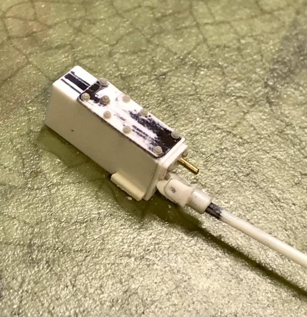

absmiami Posted August 18, 2024 Author Posted August 18, 2024 I’ve tried to make Girlings before - was never quite satisfied with the results … but I’m trying again …. This is the Tamiya Seven kit part combining the caliper and the rotor - gonna try to use the rotor casting with a more accurate Girling - sand off the kit brake …
absmiami Posted August 18, 2024 Author Posted August 18, 2024 Once again - Evergreen strip and rod and lots of Tamiya liquid glue … this is the basic housing - need some details …

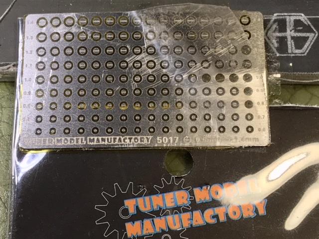

absmiami Posted August 18, 2024 Author Posted August 18, 2024 You never need the Tuner Model Factory photo-etch stuff - until you do …. 1
absmiami Posted August 19, 2024 Author Posted August 19, 2024 These super small nut/washer bolts are still gettable - - but hideously expensive - almost a dollar per …. Can’t possibly justify them …. Thank you sir / I’ll have another …

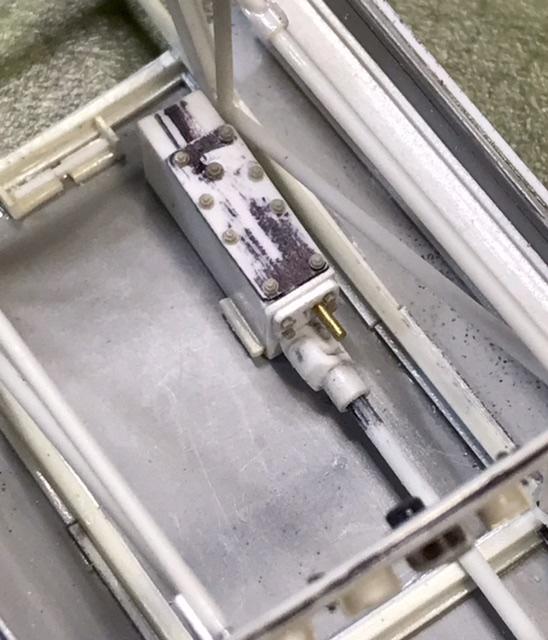

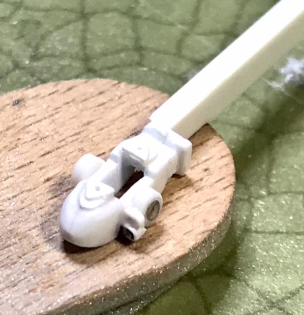

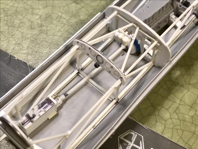

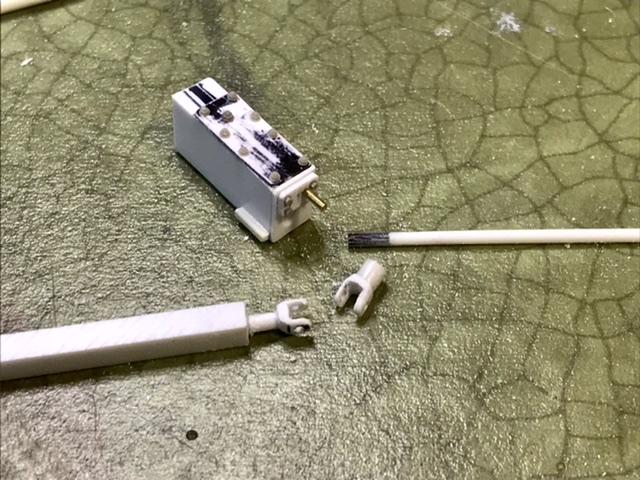

absmiami Posted August 20, 2024 Author Posted August 20, 2024 Drive shaft is .047 Evergreen with U joints made fr .100 square ….

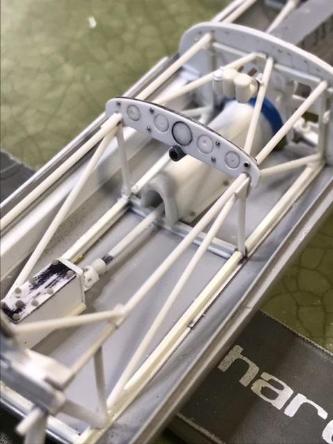

absmiami Posted August 20, 2024 Author Posted August 20, 2024 Is there enough room for a seat? Maybe …
Pierre Rivard Posted August 20, 2024 Posted August 20, 2024 Extensively researched and beautifully fabricated chassis and mechanical components, You don't do easy kits do you?
absmiami Posted August 20, 2024 Author Posted August 20, 2024 Thanks Gr PR - there’s a straight line there somewhere …
Bainford Posted August 21, 2024 Posted August 21, 2024 Calipers are gorgeous. The overall chassis shots are model builder's porn.
