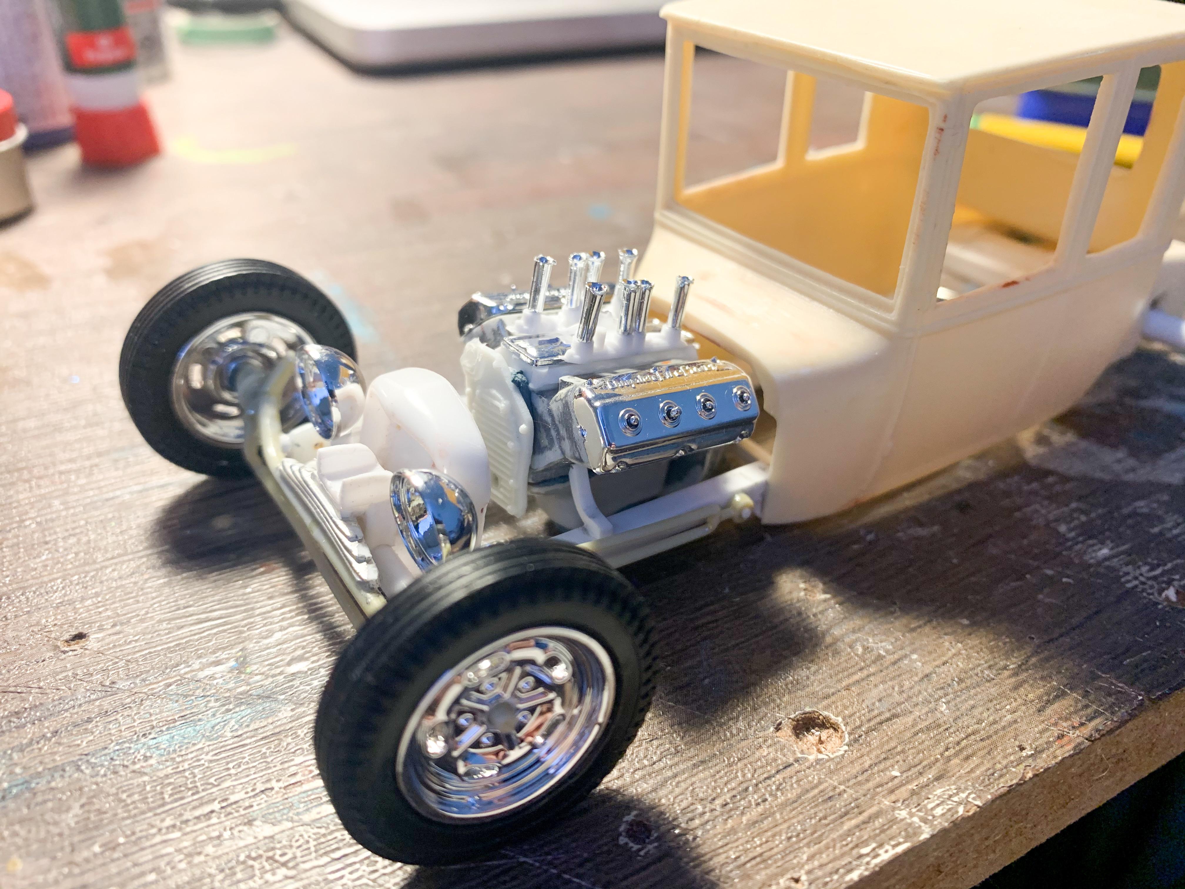

IMHO that engine sort of overwhelms the build.

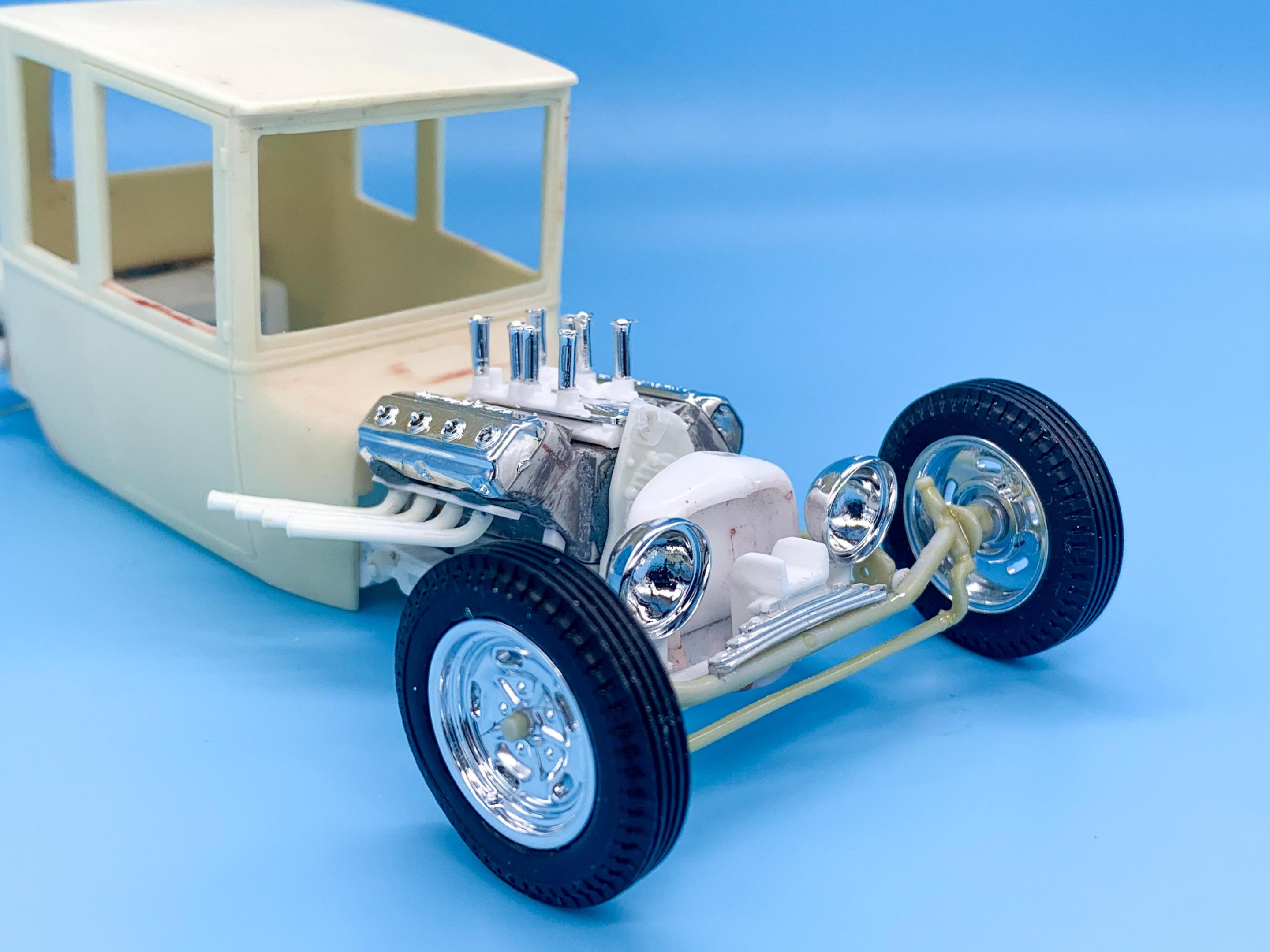

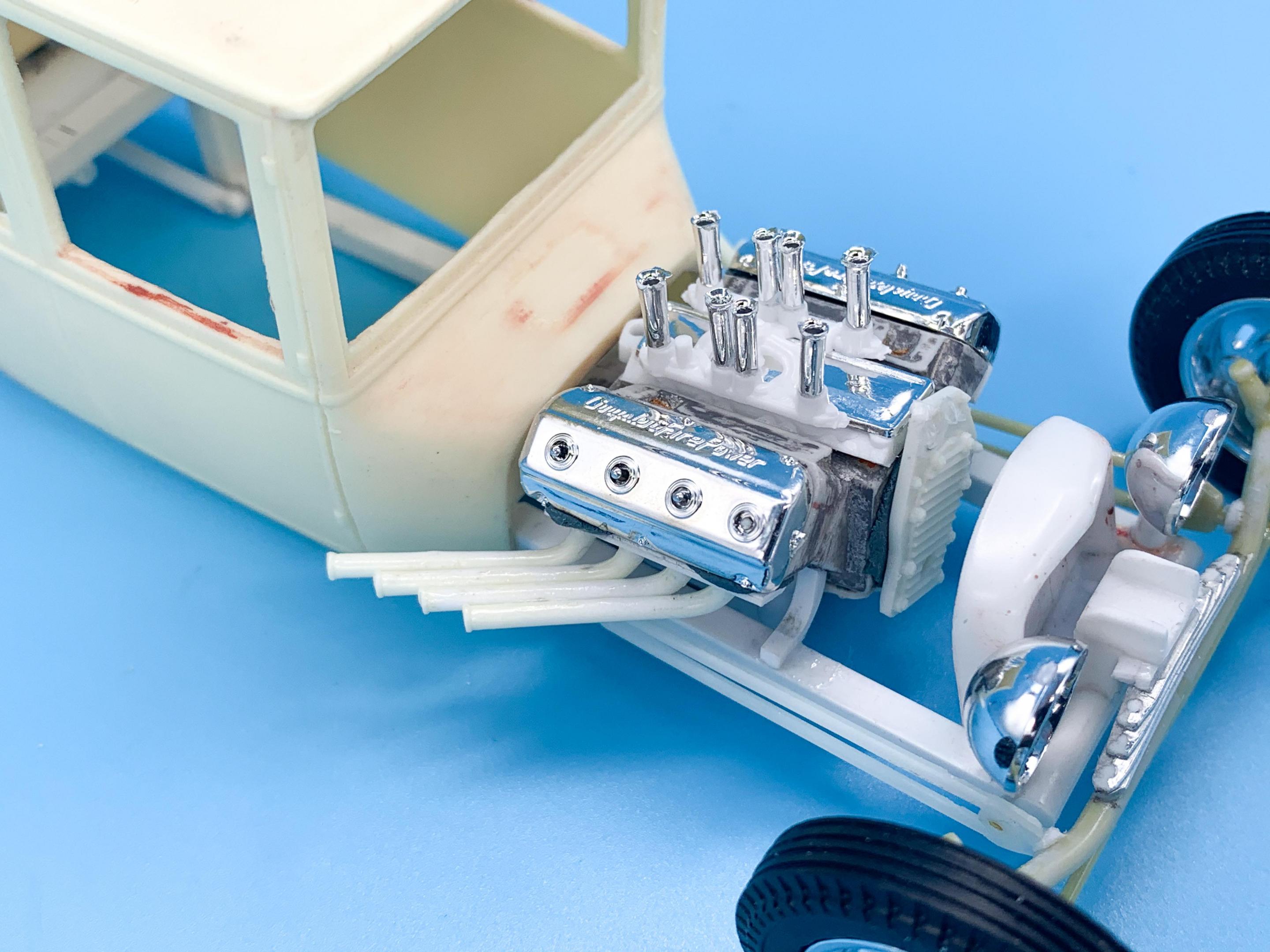

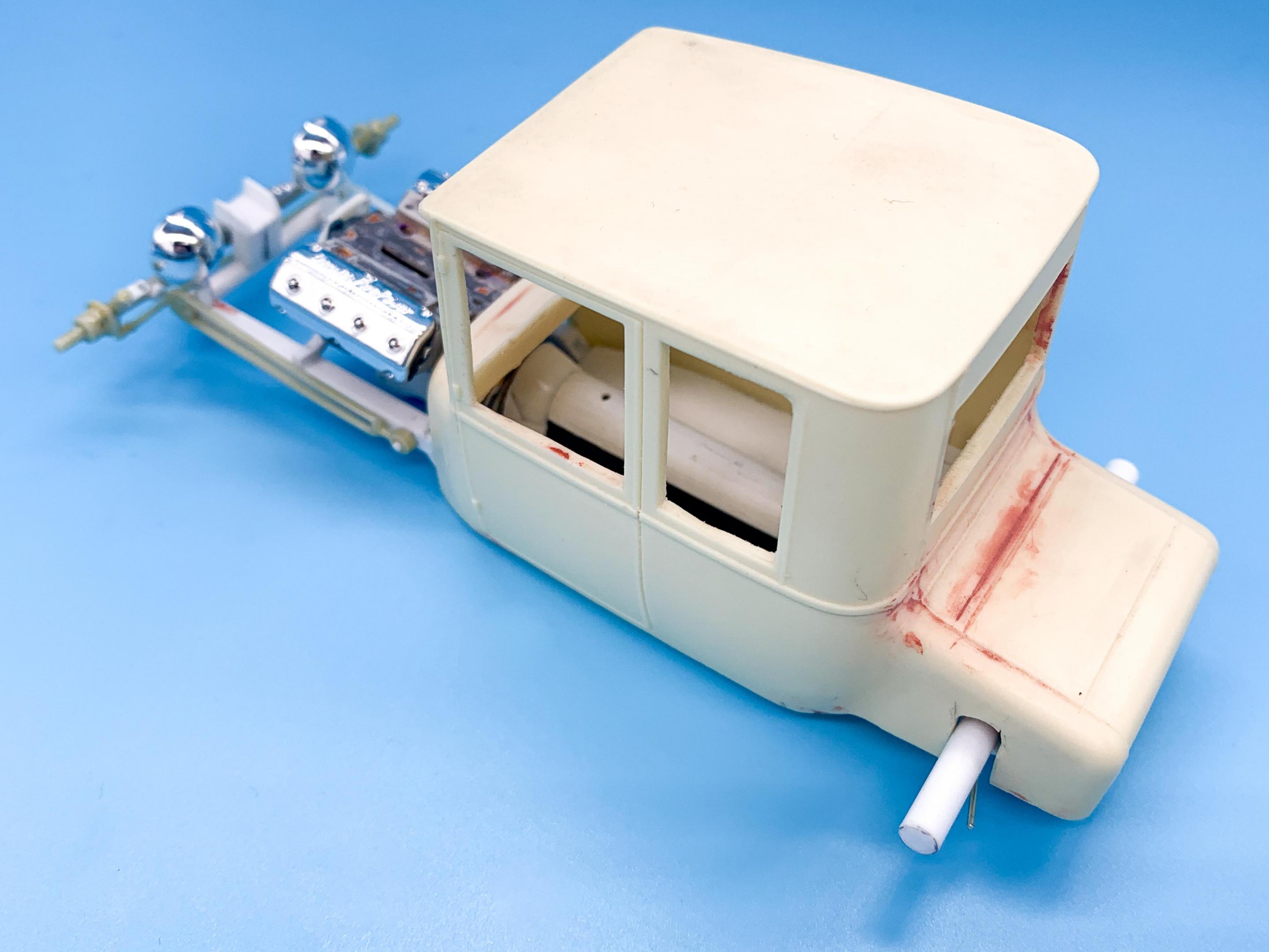

 I’m kinda with you, yes!  I had the blower stuff sitting on the bench so I tried it and kinda liked it (and liked it more the longer I looked at it), but my original idea was something more subtle but mechanically interesting still - like a Hilborn mechanical fuel injection setup maybe?
That’s more what I originally had in mind...the block still looks HUGE in there, which I like, but it’s not as ‘bad’ (or good, depending on your viewpoint) as with the big blower.  Need to keep thinking on that...

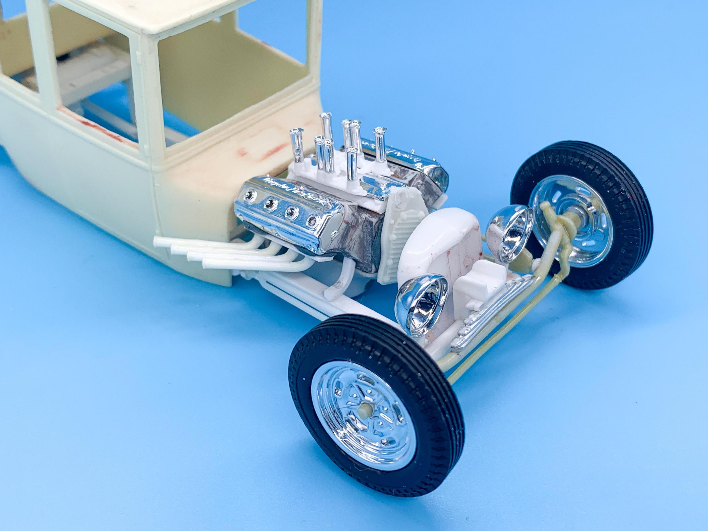

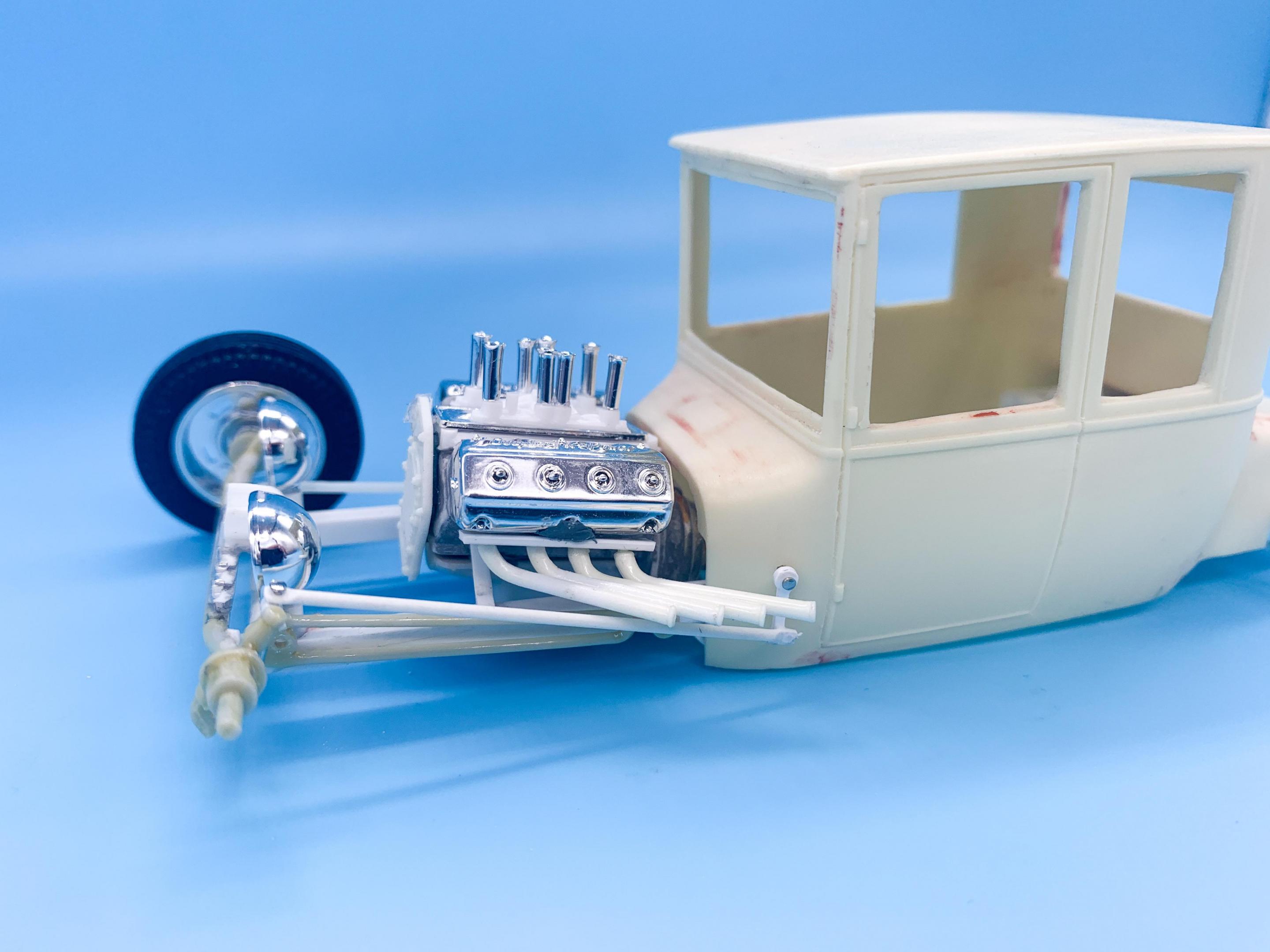

Meanwhile, I was putting off making headers, but I needed to so that I can do the steering parts so that was today’s project.  Did some research on tube sizes, and 1 7/8” seemed to be the consensus of what would be a sensible diameter for a traditional size pipe coming out of a Hemi...nowadays 2 1/2 to 3” pipes seem to be more common from what I was reading but they’d run a little smaller back in the day:
These are the individual headers from the AMT Showboat kit, which I like because you get 32 of them in the box ?.  That’s where I got the intake system from - but I still need to do some research and make sure it’s appropriate for this engine.
I stripped the chrome, cleaned up each pipe and then did some careful measuring and positioning to get them to match on both sides...they measure out to just under 2 inches diameter, so I think they’d work ok without choking that Hemi too much, but still looking traditional and not as big and chunky as people might run now.
Something I wanted to do was to get the angle of the pipes to match the angle of the cowl, when viewed from the top - or close as I can on a cowl that has a bow in it, anyway.  I think I like ‘em!
More soon - need to figure out steering next!

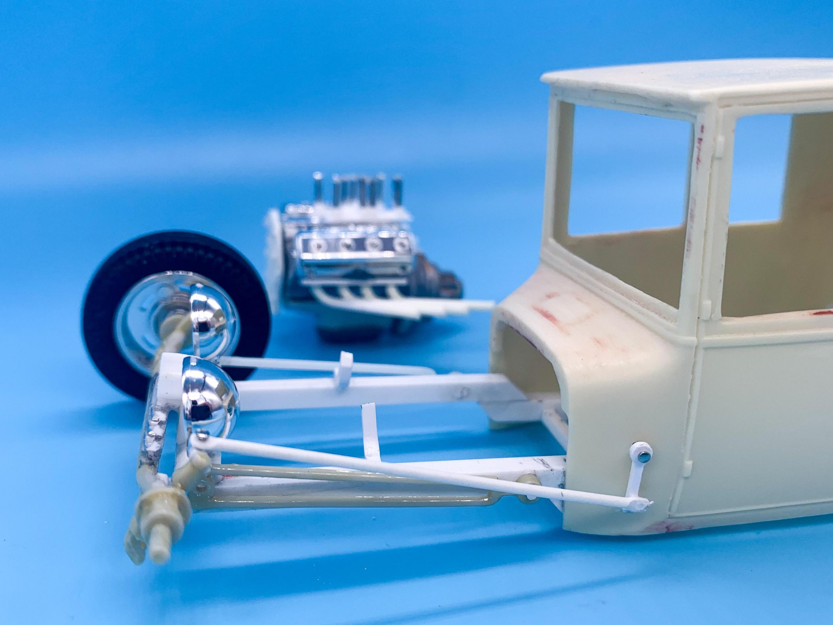

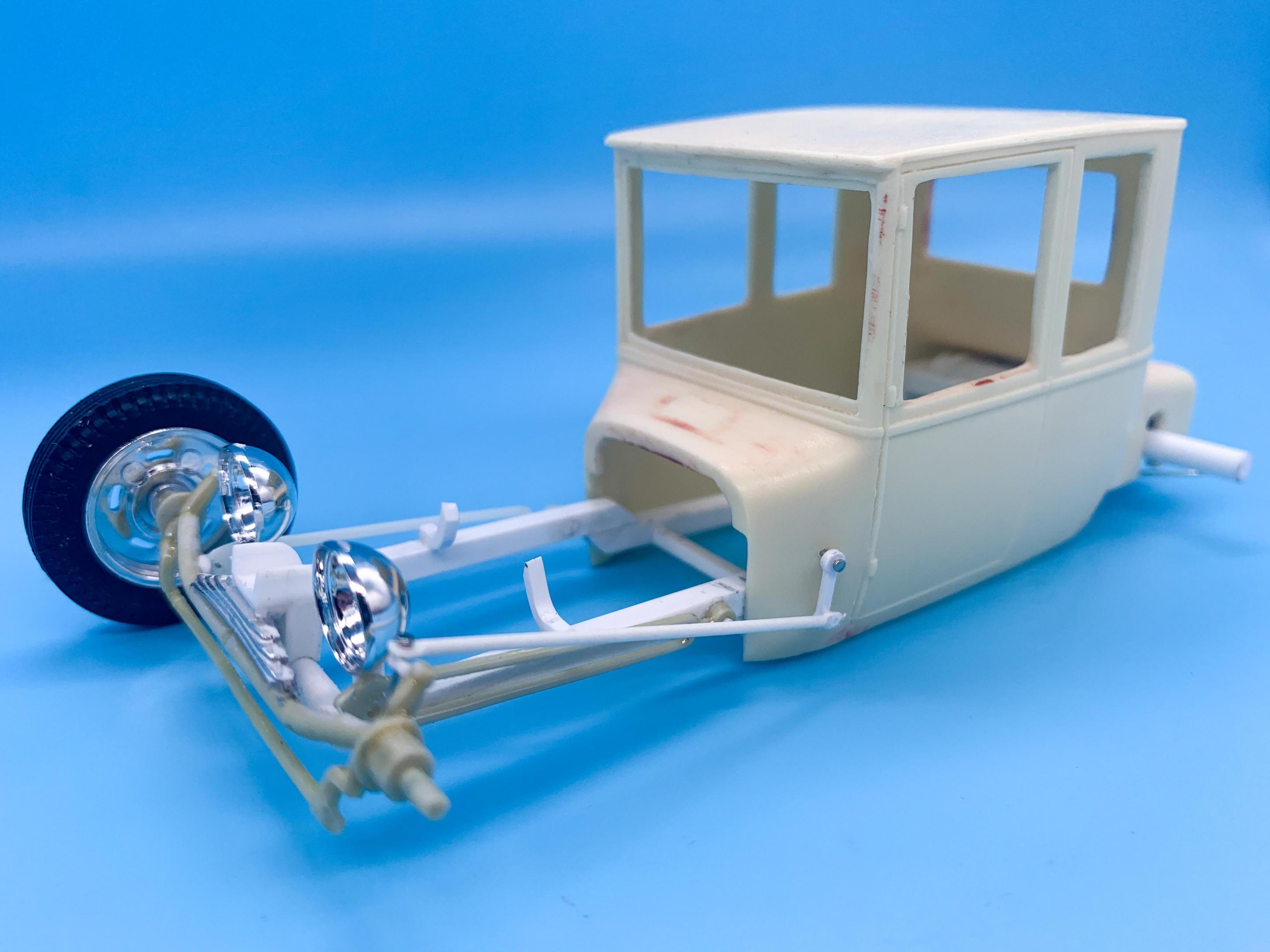

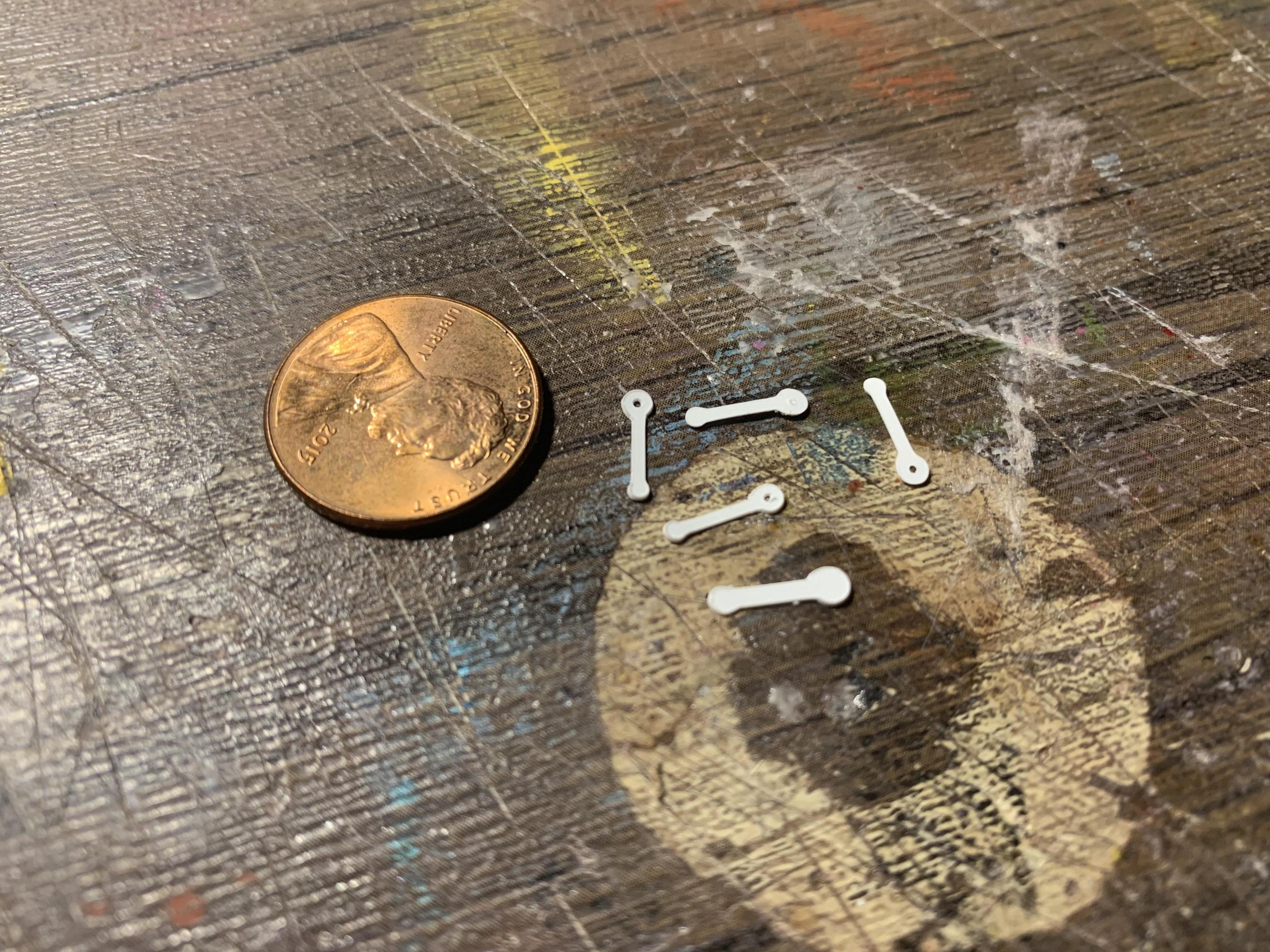

Steering crank parts, fresh off the cutter:
Add a little bar to connect the crank to the front...
Make sure it clears the headers (and that the crank could turn without hitting anything, and ditto the linkage)
I’ll detail this up some and clean it up properly after we move - but that’s another part ticked off the list!  Next job will probably be the rest of the steering setup, and then a firewall.  More soon (ish)!

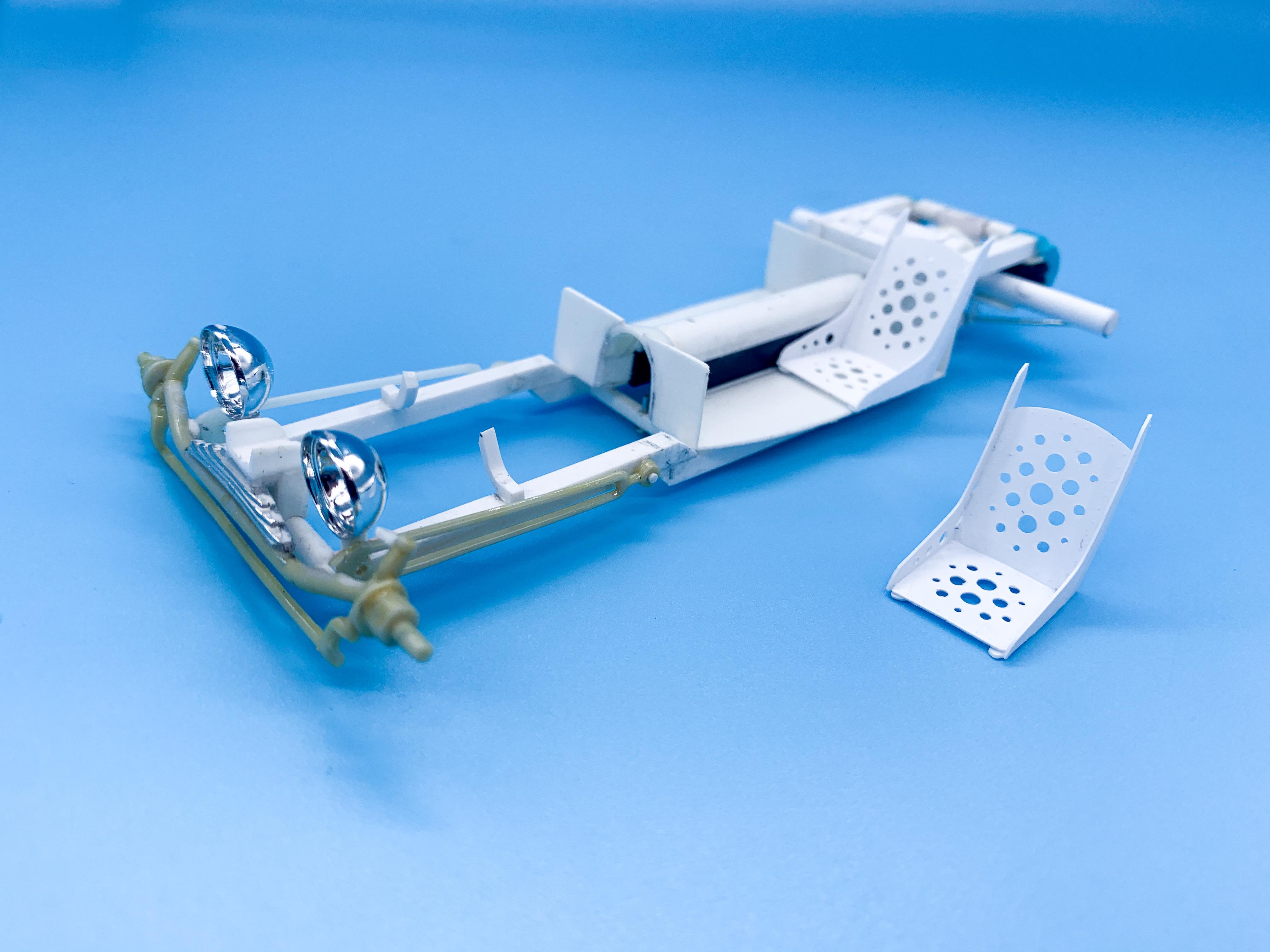

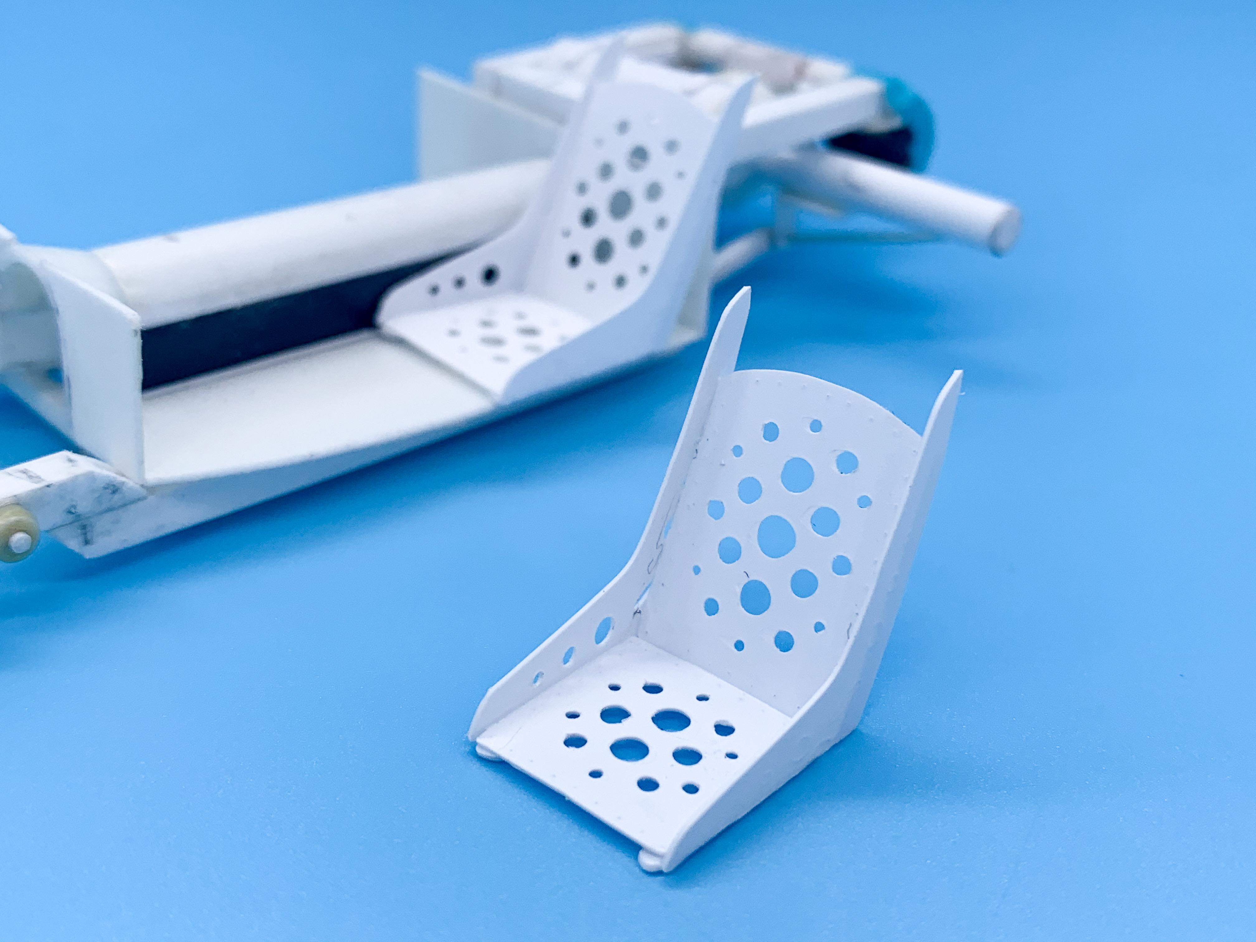

Next up, I needed some seats.  I was going to make a bench, but the tunnel meant that the seat base would sit higher than I wanted.  That creates a little bit of a issue, because these T bodies are so narrow already that it didn’t leave much space.
So, to check I’m actually building something (mostly) feasible in 1:1 scale I measured the smallest gap I would be able to sit in (yes, I measured my rear end with a ruler) and then measured the gap available and discovered I would JUST squeeze in there ok.  Because it’s a tight fit though, bomber seats made total sense, so I made a set with a 16” wide seat base based on plans I found online:
I might lose those ‘bat ears’ on the top before I’m done, but I kinda liked them when I was tweaking the design...we’ll see!
Those should work!  I think it would probably feel a little like how a Lotus 7 (or the home built variants) feels like to sit in, where you kinda squish yourself into it, but I like how they look.  Next up will be some risers to mount them (and some more clean-up once the glue’s dry and they’re not so fragile) and I can get back on the steering setup.

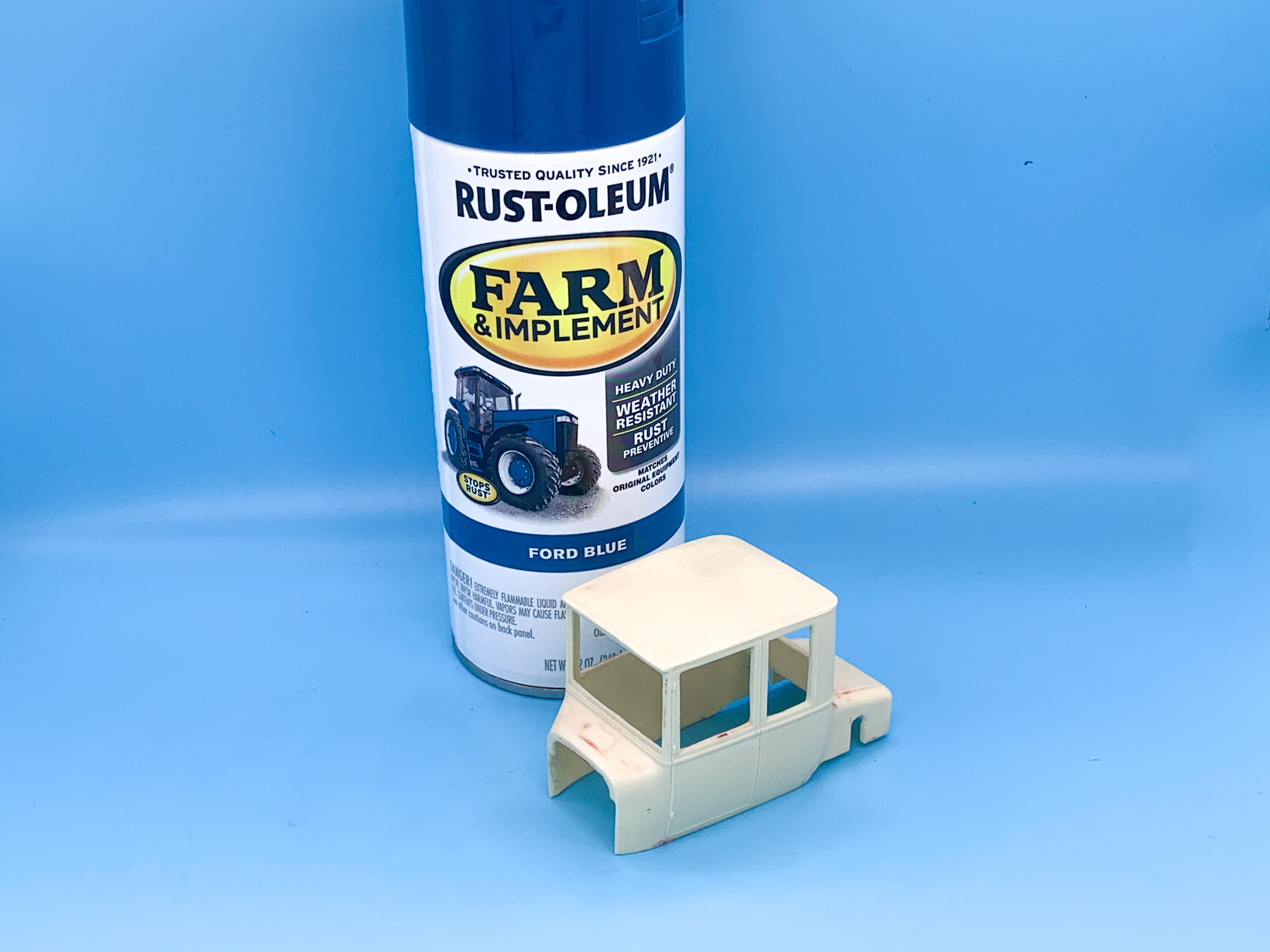

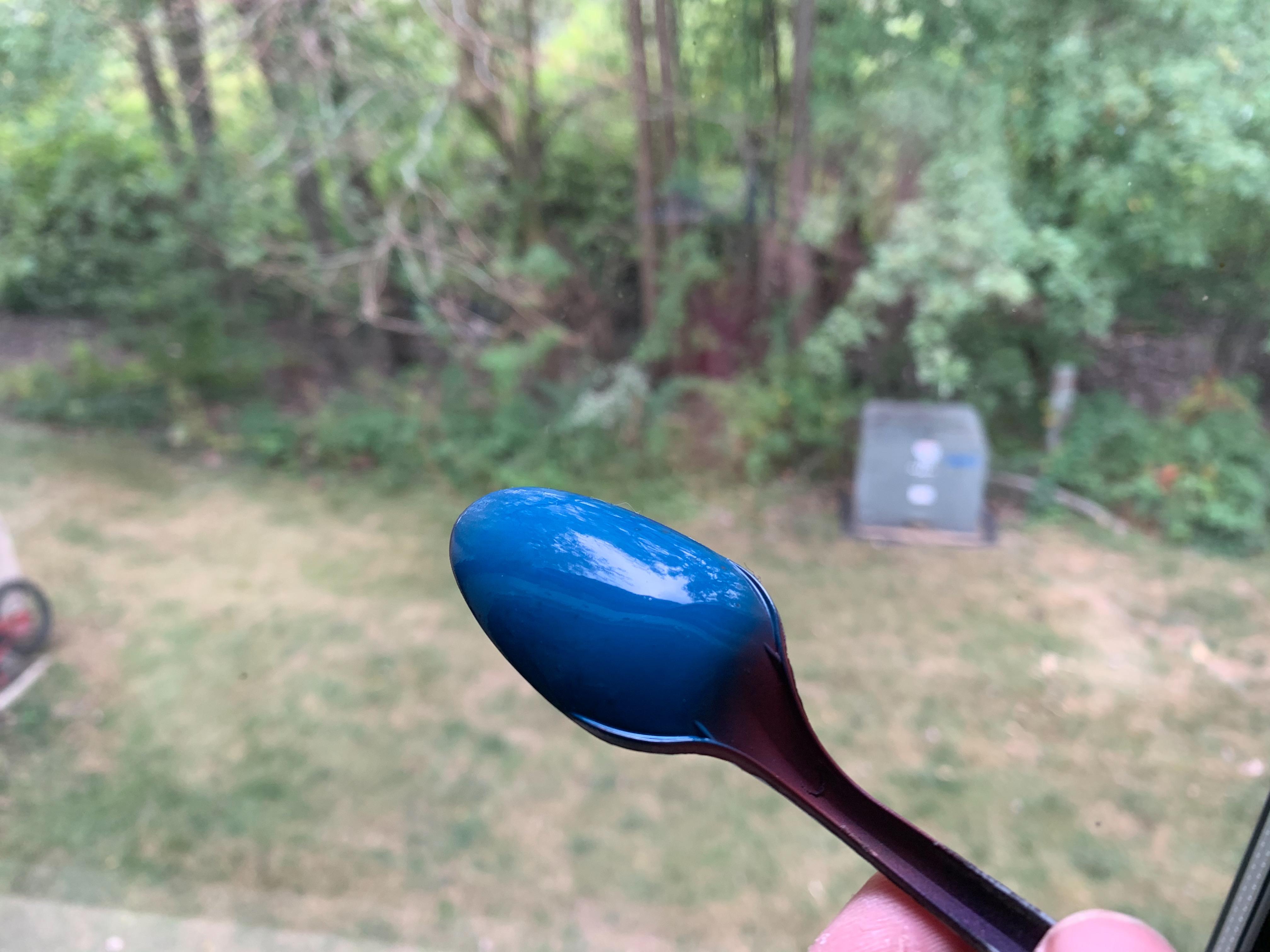

Im starting to get to where I can put some paint on this thing, almost...I had a color in my head that I’ve been trying to find and hadn’t managed to track down yet.  I wanted a solid color for this one, a kind bright dark blue ?. Not a REAL dark blue, but not too bright either.  Kinda traditional looking but not too old looking...and obviously that mix of requirements made it hard to find what I was looking for ?.
Hunting in Menards today I found this, in the tractor paint aisle, no less.  JUST what I had been looking for!
Shot a couple of spoons to see if it’s about what I wanted and I think it is - I’ll check them out in the daylight tomorrow and see.  I think we have a winnner though - and it’s a Ford color ?.  First paint job after moving to Indiana and it’s a tractor color ?
Should look something like this shade hopefully;
Kind of an unusual shade for a Tall T, I feel like  - but I think I’m gonna like it!

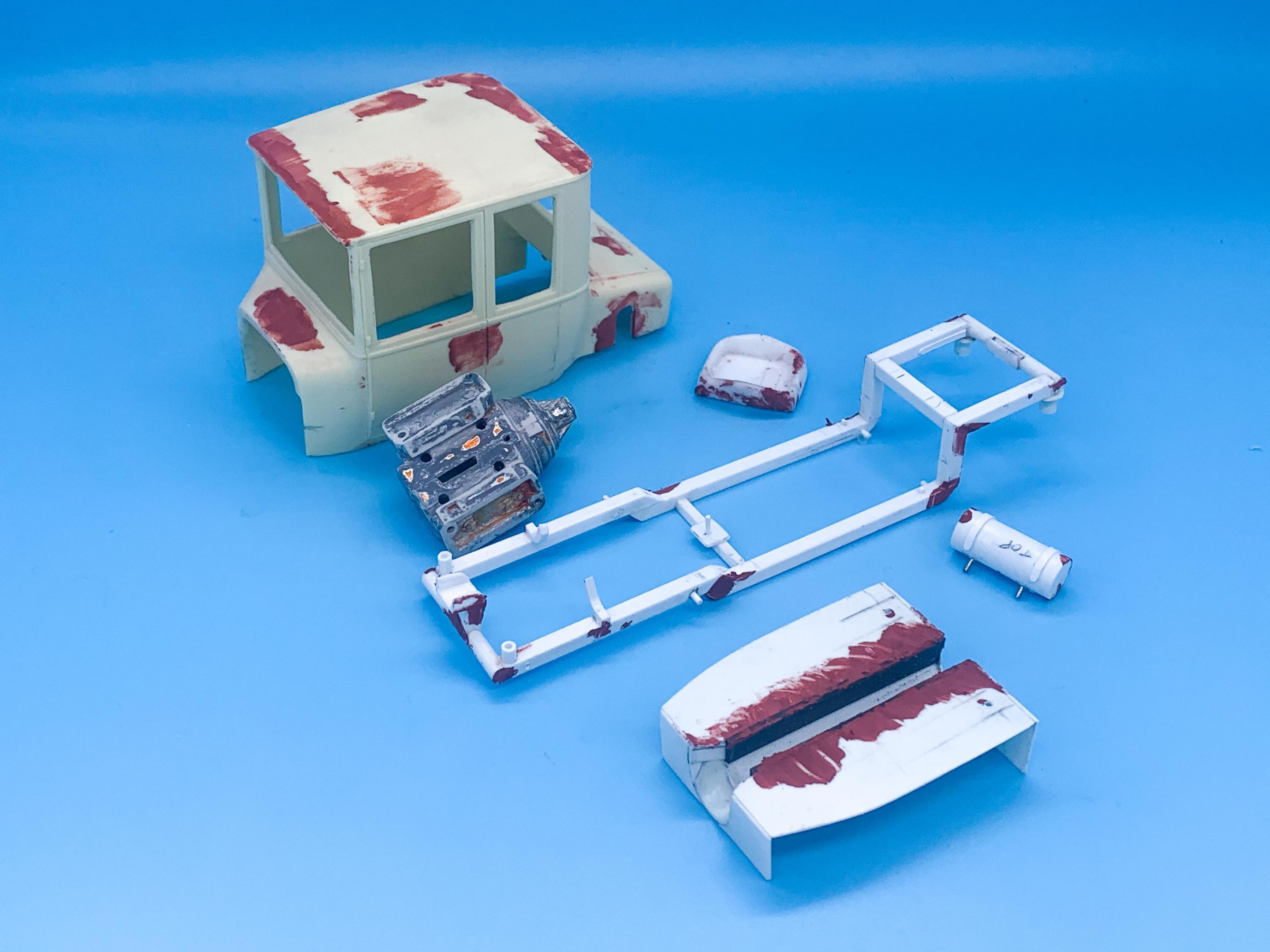

Got a couple of little bits and pieces cleaned up on the frame today, and got all the parts that will need some more work Bondo’d ready for some sanding and then primer tomorrow, hopefully!  More soon!

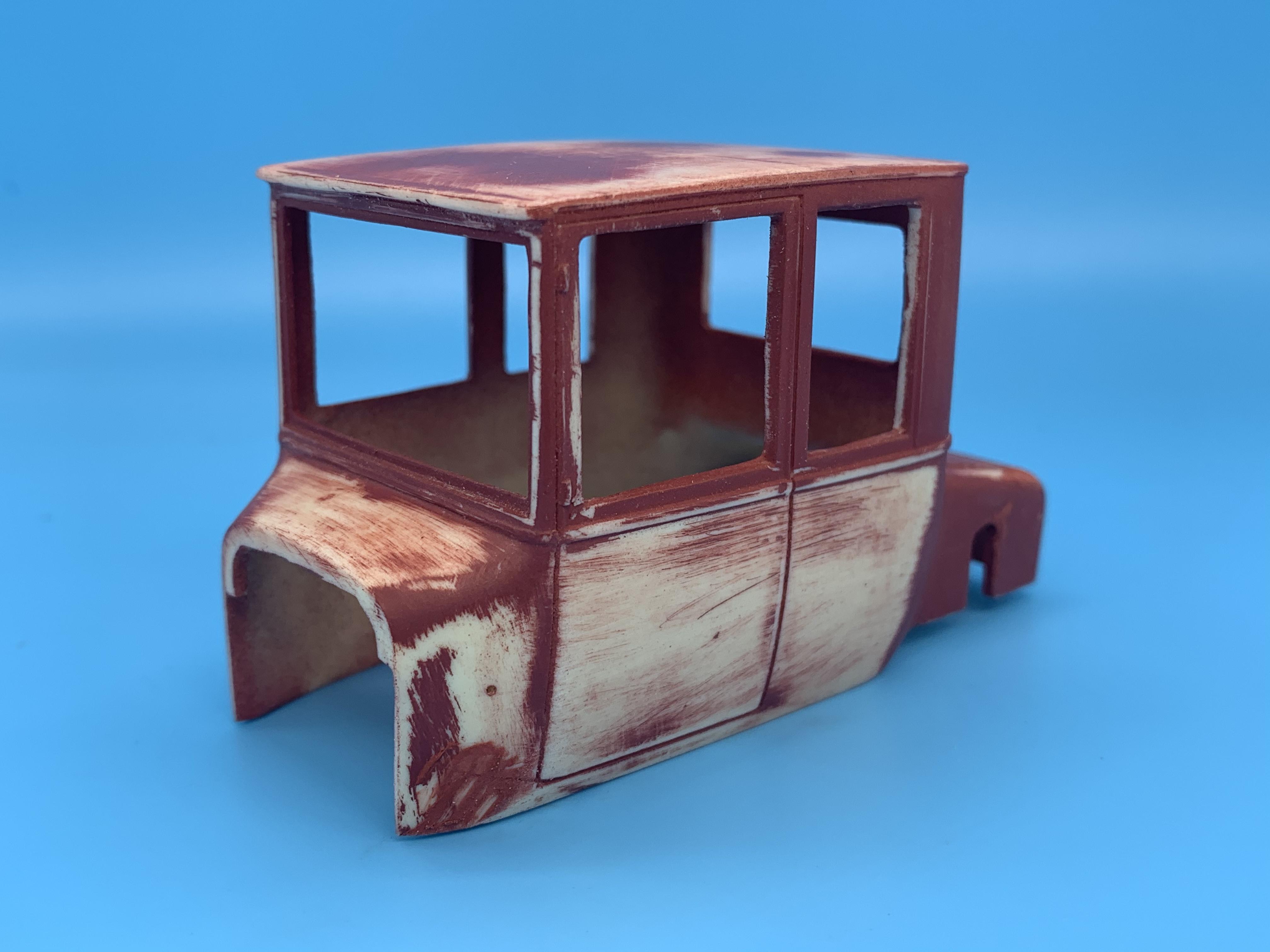

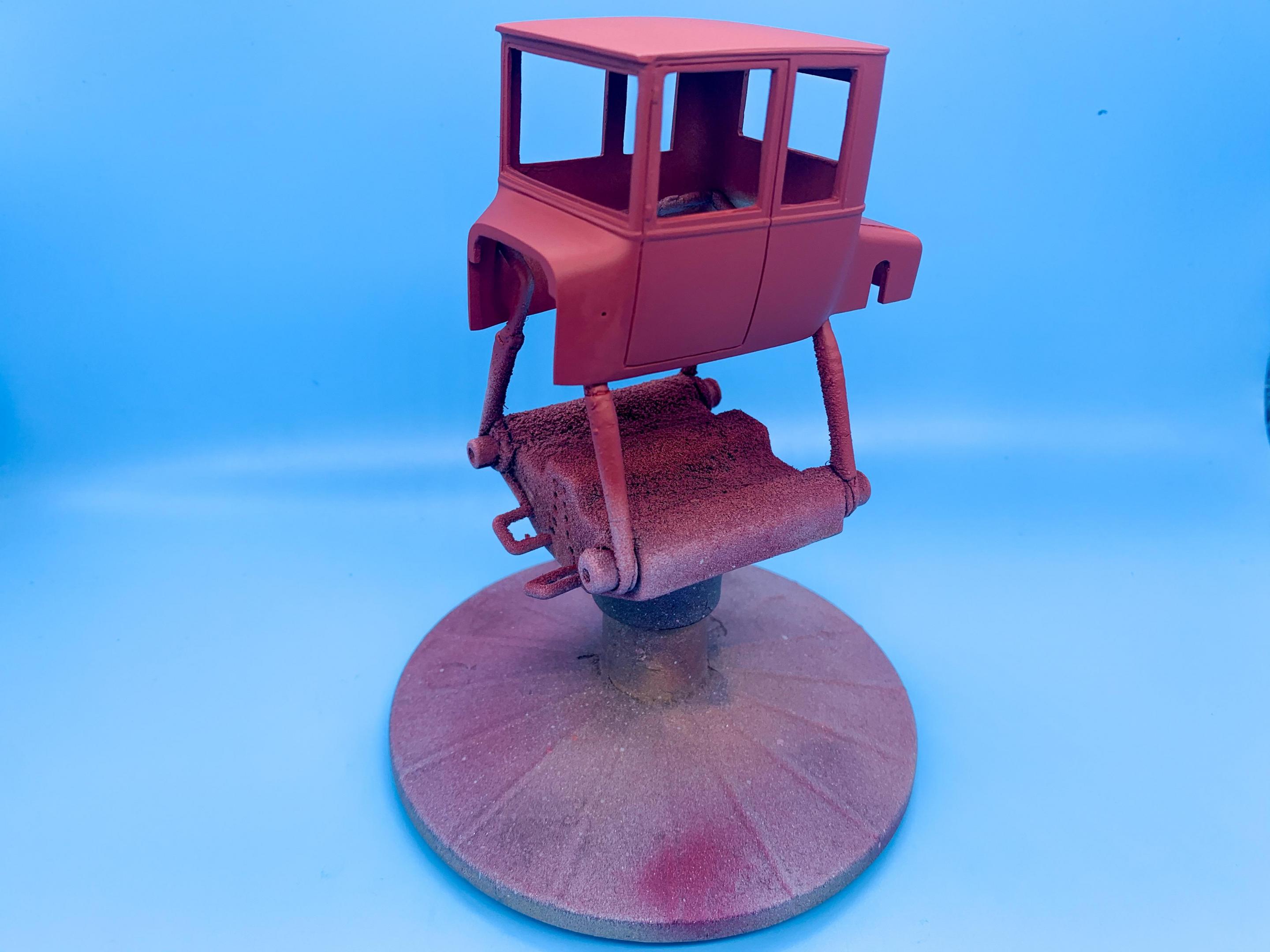

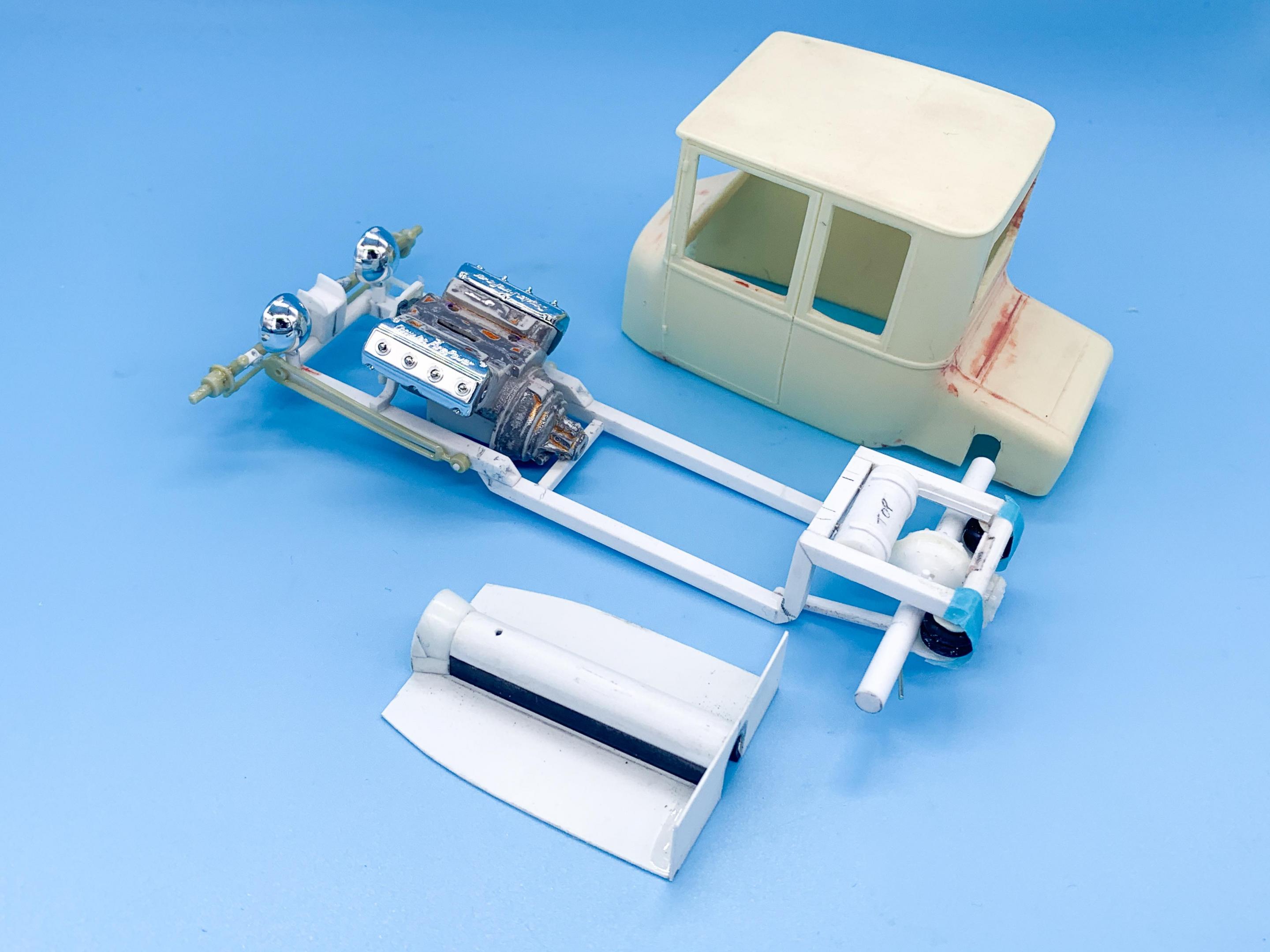

Got stuck in an endless loop of priming the body, fixing the flaws, re-priming, spotting a new flaw and so on...had a lot of THIS look to the body this week...
And a lot of this too...might be getting closer to being paint-ready now!  This body is definitely a challenge...
Confident that Tractor Blue is gonna look cool though!

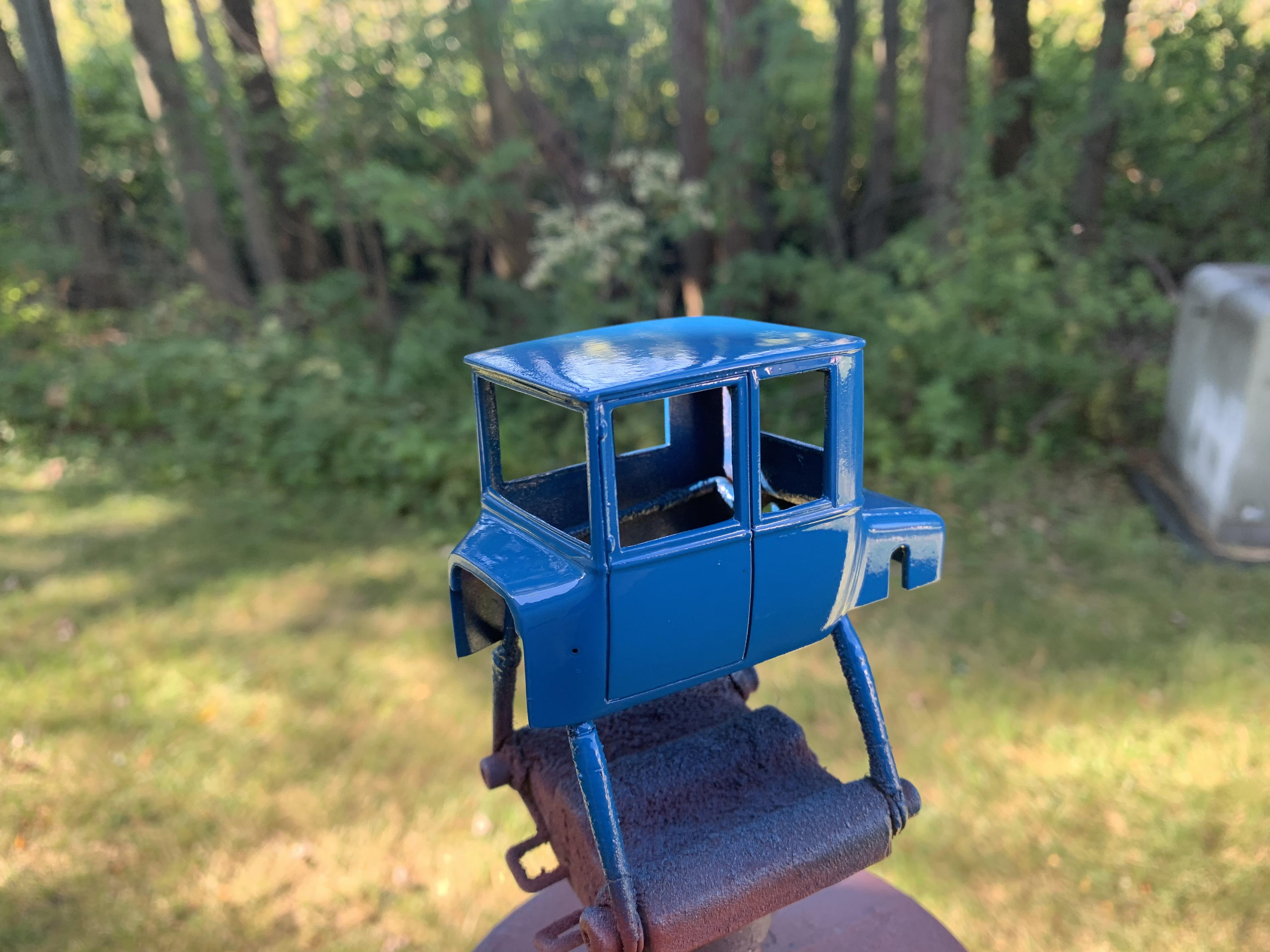

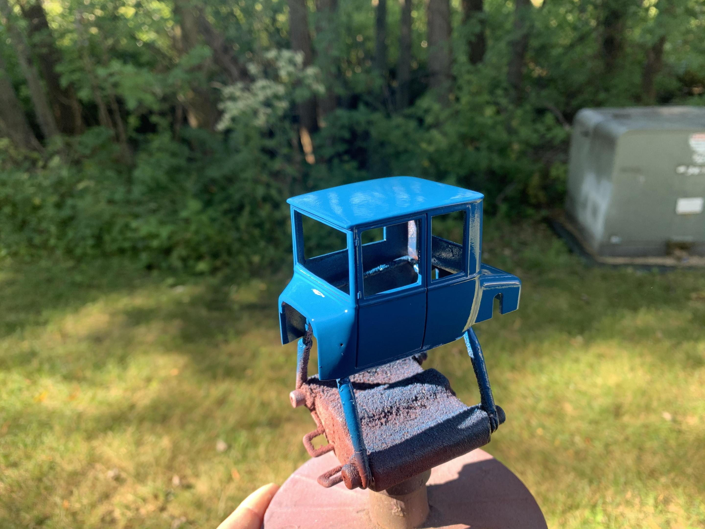

Got some paint down today!  Had a nice still, dry, warm day so I got to use the new outside paint booth:
The color is actually a touch darker than it appears in these pics - see the spoon pic I posted above for a better reference...but I’m pretty pleased with it!  More soon!
Looks good! Great to see that colour going on.

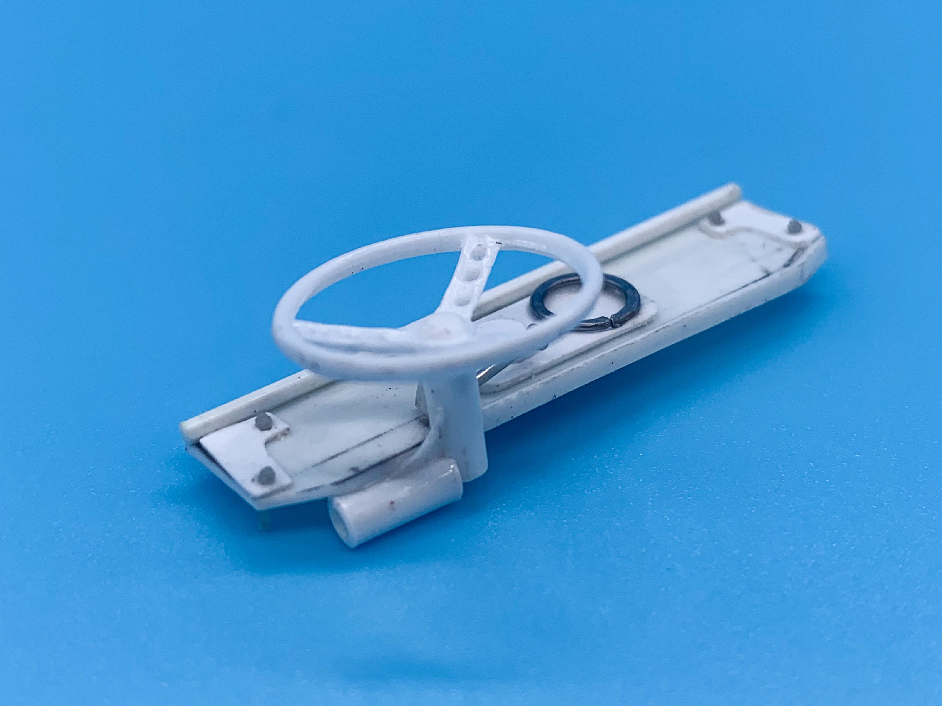

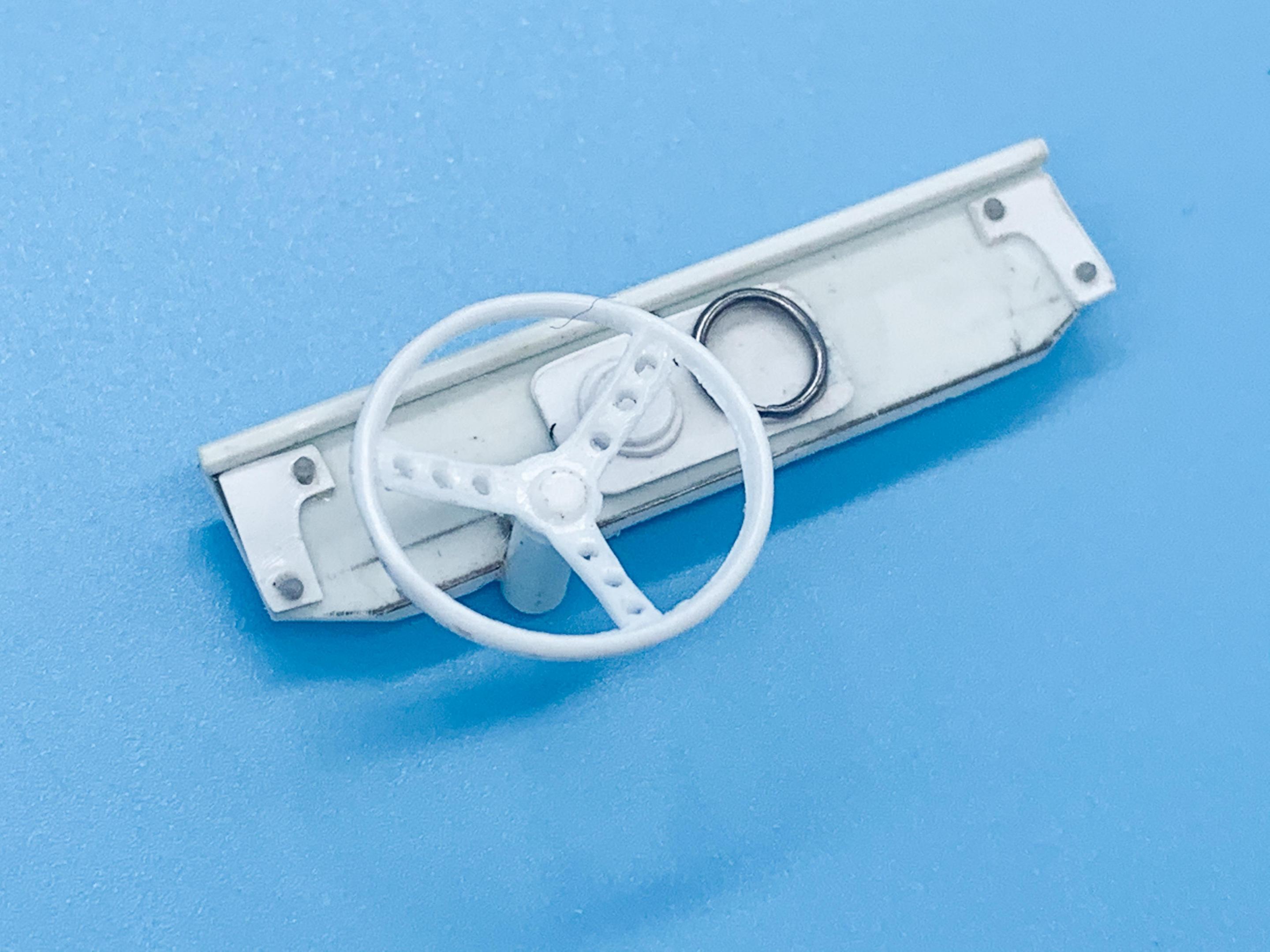

Speaking of which, I wanted to use a variation on a stock T dash, like this...
...and replace that ammeter with a speedometer.  Because of the thickness of the resin body though I had to distort the proportions to make it work, so this is an “inspired by a T dash” rather than a properly scaled replica.  No biggie, that Hemi wasn’t in there from the factory either...
I’ll replace that wire gauge surround with a photoetched one when it’s painted and ready for detailing, but that’s roughly what we’re looking at.  I’ll finish cleaning it up tomorrow when the glue’s set up tomorrow and get it in primer and see what we’ve got
Oh, and finish that steering box, which will just be visible under there...just mocked up a little styrene tube for now to I could make sure it lined up with the output roughly right...

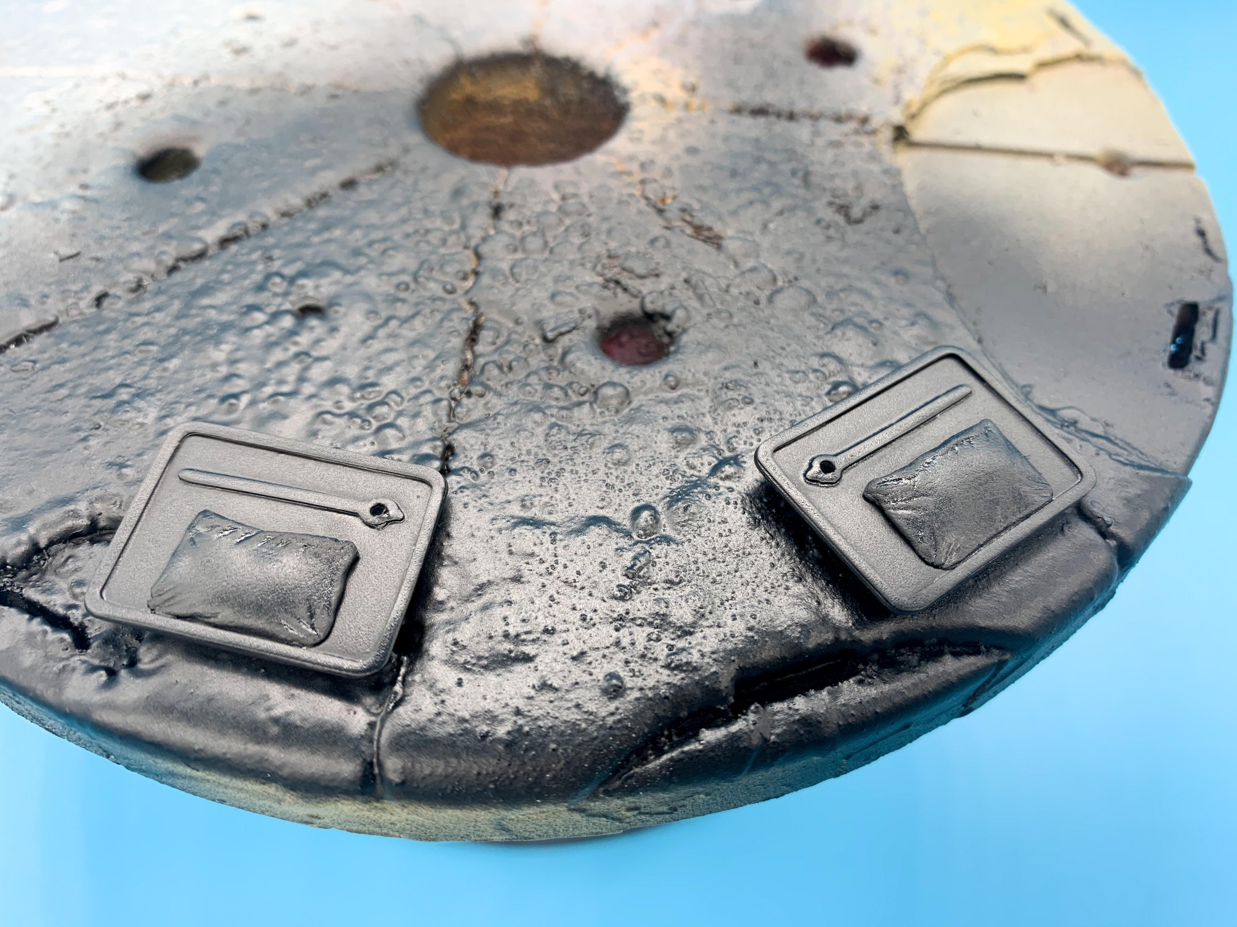

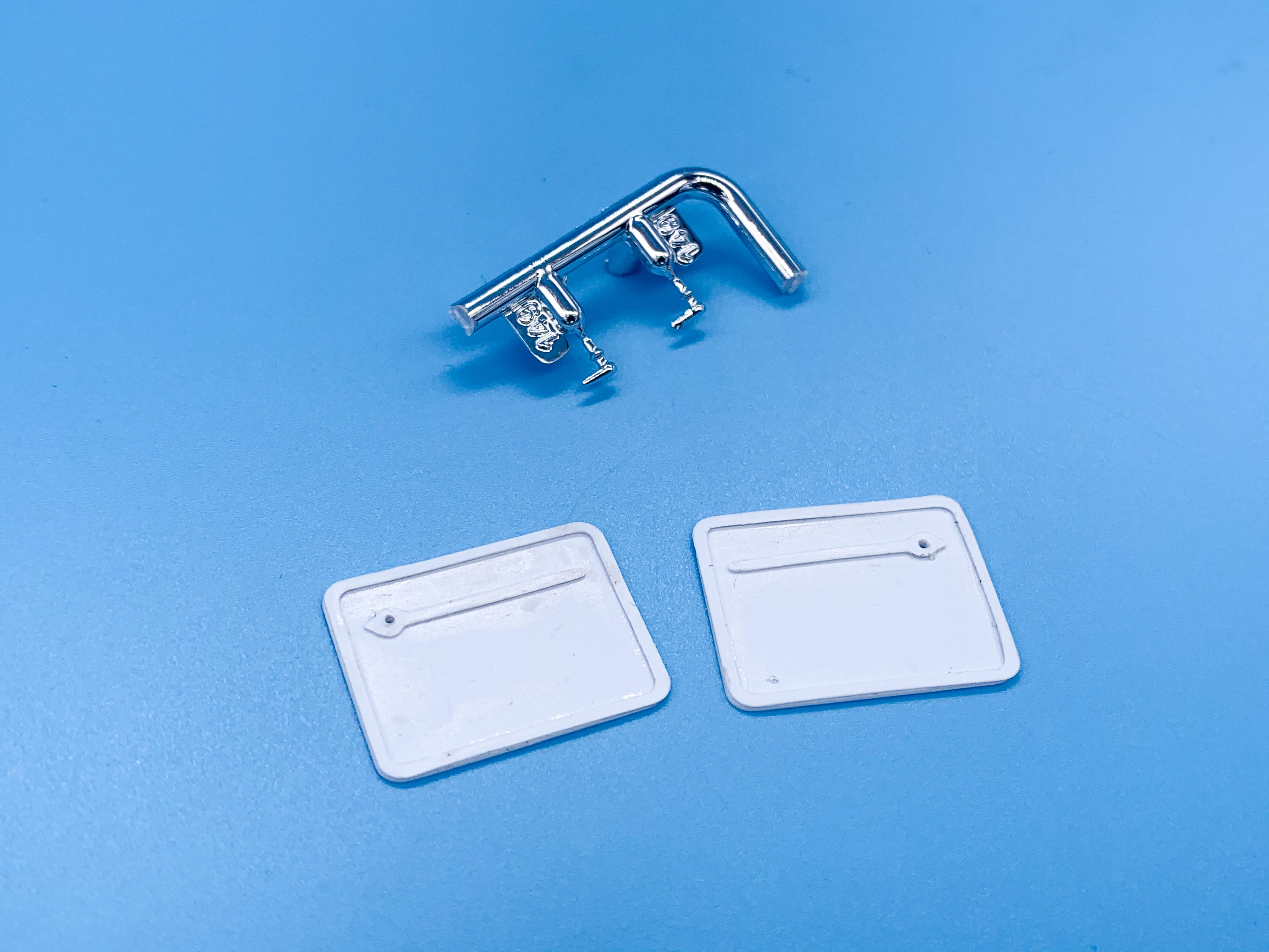

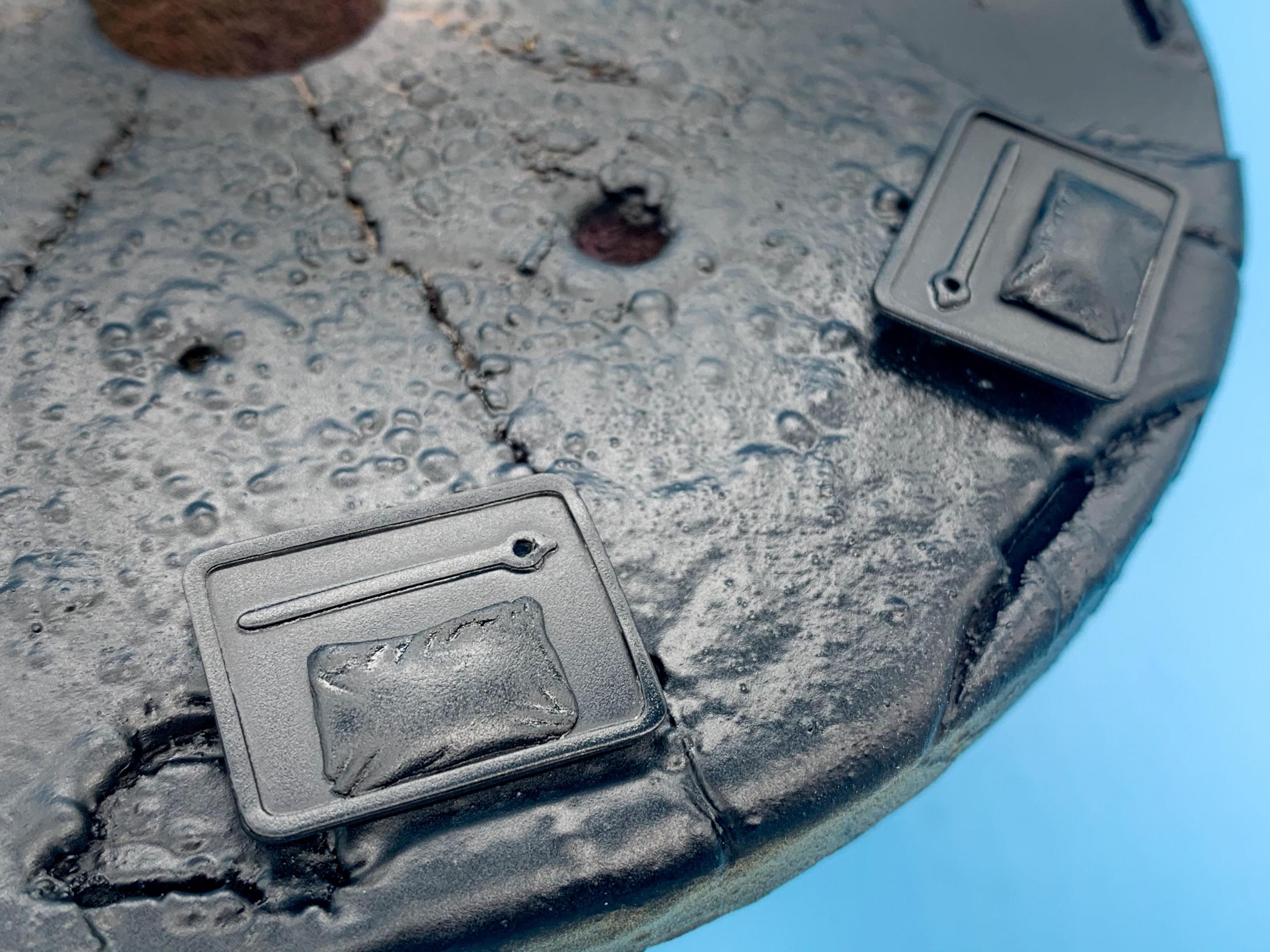

A little more work on this today...made some door panels, somewhat based on a tidied-up version of stock T door panels (to which I’ll add these spare door handles from the Revell 29 kit):

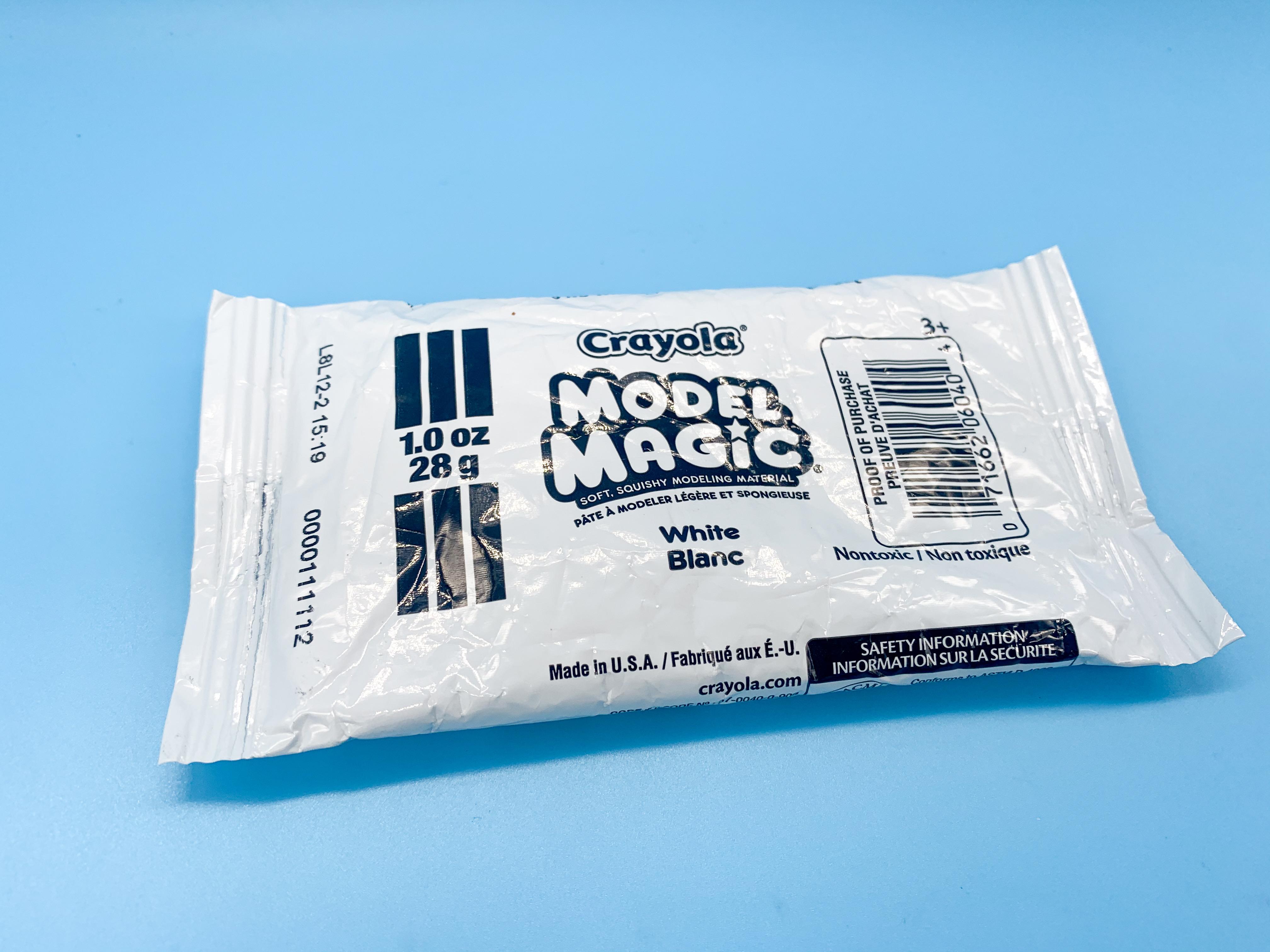

On the basis that I filled the trunk with frame and axle I figured some door pockets might be a nice addition, but I couldn’t find a door panel that had pockets that I liked in my stash here.  I did find this stuff at the Dollar General though...

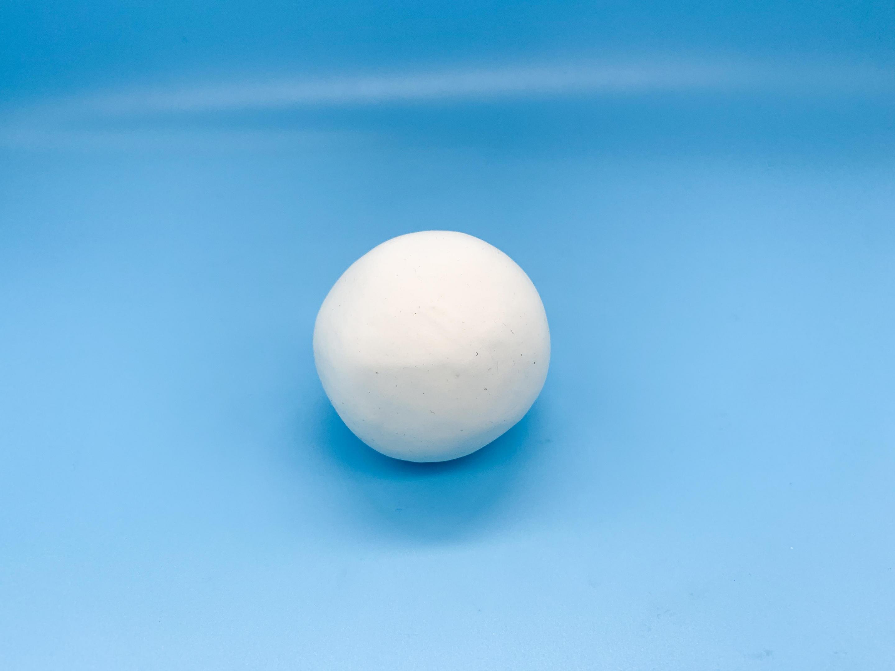

I KNOW there’s better stuff than this for sculpting model parts out of, but I already in there...the material feels kinda foam-y but apparently you can paint it and it air dries in 72 hours or so...

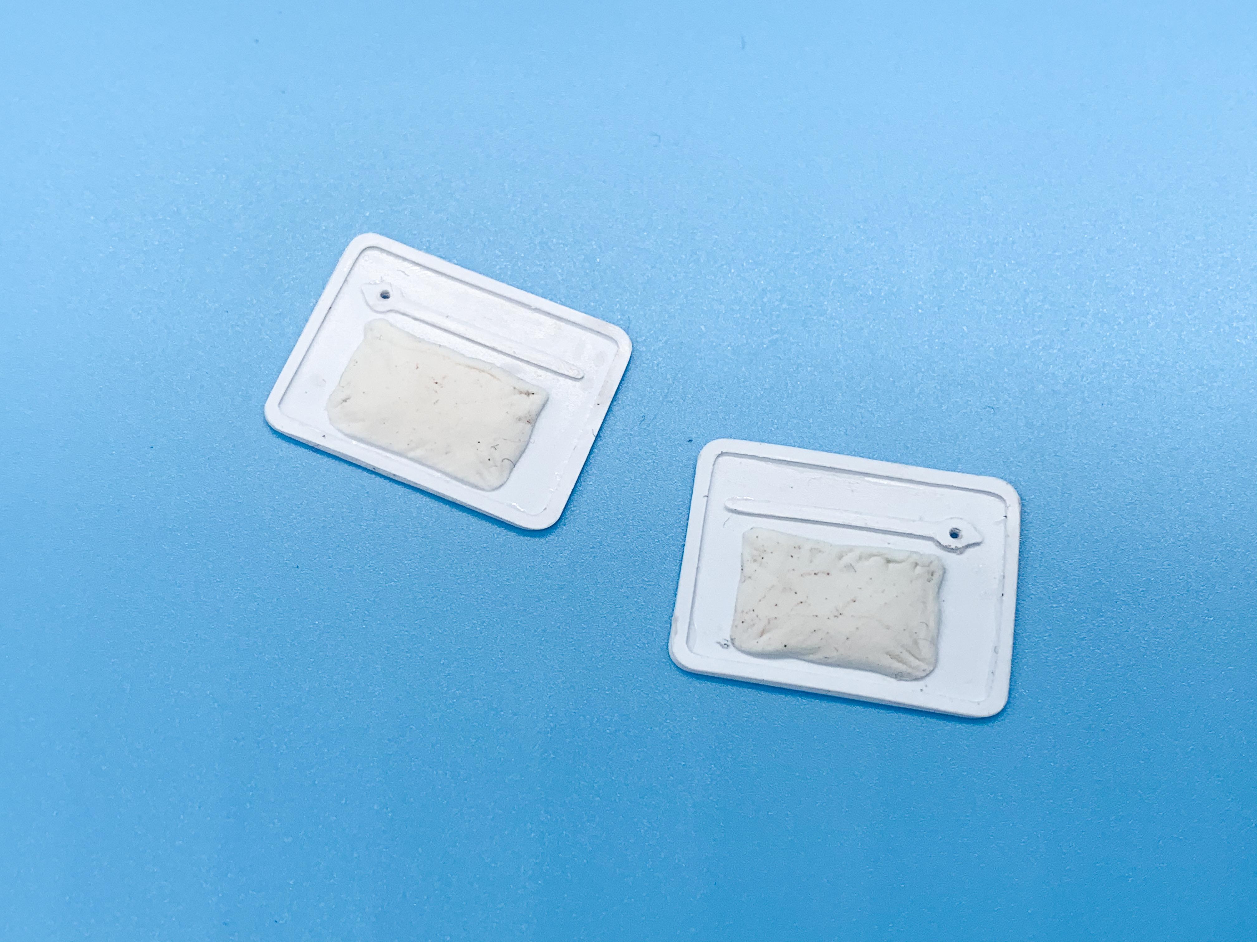

Rolled some out into a sheet and added some creases and detail to make it look like fabric door pockets...not that you’ll likely be able to see it anyway if I paint those door panels to look like they’re fabric or leather colored but I wanted to try the technique:
And how they’ll look on the door panels:
Just adds a little interest I think - we’ll see in a few days if you really CAN paint these ok!  Worse case I have to shell out a few bucks to use some ‘real’ product...

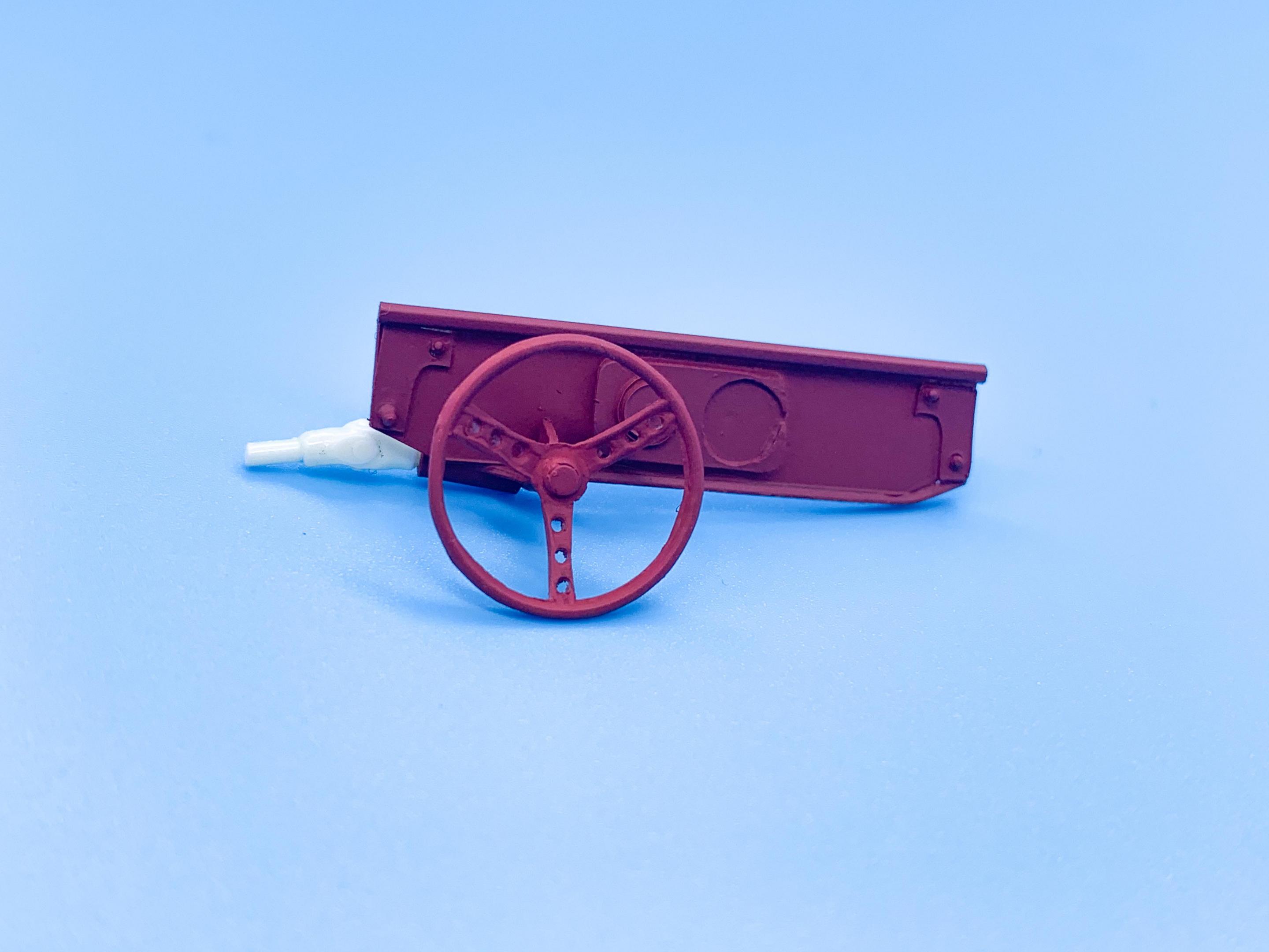

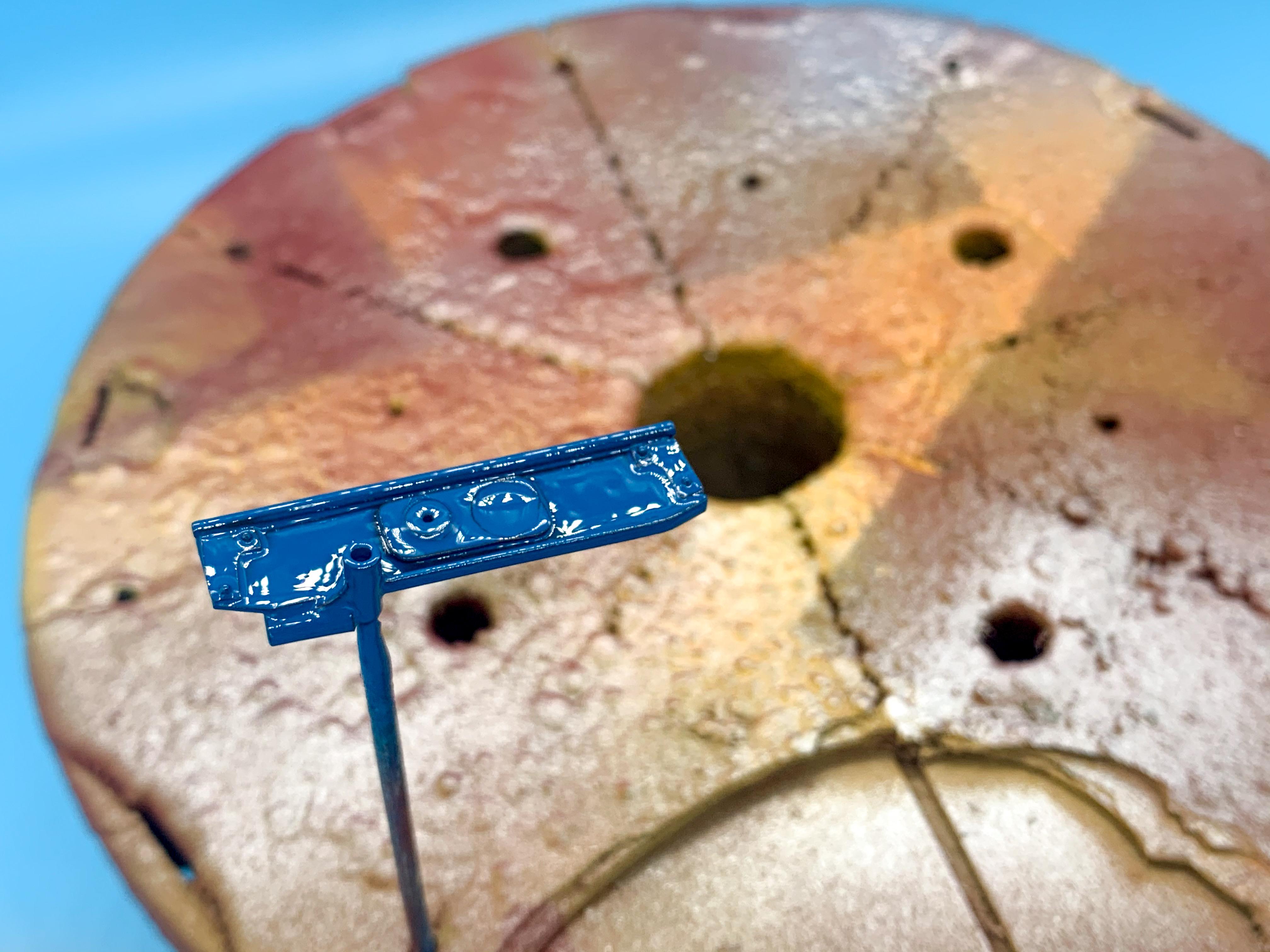

Oh, and I primed that dash ready for some paint...
...then cleaned it up and got it body-colored:
This tractor paint sure is thick, but it seems to shrink down nicely and stay glossy so I’ll take it...

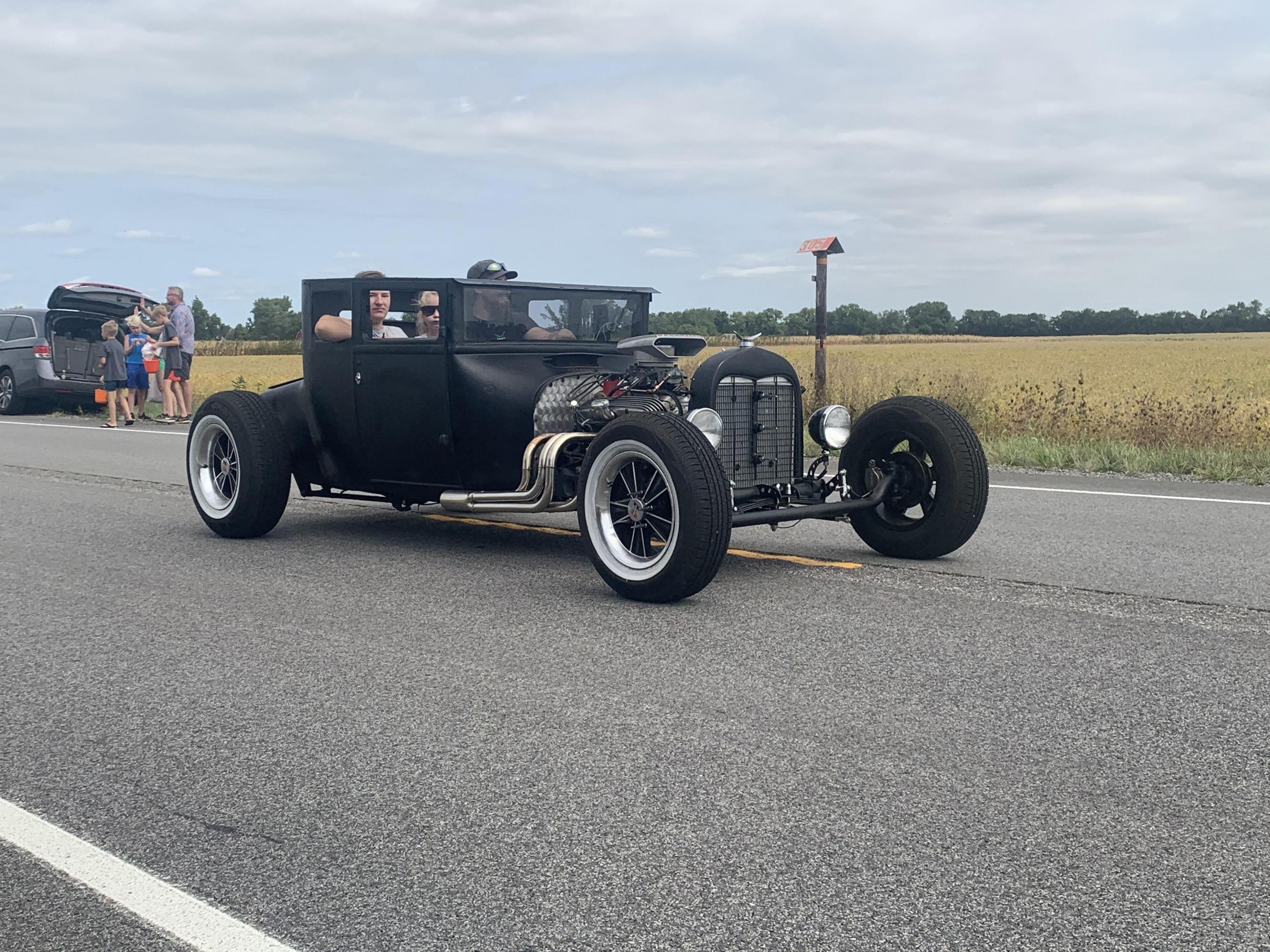

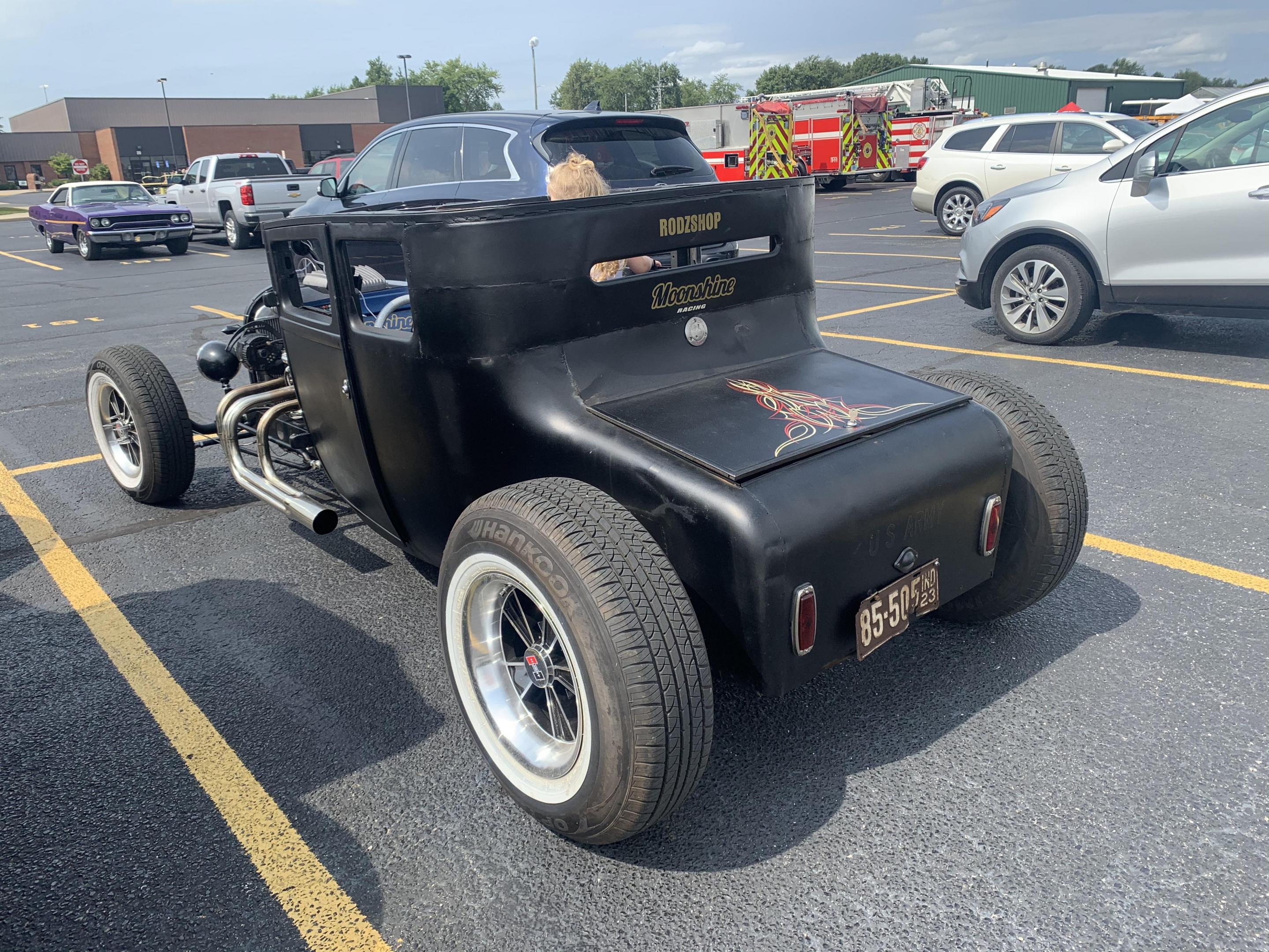

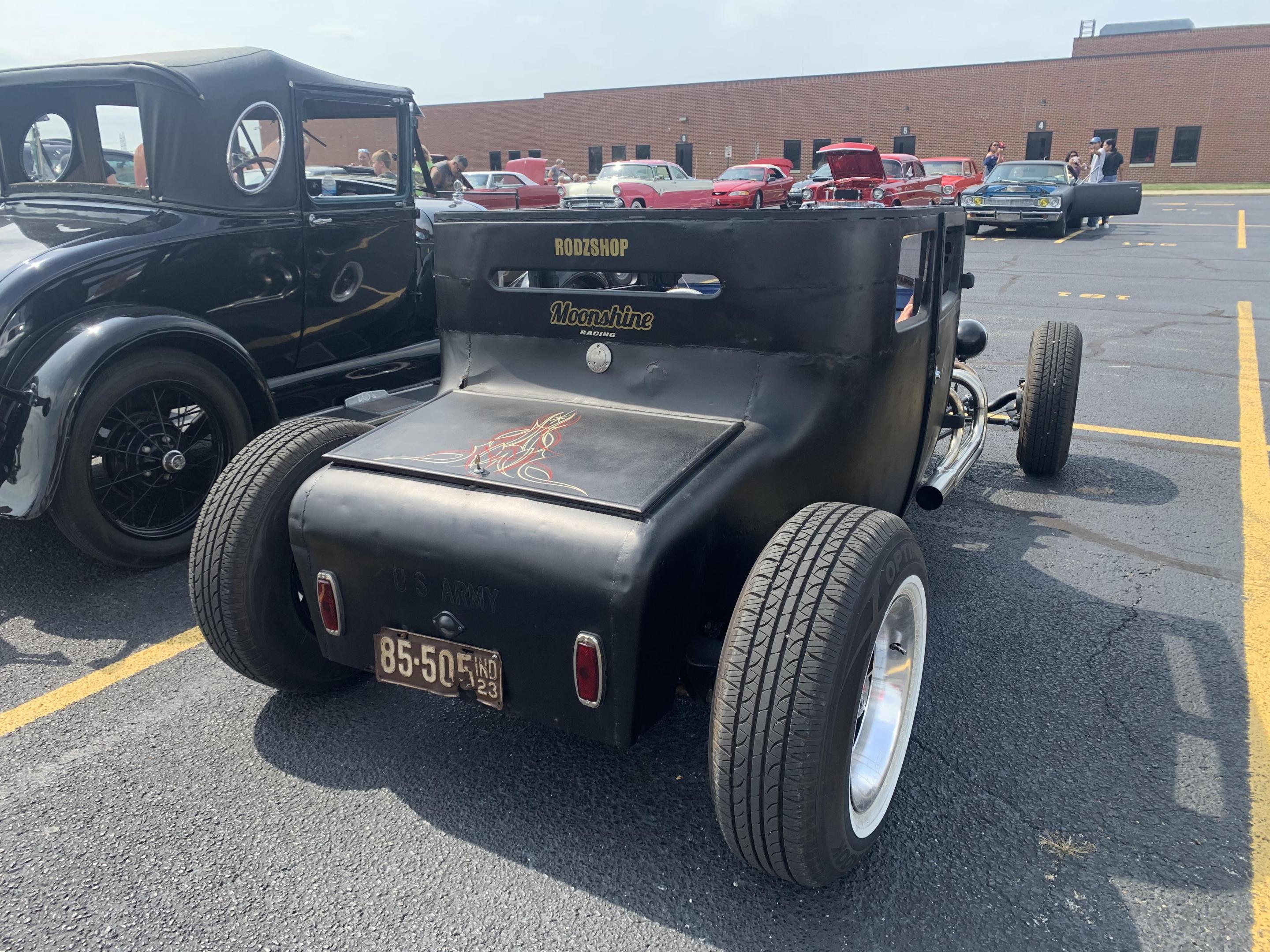

Oh, a little sidenote - saw this yesterday:
Got a good chance to check out the interior - these things REALLY are tiny!  Even without a big high trans tunnel this thing had some super narrow seats in, but they didn’t look much wider in 1:1 than mine would scale up to...reassured to know from studying one up close that I wasn’t too far off!

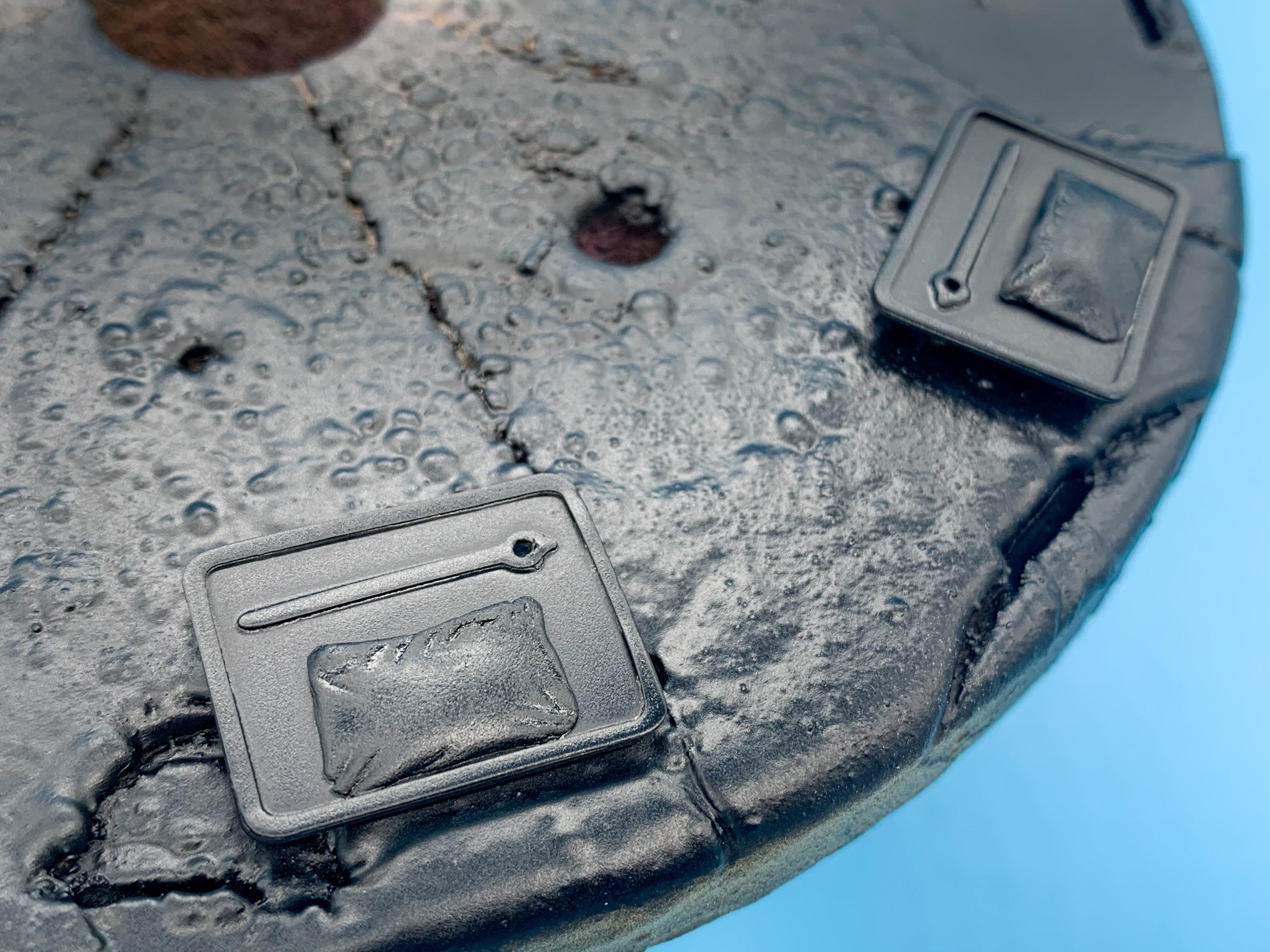

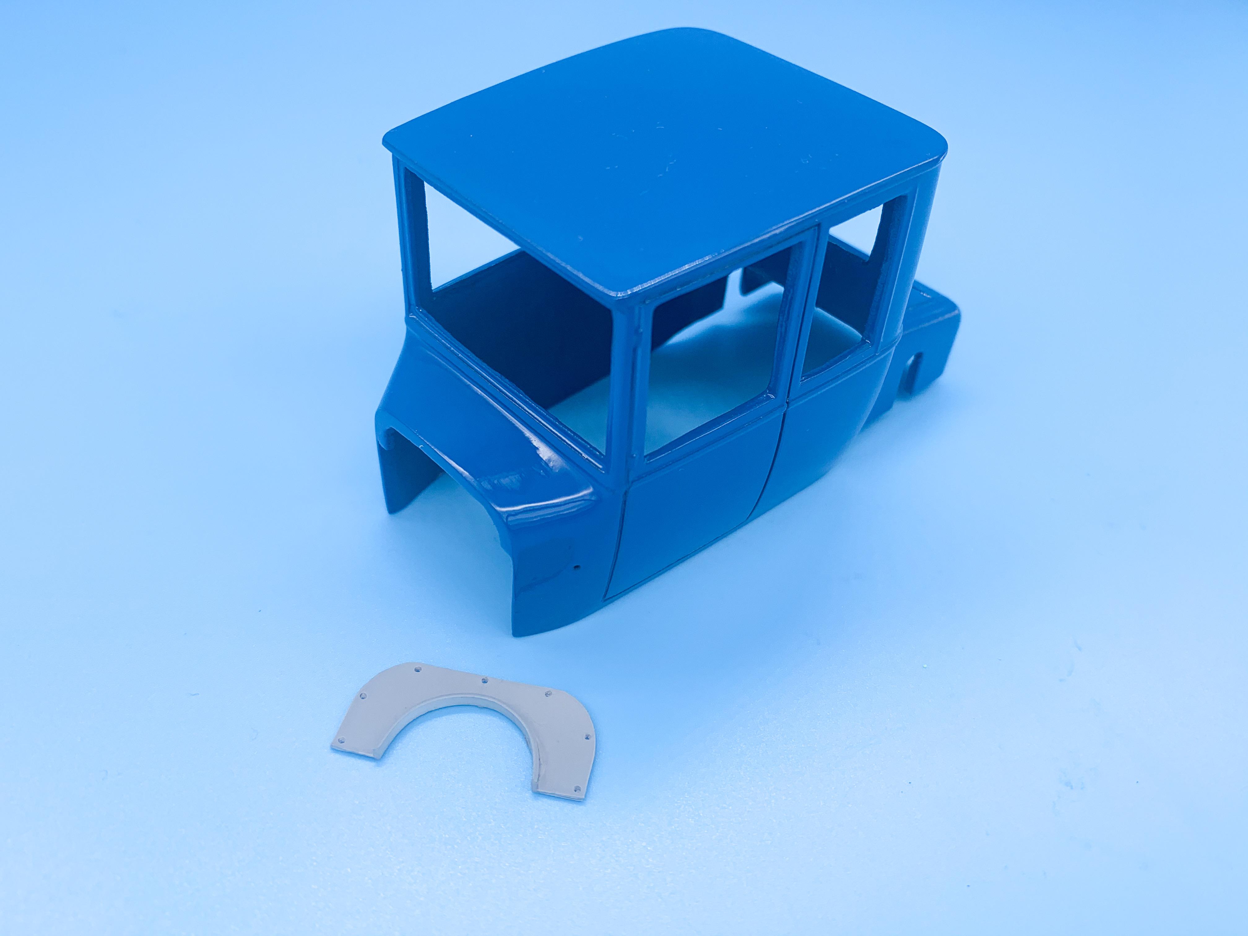

Tiny update - my experimental clay door pockets dried fine and took paint fine too!
Scratchbuilt a little firewall ready for paint and detailing:
And now, whilst I wait a couple more weeks before I dare attempt polishing that thick ol’ enamel tractor paint I can start detailing some of the assemblies ready to mount to the chassis (which is also in thick ol’ tractor paint so it’ll be a little while before THAT’s ready to mess with too ??)
