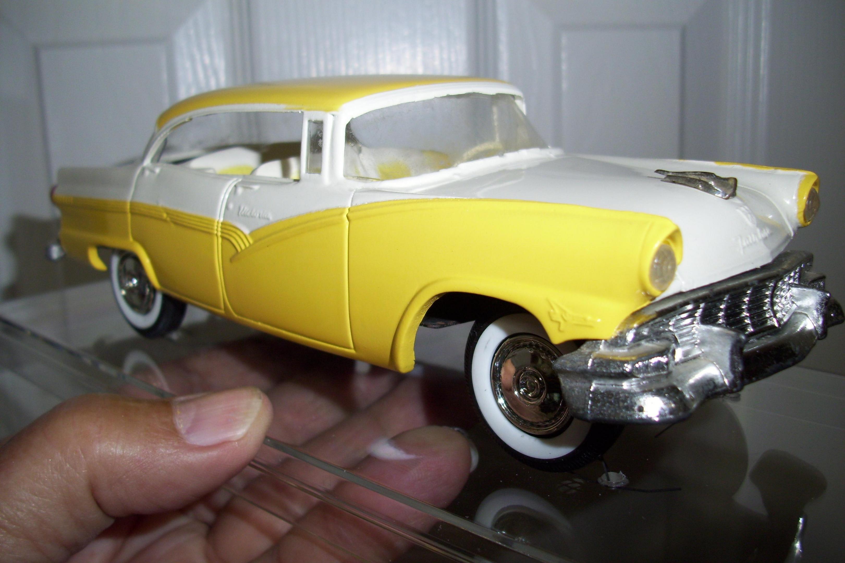

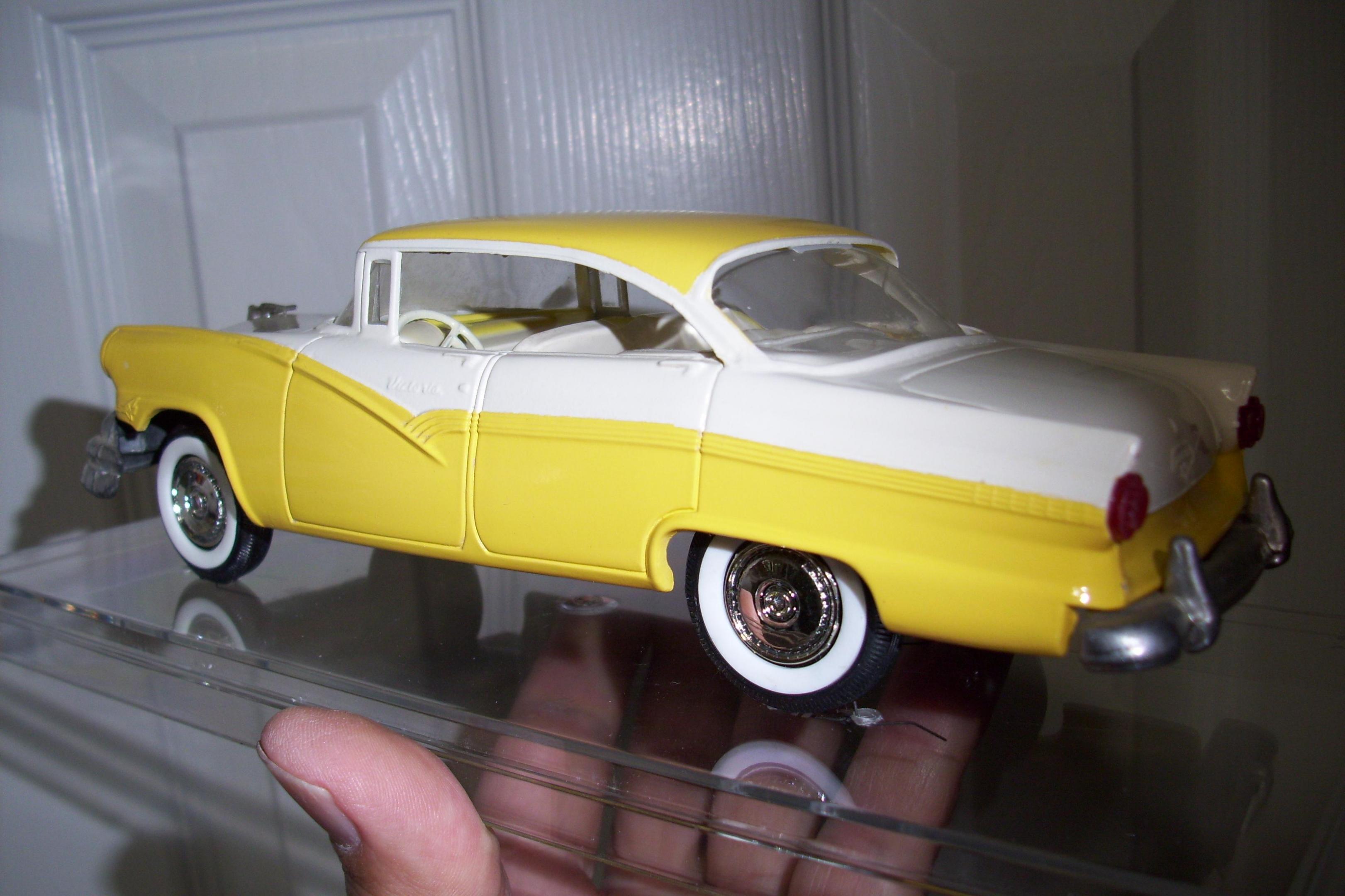

Here is a 1956 Ford Promo that I restored. I could not get all the warp out.
To me, it was worth the effort to bring the old Ford back from the dead.

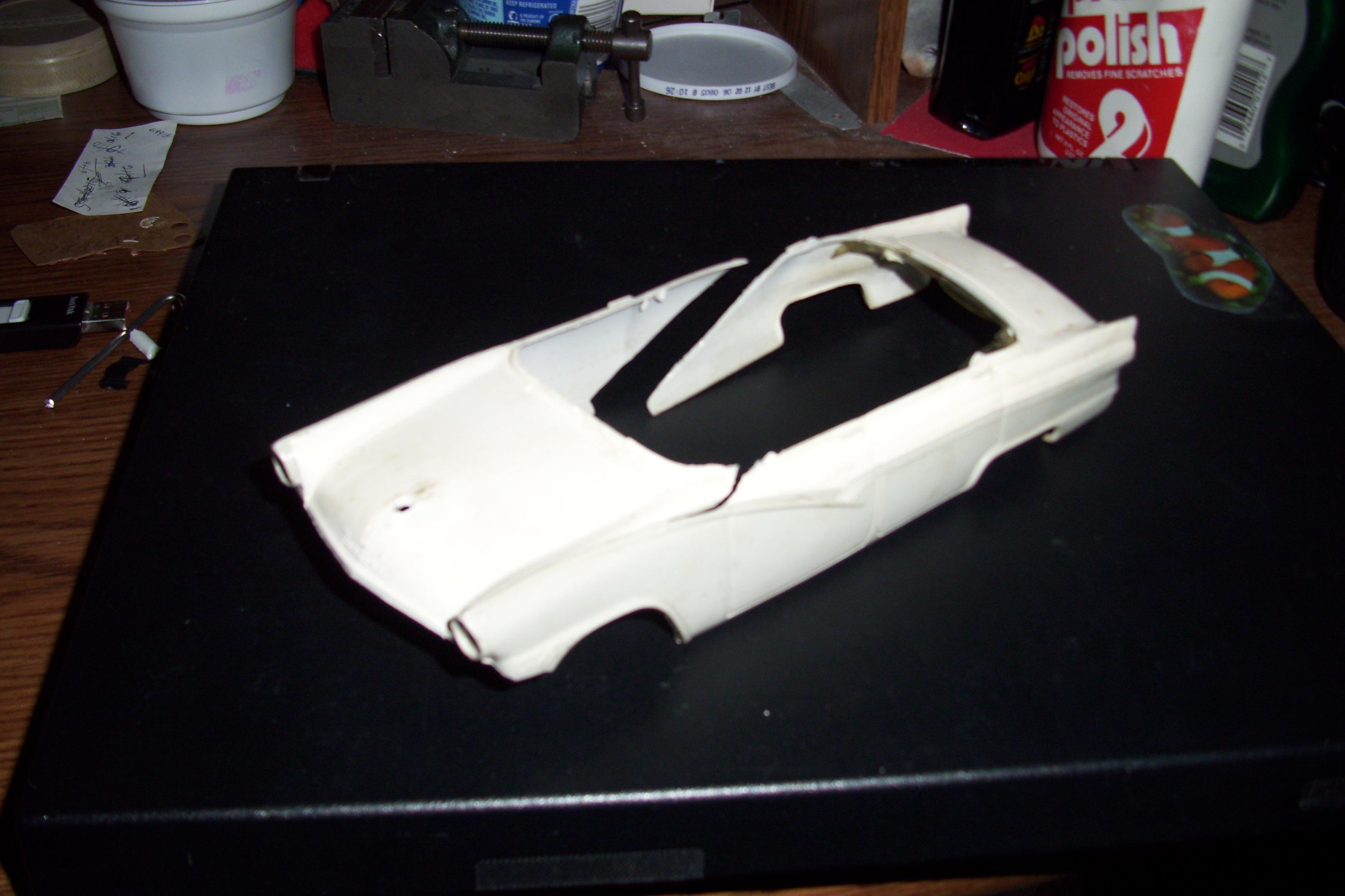

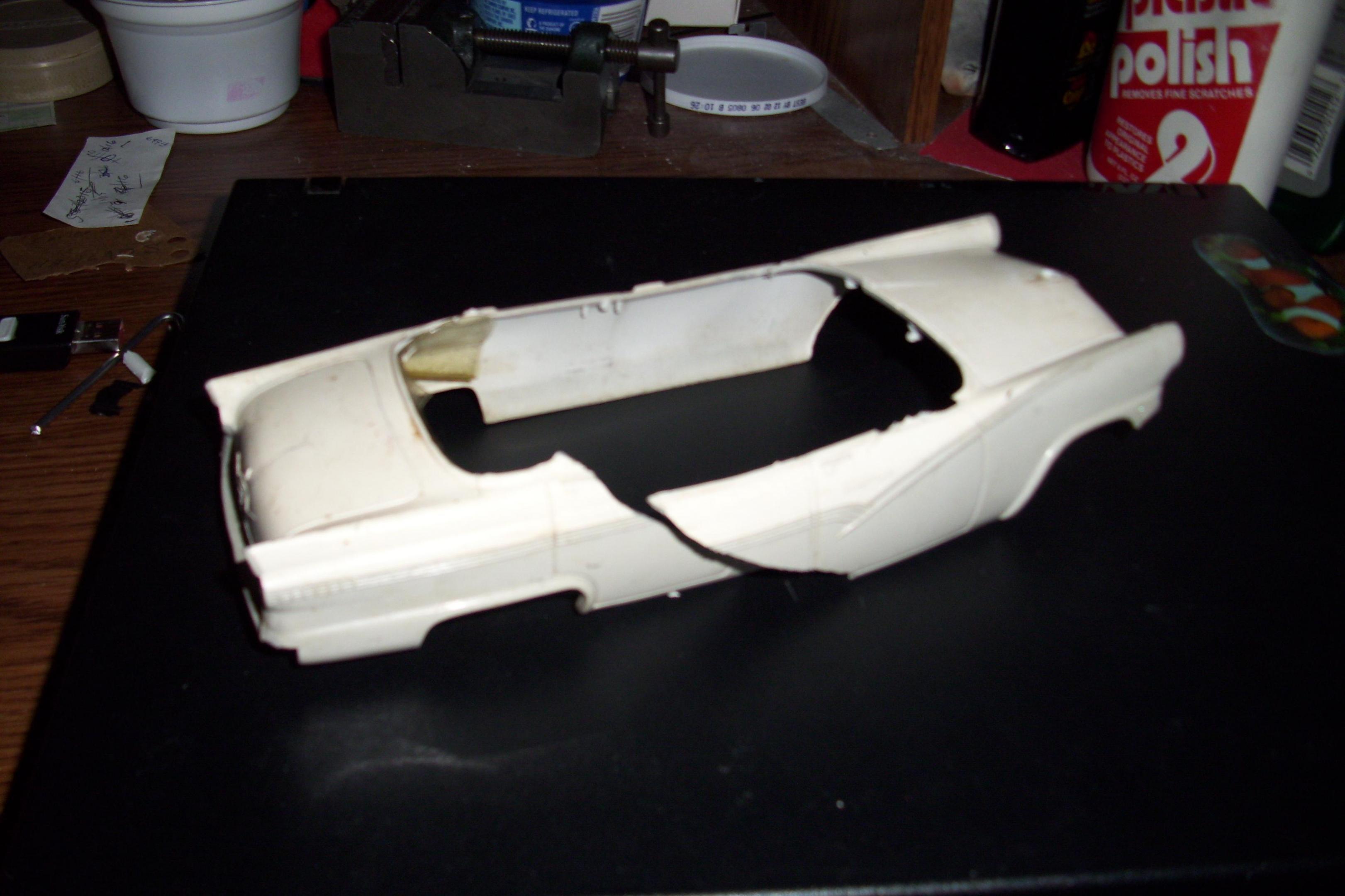

Good job! I'm not skilled enough to repair a warped casting. Something like that I would have changed the body using the AMT Ford Victoria, or at least most of a newer casting. Some will say it's not the same car then, I get that, but is much better than something that looks like it's been in the oven for an hour.

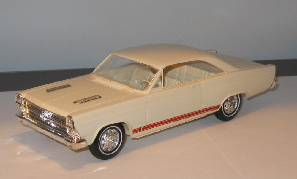

Then there was this '66 Fairlane GT promo which I took back to original. Before...
...and after:
Tough part was getting that black paint off and its stains out, eventually got it with Testors ELO stripper and a lot of elbow grease. Got the bumpers redone by GT Kustom Krome (after dislodging the front one which was held on with half a bottle of Elmers Glue), touched up the taillight bezels and wheelcovers with Molotow, gave it a final polish, and done. Couldn't do much with the stripes (nobody I know of repros them, and neither the original kit nor the new version have them).
Now THAT is a TRUE restoration, a term that's almost always misused around here. VERY well done, my friend! B)
