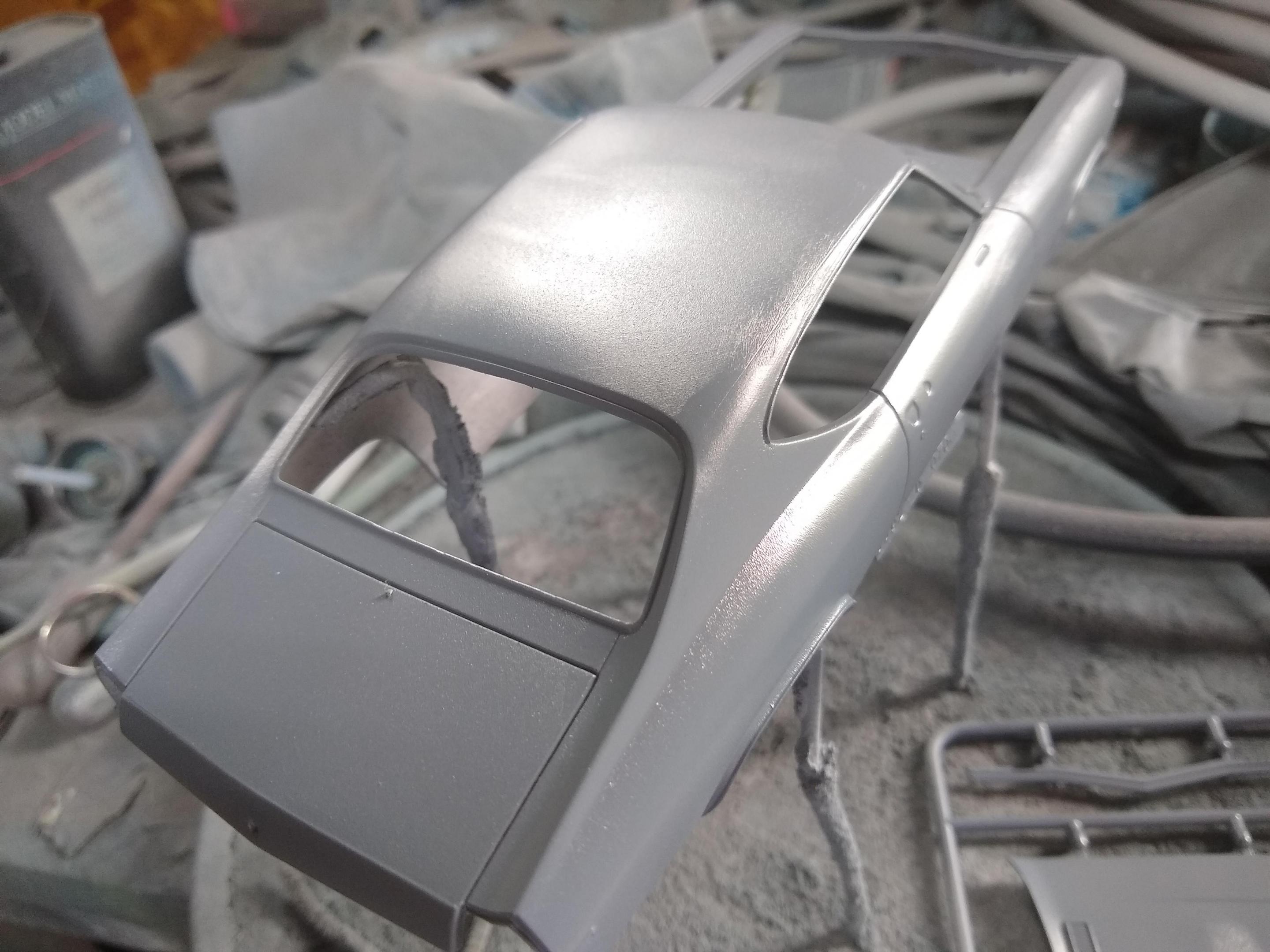

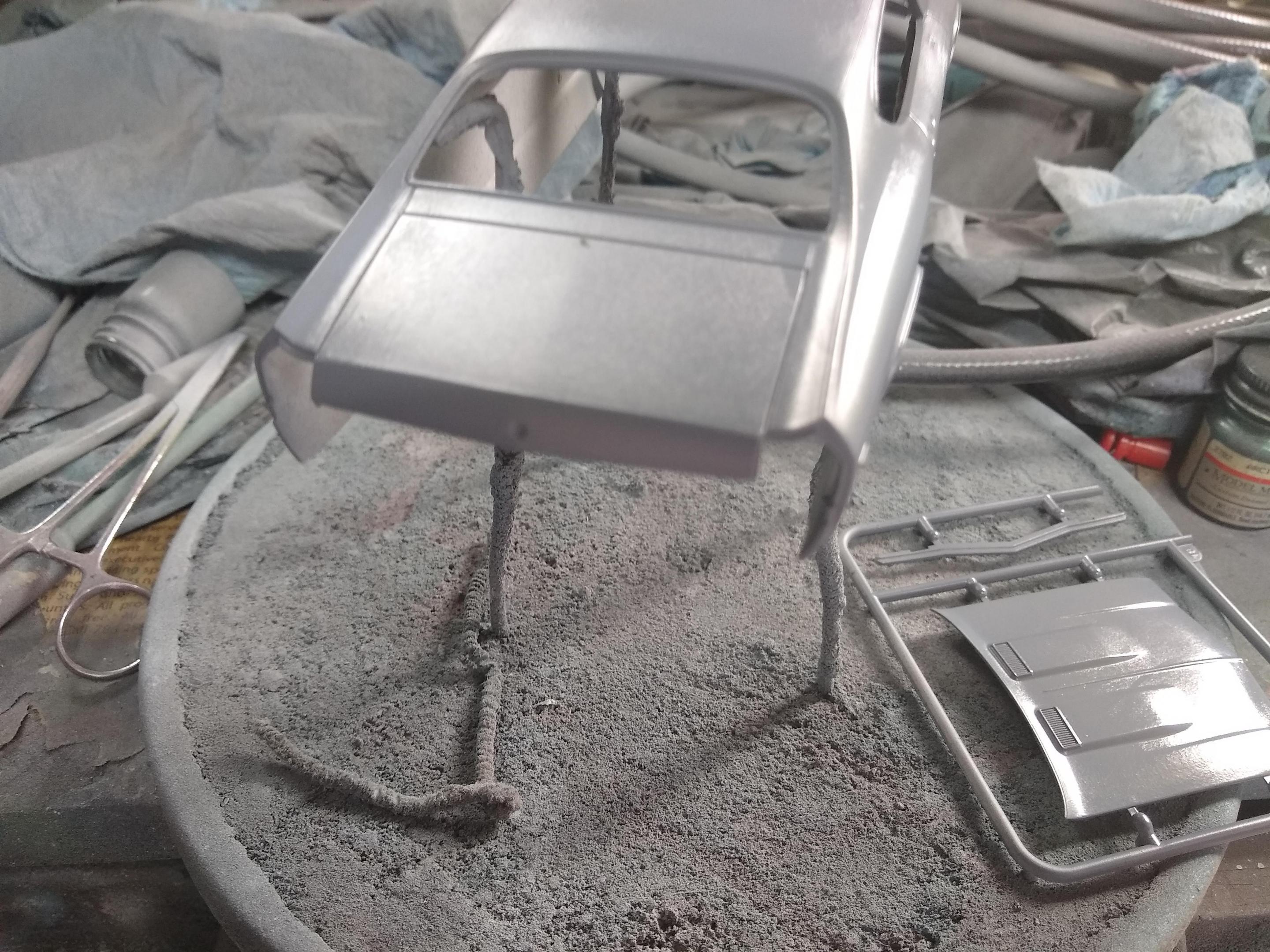

randyc Posted August 10, 2020 Posted August 10, 2020 So, thought I'd prime these two right quick. New can of duplicolor gray primer. This is NOT kit plastic friendly! Be warned. See photos.
randyc Posted August 10, 2020 Author Posted August 10, 2020 Enlarged photos don't really show the crazing. I've been spray bombing for years, so it's not like I did some prep thing incorrectly. Same process as always. There is just no predicting what new sprays will do with new formulations. Probably going to start sticking with Rustoleum 2x primers and paints. HPI GUY Chris seems to have good luck and it does seem to work pretty well. Can't find duplicolors as reliably. I did get a can of "Miracal" flat black at Dollar General. It sprays beautifully. But in the weather right now, it dries a semi flat dark gray. Which works for me, as I can mist on other blacks to give different finishes.

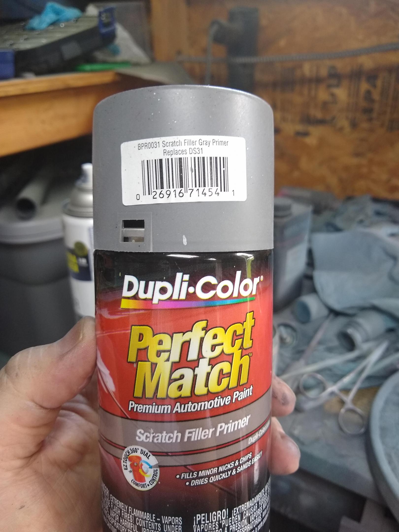

randyc Posted August 10, 2020 Author Posted August 10, 2020 On 8/10/2020 at 1:15 PM, crazyjim said: Haven't any issues with Duplicolor sandable primers. Expand And maybe that's where I screwed up. Scratch filling primer this time. I don't remember when I bought this - not long ago. Don't remember my thought process, either. I probably thought this might work better with my current building process of scribing panel lines and such. HAH! I just remembered - I bought this to fix my MILs real car. Then I put the can on my modeling table, figuring I could use it there. Still my fault for not testing first. I've really got to do some organizing.... I did have plans to do that during the first 2 week Covid shutdown back in March, but only got 3 days of one week at home, then I was called back to work - was only person in office for like 3 solid weeks. and told that I would never be laid off again til the owner or I die. Or retire.

Ace-Garageguy Posted August 10, 2020 Posted August 10, 2020 I've had a lot of semi-disasters using various primers in recent years. The regular Duplicolor crazed one badly, but I was able to save it using PlastiKote "scratch filling" primer...but the formulation was subsequently changed and it's crapp now. "Scratch-filling" primers are nothing but higher-solids, high-build versions of the regular automotive primers, chemically pretty much the same. But kit plastic formulation is all over the board these days. You can safely use some hot automotive primers on SOME issues of certain kits, but they'll turn other issues into a wrinkly mess. I've about given up on automotive primers for most full-body paint work now, especially on recently manufactured kits. But Tamiya works beautifully and lays out slick and smooth if I shoot it wet like I USED to be able to do with Duplicolor et al. Yes, it's more expensive, but I'm OK with that as long as it actually works.

Ace-Garageguy Posted August 10, 2020 Posted August 10, 2020 (edited) Weather has no significant effect on crazing (other than high humidity slightly slowing the flash time, allowing hot solvents to remain longer on the surface). It's simply the hot solvents attacking the plastic substrate. You CAN mitigate the crazing effect by shooting "mist" coats from farther away (which allows for some solvent evaporation prior to the primer hitting the surface), but this also causes a grainy or orange-peel surface that has to be addressed prior to color. Either way, you're screwed. Scuffing, however actually CAN have a slightly adverse effect. Injection molded plastic parts have a slightly harder surface...the part that was in direct contact with the hot mold...than the underlying plastic. Scuffing, even the gentle scrubbing with an abrasive cleanser I now favor, can exacerbate the tendency towards solvent crazing...and I know this from experimentation. So in short...TEST, TEST, and TEST before committing to using ANYTHING on a particular model. On 8/10/2020 at 2:40 PM, randyc said: ... I hate the sanding trying to fix it, but got no choice. Ugh. Expand I feel your pain, but I thought this one was pretty much ruined. In the event, saving it was really pretty easy. Edited August 10, 2020 by Ace-Garageguy
