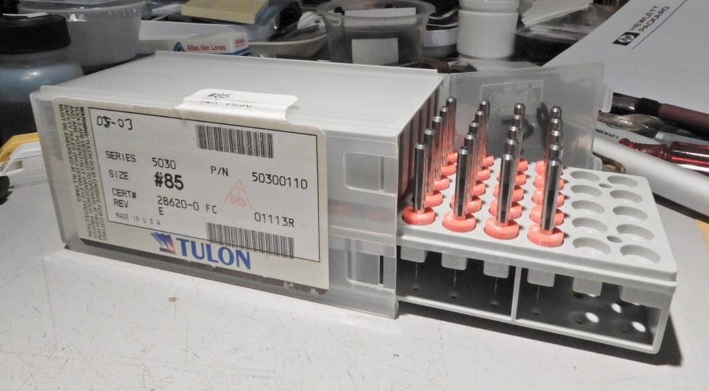

ChrisBcritter Posted September 22, 2020 Posted September 22, 2020 I got this set from Harbor Freight, cheap: So far, so good - nice and sharp. Wish they came with a 3/32" shank instead of 1/8" so they would fit my little Michael's grinder; I can work them by hand OK but I do tend to get cramps in my fingers after a while. I'm going to pick up some automotive rubber hose with 3/32" ID and cut short lengths to fit over the shanks as cushions to see if it helps.
ACR-E Doug Posted September 22, 2020 Posted September 22, 2020 i buy my carbide bits from "Drill Bit City" but with the carbide you have to be very careful because the do brake very easy, but do a great job drilling holes. I find they work very well in my Sherline lathe and mill, but because there is no side load I have not broken many. BTW I always buy their re-sharpened sets, they come 5 or 10 in each box. The re-sharpened ones work great on plastic and soft metals.

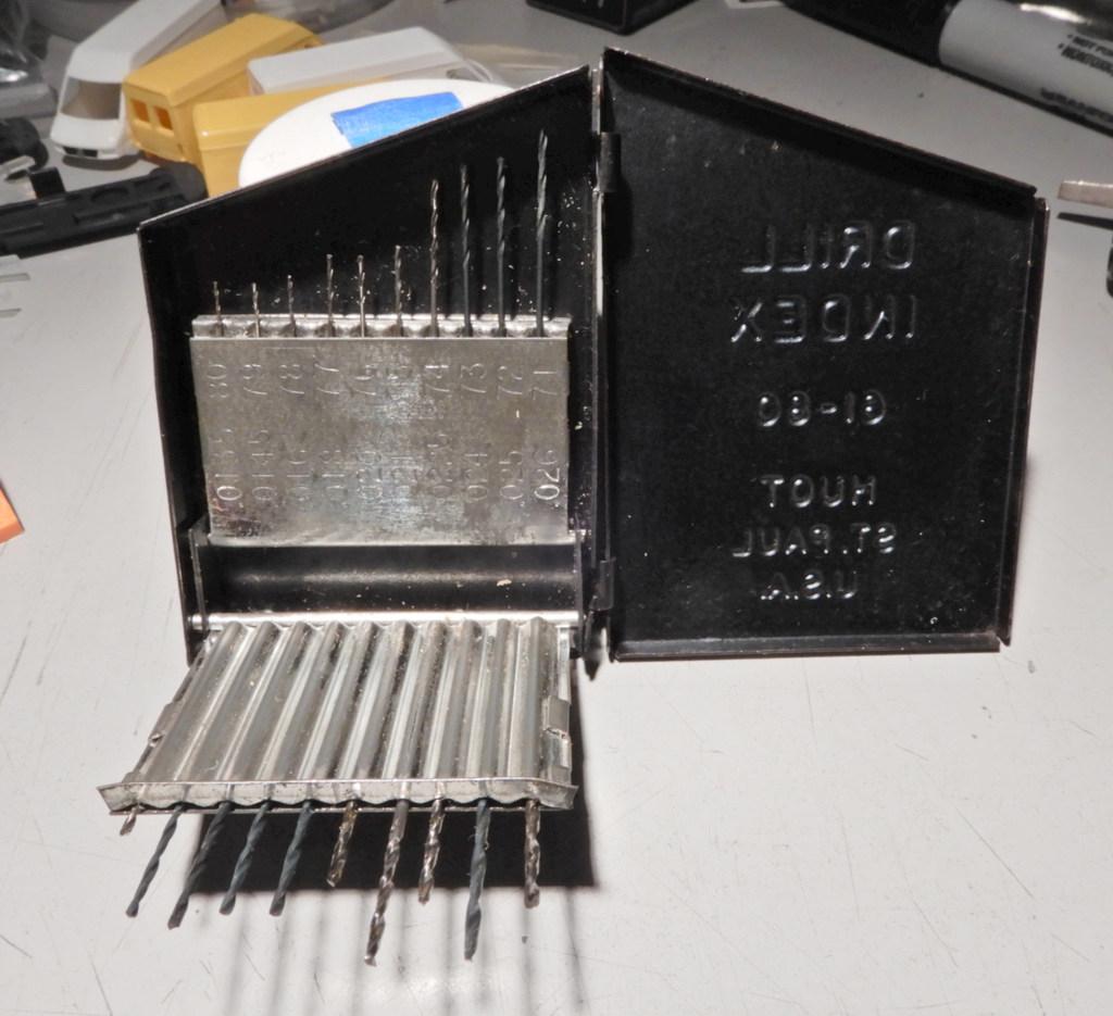

Dave Ambrose Posted September 22, 2020 Posted September 22, 2020 On 9/19/2020 at 10:30 PM, Russell C said: Drill bits break? Might be a matter of the kind of metal they are made out of and how well sharpened they were out of the gate. I kid you not, swear on a set of Bibles, I've been using the same set of #61-80 bits since I snagged 'em from my machinist father sometime in the late 1980s, in both my motor tool and in my pin vice. A few seem a little duller than the rest by now and the only broken one in the bunch is the #79 where I dropped whatever I was using to drill on the floor. I have a set of those. They are great! Been using them for a very long time. I've broken one or two, which I'll ascribe to carelessness on my part.
Pete J. Posted September 22, 2020 Posted September 22, 2020 Interesting! I have seen that little box copied a hundred different ways. That is the first time I think I have seen the original. All the knockoffs can be very sketchy. I would bet the original "Made in the USA" stuff is really pretty good. I am also willing to bet that the Chinese knockoffs are junk! Strange as this sounds the best I have found is Kyocera Asia Pacific tools. I believe they have headquarters in Singapore. Good stuff but not cheap. I save them for drilling very delicate holes. It is fun the see a spiral chop the size of a hair come off of them.
randyc Posted September 23, 2020 Posted September 23, 2020 I have looked and looked today. At drill bits and razor saws. So many reviews say same thing - point not sharpened. I wish I had had internet when I first got that set of Huots in the black case. I still have a few but I broke most being heavy handed. I suppose I could order the 70 & 72 like others recommend. Really all I need is for plugs wires and pins. I have enough larger ones still left.
Pete J. Posted September 24, 2020 Posted September 24, 2020 On 9/22/2020 at 10:31 AM, Dave Ambrose said: I have a set of those. They are great! Been using them for a very long time. I've broken one or two, which I'll ascribe to carelessness on my part. On 9/19/2020 at 10:30 PM, Russell C said: Drill bits break? Might be a matter of the kind of metal they are made out of and how well sharpened they were out of the gate. I kid you not, swear on a set of Bibles, I've been using the same set of #61-80 bits since I snagged 'em from my machinist father sometime in the late 1980s, in both my motor tool and in my pin vice. A few seem a little duller than the rest by now and the only broken one in the bunch is the #79 where I dropped whatever I was using to drill on the floor. Found them!!! Original manufacture and I would bet, based on the price they are pretty good quality. Next order, I am going to spring for a set. https://www.mscdirect.com/product/details/78579042
Russell C Posted September 24, 2020 Posted September 24, 2020 12 minutes ago, Pete J. said: Found them!!! Original manufacture .... https://www.mscdirect.com/product/details/78579042 Good to know, if calamity wipes out my set.

peteski Posted September 27, 2020 Posted September 27, 2020 (edited) On 9/20/2020 at 1:30 AM, Russell C said: Drill bits break? Might be a matter of the kind of metal they are made out of and how well sharpened they were out of the gate. I kid you not, swear on a set of Bibles, I've been using the same set of #61-80 bits since I snagged 'em from my machinist father sometime in the late 1980s, in both my motor tool and in my pin vice. A few seem a little duller than the rest by now and the only broken one in the bunch is the #79 where I dropped whatever I was using to drill on the floor. I have one of those drill indexes, but mine is probably a bit newer (to was bought new in the '80s). But I'm pretty sure that HUOT just makes the index box - the drills are put in by whoever sells the set. If that is the case then HUOT does not automatically mean "quality bits". IIRC, my set came from either Micro-Mark or possibly Walthers (not from one of the industrial suppliers). I do use (and sometimes break) these high-speed steel bits when I know that I will not be able to hold the drilled item steady. But I'm highly addicted to those PC board Tungsten Carbide bits with 1/8" shanks. Not only they are extremely hard, but that are sharpened to a split point, so they cut really fast and don't wander. They will drill anything from hard stainless steel through styrene, I use them in my Micro-Mark drill press, Sheline Mill, pin vise, and for the really small ones, I just hold the 1/8" shank in my fingers. Sometimes I use the larger ones in my Dremel). Not often. While I don't have all the consecutive sizes, I do have quite a range available. I made my own indexes. Since I know they do break, I do try to get them cheap in bulk. Like boxes of 50. I bought the ones above in 2003, and still have plenty left. I usually found bargains on eBay, but I'm not sure if that sill holds true today. I hyst searched for the size (like 80) and "PCB" or 'PC Board" drill bit . Edited September 27, 2020 by peteski
Russell C Posted September 27, 2020 Posted September 27, 2020 3 hours ago, peteski said: ... I'm pretty sure that HUOT just makes the index box - the drills are put in by whoever sells the set. ... In looking into this further myself, you are probably right on that. Whoever the supplier was at the time I began borrowing this set from my dad in the late '70s, they've been unbreakable, apart from the one that met its end from a 4 foot drop to a concrete floor.
