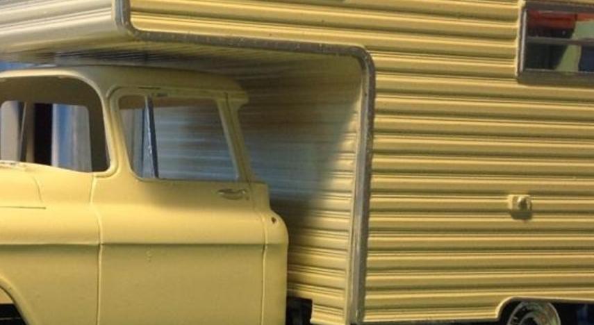

I checked the pickup bed shell that comes with the Gear Hustler El Camino since it's a flat panel about 2 1/8" by 3 7/16", but it has the same issue (wrong number of thin ribs and the thick ones aren't thick enough). Here's a cropped shot of your trailer with the pattern enhanced:
Your closest match would be the material used for the MPC Open Road Motor Home. You'd have to sand the thicker ribs down almost level with the thin ones, but that would get you very near to perfect:

It would be interesting to find out what material the caster used for the siding on the camper casting.
Expand
It’s probably kit plastic.. this camper has been out as the Model King version only the box with the race hauler body. Shouldn’t be too hard to find
