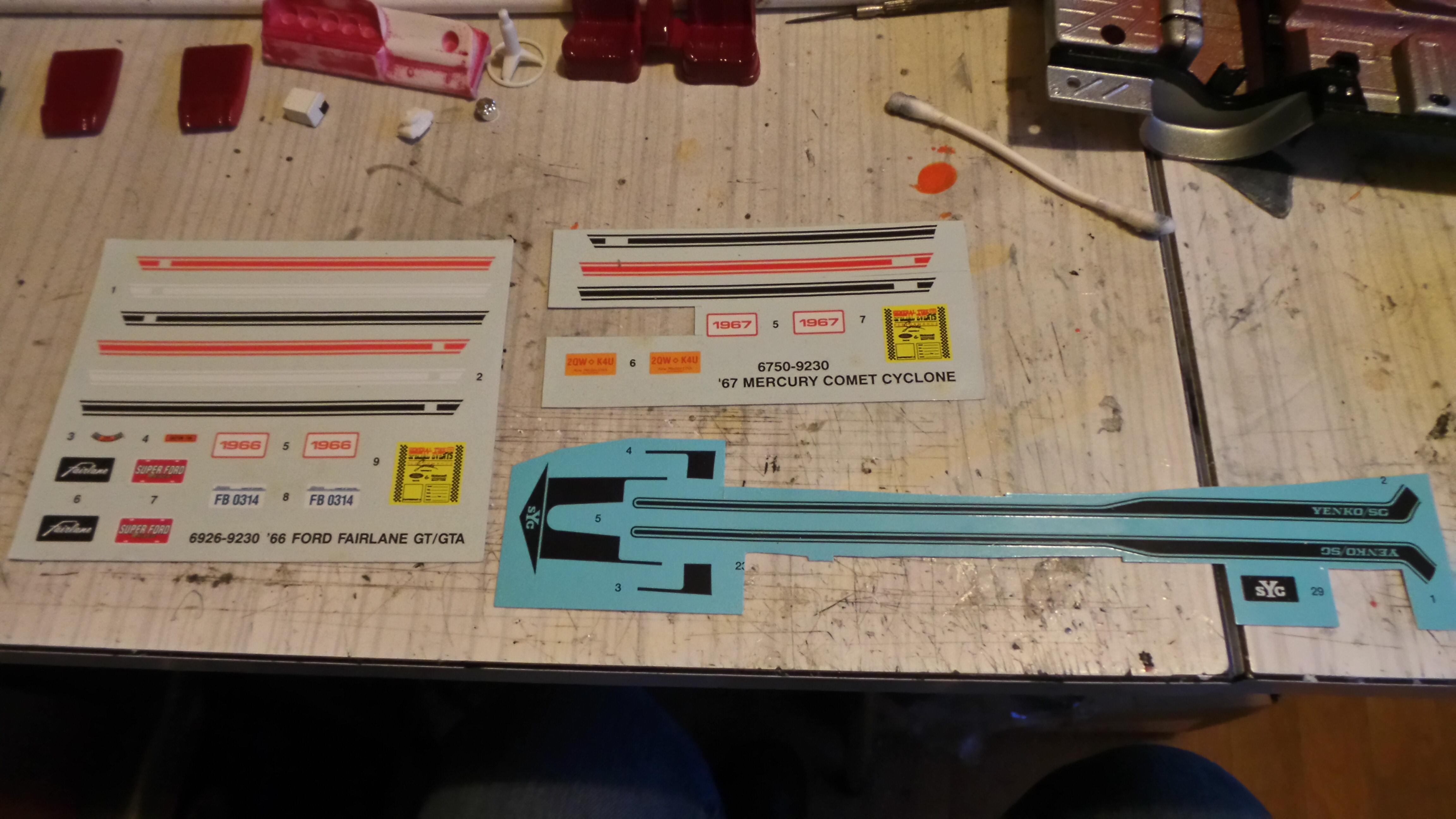

doorsovdoon Posted October 4, 2020 Author Posted October 4, 2020 ok, I tried freehand pin striping, didn't work! I got about two cm of line and saw how much of a mess I was making, so I wiped it off before it had a chance to set. I found these decals in my spares tin and the idea is to very carefully cut the thin outer lines away and use them instead.

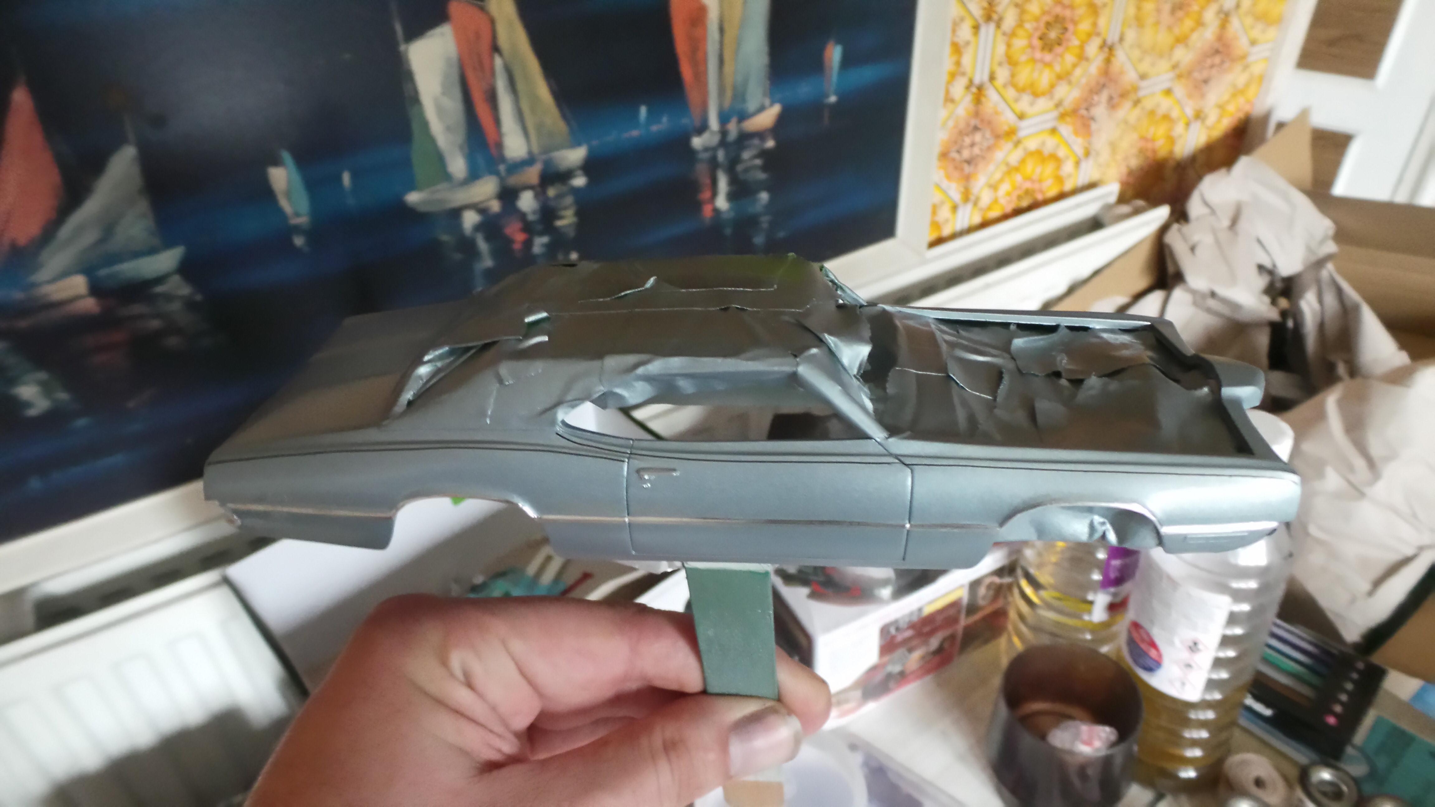

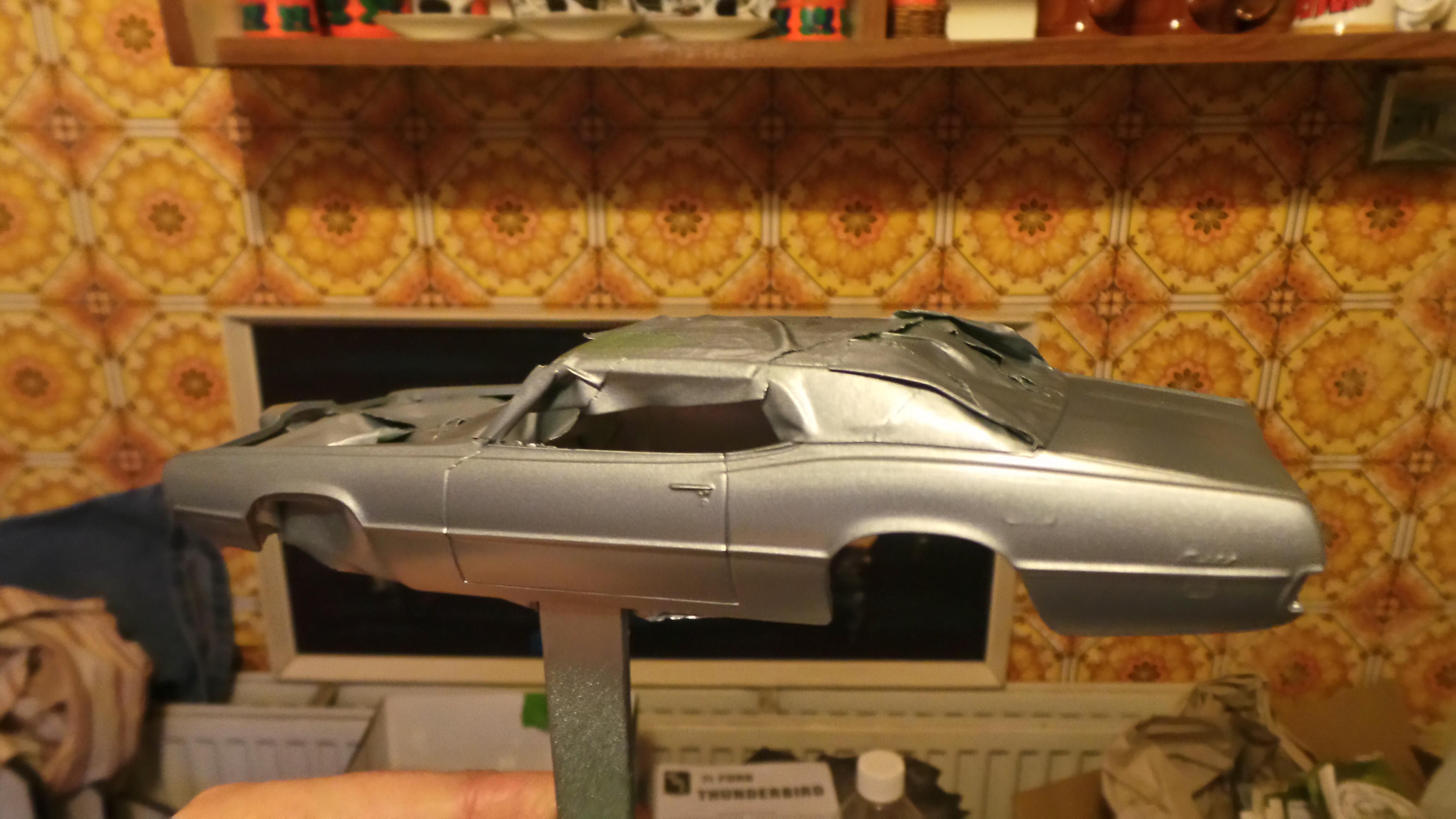

doorsovdoon Posted October 4, 2020 Author Posted October 4, 2020 This is the colour I'm going with, Moonstone Blue metallic. It looks silver in the pictures but the light isn't good enough to show the blue, needs to be out in the sun to show how nice this colour is, something we don't often get here in the UK.

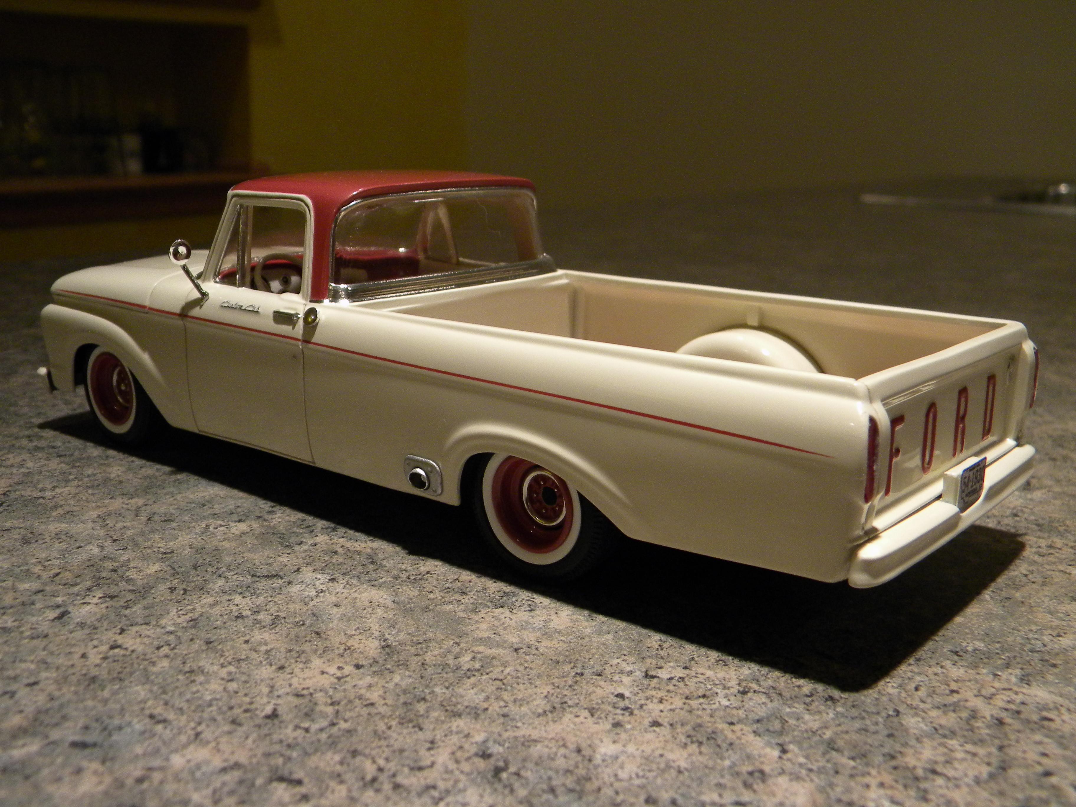

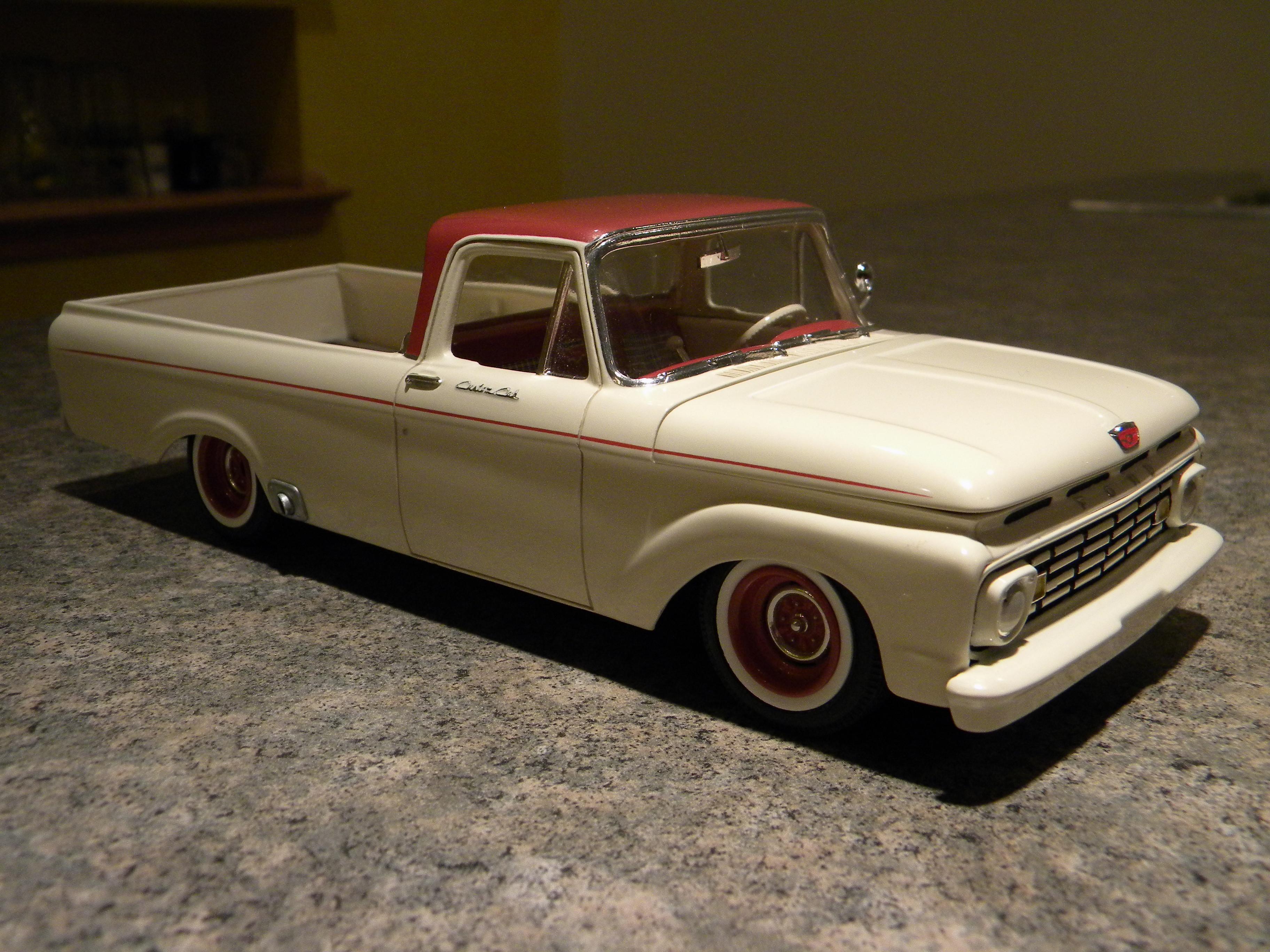

StevenGuthmiller Posted October 4, 2020 Posted October 4, 2020 (edited) 26 minutes ago, doorsovdoon said: ok, I tried freehand pin striping, didn't work! I got about two cm of line and saw how much of a mess I was making, so I wiped it off before it had a chance to set. I found these decals in my spares tin and the idea is to very carefully cut the thin outer lines away and use them instead. You could try masking and spray painting the stripes. It's really not as difficult as you might think. As long as you have some good masking tape, like Tamiya or equivalent, it's not too terribly hard to do some pretty thin stripes. I painted the pin stripe on this '63 Ford pickup with an air brush. I also sprayed the stripes on my '68 Olds 442, this time with a rattle can. It's really pretty easy to do with good tape and very light coats of paint. I plan on spraying the bumble bee stripes on my current '68 Coronet R/T project as well With the decals you're pretty much at the mercy of the current shape of the stripes. With masking tape and paint, you can follow the contours of the body as you wish. The tape will bend as needed if you cut thin strips. Steve Edited October 4, 2020 by StevenGuthmiller

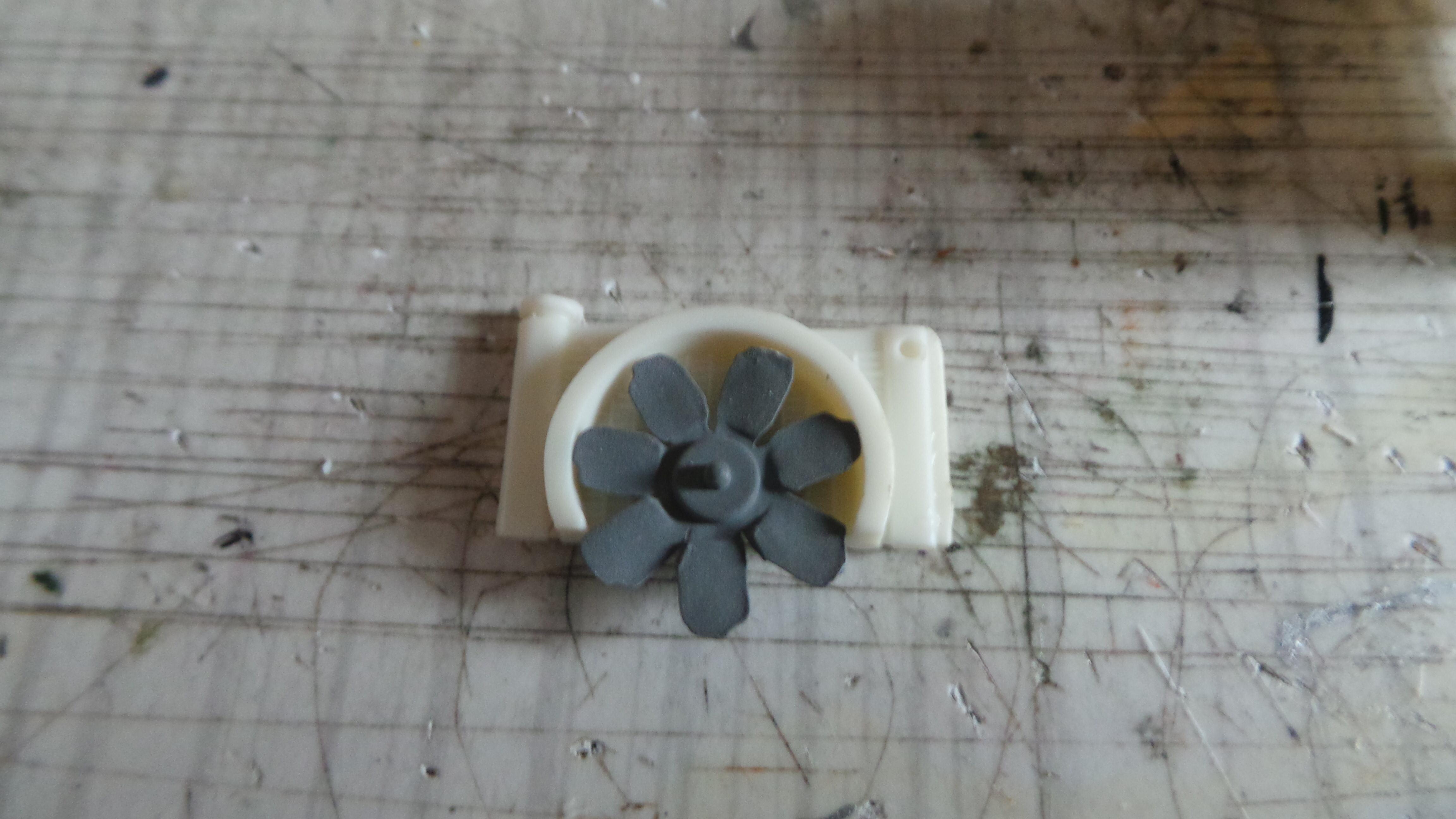

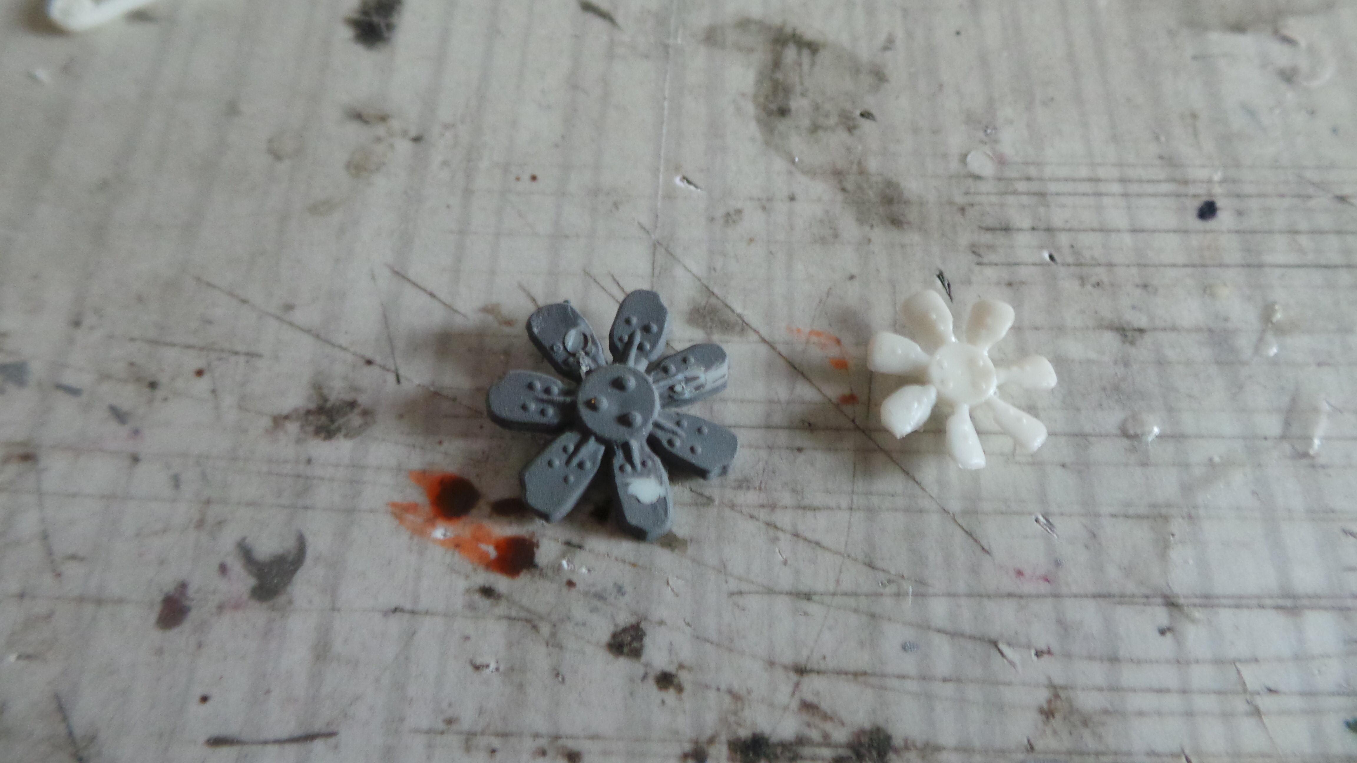

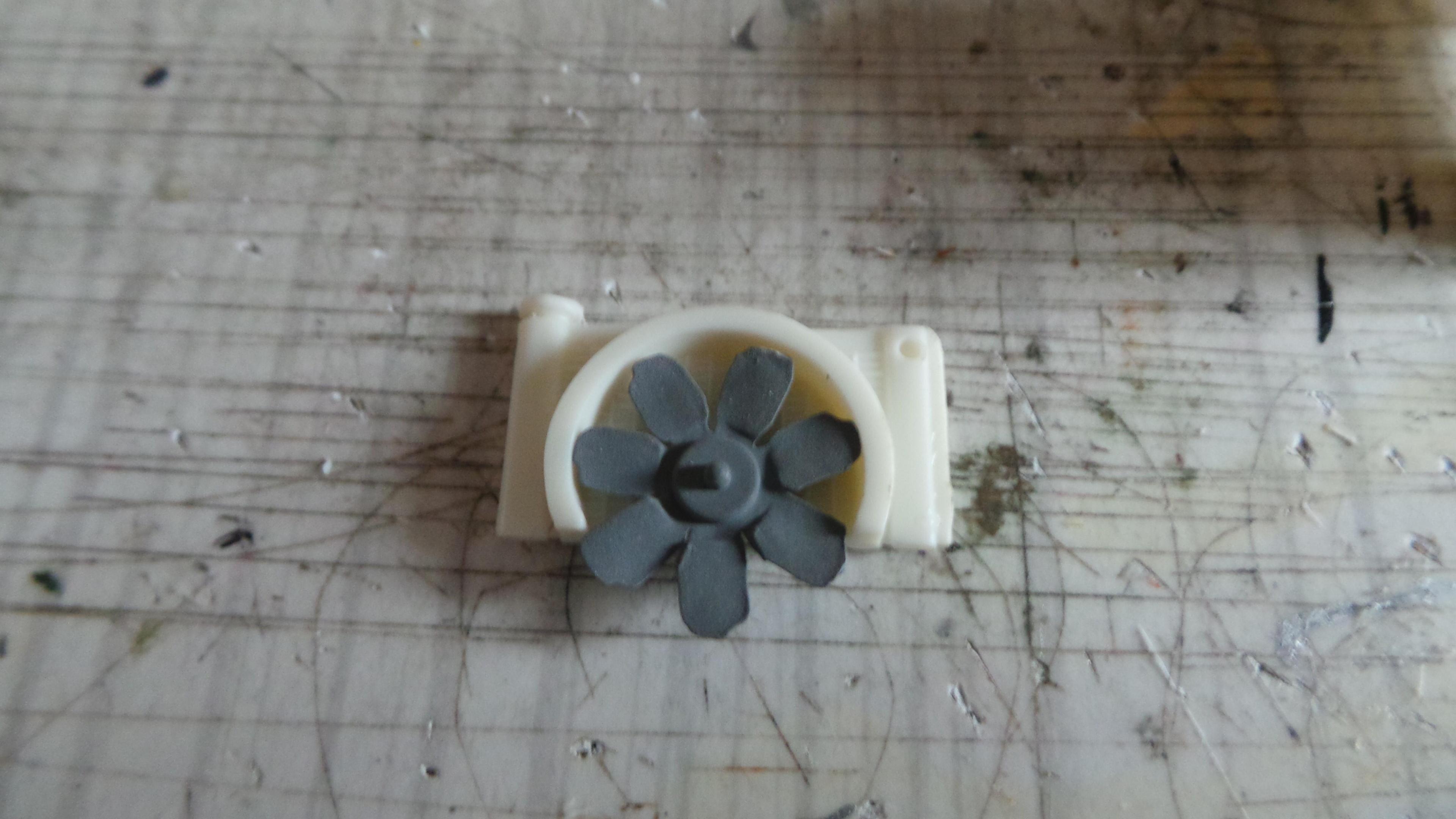

doorsovdoon Posted October 4, 2020 Author Posted October 4, 2020 The cooling fan on this kit is tiny, so I've replaced it with something bigger. Not sure what kit it came from but looks far better. The detail under the hood is so lacking I might actually wire this one with telephone wire and see what other bits I can stuff under there. I've already found a washer bottle and some horns. This kit will be considered advanced by the time I'm done with it! xD

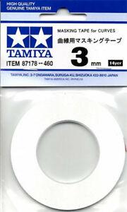

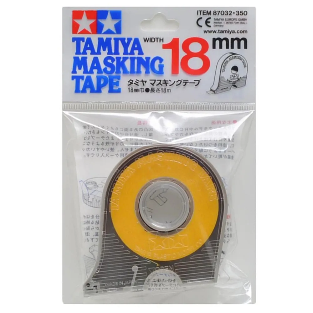

doorsovdoon Posted October 4, 2020 Author Posted October 4, 2020 I keep hearing about Missing Link, sounds like a one stop shop for bits like that. Cool, I'll have to check that out. Yeah, Tamiya products seem to be readily available here, is this the tape I need?
StevenGuthmiller Posted October 4, 2020 Posted October 4, 2020 1 hour ago, doorsovdoon said: I keep hearing about Missing Link, sounds like a one stop shop for bits like that. Cool, I'll have to check that out. Yeah, Tamiya products seem to be readily available here, is this the tape I need? I believe that the white tape is more flexible and apparently designed for curves. I can't comment on how well it works as I've never used it, but being a Tamiya product, I'm confident that it is as good as the regular tape. The standard tape looks just like that, but it's yellow. Steve
doorsovdoon Posted October 4, 2020 Author Posted October 4, 2020 ok, cool. I just now bought a roll on ebay in case the decals don't work out.
StevenGuthmiller Posted October 5, 2020 Posted October 5, 2020 3 hours ago, doorsovdoon said: ok, cool. I just now bought a roll on ebay in case the decals don't work out. I guarantee you, you'll never do without it again! Steve
Bucky Posted October 5, 2020 Posted October 5, 2020 I use the Tamiya tape on all the hard edges on my two-tone paint jobs, too.

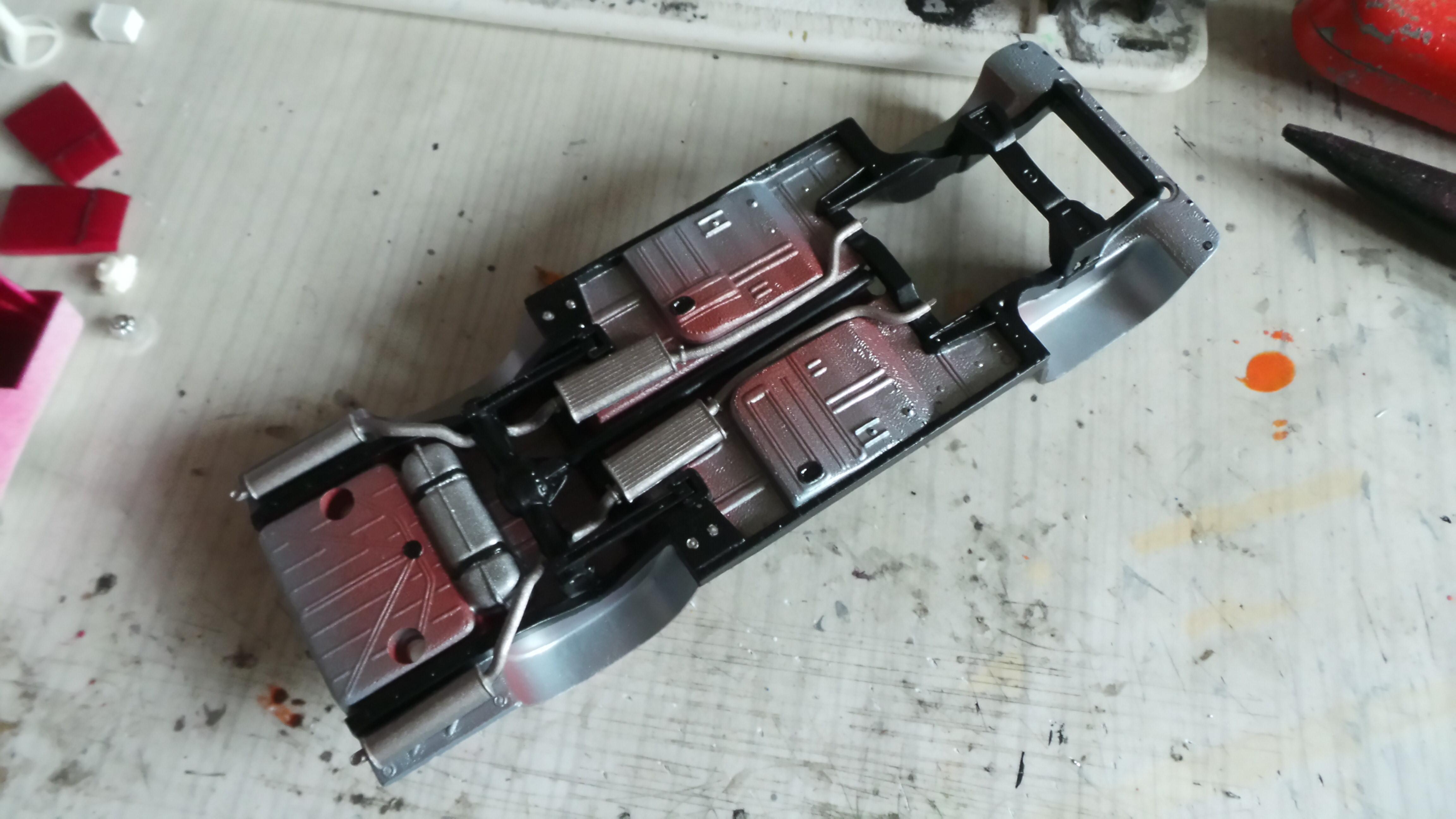

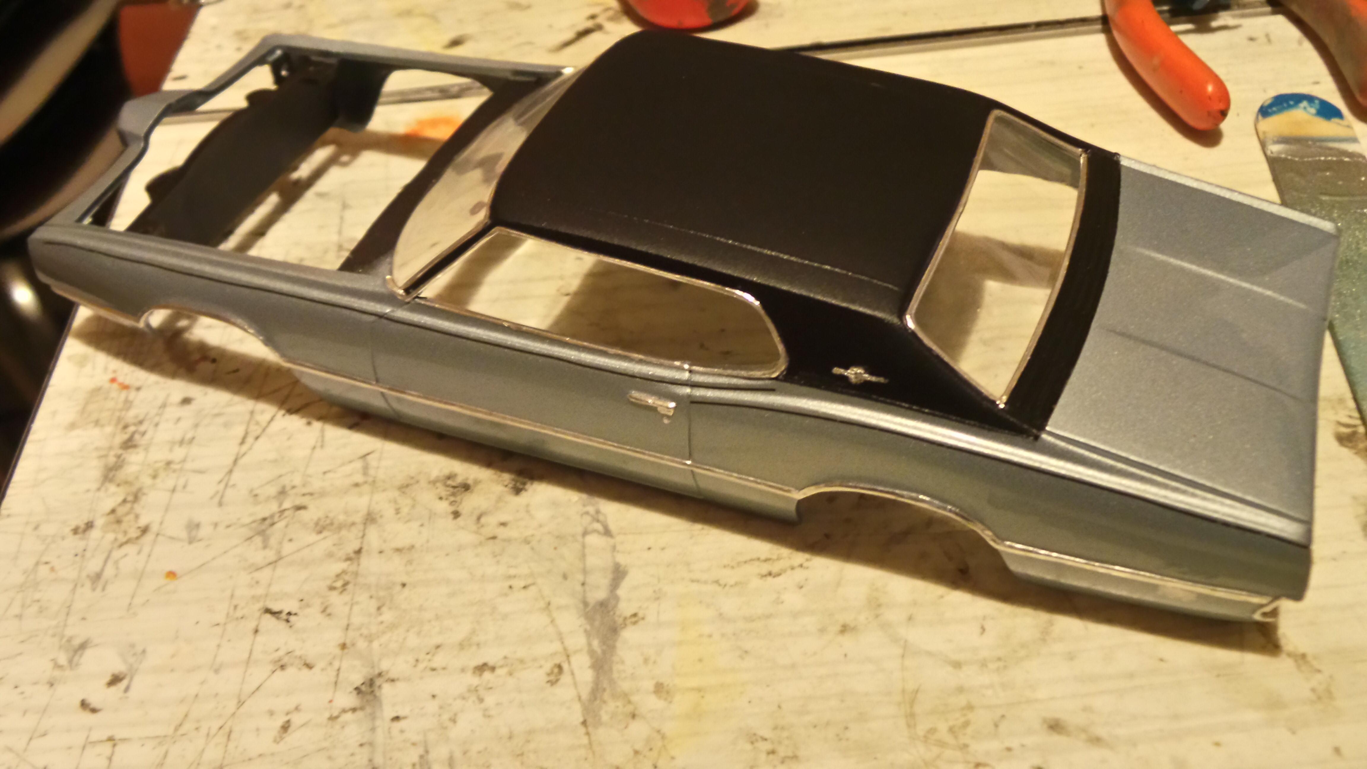

doorsovdoon Posted October 5, 2020 Author Posted October 5, 2020 Finished up the chassis and done the foiling today, I also gave the body a couple of coats of lacquer but it's so cold here now even the lacquer has a dull sheen. Not sure when or if we'll have a nice day again here until at least next year. My shed is way way down the end of the garden and no electric for a heater and the Mrs wouldn't be too happy if started spraying lacquer in the kitchen! so I'm not sure when I'm going to get this finished. aahh, so frustrating.

Spottedlaurel Posted October 5, 2020 Posted October 5, 2020 Looks like it's coming on well. Will the lacquer dullness polish out? I must admit with colder weather approaching I'm looking to get a few prepped and sprayed bodyshells done so I can fiddle away at the details in the winter.
doorsovdoon Posted October 5, 2020 Author Posted October 5, 2020 I am starting to get a bit more into this build now as I go along, it's probably the weather here to be honest. It's been a proper stereotypical UK weather week. Grey, dull, wet, and colder than my ex girlfriend's embrace, but I digress, The chassis give me a bit of a boost and my foiling seems to get better with each build, so other than the weather holding me back I'm enjoying the build. Yeah, the lacquer might polish up but I've only given it two light coats so can always give it another coat when warmer weather arrives.
David G. Posted October 5, 2020 Posted October 5, 2020 Looks good so far. I think the silver will go well with a black vinyl top, if that's your plan. David G.
doorsovdoon Posted October 5, 2020 Author Posted October 5, 2020 26 minutes ago, David G. said: Looks good so far. I think the silver will go well with a black vinyl top, if that's your plan. David G. Thanks, David. Yes, black vinyl roof. The car is actually blue but the light and my camera makes it look silver.
espo Posted October 5, 2020 Posted October 5, 2020 This T-Bird is looking much better with the paint and trim added. The last pictures you can start to see the blue cast to the color .
doorsovdoon Posted October 5, 2020 Author Posted October 5, 2020 5 hours ago, espo said: This T-Bird is looking much better with the paint and trim added. The last pictures you can start to see the blue cast to the color . Yes, it's definitely brightened it up, and the lacquer seemed to bring out the black pin stripes. You could hardly see them before.

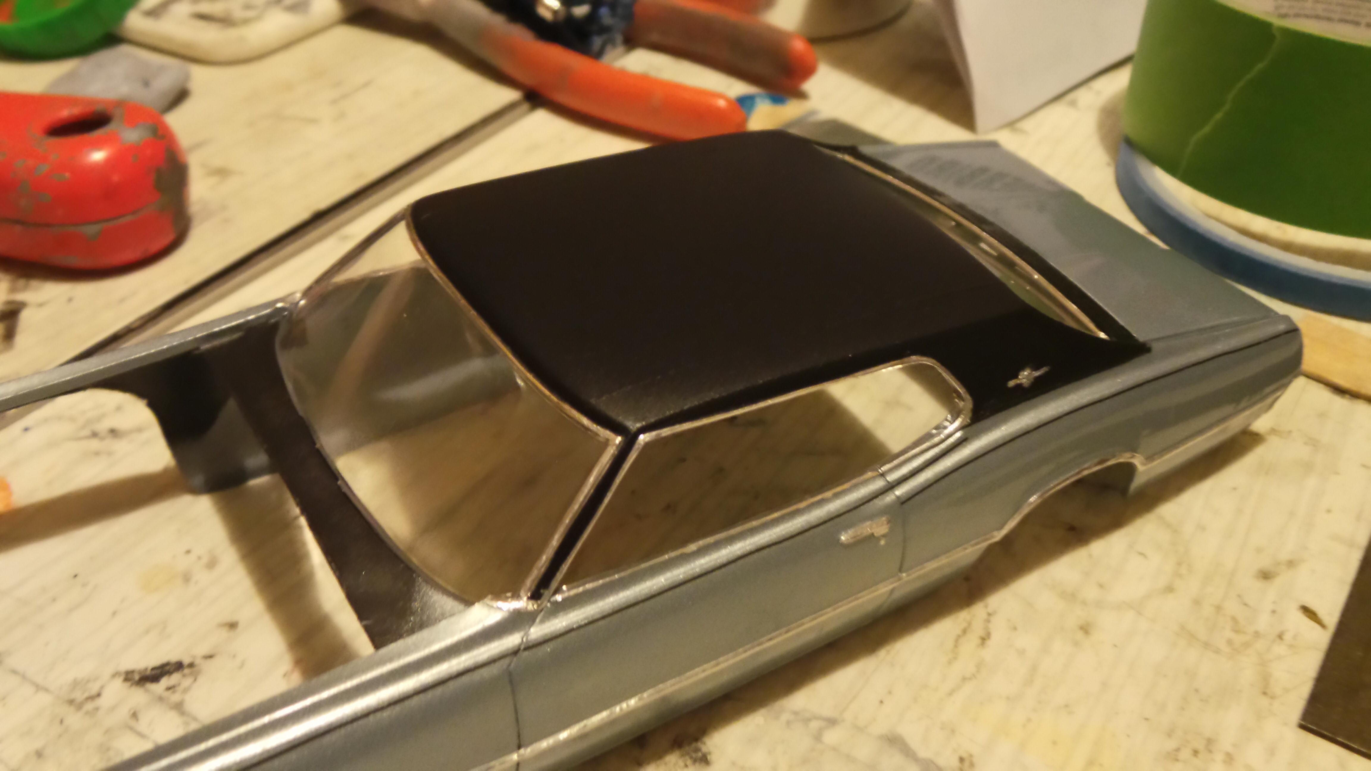

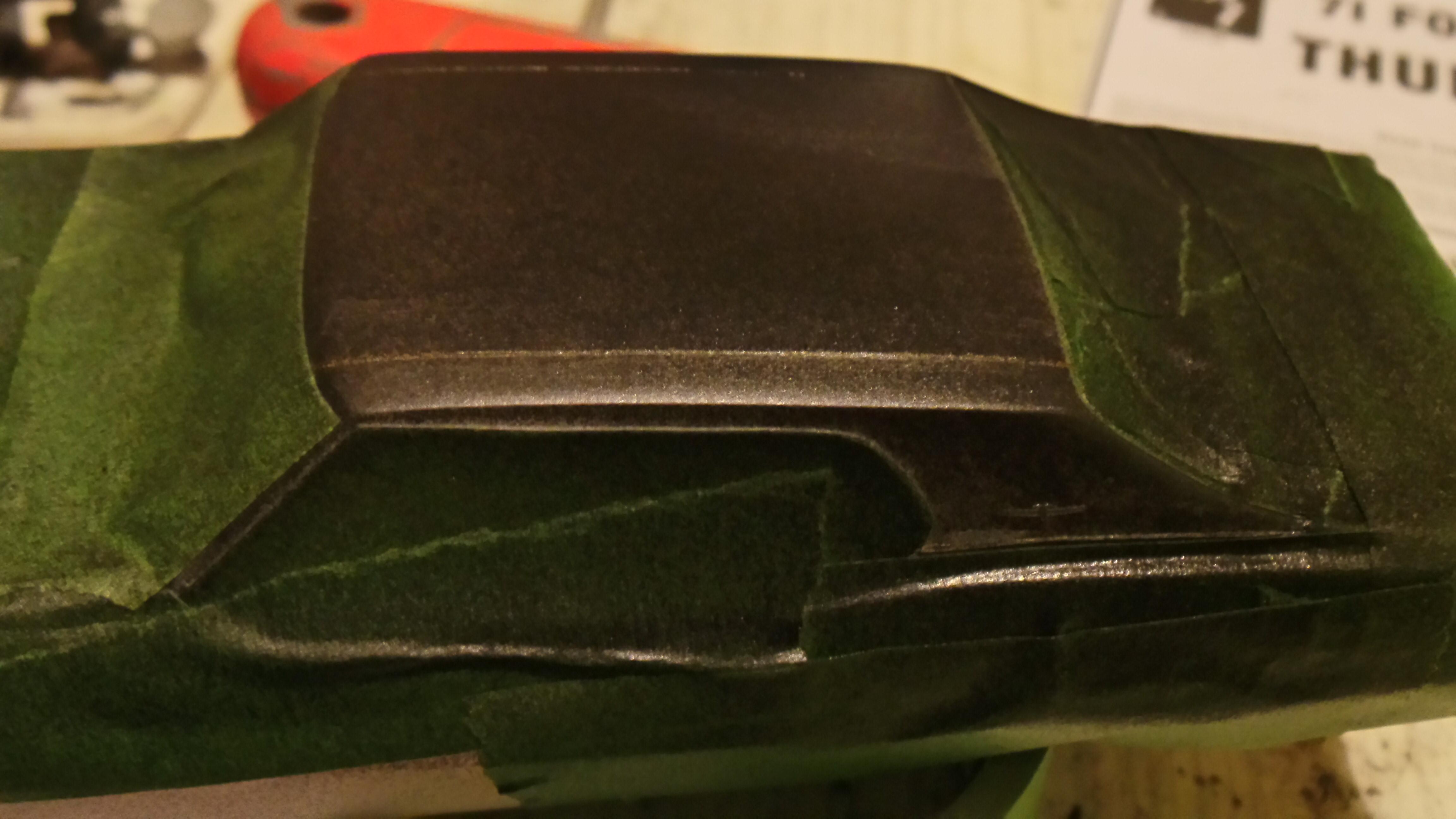

doorsovdoon Posted October 5, 2020 Author Posted October 5, 2020 (edited) I polished the Lacquer and the thing looks like glass! I thought I took a picture of it but it's not on my camera so I must have forgot, no matter, will be nice surprise when I remove the masking tape. Not to blow my own horn.. ok maybe a little, but it looks amazing! I can't wait to show you guys:) Now that the body is done, I've started on the roof. This is such a stressful part of the build, if I go too heavy or the can spits a snob the roof is ruined. Wish me luck! Edited October 5, 2020 by doorsovdoon

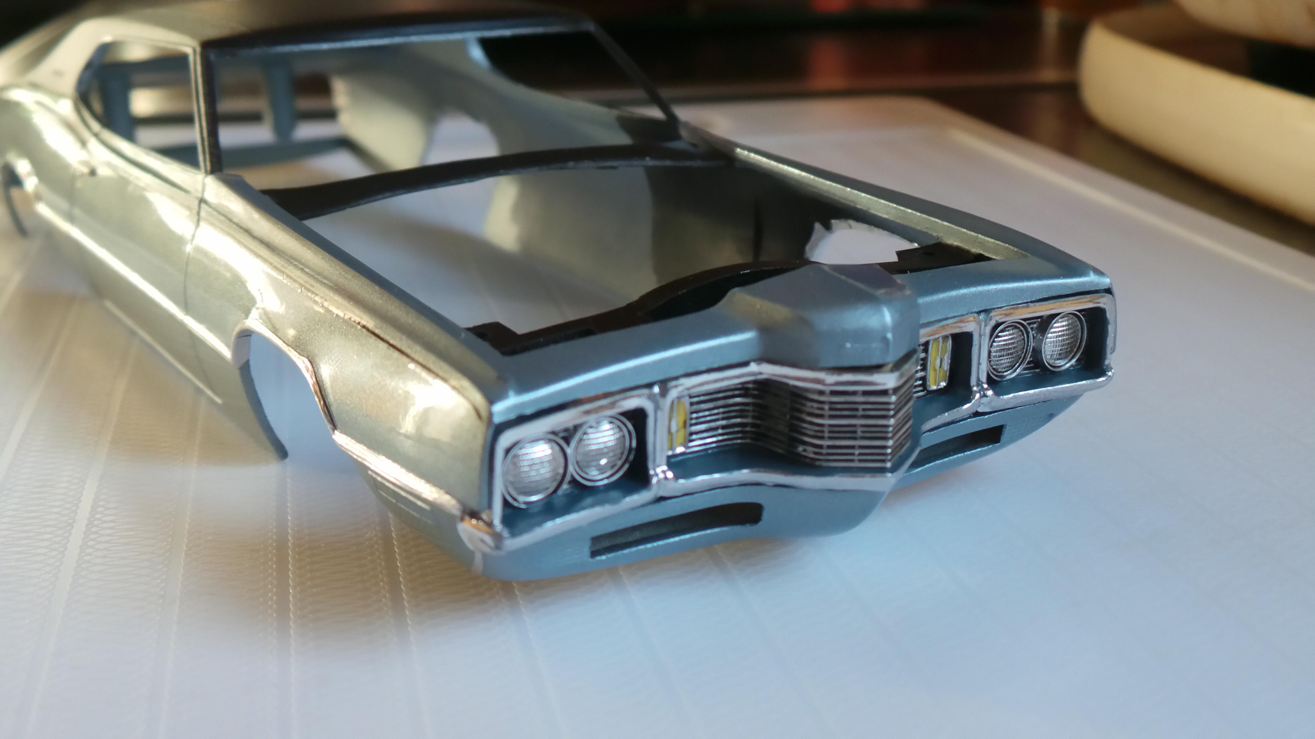

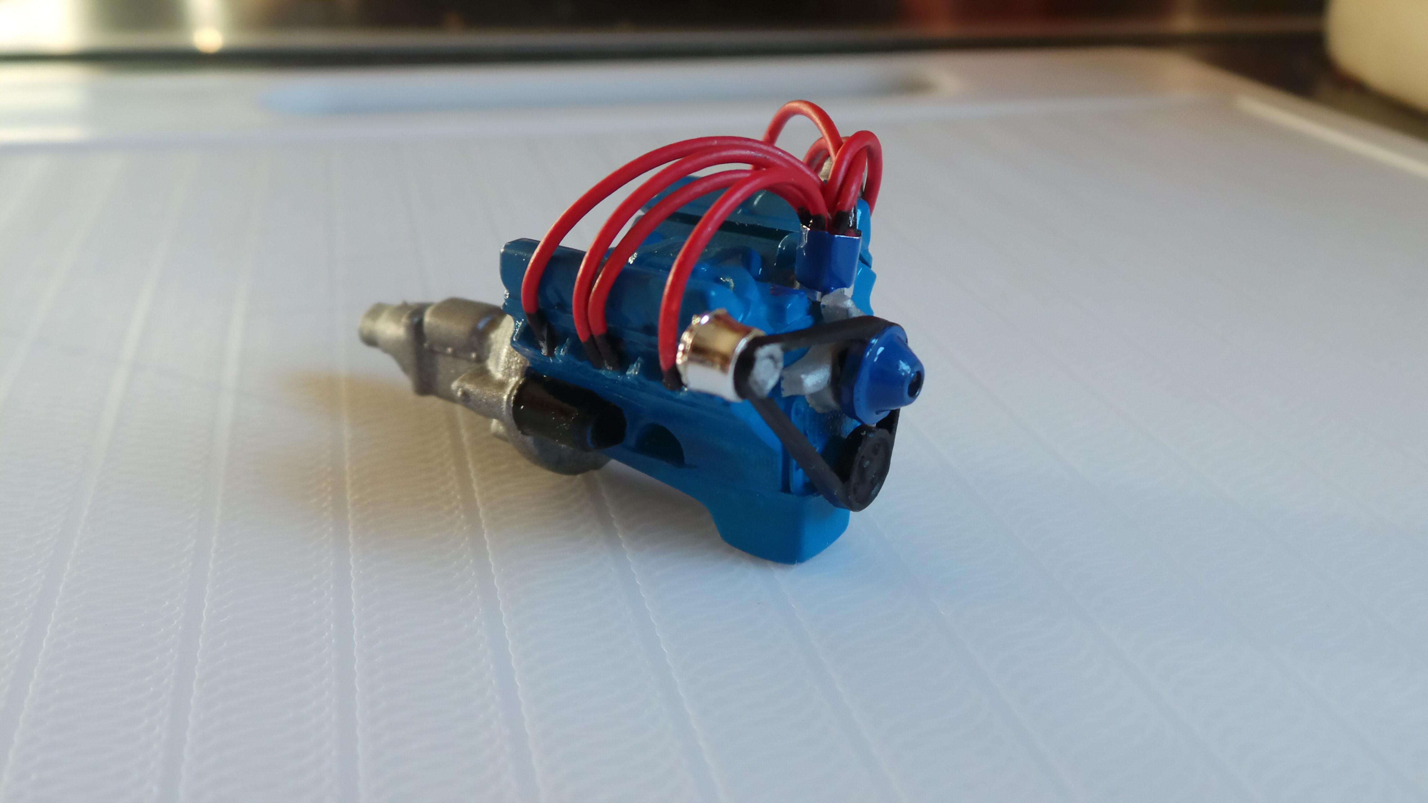

doorsovdoon Posted October 6, 2020 Author Posted October 6, 2020 (edited) Roof is done and the body polished up, it looks amazing and I haven't even done the gutter foiling or window frames yet! Looking through photos of this car on Google I see the front grill and headlight bezels are usually painted, either body colour or grey, seeing as I'm going the extra mile with this build I painted in the bezels instead of just leaving them chrome. I also done my first engine wiring job and now realise what I was missing out on on my previous builds, it looks so much better with plug wires! Not bad for my first attempt:D Ohh yes, there's a very smug Welshman on the forum today, you better believe it! xD haha! Edited October 7, 2020 by doorsovdoon
RichCostello Posted October 6, 2020 Posted October 6, 2020 Your T-bird looks great, but your plug wires are just like me.......way too fat. Those would make good heater hoses.
doorsovdoon Posted October 6, 2020 Author Posted October 6, 2020 42 minutes ago, RichCostello said: Your T-bird looks great, but your plug wires are just like me.......way too fat. Those would make good heater hoses. Thanks, Richard. Yeah, they do look like water hoses! xD It's old telephone wire I had hanging around, being I've never done it before I thought I'd try it and if I messed it up it's just old wire. Problem now is, I'll want to do this to every build now, haha!

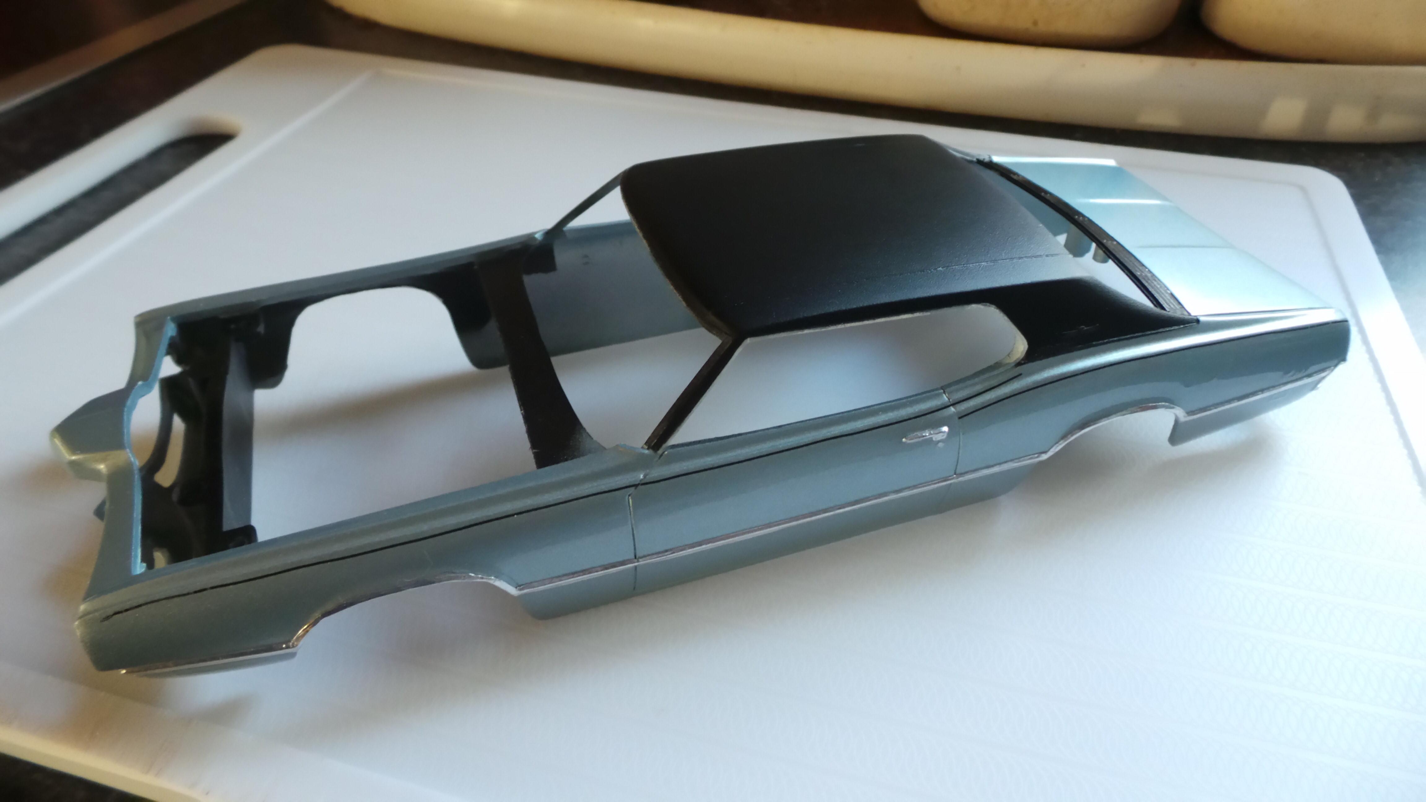

doorsovdoon Posted October 6, 2020 Author Posted October 6, 2020 Finished the body, just need to do some detailing of the name scripts and side markers.
