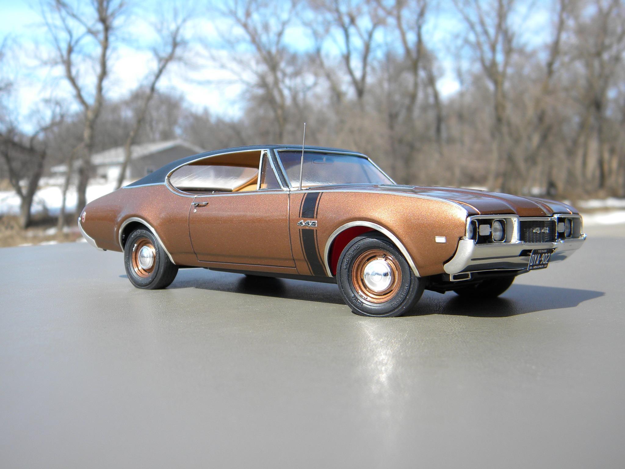

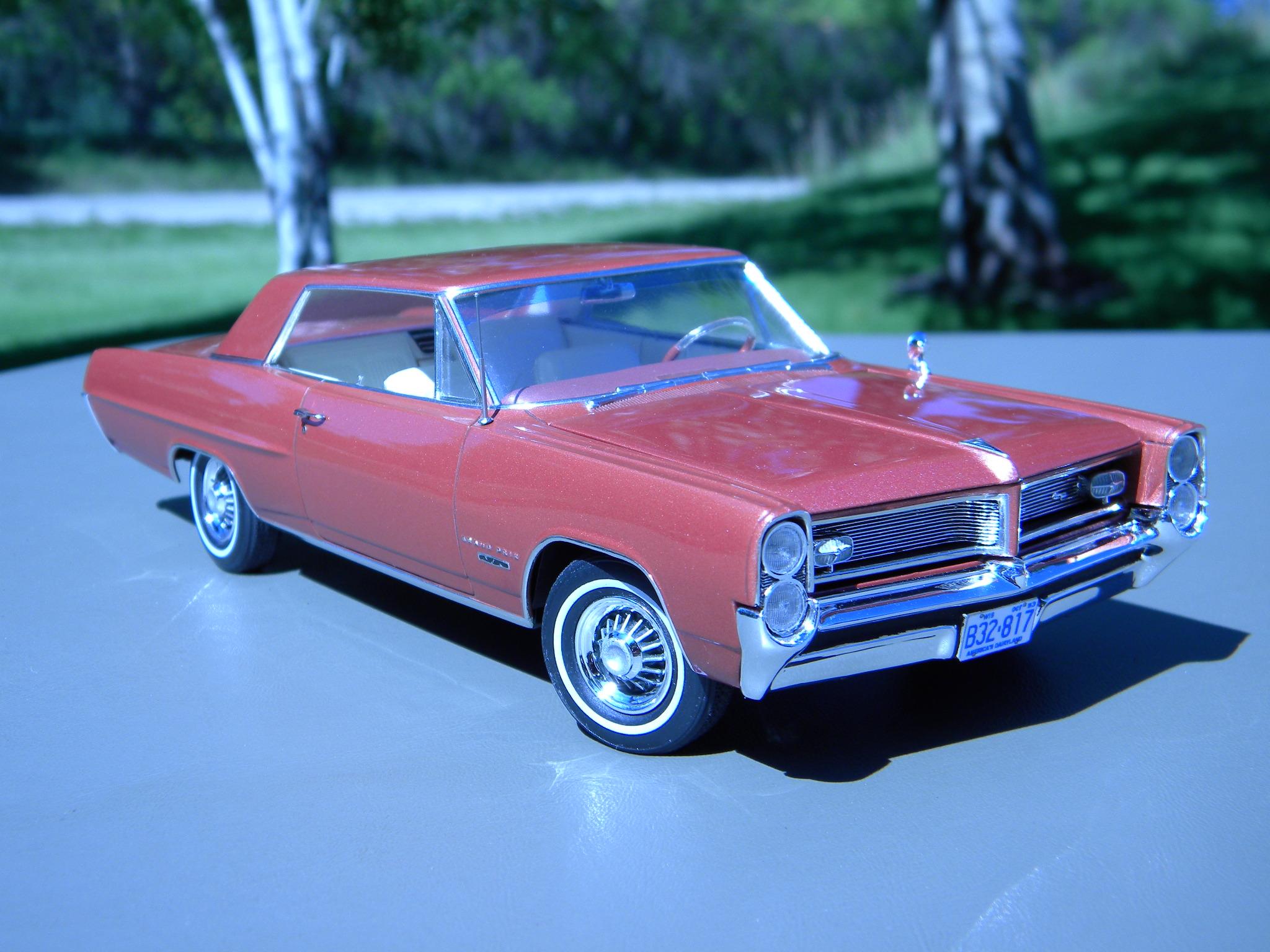

StevenGuthmiller Posted November 2, 2020 Posted November 2, 2020 As far as the size of metallic particles in Scale Finishes paint is concerned, my assertion would be that it's not quite s good as MCW, but better than most automotive or hobby paints. Both of these models wear Scale Finishes "base coat" paints with Duplicolor acrylic lacquer clear coat. Steve
