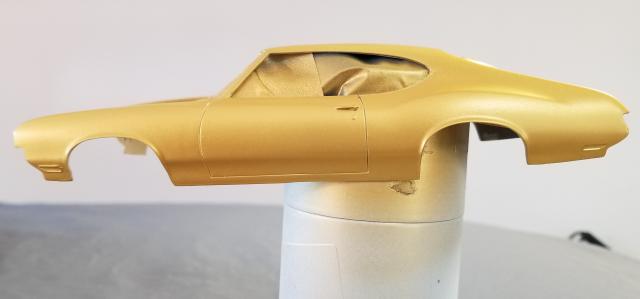

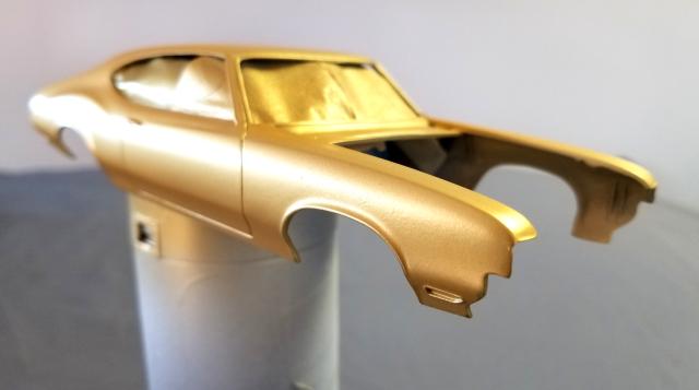

TransAmMike Posted November 18, 2020 Author Posted November 18, 2020 Bit the bullet today and mixed up the Createx gold. Used the 4012 and 4300 mixed I guess close to as recommended. Started with the #3 tip and wasn't getting a lot of flow so went to the #5 and it worked a lot better. I'm not saying I didn't have some glitches that I had to deal with upon the first spraying (bubble, too heavy on high spots) but overall It came out I suppose OK. The pictures were taken about 20 minutes after my last coat. I't did dry out a bit smoother after some time and I'm guessing clearing will make a difference too. The hood will need to be redone, had some scratches from sanding that are way too obvious. Anyway, since you guys that have been following and helping (thanks again by the way) know I am a real novice at air brushing I likely will stick to rattle cans or I may try spraying enamel like scale finishes or MCW.
Dave G. Posted November 18, 2020 Posted November 18, 2020 (edited) Lookin good in terms of lay down from here Mike ! What are you clear coating with ? If you want to mess with airbrushing enamels try some tests on spoons using Testors enamels from the little square bottles mixed just short of 50/50 with hardware store lacquer thinner.I think you will be surprised at how well that goes down. Edited November 18, 2020 by Dave G.
TransAmMike Posted November 19, 2020 Author Posted November 19, 2020 Thanks Dave. I'm open to suggestions for clear, I do have an old bottle of Future. And another question.......can/should the Createx I have sprayed be sanded to smooth out any light roughness or small imperfections??
Dave G. Posted November 19, 2020 Posted November 19, 2020 On 11/19/2020 at 1:15 AM, TransAmMike said: Thanks Dave. I'm open to suggestions for clear, I do have an old bottle of Future. And another question.......can/should the Createx I have sprayed be sanded to smooth out any light roughness or small imperfections?? Expand Both your questions are best answered in a spoon test before applying to your model ( will Future make me happy, can I sand this stuff). With that said, in my own painting I use steel wool to smooth fuzzy areas of base color coats but I don't use Createx. And I use Future in tests to see how clear looks over a color but on models I use Tamiya X-22 or clear lacquer. There is just something about putting something on a car model that's meant to be a temporary floor finish that bugs me. But that's me, many people do it and are happy I guess. Somehow I have this vision that 5 years down the road the future starts peeling. I have no evidence of this but my imagination is vivid in this area. Createx to my knowledge isn't known for it's good sandability qualities fwiw.
Kit Basher Posted November 19, 2020 Posted November 19, 2020 On 11/19/2020 at 1:15 AM, TransAmMike said: Thanks Dave. I'm open to suggestions for clear, I do have an old bottle of Future. And another question.......can/should the Createx I have sprayed be sanded to smooth out any light roughness or small imperfections?? Expand Auto Air can be dry sanded, I'm guessing Createx can too. If you sand it you will probably lose your pearl effect though. I sometimes sand the next to last coat, and then give one more light coat of paint. Even if you don't sand, you can clear coat and then polish the clear to a smooth finish. It looks good, but if you look closely you can kinda see the roughness of the paint under the clear, if that makes any sense. Your paint job looks good to me. Unless it's more trouble than it's worth, don't give up on this paint. It looks like you're getting the hang of it.
TransAmMike Posted November 19, 2020 Author Posted November 19, 2020 Didn't think about testing the sanding on a spoon duh!! IMO, the finish I got is just slightly rough to the touch and there is 1 or 2 specks of "trash" that should probably be removed. I guess I'm more concerned about the specks. As far as the clear, it sounds like you really like the Tamiya Dave. My thing is I like to not have to order stuff on line unless I absolutely have to. Hobbylobby (my go to place) doesn't carry Tamiya. So ModelMaster or maybe Duplicolor from auto part store.

Cornpatch Posted November 19, 2020 Posted November 19, 2020 I use Createx and Auto Air Paints all the time for several reasons, one being the many different colors they have. Another being that I can spray them in the basement without stinking up the whole house. When they need thinning I use water and or windshield washer fluid and have never had any problem with them. I spray between 25 and 30 PSI with a #5 needle in a single action Paasche H Air brush. Which works just fine for me. Sometimes I use a brush where I have to or need to. As far as sanding I never do it, I use a #0000 steel wool which leaves a nice smooth finish for the next coat. It is a little messier and you have to wash and dry the car after steel wooling it. but by not sanding I leave no possible scratches in the paint and no possibity of sanding off the emblems. Since there is no time limit on applying the next coat I have time to do this. If in a hurry you can dry the car and then dry the paint with a hair dryer, wife gets PO but that's normal. For finishing I use either Createx Clear or Rust-Oleum 2X Clear and find that these 2 work pretty darn good for me. Jeff

Venom Posted November 20, 2020 Posted November 20, 2020 On 11/19/2020 at 1:15 AM, TransAmMike said: Thanks Dave. I'm open to suggestions for clear, I do have an old bottle of Future. And another question.......can/should the Createx I have sprayed be sanded to smooth out any light roughness or small imperfections?? Expand I looked at your pics of the gold painted car body Mike. They aren’t the most clear pics, but from what I CAN see, I’d say it’s time to spray the Createx clear over it. Maybe do three to four coats and then wet sand it... The “flecks” could probably be popped off (before you clear it) with the tip of a #11 blade, and then filled in with paint with a fine detail brush... But if you are dissatisfied with the way the paint looks now, just take it to the sink and spray it down with lots of Windex and clean it with a toothbrush and repaint it. It’s surprizingly easy as long as you haven’t cleared it yet. I did that twice on the Cobra I posted on this thread before I decided to clear it. It also helped me learn the paints properties better. My opinion with the Createx is that all the sanding should be done AFTER clear... If it’s so rough that it needs sanded before clear, then something needs to improve with the spraying method/technique. In my experience, dry sanding the paint causes little balls of paint to form and roll around under the paper, and even when that doesn’t happen it seems to dull the paint in the sanded area and look blemished.
TransAmMike Posted November 20, 2020 Author Posted November 20, 2020 Thanks Josh, good suggestions. I actually don't think it's so bad it will need repainting. Really there is only 1 noticible speck and your're suggestion could work. So you think the Createx clear.
