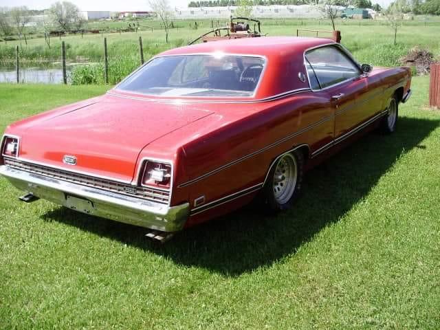

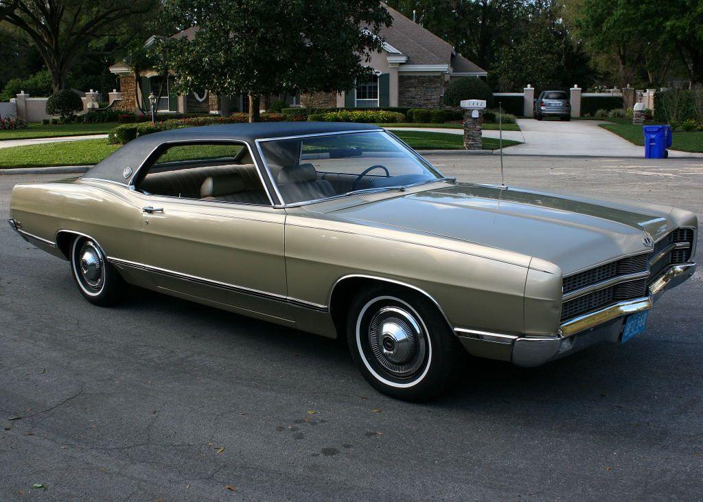

Rob Hall Posted November 3, 2020 Posted November 3, 2020 I'm in a Facebook group for '69-70 Fords, really like these cars..found a couple pics from there that may help..
Rodent Posted November 3, 2020 Posted November 3, 2020 There are a fair amount of pics online if you search for LTD instead. There is a YouTube walkaround video of a red LTD in Alberta but the perspective is wonky on my monitor. It makes the car look too short and the point on the rear window exaggerated.
Plowboy Posted November 4, 2020 Author Posted November 4, 2020 5 hours ago, Rob Hall said: I'm in a Facebook group for '69-70 Fords, really like these cars..found a couple pics from there that may help.. Thanx Rob! Those help! Is there any way one of them could measure from the top rear of the door to the corner of the quarter window? That would help a ton! Something else I noticed on the rear window is the top corners need to be rounded. If anyone sees anything wrong, please speak up! I won't get butt hurt over it! I'm not going for perfect. But, I want it to be pretty accurate as far as the body goes. I'm not going to sweat the interior much.
