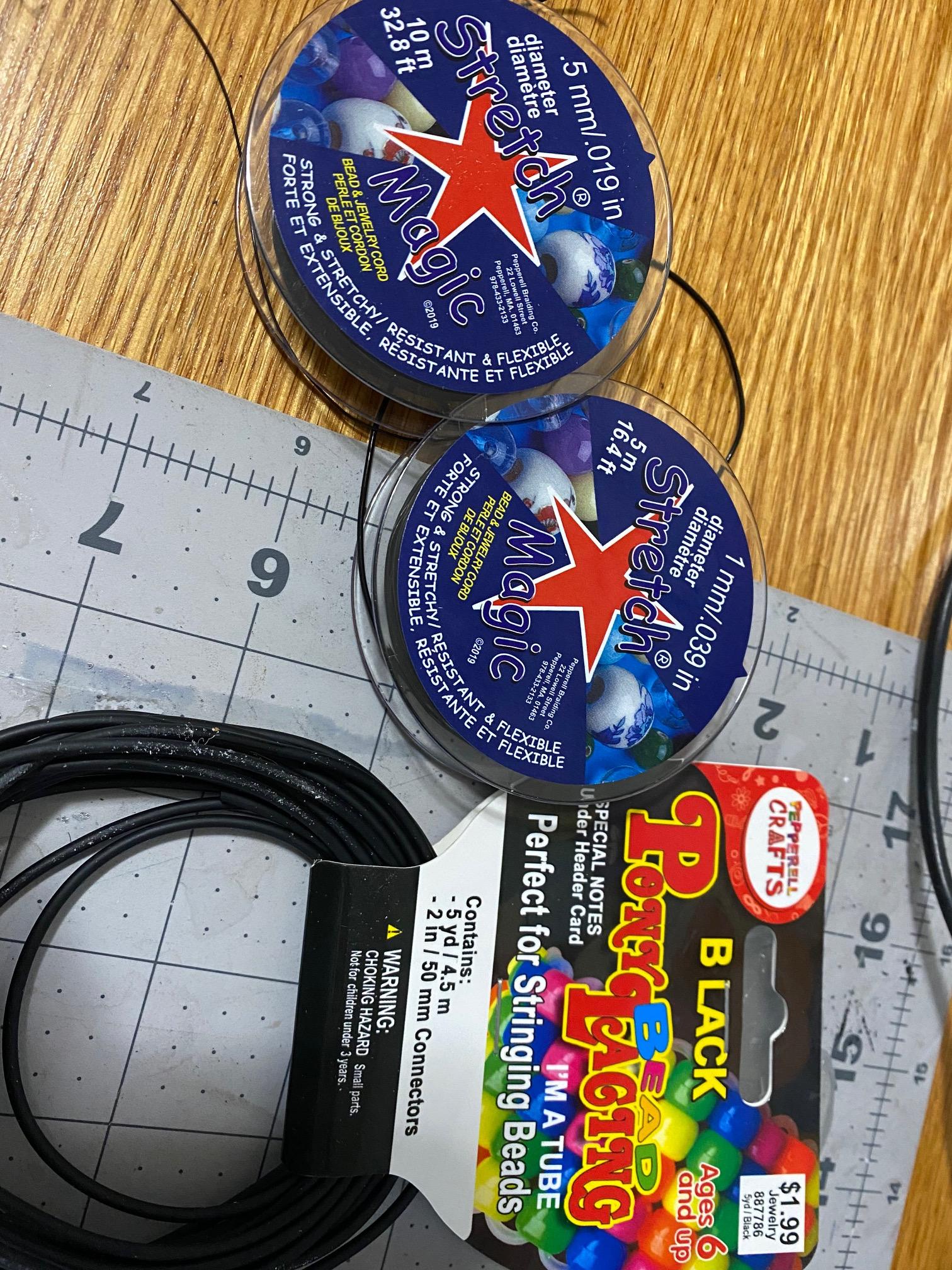

Oldmopars Posted November 4, 2020 Posted November 4, 2020 On a resent quest to work on things easier for my arthritic hands, I have gone to some larger scale stuff. 1/8th and 1/16. However when hunting down correct tube/wire to use for ignition wires, heater hoses, etc. it has open my eyes to how often we are way out of scale in these areas. To illustrate this, if you have a V8 engine and upgrade the spark plug wires, you look for 8mm wires. These are the better wires over stock, stock wires will be about 7mm or so. But, to make my point, lets assume that all cars we build have these high performance wires at 8mm. In 1/8th scale that would mean that the tube/wire we use needs to be 1mm (1:8x1mm=8mm in scale), so for 1/16th scale this would be .5mm (1:16x.5mm=8mm). Now, when we get to 1/24 or 1/25 this gets really small. 8mm/25 is only .32mm. In the picture below I found some tube at HL, .5mm, 1mm and about 2mm. They are on a quarter for scale. In my 1/16th scale T-Bird the tube that was included in the kit was at least 2mm, this would be 32mm in scale, or 1.3in. HUGE. What have you all found as correct scale wire or tubes?

Oldmopars Posted November 4, 2020 Author Posted November 4, 2020 The 1/16 T-Bird I am building has those huge tubes for wires in the kit. I took the tube, cut it into short lengths and and made spark plug boots, then put smaller wire inside. This did make it look more to scale, but I think it is till on the large size. I am doing an 1/8th scale Corvette right now and it has me really thinking about correct scale and sizes as I am adding a lot of extra details to it.
