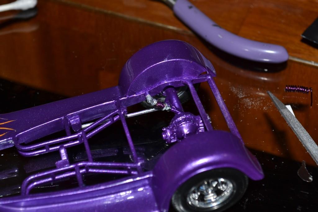

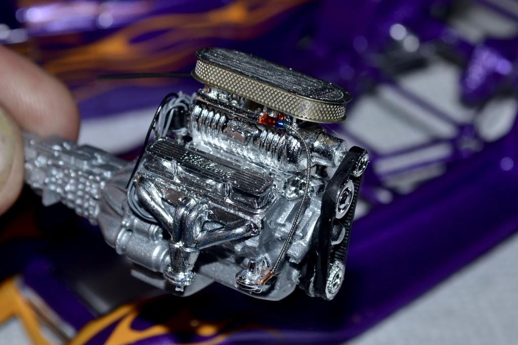

mrm Posted November 8, 2020 Posted November 8, 2020 (edited) Ok, another Deuce specific thread for all the Deuce Roadsters out there. Highboys, Lowboys, Fendered, stock or fully blown drag monsters. If it's based on a Deuce Roadster/Cabrio - IT FLIES! Show'em up guys! I am going to start it with a Bobby Alloway inspired Fendered Roadster. It sits on a scratch-bashed chassis, with Roadster rails and front cross member, half Phantom Vicky - half scratchbuilt rest of crossmembers. Quickchange with the center copied in resin by me from the Paddy Wagon and the rest of the rear axle and shocks scratchbuilt. Front axle is from the Roadster kit, together with the brakes, wheels and brakes. The Engine, transmission and blower are from the Rat Roaster. The dual carbs are from the parts box. Headers are from the Revell '37 Ford and the rest of the exhaust is scratch built from aluminum and solder. The valve covers and airfilter are mixed media resin/photoetched pieces from MCG. I believe they discontinued their SBC offerings. Everything was covered in Molotow chrome and fully plumbed and wired. Body has been modified with the cowl from the Phantom Vicky grafted and the windshield from the same kit. It needed some tweaking to sit properly over the 5-window fenders, especially since it is slightly channeled on its front. This required the grille shell to be sunk even more in the front fenders. The front grille had to be filled on the bottom, to look good behind the MCG photo etched grille, together with the scratchbuilt photo etched radiator. Interior is pretty much stock from the Roadster kit, save for the MCG photo etched gauges, steering wheel, pedals and the detail master photo etched seatbelts. Paint is waterbase Createx from Hobby Lobby, with 2K midcoat and then the flames were free hand cut with exacto knife over BMF on the model, followed by Tamiya white, yellow and two oranges. Everything was topped by more 2K clear, sanded even and cleared again. Technically the model is not 100% finished, as it still needs taillights, licence plate and some minor details. Edited November 8, 2020 by mrm 3

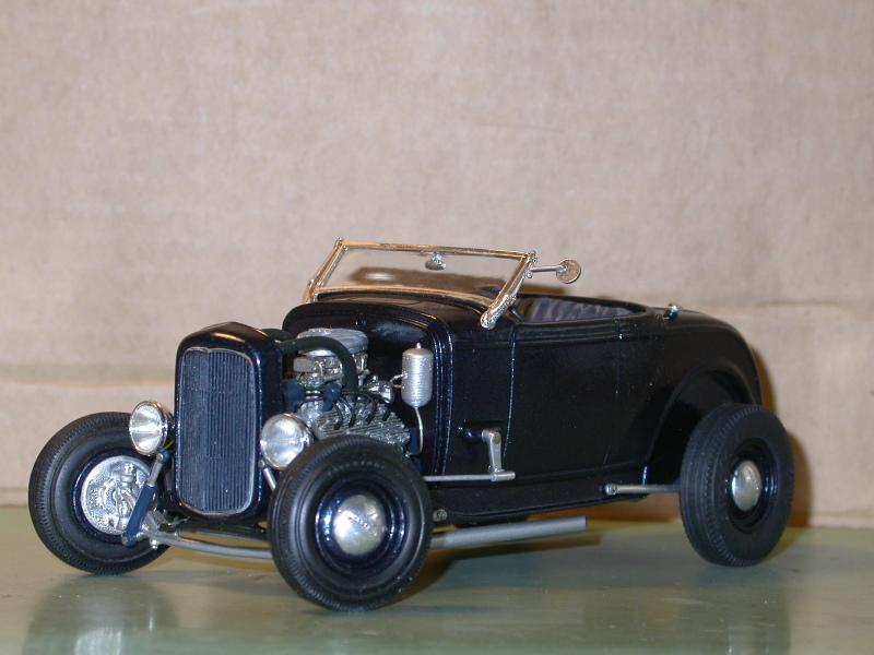

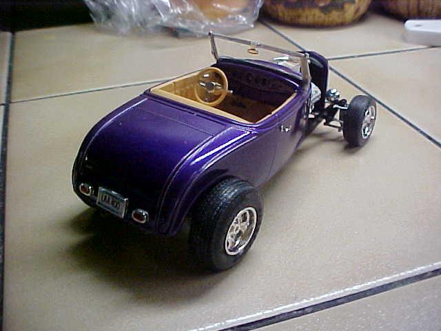

Quiet Eric Posted November 8, 2020 Posted November 8, 2020 Very Alloway looking, really neat roadster. Here's a couple I've done over the years. This one from the Revell kit. I couldn't tell you where a lot of the parts came from that are on it, and don't think it had an engine in it. This Big Deuce has looked like this for a solid 10-12 years. One day I'll finish it. 4
mrm Posted November 8, 2020 Author Posted November 8, 2020 That Roadster is pretty cool Eric, engine or no engine. The color looks very much like Ferrari's Blue Pozzi. Looking black most of the time but very obviously blue under certain light. And I definitely hear you on the big Deuce. I have some projects that are in some box in a bigger box, somewhere in the garage and have not seen light in over a decade.

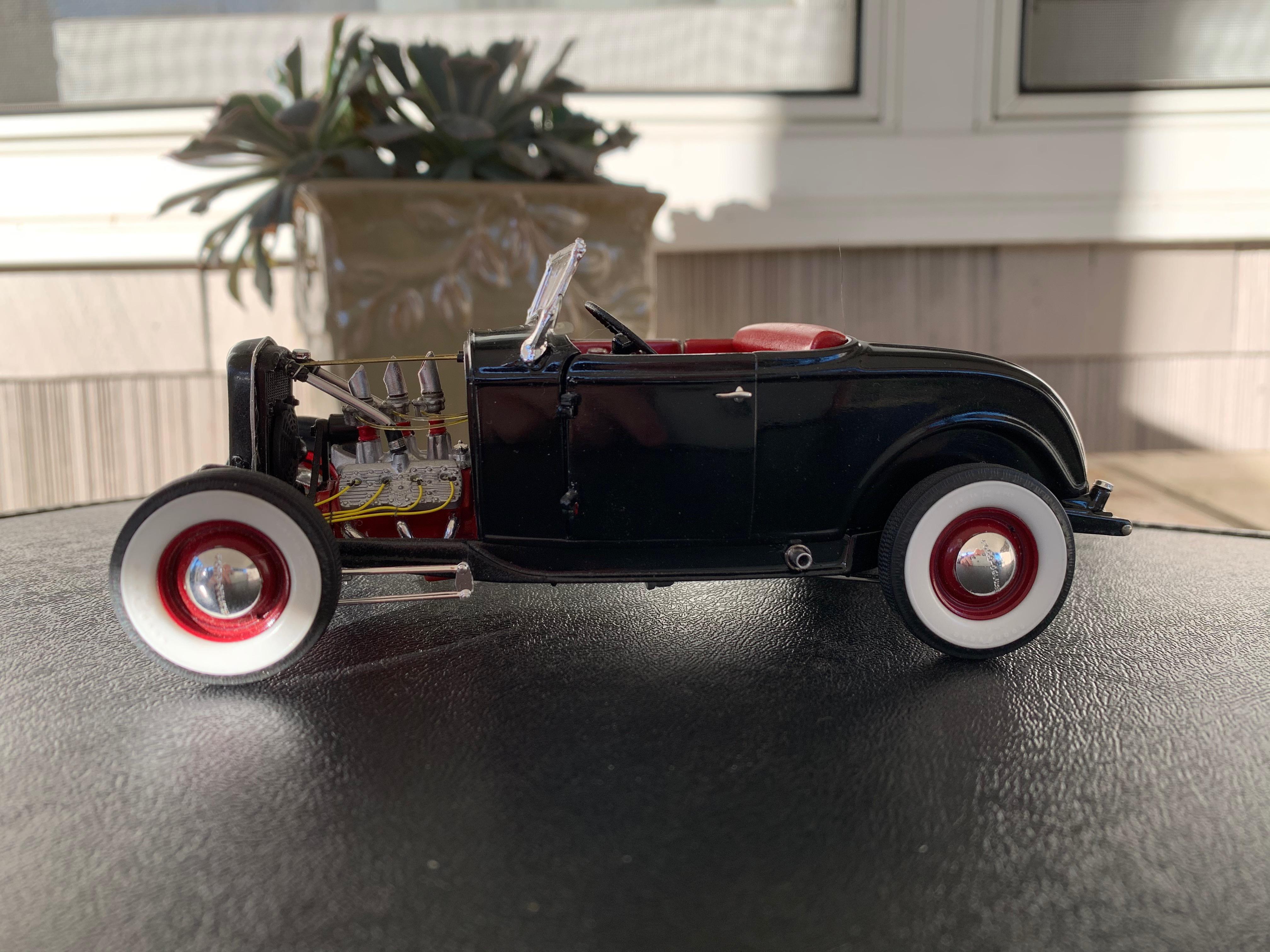

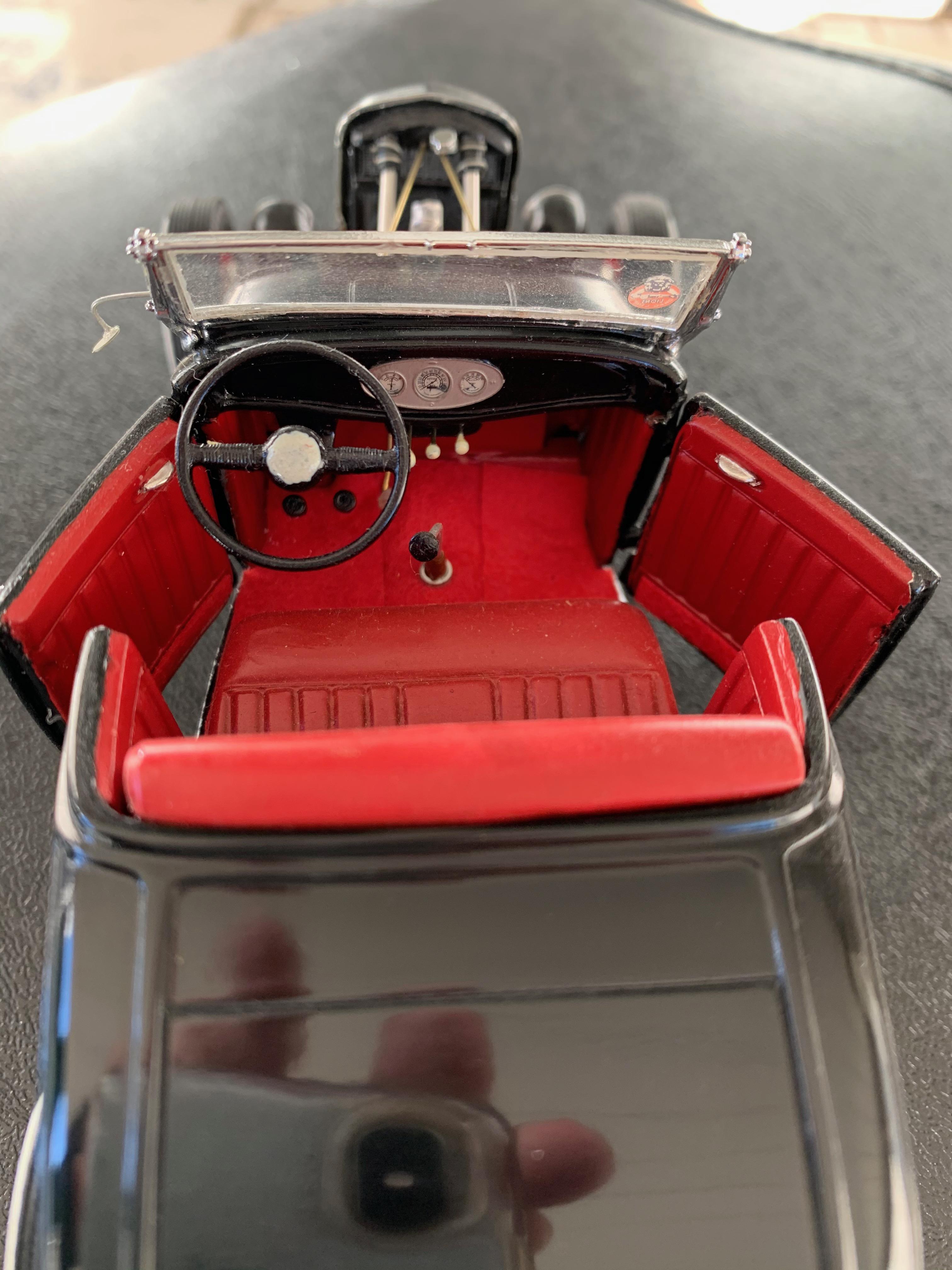

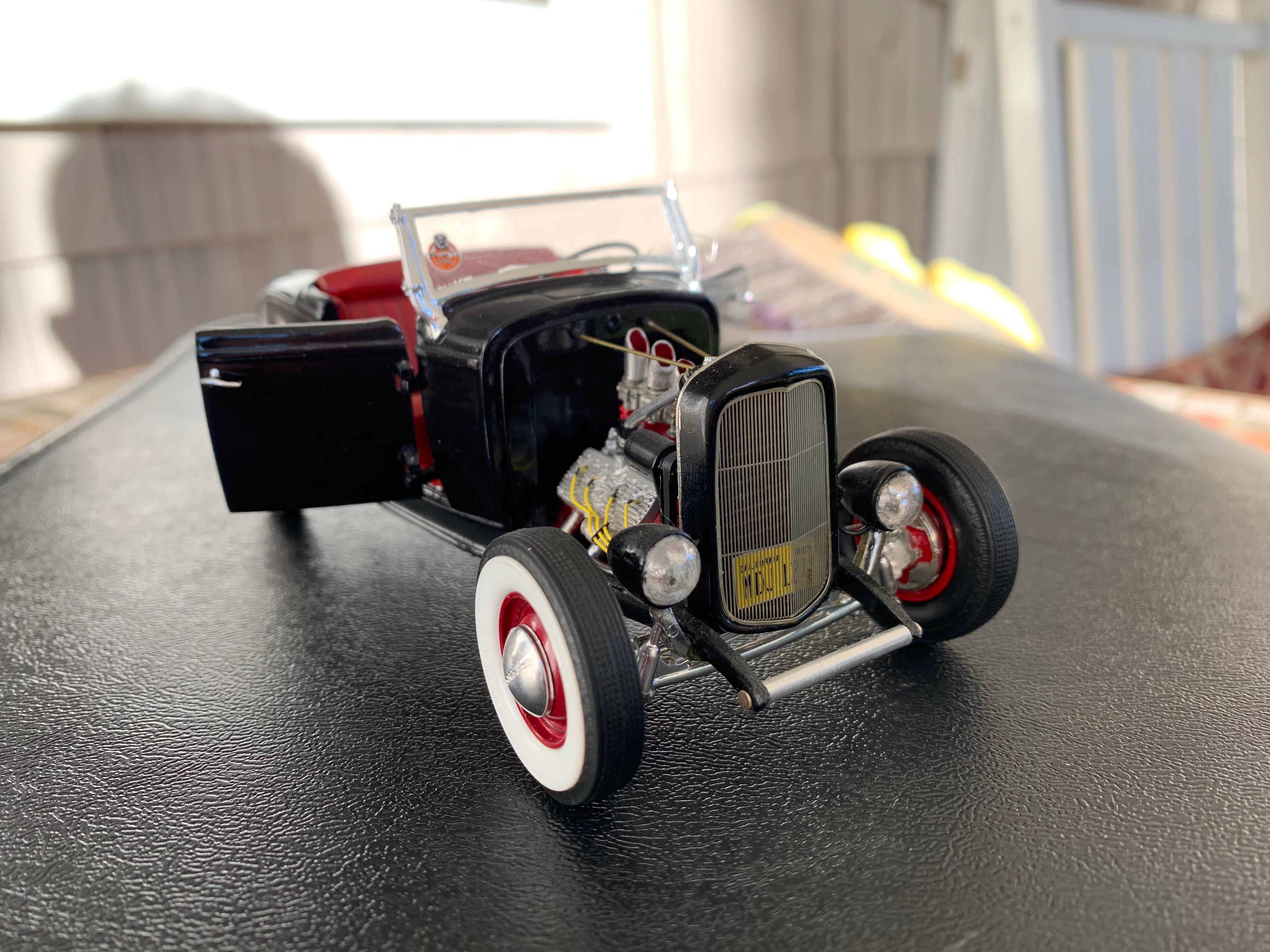

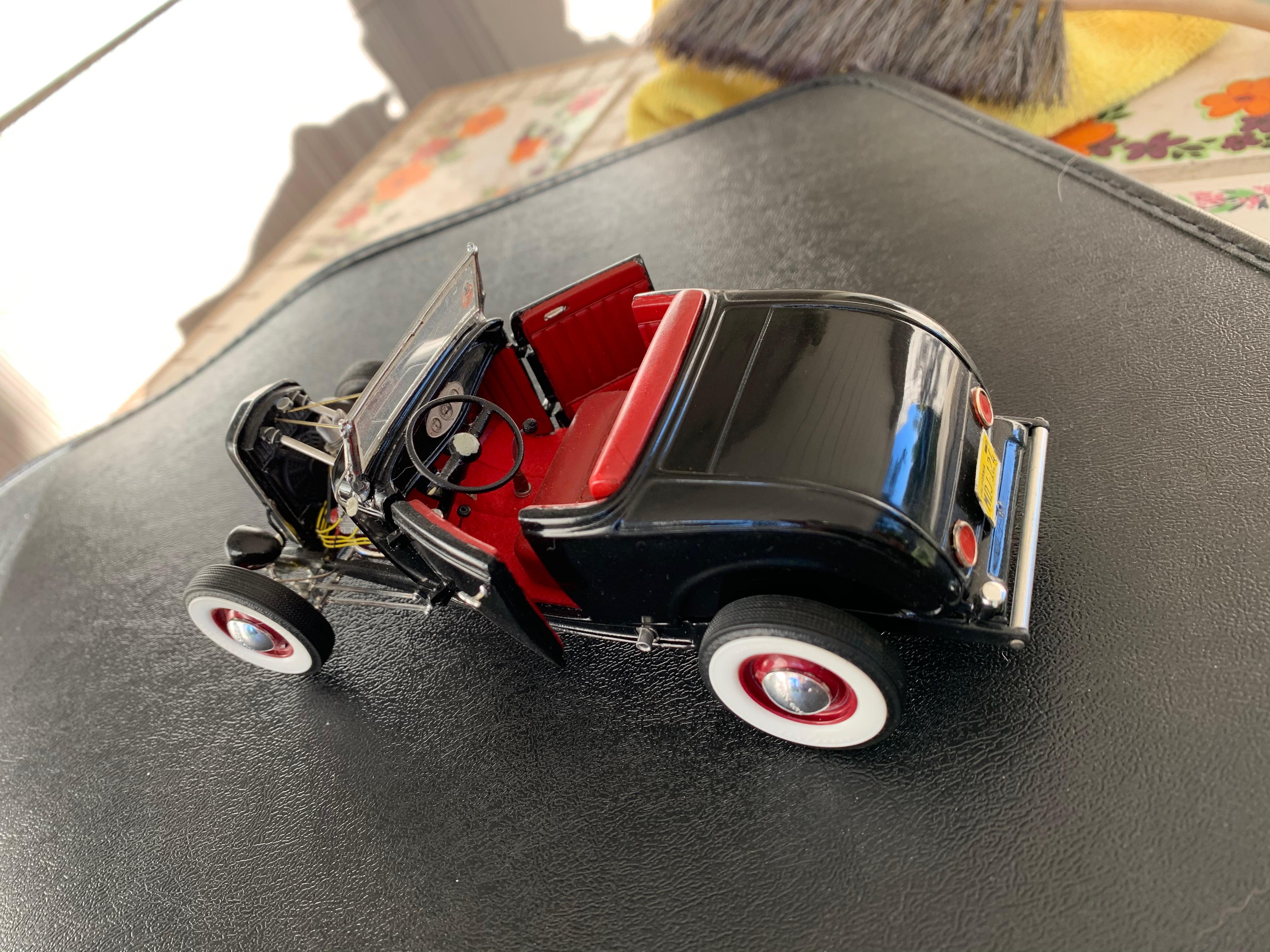

Watertown Posted November 8, 2020 Posted November 8, 2020 (edited) This is a build from about 15 years ago. Engine, wheels and tires from Revell '40 Ford Convert, MCG photo-etch grill and gauges. aluminum tubing exhaust routed through the frame. Other details include plumbed brake lines, fuel lines, and various hoses. Doors cut open and hinged. Edited November 8, 2020 by Watertown 3
mrm Posted November 8, 2020 Author Posted November 8, 2020 Great classic roadster Mike. I love the knobs on the dash. Little details like that make all the difference.
Watertown Posted November 8, 2020 Posted November 8, 2020 6 minutes ago, mrm said: Great classic roadster Mike. I love the knobs on the dash. Little details like that make all the difference. Thanks. Loving your much more contemporary take on this kit. I wish Revell had considered offering stock versions of these kits.

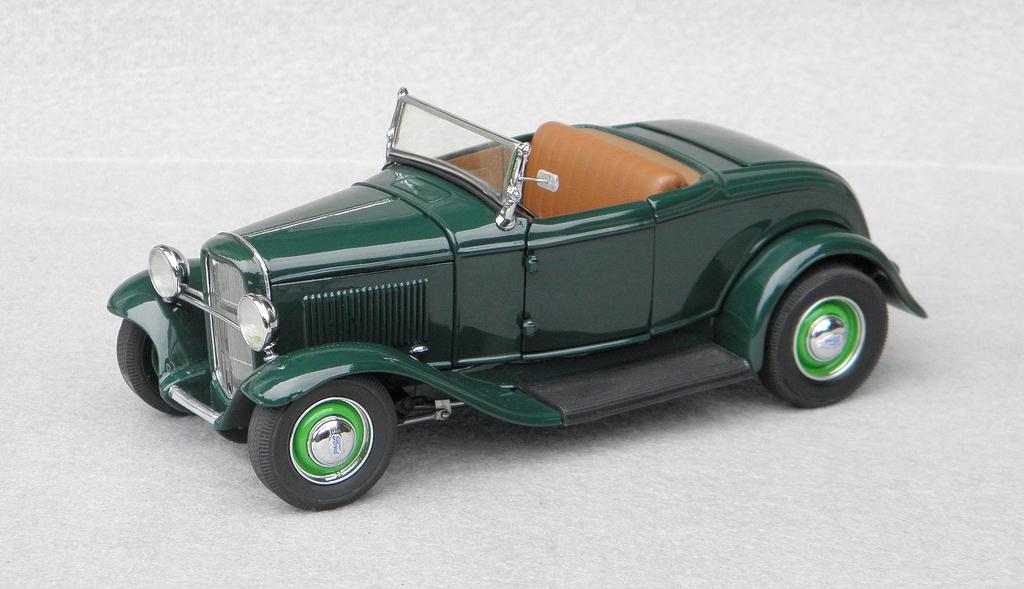

Bernard Kron Posted November 9, 2020 Posted November 9, 2020 Now, if I've built far too many Deuces in general, I've really built too many roadsters. Here are a some pics each of a few (all Revell 1/25th): This is my most recent completion from a few months back - Classic black flathead powered highboy: Full fendered: Bare metal Hemi powered highboy: Candy apple lo-boy: 3

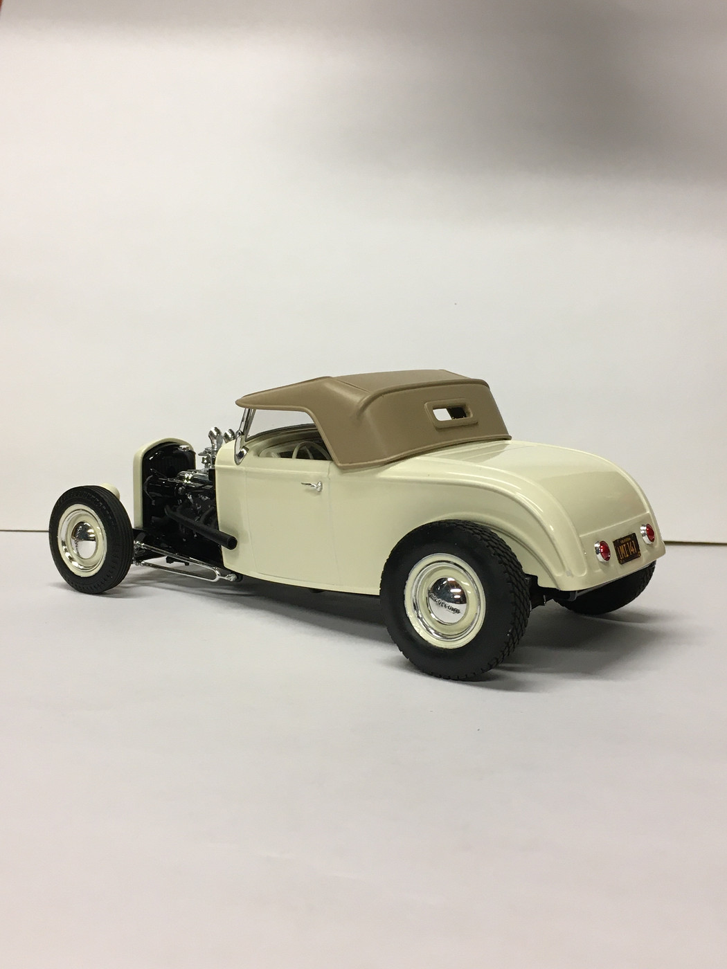

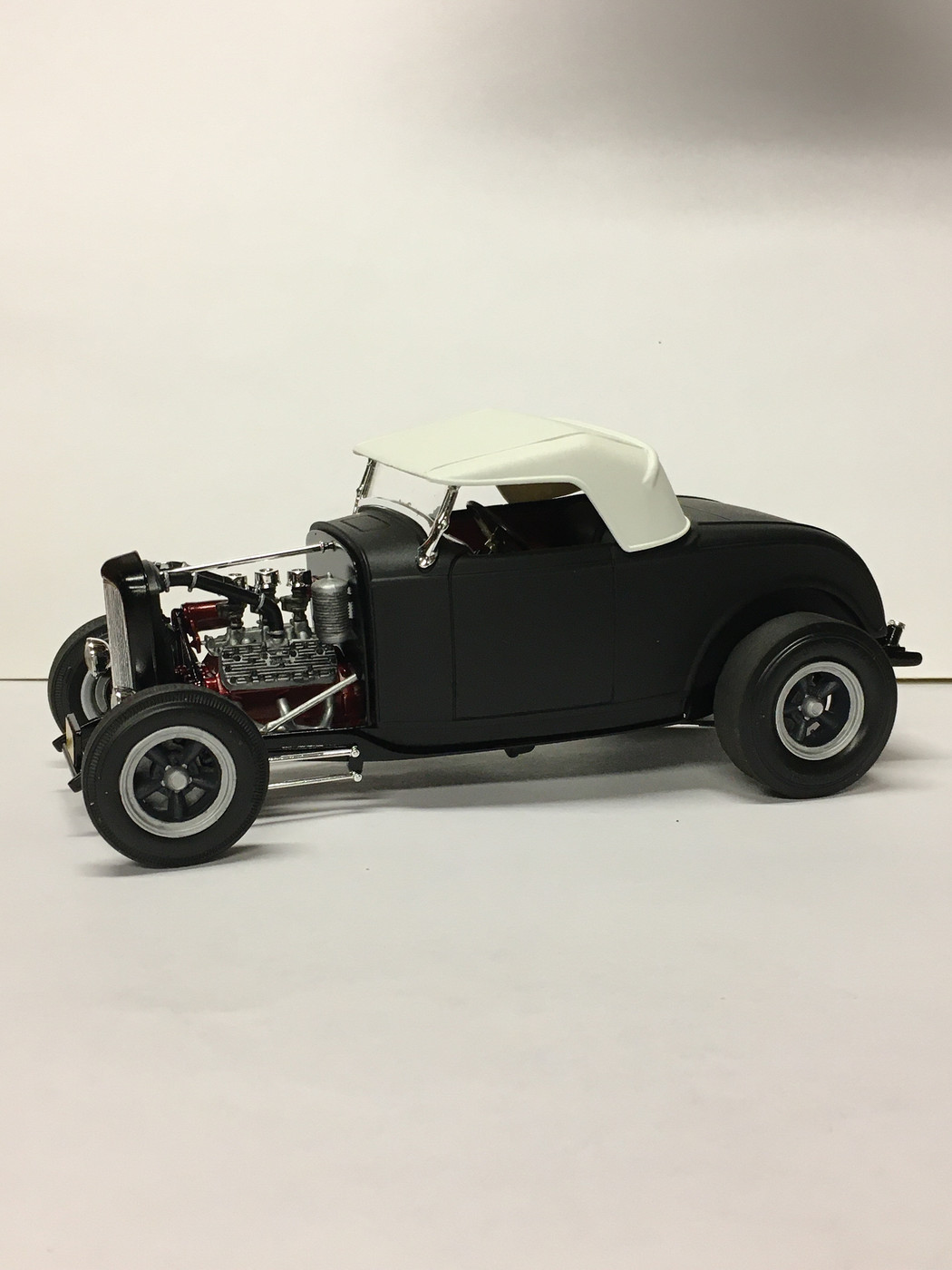

Dennis Lacy Posted November 11, 2020 Posted November 11, 2020 @mrm I love your flamed roadster. As Eric said, it looks like it could be straight out of Alloway's shop! Here's my Roadster contributions. Revell Rat Roaster body channeled over 5-Window chassis. Chassis back-dated with Revell '40 Ford cross members and rear axle. Heavily kit-bashed Buick "Nailhead" with early Ford 3-speed trans. Revell '29 Roadster wheels, tires and finned brake drums. Modified Monogram '30 Phaeton seat and side panels with Revell '40 dash, column and wheel. Tamiya Racing White paint. Resin stylized roadster top from Drag City Casting which I created the master for. Revell '32 HiBoy Roadster with their '32 Sedan Flathead engine and 5-spoke American's. Interior made to look like a work in progress with unfinished upholstery, Revell '40 dash and AMT '40 Ford seat. Resin stylized roadster top by Drag City Casting which I created the master for. Tamiya Flat and Gloss Black. This model was built 10 years ago and intended to look like an unfinished driver. 4
