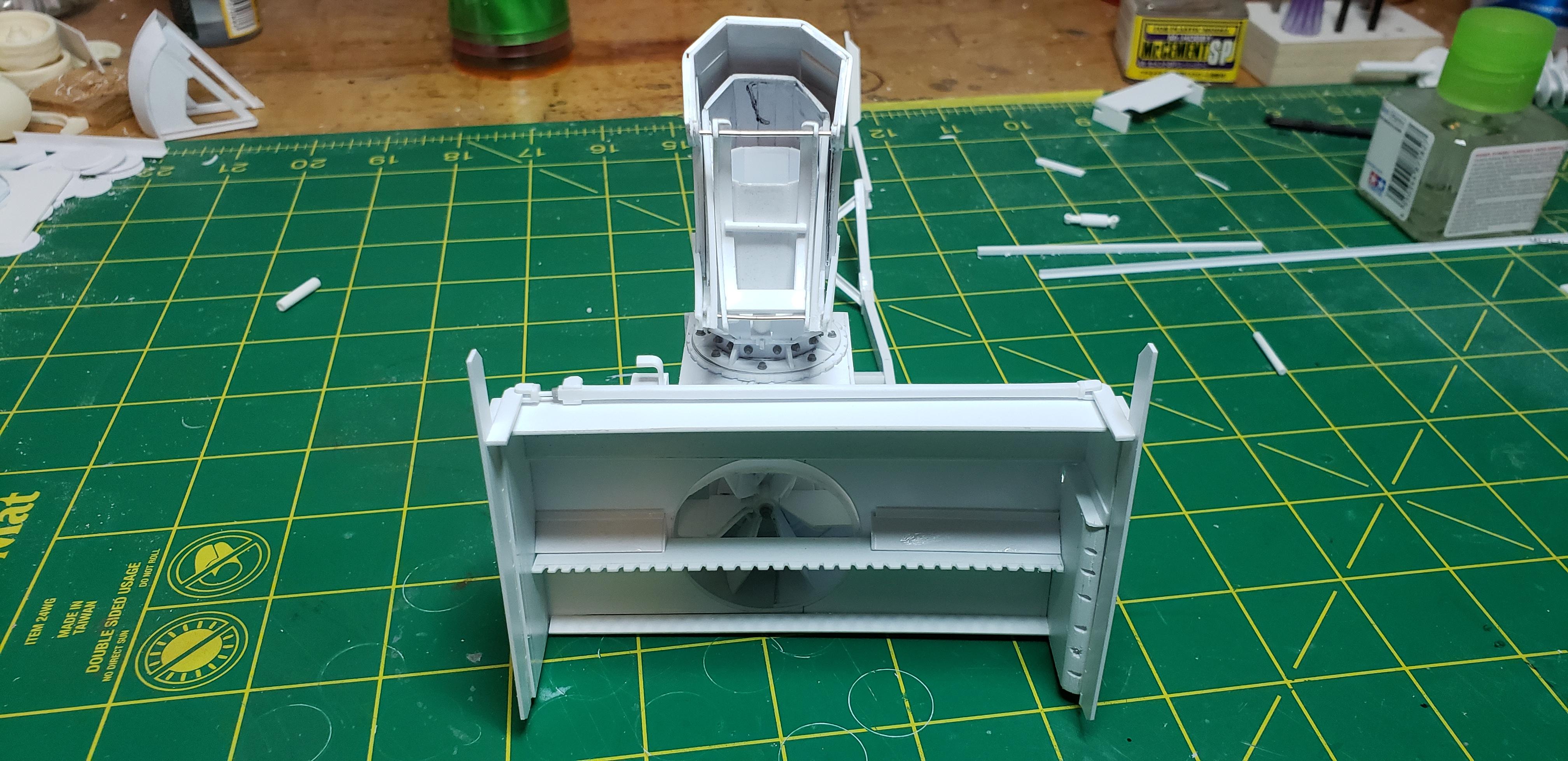

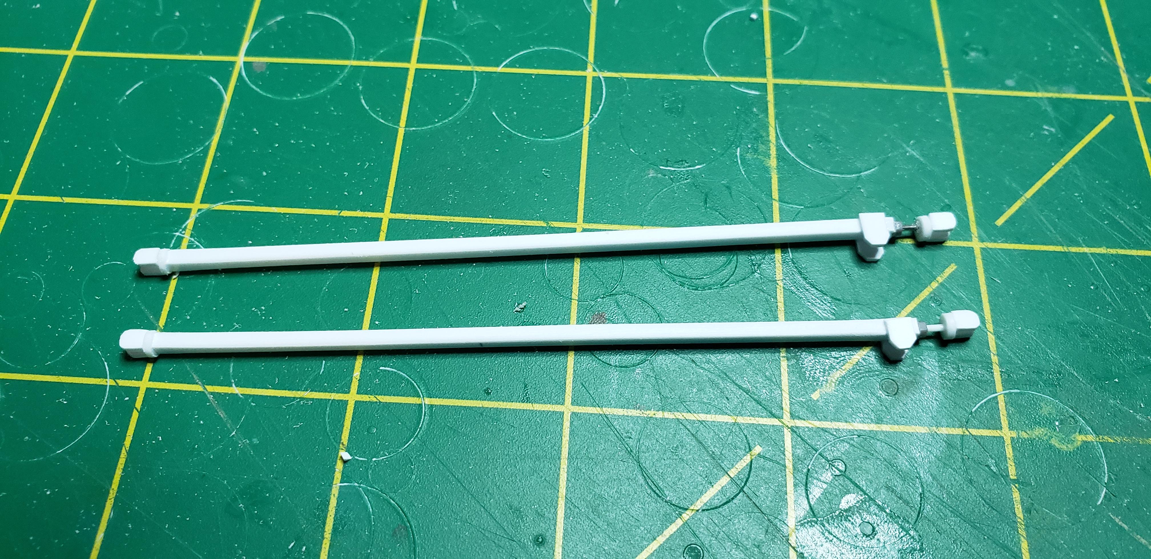

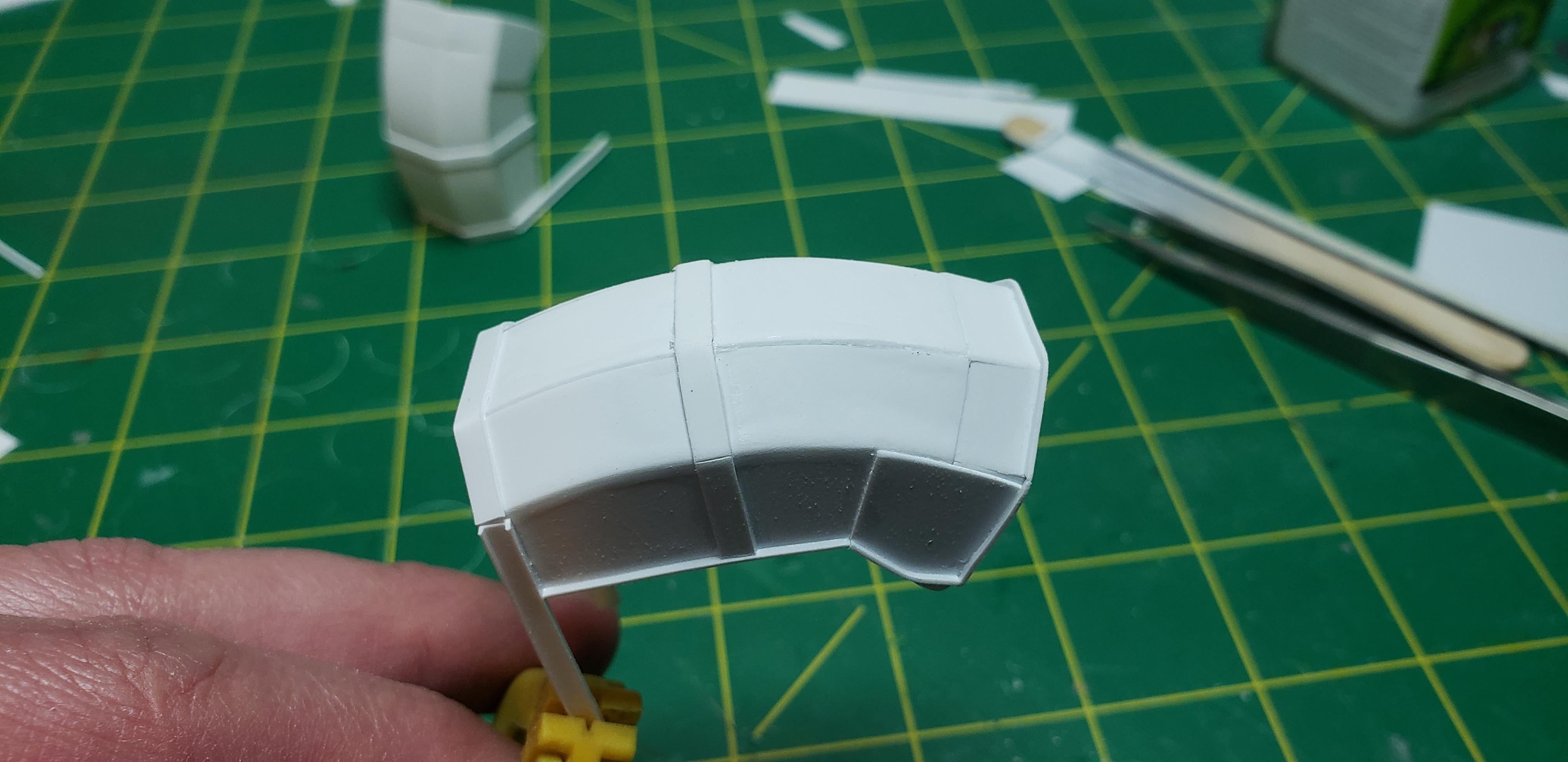

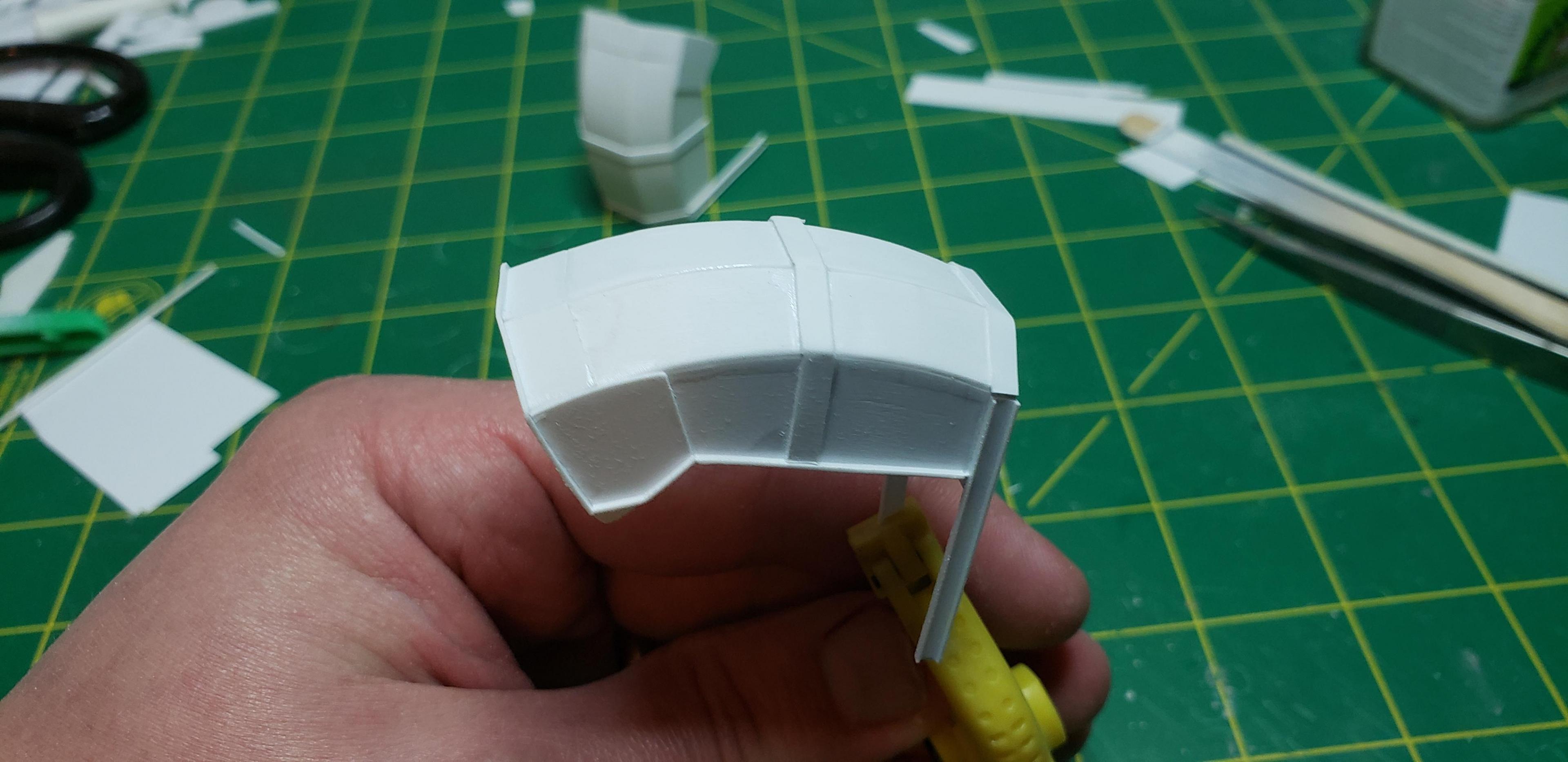

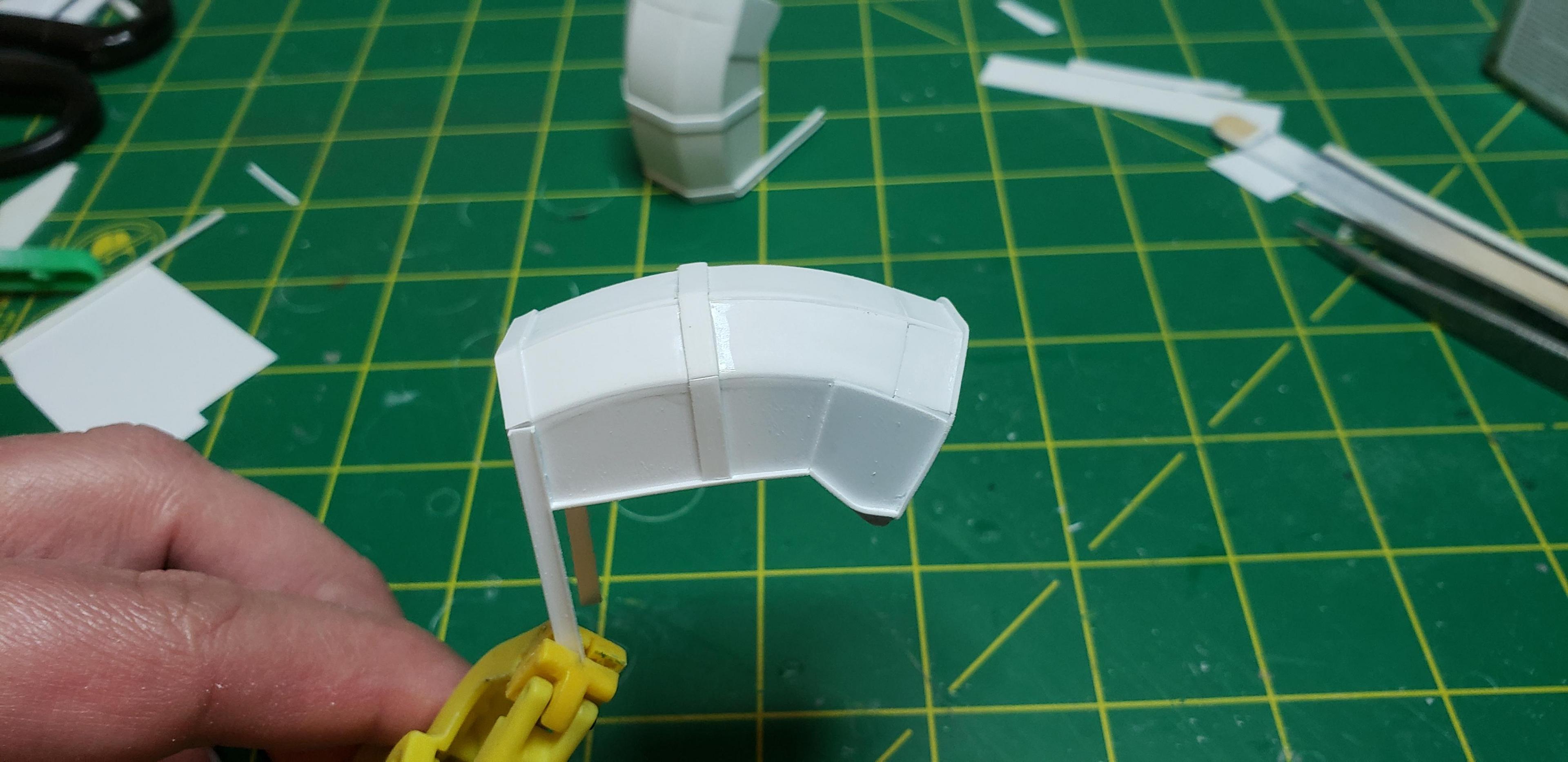

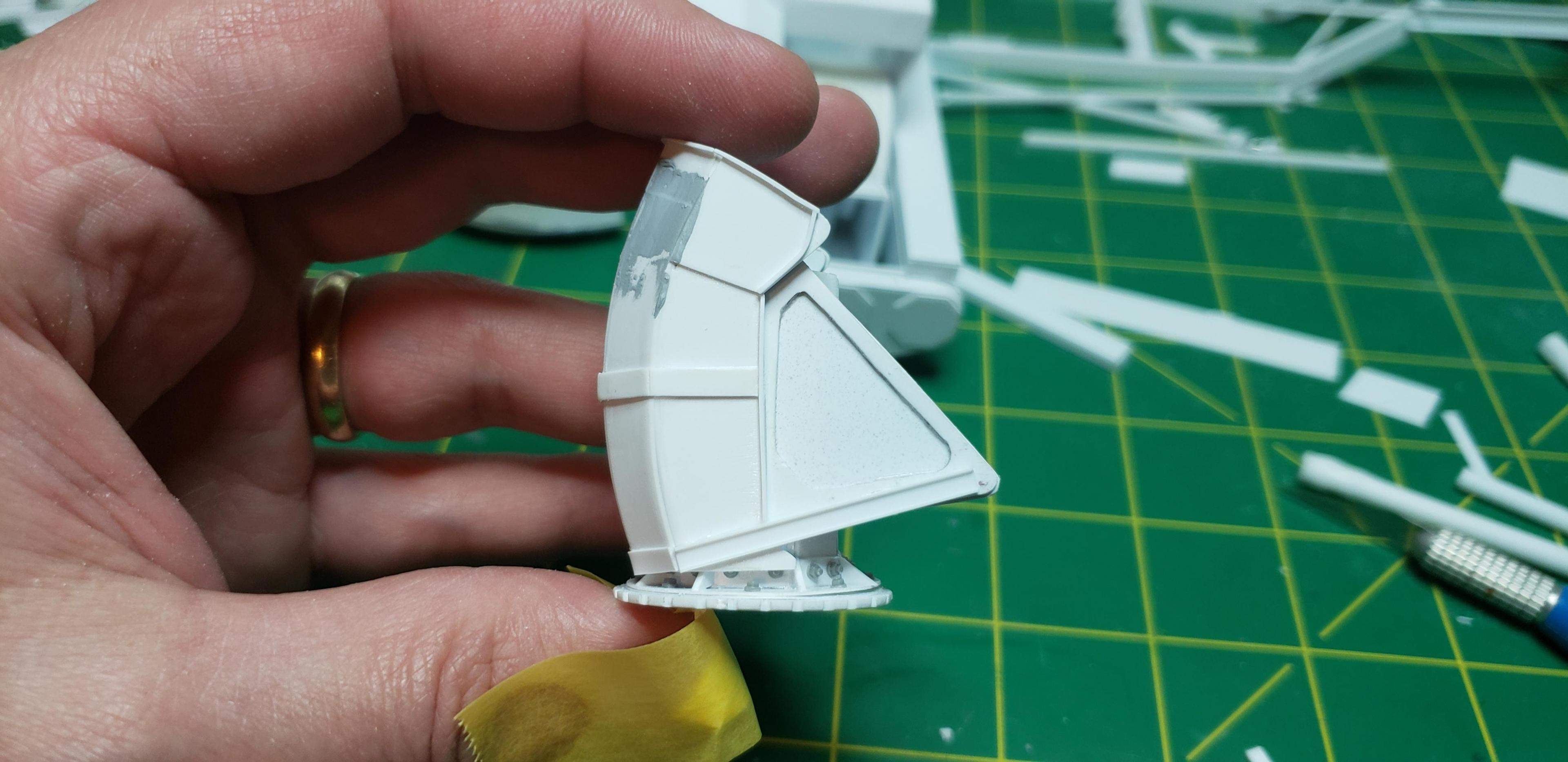

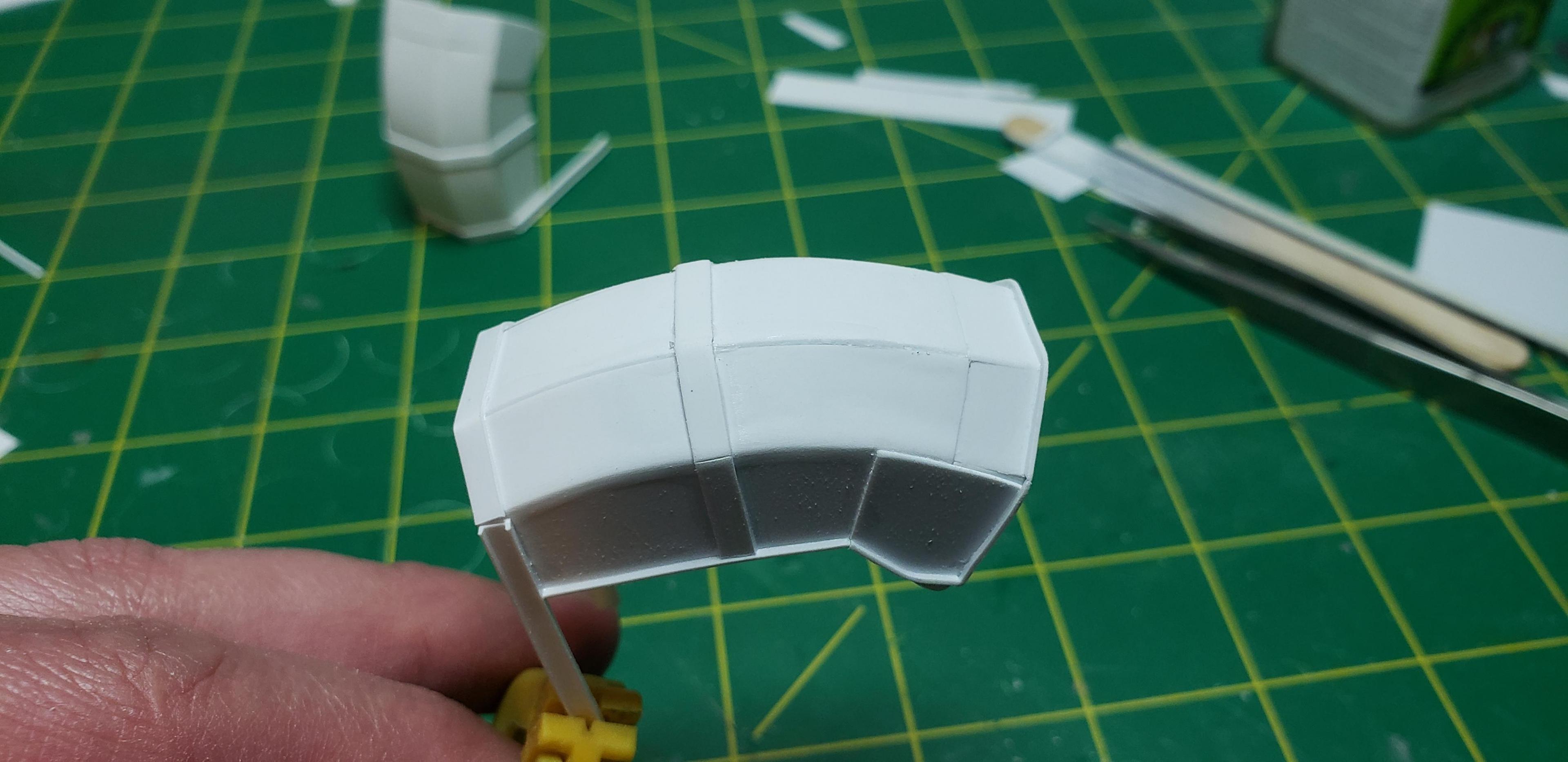

gotnitro? Posted January 1, 2021 Author Posted January 1, 2021 (edited) Today I wanted to focus on the discharge chutes. Their an enormous focal point on the snowblower w linkages and brackets going every direction. The chute " leaves " as their actually called have ribs ( not the KC yummy kind) and welded stiffening plates all around. I first double walled all the outer shell to strengthen it up, I originally made it scale thickness but had to fatten it up to avoid damage . Then working front to back adding plates and thin ribs . I spotted a glitch during construction w angle of the long channel, I mounted it too flat. The brace points about 45 degrees when leaves are stored. Trimming the section away and adjusting the angle had everything lining up. That putty mess was needed when the glue melted dips in plastic from my new clamps..oops One last part the squirrels made for me was the bank cutter flap support bar . This rod attaches to a small ram adjusting the angle of the cutters while clearing snow . Thanks for following Have a safe and happy New Years day Edited January 1, 2021 by gotnitro?

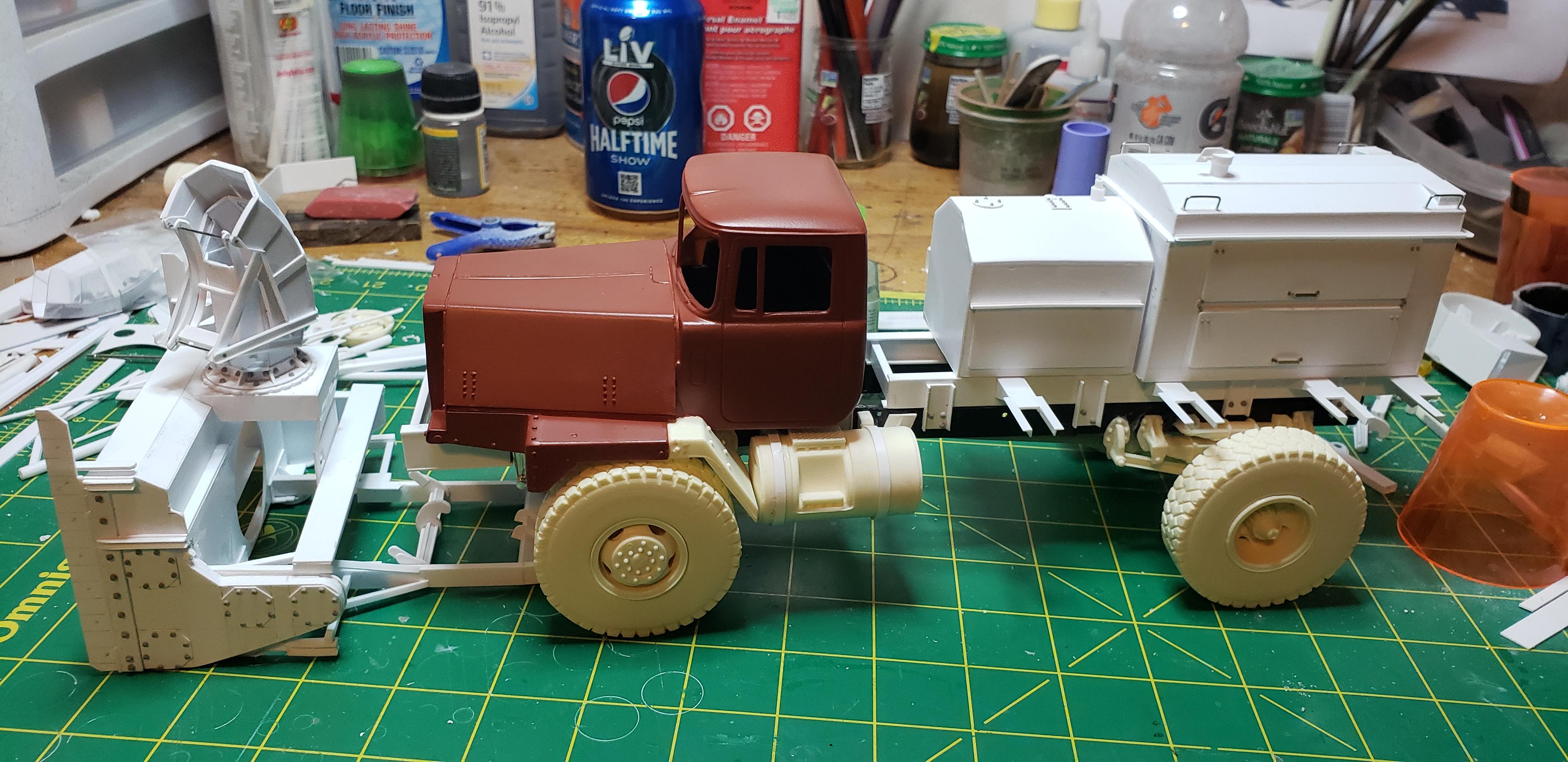

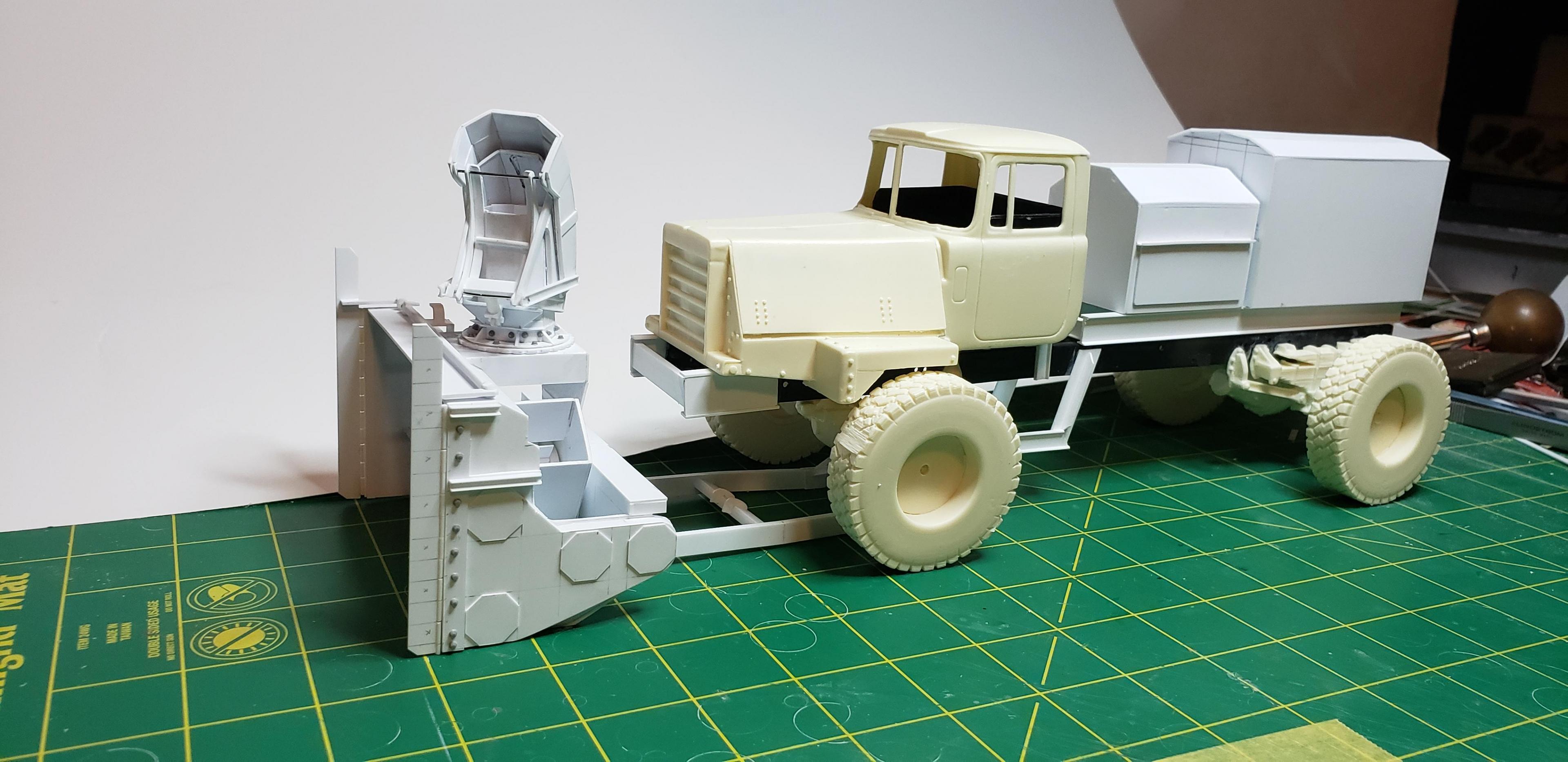

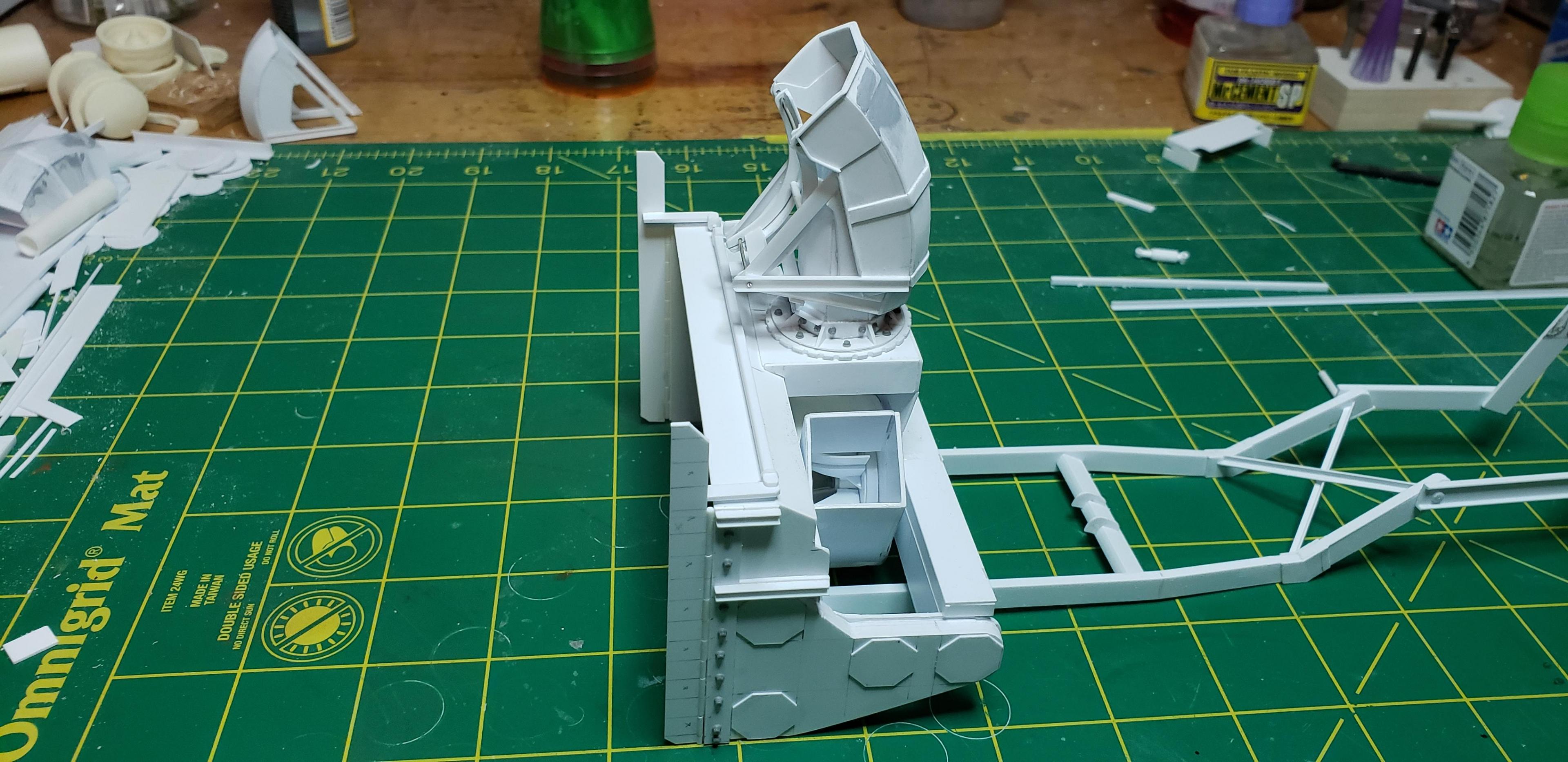

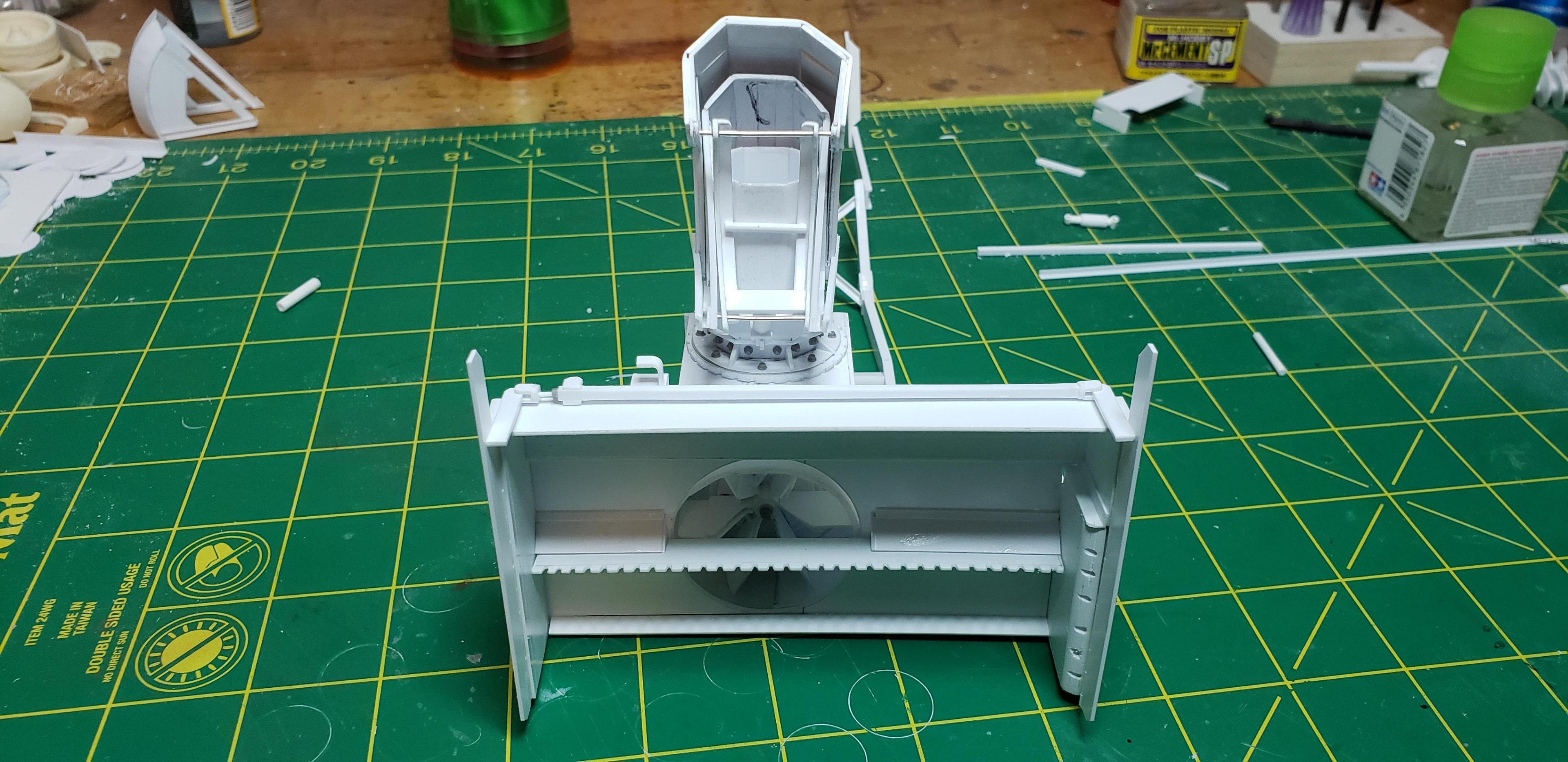

gotnitro? Posted January 3, 2021 Author Posted January 3, 2021 Wrapped up the chutes finally, several things I'd done differently but its assembled. Tossed together the bank cutters w fake hinge and decided to mock everything up w the RM . Just picked up the paint , chrome yellow overall w blue rear warning stripes. The hood will be anti glare flat black, drivers gotta see where he's driving with all that snow flying !!! Enjoy ! Happy modeling!

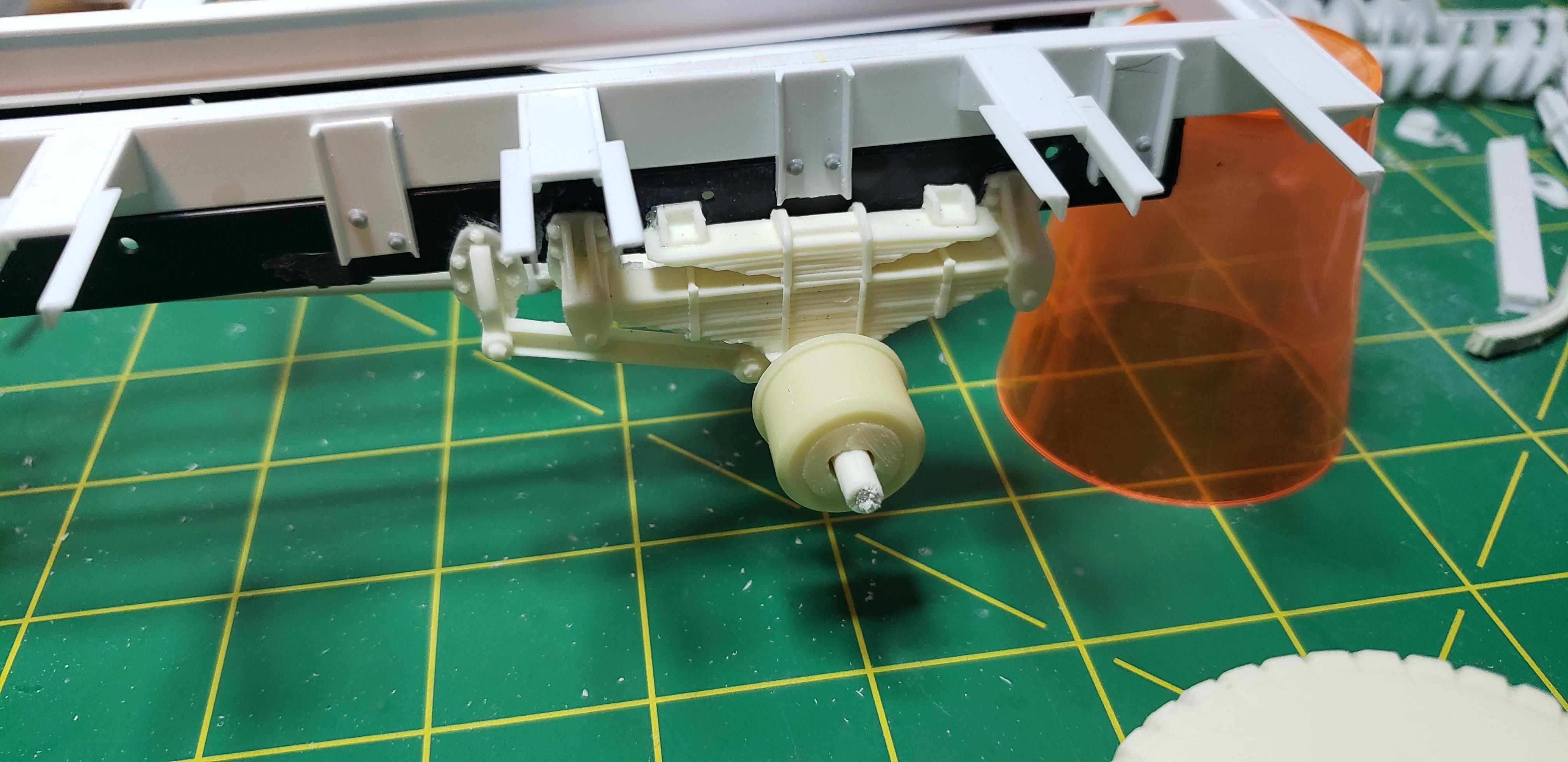

Chariots of Fire Posted January 7, 2021 Posted January 7, 2021 (edited) That's a lot of great work, Jeff. makes that Mack cab look pretty insignificant. Three tiers of springs on the back end? Or is what appears to be springs on the bottom like radius rods that keep the axle where it should be? What kind of load were they carrying weight wise? Edited January 7, 2021 by Chariots of Fire
Mopar - D Posted January 7, 2021 Posted January 7, 2021 Jeff awesome progress on the snow blower. You have it all coming together nicely now. Looking forward to seeing you paint it.

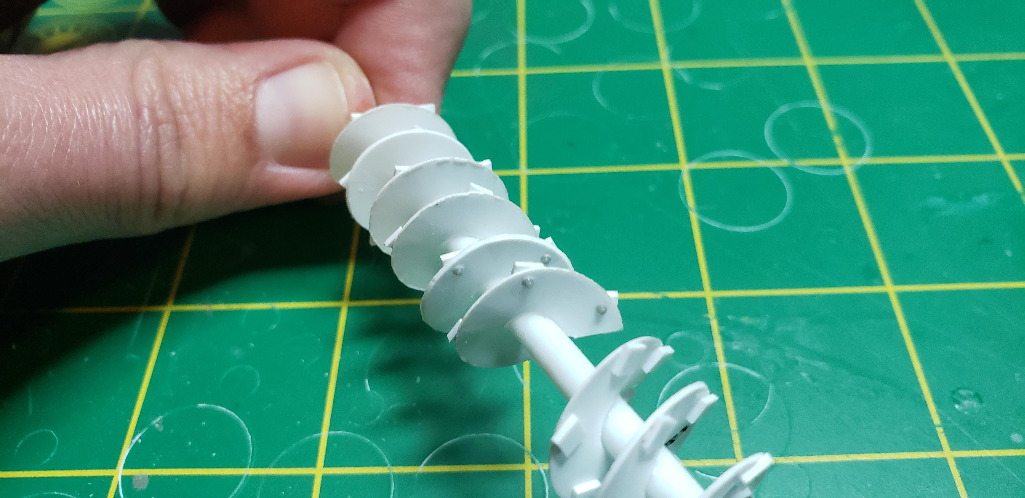

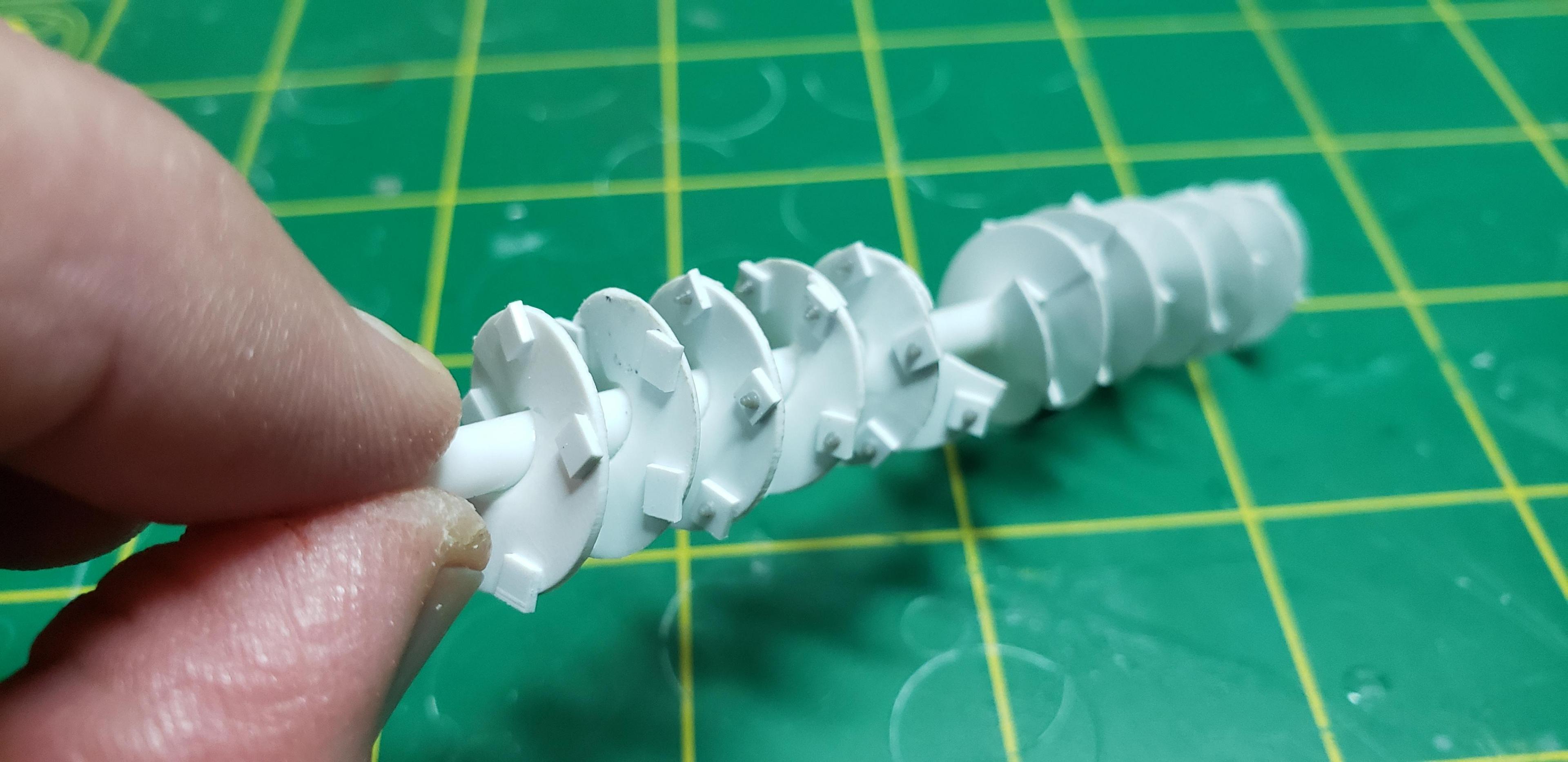

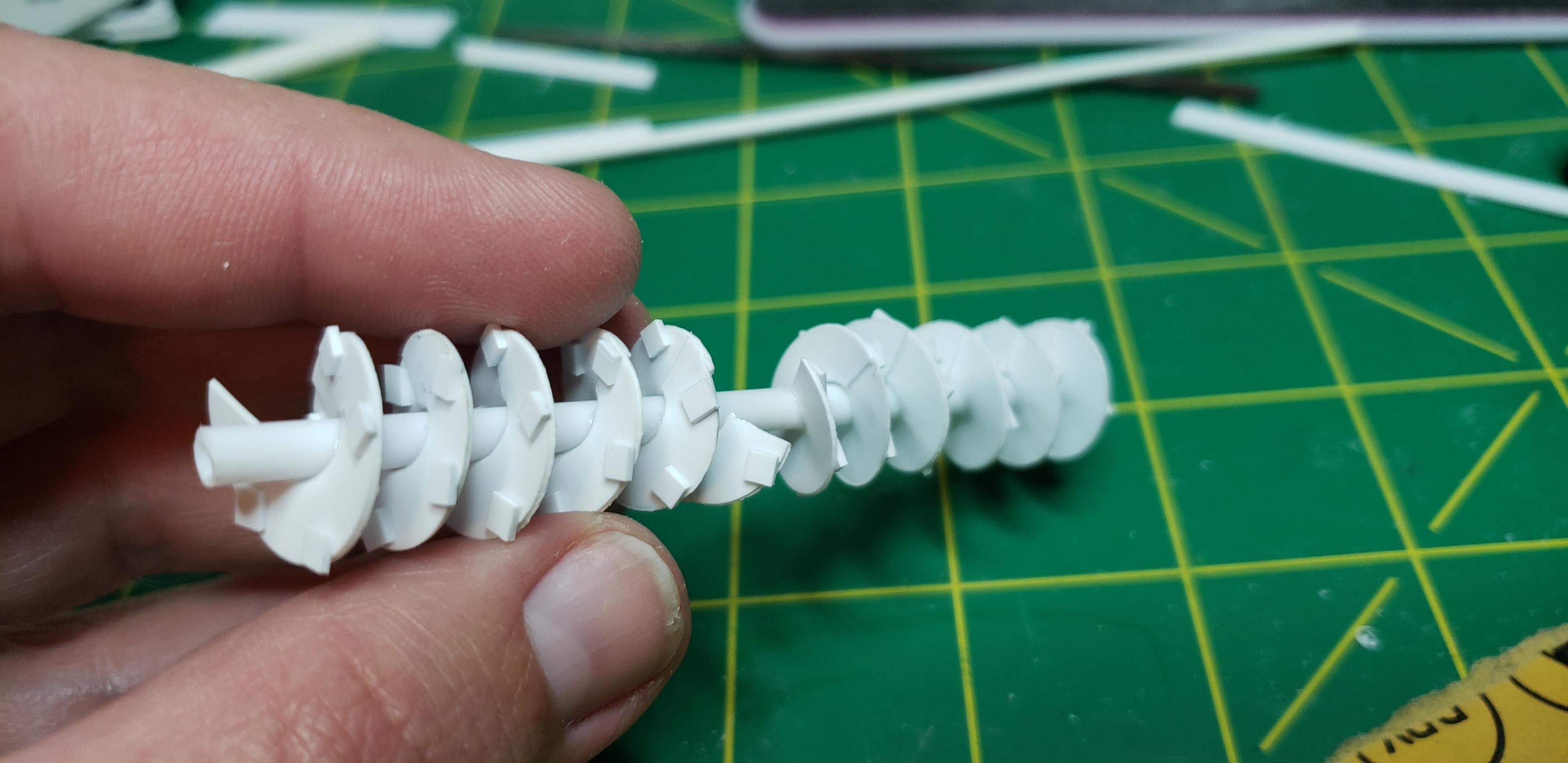

gotnitro? Posted January 7, 2021 Author Posted January 7, 2021 2 hours ago, Chariots of Fire said: That's a lot of great work, Jeff. makes that Mack cab look pretty insignificant. Three tiers of springs on the back end? Or is what appears to be springs on the bottom like radius rods that keep the axle where it should be? What kind of load were they carrying weight wise? Thanks ! It's starting to be difficult to work around now all the bracing is going on before paint .. The rear springs have a radius rod type bar id assume is to keep axle centered . I got them from Dave Natale specific for this build . The trucks typically had a Cat bulldozer engine to power the blower unit , D 348 possibly. Theres a large rear mounted radiator also. 25 minutes ago, Mopar - D said: Jeff awesome progress on the snow blower. You have it all coming together nicely now. Looking forward to seeing you paint it. Thanks , its definitely starting to look like a snowblower now instead of a huge pile of random parts.. Tonite I had a few spare minutes so I cleaned up the augers . Our 4 yr old said " it doesn't have teeth like Bumble ..did Hermie take his teeth out too ? She watches Rudolf too much . Well now it has the teeth ! I may add some meng bolts later
Mopar - D Posted January 7, 2021 Posted January 7, 2021 Nice added detail Jeff. The bolts will add the next level of detail to the teeth.

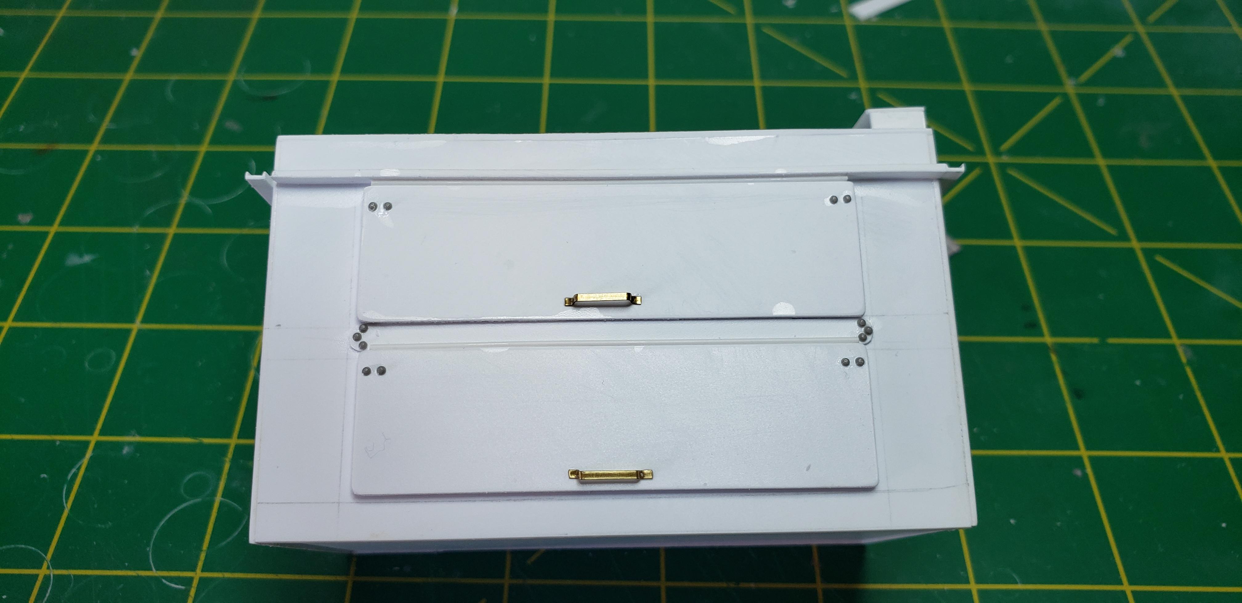

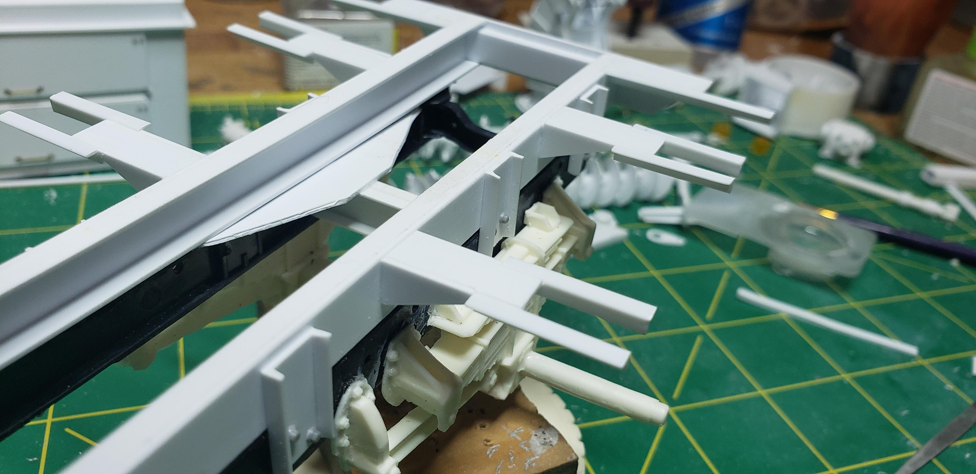

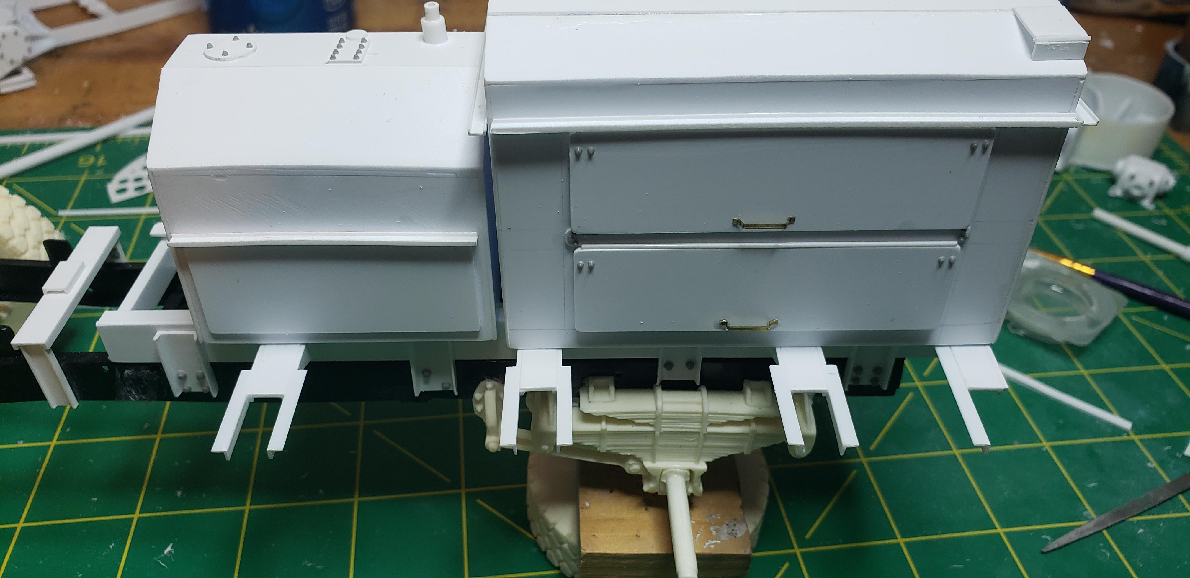

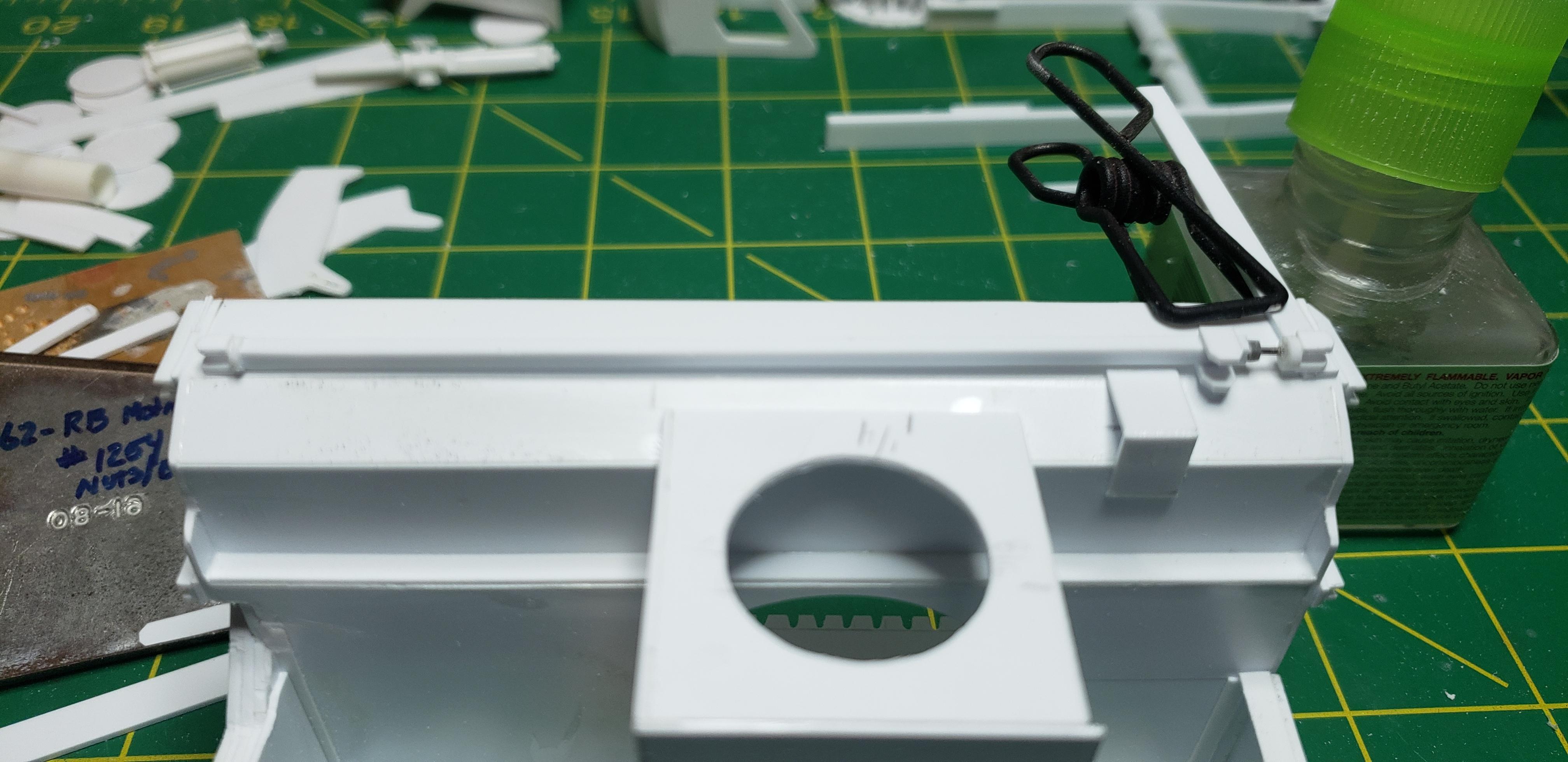

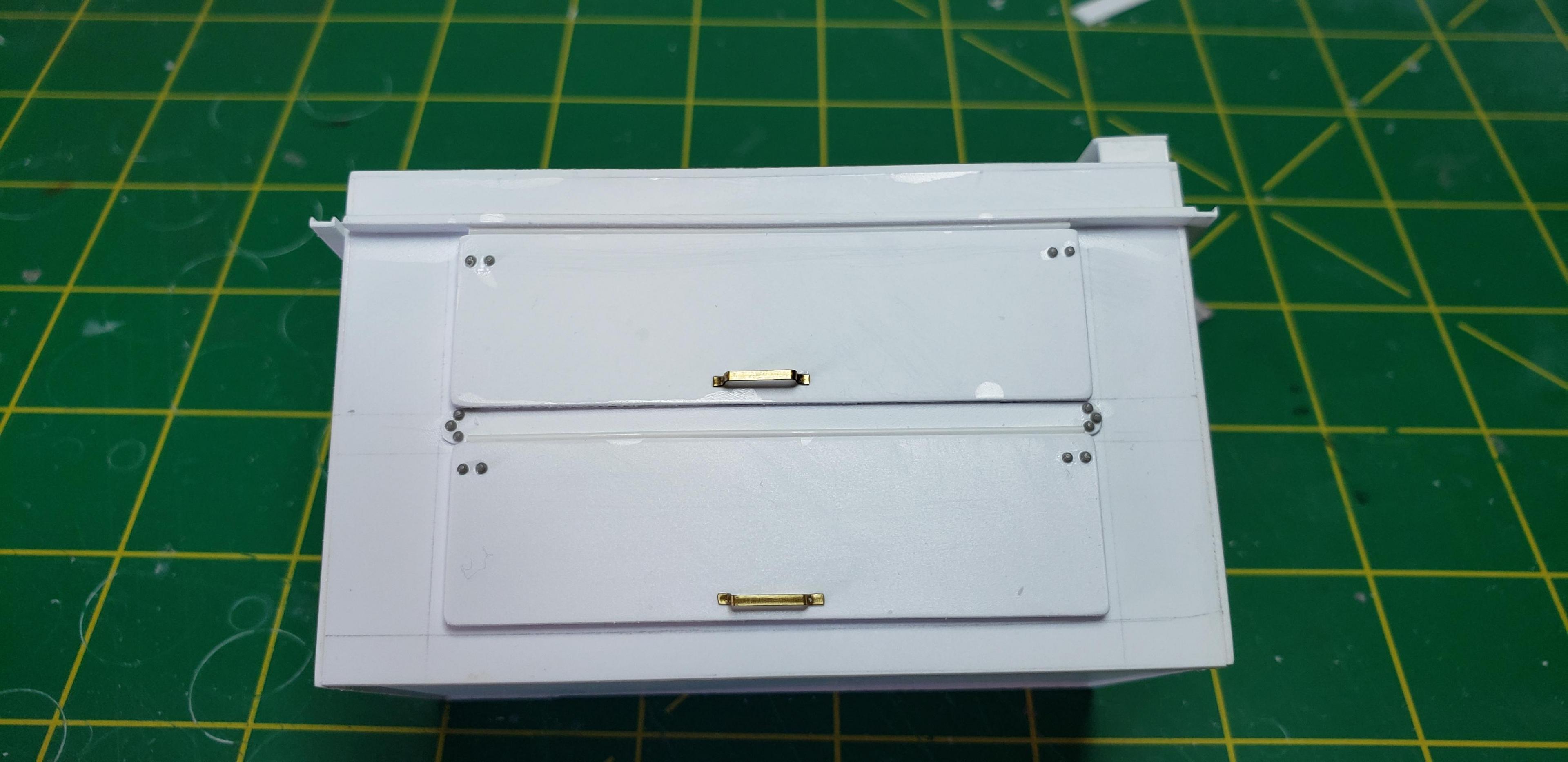

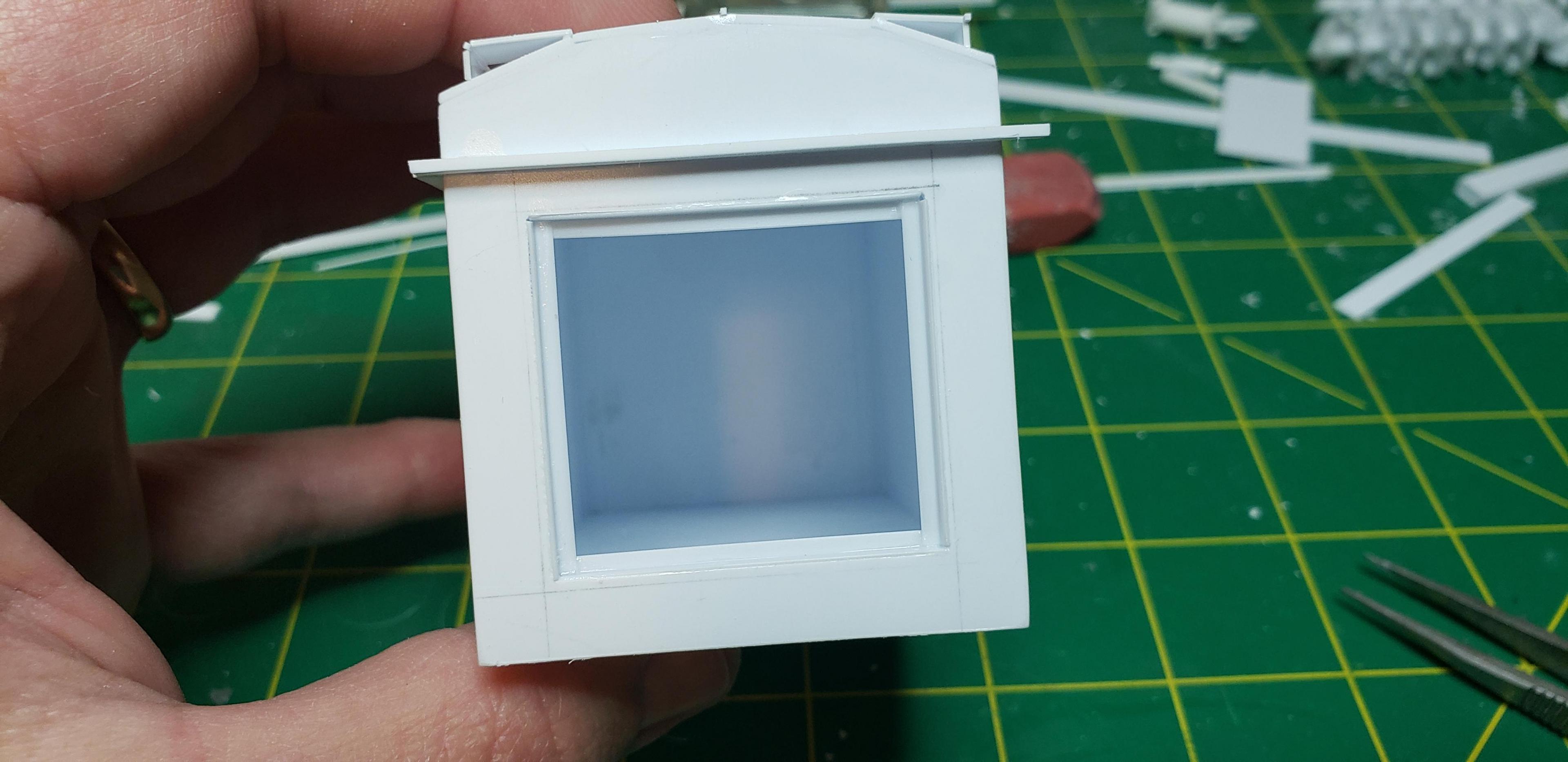

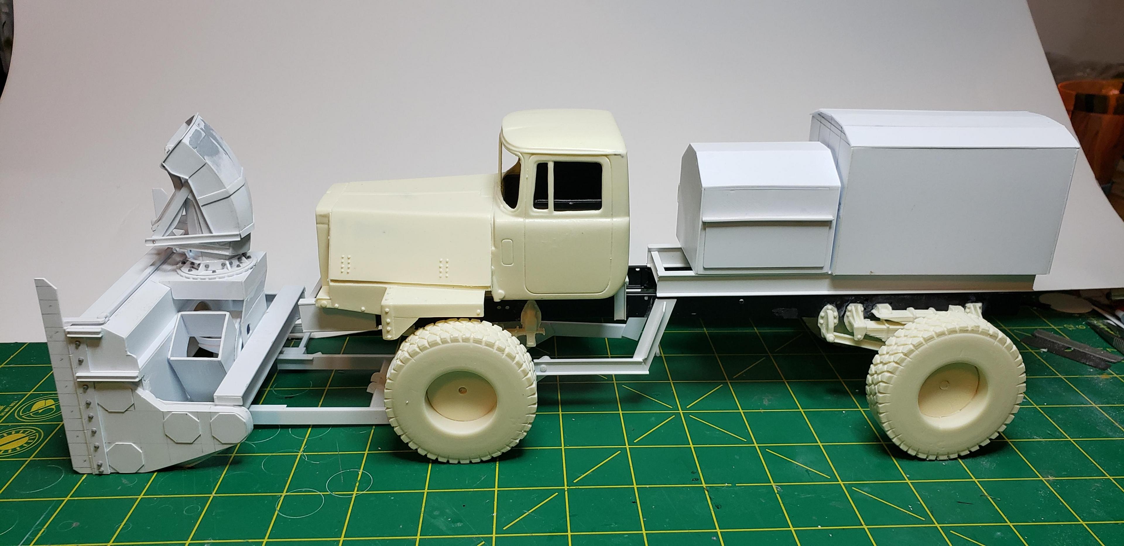

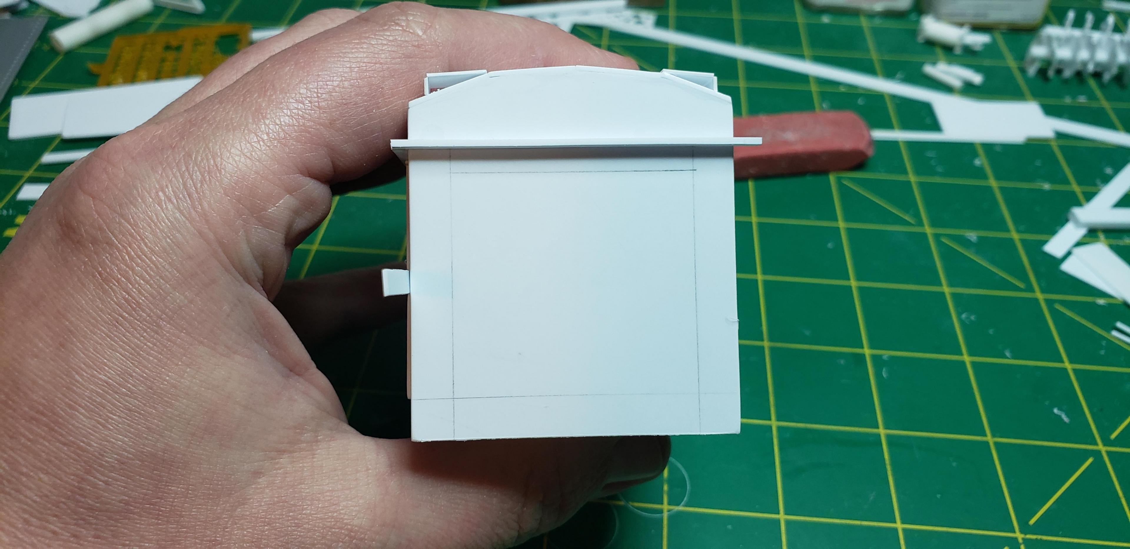

gotnitro? Posted January 9, 2021 Author Posted January 9, 2021 This weekend I decided the rest of the truck needed some attention, work started on the blower engine compartment. Theres a large rear facing radiator so out came the dremel to remove the panel. I cleaned up opening then framed in w angle . Later ill fill it w a expanded metal screen . I still plan to blank off the back to avoid see thru Doors, drip rails were added along w meng detail bolts . Then some scrap Pe handles were attached I rebuilt the frame for the boxes after a photo showed its c channel not I beam , so a quick rebuild i added the welded braces w more meng bolts. Next up will be the frame bracing for expanded metal walkway, and rear bulkhead . Another necessary mockup was in order . Everyone suggested the truck should have tire chains so I added that to list ....squirrels lol

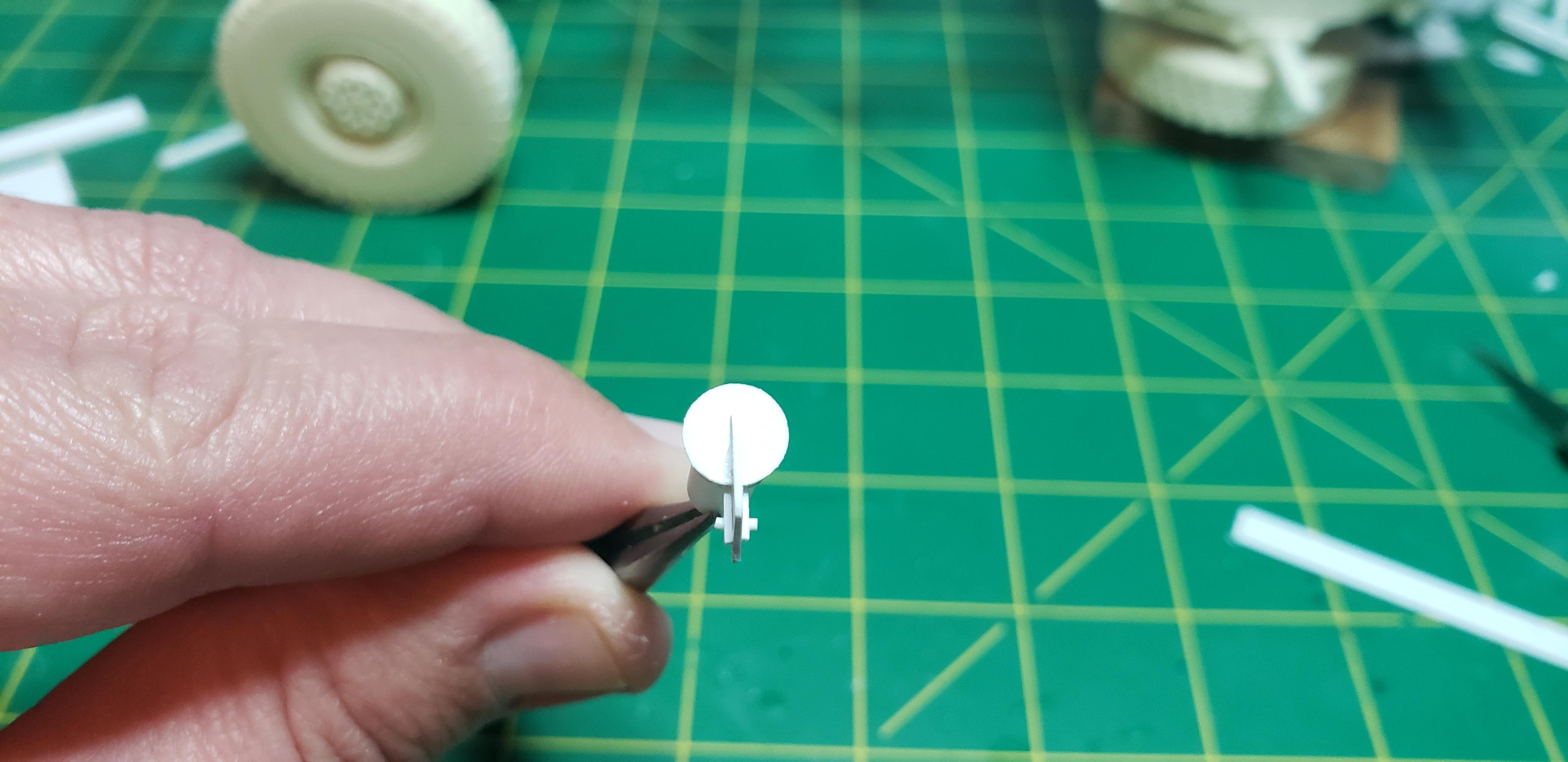

gotnitro? Posted January 10, 2021 Author Posted January 10, 2021 Playoffs were on..so I headed to the bench for more build time ! Built up a set of walkway hangers based off photos I took a few days ago. I'd wished now I'd taken a quick measurement but eye balling this one . Couple triangle braces , u channel in center w angle extensions ..typical Oshkosh fabrication built heavy Kept looking at photos , and wanted to try building a rain cap on the blower engine exhaust stack.. Thats it for today, thanks for following!

gotnitro? Posted January 13, 2021 Author Posted January 13, 2021 Well I started adding the auger bolts, glad I have a magnifying light on the bench cause they are tiny! Meng calls them 0.8 Tidied up more of the chassis stuff, added rear brake drums from kfs and attached the fuel tank..its getting difficult to work around now and not break something Really looking towards the primer stage soon..been looking at this too long
