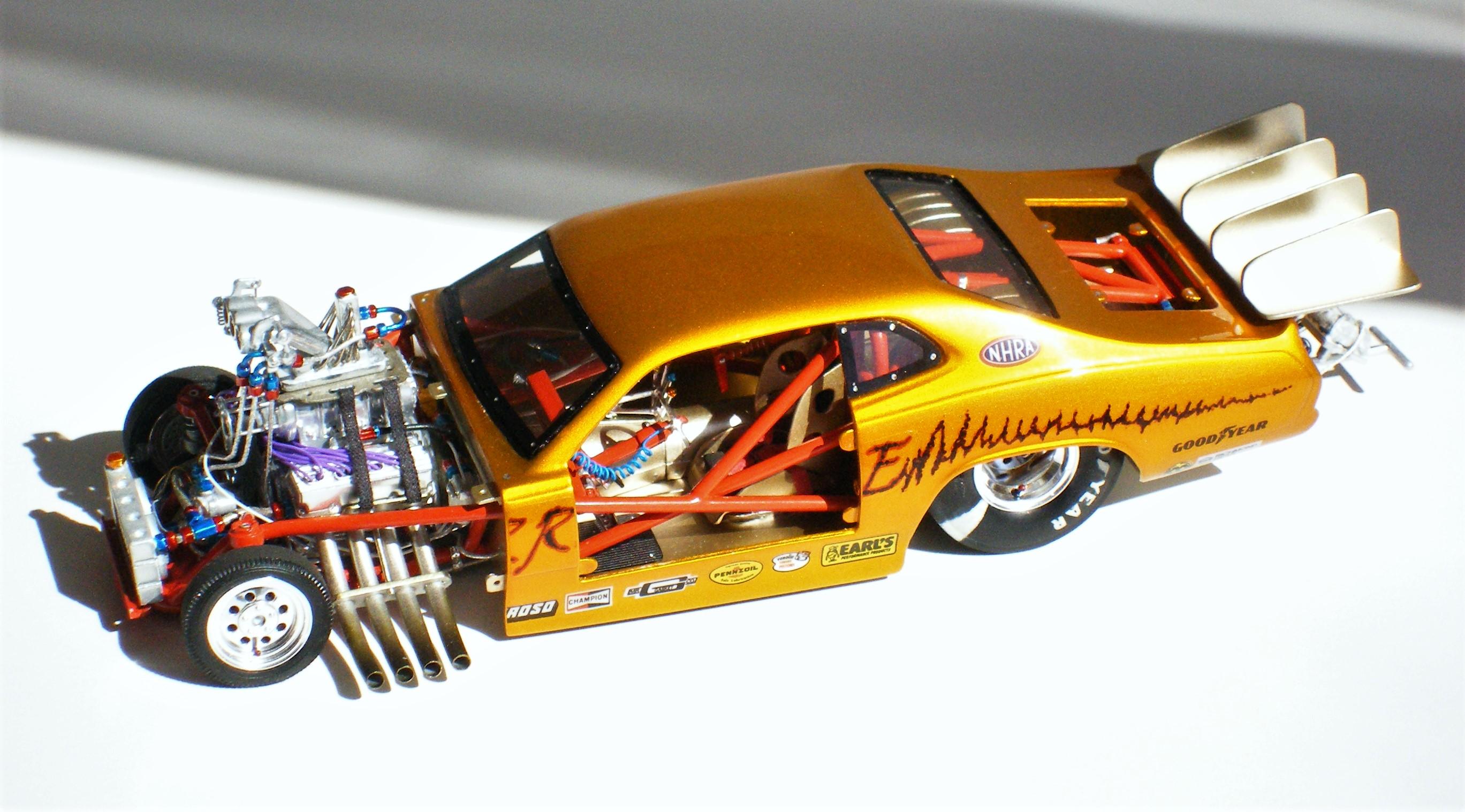

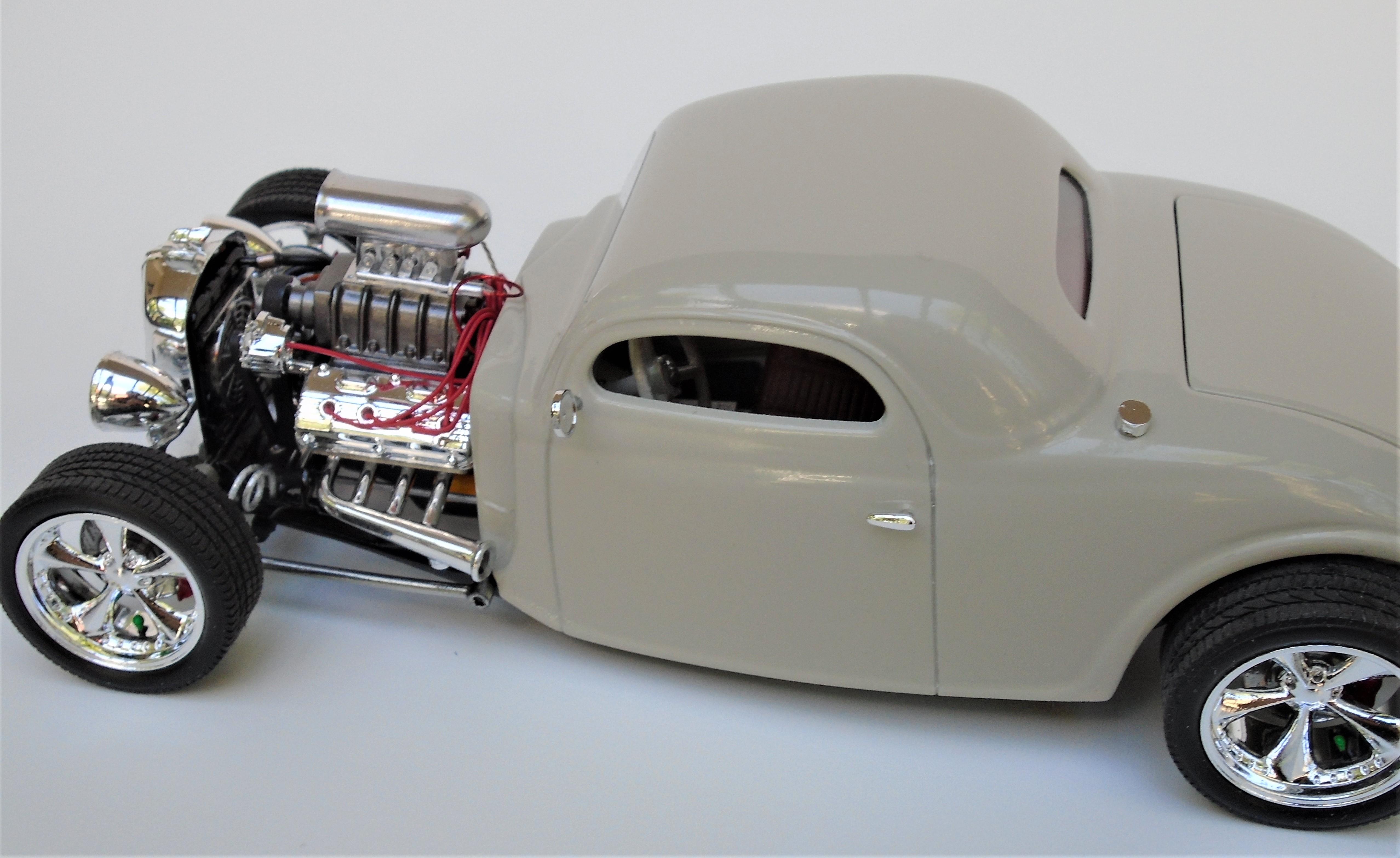

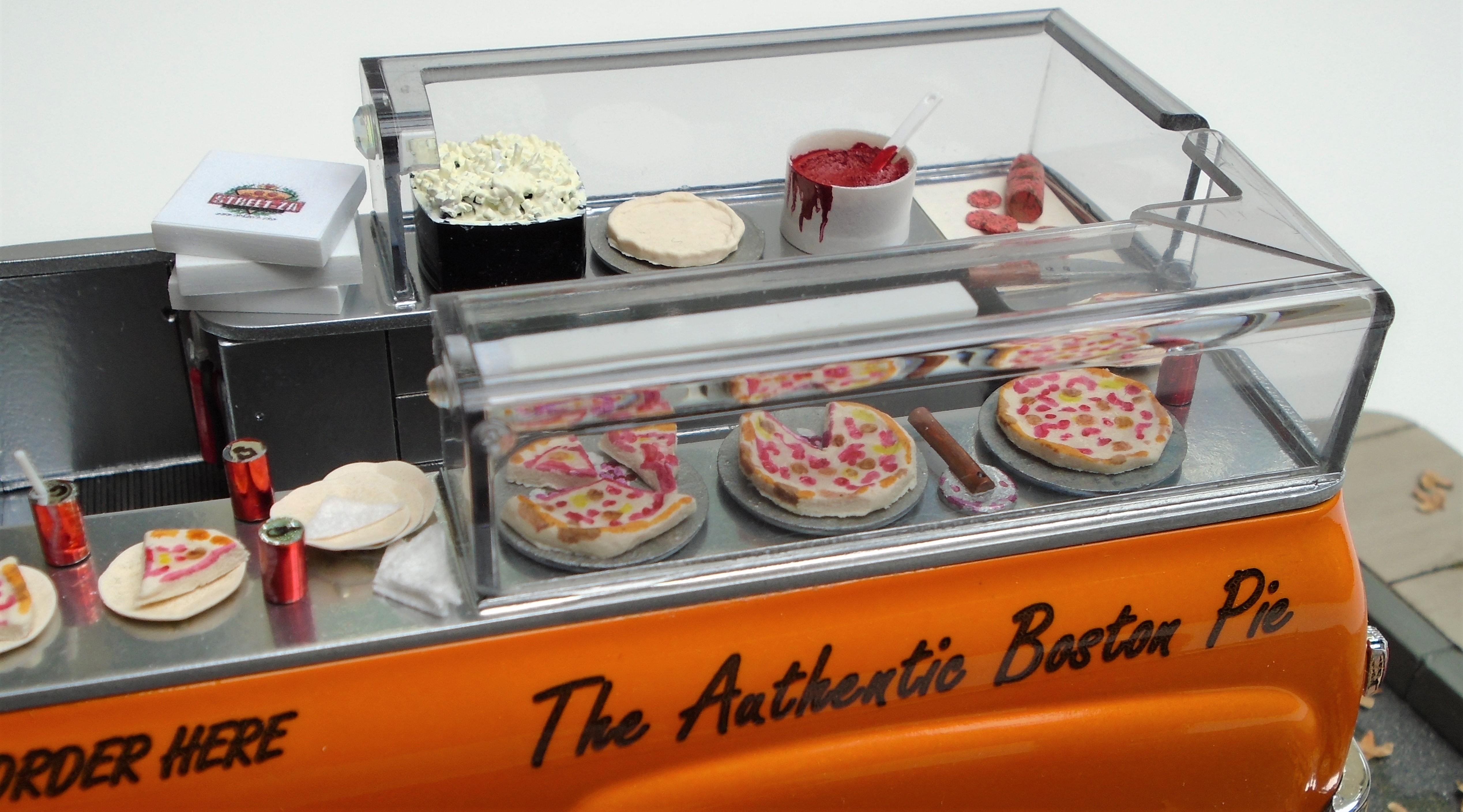

Claude Thibodeau Posted December 8, 2020 Posted December 8, 2020 Hi John! The blower scoop on this 36 was shot with a Krylon spray-can finish, that gave a sheen that is less bright than regular chrome, but lighter in hue than the usual Alclad on a black enamel base. So is the counter top on the food truck. Speakin of Alclad, I tried it on a white enamel base, and it then mimicks more polished aluminium than the darker chrome on black enamel. (see Duster scoop below) For what it's worth, just my two cents... CT
