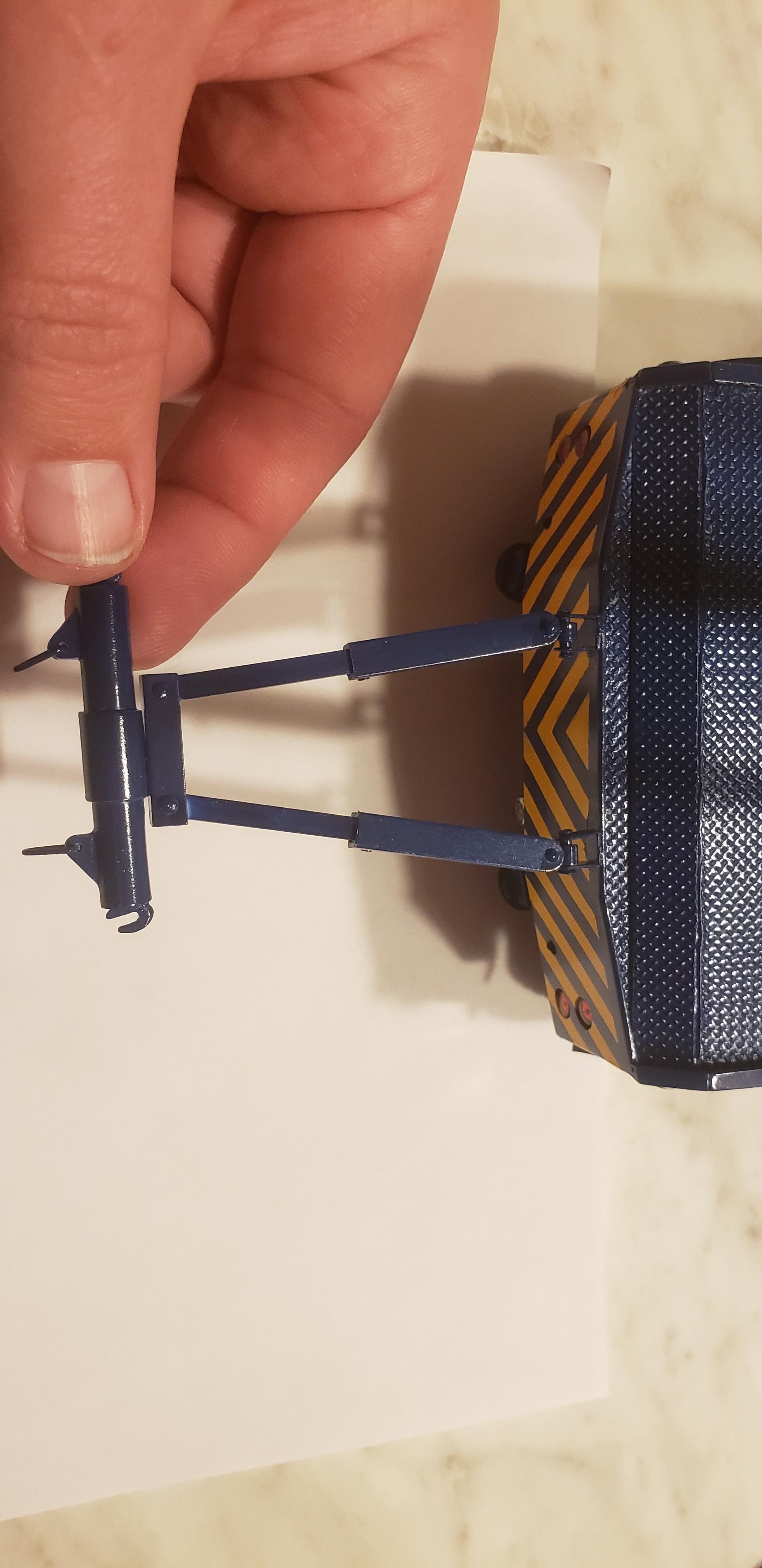

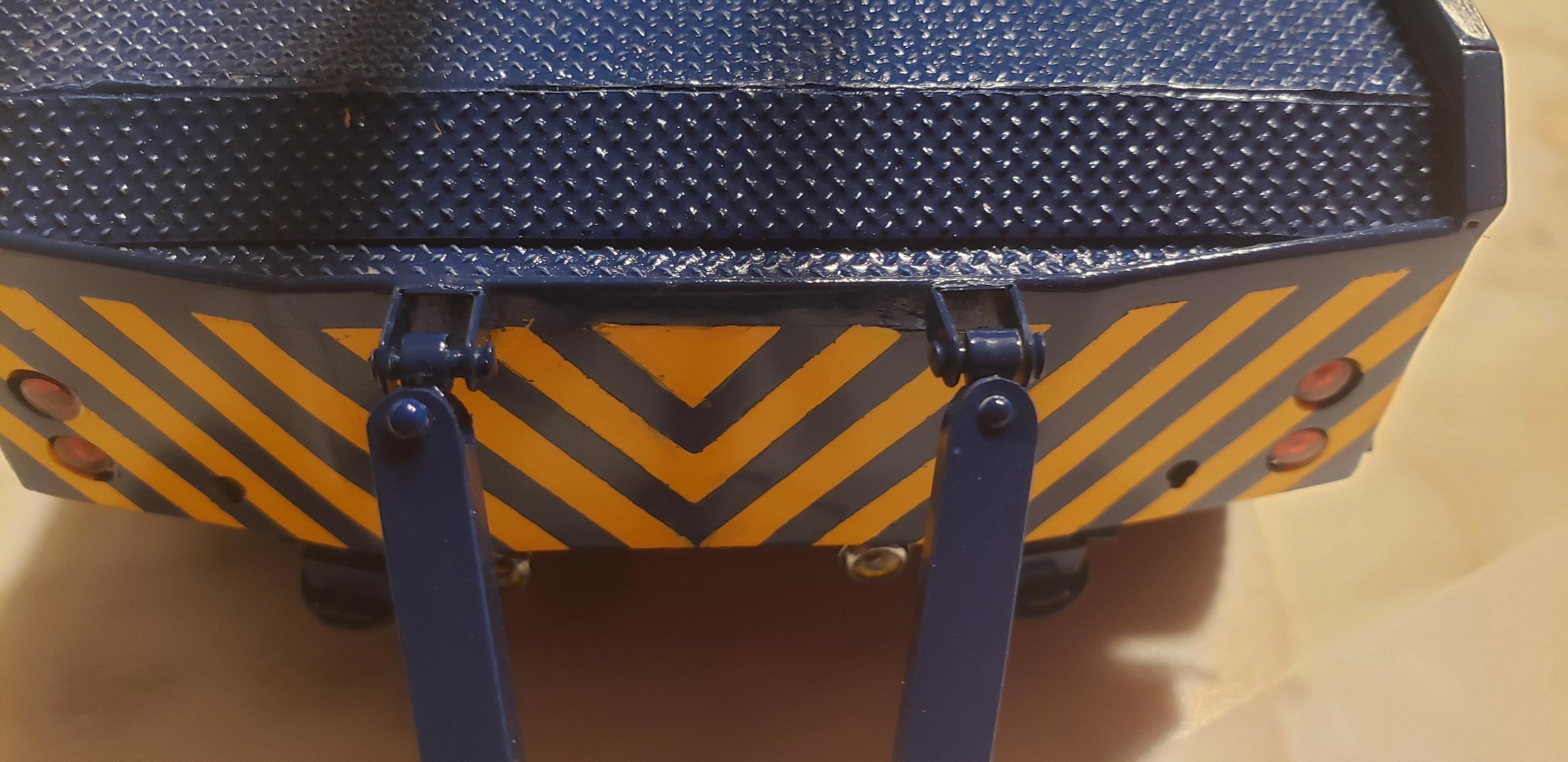

gotnitro? Posted January 3, 2021 Posted January 3, 2021 Here ya go The legs are telescopic square tube 2 1 / 8 overall length. Each section is 1 1/8 long inner one closest to truck was 3 /16 tube outer 1/8 The towbar tube body is 1 5/8 long The middle tube is .305 tube 7/16" long Outer tubes .248 " 5/8" long The rectangular section where legs join tow bar is 3/4 long x 3 /16" it was photoetch Underneath was a small shaped piece looked like T pinning both sections of legs . Real ones this allows legs to extend . Here's how KFS wanted them attached to bed body Hope this helps !
landman Posted January 3, 2021 Author Posted January 3, 2021 1 hour ago, gotnitro? said: Here ya go The legs are telescopic square tube 2 1 / 8 overall length. Each section is 1 1/8 long inner one closest to truck was 3 /16 tube outer 1/8 The towbar tube body is 1 5/8 long The middle tube is .305 tube 7/16" long Outer tubes .248 " 5/8" long The rectangular section where legs join tow bar is 3/4 long x 3 /16" it was photoetch Underneath was a small shaped piece looked like T pinning both sections of legs . Real ones this allows legs to extend . Here's how KFS wanted them attached to bed body Hope this helps ! Absolutely! Thamk you Jeff.

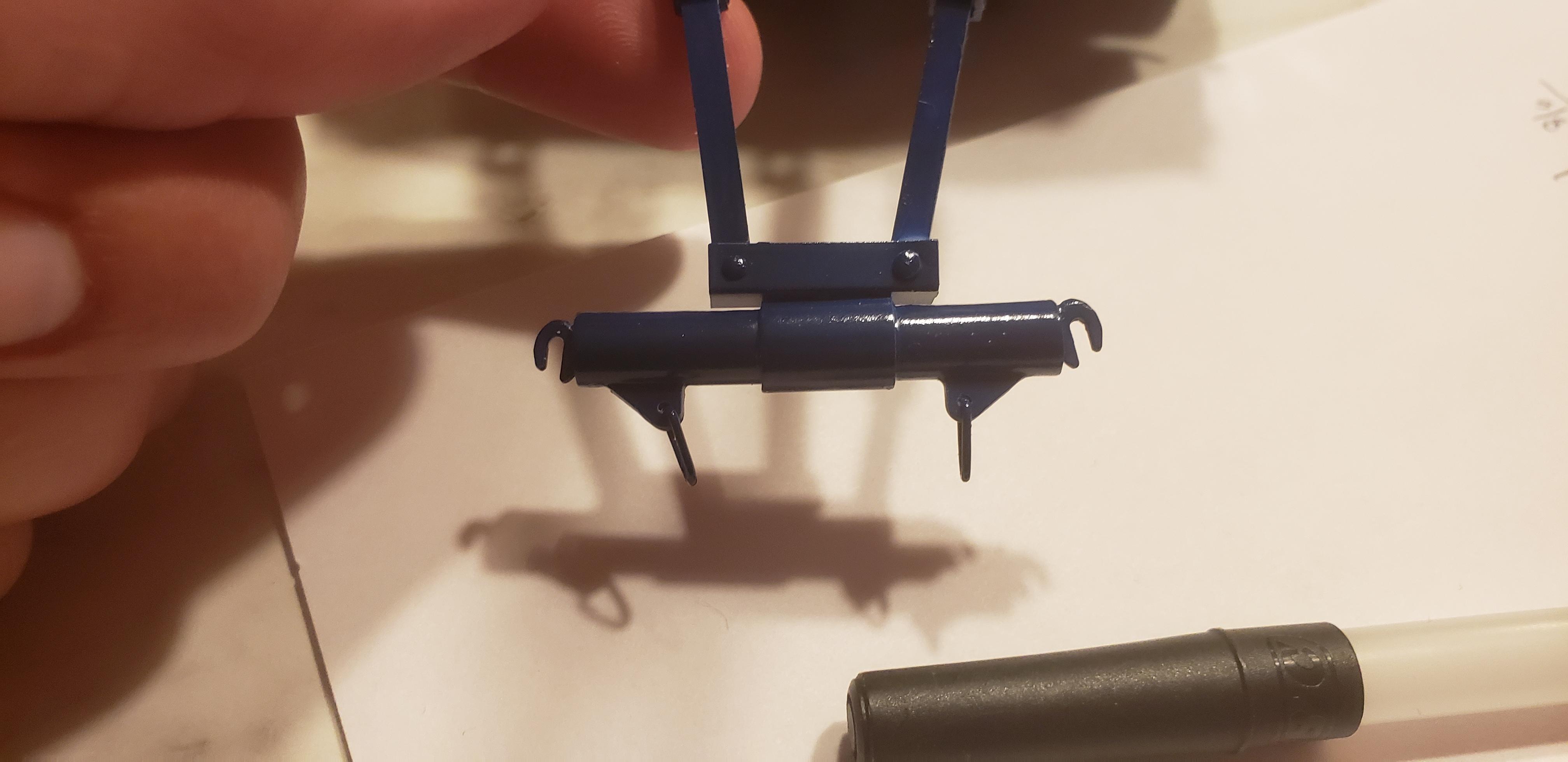

landman Posted January 4, 2021 Author Posted January 4, 2021 Almost ready for primer. I found some hooks on some junk frame rails, those will be added to the ends of the tube.

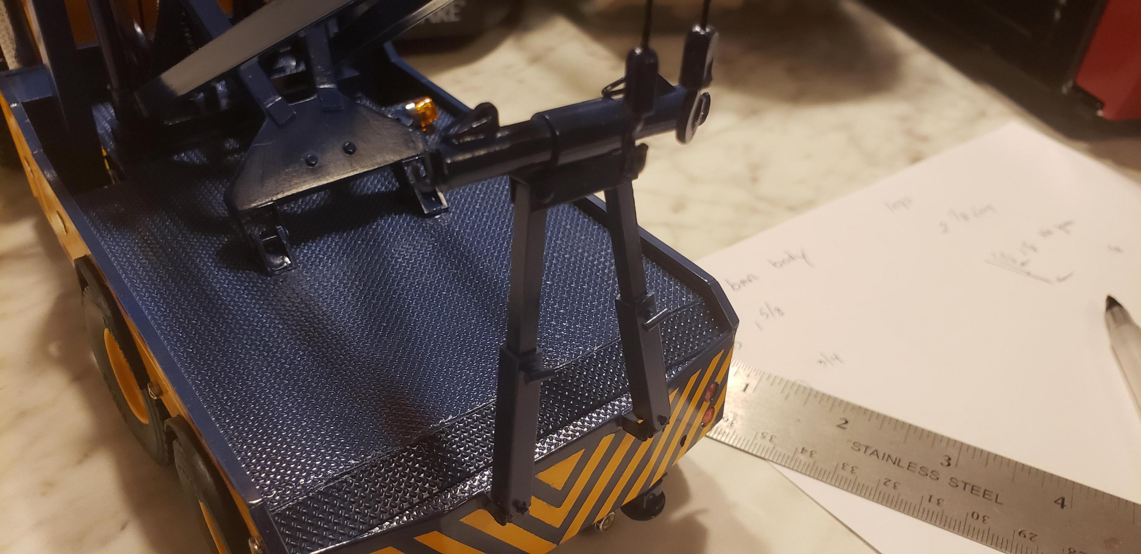

landman Posted January 10, 2021 Author Posted January 10, 2021 (edited) And so here it is in primer. I t will stay like this until I find out what truck it will sit on which will also dictate which color it will be. Edited January 10, 2021 by landman
landman Posted January 10, 2021 Author Posted January 10, 2021 28 minutes ago, DRIPTROIT 71 said: Man that looks good!!! Glad you like it Brian.

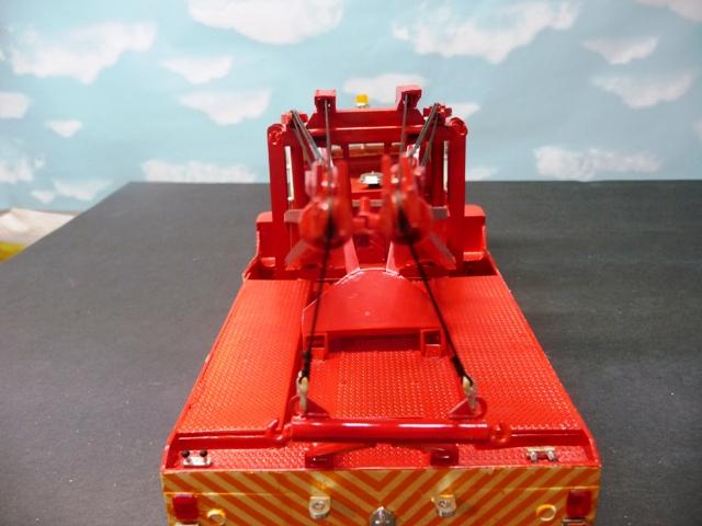

GLMFAA1 Posted January 15, 2021 Posted January 15, 2021 Got a chance to dig out the ALF/Holmes and took a shot of the boom lock. I cheated and did not use Phil's plan on the lock. I used a simple C channel with a single piece from the other boom to fit inside and then pinned it through a hole hope this helps. greg
landman Posted January 15, 2021 Author Posted January 15, 2021 2 minutes ago, GLMFAA1 said: Got a chance to dig out the ALF/Holmes and took a shot of the boom lock. I cheated and did not use Phil's plan on the lock. I used a simple C channel with a single piece from the other boom to fit inside and then pinned it through a hole hope this helps. greg It will, thanks.
