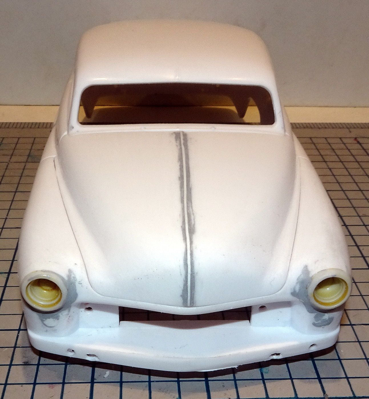

Phildaupho Posted January 10, 2021 Author Posted January 10, 2021 I spent some time sanding the hood and grill opening to partially correct the kit shortcomings by making both more rounded. I think it is definitely an improvement and closer to how it should be.

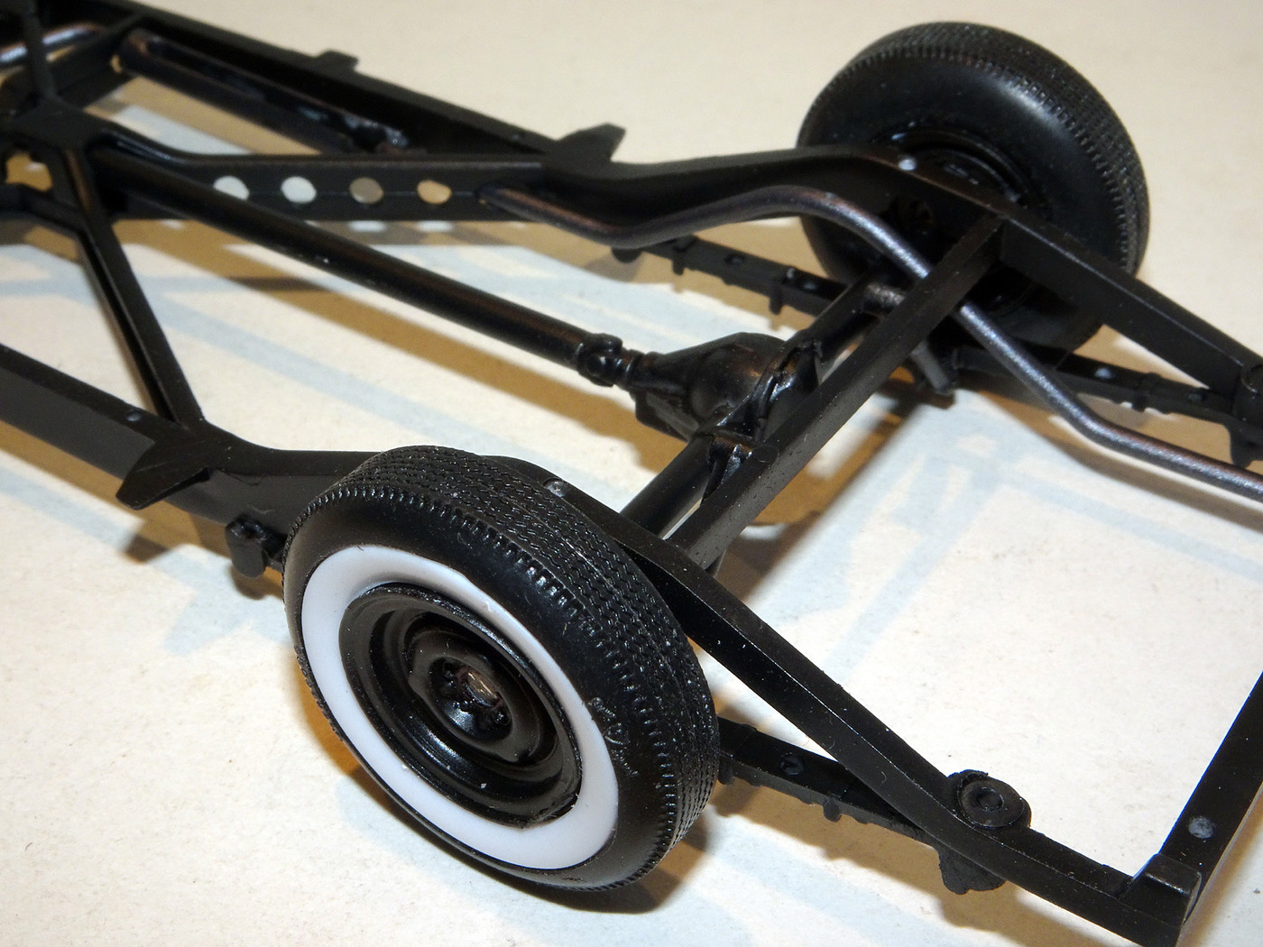

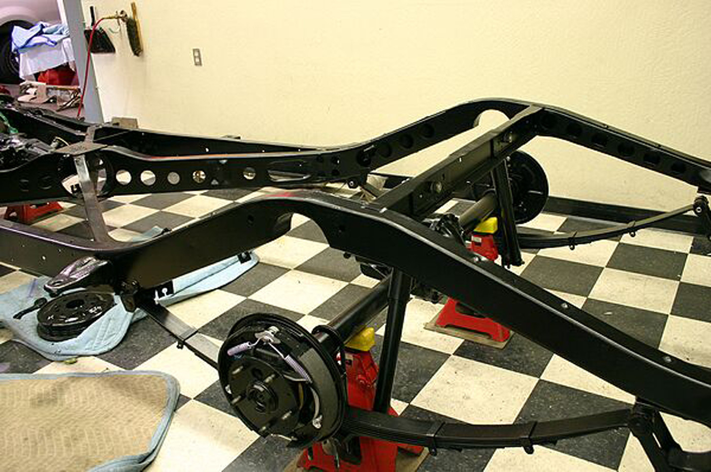

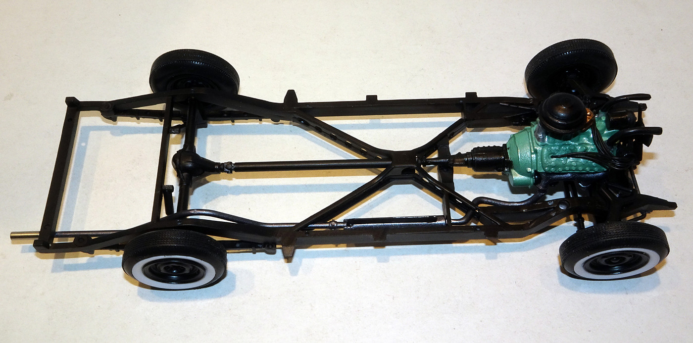

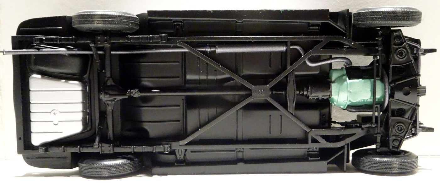

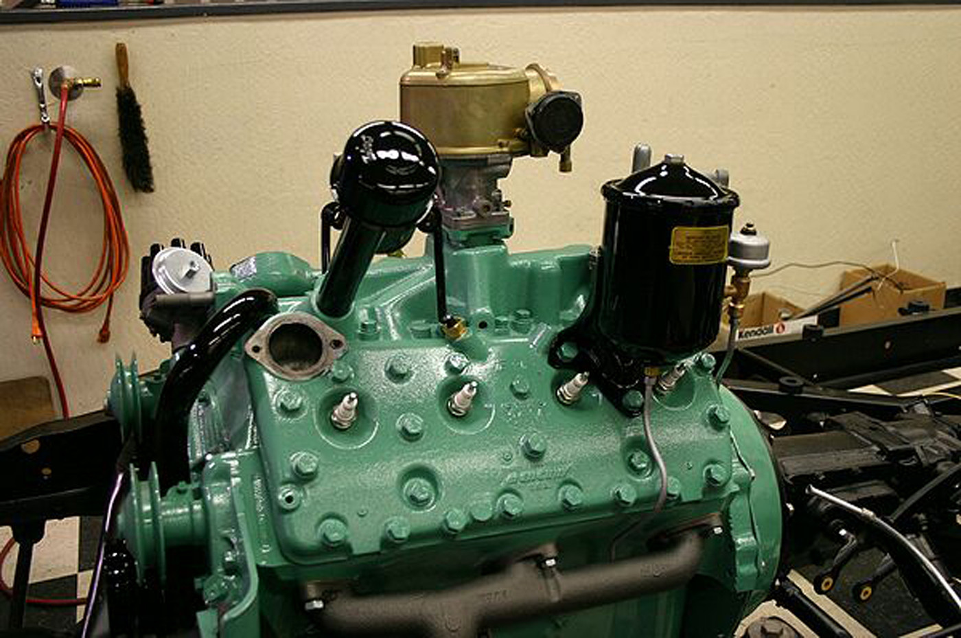

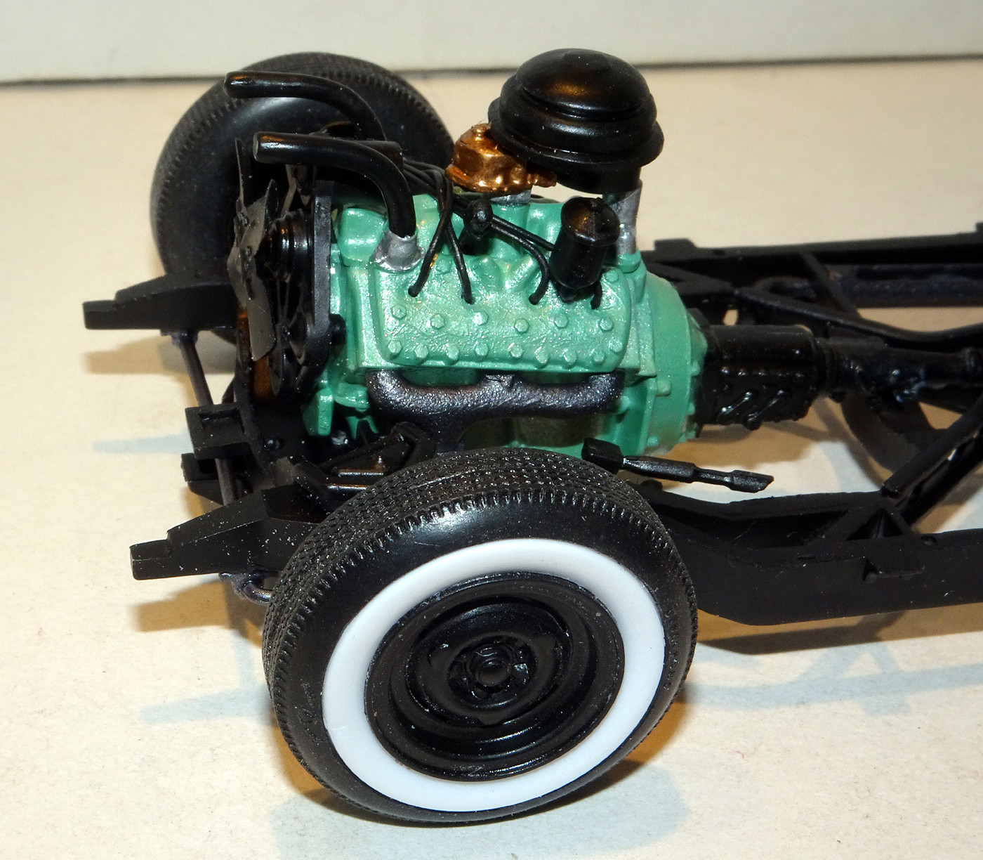

Phildaupho Posted January 22, 2021 Author Posted January 22, 2021 I am very impressed with the Revell chassis and it only but needed minor modification for this project. I used the Brizio restoration photos as a guide to build the rolling chassis. The frame was C’d, the hanger for the left side exhaust removed and the holes were filled for the lakes pipes. The AMT ’49 Merc flathead was built absolutely stock and connected to the AMT exhaust system as far as the muffler where it connects to the Revell tailpipe. I have included a couple of the Brizio photos for comparison.

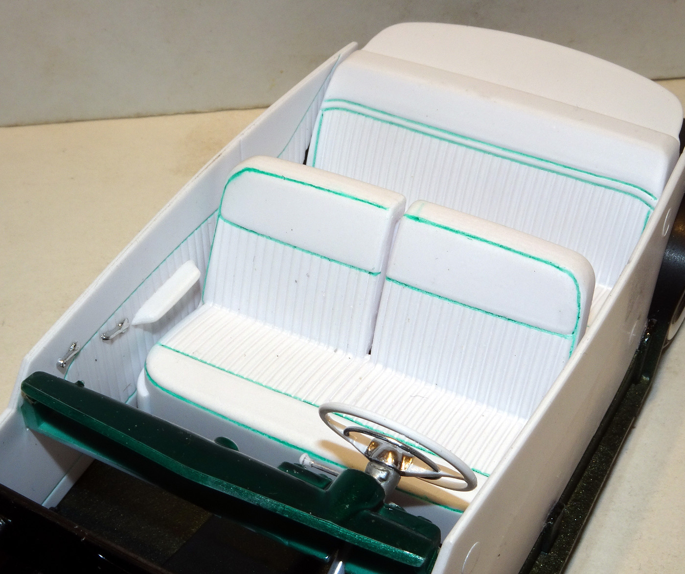

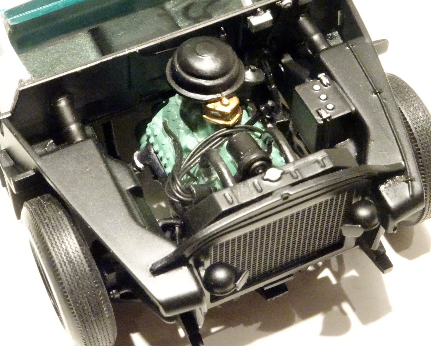

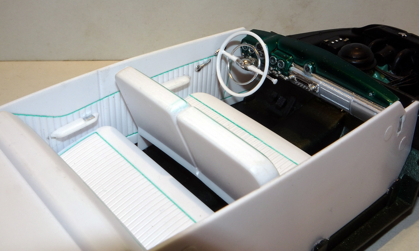

Phildaupho Posted February 10, 2021 Author Posted February 10, 2021 I finally completed the interior and engine compartment so the entire inner body structure could be fully assembled. The split in front seat was cut open. Arm rests, cranks and levers were added to the door panels and a clutch pedal added to the floor board. Green trim done with .2mm archival ink pen which will look OK looking through the windows and to the naked eye. The carpet area is dark green as will be the headliner The engine compartment was built pretty much box stock except for filling the holes in the firewall for mounting a bee-hive filter. The radiator was modified for the dual flathead cooling hoses. I have to say I was very impressed with this kit in terms of the interior, engine compartment and chassis. Now on to finishing the body.
