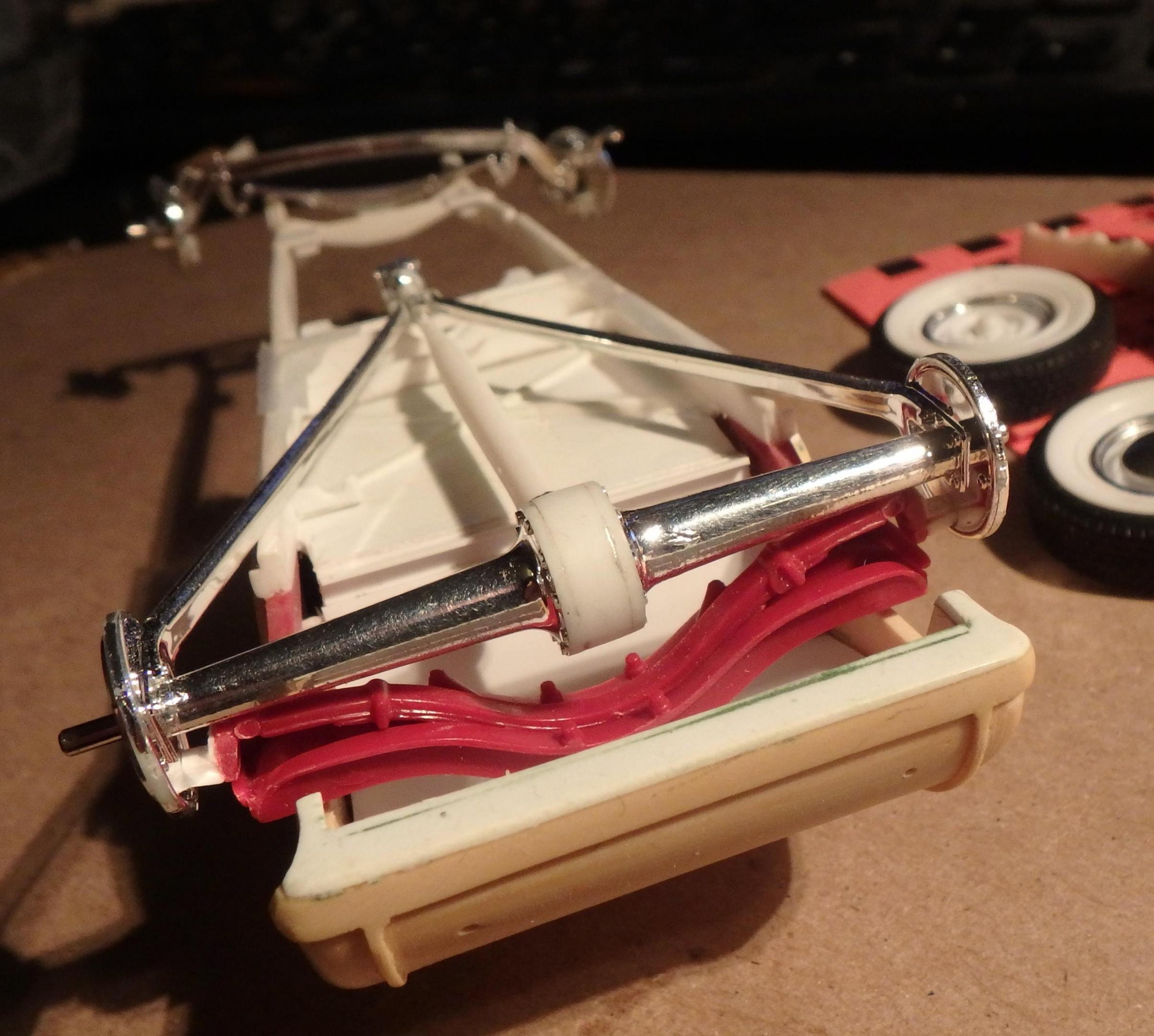

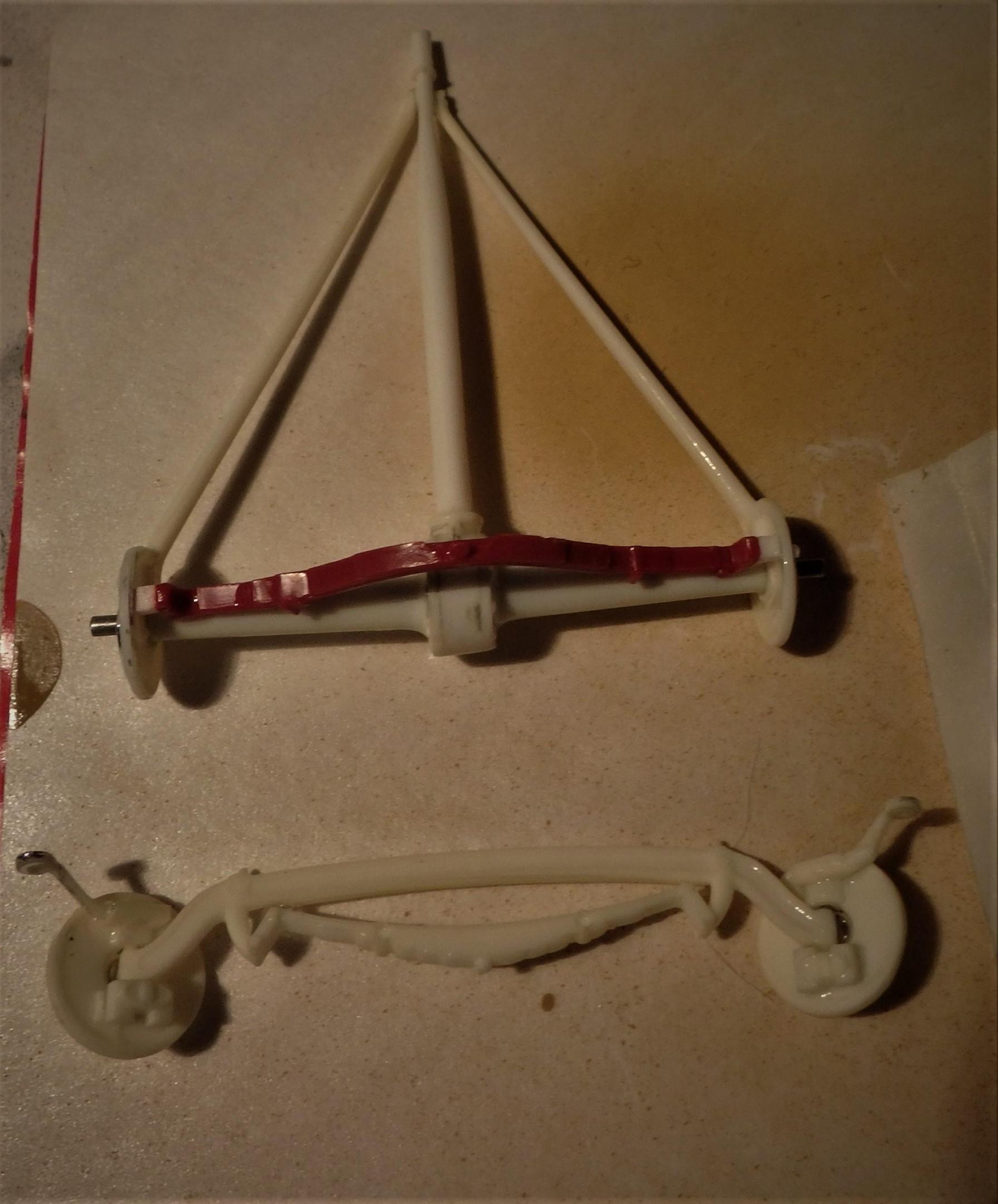

SpeedShift Posted January 22, 2021 Posted January 22, 2021 (edited) While waiting out the painting on other projects I'm pulling out some old projects and picking them back up. I've always like the look of the 27 T. Not many kits of the 27, but I found a resin body years ago and started collecting some aftermarket parts and raiding some kits in the stash to do a hot rod in the traditional fifties style. Will have a flathead Ford engine, some vintage speed equipment, hair pin nerf bars, classic white wall big and littles with baby moons on steelie wheels . Started with a Z treatment on a model A frame , with banjo rear differential. Grafted on a rear cross member and rear leaf spring from a AMT 29 roadster. Edited January 23, 2021 by SpeedShift spellcheck 1

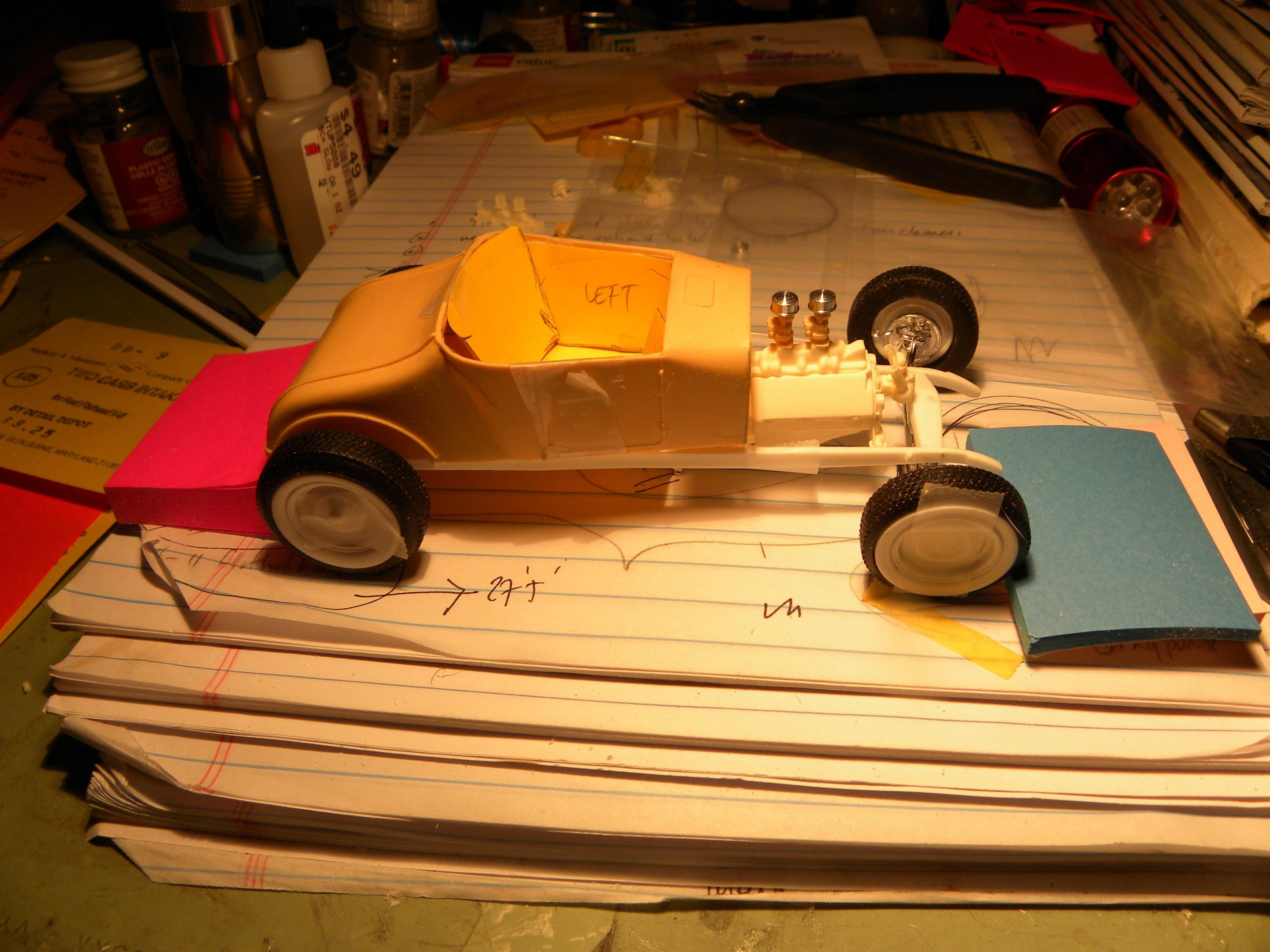

SpeedShift Posted January 22, 2021 Author Posted January 22, 2021 Checking the fit for the desired stance was next. 1

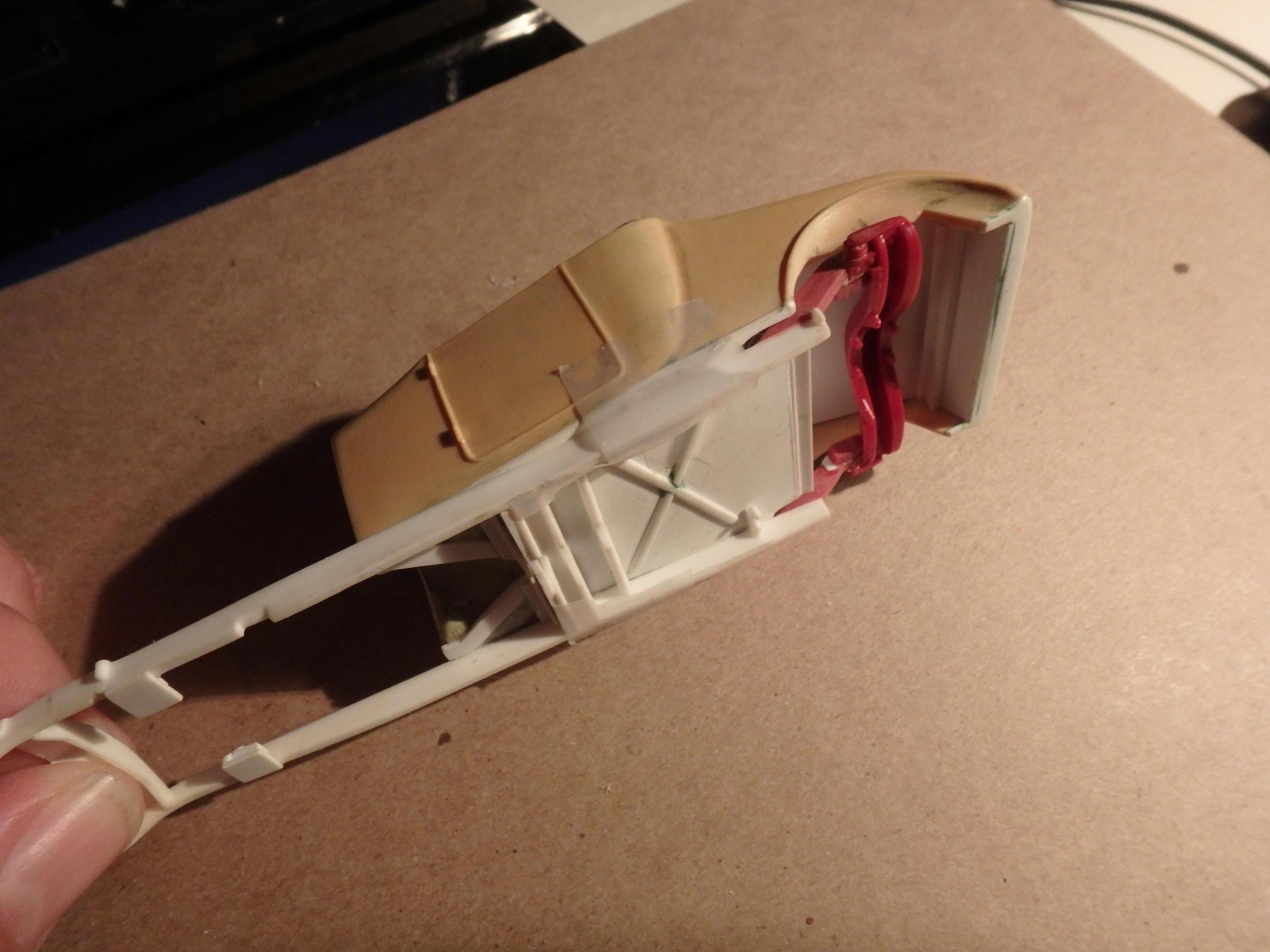

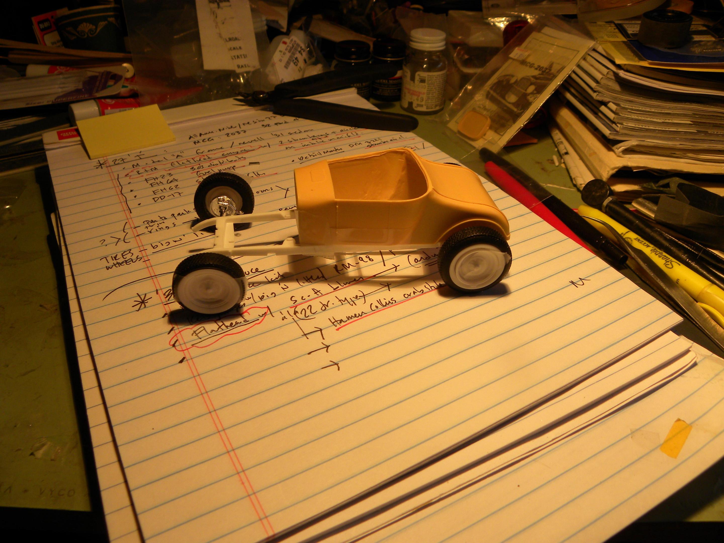

SpeedShift Posted January 22, 2021 Author Posted January 22, 2021 Had to scratch build an interior for the body shell. Plastic sheet and evergreen strip provides the tuck and roll. 1

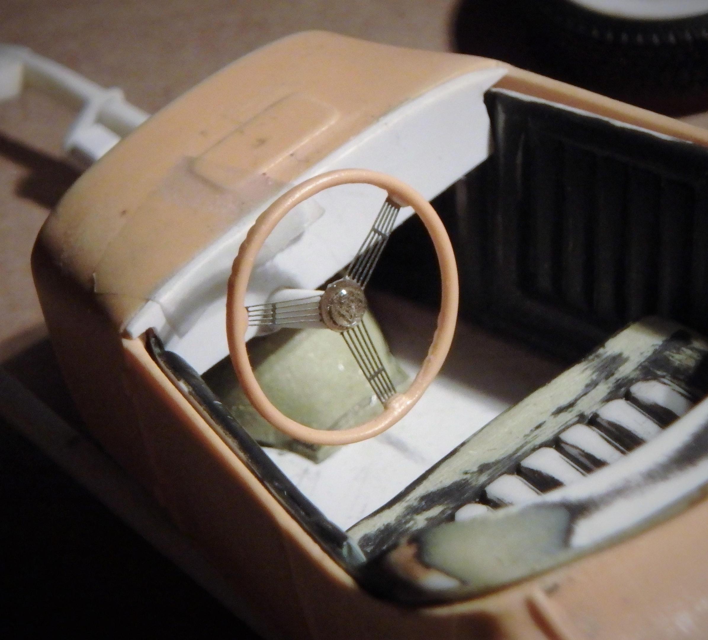

SpeedShift Posted January 22, 2021 Author Posted January 22, 2021 Vintage Banjo steering wheel and I'm looking for vintage gauges. 1

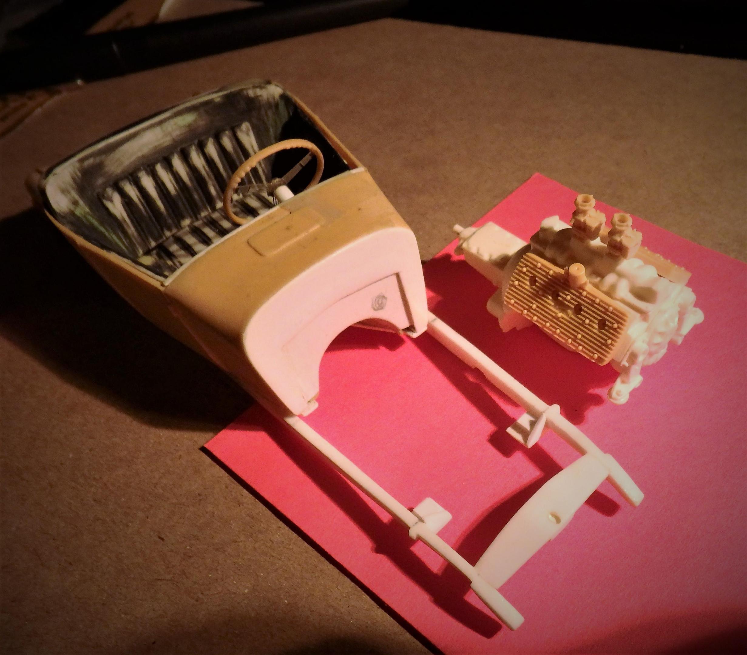

SpeedShift Posted January 23, 2021 Author Posted January 23, 2021 Replicas and Miniatures very nice flathead engine components and Model Car Garage stromberg 97s.... 1

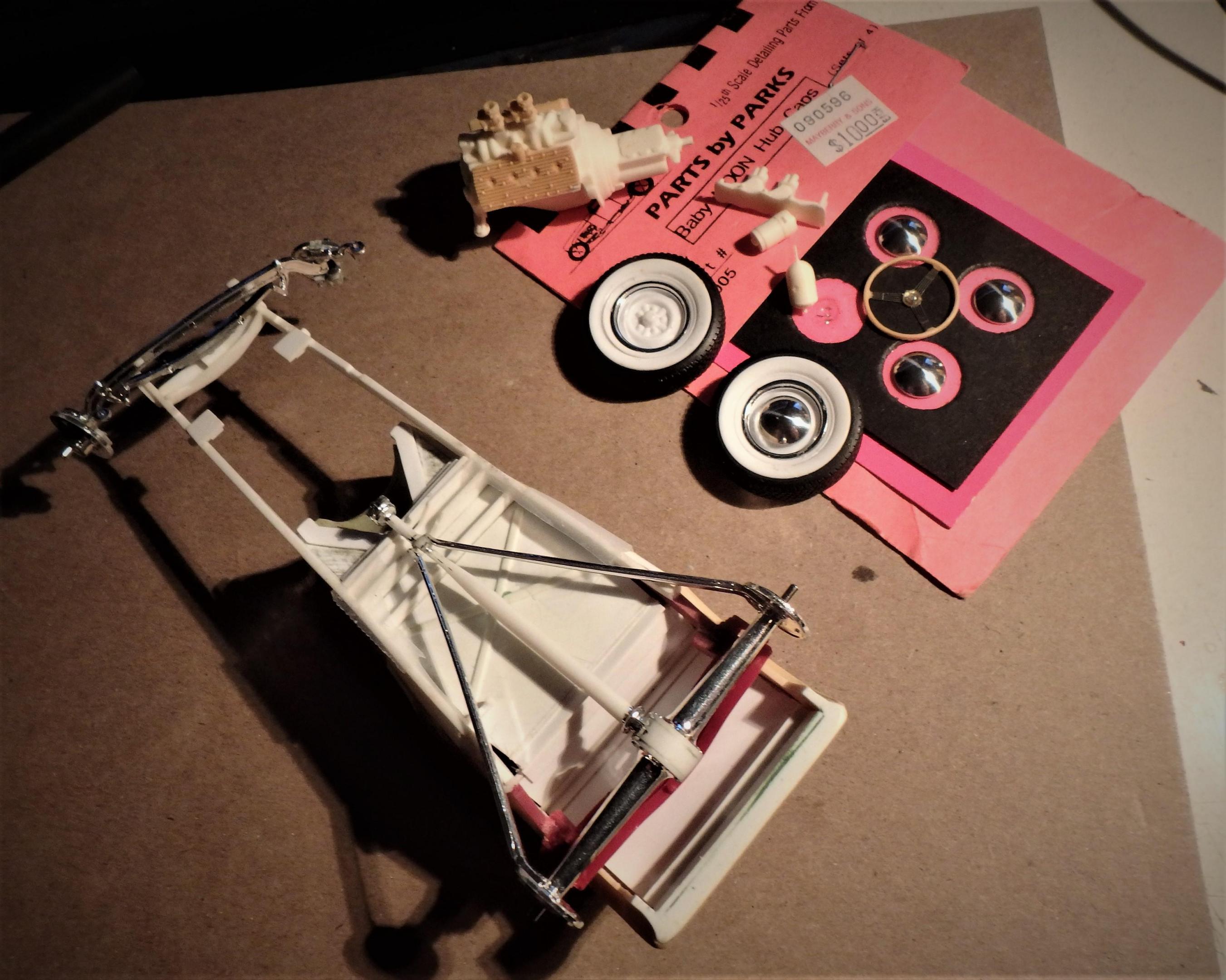

SpeedShift Posted January 23, 2021 Author Posted January 23, 2021 (edited) Tires and wheels are from the Revell Rat Rod PU kit, baby moons re Parts by Parks. Edited January 23, 2021 by SpeedShift 1

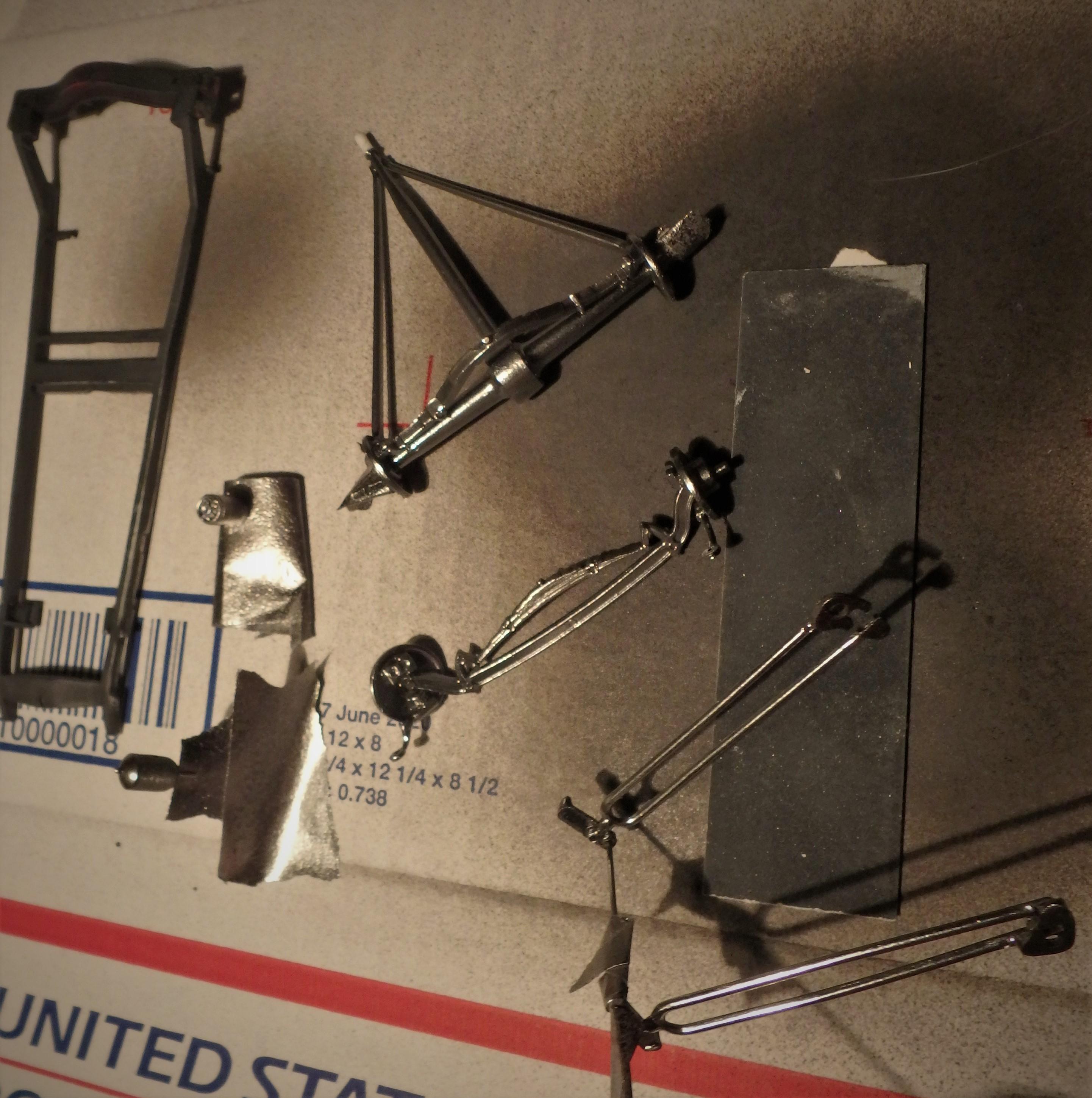

SpeedShift Posted January 23, 2021 Author Posted January 23, 2021 Dechromed axles ready for Alclad.....a 15 minute soak in Zep hair clog remover (a liquid plumber) too the chrome off cleanly.
SpeedShift Posted January 23, 2021 Author Posted January 23, 2021 (edited) After gloss black base coat, Alclad applied on the axles, beehive oil filter, generator, hair pins ...next up....the resin valve covers. Edited January 23, 2021 by SpeedShift 1

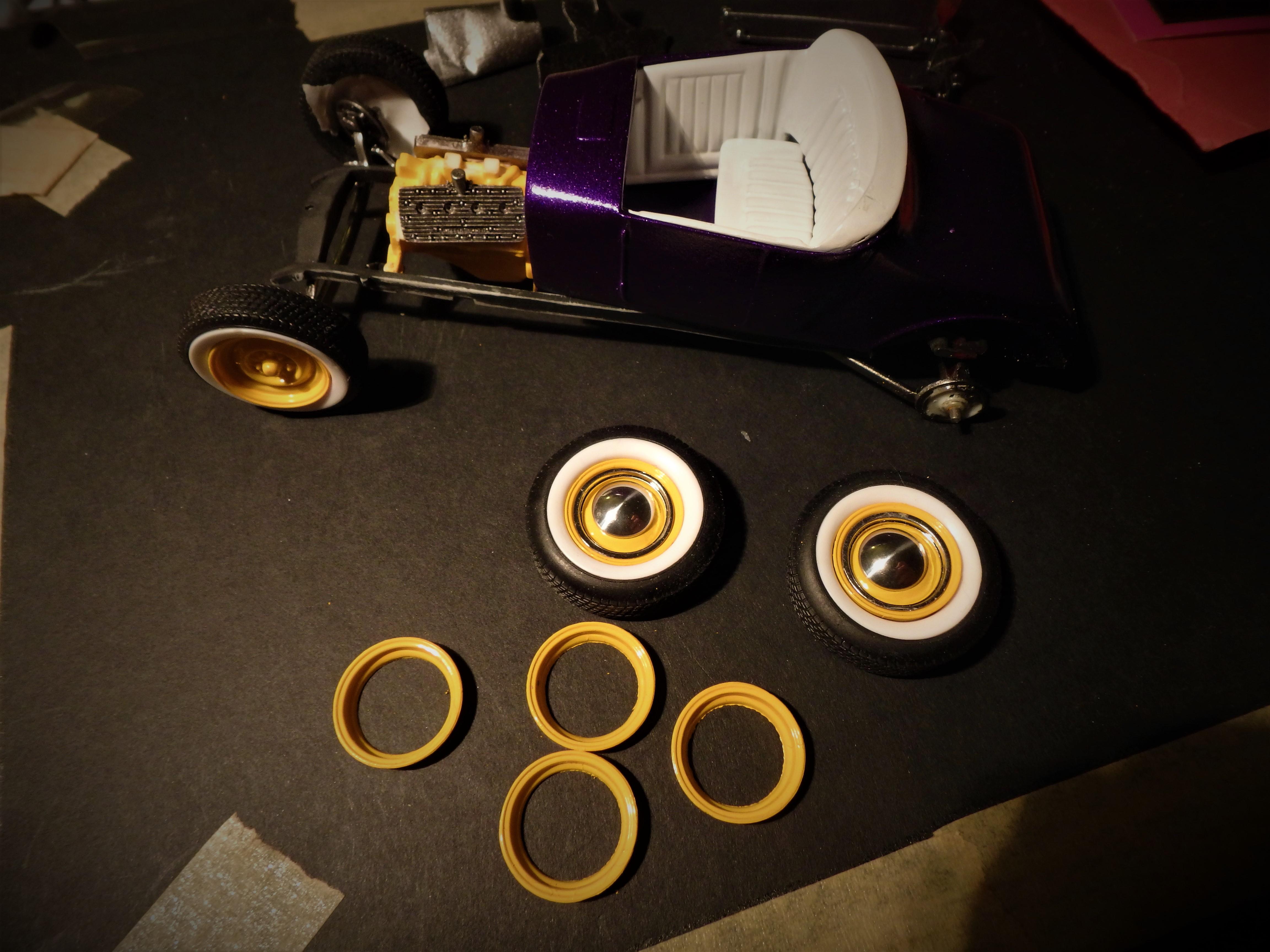

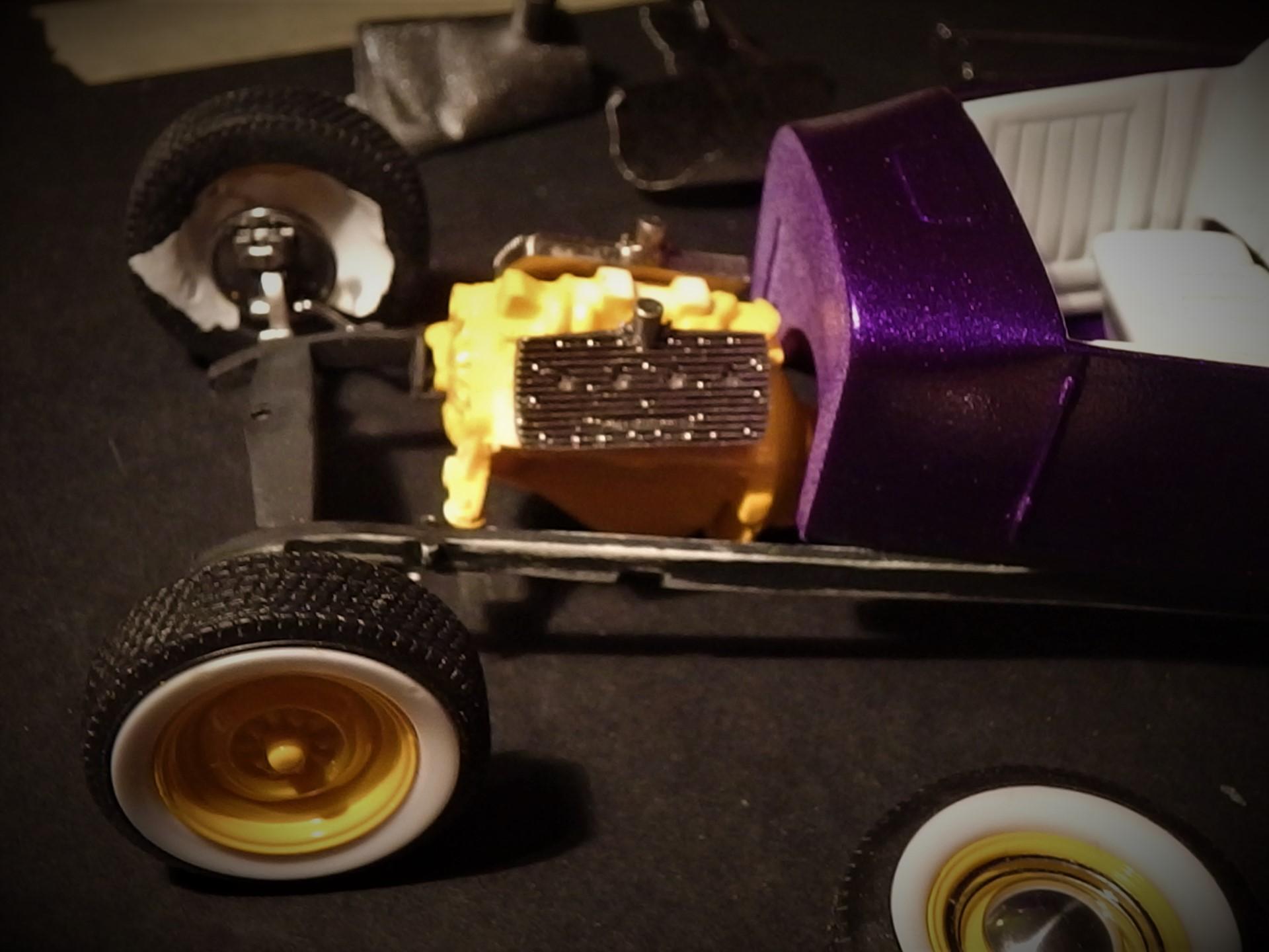

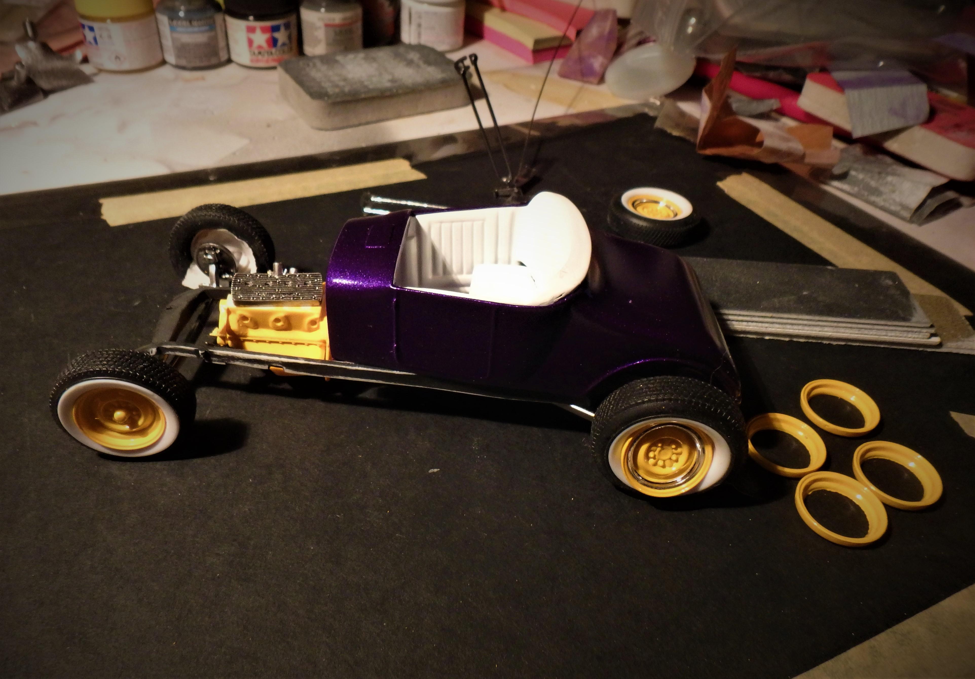

SpeedShift Posted January 23, 2021 Author Posted January 23, 2021 (edited) I've been debating the color scheme for this '27 T in my head ...what I was sure of...I wanted a dark body/grill color with complementary (opposite) color on the wheels/engine Black is a bit too often used, I like red too, but that is a bit common as well. Been reading Al Drakes book on fifties hot rods, there were purple cars back then, even some on the dry lakes. I thought I maybe a very dark blue/violet metallic with red or maybe yellow orange steelie wheels. After searching the rattle can racks I couldn't find exactly what I wanted....the choices: Tamiya Blue Violet........ value too pale, hue a bit bland light blue, a solid color, a metallic might be better Tamiya Deep Metallic Blue......right value, dark, but hue was too blue, not enough violet Model Master Deep Pearlescent Purple enamel.........dark enough but not exciting Model Master/Rustoleum Ford Ultra Violet Pearl Lacquer.........the right value, dark, and a deep violet hue, and its a fast drying lacquer Made a decision, went with it. Here's what I got. ...parts mocked up, not glued yet. The Tamiya Chrome Yellow is a bit too orange for my liking.....wish they had a lighter yellow in a spray can. Edited January 23, 2021 by SpeedShift
