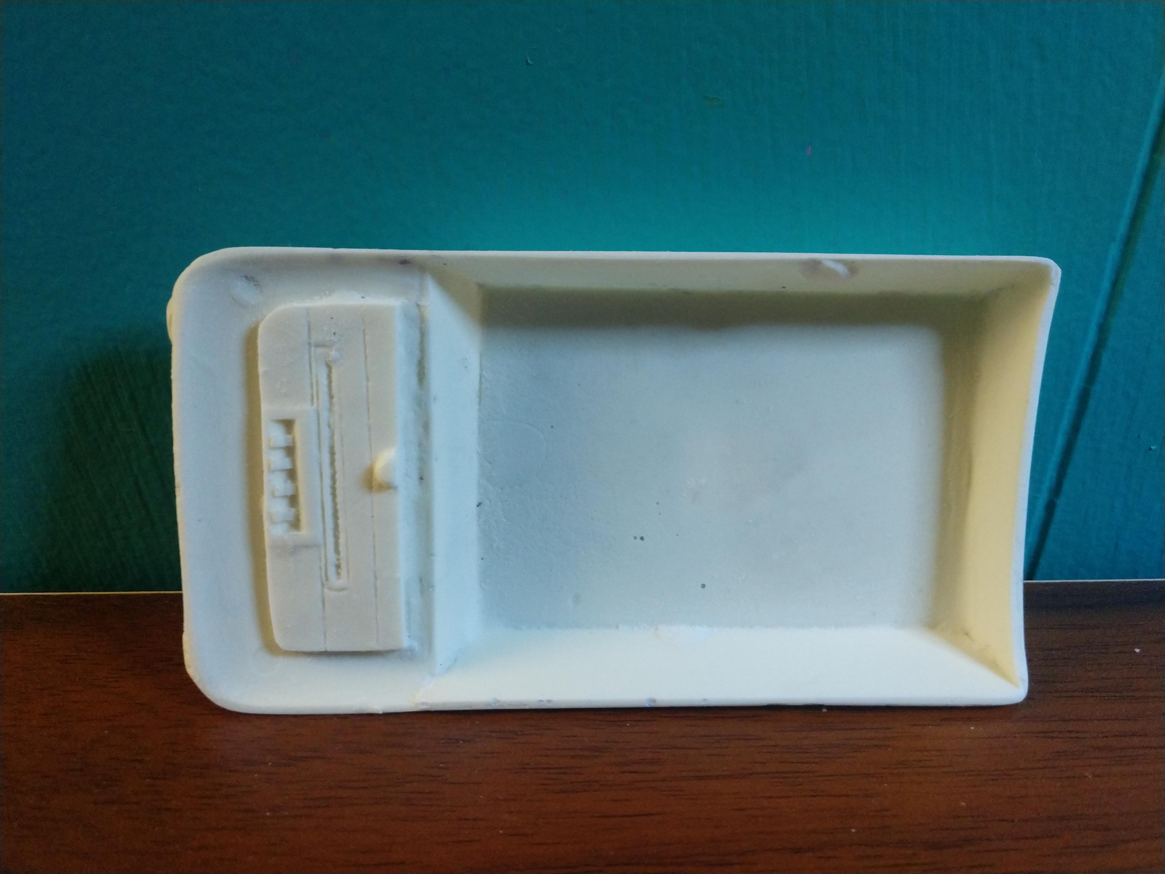

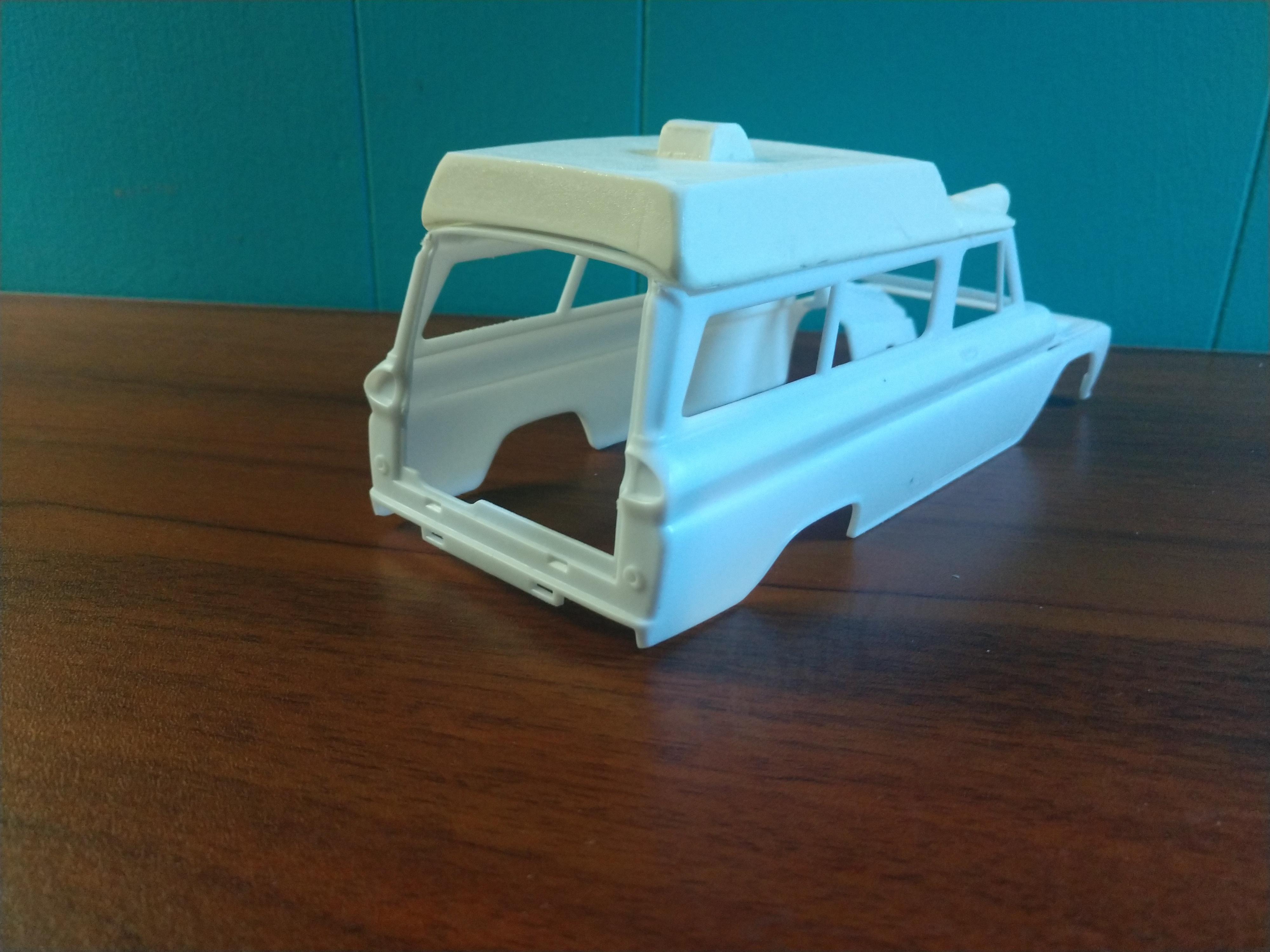

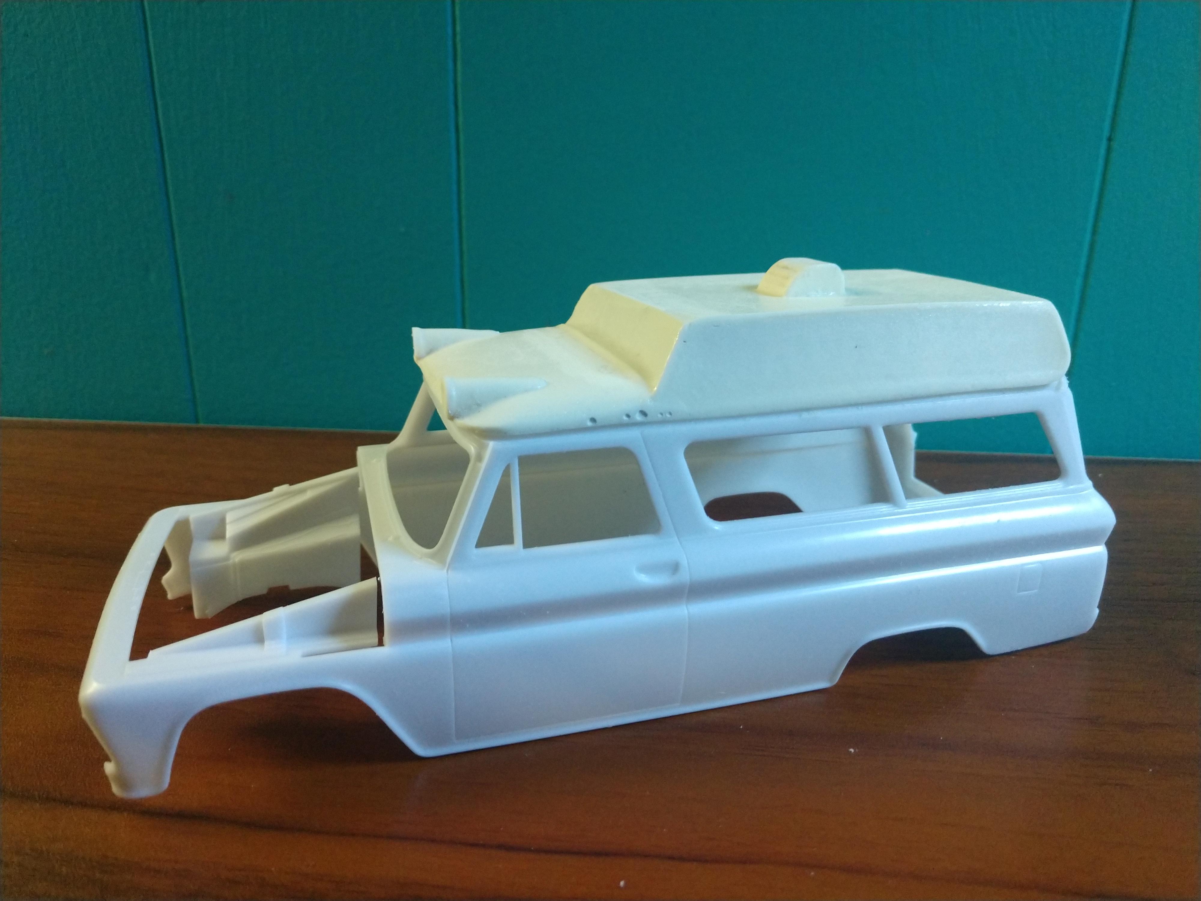

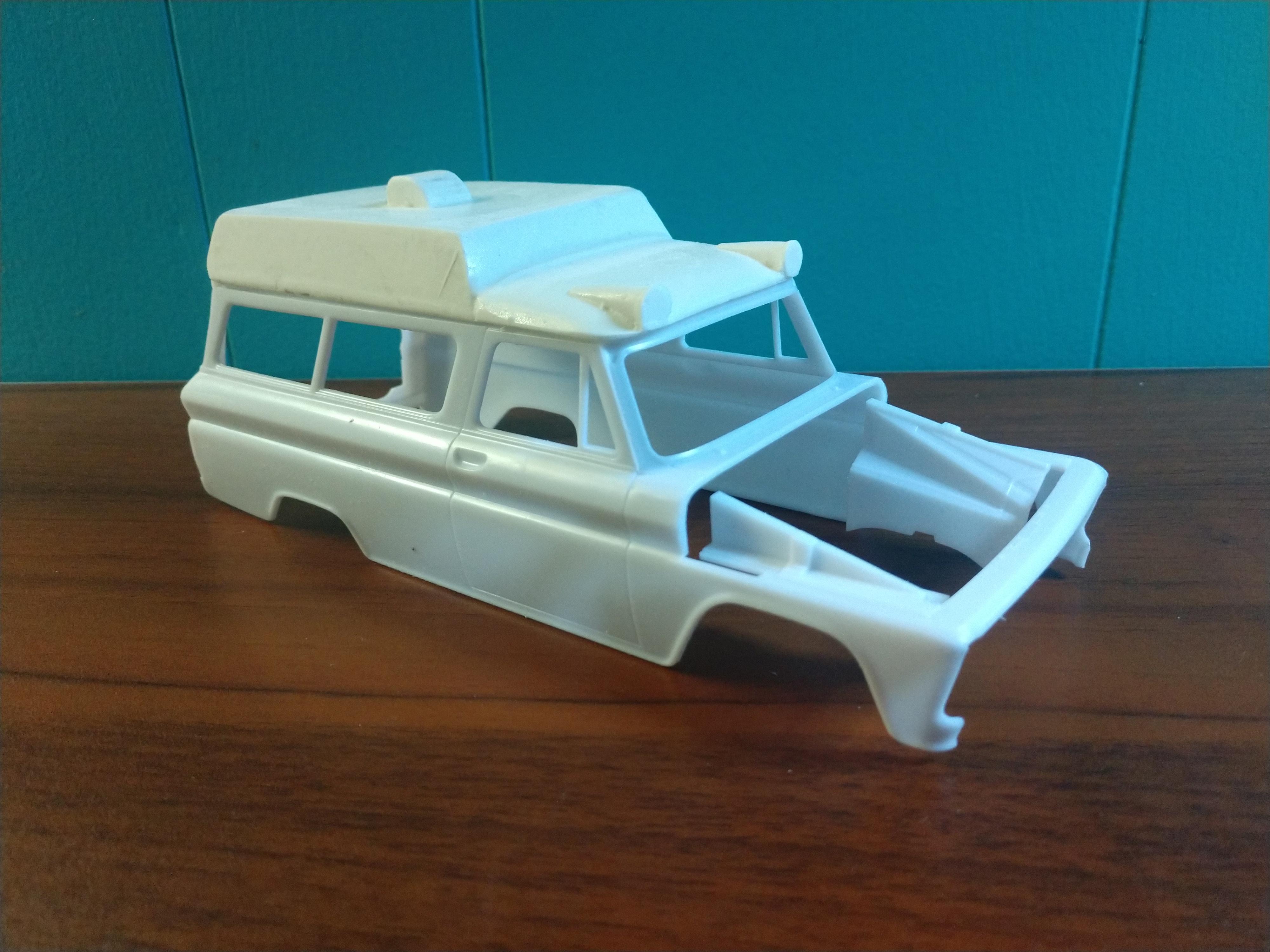

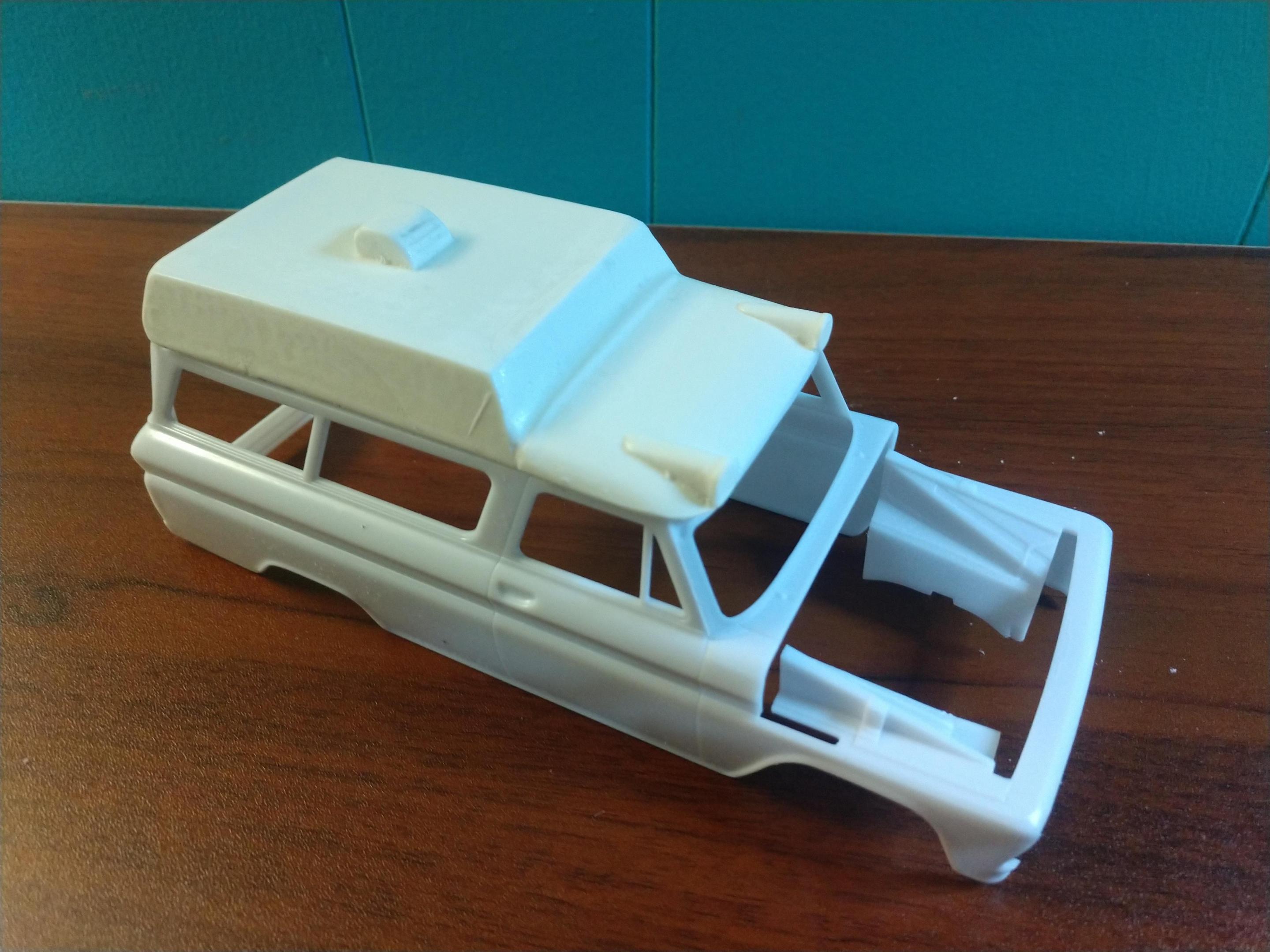

BIGTRUCK Posted March 18, 2021 Posted March 18, 2021 (edited) Being retired now is awesome ,I can actually start something and finish it. Waiting for paint to cure on another project I dug out the Revell 66 Suburban and will convert it into an ambulance using the "Three Inches Under" high roof conversion. Revell made this pretty easy by leaving the roof skin off the kit. This one will take some time and it will not be a replica of any actual department. The resin piece has a few pinholes and thin in one area, it needs some clean up to fit snug and once its on , the body and roof will need some lines smoothed so it looks like it belongs.It also has some driver overhead detail .None of these issues would be something thats a deal breaker. Edited March 18, 2021 by BIGTRUCK

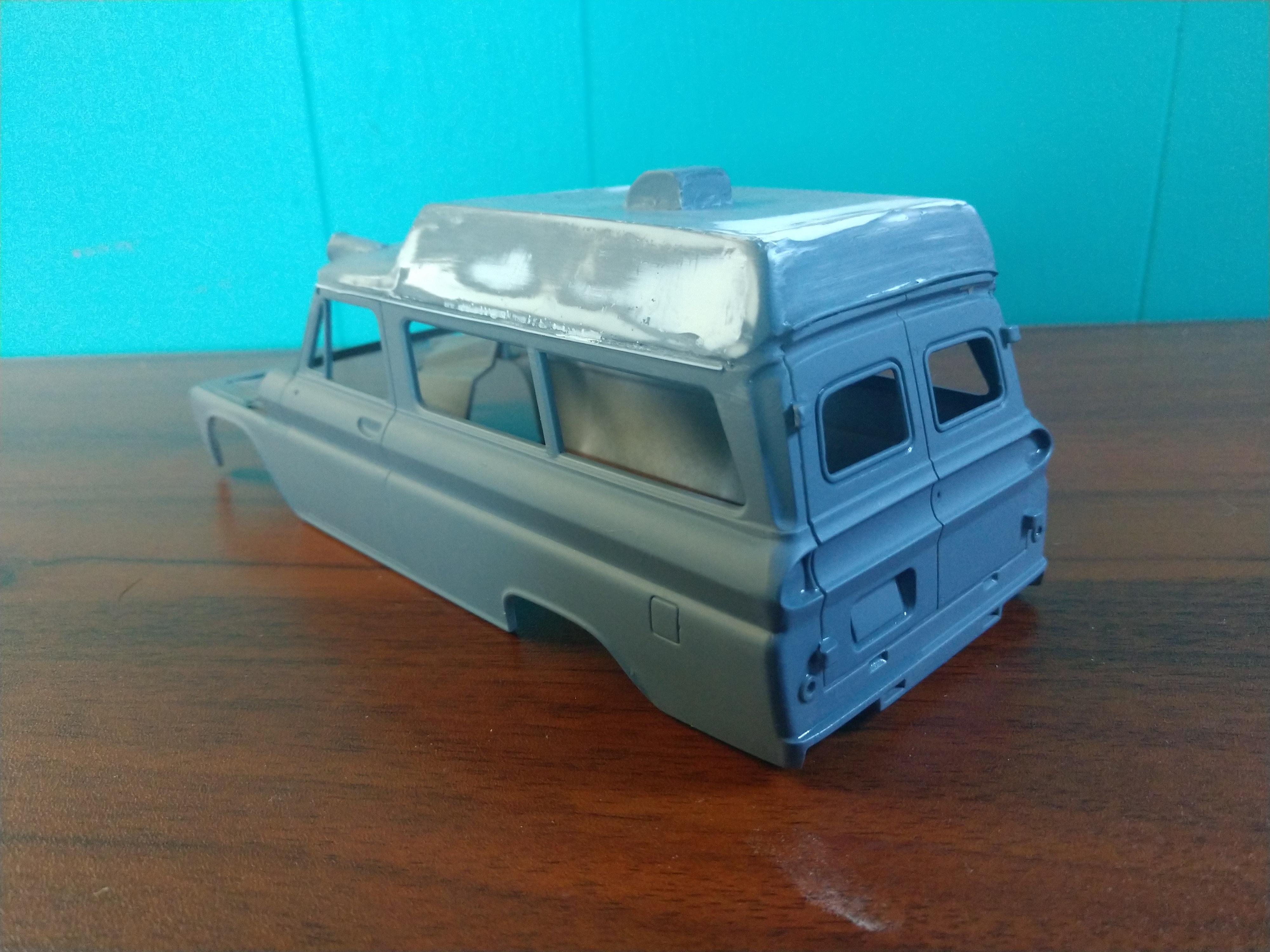

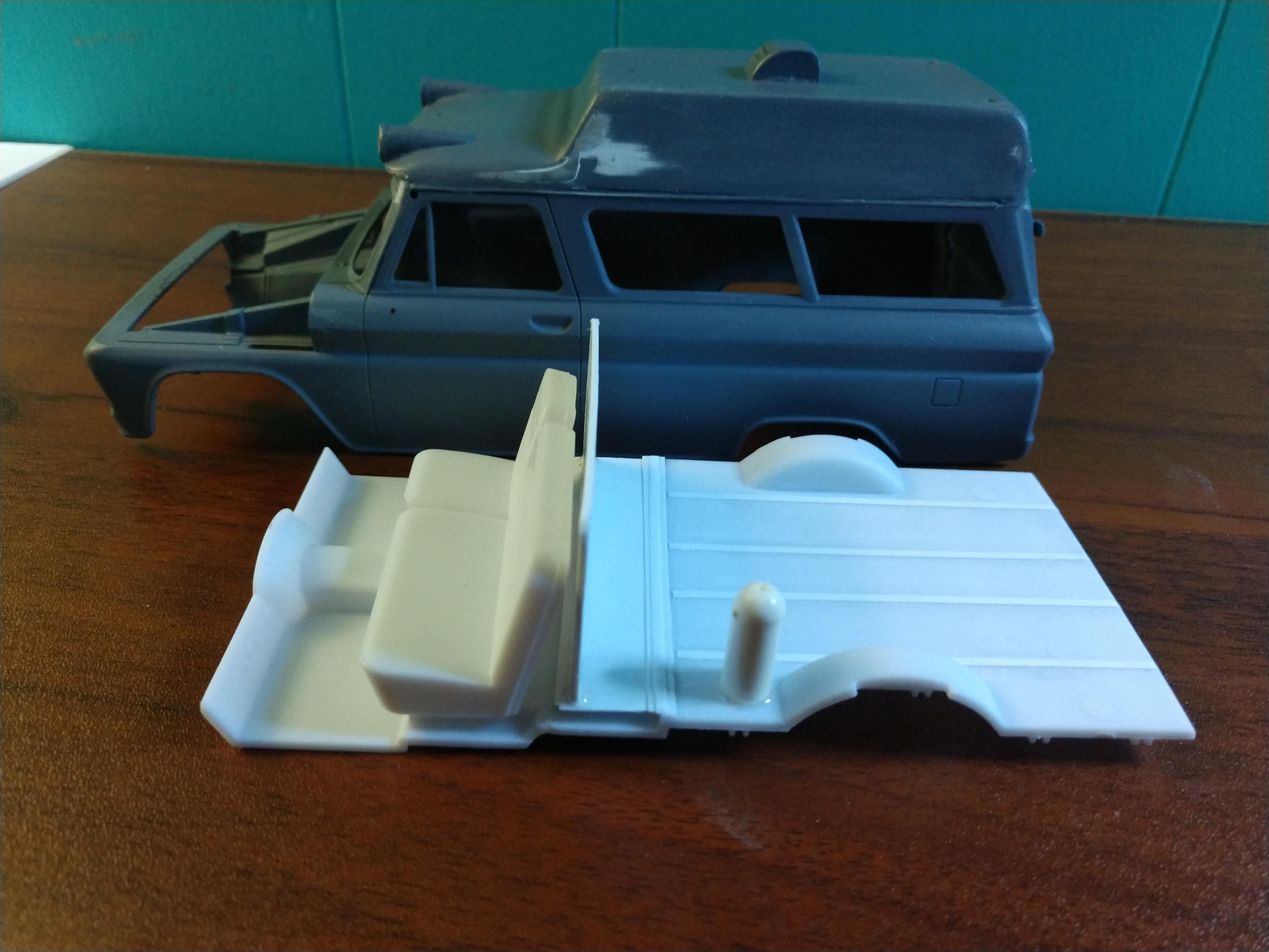

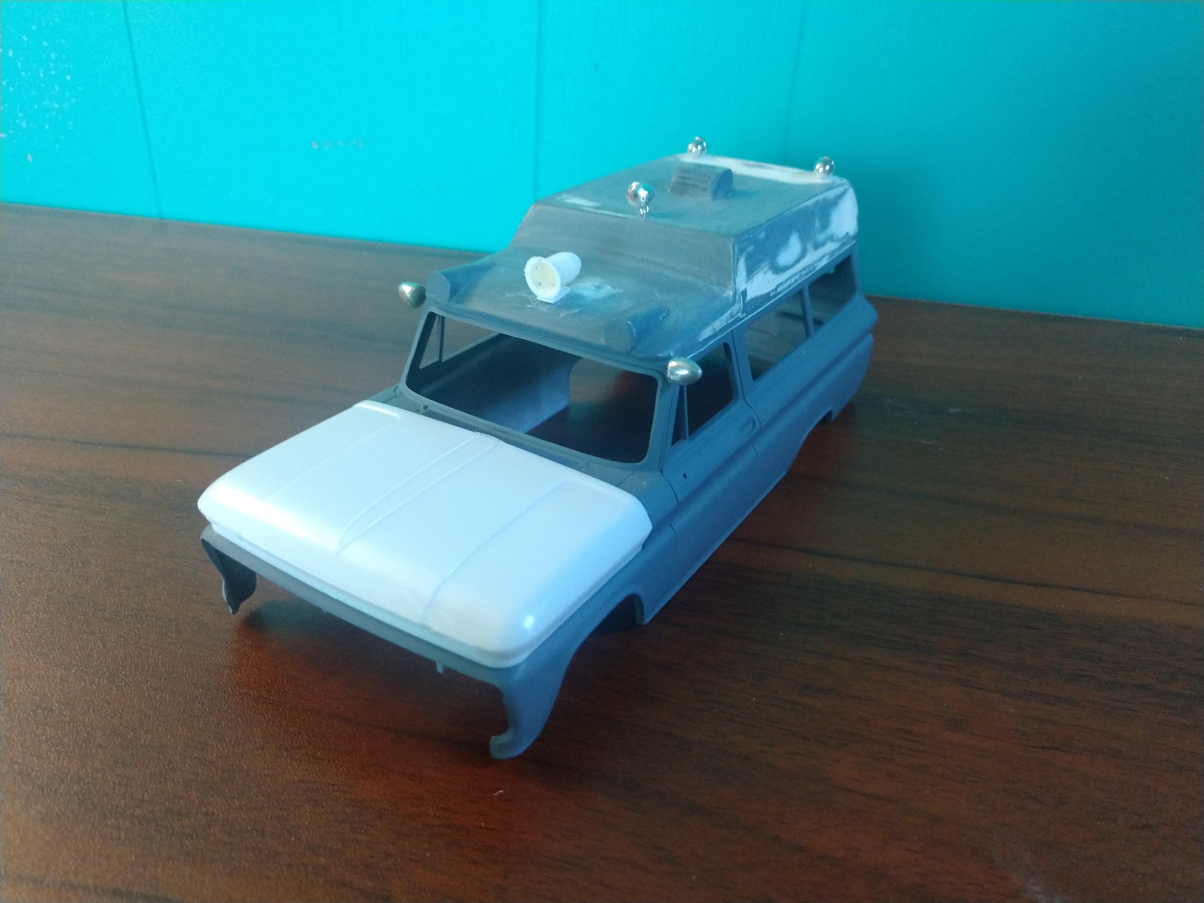

BIGTRUCK Posted March 19, 2021 Author Posted March 19, 2021 Roof mods 95% done, some touch up here and there then start engine and chassis. Added side and rear gutters at new roof line.

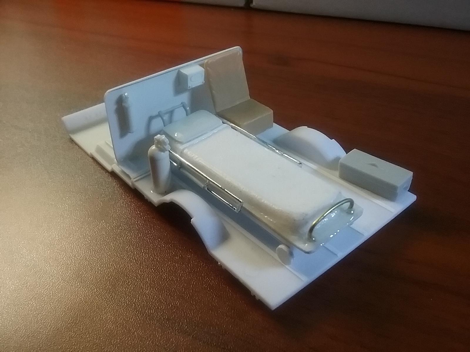

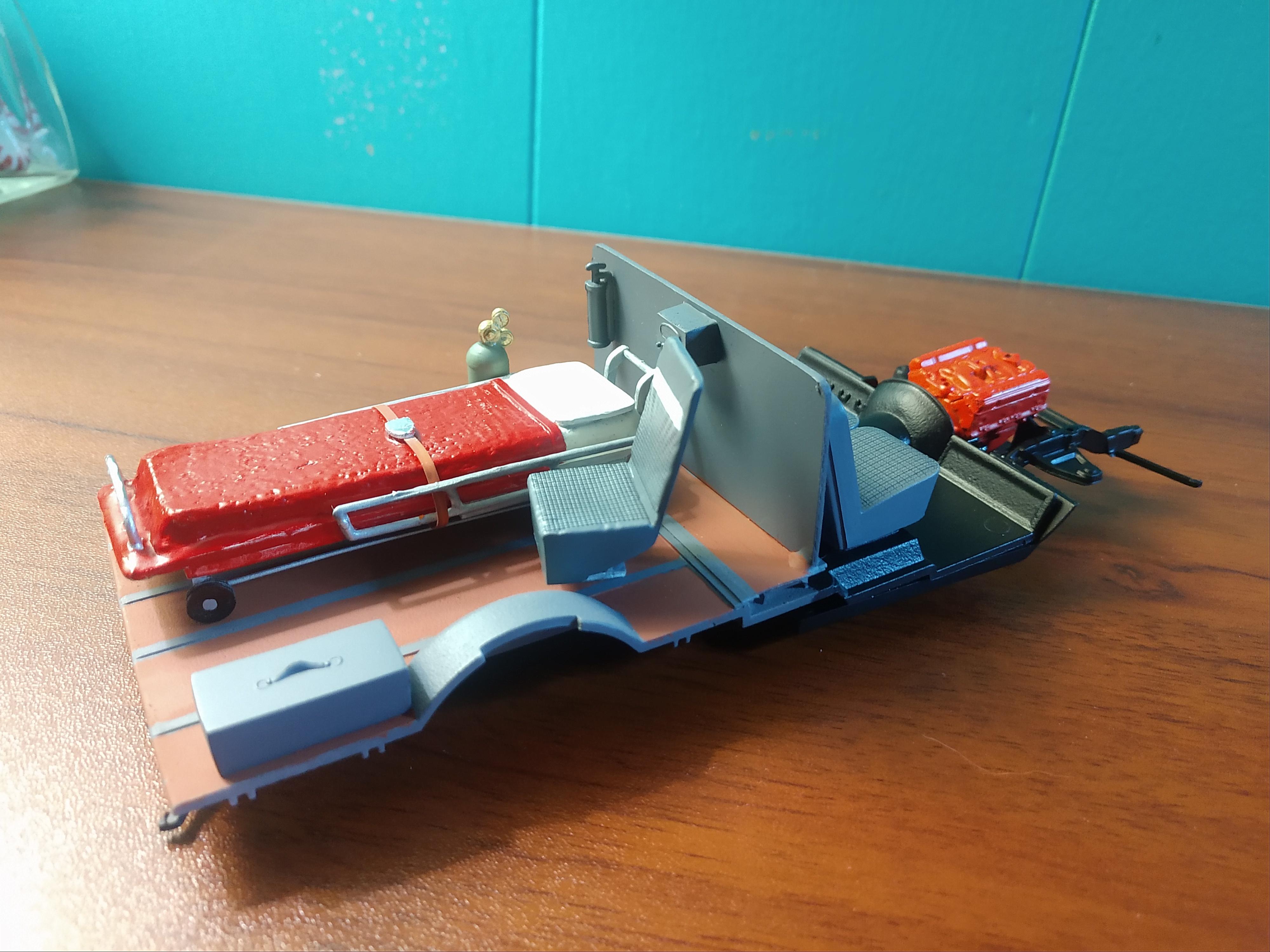

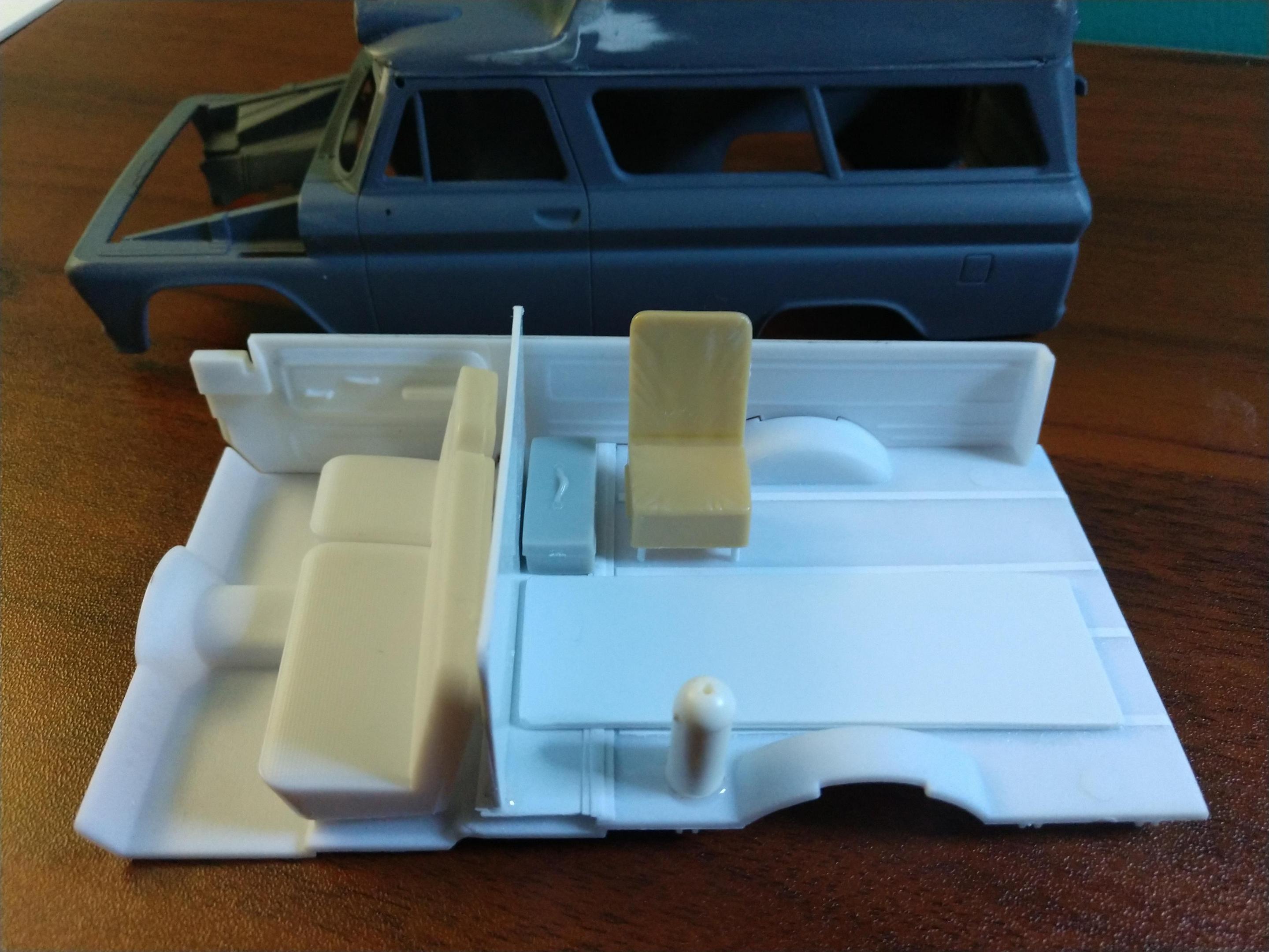

BIGTRUCK Posted March 23, 2021 Author Posted March 23, 2021 Got the interior rear floor area how I need it to be and did a quick mock up and on this time I'm going to build a simple gurney using the Johan Ambulance gurney as a guide, I cut out the size it will be and have it on the floor for fit. Built the partition and found some other goodies that will work.

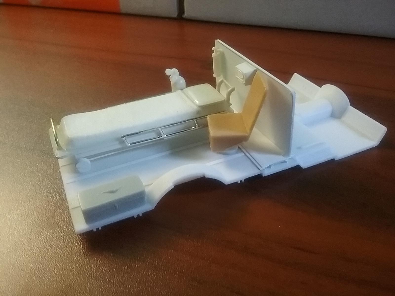

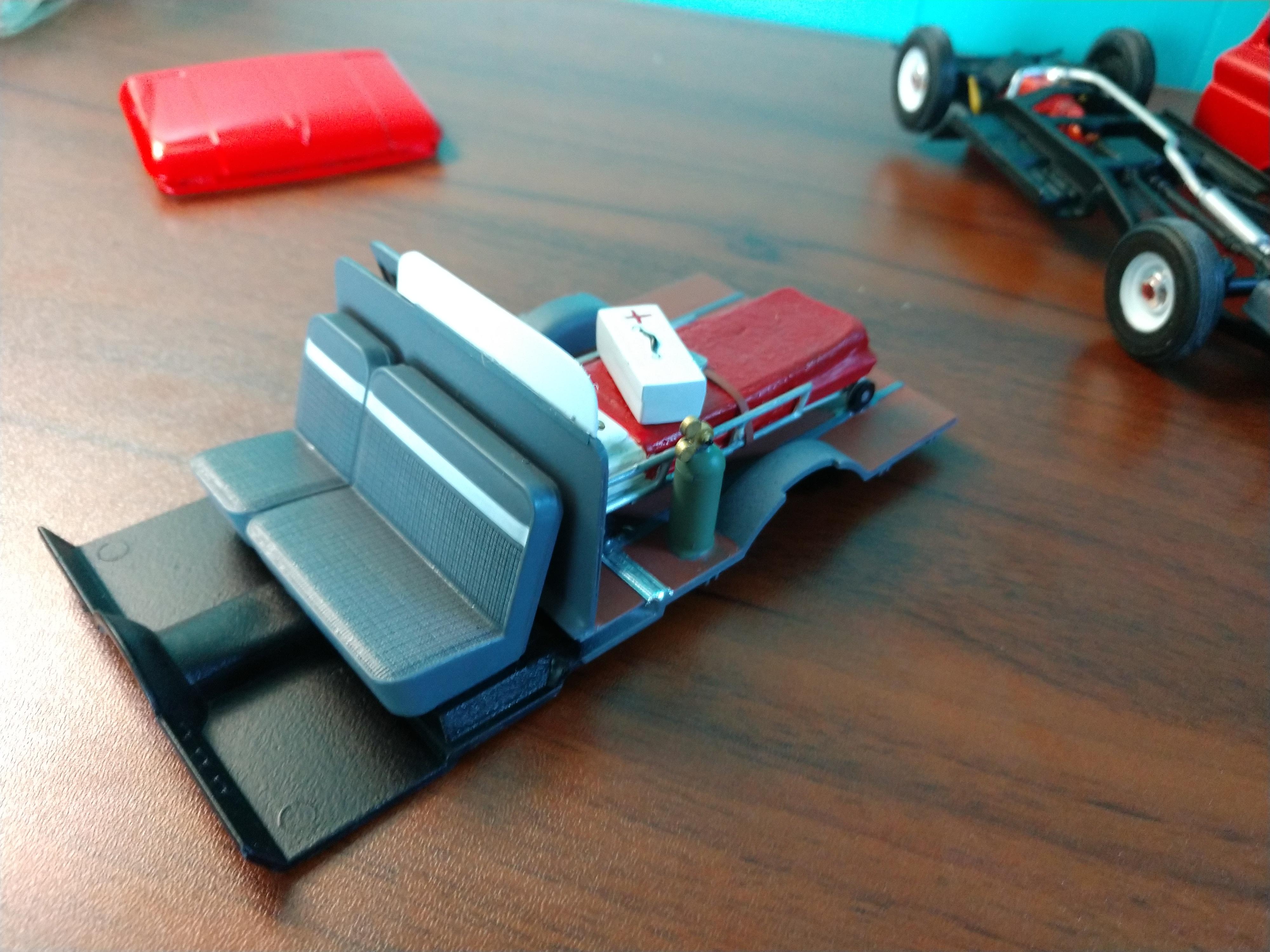

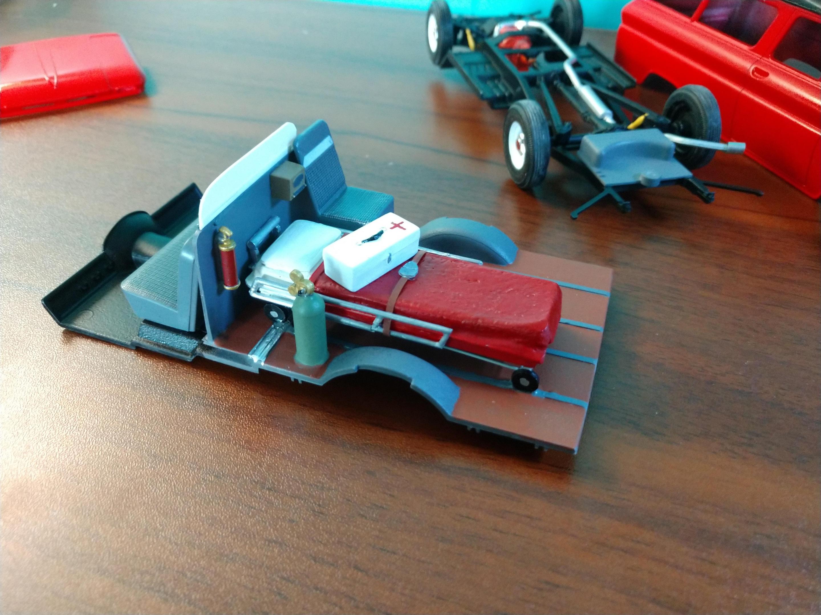

BIGTRUCK Posted March 27, 2021 Author Posted March 27, 2021 The rear area with gurney mocked up and ready for primer / paint. For the gurney I chose to try my hand at making my own so first I borrowed the main part of the Johan ambulance gurney and made a clay mold. I had bought a few bottles of amazing resin "A" and "B" and made the main bed. Mounted that on some evergreen plastic, made the pillow from epoxy. Tires are evergreen plastic cut with a paper punch and glued 3 to make 1 tire. The main side rails are made from ,if I remember right , roof rails from 55 Chevy wagon .Found a few more items for effect in the back.

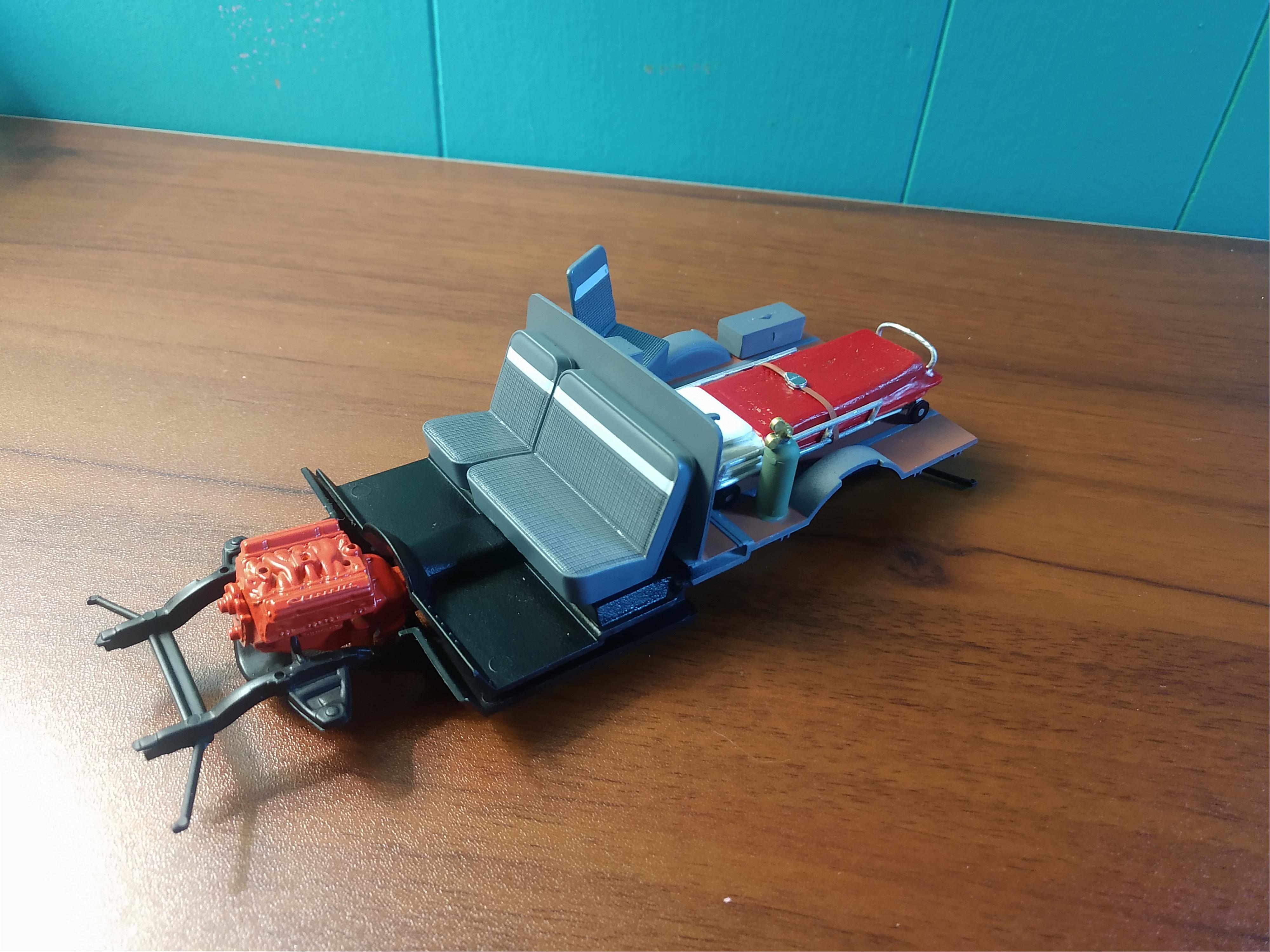

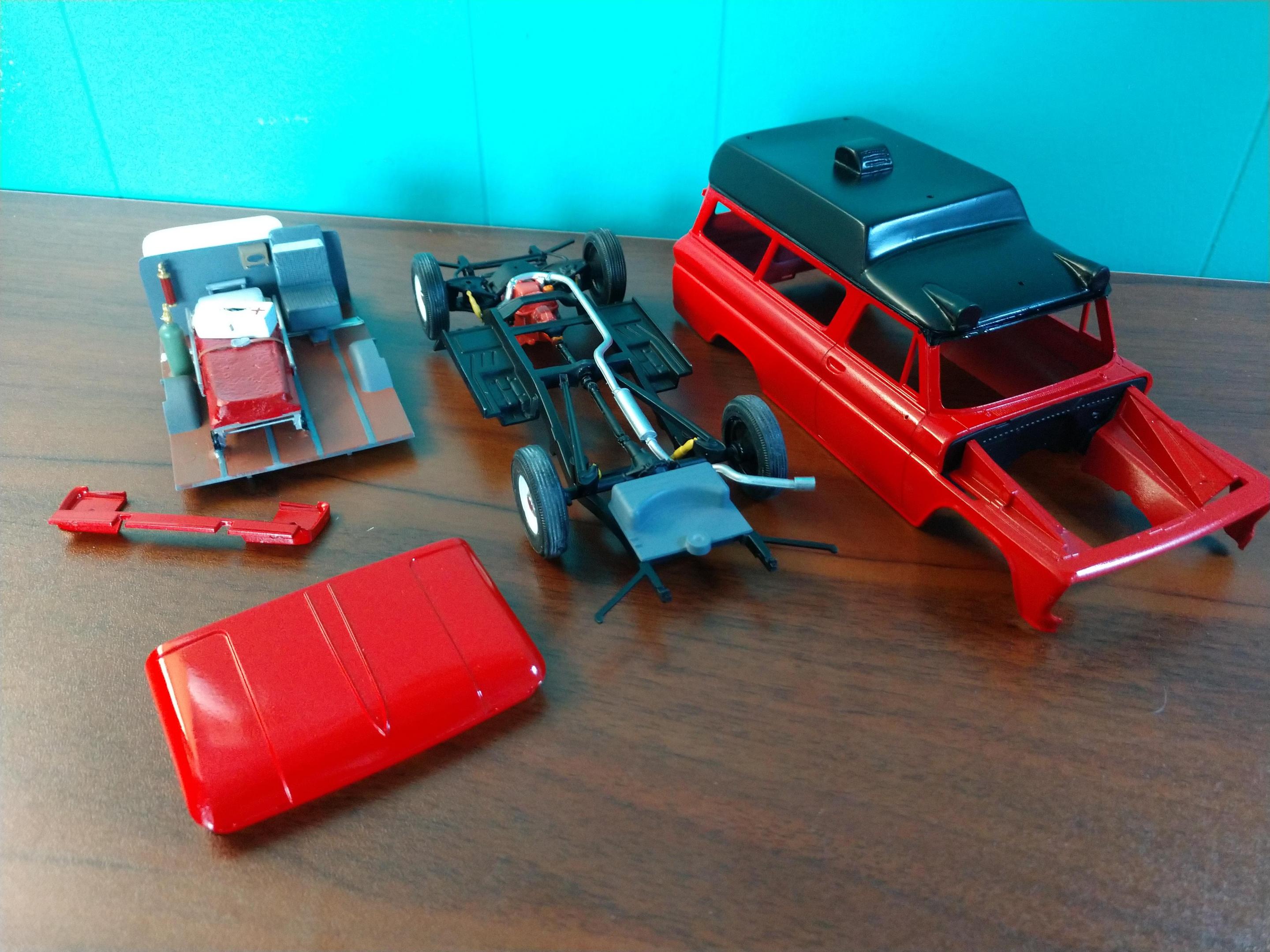

BIGTRUCK Posted April 1, 2021 Author Posted April 1, 2021 (edited) With the gurney completed, I started painting the rest of the business area . Alot if detail painting left to go and need to foil the floor strips. I really like the seat pattern and the seat /dash decals Revell put in this kit and I added that seat pattern to the rear jump seat. This kit has mega possibilities for other builds. Edited April 1, 2021 by BIGTRUCK

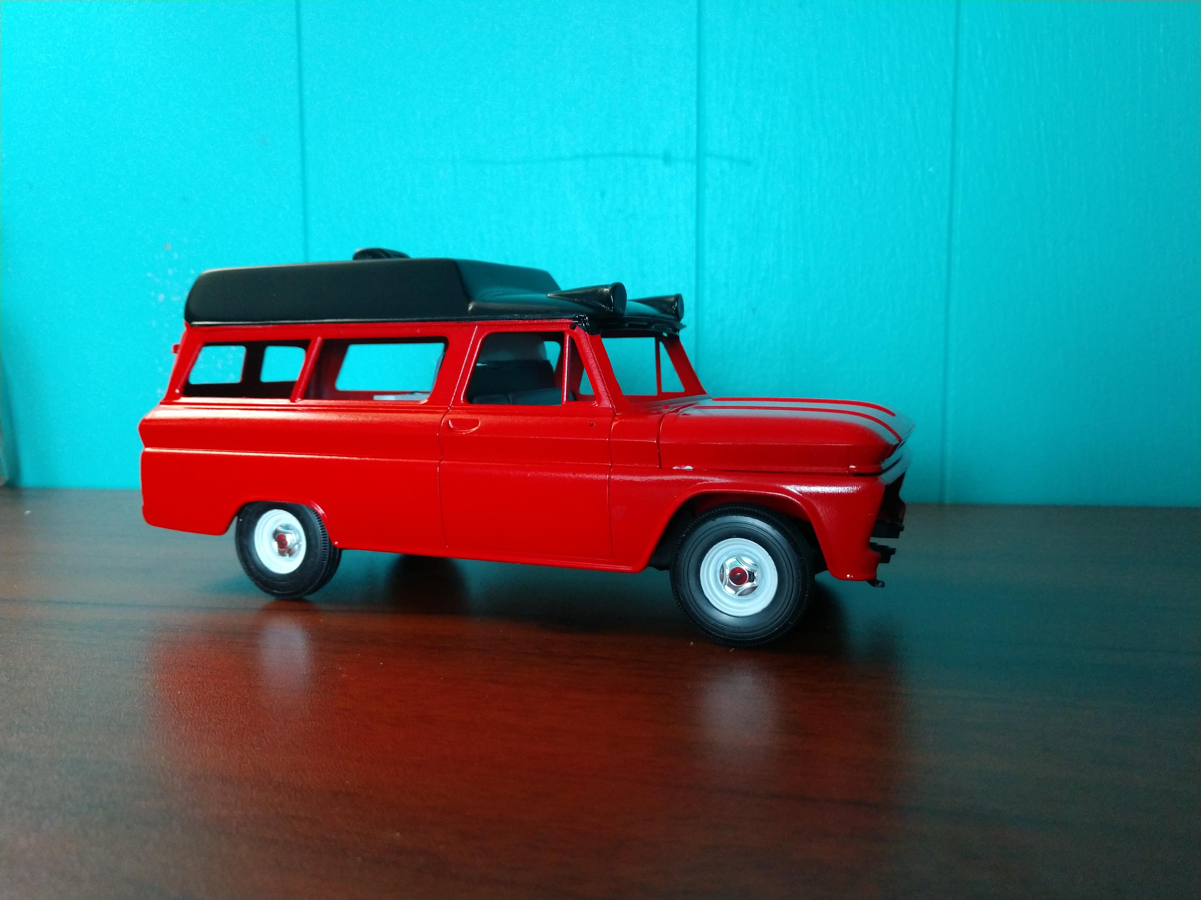

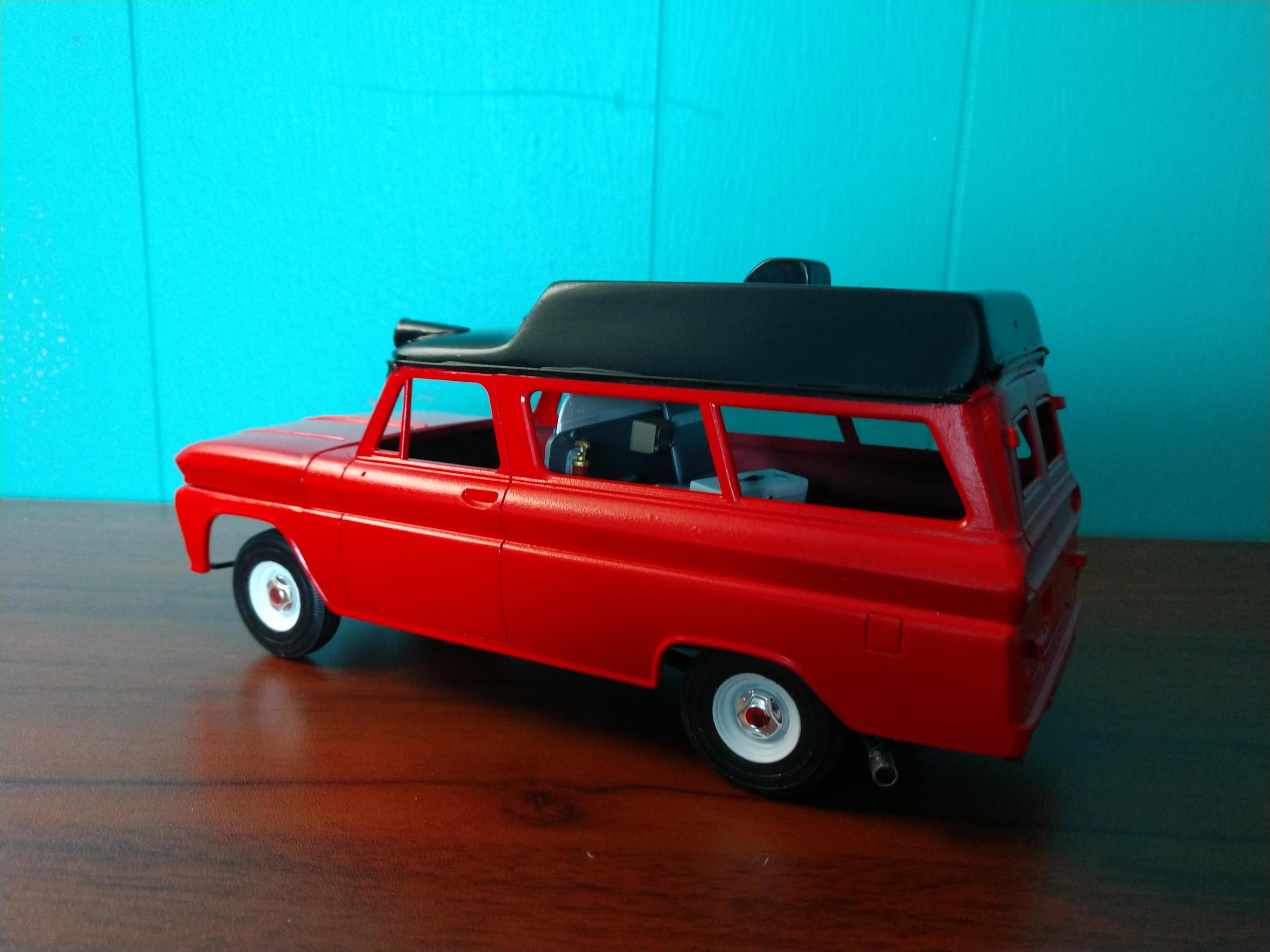

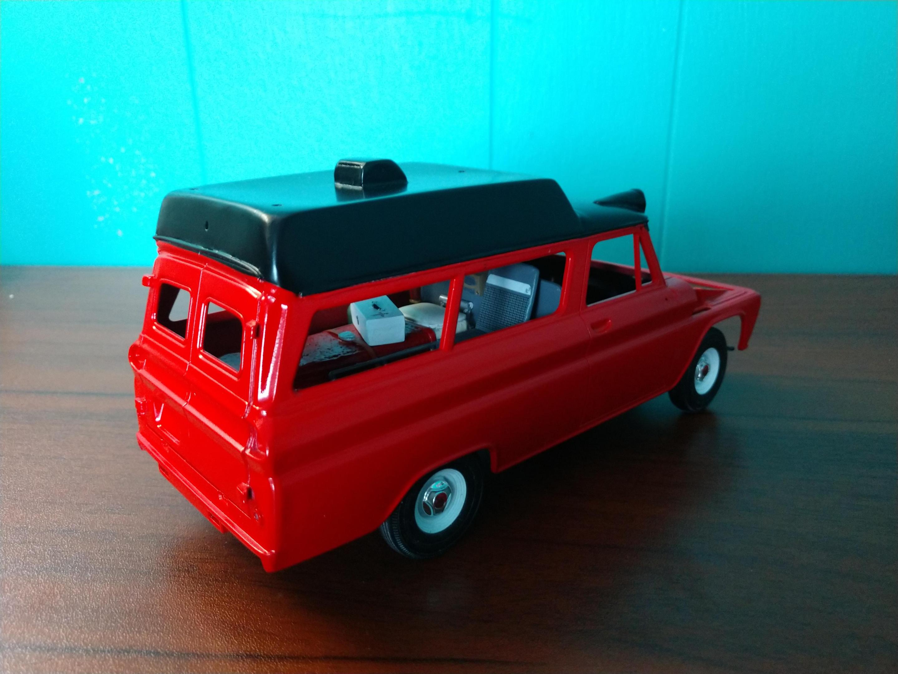

BIGTRUCK Posted April 7, 2021 Author Posted April 7, 2021 Body color I decided on Chicago Fire Dept. I bought some decals for Chicago Fire, not period correct but either is a 66 Chevy Suburban. Its about 70% done and the only thing left to go wrong would be all that glass, and that should be good?.
BIGTRUCK Posted April 7, 2021 Author Posted April 7, 2021 (edited) ?. On the decals too, never used any from this seller, they look great. Edited April 7, 2021 by BIGTRUCK
