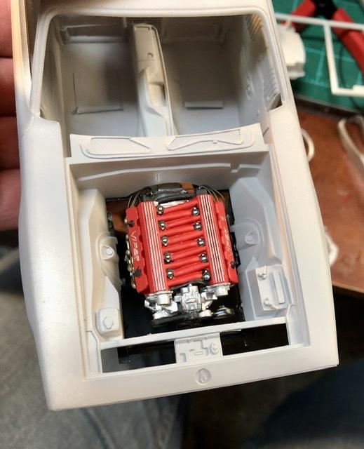

Andrew D the Jolly Roger Posted July 2, 2021 Author Posted July 2, 2021 (edited) 1 hour ago, BDSchindler said: yeah, I agree...Going to have to find a way to do it. I don't trust my meager talent blending the front valance, even with it being black paint. One more question regarding the wiring under the hood. you've compelled me to at least try to go to that level of detail. Where did you find insulated wire that small? I'm assuming it's a combination of smaller gauge wire. To stick a boogar in the works, I plan on stuffing a Viper Engine under the hood. Test fitting it tells me it will fit convincingly so (note, image shot prior to removing the molded in battery and washer bottle)... Hey there Brian, Looks good, fascinating idea of the Viper engine in there! Looks like a good fit, at least at a glance, although I'm no expert; aircraft are my usual specialty, hence all the probably-basic automotive questions I tend to pose here. As far as the wire, yes, I keep a stock of multiple sizes of insulated wire; 3 basic sizes, although I do have larger ones for the larger hoses. I also use metal wire for brake/fuel lines. Here's the $0.50 tour of the main insulated wires: Here we see the three basic sizes in three piles. Ultra-fine on the left, medium in the middle, and on the right is the thickest of the three (spark plug wire guage). Here's the closeup of the ultra-fine. It's .0125 diameter, and I usually get it from Ebay dealers. I keep a supply of white, red, blue and black. Again, I also keep some larger stuff on hand for the heaviest of the lines. Second, the mid-guage, size .016. Also found with Ebay dealers, although sometimes with some of the auto aftermarket dealers. Finally the .020, normally for spark plug wiring but useful for many other things. I keep many colors of this as well, including several shades of gray (sometimes just getting the same guage from different manufacturers provides options of different grays, which can make a build seem more varied and "interesting".) Google images is both my friend and enemy in researching engines; can't ever find two matching engine bays for the same year/make/model, so I just pick the features that look most interesting and try to copy, all the while sifting through as many pics of the bays and engines as I can. Hope this helps! Edited July 2, 2021 by Andrew D the Jolly Roger 1
BDSchindler Posted July 2, 2021 Posted July 2, 2021 12 minutes ago, Andrew D the Jolly Roger said: Hey there Brian, Looks good, fascinating idea of the Viper engine in there! Looks like a good fit, at least at a glance, although I'm no expert; aircraft are my usual specialty, hence all the probably-basic automotive questions I tend to pose here. As far as the wire, yes, I keep a stock of multiple sizes of insulated wire; 3 basic sizes, although I do have larger ones for the larger hoses. I also use metal wire for brake/fuel lines. Here's the $0.50 tour of the main insulated wires: Here we see the three basic sizes in three piles. Ultra-fine on the left, medium in the middle, and on the right is the thickest of the three (spark plug wire guage). Here's the closeup of the ultra-fine. It's .0125 diameter, and I usually get it from Ebay dealers. I keep a supply of white, red, blue and black. Again, I also keep some larger stuff on hand for the heaviest of the lines. Second, the mid-guage, size .016. Also found with Ebay dealers, although sometimes with some of the auto aftermarket dealers. Finally the .020, normally for spark plug wiring but useful for many other things. I keep many colors of this as well, including several shades of gray (sometimes just getting the same guage from different manufacturers provides options of different grays, which can make a build seem more varied and "interesting".) Google images is both my friend and enemy in researching engines; can't ever find two matching engine bays for the same year/make/model, so I just pick the features that look most interesting and try to copy, all the while sifting through as many pics of the bays and engines as I can. Hope this helps! Absolutely helps! Many thanks! I’ll keep you posted!
