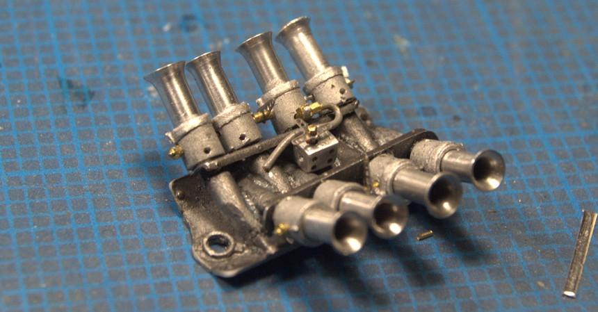

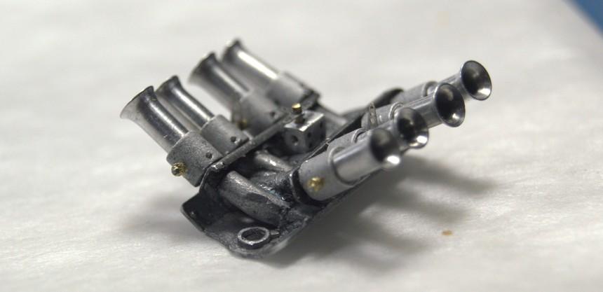

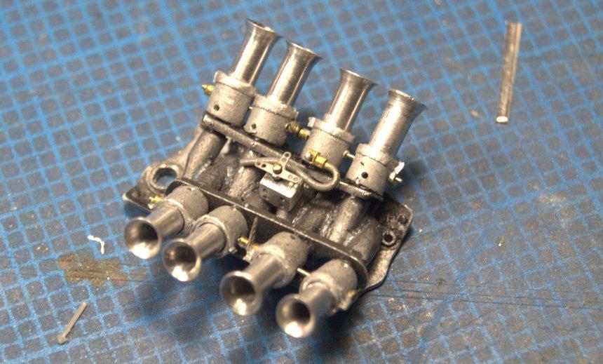

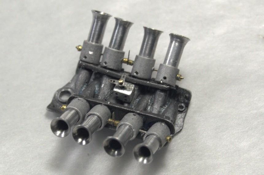

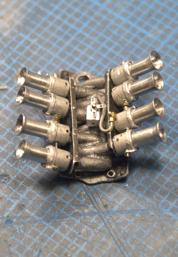

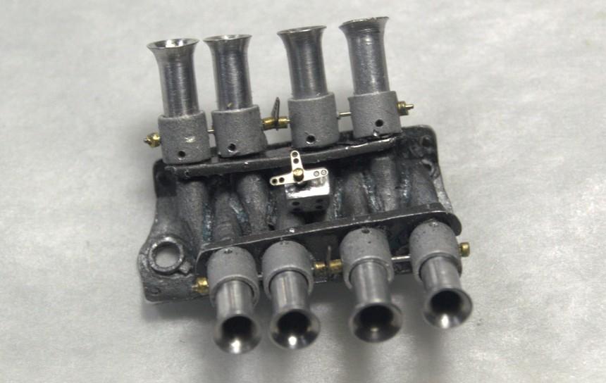

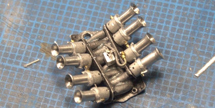

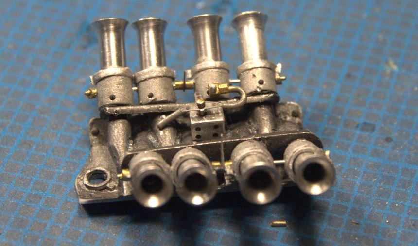

Straightliner59 Posted January 16, 2022 Author Share Posted January 16, 2022 I took a few days break break from this, as I just wasn't "feeling it", regarding the manifold. I played around with one of those RM Kustom Chopper kits I have up in the closet. I made a couple of mods to it, that I had planned, then took another look at this. I have decided that I don't need to build another one, because I like this one, better than I thought I did! That said, I went ahead with working on the linkages. The throttle shafts and links went together much easier than I was expecting. That was a nice surprise! I glued the fuel valve in place, as well. Next job will be installing the injector lines and fittings. Comments, queries and critiques are always welcome. Thanks for looking! Quote Link to comment Share on other sites More sharing options...

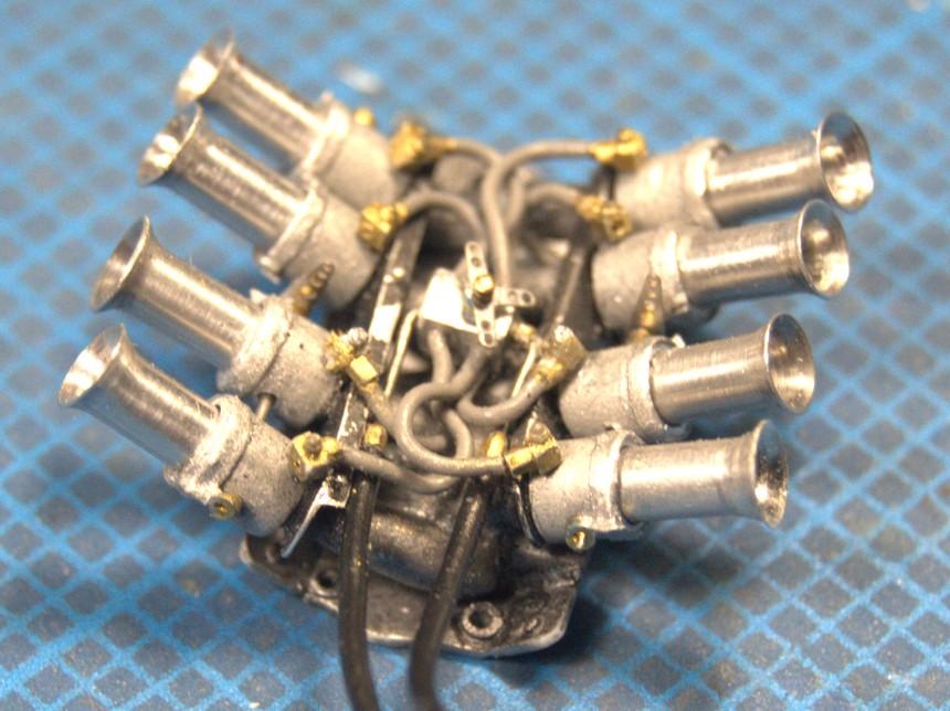

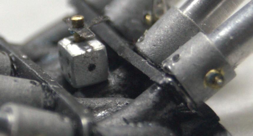

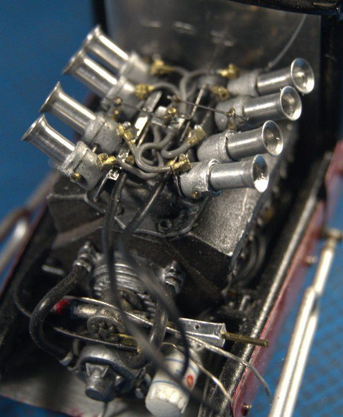

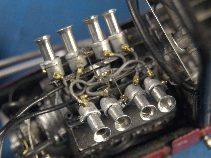

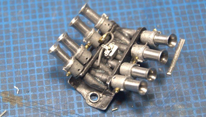

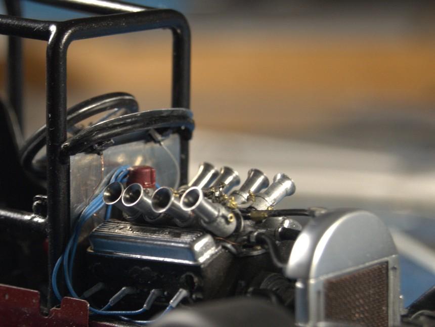

Straightliner59 Posted January 18, 2022 Author Share Posted January 18, 2022 I added the "flanges"/tabs that secure the 1:1 velocity tubes to the throttle bodies. I also started working on the injectors @absmiami had asked how/what I was going to do with the lines and fittings--now, I guess we both know! I cross-drilled .030" square styrene strip and inserted a small model RR hex bolt casting through it and cemented it with WeldOn 4. While it dried, I bored into a length of .030" hex rod, and stripped the end of a length of the pictured TCS wire. This wire is super flexible. It should work beautifully, here. I slipped a short length of the hex over the stripped end of the wire and super glued it (leaving just under .030" of the conductor exposed). Next, I drilled across the .030" strip, perpendicular to and across the original hole (thus, through the bolt). Finally, I super glued the wire with the hex fitting into the hole in the strip. Lastly, i dipped the fitting end into a bottle of brass metallizer, and painted the bolt head with non-buffing aluminum metallizer. Comments critiques and questions are always welcome. Thank fer lookin'! 1 Quote Link to comment Share on other sites More sharing options...

Straightliner59 Posted January 19, 2022 Author Share Posted January 19, 2022 13 hours ago, absmiami said: OPTIVISOR ! Dang skippy! 8 hours ago, AmericanMuscleFan said: I knew it was worth persisting... 😁👌 You were absolutely correct. I have five more injectors to build, then I gotta' hook 'em up! It won't be long before I'll have to paint, too...whoopee! Quote Link to comment Share on other sites More sharing options...

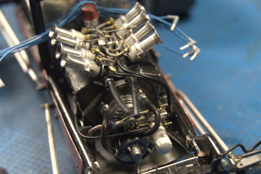

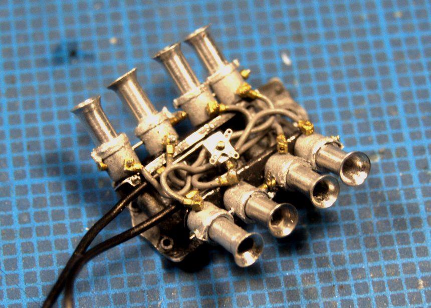

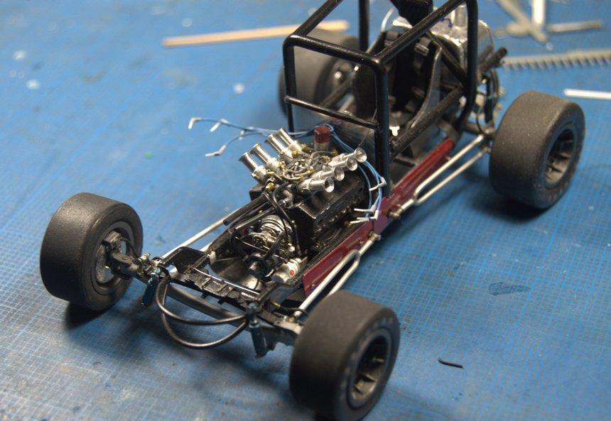

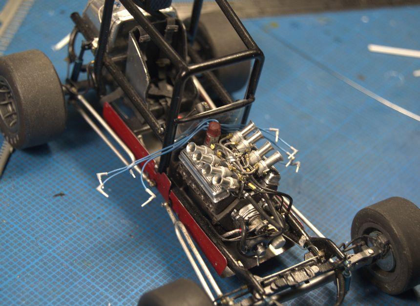

Straightliner59 Posted February 20, 2022 Author Share Posted February 20, 2022 Just because I took a break to build the Chevy II doesn't mean that I've forgotten this. I have created a bundle of snakes! 1 Quote Link to comment Share on other sites More sharing options...
absmiami Posted February 20, 2022 Share Posted February 20, 2022 Yup. Linkage next … 1 Quote Link to comment Share on other sites More sharing options...
Straightliner59 Posted February 21, 2022 Author Share Posted February 21, 2022 (edited) 23 hours ago, absmiami said: Yup. Linkage next … Yessir! And, we're off! Edited February 21, 2022 by Straightliner59 Quote Link to comment Share on other sites More sharing options...
AmericanMuscleFan Posted February 21, 2022 Share Posted February 21, 2022 On 2/20/2022 at 3:25 AM, Straightliner59 said: Just because I took a break to build the Chevy II doesn't mean that I've forgotten this. I have created a bundle of snakes! Cool, I love snakes, Cobras and Vipers come to mind but yours look good to my friend! 👍 1 Quote Link to comment Share on other sites More sharing options...
Straightliner59 Posted February 22, 2022 Author Share Posted February 22, 2022 A start on the linkages... Quote Link to comment Share on other sites More sharing options...

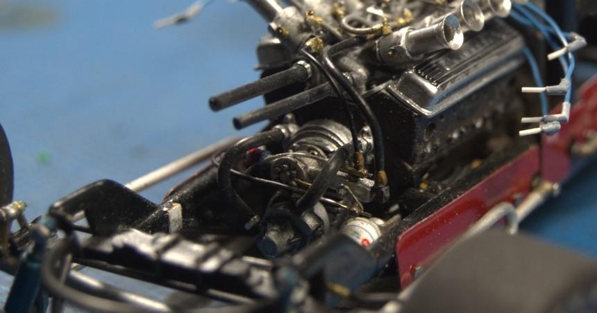

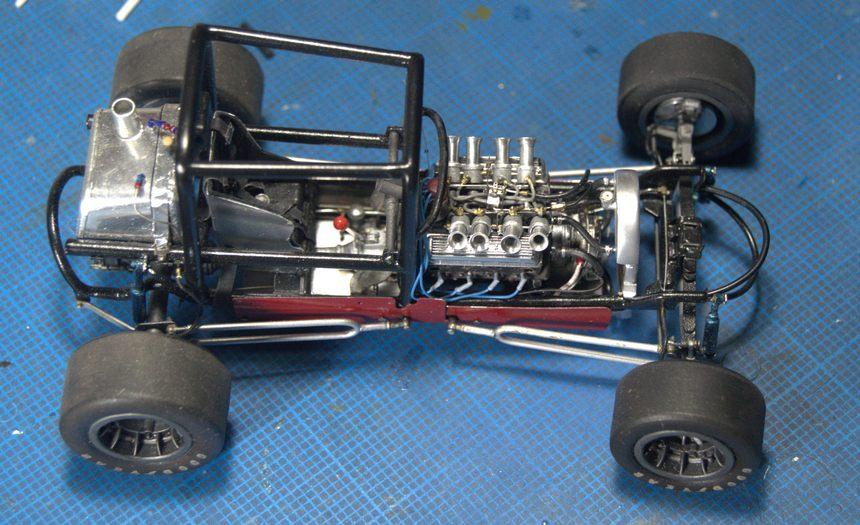

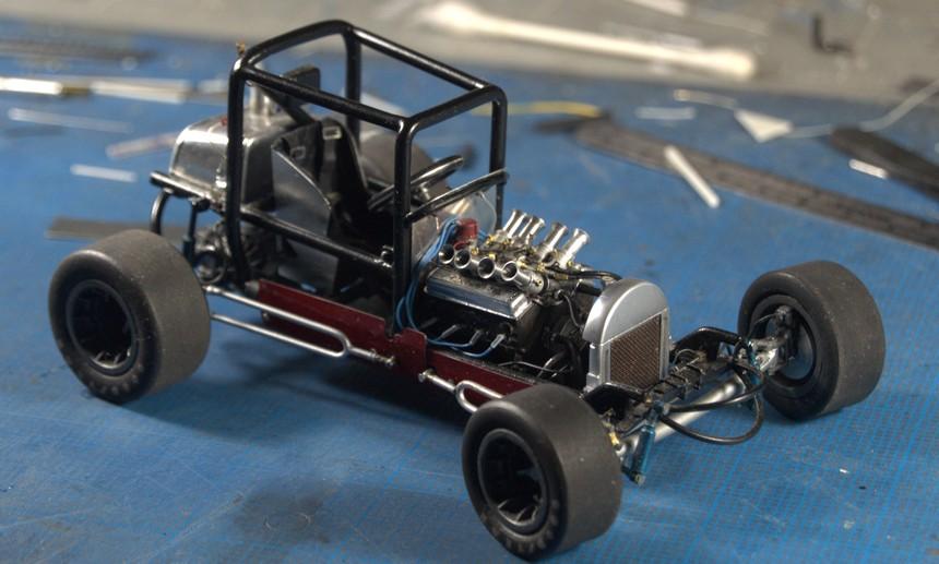

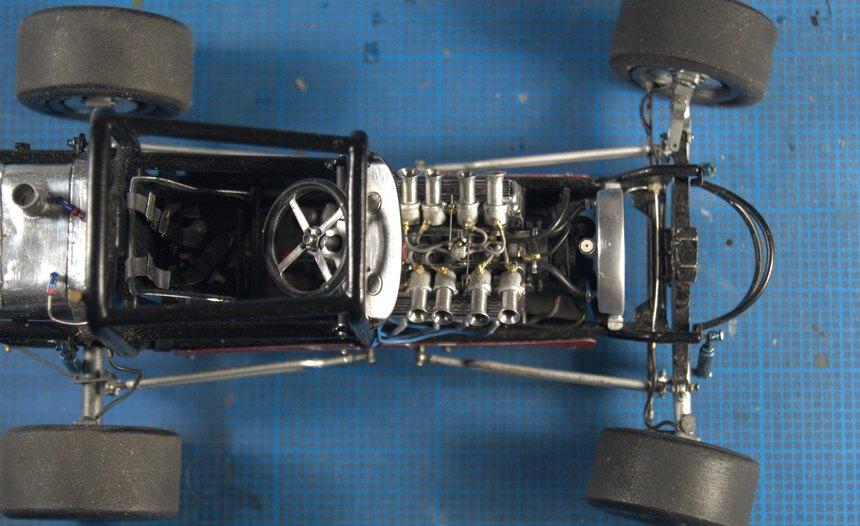

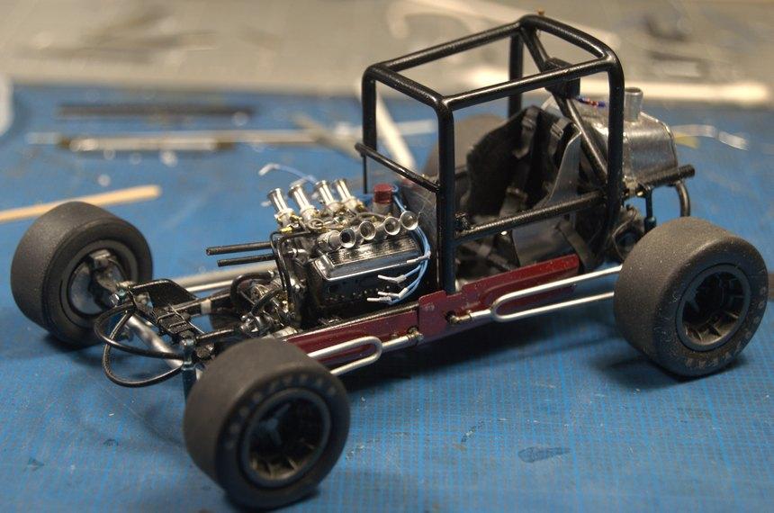

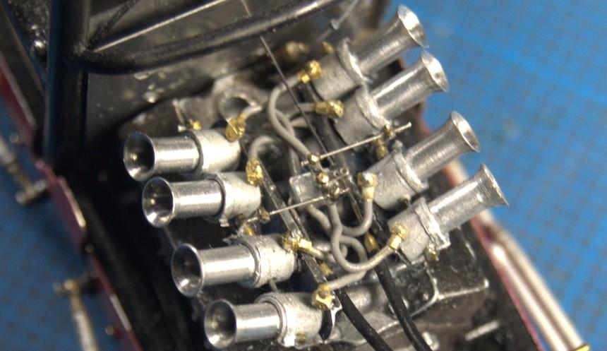

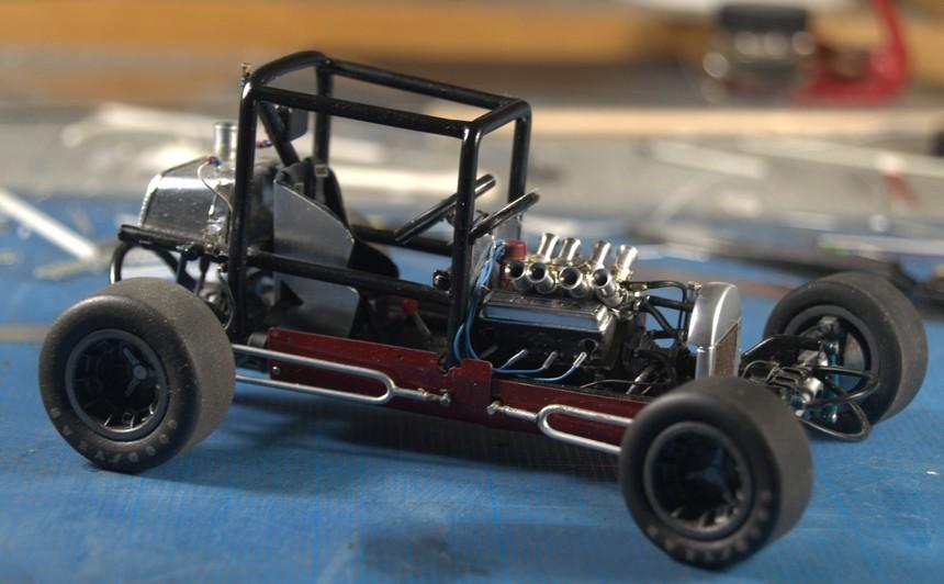

Straightliner59 Posted February 27, 2022 Author Share Posted February 27, 2022 Except for a return spring and the main throttle link, the engine is done! Headers won't be installed until the end. Since these photos were shot, I installed the plug wires. As always, your comments, critiques and questions are appreciated. Thanks for looking! 1 Quote Link to comment Share on other sites More sharing options...
AmericanMuscleFan Posted February 27, 2022 Share Posted February 27, 2022 I have no other comment to say except that it is superb my friend! 😊👍 1 Quote Link to comment Share on other sites More sharing options...

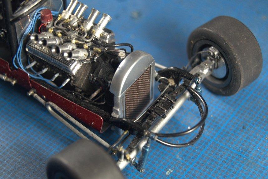

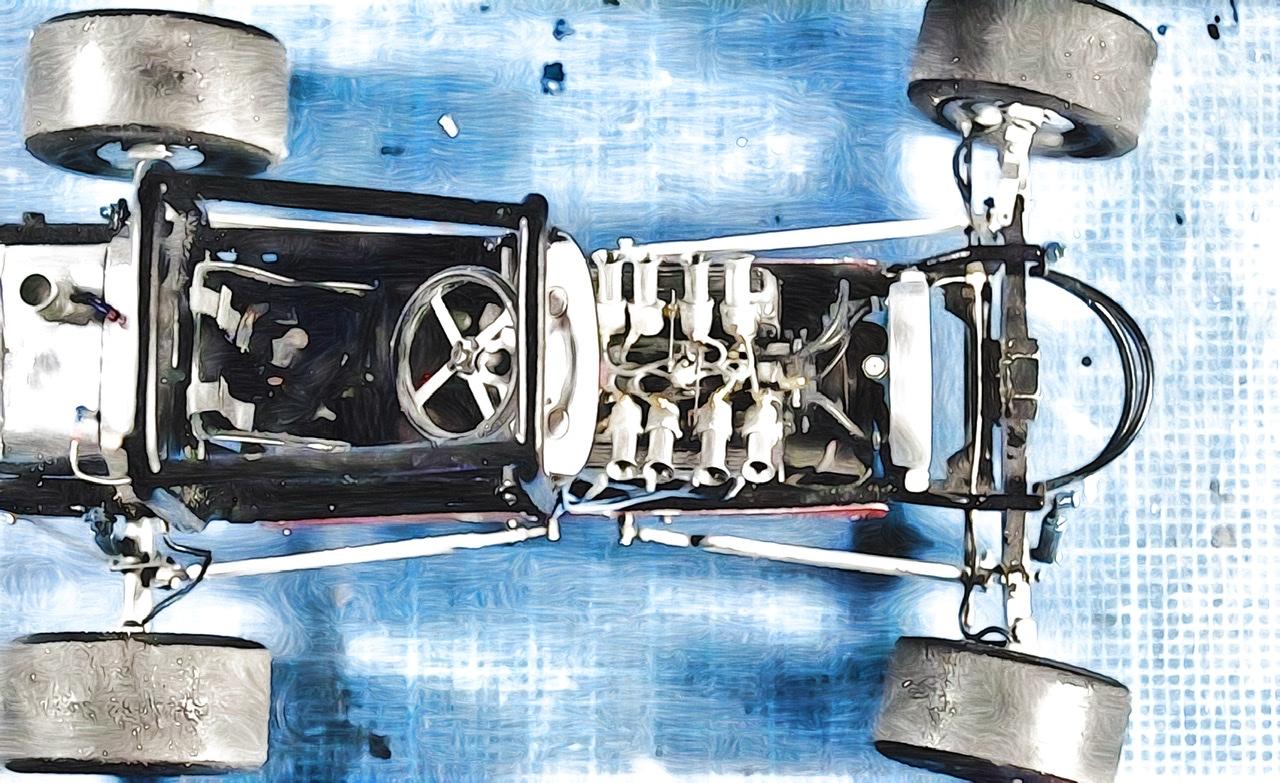

Straightliner59 Posted March 2, 2022 Author Share Posted March 2, 2022 Thank you, Francis. I got the radiator installed, last night. I should be able to get started installing the dash, in a session, or so. Quote Link to comment Share on other sites More sharing options...
Straightliner59 Posted March 2, 2022 Author Share Posted March 2, 2022 Cooling system installed and plumbed. The dash is mostly installed. I should be able to get that done, after work, tomorrow. Once it and the wheel are installed, I'll start work on the wing, and its hardware. Comments are always welcome. Thanks for lookin'! Quote Link to comment Share on other sites More sharing options...

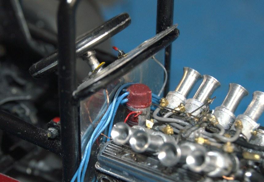

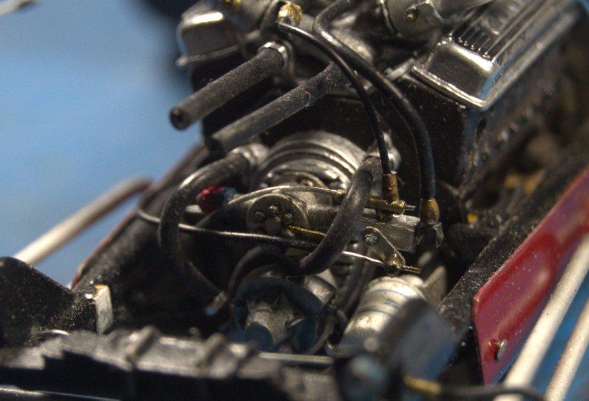

Straightliner59 Posted March 3, 2022 Author Share Posted March 3, 2022 (edited) Dash is installed, gauges are hooked up. The clear mono line is for the mechanical oil pressure gauge, the copper is the thermocouple for the temp gauge. I also connected the mag kill. I installed the wheel, as well. As always, comments, questions and critiques are welcome. Thanks for looking! Edited March 3, 2022 by Straightliner59 2 Quote Link to comment Share on other sites More sharing options...
