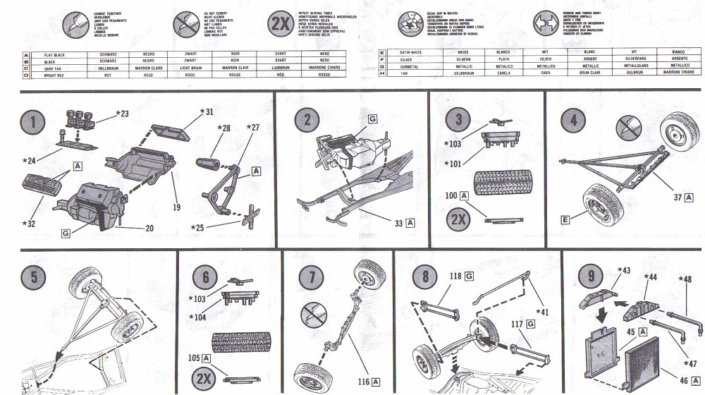

If you want to be exhaust-port retentive about scale, about the only early speed parts in 1/24 come from Monogram's other offerings of the period.
For instance, their old '40 Ford pickup has a three carb setup and finned aluminum high performance heads.
2
As does the '36 Ford you asked about:
5 minutes ago, Richard Bartrop said:
While the Revell '48 Ford is listed as 1/25, if you compare the engine with the one in the Monogram '36,  you'll find it's almost identical in size.
