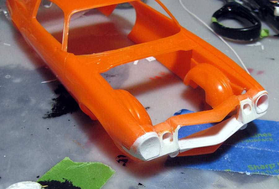

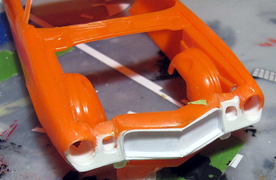

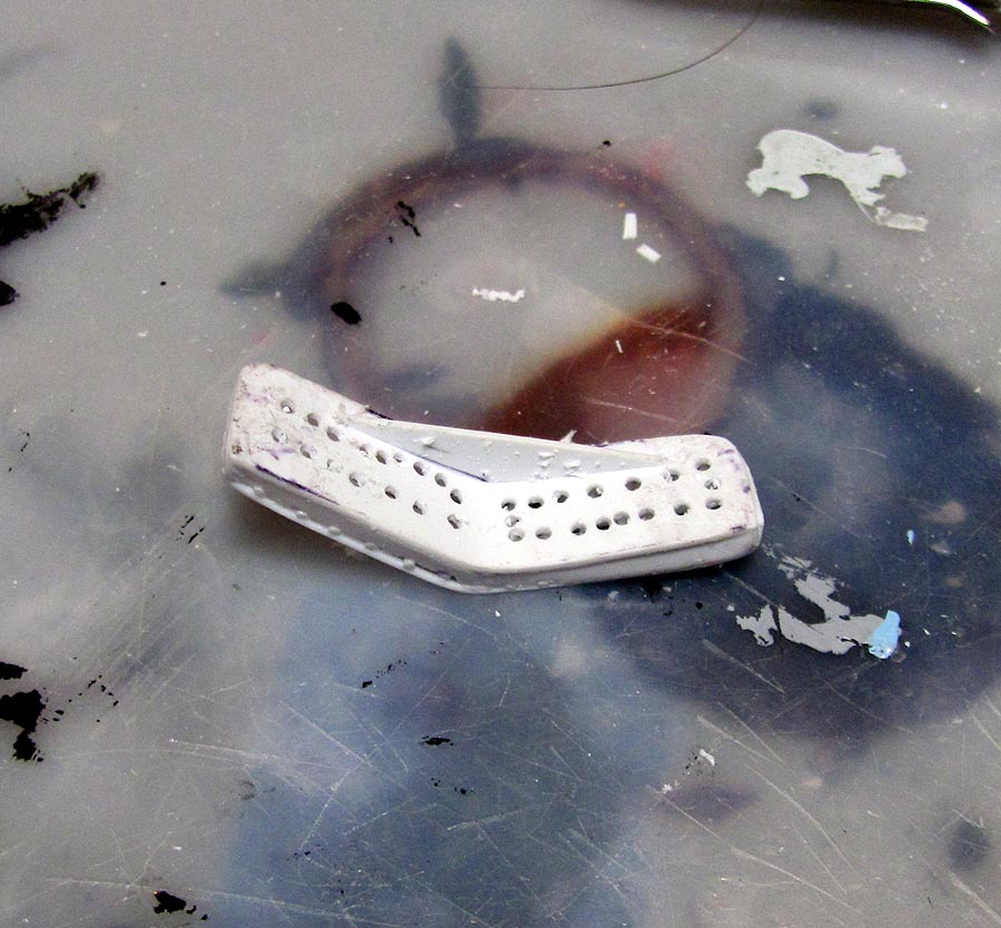

MarkJ Posted June 27, 2021 Author Share Posted June 27, 2021 Thanks , Patrick. I'm going to give it one more shot. I have learned some things from the first 2 failed attempts. I'm going to make a better locating image and I'm going to make the location image to where it can be removed . Also the grille will be open at the back and I will use rod material first before I go to strips. The process will also involve masking tape, so I can make a better outer boundry for the grille that will fit better in the grille opening. Quote Link to comment Share on other sites More sharing options...

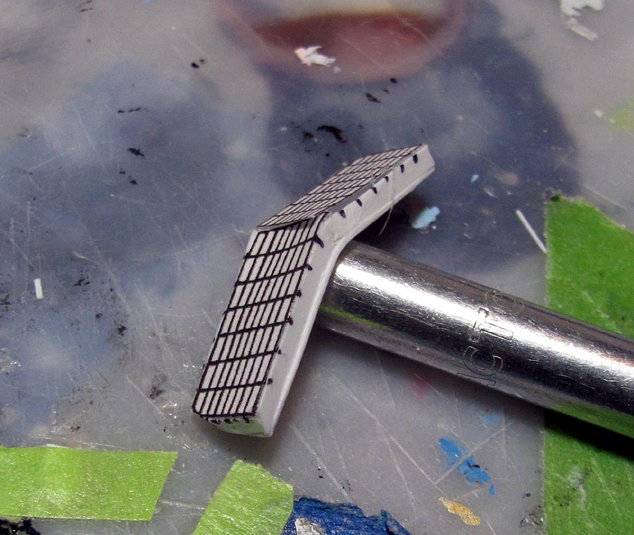

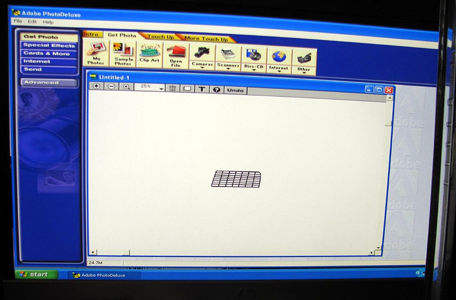

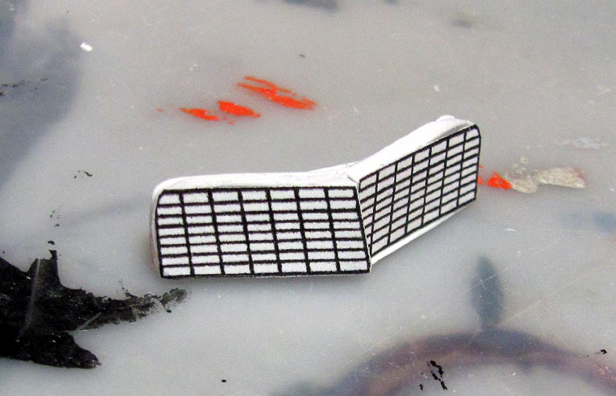

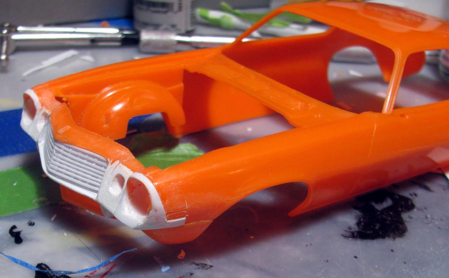

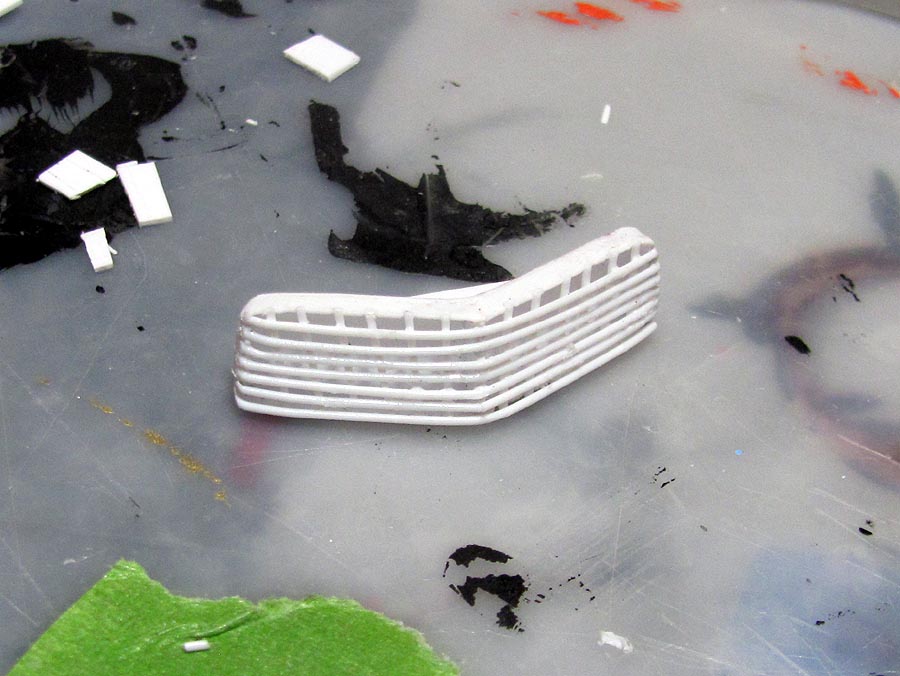

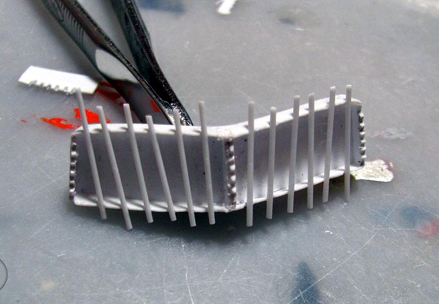

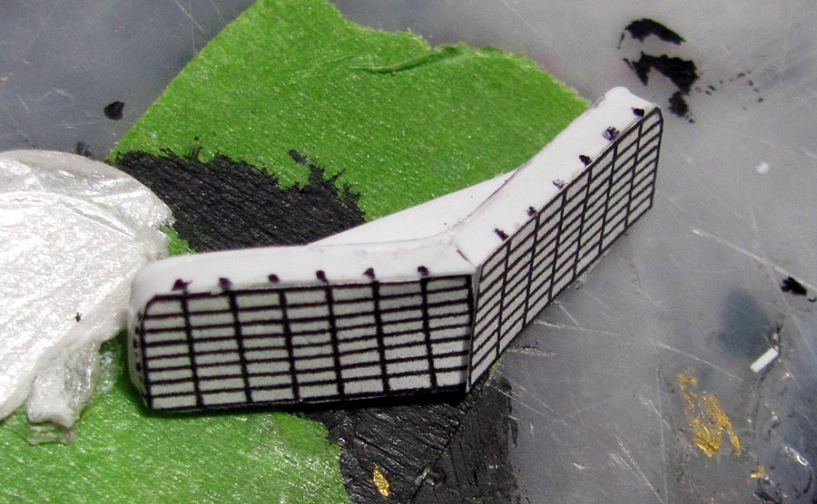

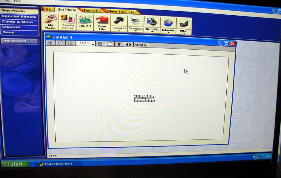

MarkJ Posted June 29, 2021 Author Share Posted June 29, 2021 I'll let the pictures speak for themselves, but I basically found a picture of a 74 camaro with the left side of the grille facing the camara directly . i turned the image into a 1/25 scale image of the grille and enhanced it by making the grille black on a white background. I then flipped that image horizontally to get the right side of the grille. This gave me patterns to put on the grille opening so i could mark where the .025 rods I used woud go. These were the smallest rods I could find, but they were really flimsy to work with as you will see on the pictures I post today. it was really hard to cut the slots on the sides of the grille for the horizontal rods. I will need to cut the back out of the grille assembly, so I can bolster the rods from the back to give them a more flat appearance. Quote Link to comment Share on other sites More sharing options...

MarkJ Posted June 30, 2021 Author Share Posted June 30, 2021 18 minutes ago, David G. said: What a great idea! I can't wait to see how it works out. Over the years I've learned a number of different techniques just so I could make a particular part for a build project. At this point I might consider teaching myself how to photo etch. David G. Yes, photoetching would be great for so many things. I had to remove the grille work I did and start over by making the side grille slots more pronounced to fit the horizontal rods better. hopefully I will nave better results today. Quote Link to comment Share on other sites More sharing options...

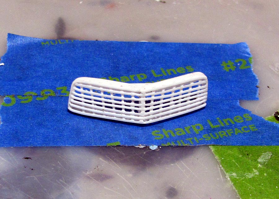

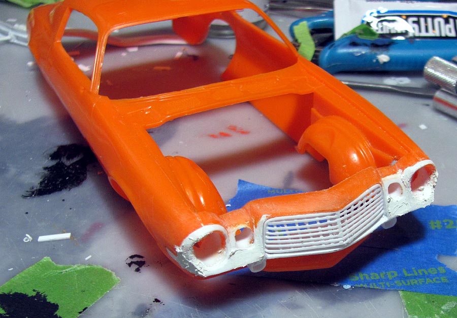

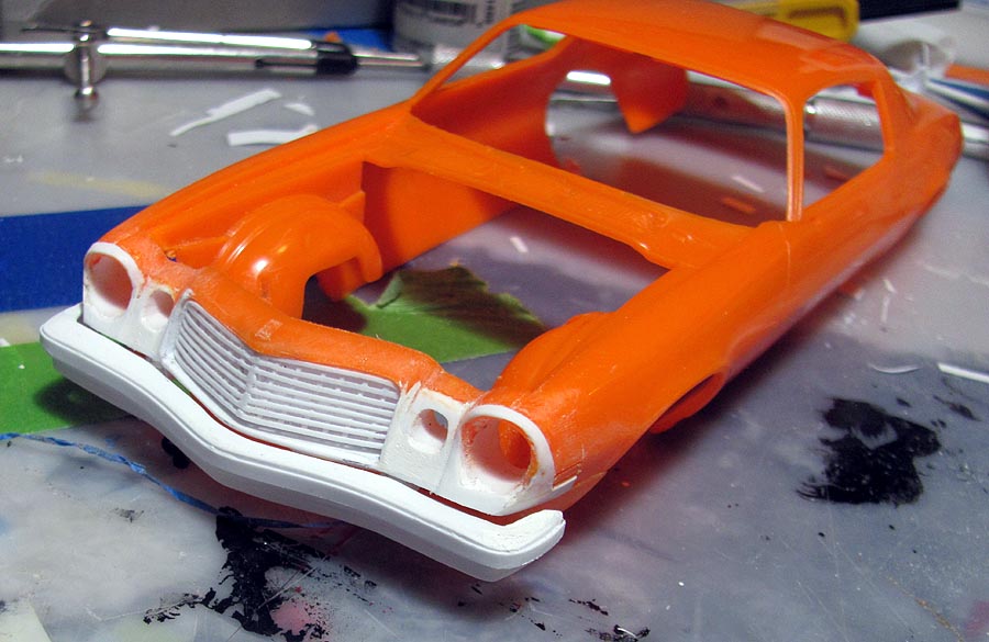

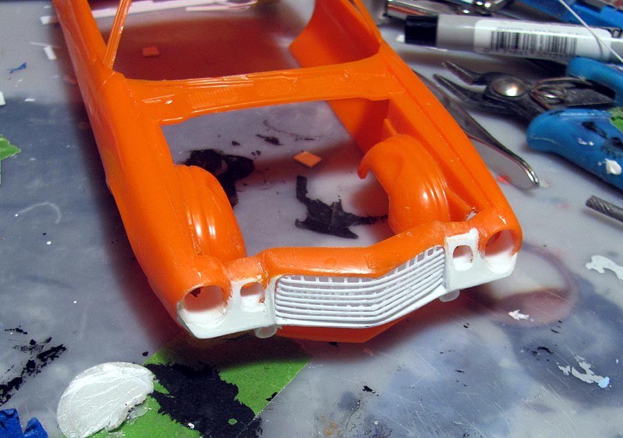

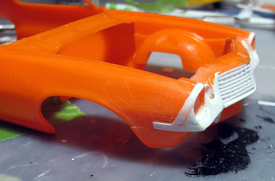

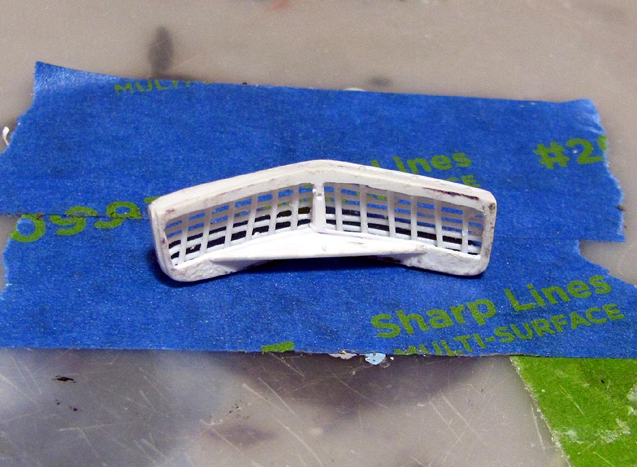

MarkJ Posted June 30, 2021 Author Share Posted June 30, 2021 Finally got the rough grille assembly finished. I now need to fine tune it with more styrene in certain places, and then some block sanding to give it a more egg crate appearance and also it needs a more pronounced pointed edge to the middle of the grille. The smallest material I had to use was .020 rod which was really too big for the grille bars, so to speak, but anything smaller would have been impossible to work with and the glue would melt it. I think i can get it presentable when finally finished. I also need to adjust the grille opening for proper fit. Quote Link to comment Share on other sites More sharing options...
David G. Posted July 3, 2021 Share Posted July 3, 2021 That looks like it may work. David G. Quote Link to comment Share on other sites More sharing options...

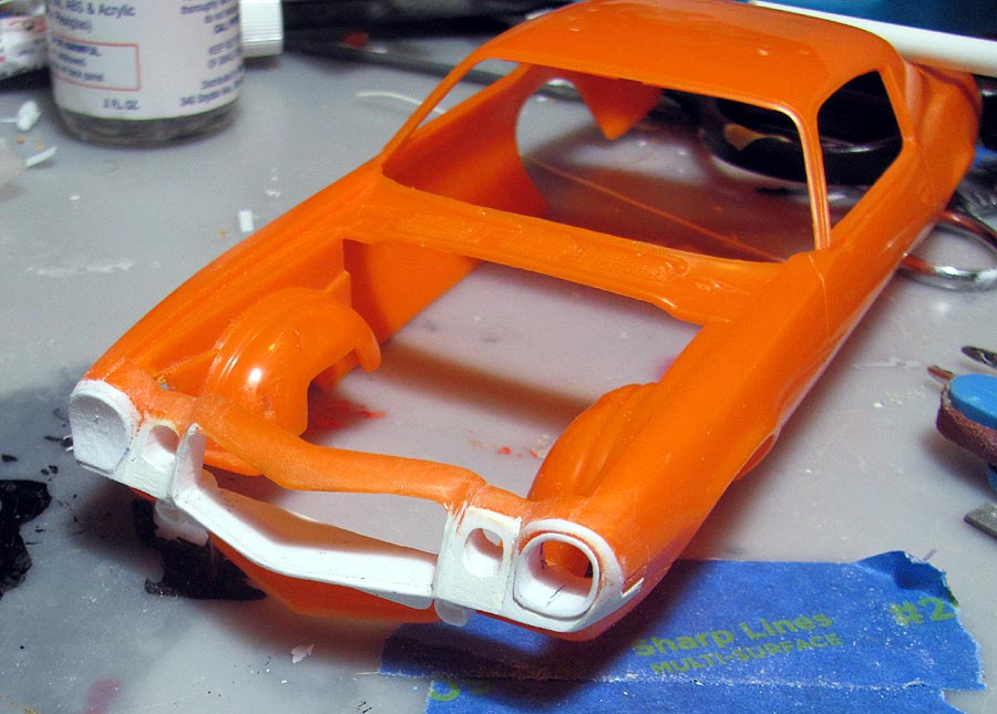

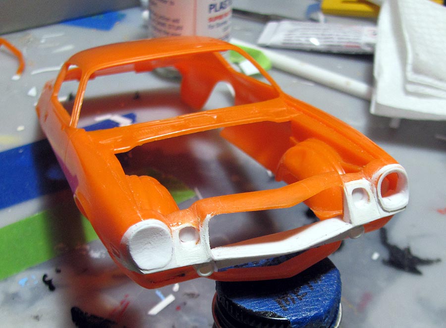

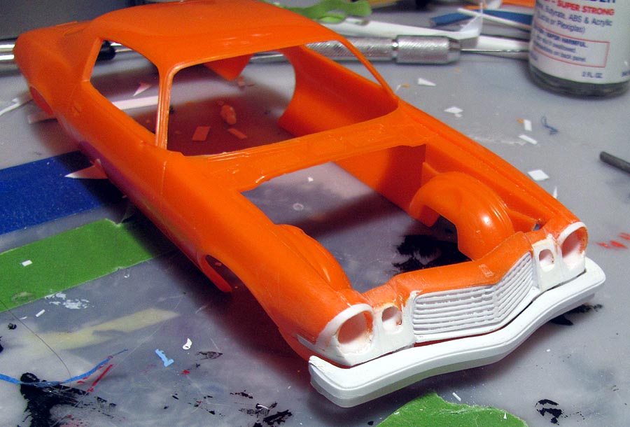

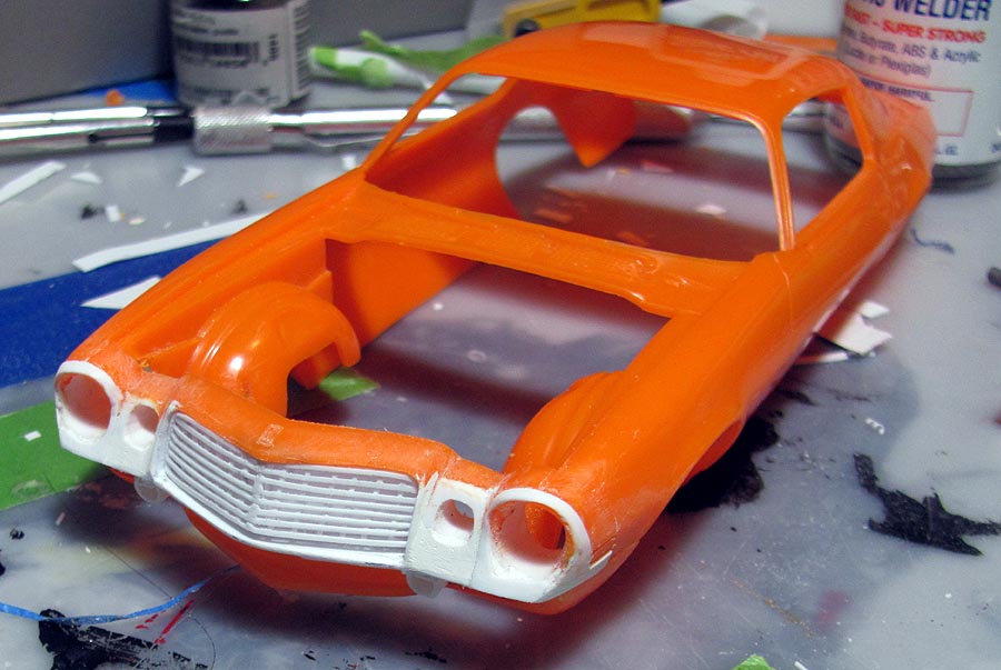

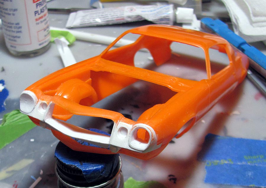

MarkJ Posted July 3, 2021 Author Share Posted July 3, 2021 Grille and bumper are not in their final locations. They wont be installed until after they are painted. They both need some more work before painting them. Quote Link to comment Share on other sites More sharing options...

Oldcarfan27 Posted July 4, 2021 Share Posted July 4, 2021 Dude! I'm really liking how you are including the headlight shell detail. That's exactly what they looked like! And they fit right over the same '73 fenders. Quote Link to comment Share on other sites More sharing options...
