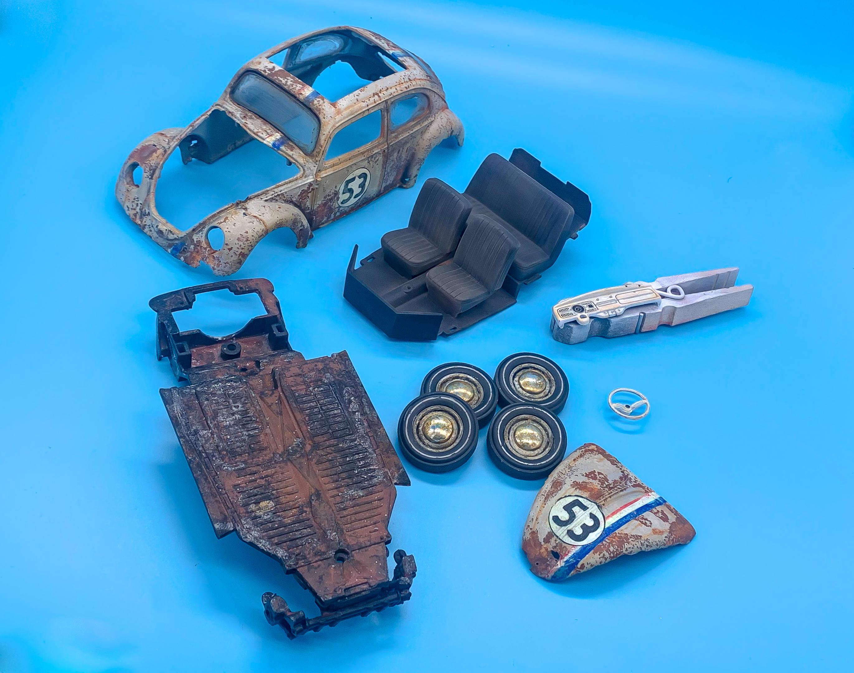

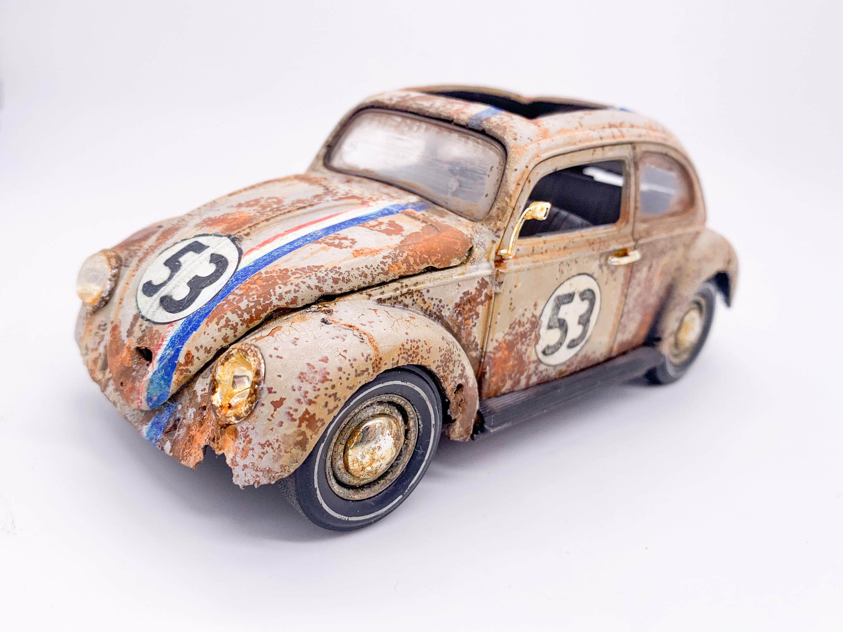

This thing will likely be going on a base so I didn’t need to weather the chassis (but I did anyway). Just kinda rusted it up and made it look dirty and neglected in case anyone ever peeks under there:

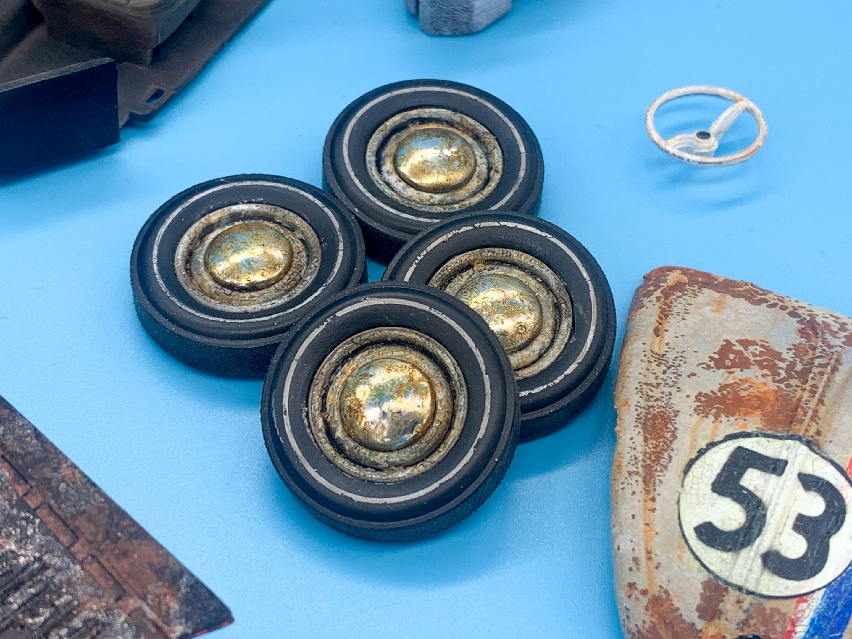

Ruined the wheels too - painted them steel Alclad then added salt and then painted the body color on there, weathered the hubcaps and gave them a wash and then distressed the whitewall on the tires and dulled them down with pastels:

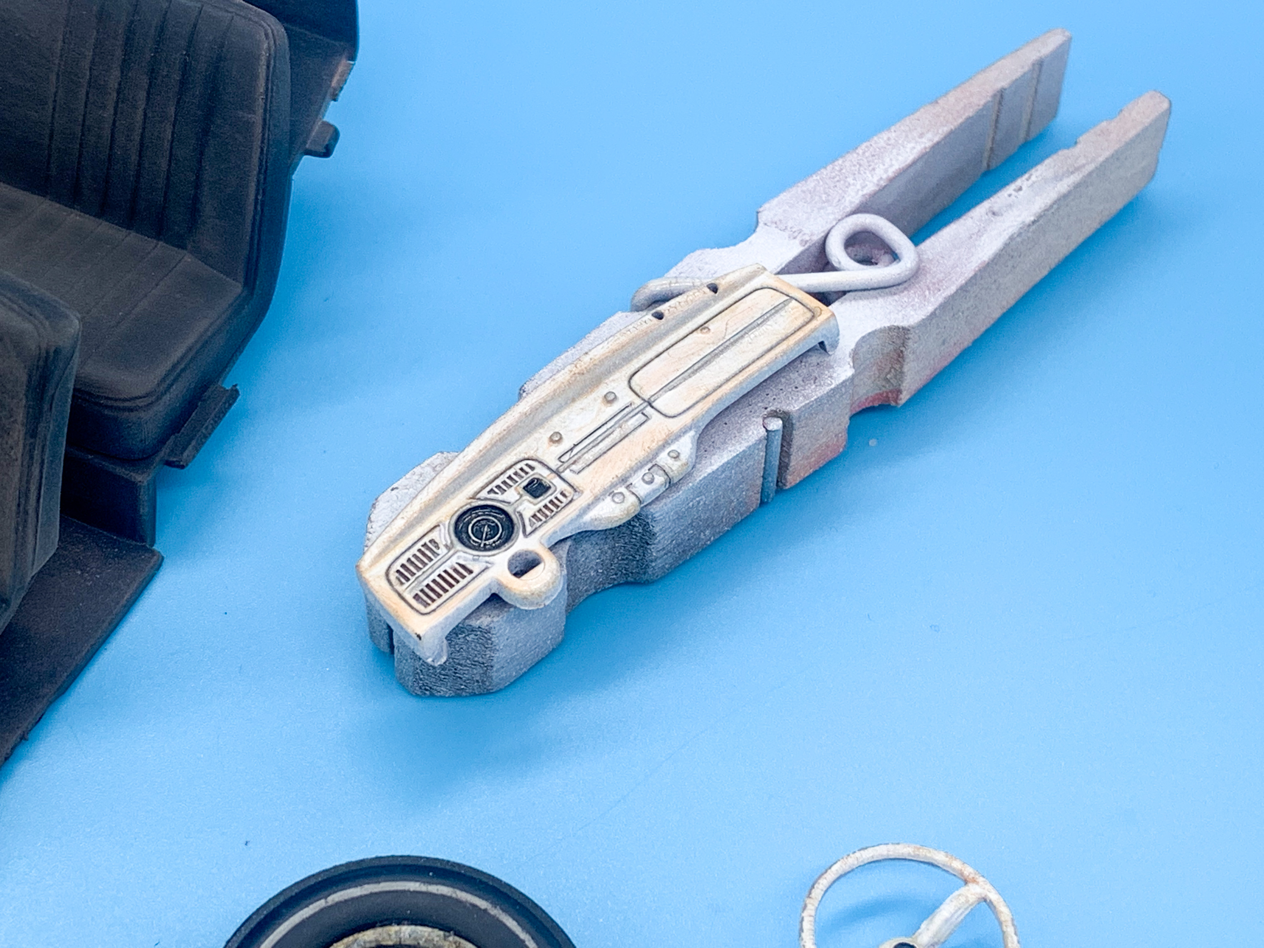

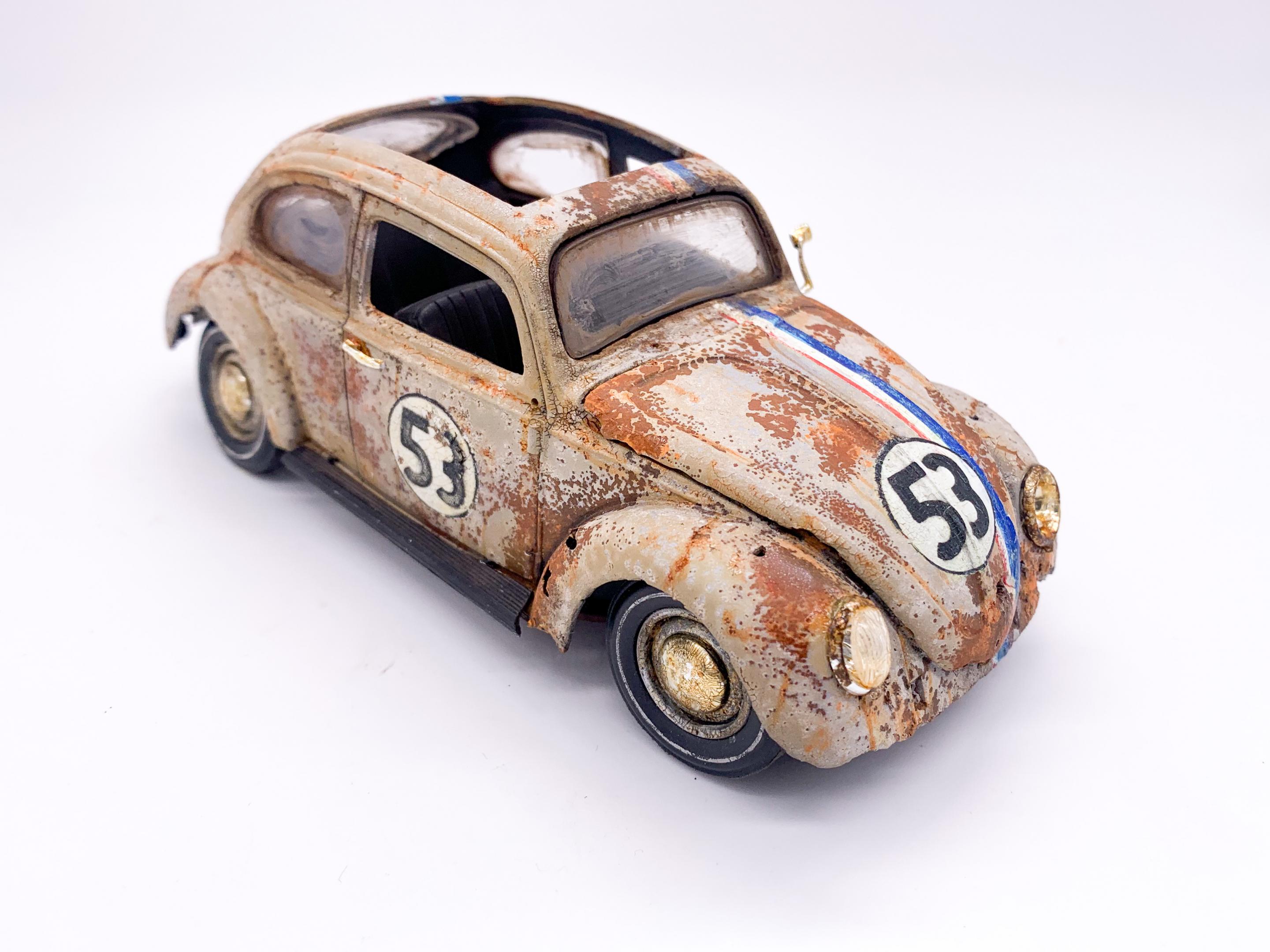

Started abusing the dash - not done with this yet…

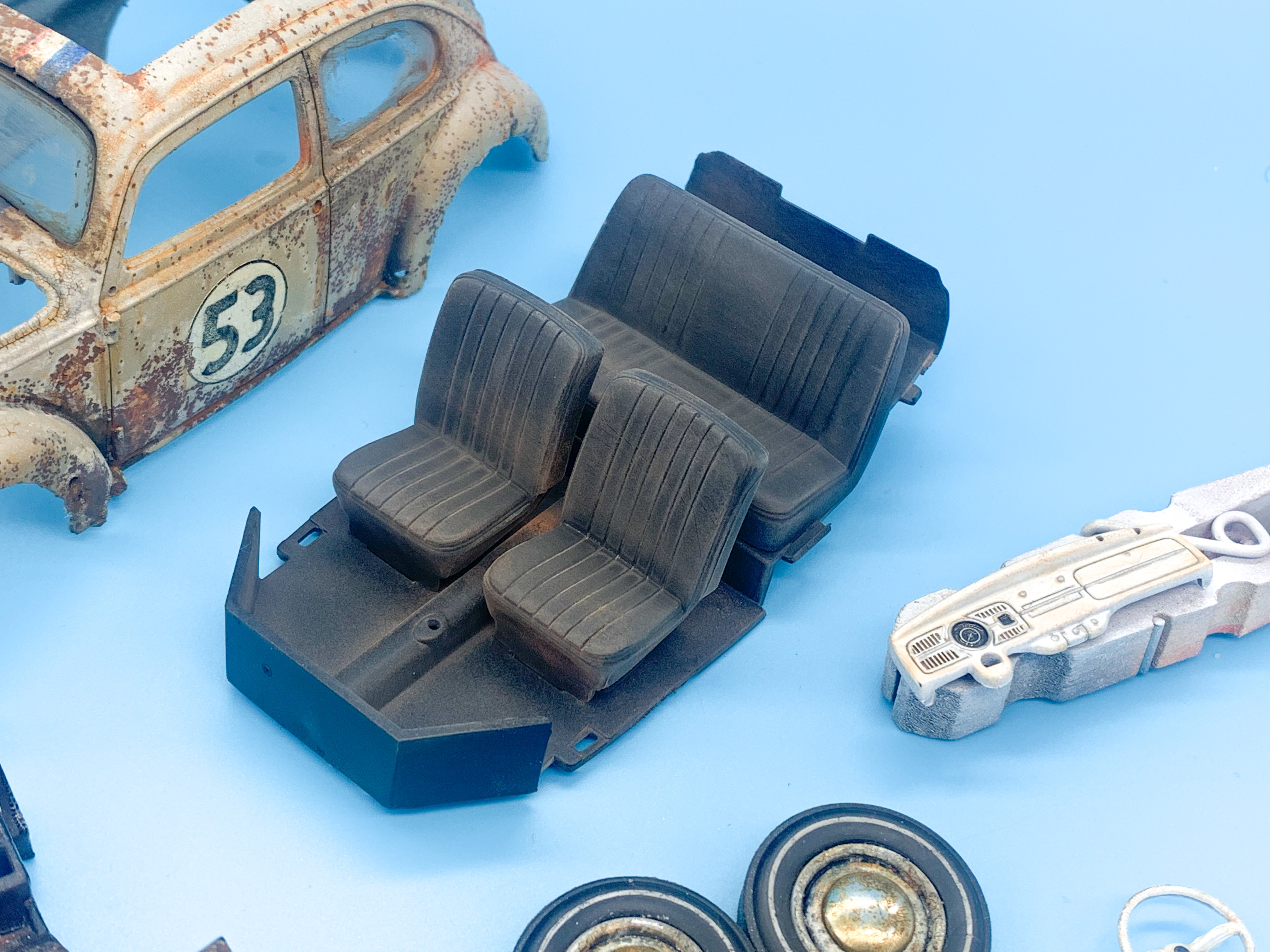

Ditto the interior - I’m not going wild and ruining the inside because no one wants to drive a car and have a seat spring sticking in their backside or whatever…just dirtying it up a little with some weathering:

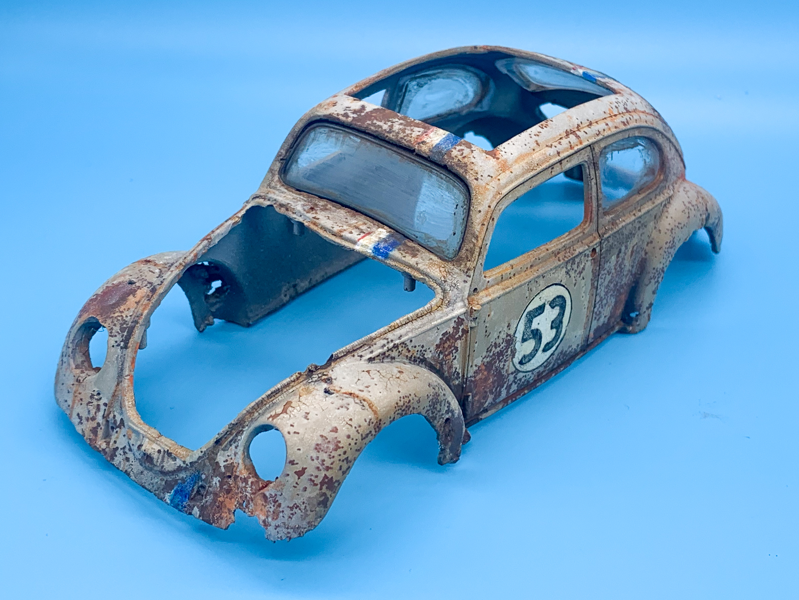

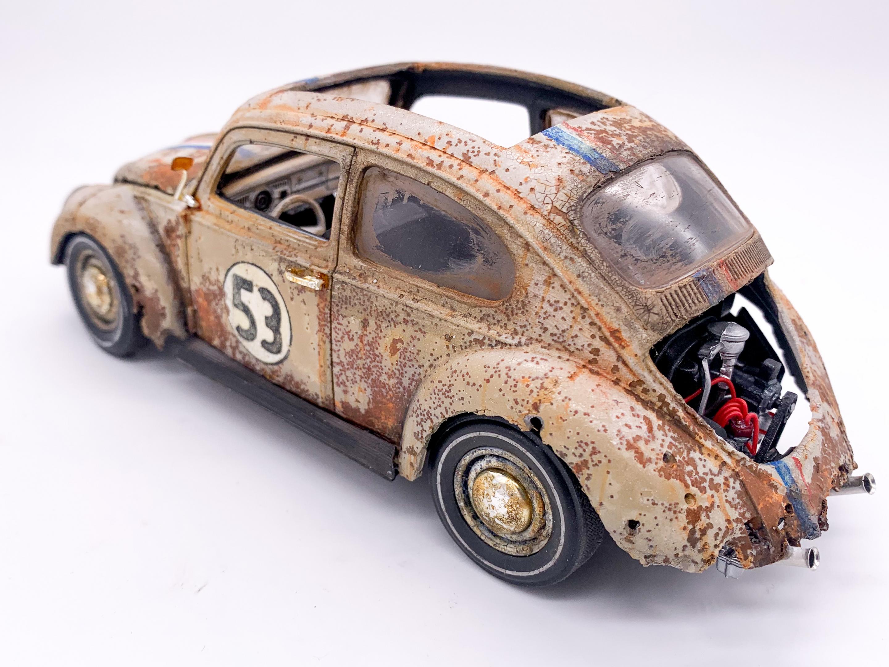

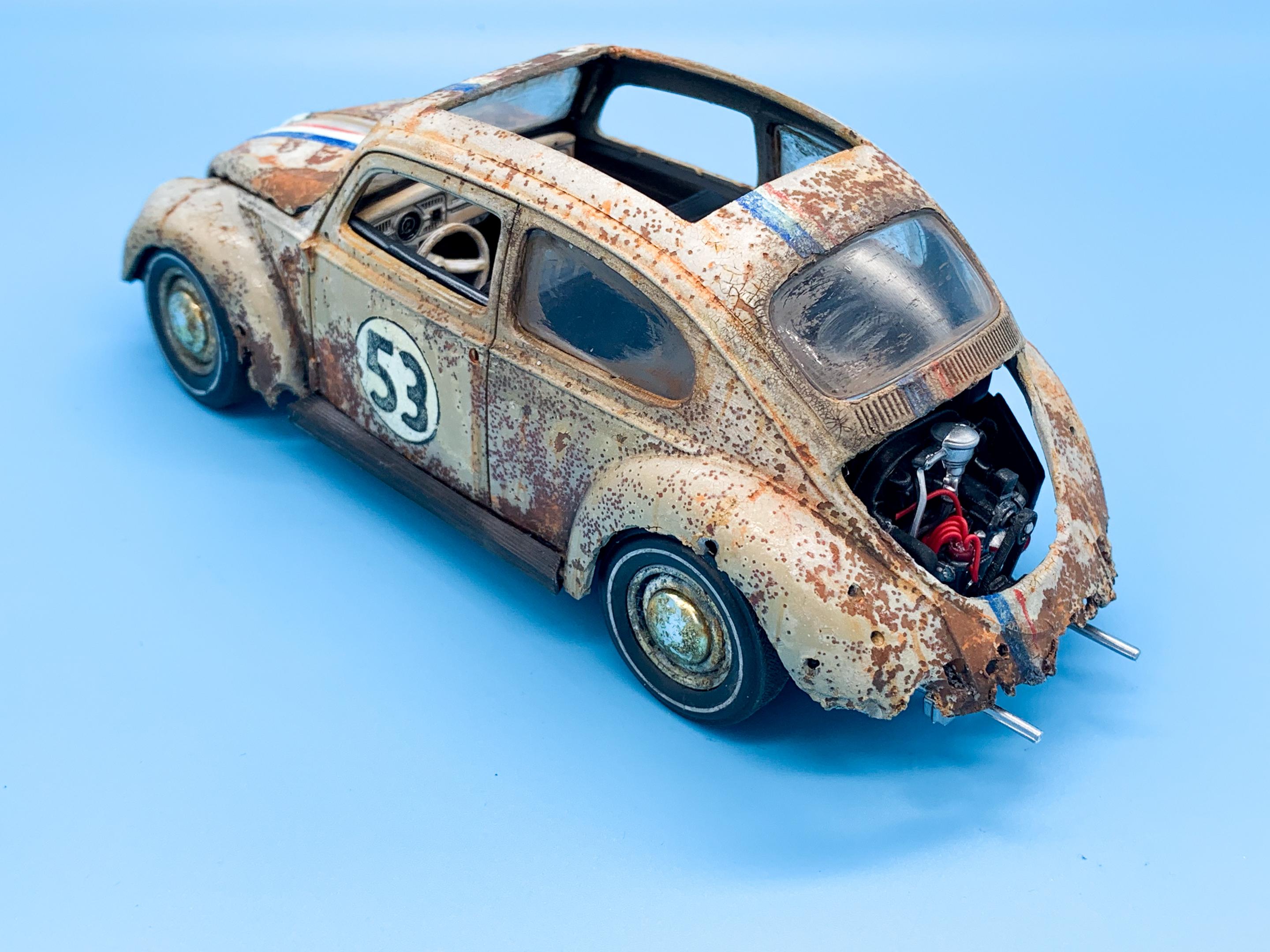

Installed glass and started weathering that too:
And that’s about it for my Saturday at the bench today:

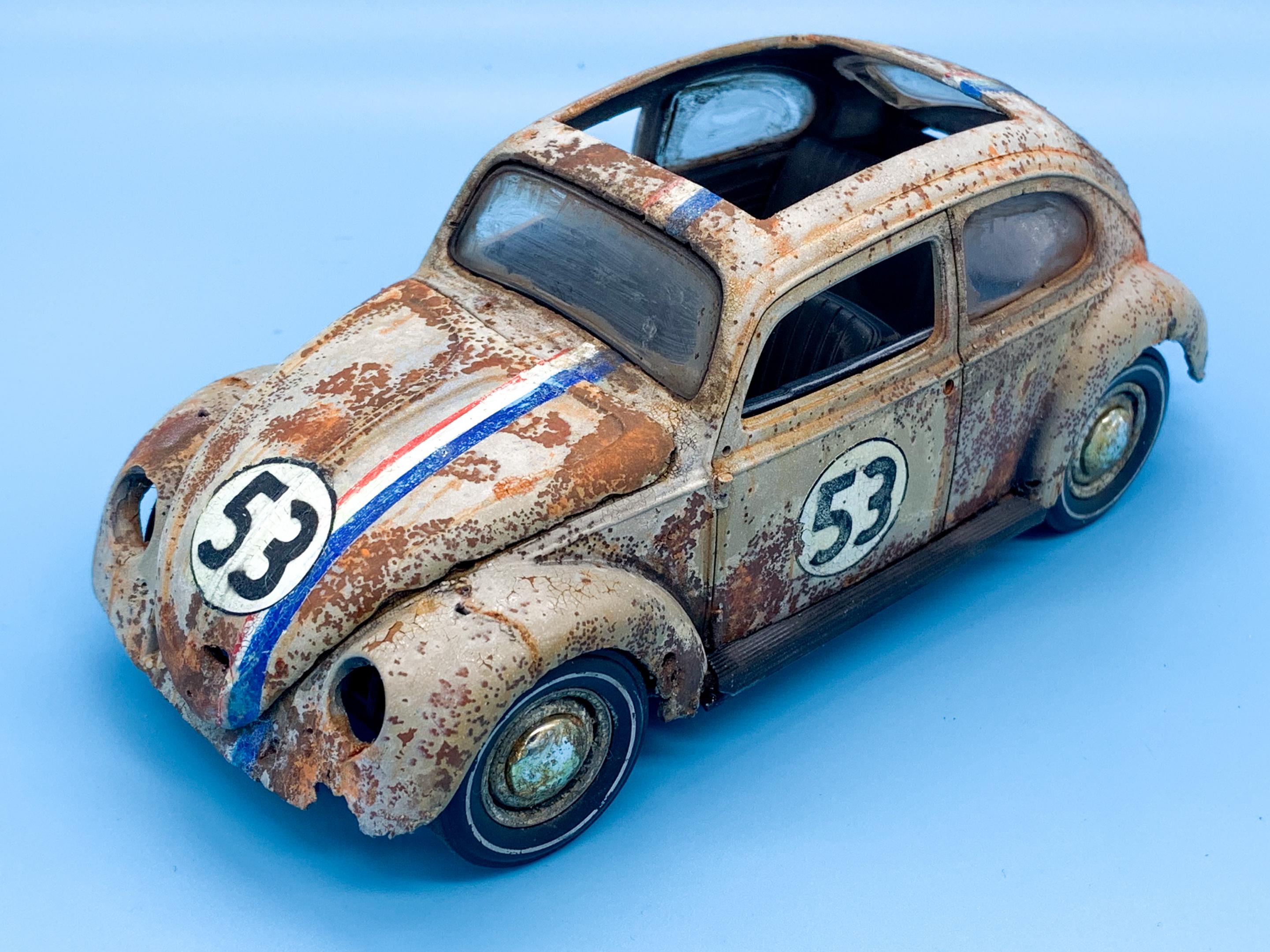

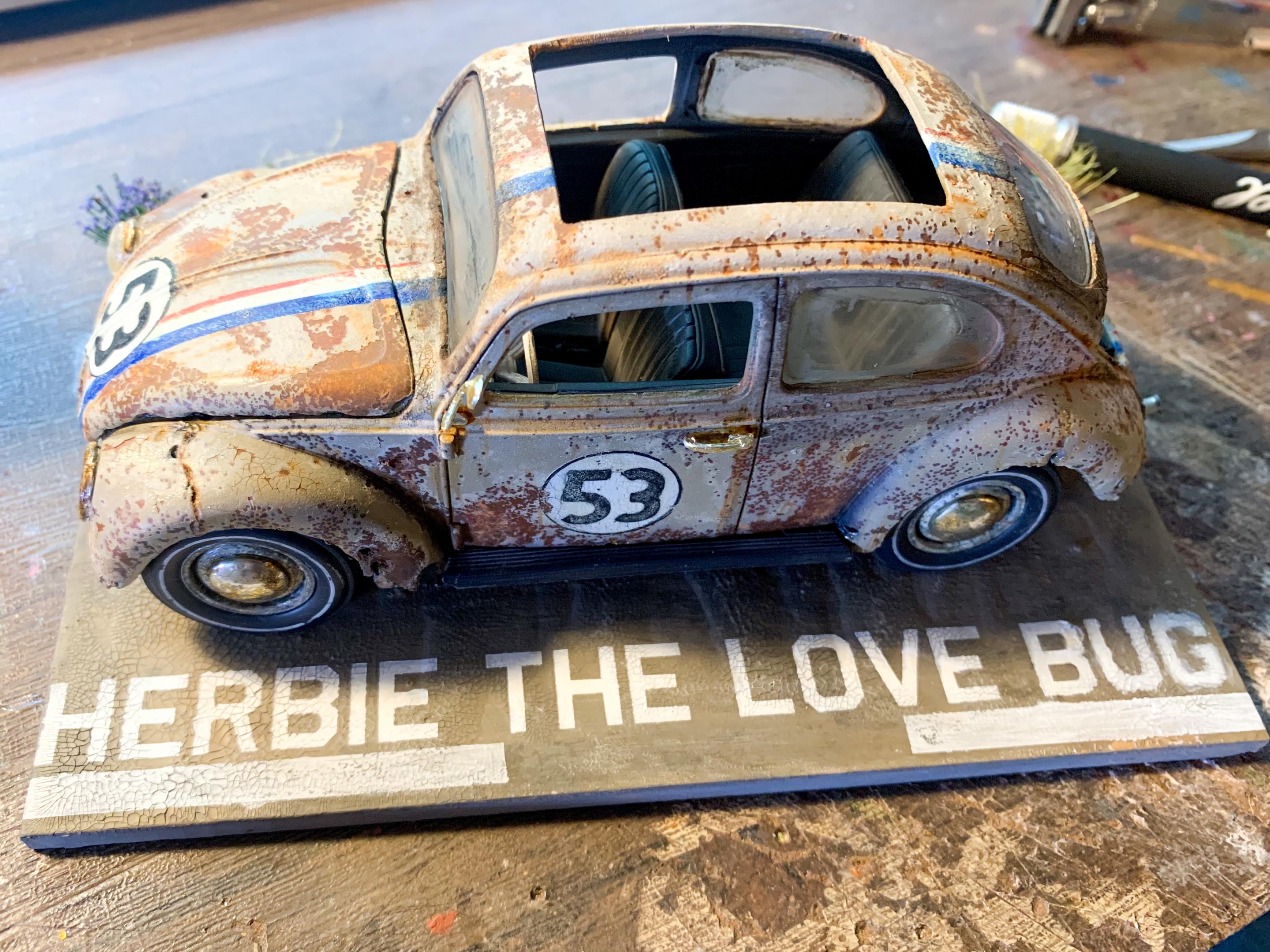

Wrapped this one up today, mostly…this being a snap kit it practically falls together.  Got engine built, and the major assemblies together:

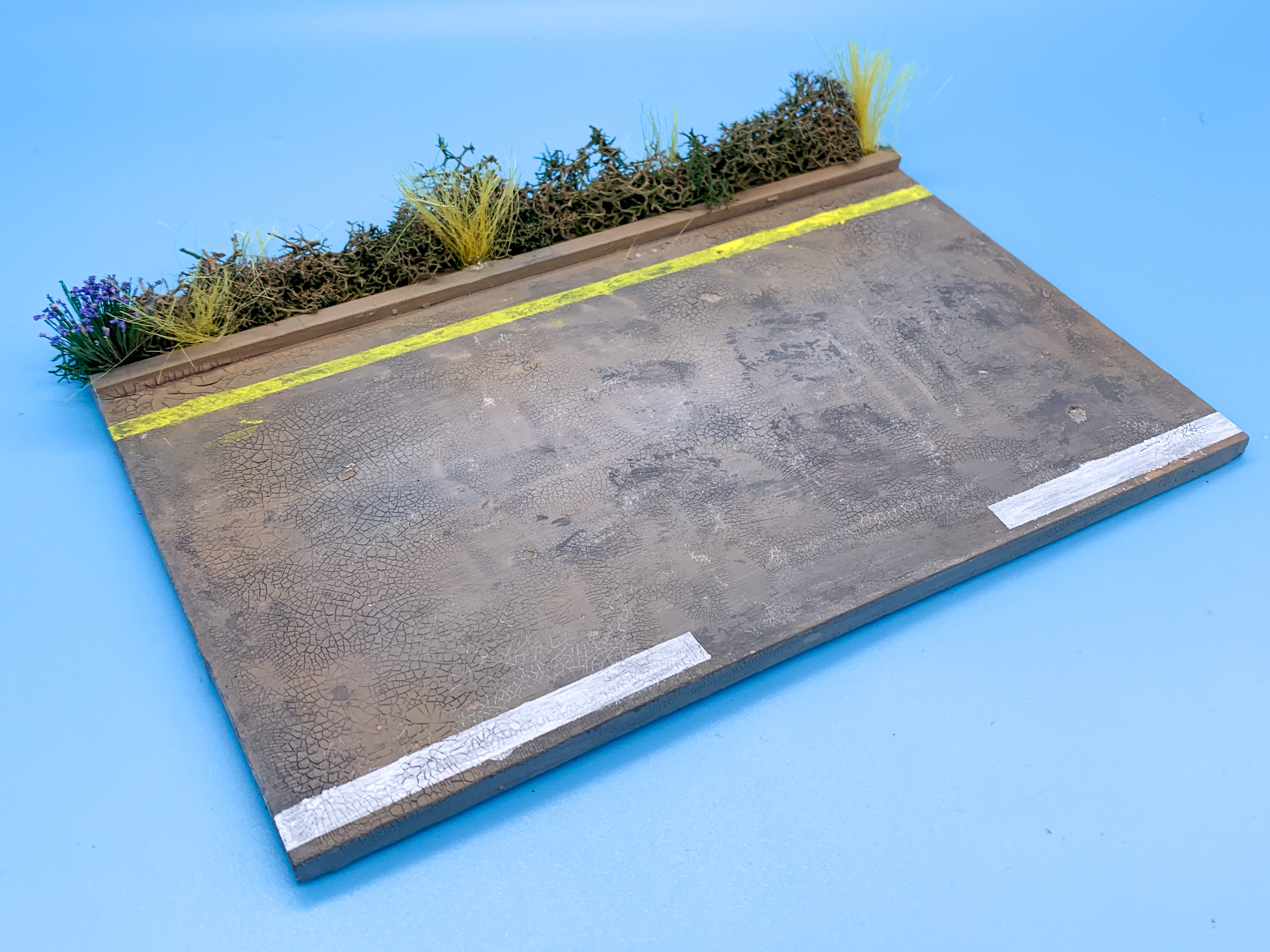

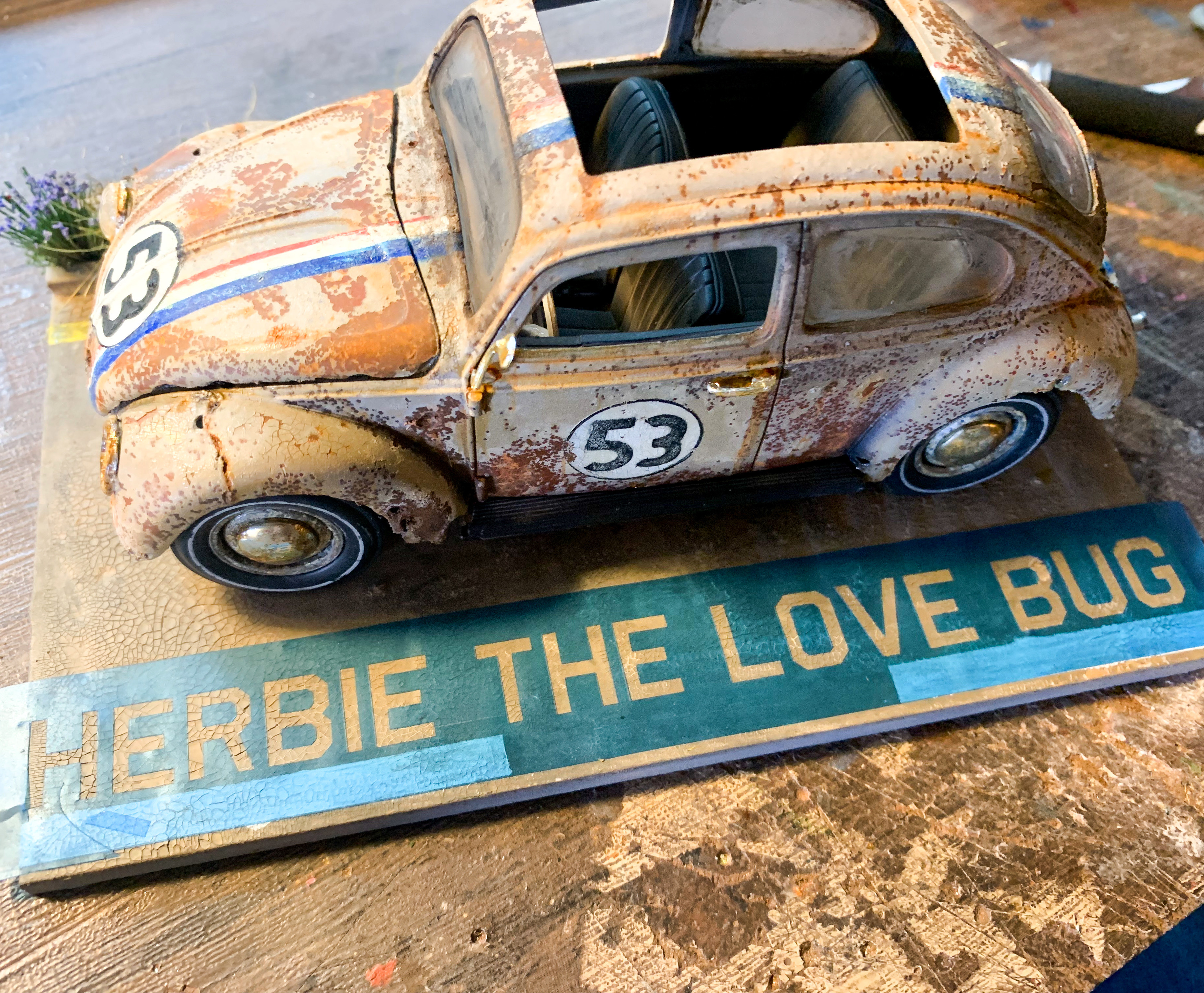

And whilst the glue was drying on the lights and door handles and other delicate little bits I ran to Michael’s and grabbed a little wooden base and these bits from the model railroad stuff:
I painted the wooden base with primer, then some crackle medium and finally acrylic paints, masked out some road markings and added the green bits (which I then airbrushed with some brown colors to deaden them up a little:
This little base fits the car perfectly!

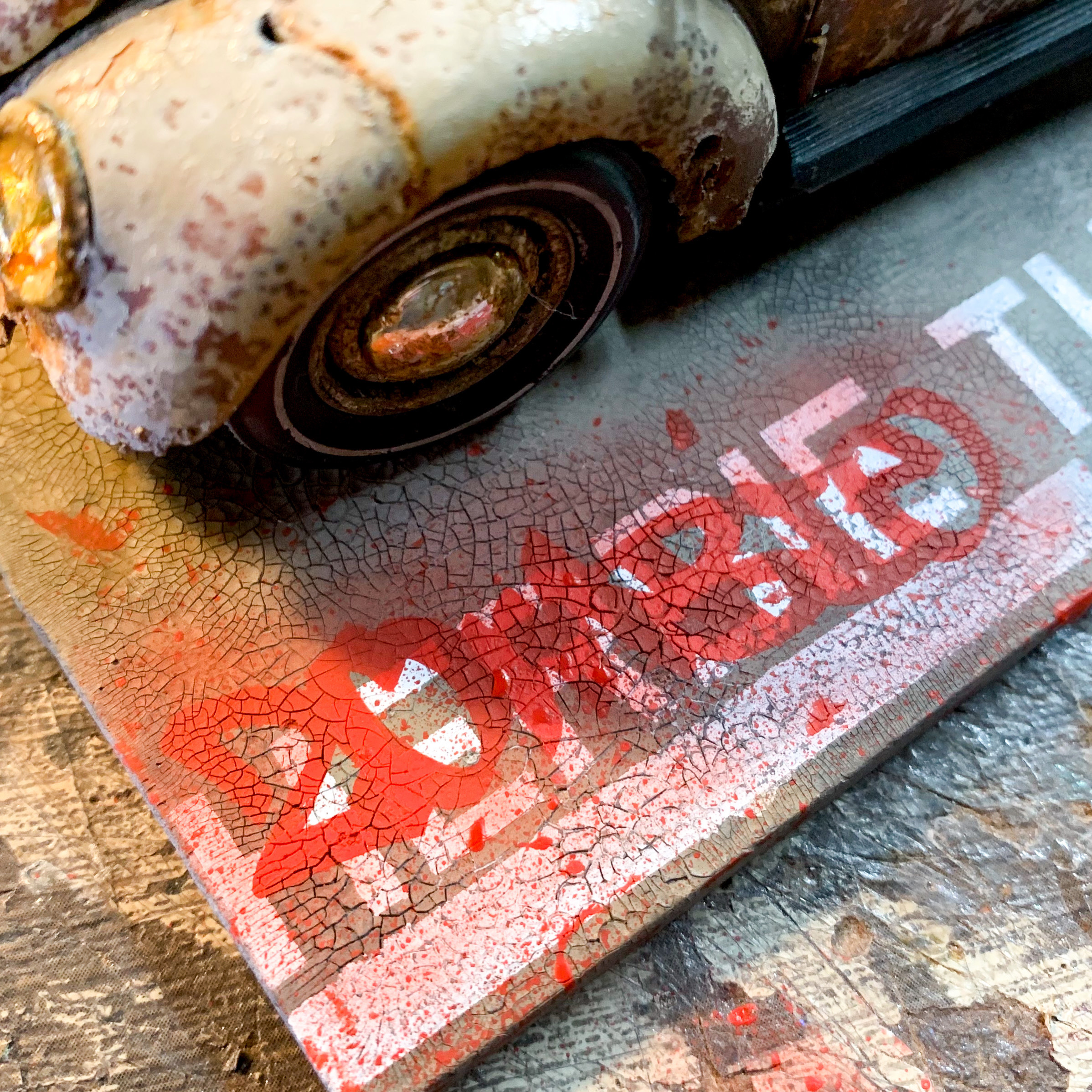

Next up, cut a mask to lay some lettering down on the road there:
Painted it white:
Then cut another mask, and shot some red over THAT, followed by some freehand misting and a few splatters:

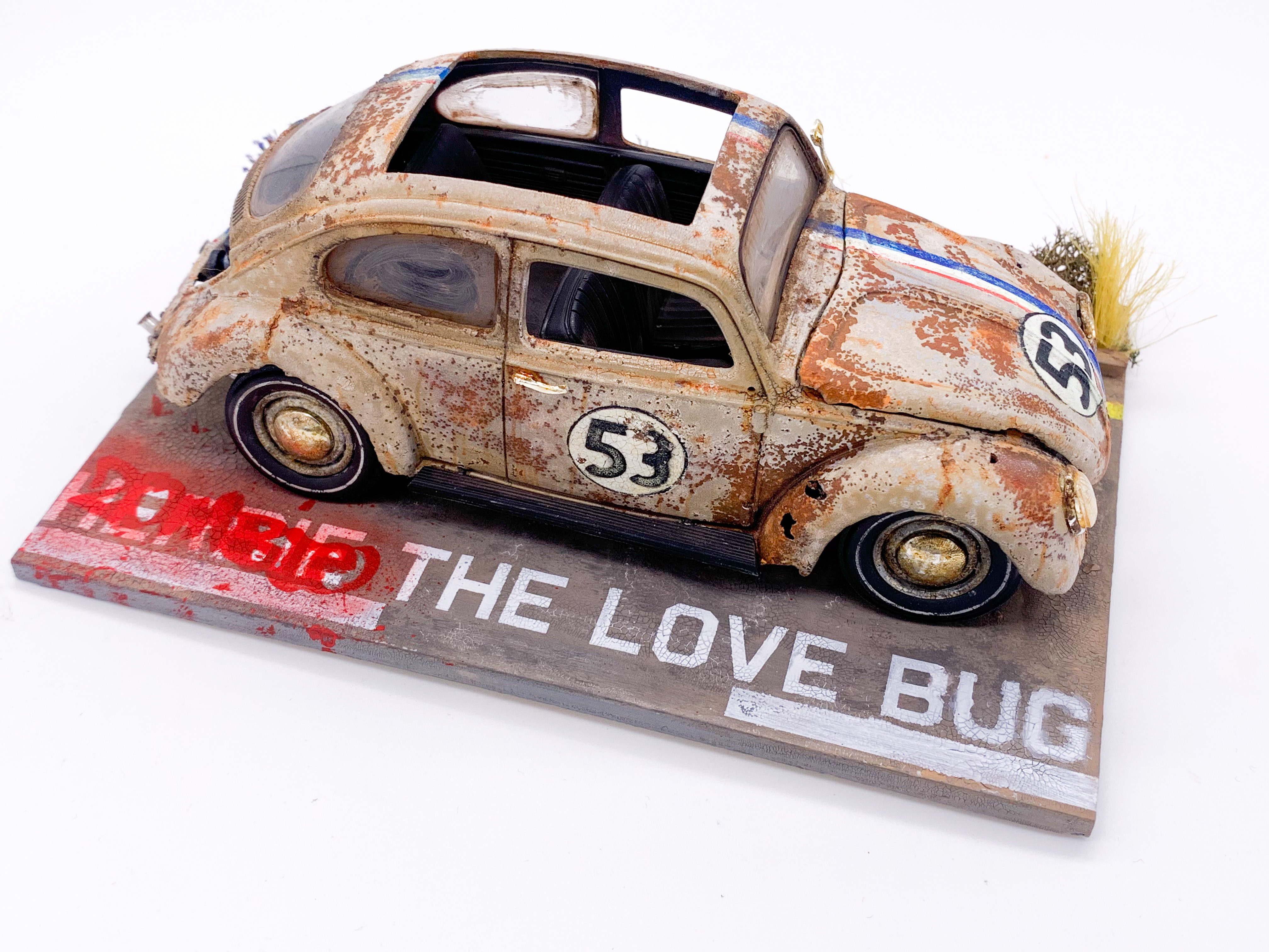

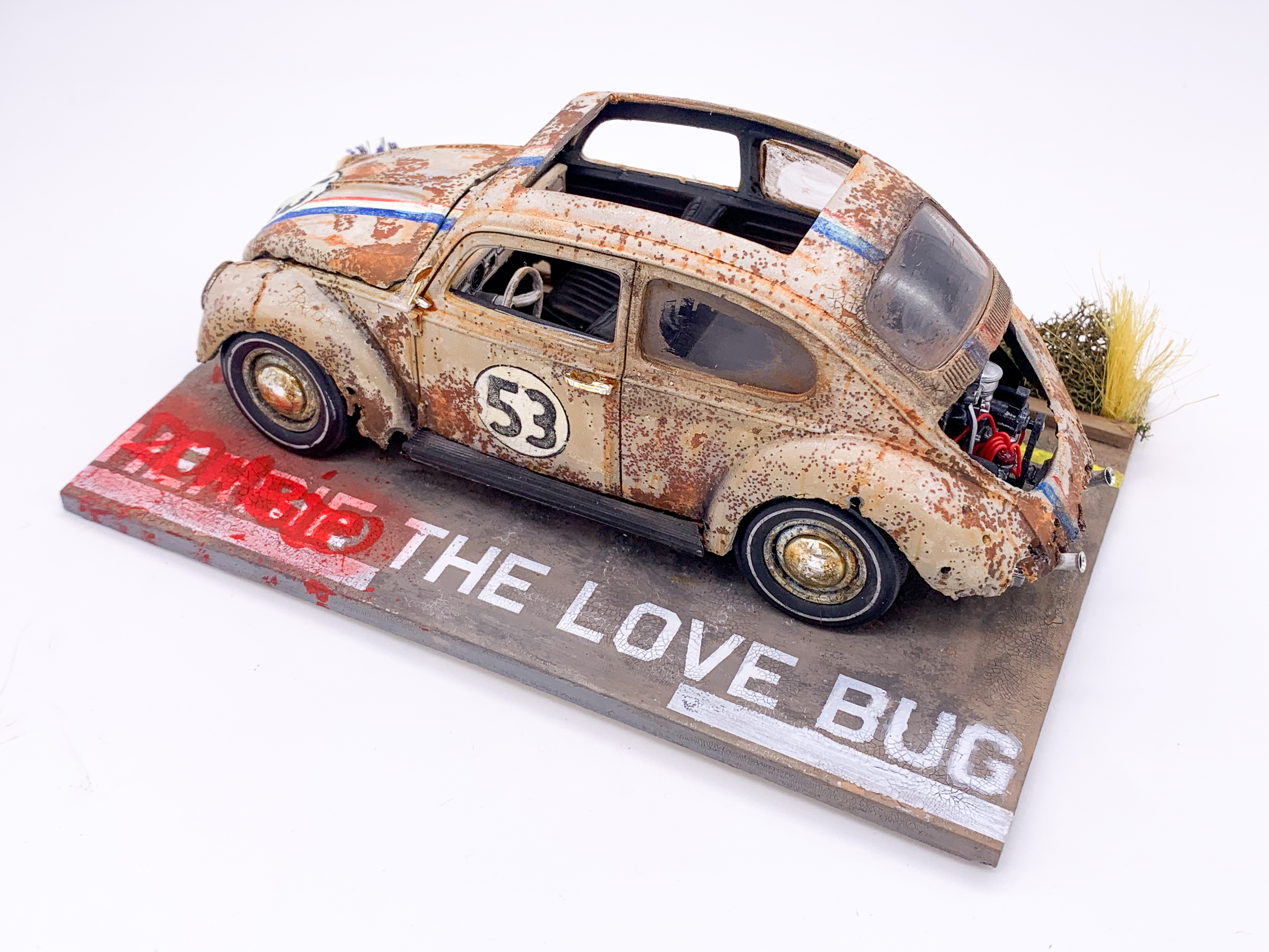

And that’s about a wrap on this one!  Could’ve gone more detailed but I really just wanted to get this idea out of my head and onto my shelf so I could stop thinking about it!  Thanks for following along!
