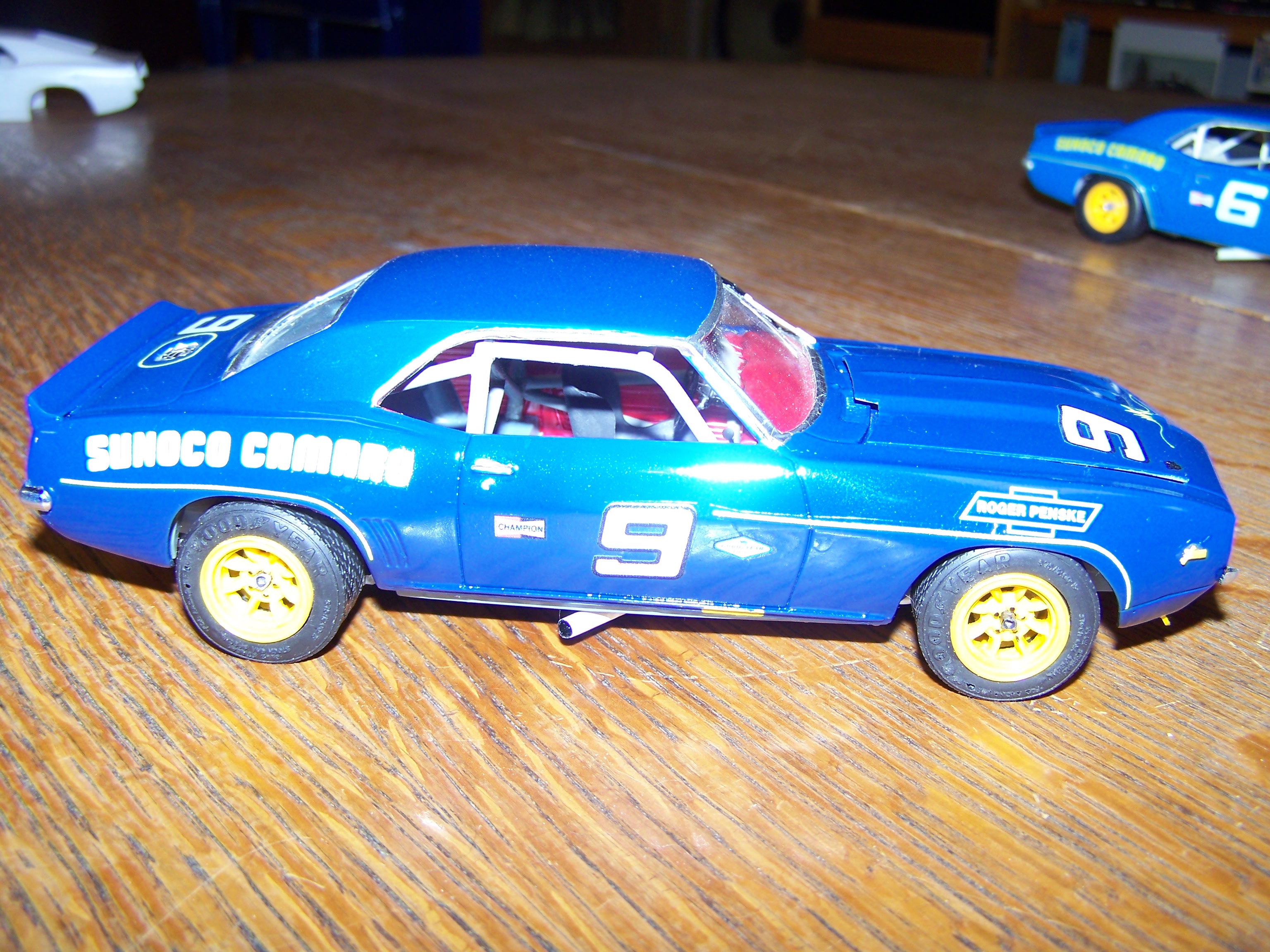

There was somebody selling the complete conversion kit for the 69 Camaro for Trans Am, but I haven't seen any lately. It had roll bar, dash, bucket seat, spoiler, & some other stuff. He also was selling a resin cast 69 Camaro body with fared wheel wells I bought both to build the Sunoco #9 Penske 69 Camaro & used the Revell 89 Z28 kit for a donor. I bought the 67 Chevelle roll cage on ebay, but have yet to use it.

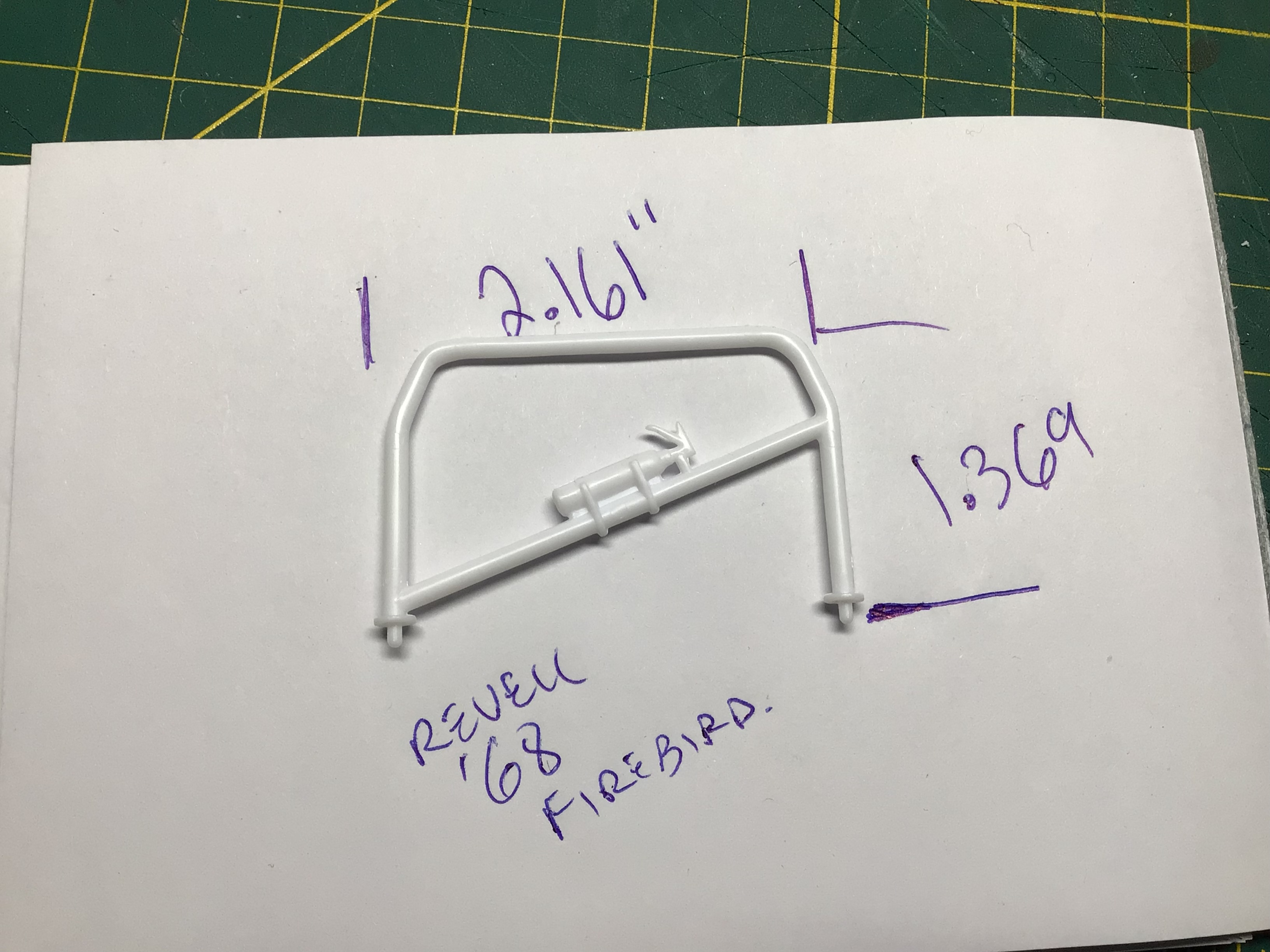

The Nova doesn't have one. I can check the Firebird.
Not sure the Firebird has one.  If it has a roll bar, it would likely be a good fit inside the Camaro body (a good roll bar is usually closely fitted to the available space) and built upon with styrene rod to get a full cage.
10 minutes ago, Exotics_Builder said:
This is what the Revell instructions show
I can check the kit to verify, if needed
It’s only a roll bar, no cage…but here are the dimensions. Diameter is .017”.
Edited by NOBLNG
That one would be a good starting point.  It should at least have the two bars added that extend to the back, making it a four-point.  It wouldn't be tough to add those, and side braces extending forward.  Adding pieces to make it a full cage would be more work, still do-able though.
