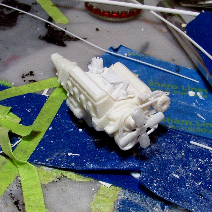

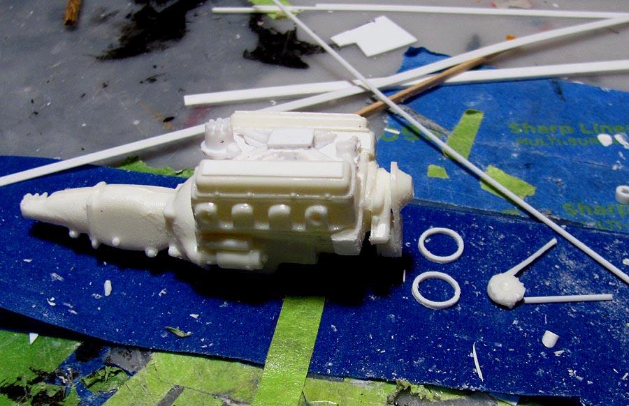

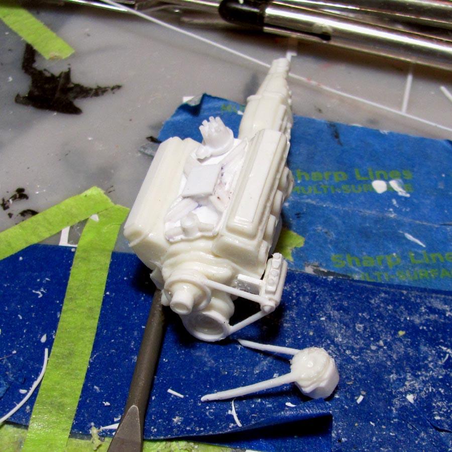

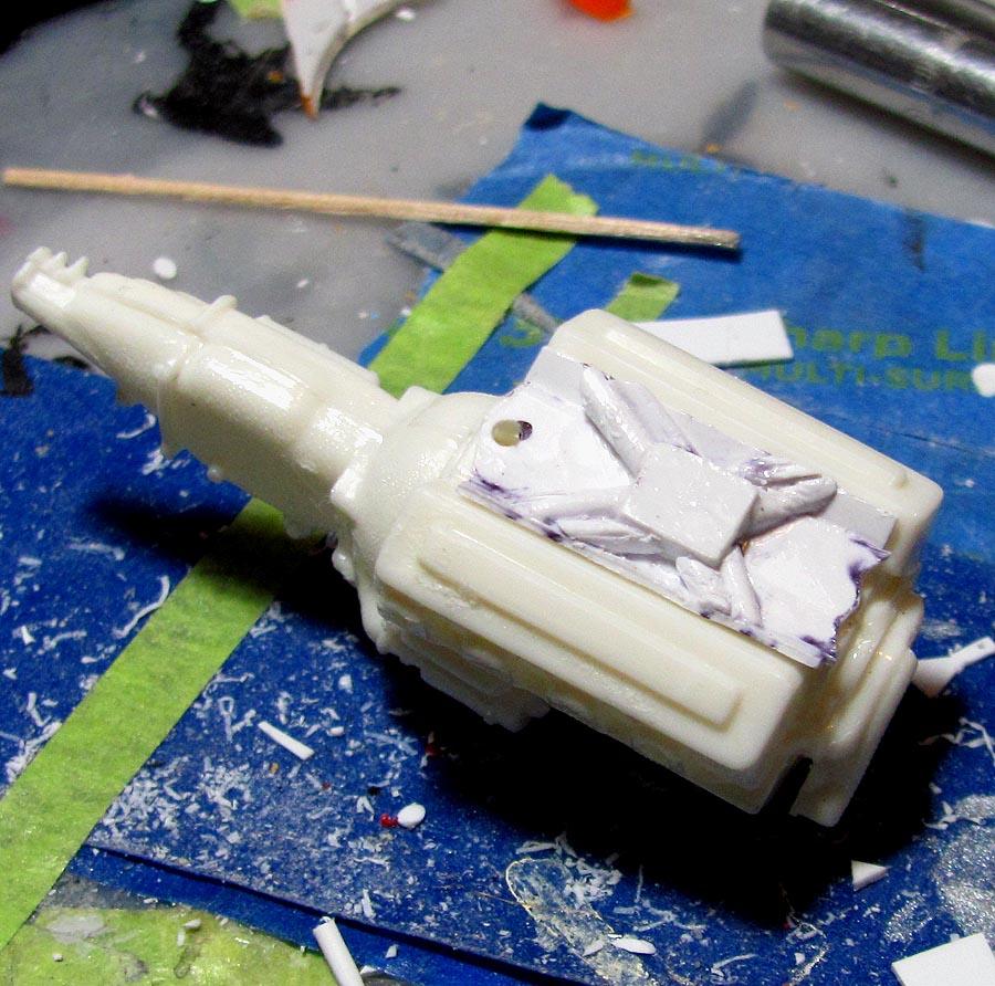

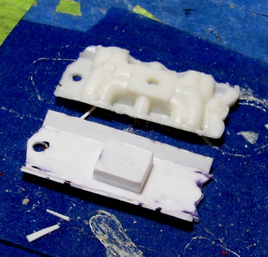

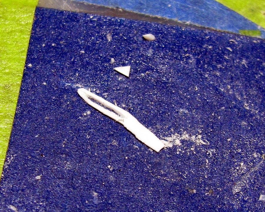

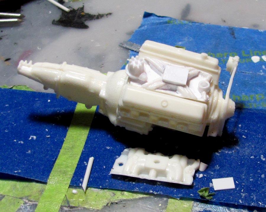

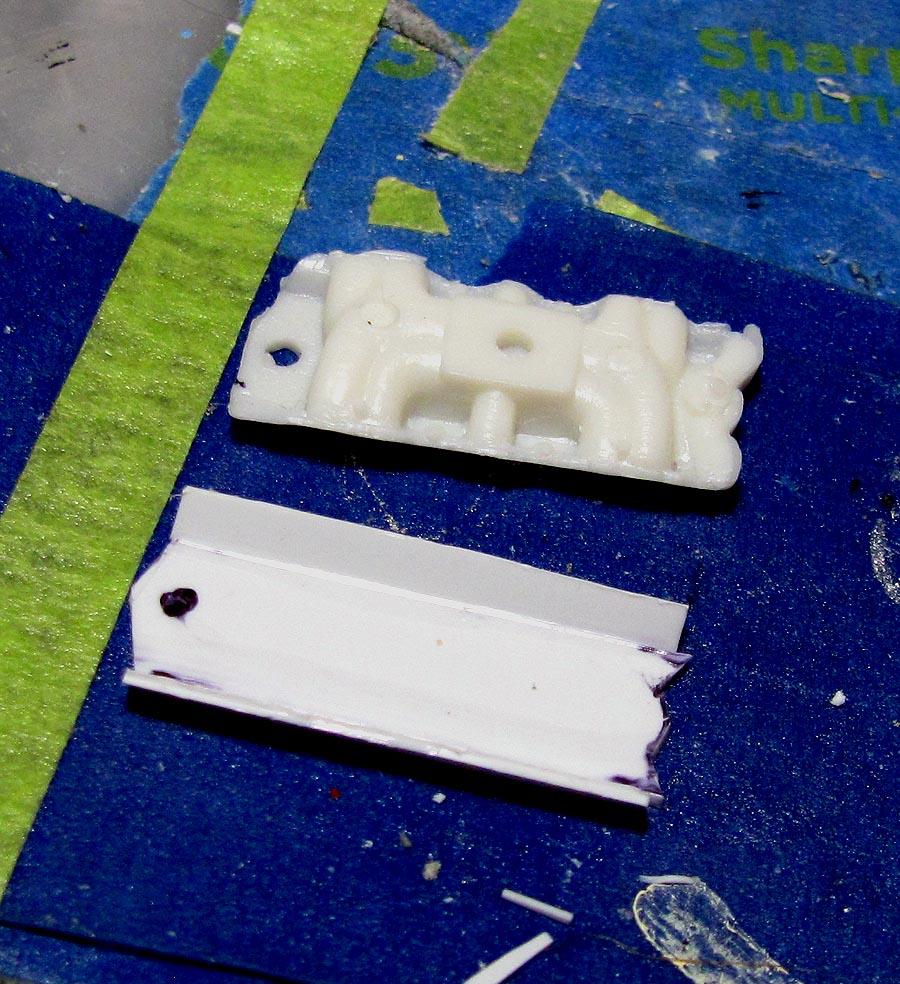

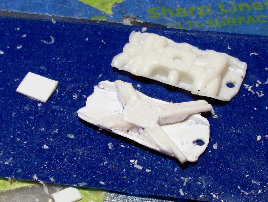

The model needed an early seventy's single plane intake manifold, so i'm trying to make one. Needs a lot more work.
2 hours ago, Pierre Rivard said:
Talk about detailed research! I should spend more time with intake manifolds. Definitely interested on how you will fab this one!
Thanks Pierre. Yes, I have a lot of adjusting to do on this one.
Need to add some more stuff, and modify the air cleaner and valve covers, and make some headers. I only have one ref picture of under hood, so alot will be a guess.

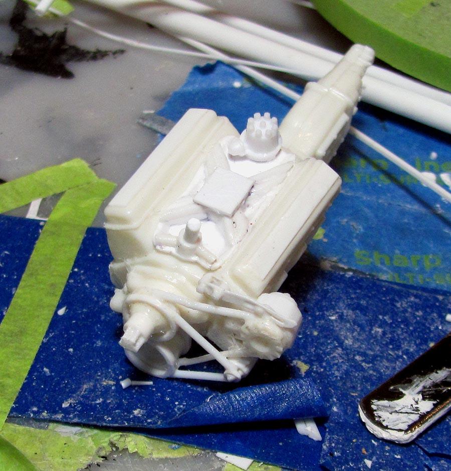

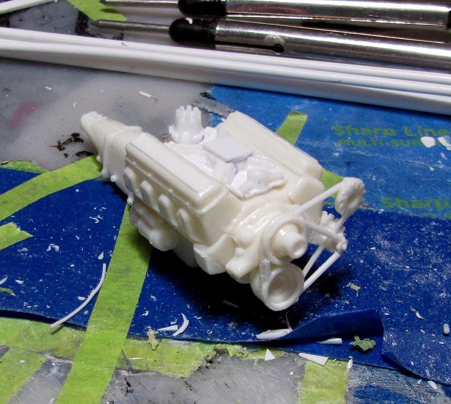

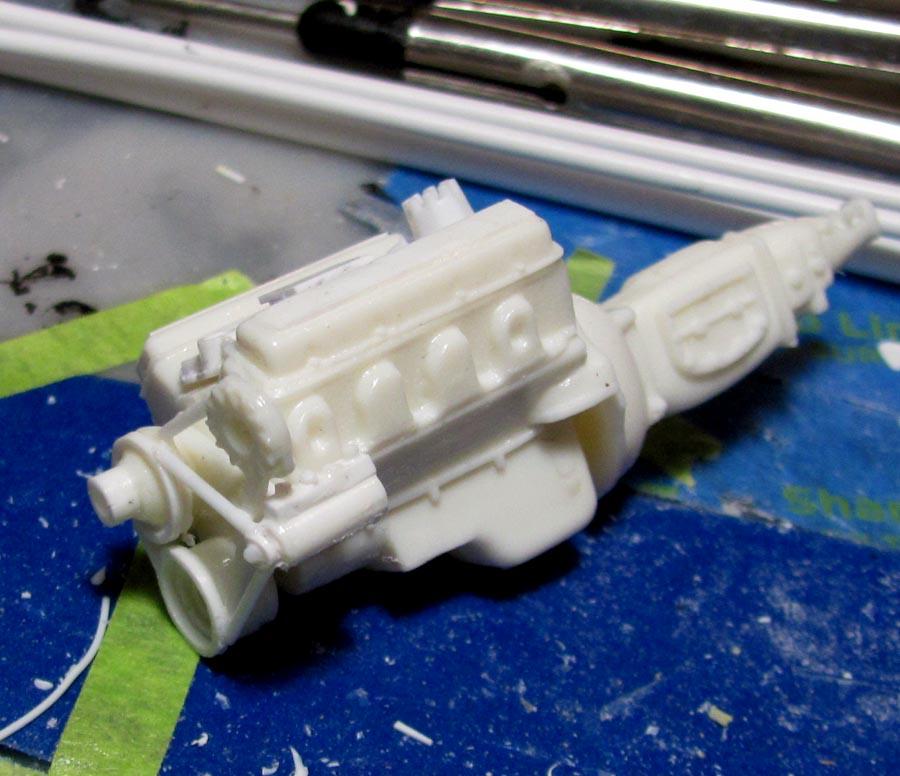

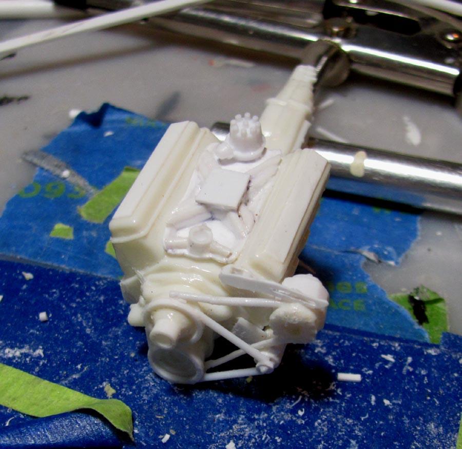

It's taking shape. The part on left side of the accessory drive is a dry sump pump?

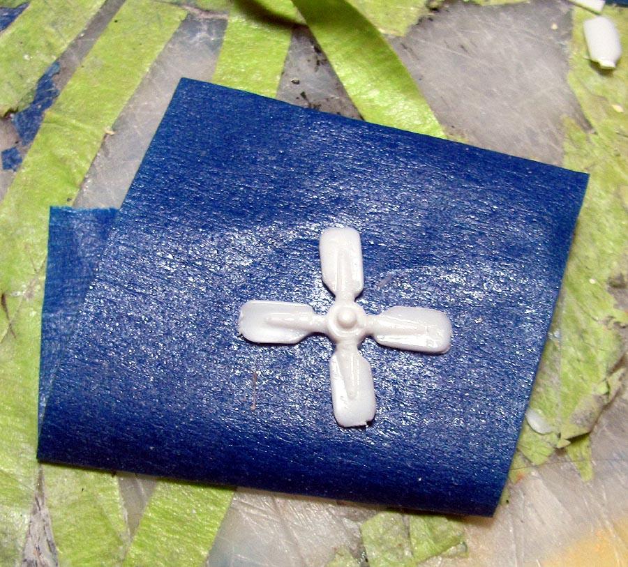

Yes Pierre, it's supposed to be. I don't have a view of the actual pump, so I just made one up from pictures of hopefully pumps from the early seventies. Once the headers are installed you won't be able to see much of it anyway.

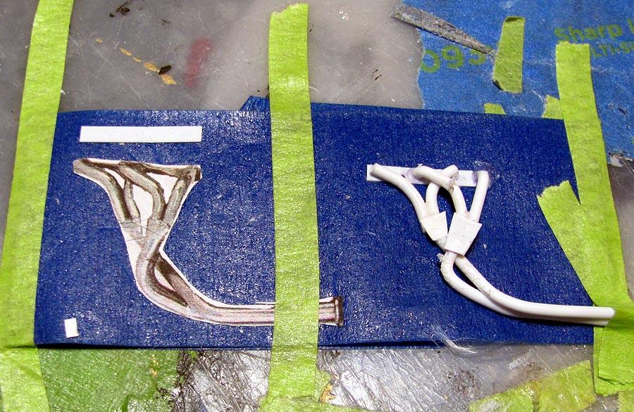

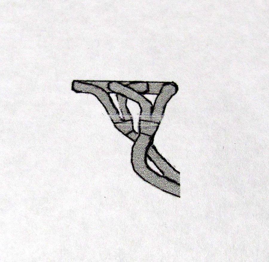

After I get the alternator completely mounted and make and install a fan, I can make the headers. I might try making them out of plastic tubing instead of solder. I have a pretty good idea what headers were used and have pretty good ref pictures of them. They are 2 into 1 and the those 2 into a collector. Kind of weird headers
Hey there Mark.  Looking good so far Buddy, will be interested to see your header construction. I used solder on one set I built and aluminum wire on another. I think I preferred the aluminum wire.   Good luck.
Hopefully tomorrow. I want to make a right-side scale pattern for the right-side header. I also needed to add some more to the left side pattern. I will use folded over masking tape which essentially makes it 2-sided tape to hold the tubes together while I drop adhesive on the joints to bond all the tubes together. I think it should work. The adhesive won't stick to the tape.
I found a picture of the headers I wanted for this build, so I took the photo to my graphics program and turned each image of the header left and right profile shots, into 1/25 scale sized images. I then made a double-sided masking tape deal to put the image on one side and use the image as a pattern for making the pieces of the header. the sticky side of the masking tape holds the pieces together and then you hit the joints with the brush from the adhesive bottle. I'm using "the same stuff" adhesive. It's a clear liquid that bonds in about 20 seconds. You then wait 24 hours to get a permanent strong bond so you can work with the piece by trimming and sanding it and even filling it if need be. It's not perfect but the process works and the header will glue to the engine and I'm hoping look better than using solder.
Need to clean it up a bit and prime and paint it. The headers were white on the real car. I don't know if it's some kind of porcelain finish or what. Going to try to do the right header today. In the last picture, the header is not installed. it's just placed in position.
