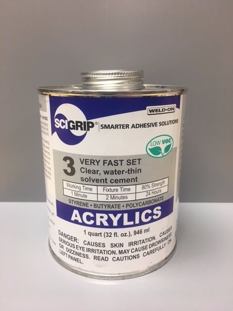

Pete J. Posted July 18, 2021 Posted July 18, 2021 If cost is your primary objective then you can't beat Weldon 3 or 4. It is about $25 a quart. You can get it on line or at your local plexiglass fabricator's. Every model I have built in the last 20 years was assembled with that stuff. I have a small 1/4 pint can that was my original purchase and just refill it from the quart bottle. A quart lasts me for years. Just never ever leave the top off overnight. The 1/4 pint will be gone in the morning. I also prefer the Touch n Flow applicator I got from Micro Mark for application. Very precise and easy to control. 1
peteski Posted July 18, 2021 Posted July 18, 2021 Yes Pete, I also have a small arsenal of liquid cements. I use Weld-ON 4SC and also 3. 4SC actually mentions Polystyrene, while 4 does not. Both of these are based on Methylene Chloride (similar to the old Tenax cement), and they evaporate *VERY* fast. Sometimes it is too fast. That's where MEK-based cements come into play. When a longer open time is needed, I use MEK-based cements like Testors. They are both useful, in different ways.

Pete J. Posted July 19, 2021 Posted July 19, 2021 11 hours ago, peteski said: Yes Pete, I also have a small arsenal of liquid cements. I use Weld-ON 4SC and also 3. 4SC actually mentions Polystyrene, while 4 does not. Both of these are based on Methylene Chloride (similar to the old Tenax cement), and they evaporate *VERY* fast. Sometimes it is too fast. That's where MEK-based cements come into play. When a longer open time is needed, I use MEK-based cements like Testors. They are both useful, in different ways. Never heard of SC. My large can is empty so I will seek it out.
peteski Posted July 19, 2021 Posted July 19, 2021 I'm pretty sure they are all based on Methylene Chloride. Probably the ratio of secondary ingredients is different between all those variants. To be honest, I originally had the "3". I picked up the 4SC because that was what a dealer had available at one of the model shows couple of years ago.
