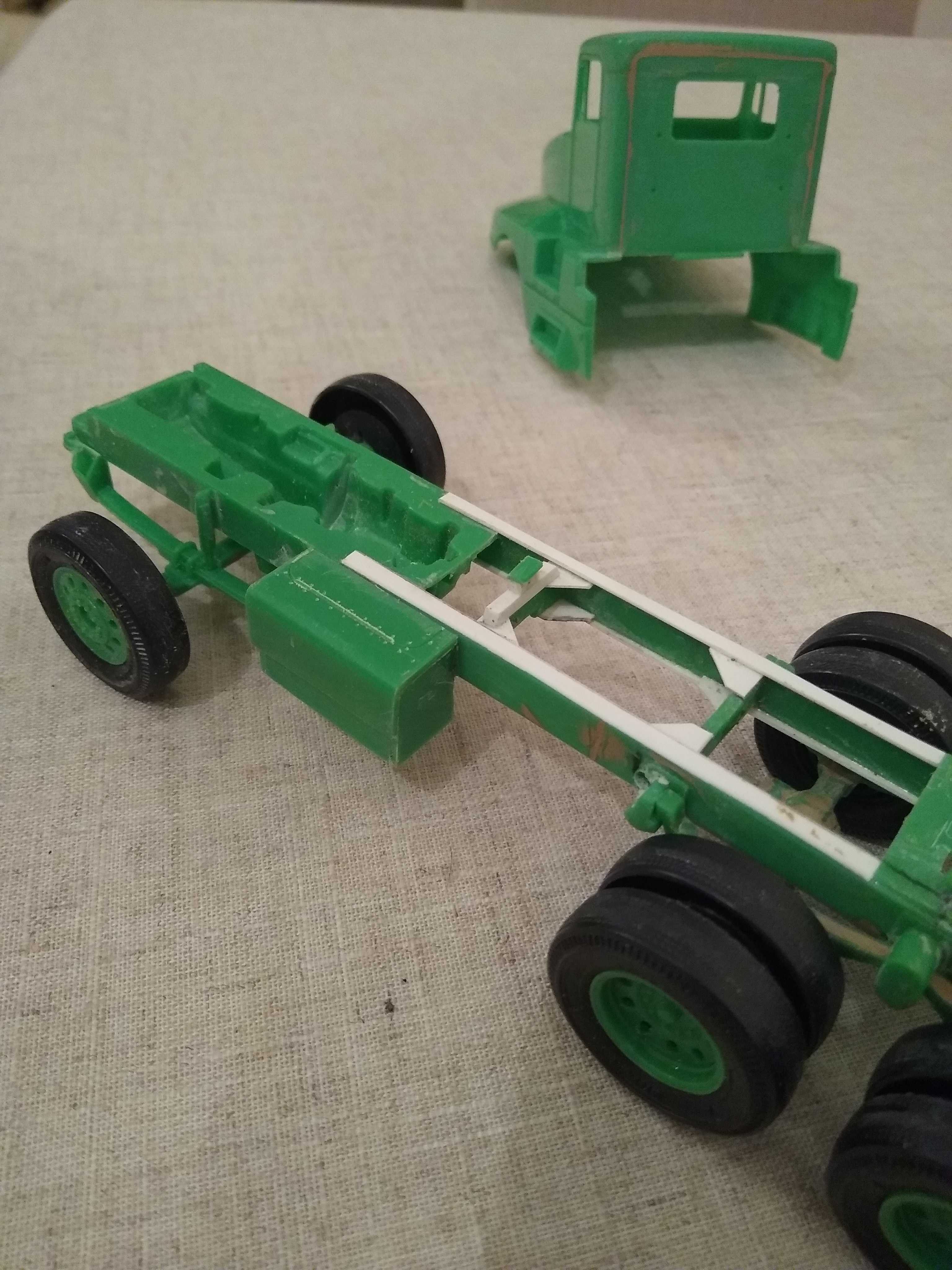

Rockford Posted August 10, 2021 Author Share Posted August 10, 2021 (edited) 14 hours ago, Jim B said: Nice work on the daycab & shortening the frame. That sure is some bright green plastic! Thanks for the kind comments gents, JIm you're right that is GREEN! Don't know whether it's worse to look at than the old red version. At least I shouldn't have any bleed through problems with the paint. Here's Kermit next to his full length stable mate. Edited August 10, 2021 by Rockford Added pics Quote Link to comment Share on other sites More sharing options...

Rockford Posted August 14, 2021 Author Share Posted August 14, 2021 I tried using oven cleaner to strip the chrome from the wheels, grille, stack and tanks but after two days it didn't work any better than household bleach. It stripped the chrome in seconds but not the lacquer beneath. Never mind. I'll only be fitting one tank and I'll be ribbing it down anyway to remove the seam. I'll do the grille in aluminium and then foil the outer edge and the middle bar. I added top and bottom rails to make the side rails C-Sections, added some fillets to the crossmembers and filled the diffs with sprue and offcuts from the kit. When it's all solid I'll start shaping the diffs roughly then use filler to finalize the shape. I filed the plastic representation of the flap off the top of the quarter fenders and replaced them with electrical tape, as I do with the mudflaps. Quote Link to comment Share on other sites More sharing options...

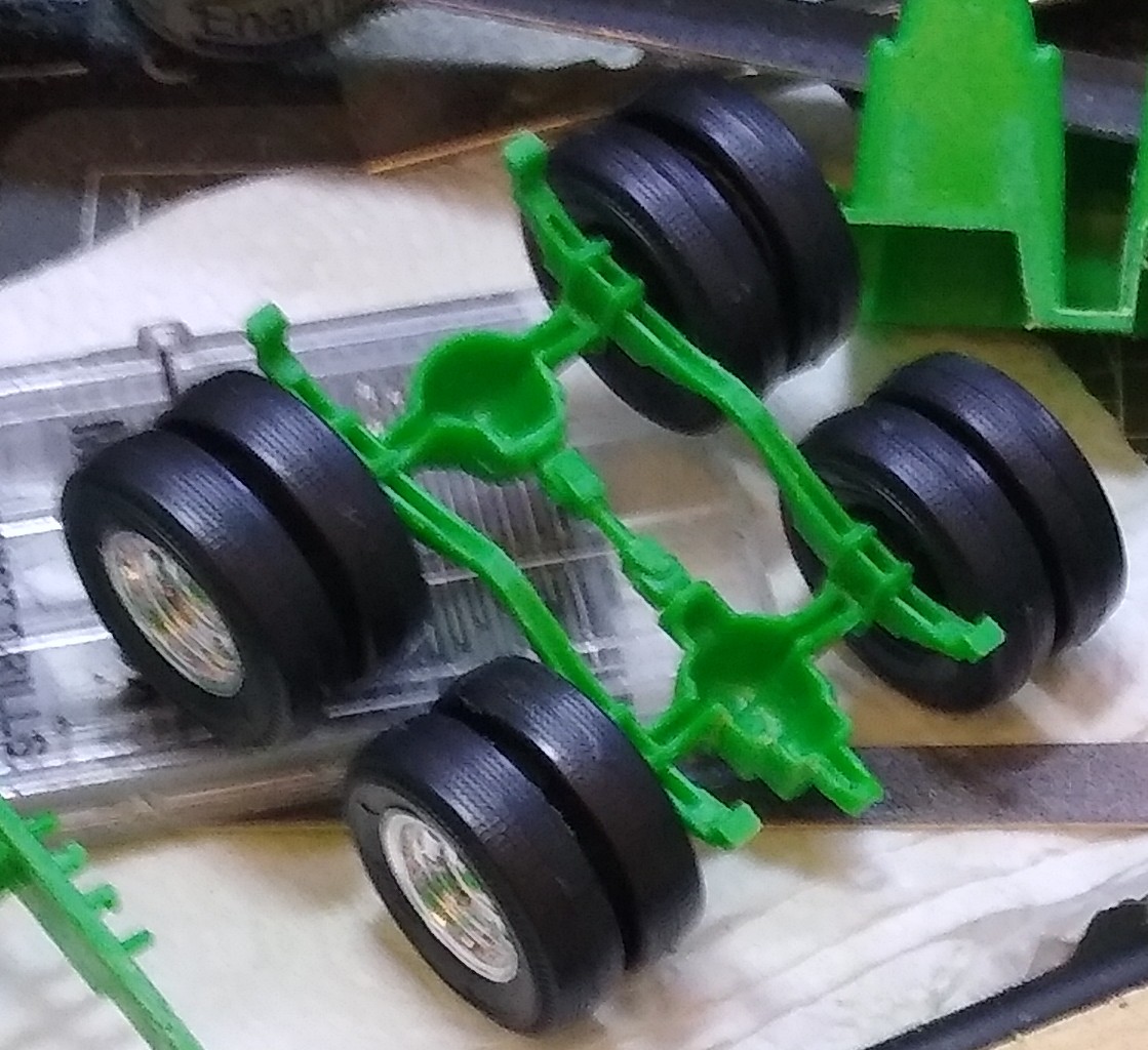

Rockford Posted August 21, 2021 Author Share Posted August 21, 2021 (edited) Not much to report. Having filled in the open topped differentials with sprue and offcuts I roughly ground them into shape with my die grinder and some files, then used filler to develop a finished shape. Filled the hollow leaf springs too. In the last picture you can see how the duals started out. Built a battery box from the remnants of the sleeper and filled the joint in rear wall of the cab. I machined some brake chambers and brackets. Will add flexi lines to them as well as slack adjusters etc... Edited August 21, 2021 by Rockford Added photos Quote Link to comment Share on other sites More sharing options...

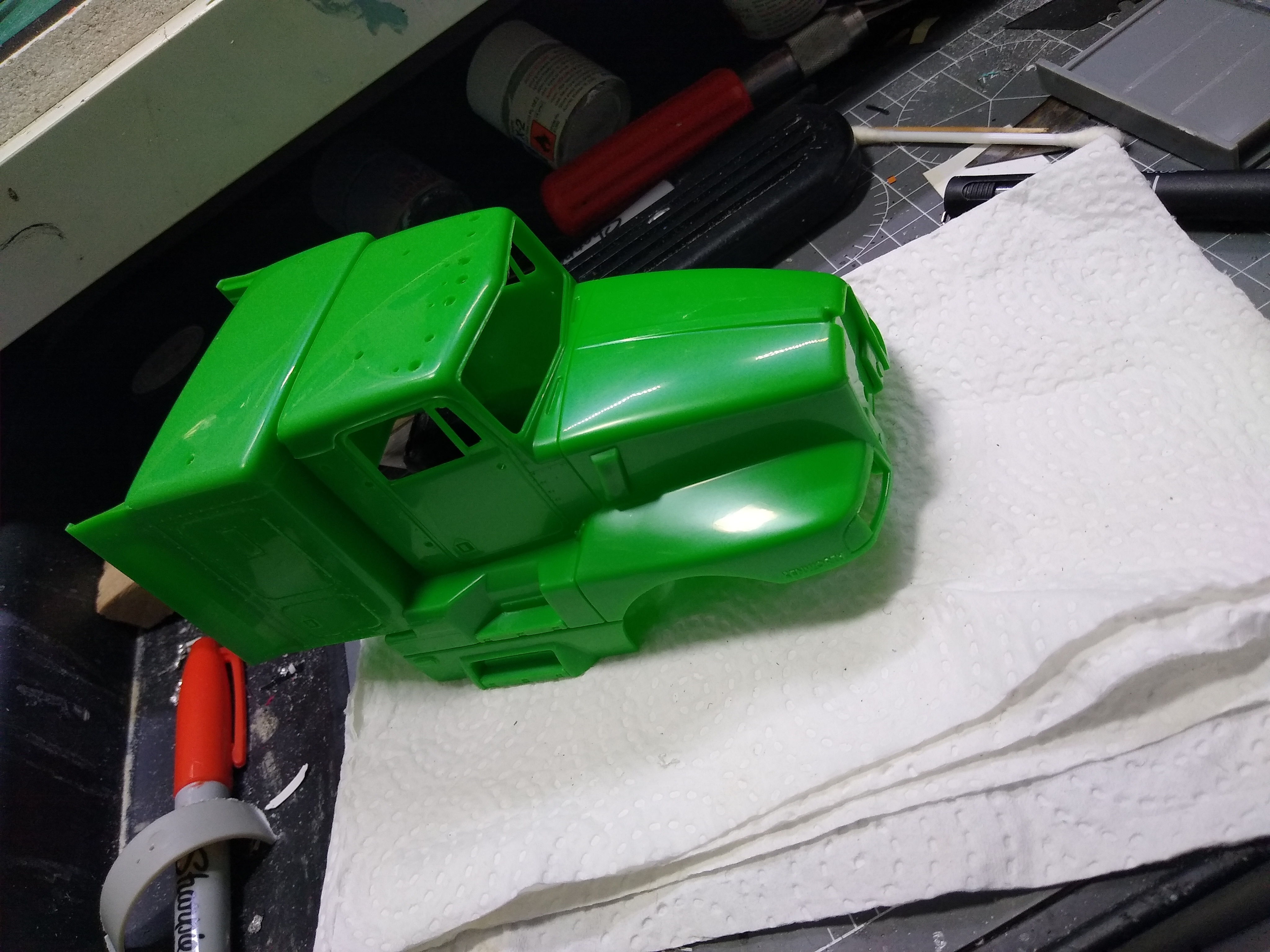

Rockford Posted October 9, 2021 Author Share Posted October 9, 2021 Got sick of looking at the green of this kit so got some primer on the thing today. Looks better because you can't see all the additions to the chassis, it just looks like one unit now. Looking at a red chassis and lower panels on the airkit and cream cab. Not sure about lettering or stripes yet. Quote Link to comment Share on other sites More sharing options...

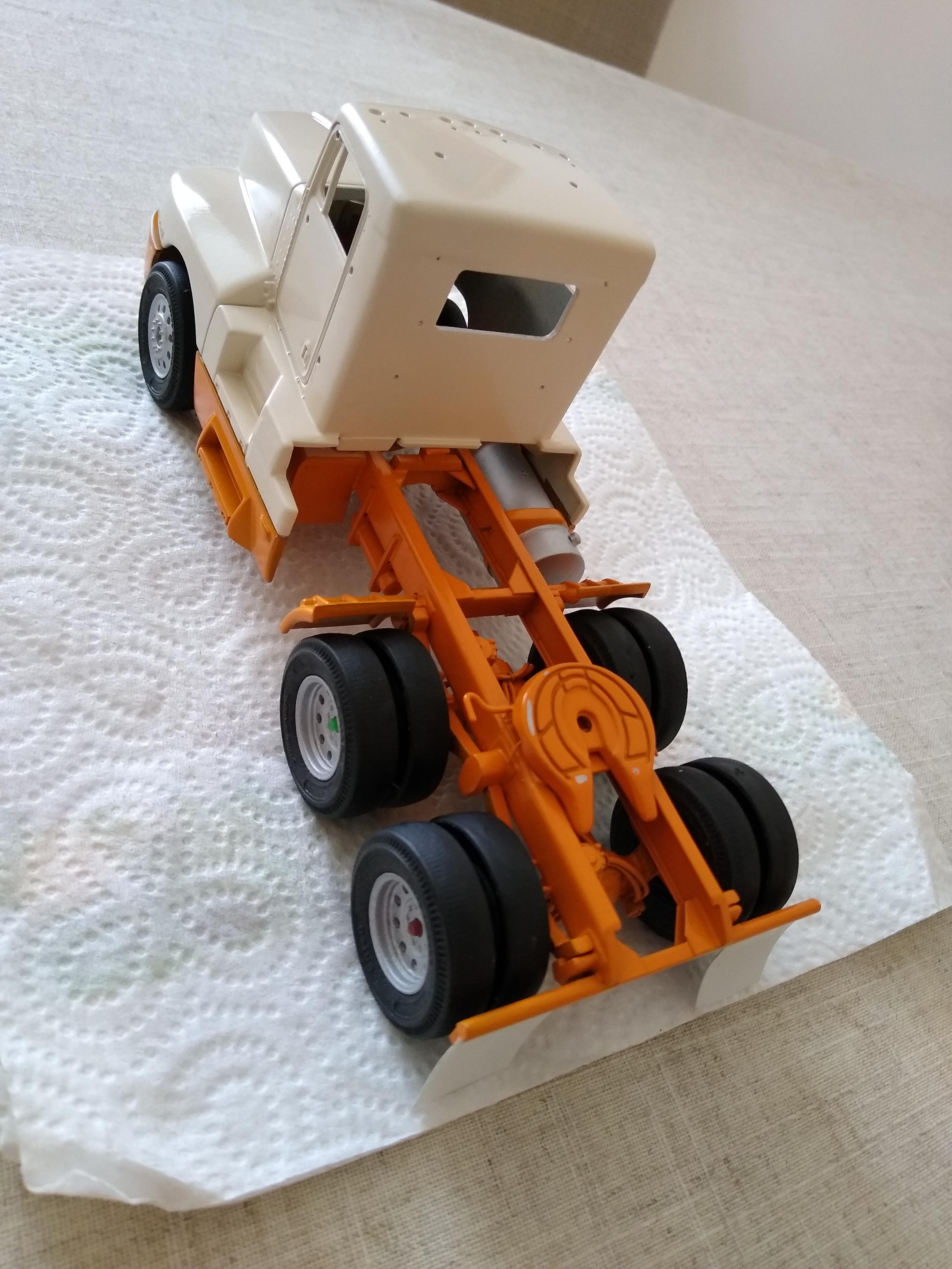

Rockford Posted October 22, 2021 Author Share Posted October 22, 2021 Thanks for the kind comments guys. Weather hasn't been too bad last few days so I managed to shoot my colours. I've added a couple of brake relays which are actually 1/25 carburettors from the Revell Z28 kit. I masked the lower apron of the aerokit with Tamiya tape (amazing stuff), also painted the fuel tank aluminium and masked off to paint the mounts and straps. Plumped for a Ford burnt orange, (can't remember the name) and Ford Ivory White for the cab. The two blend well together I think. Painted the tyres then covered them in white overspray, D'oh! I'll revisit them. Lot of work to do still but now that it's painted I know I can finish it in the lousy British Autumn/Winter weather. Quote Link to comment Share on other sites More sharing options...

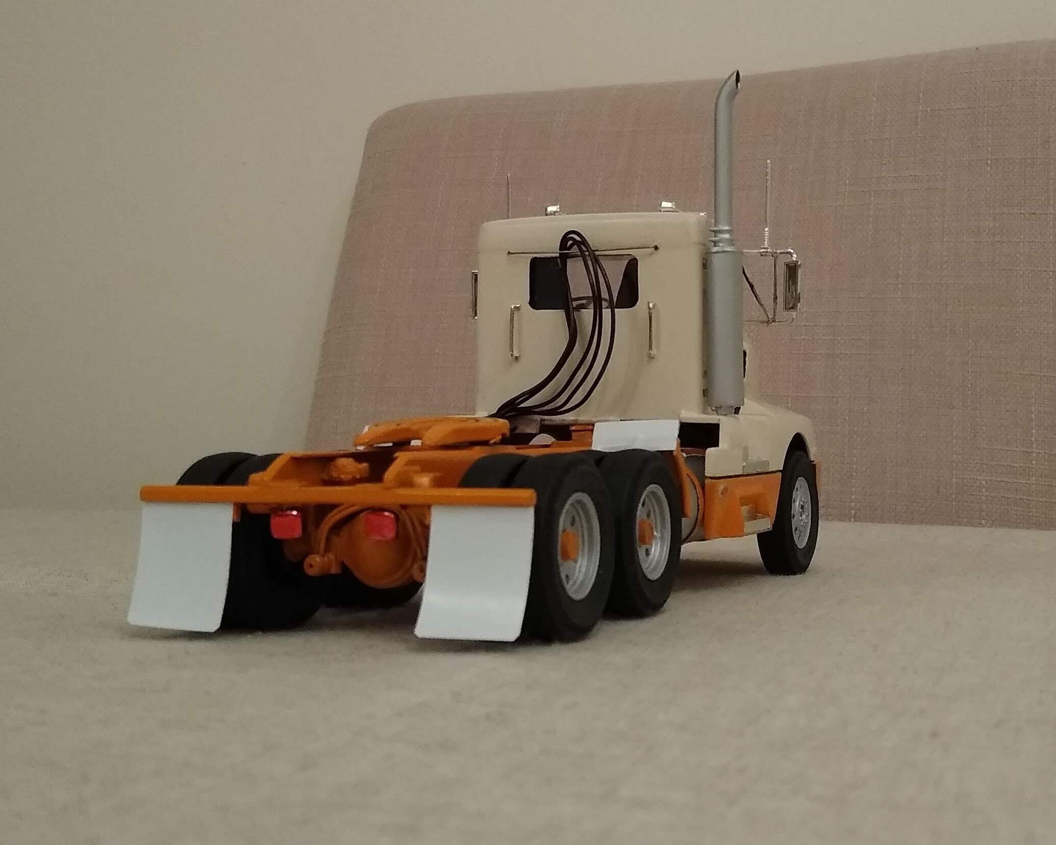

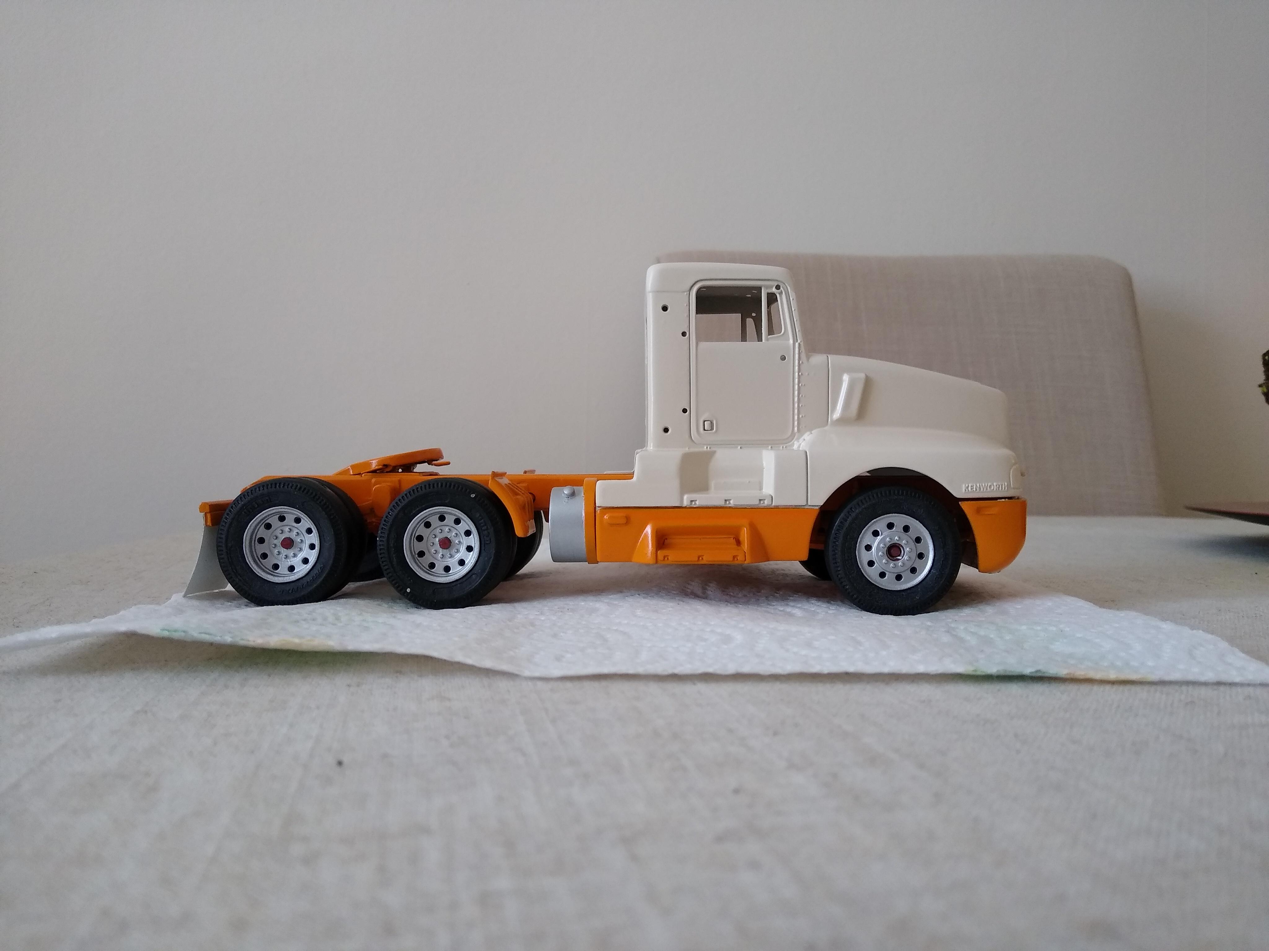

Rockford Posted October 30, 2021 Author Share Posted October 30, 2021 Started putting the makeup on the T600, bit of BMF and some panel lines. I added fuel lines to the fuel tank and made my mudflaps from electrician's tape. It's looking good. Still a lot to do. Quote Link to comment Share on other sites More sharing options...

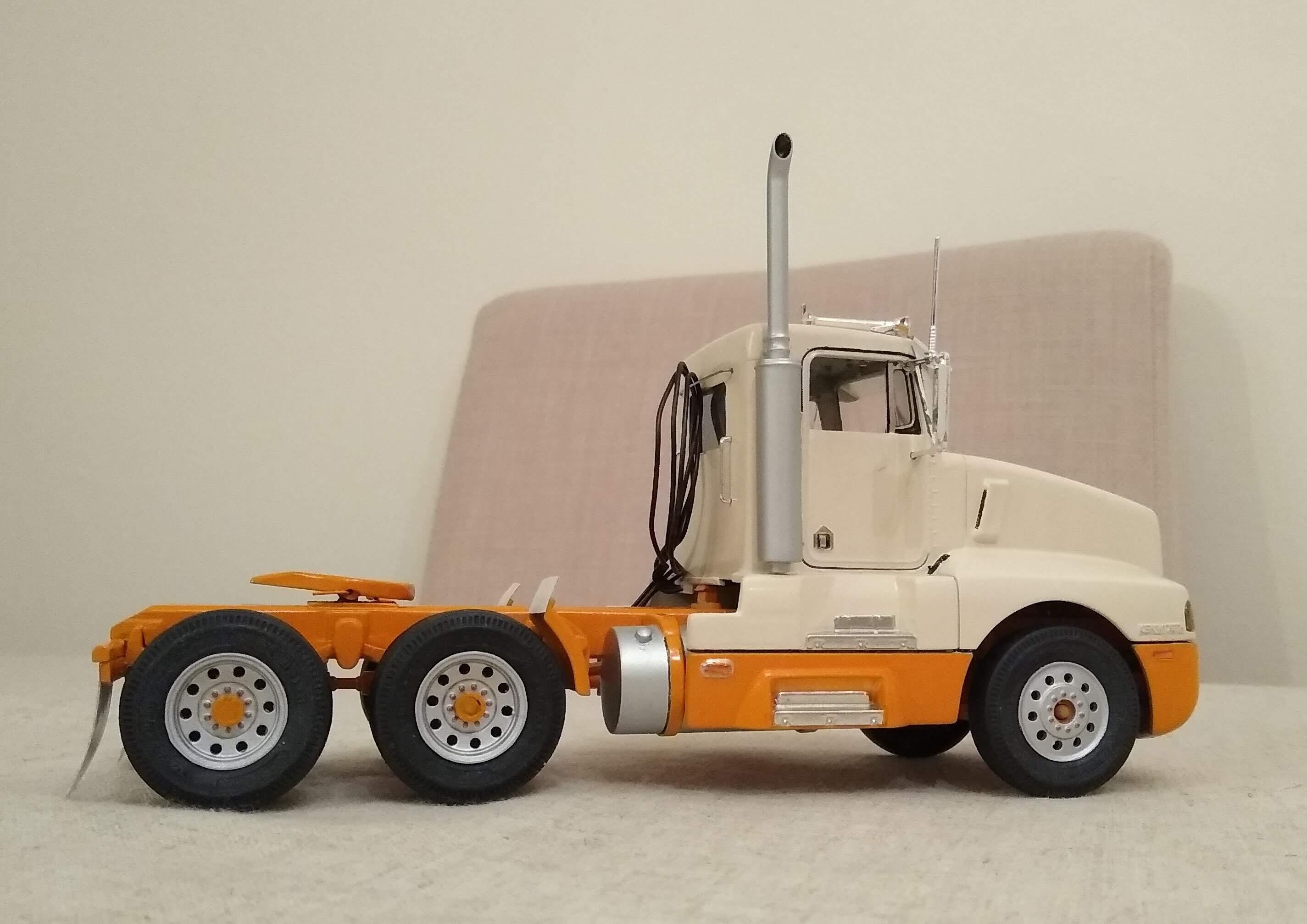

Rockford Posted November 7, 2021 Author Share Posted November 7, 2021 Pretty much finished with this one. Formed a visor out of sheet aluminium, added a sliding rail on the back of the cab for the airlines. Made some rear axle hubs out of 6mm plastic rod and some sprue. Got to think of lettering and/or livery to complete. I know it's only a snapper but it looks fairly good to me. If only it was the Snaptite W900 but they're as rare as hen's teeth now, so too the Freightshaker cabover. I'll keep looking out for them though. Quote Link to comment Share on other sites More sharing options...
