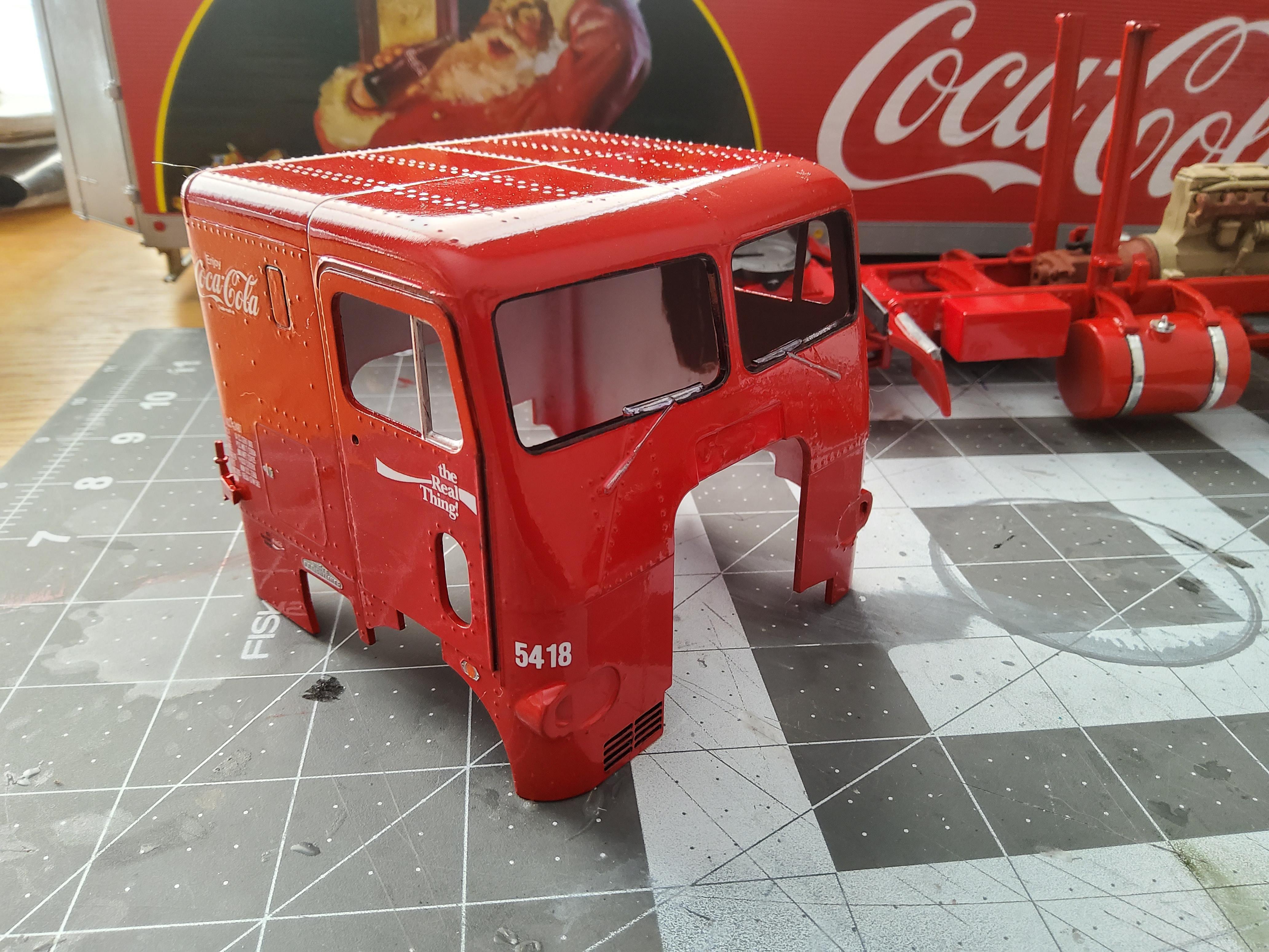

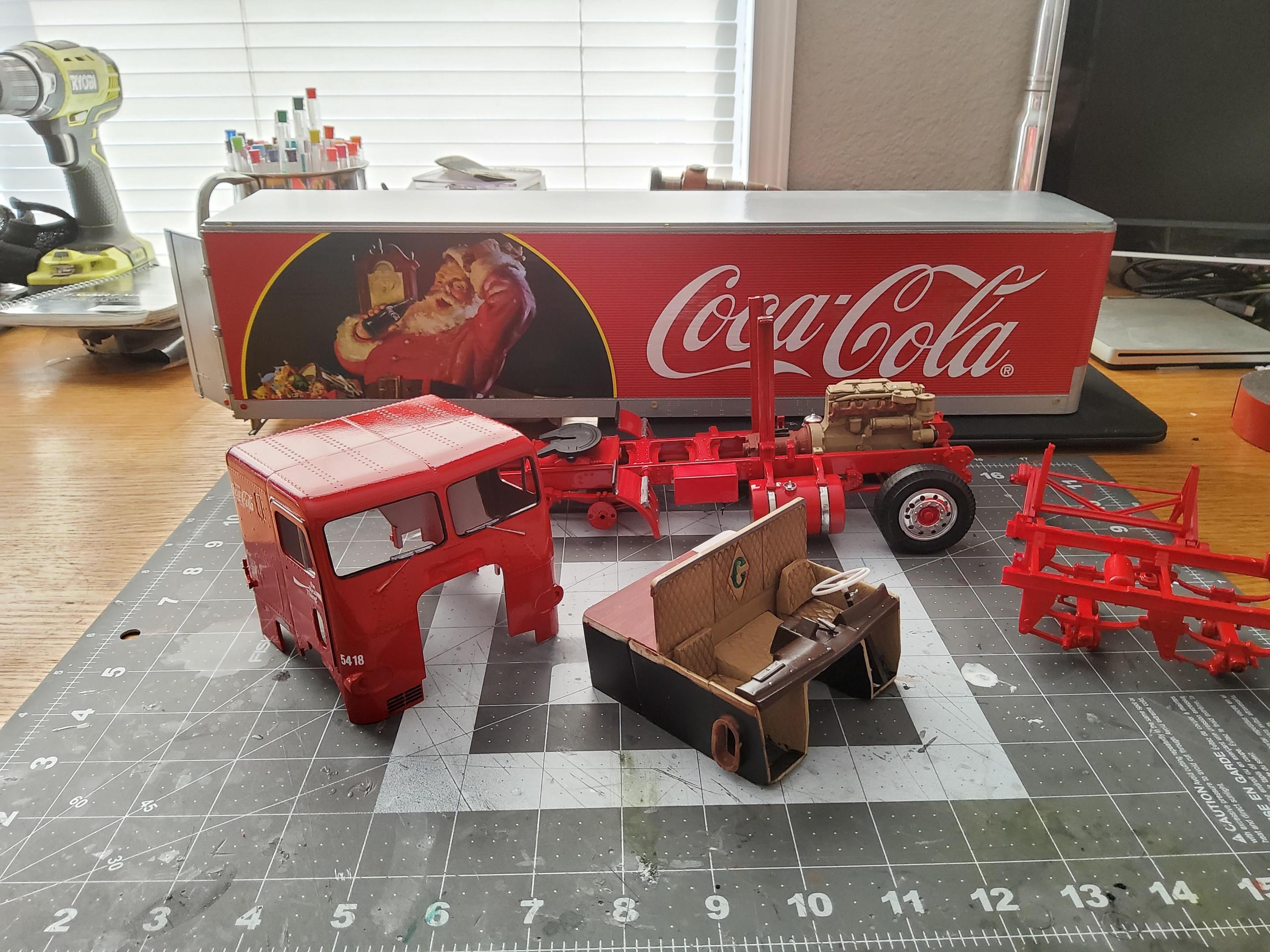

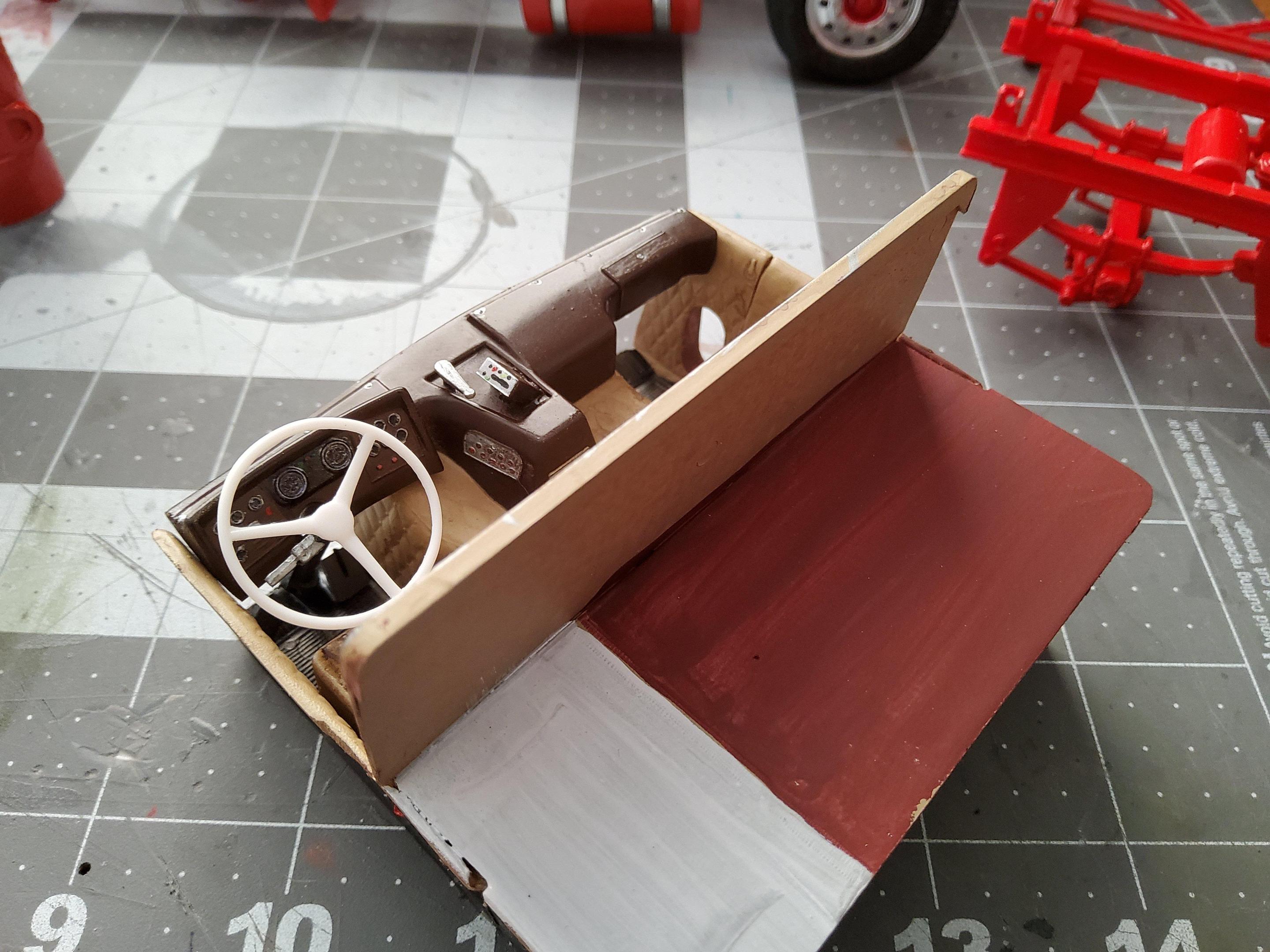

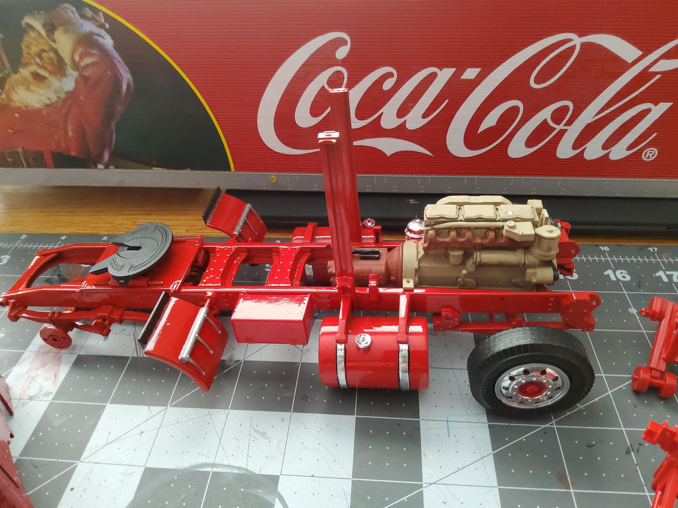

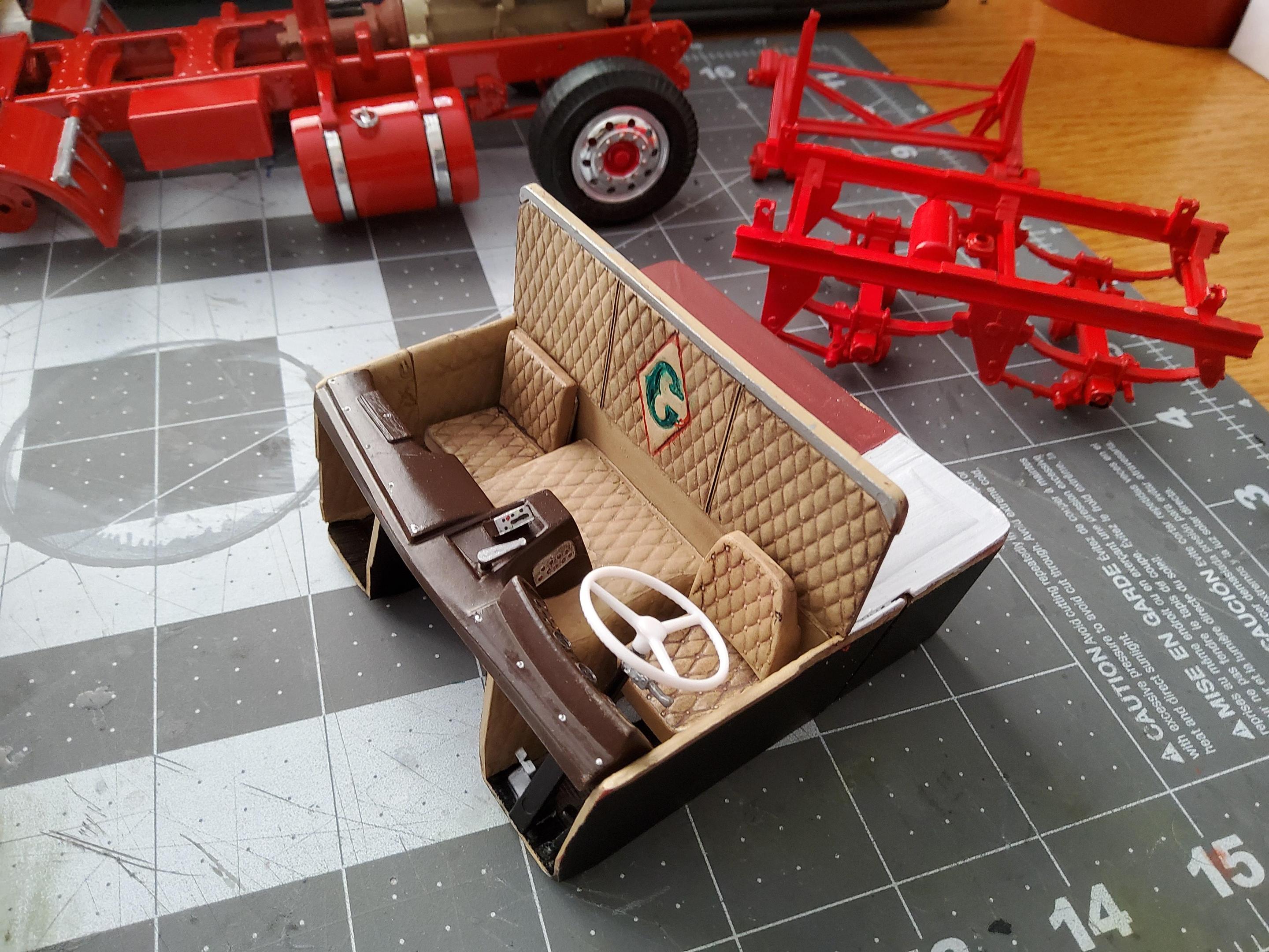

With that in mind, I am leaving almost all the chrome, except on the engine. So far all the paint is Rustoleum 2X Apple Red. Itis a very bright and true red, perfect for this build. The cab has been painted, decaled and cleared with Rustoleum Acylic Lacquer. I think I will leave the frame as is, it is shiny enough for a truck frame. The engine is just sitting on the frame, it is not in the right position. I painted the bed in the sleeper, but didn't waste much time on it as it cn't be seen once the cab is put together. I am aware of the flaws with this kit, I fixed the front axle, took out 1/4in. I however chose not to spend the time to lower the headlights, I did it on a previous one, and it was a lot of work. For the small gain, it just was not woth it too me. It also means you lose rivet detail and have to add it back somehow, I didn't want to deal wth it. I will be visiting Hobby Lobby to find a small wreath for the front, it will distract from the "high water headlights"

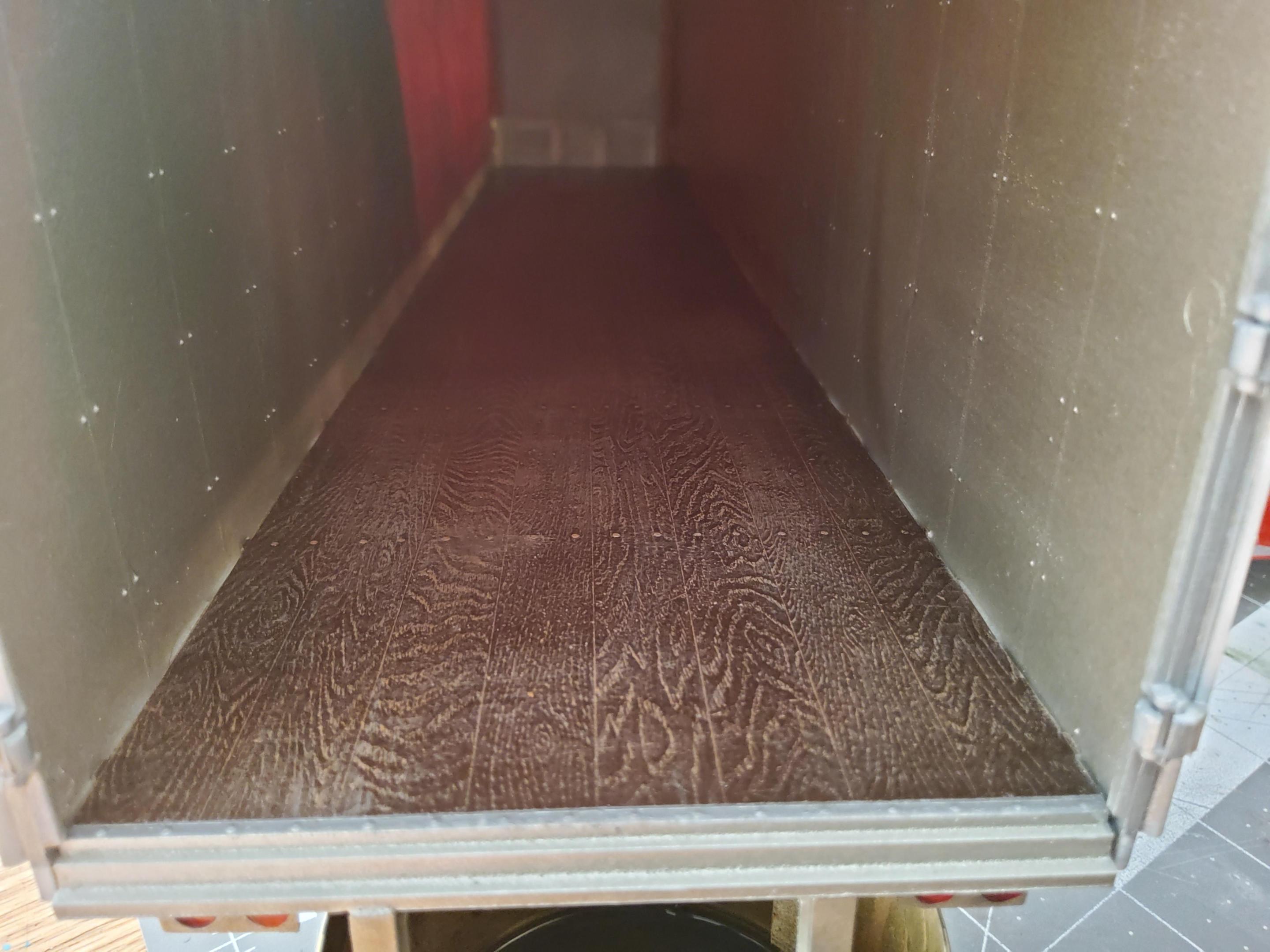

I have the trailer built, and some ofthe decals, but there are more to come on the trailer. Once finished it will get cleared the same as the cab. The trailer interior is Aluminum and I did the wood grain on the floor. It turned out really nice, but with the darkness inside, it will be hard to see. A dark base and some dry brushing brought out the molded in wood grain.

Really nice job on it. I like the treatment of trailer interior - very realistic.

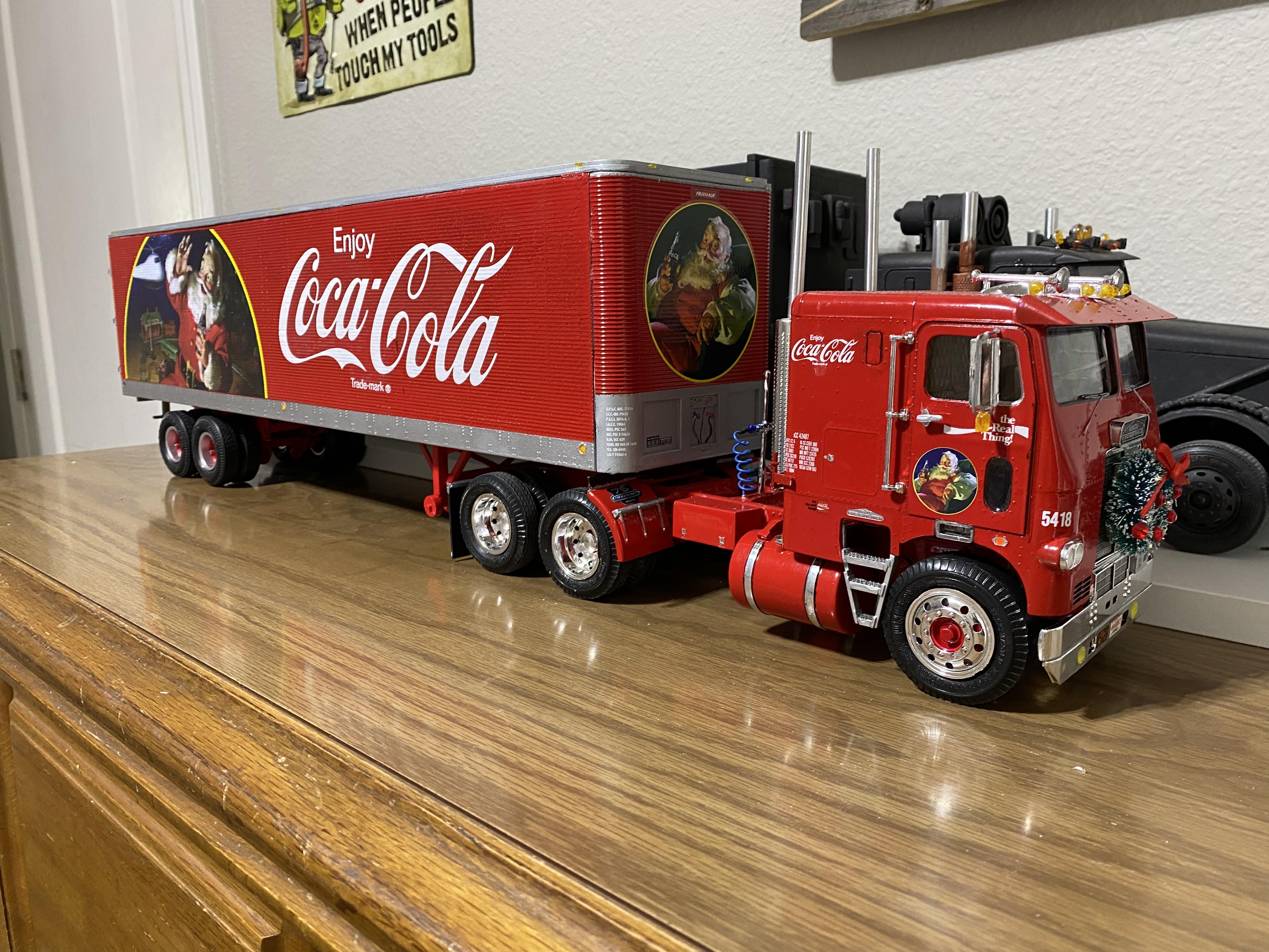

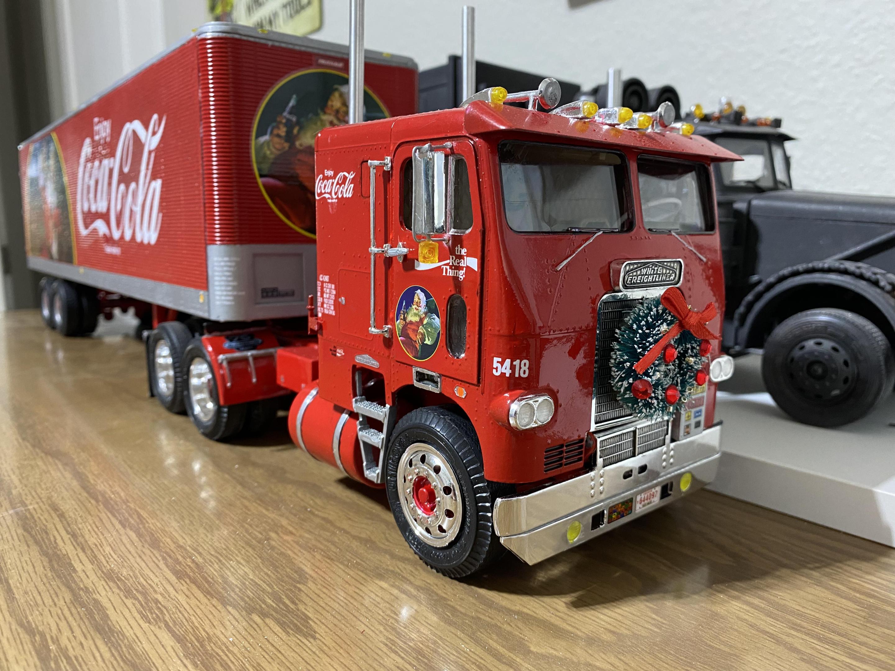

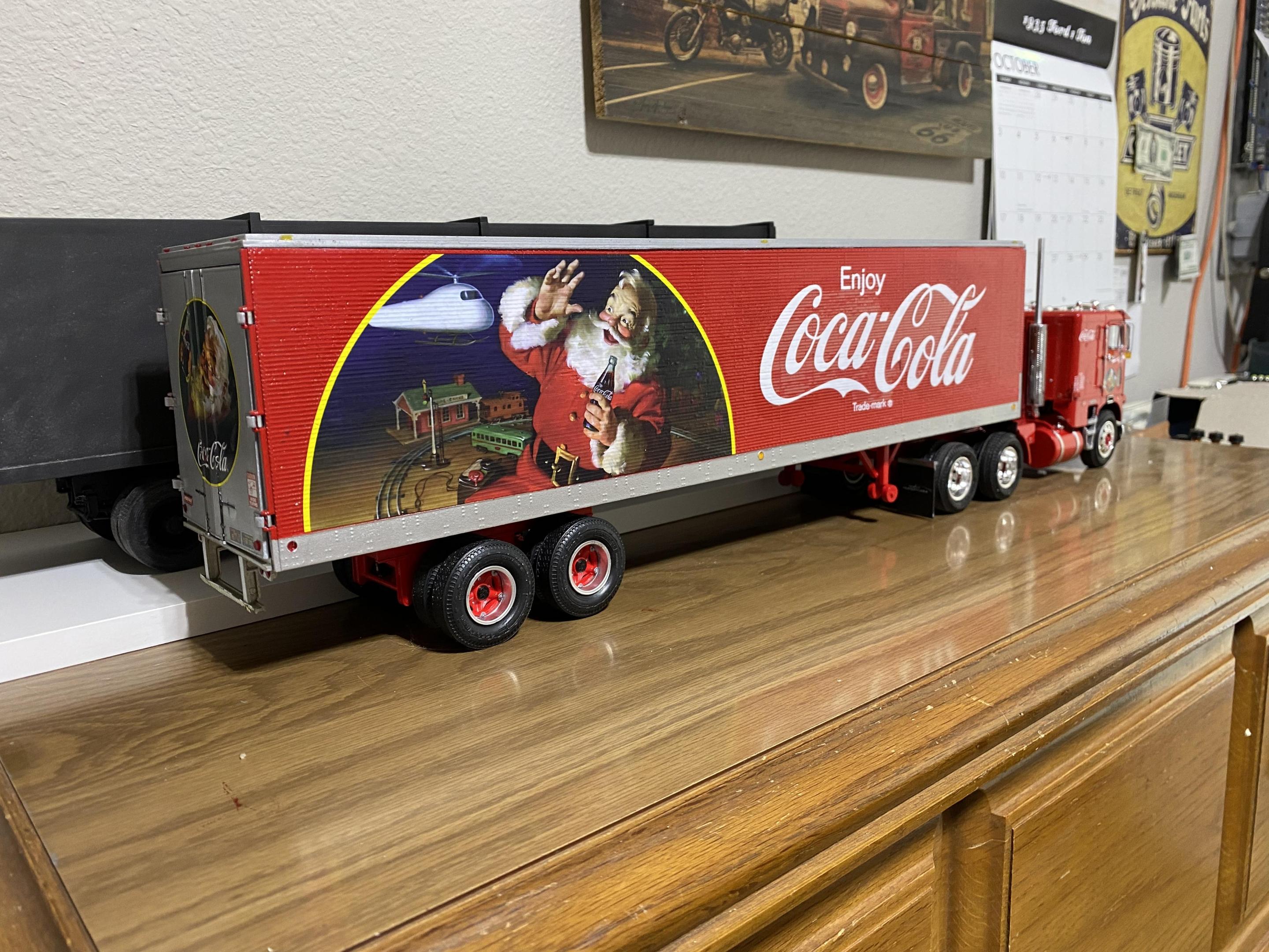

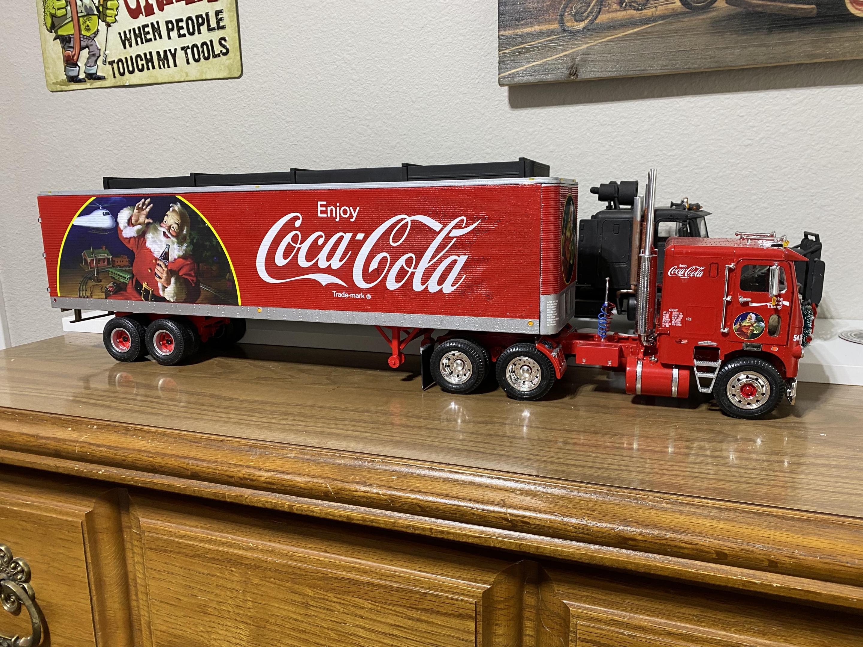

Well, I’m heading in the right direction again. I got the new trailer and stole the decals, repainted the side, new decals and it is back together. I need to fix a few small gaps from being taken apart, and a few things still need trim painted, but it’s progress.
I added a wreath I got from HL and added some color to it. I also added Christmas decals to the truck doors.
I am almost done with this one.
The trailer doors are currently held closed with masking tape so if I want to open them, it is just a quick slice with a #11.
