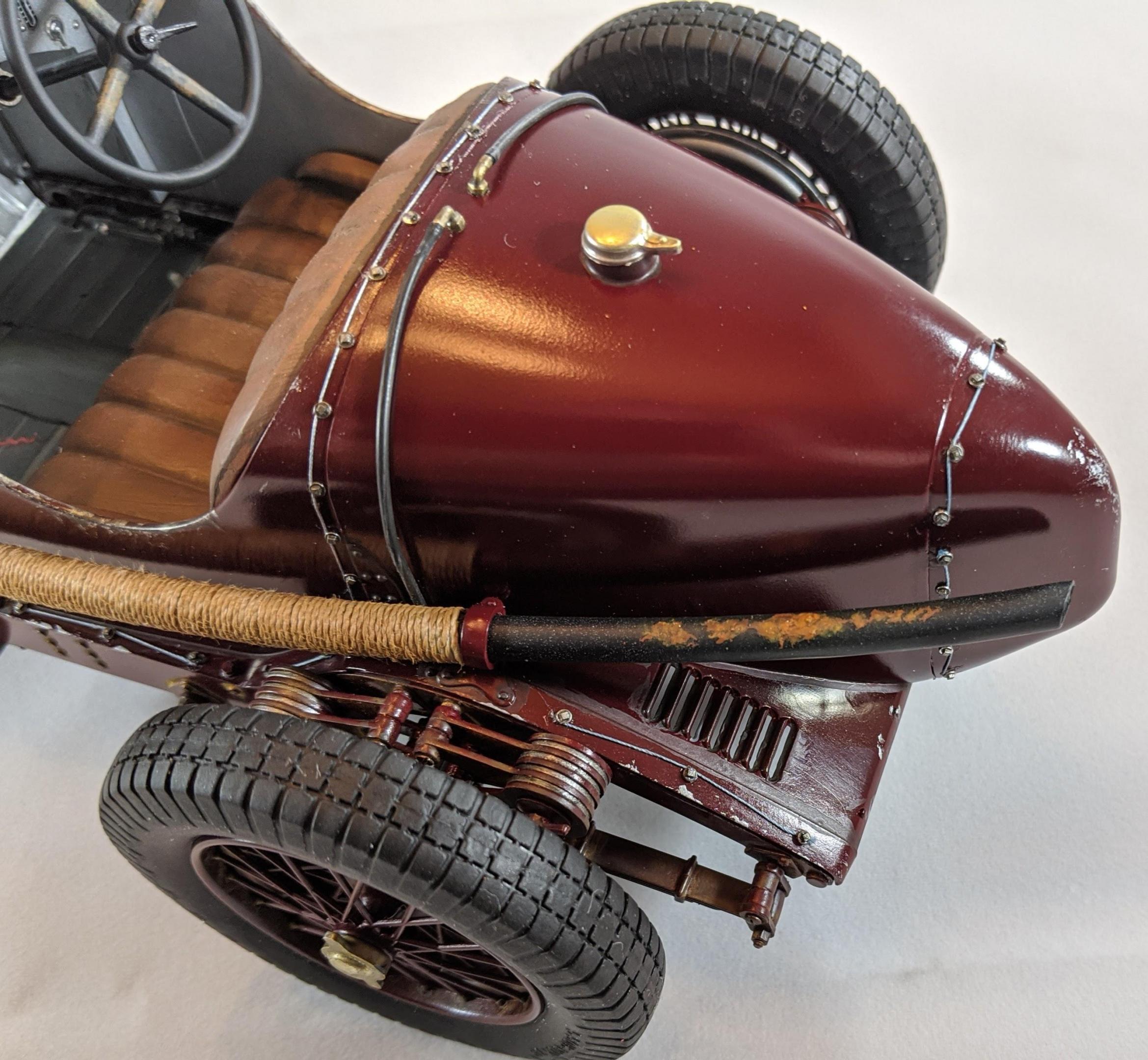

jaymcminn Posted October 26, 2021 Posted October 26, 2021 I used a stippled technique as suggested above for the exhaust on my Alfa 8c before masking with rubber cement and spraying a black top coat to simulate rust breaking through the black paint. As a finishing touch I used the Tamiya "rust" weathering powder to blend the stippling and tone down the black. 1
