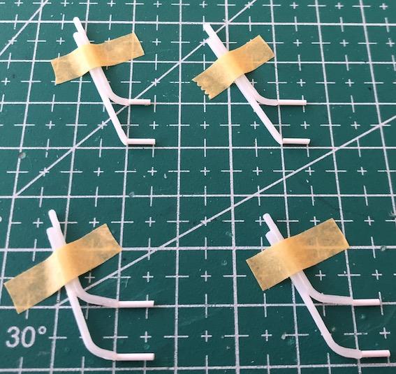

Bill Eh? Posted December 19, 2021 Author Posted December 19, 2021 12 hours ago, slusher said: Does not matter how long it takes as long as your satisfied with your work and the quality. Hang in there .. Thanks Carl, you're absolutely right. A small update. I tried making a pair of breathers to attach to the valve covers. They are based on eyeball proportion to reference pictures. They are okay, but I am going to try making them in a different way to see if I can do better. 1

Bill Eh? Posted December 20, 2021 Author Posted December 20, 2021 2 hours ago, peter31a said: Keep up the good work, Bill. Kudos to you for continuing to work your way through the issues that you encounter on this build. Thanks Peter. I took Bruce's advice and did the Scalemates thing with my Evergreen inventory. Only because I picked up 3 new packages today. Time to take a second attempt at the Valve Cover Breathers.

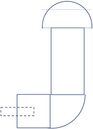

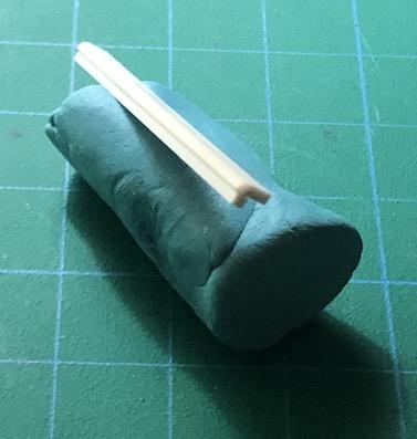

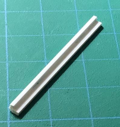

Bill Eh? Posted December 21, 2021 Author Posted December 21, 2021 I had my second try at doing the Oil Breathers. The first set were iffy. Cutting the various pieces to size and then attempting to glue them together was not the way to go. It was too difficult to position pieces that small. The first illustration shows what I am attempting to achieve. The two pictures shows a 4 cm length of the "L" parts glued together. I will let this set up and then attempt to saw off 3 mm wide sections. Then I will cut and glue on the 1/2 round which represents the cap. All of this will get pinned to the Valve Cover. 1
