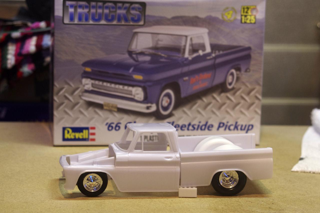

bluestringer Posted December 22, 2021 Posted December 22, 2021 Inspired by another member's pro street truck, I decided to give this a try. I've started the tubbing process, but not sure if I'm going with these tubs or some other option. I cut these from an old plastic pill bottle but they seem really soft and not sure how they will react with CA glue. The tires and wheels are from the AMT 66 Nova Pro Street. 2

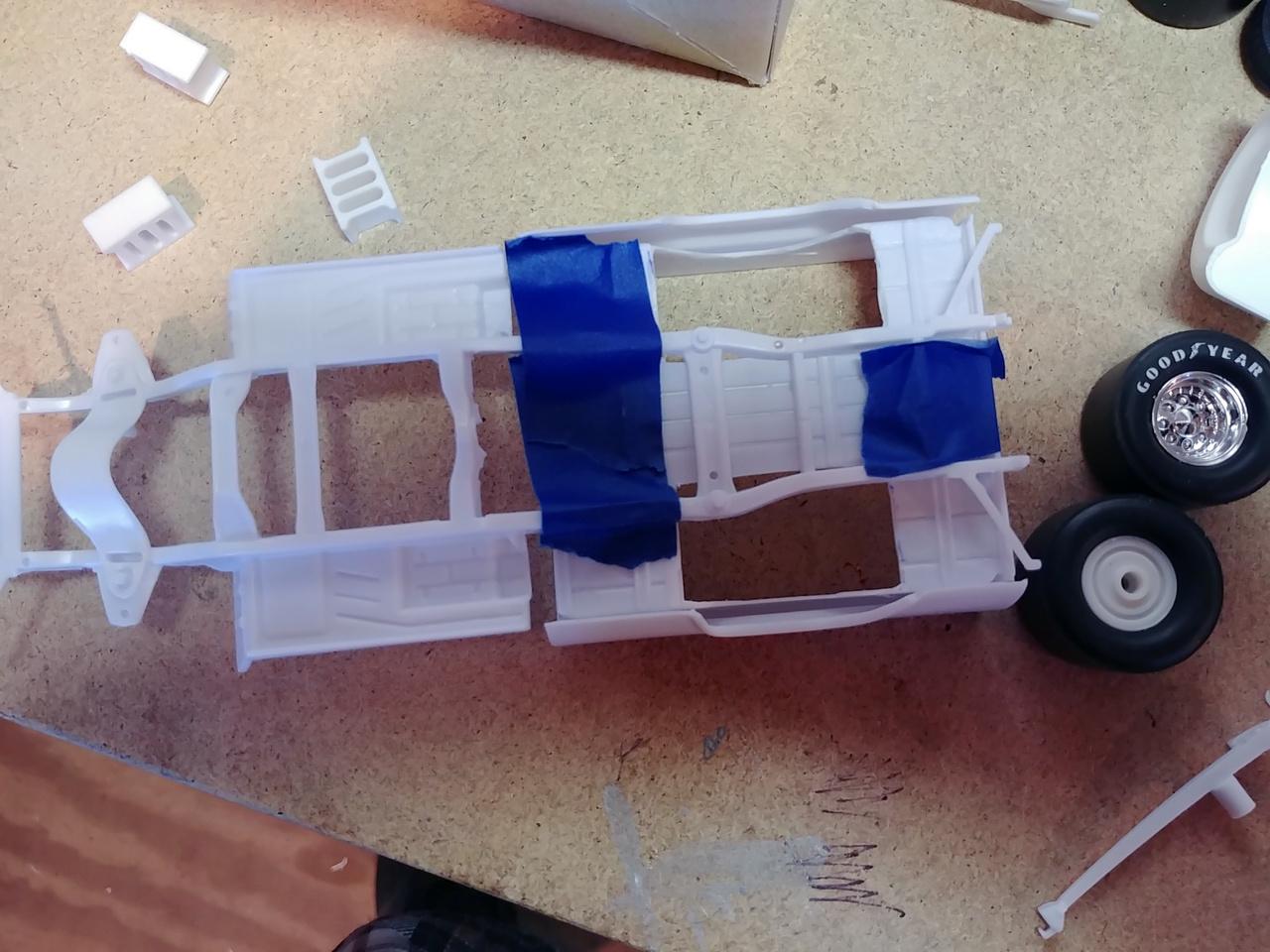

bluestringer Posted December 23, 2021 Author Posted December 23, 2021 I think I done got in over my head. Got the bed cut out for the big tires and tubs, but looks like I'm going to have to narrow the frame and axle housing to make this work. Not sure if I should use the kit supplied axle and frame or try something else. I will need to mull this over for a while.
Zippi Posted December 23, 2021 Posted December 23, 2021 (edited) 1 hour ago, bluestringer said: I think I done got in over my head. Got the bed cut out for the big tires and tubs, but looks like I'm going to have to narrow the frame and axle housing to make this work. Not sure if I should use the kit supplied axle and frame or try something else. I will need to mull this over for a while. I haven't opened this kit up yet but is there any way to cut the frame at the red lines, cut down the middle of the crossmembers at the green line and take out what is needed for the tires, then glue it all back together? Just a thought since this is all new to me as well. I have to narrow the axle housing on my 56 project as well. Here is a link where someone built a dual cab but it shows some mods that were made to the rear section of the frame. Mabe this will help. I'm sure someone has done this and can chime in with some pics that will help. Edited December 23, 2021 by Zippi
bluestringer Posted December 23, 2021 Author Posted December 23, 2021 7 minutes ago, Zippi said: I haven't opened this kit up yet but is there any way to cut the frame at the red lines, cut down the middle of the crossmembers at the green line and take out what is needed for the tires, then glue it all back together? Just a thought since this is all new to me as well. I have to narrow the axle housing on my 56 project as well. Here is a link where someone built a dual cab but it shows some mods that were made to the rear section of the frame. Mabe this will help. I'm sure someone has done this and can chime in with some pics that will help. It will need to be cut just forward of that wide crossmember because that is where the axle will glue in. Then the axle will have to be reworked to get it to fit the frame that has been narrowed. I'm sure it can be done, but may be too much for me. But as soon as I finish this Camaro I'm working on I'm going to dive in and see what I can come up with. I'm thinking about trying the complete frame from the 66 Nova kit to see if it will work with the truck body/bed.
bluestringer Posted December 23, 2021 Author Posted December 23, 2021 Cut it off right above the wide cross piece, then cut it down the middle and took out some. Put it back and checked it, looks like it's ok. Now to get the axle housing and differential to fit.

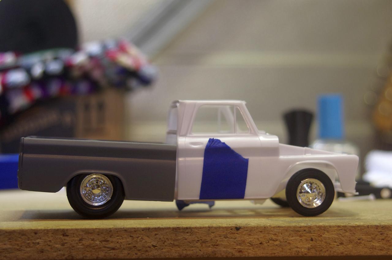

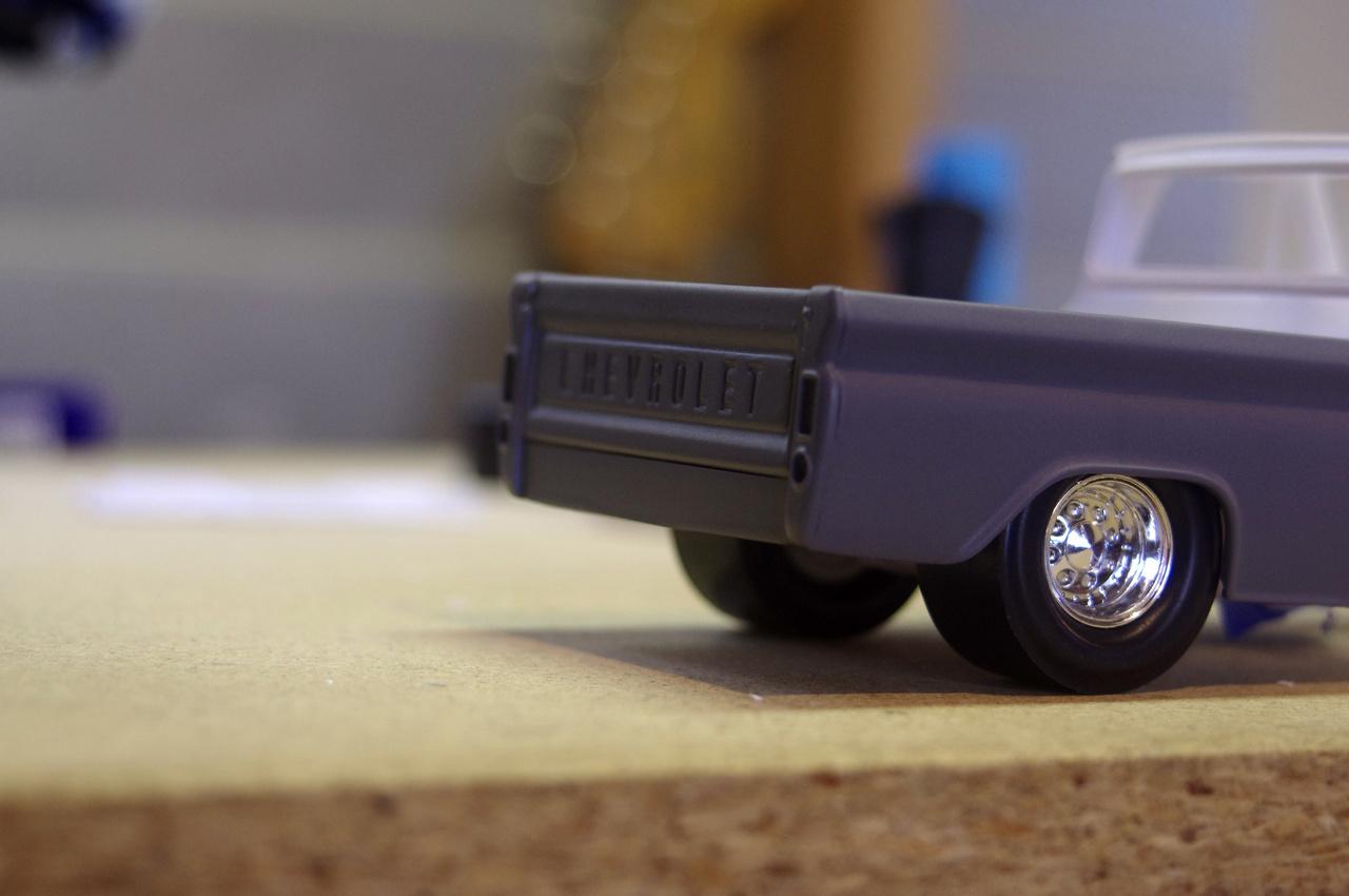

bluestringer Posted December 26, 2021 Author Posted December 26, 2021 I've got the rear about where I want it. On the front I relocated the spindles a little higher which got it a little lower but not enough. Looks like I will have to cut down the inner fender panels to get the body to sit lower. Don't think I can do anything else to the suspension. I went with the smooth look on the back, no bumper. I cut a strip of styrene to replace it.
Zippi Posted December 26, 2021 Posted December 26, 2021 Looking good James. Those big ol meats really make the truck don't they.
bluestringer Posted December 26, 2021 Author Posted December 26, 2021 1 hour ago, Zippi said: Looking good James. Those big ol meats really make the truck don't they. Thanks Bob. Yea those tires look mean. I was thinking about putting in a hemi, but have now decided to put the 427 Chevy out of the Chevelle Pro Street in it. Doing some test fitting and there is going to be a lot of frame modification to get it to work. This is turning out to be more than I thought it would be, but I'm going to keep at it and get something built, but it probably will not be pretty.
