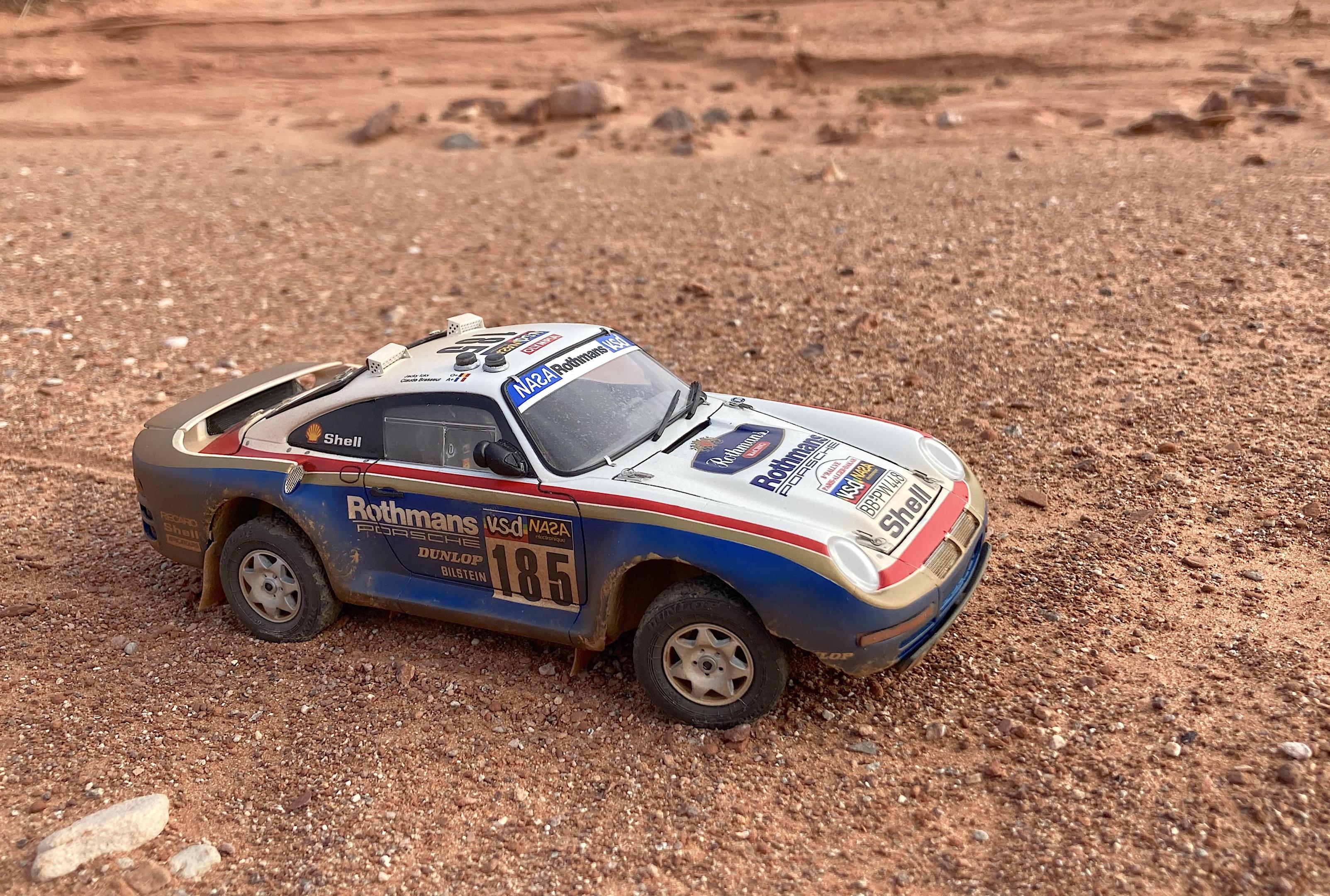

Oh heck no, I started that a few years ago, sat in the box for about a year, before resuming to finish.  I'm not sure what you're asking about the Dakar Classics.  I've looked up videos from the 959 era, but haven't kept up with the current race.

Kurt, you're 959 was that one of the Modeling Master kits? Fantastic build btw. Looks stellar.
Yes it is, thank you.  I *had to* fix a few things, namely the total lack of intercooler plumbing, which is the achilles heel of the 959 kit, which I also fixed on the regular Tamiya kit.
