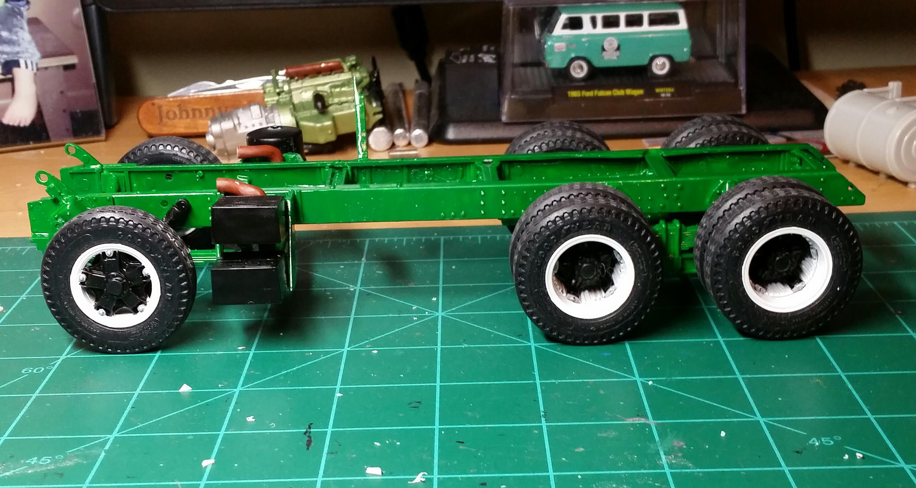

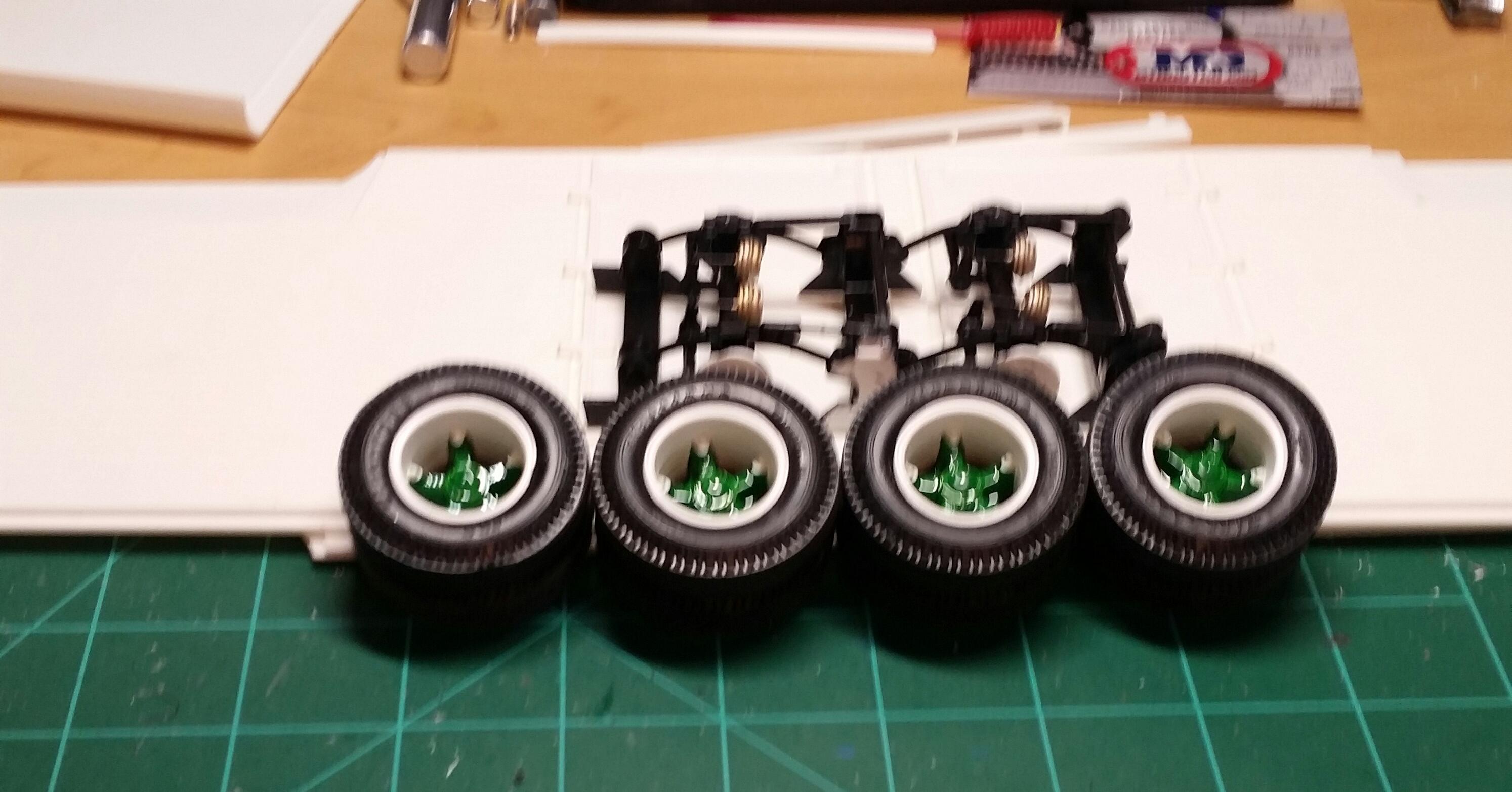

Found a decent extra set of tires in another kit so,have the trailer wheels done.
Glued the side doors in place because they were warped and no one is ever going to look inside anyways!
Rear doors are really warped bad.
Hope i can straighten them more than I have already.
Snuck outside between rain drops and painted the trailer bottom.
Got the three sides glued to the roof.
Now need to try and straighten the rear doors some more.

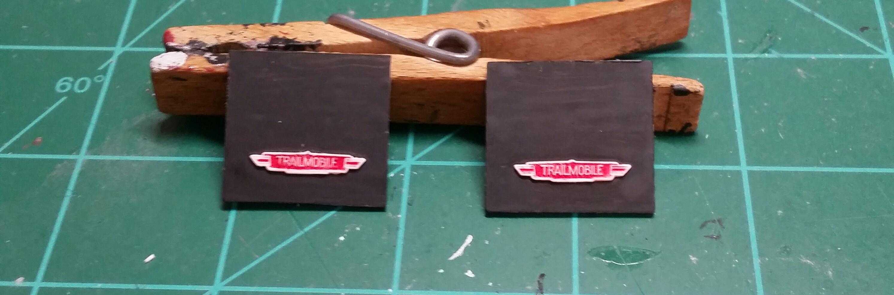

Didn't like the taillights for the trailer, can't remember seeing any like them.
So decided since so many extra lenses were included I would do somerging more familiar.

Looking Great so far!! Nice work on the tail light conversion !!
I always assumed that these were the style of lights the the kit was meant to represent. While I always liked this style of Trailmobile lights, you are right, the kit representation falls way short. Looks much better.
