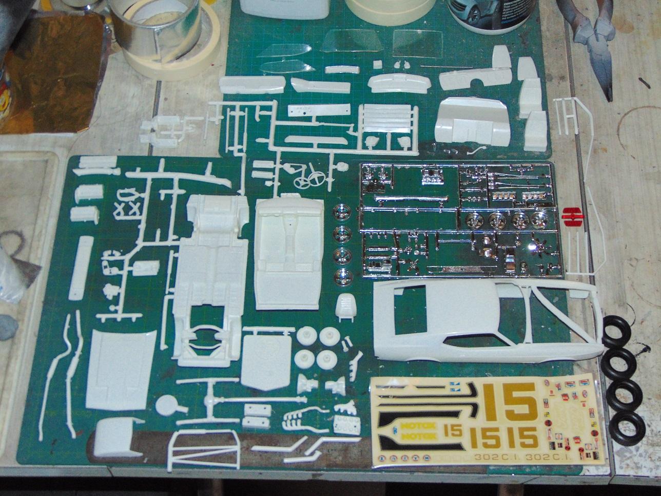

I've heard this isn't a great kit, so I went and bought one! Not sure when this one was released but it's old. Most of the parts were loose off the tree but everything seems to be there.

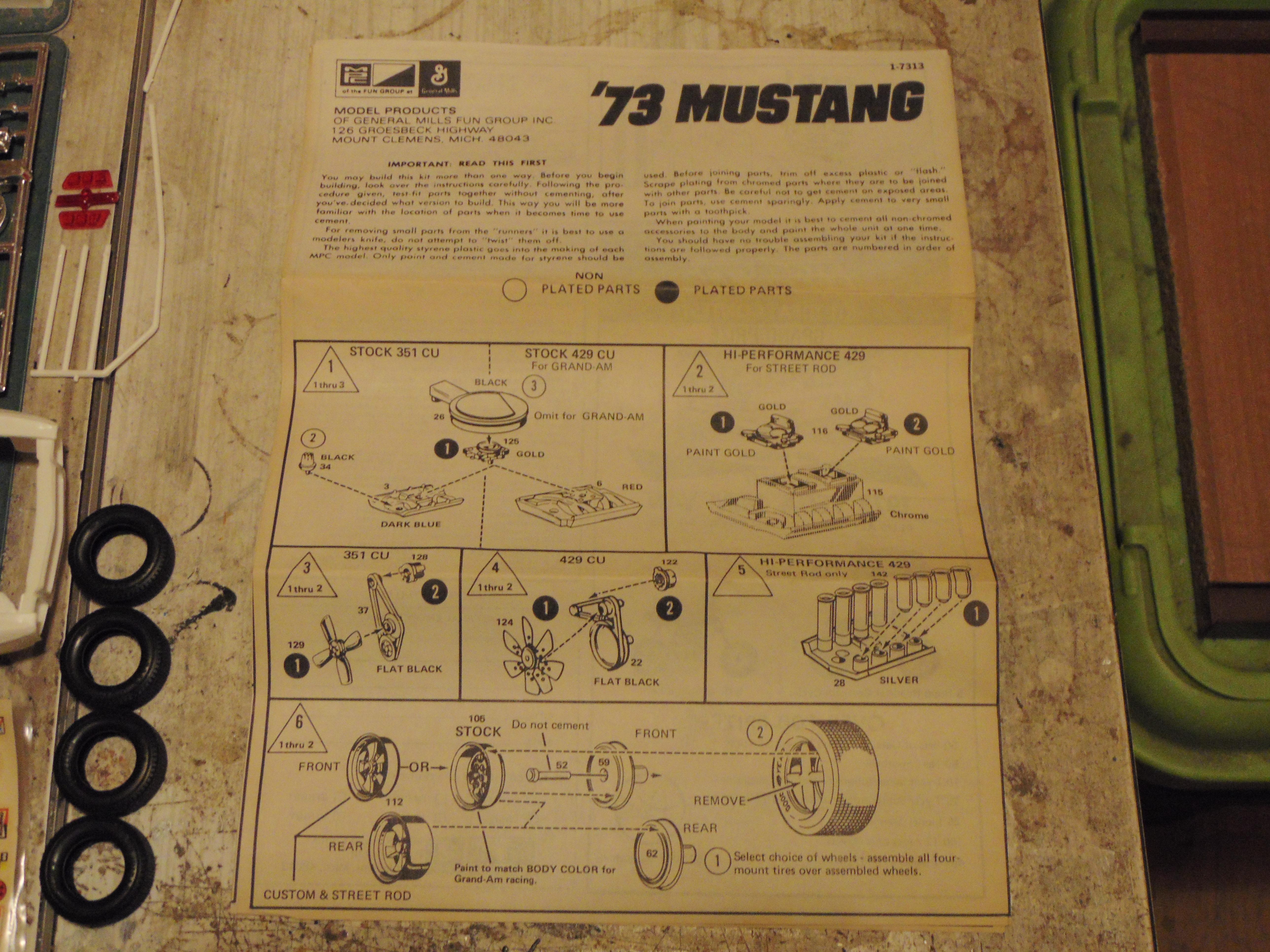

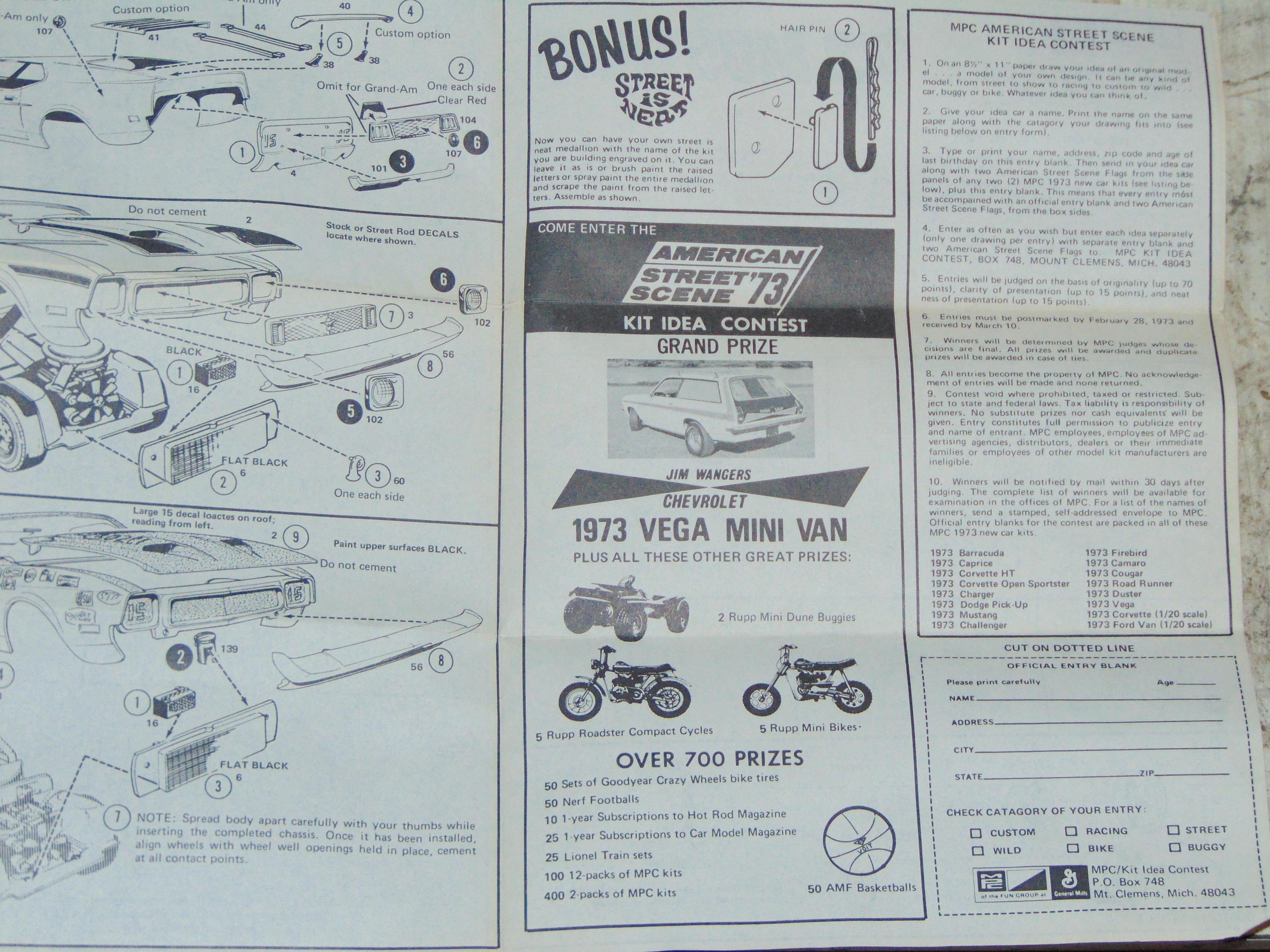

Love these old kits though, pretty cool looking through this when I opened it. Check out the instruction sheet where you can win all sorts of goodies, like Rupp mini dune buggies and bikes, and Jim Wangers Chevy Vega van... no idea who he is. I did Google him but came up with the guy behind the Pontiac GTO? There's also a "Street is Neat" medallion in there too... might wear that with an open shirt next time me and the Mrs go boogying on down to the discotheque! xD

Jim Wangers was in advertising , and is a big proponent of the GTO , and Pontiac in general (but enjoys all makes and models).
  Jim Wangers Bio (hbconcours.org)
Thank for the link, John. Interesting read, I'll have to look for the book "Pontiac Pizazz" if only for the artwork by Art Fitzpatrick!

The Jim Wangers Chevrolet van was during the period when Jim had a Chevy dealership in the city of Milwaukee. Lasted only a few years but he sold those Vega vans with special markings on them.

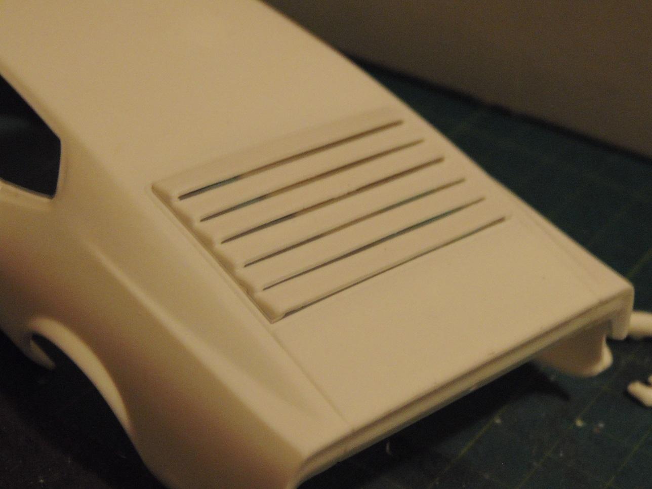

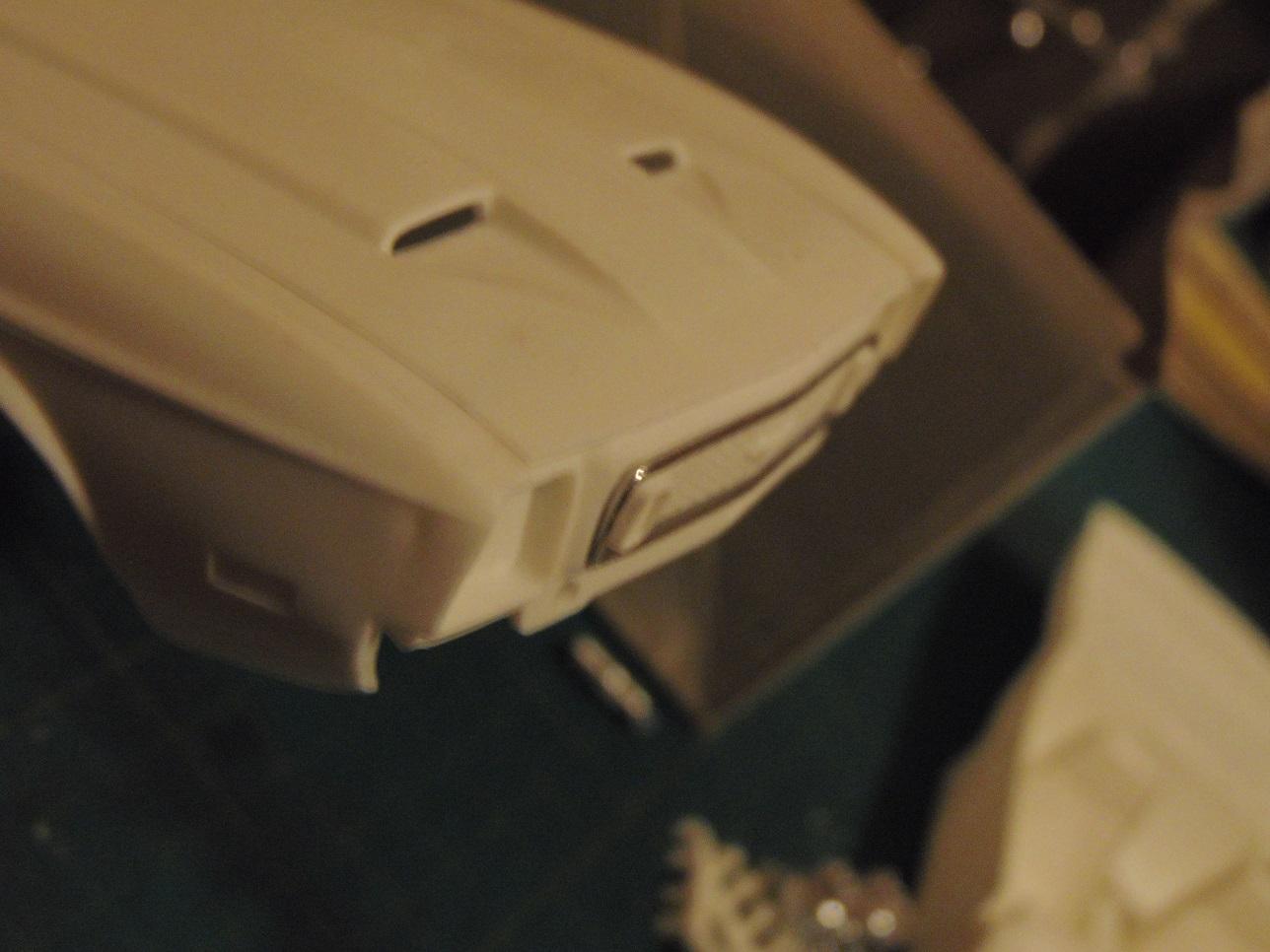

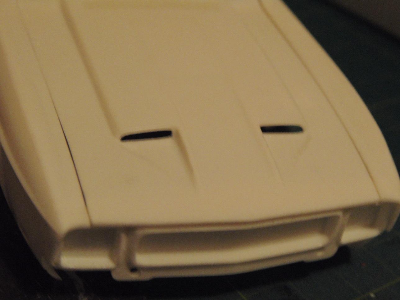

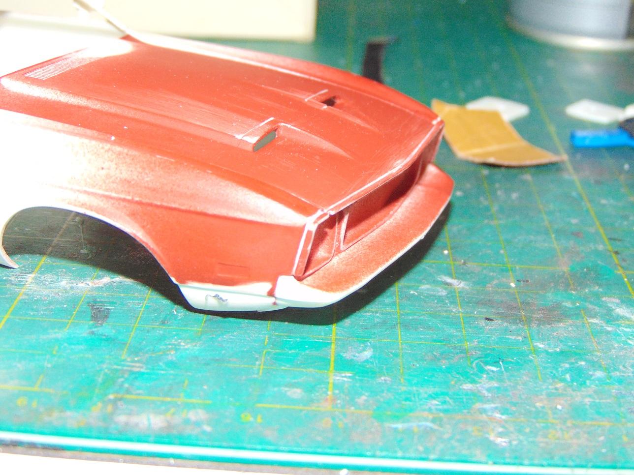

Doing some cleaning up and fine tuning before glue and paint. So far I've cut out the hood vents and made the rear window louvers fit nicely. I've also lightly reworked the front panel and grille to give it a rake like the real car. It's almost dead flat on the kit. Left to do is to score a panel separation line on the leading edge of the hood and wing tips.

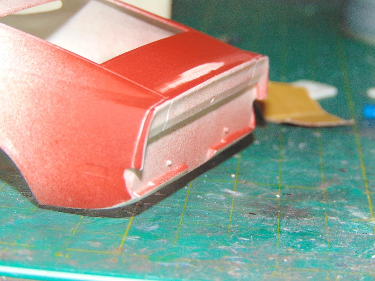

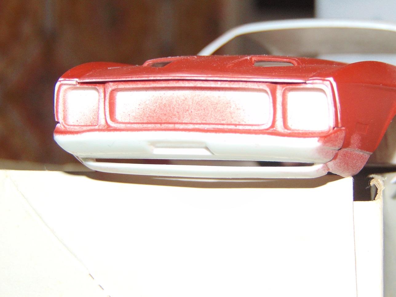

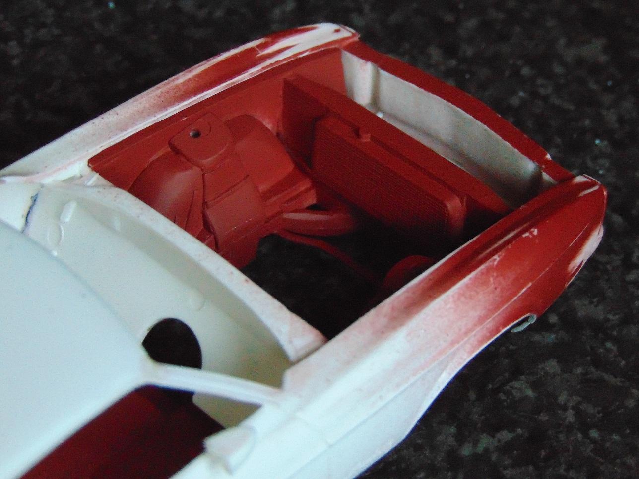

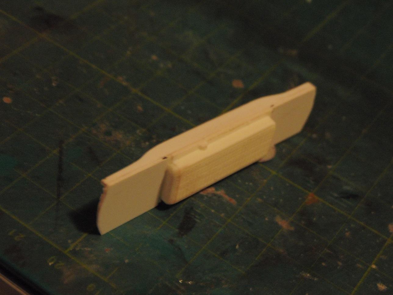

I scribed the panel lines in the body today and also opened up the intake on the lower valance. The radiator is comically wide on this kit, so I shortened it and made a new frame. It's not accurate to the real car but is miles better than what it looked like off the sprue.

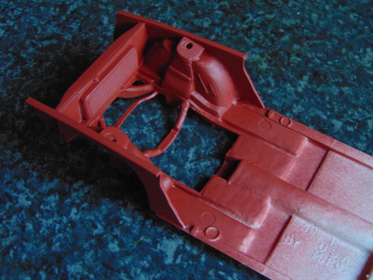

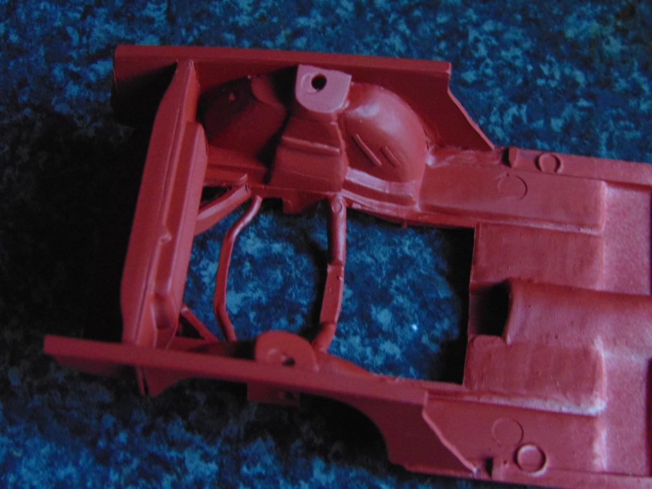

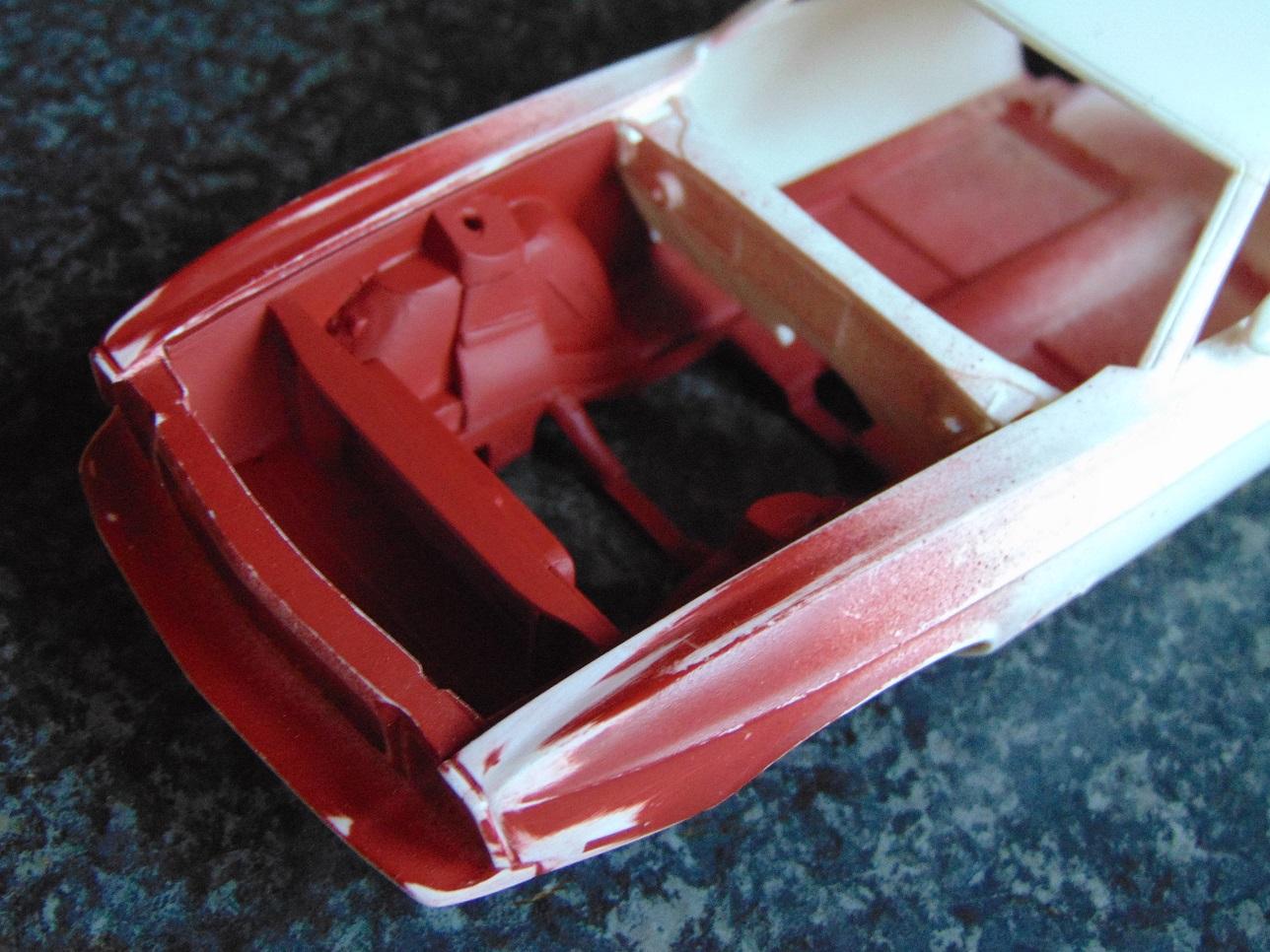

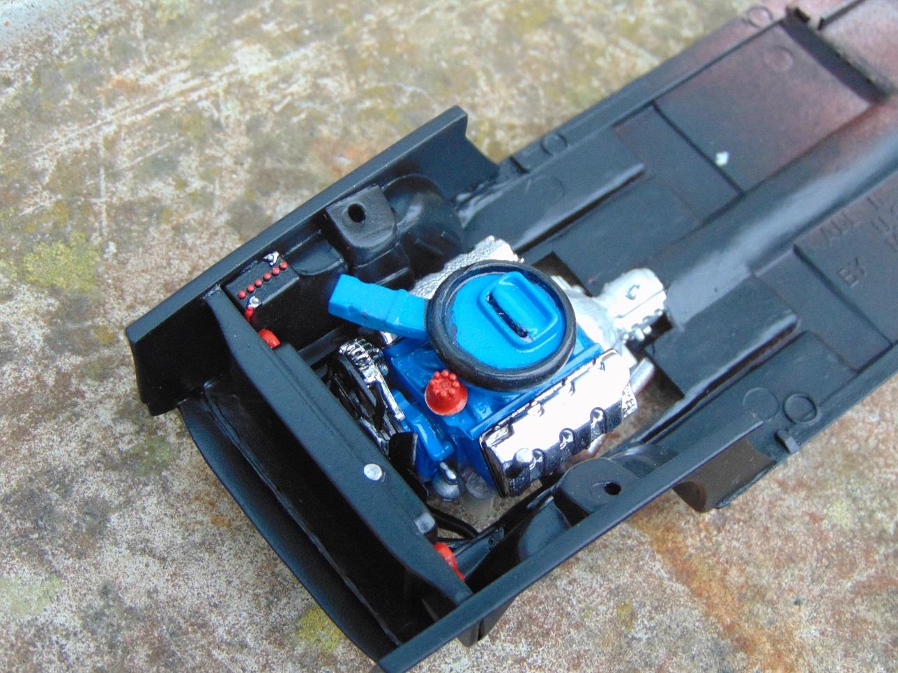

The under hood detail in this kit is non existent so I did a bit of scratch building and added inner wings and suspension strut towers.
You got that right.  Adding the shock tower supports will make it look more realistic too.
WOW you did a awesome with the detail under the hood i have to try that my self very nice it puts new life in a old kit.!!!

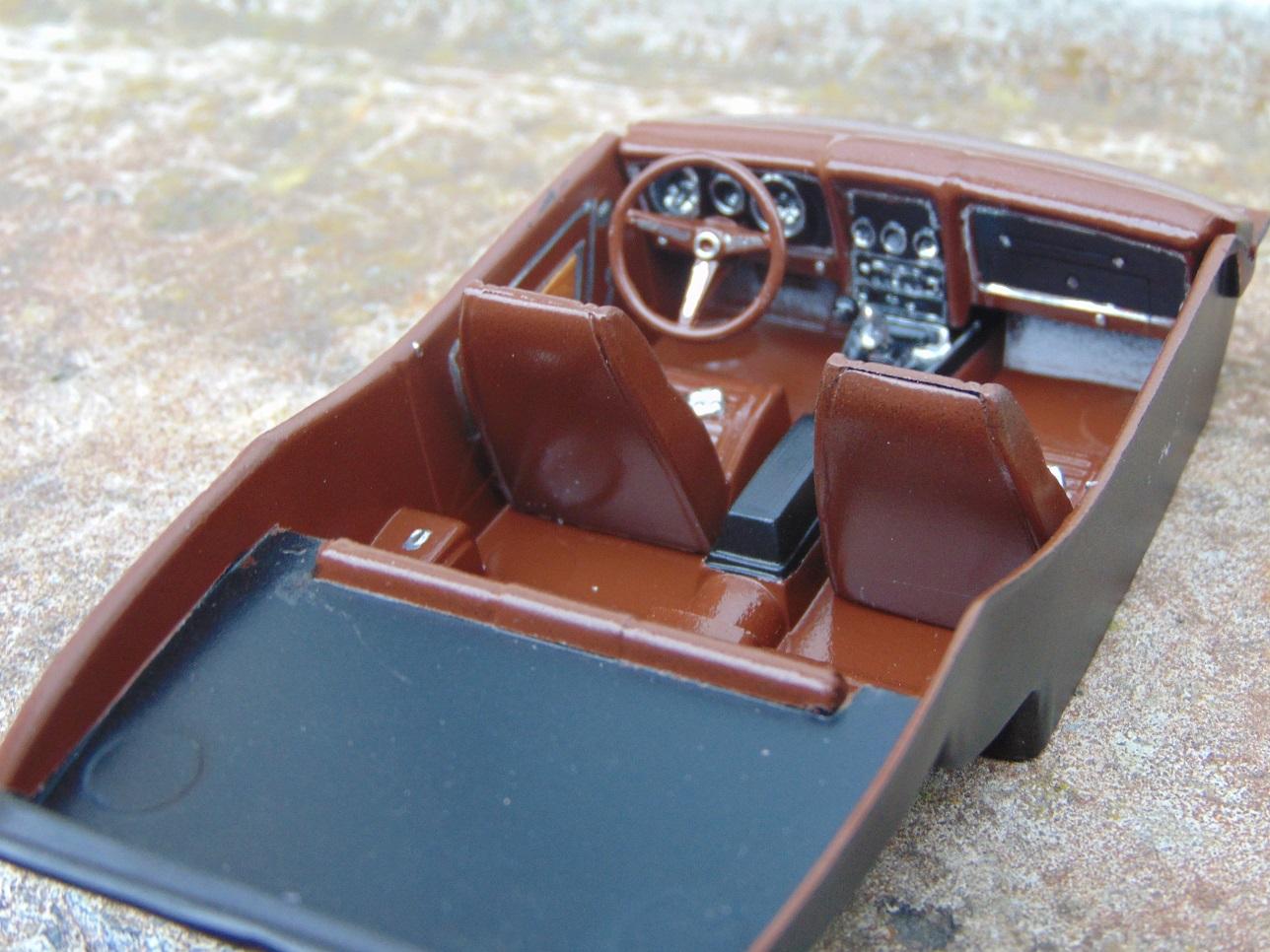

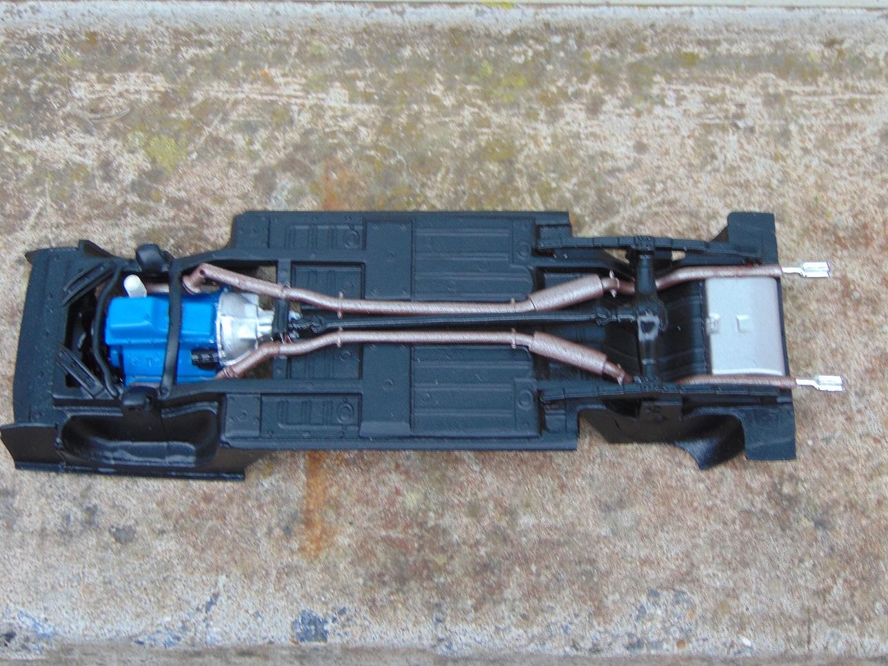

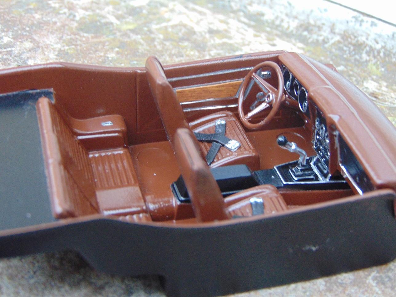

Thanks guys. The chassis and engine are done, I just have the suspension tower braces to do to finish it off under there. I've got the interior painted and detailed, I did paint it black first but then I seen a '73 with a brown interior, vinyl roof and mustard yellow body with black stripes, so I've decided not to do the WFIL radio car.

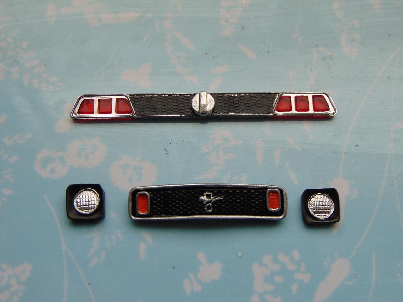

The headlights in this kit are awful. They don't fit the recesses of the headlight pods and both are misshaped. I cleaned them up and painted them black. Rear panel trim is ok and didn't need any work.

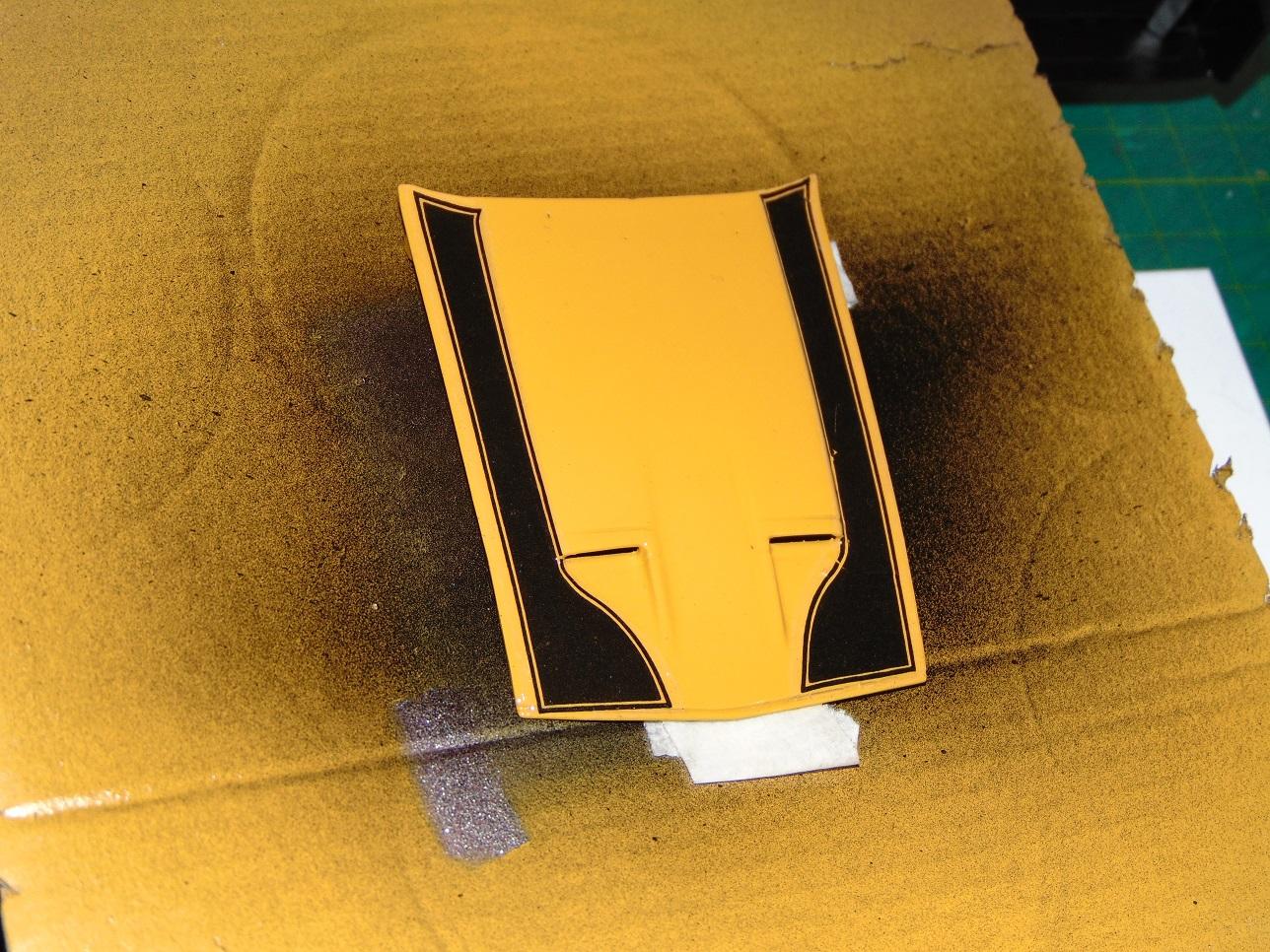

Time for paint, and fitting the nearly 50 year old decals! Colour is Vauxhall Mustard Yellow. The hood decals wouldn't slide off the backing paper so I just peeled them off with my bare fingers and hoped for the best! They were very dry but laid down ok, though I did need to use decal solvent to flatten some raised areas that wouldn't settle. Lacquer has been applied so they are now locked in. I'm hoping the side decals for the body will cooperate just as well so fingers crossed!
