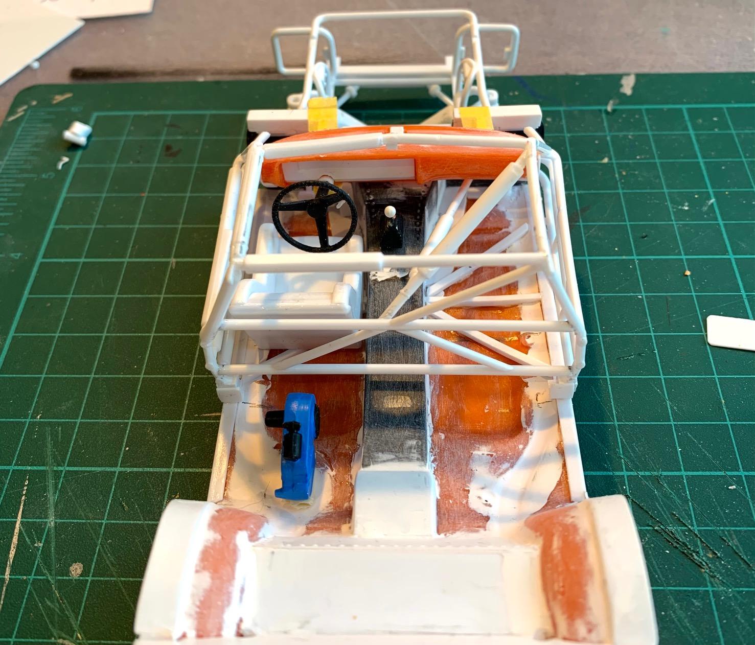

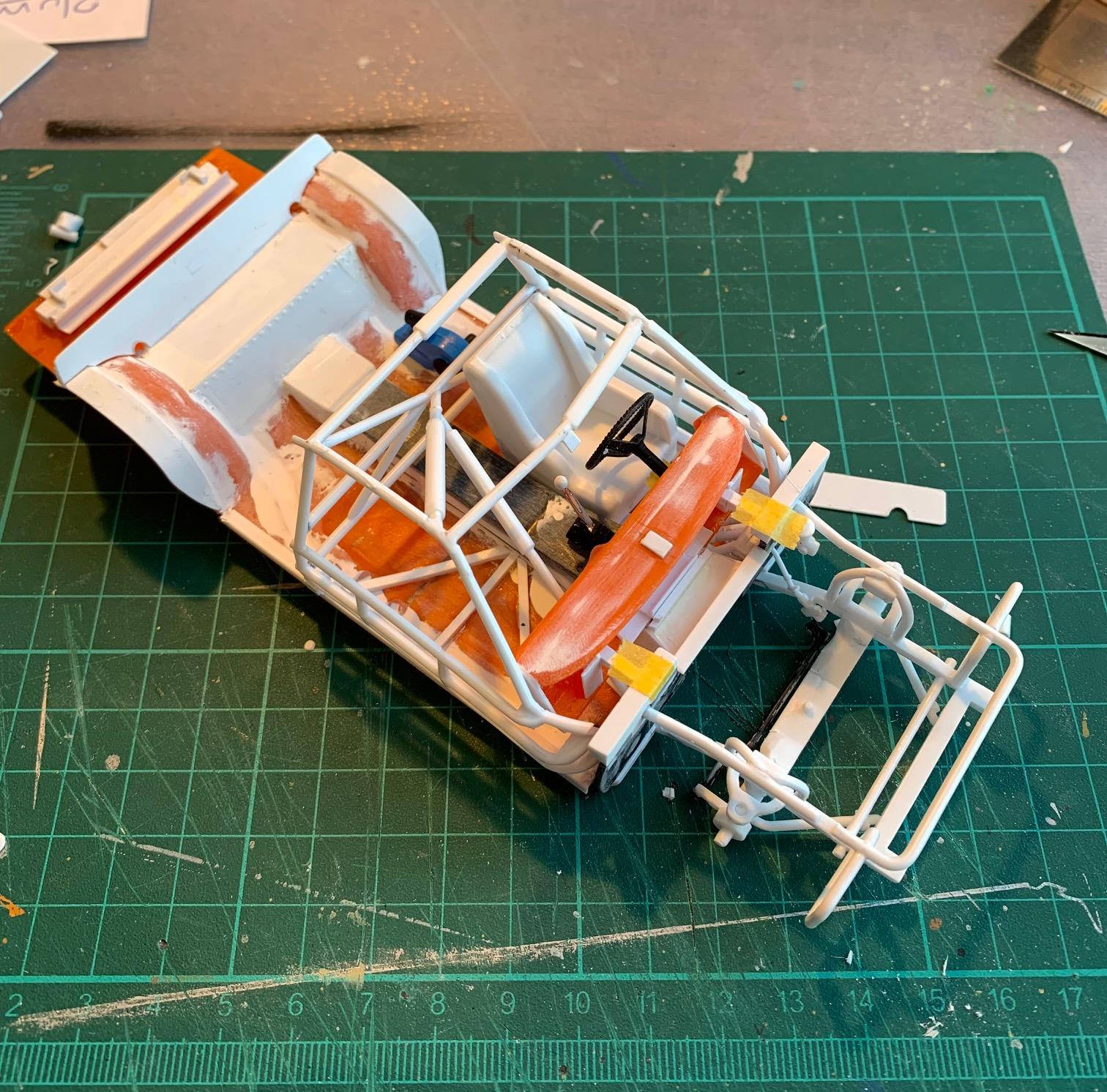

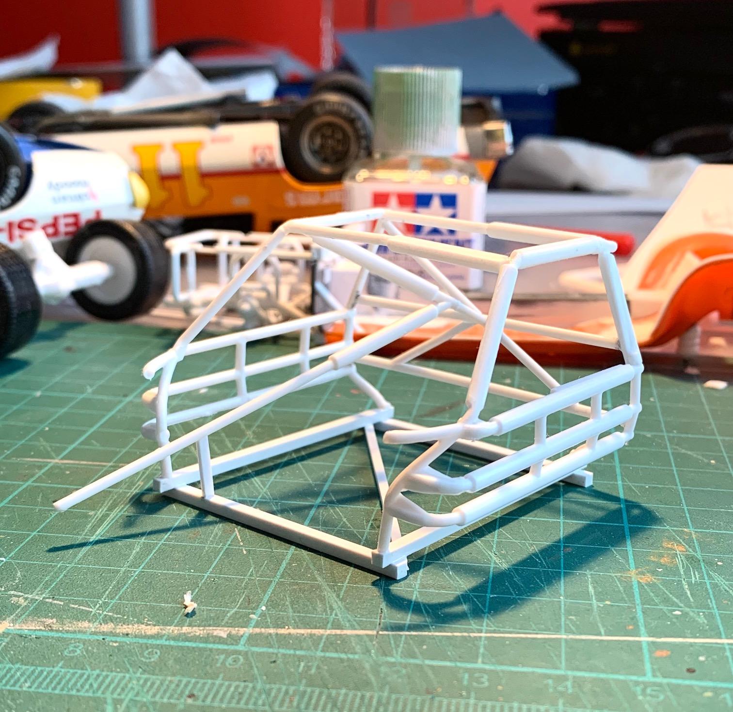

2 hours ago, afx said:
Cage looks good Pierre.  I agree the goal is to get a good fit on the roof/green house.
I could no agree more JC. The 2 things that bug me the most when I build a car is when I fail to get the stance right or an ill fitting roll cage.
Trimmed and glued the back bar assembly plus bars to top corner and to front frame.
Test fitted to body. I should have shaped it tighter to the A posts but not bad overall.
So true!!!!!
Man, this cage is awesome, Pierre. Much better than trying to squeeze a cage for something else in this body. About as custom built as you can get.
Thanks Mark. I am repeating the idea I first tried on the Galaxie to build it upside down and it seems to work better that way.
  • Like 1

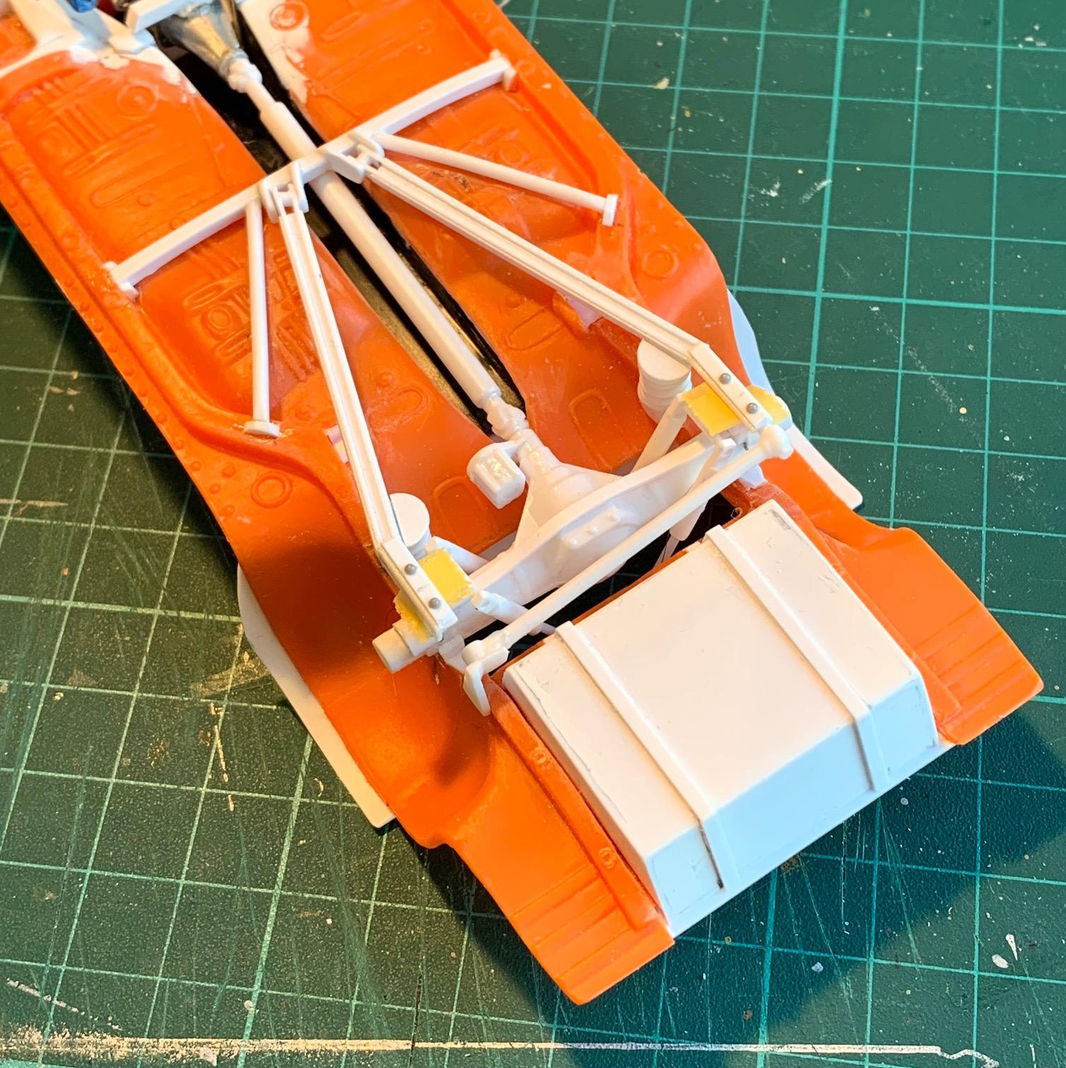

So the decision was made to retrofit this rear chassis to a long arm setup. I did not want to sacrifice a donor chassis just for these few parts so I figured I could just scratch build it.
I keep doing this to myself...I look at the part and I say it's easy to copy...but it's not.
Here's where I'm at after 2 days. I'll get there eventually.

Chassis rear axle & suspension finally done. I basically started with the AMT Monte Carlo axle but all the rest is scratch built.
First pic is the parts as I built them and as I plan to pre-paint them prior to final assembly. The other pics are the mock up of the assembly.
Lots of work but it would have bothered me to leave it as a short arm knowing it was not.

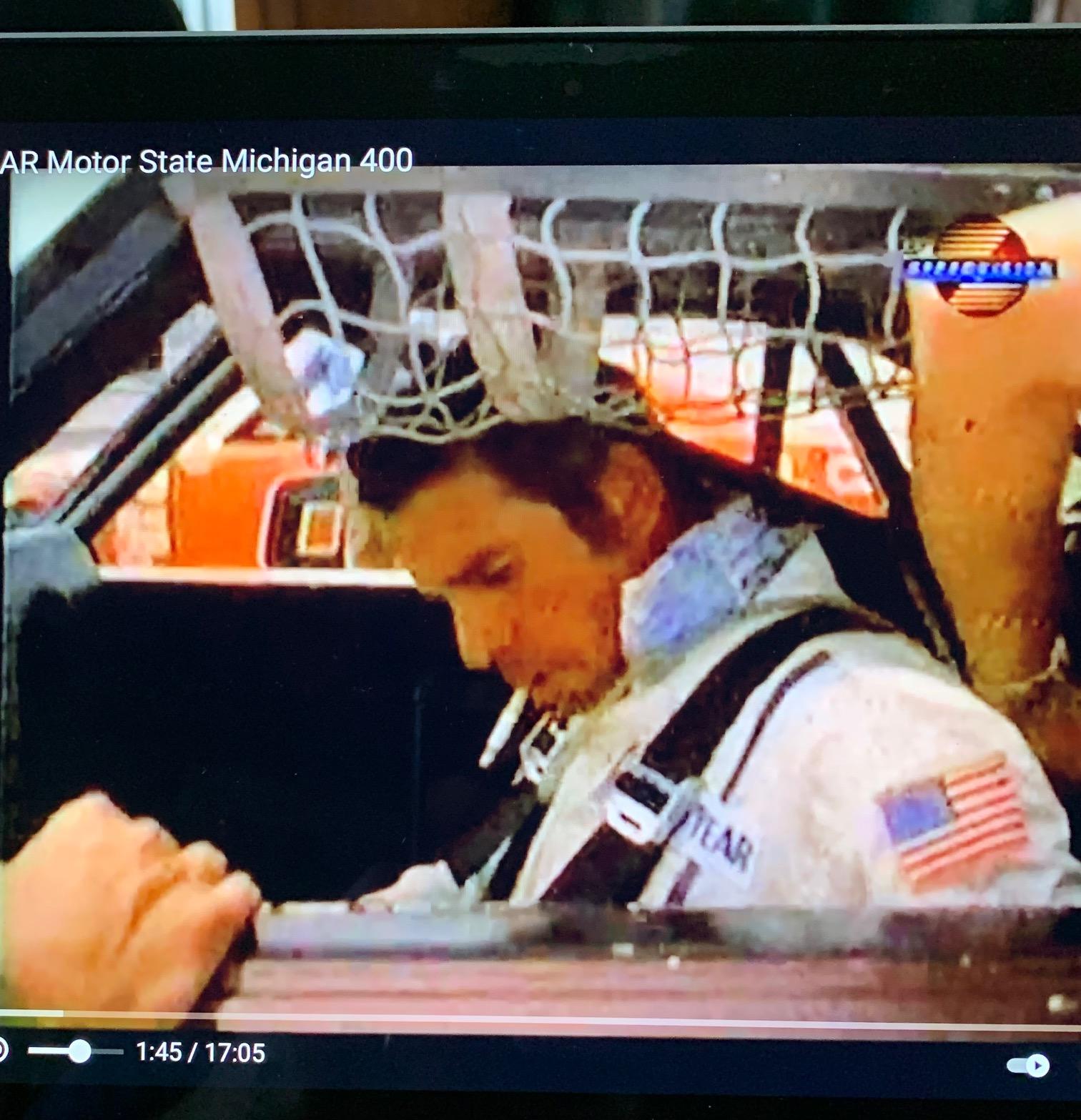

Completed most interior part fab and mocked up before moving on to paint and assembly.
Interior built up from upper side of GTO kit chassis. I used old MPC Nascar chassis driveshaft/trans hump as well as firewall.
I decided to use the stock IP. My best guess based on these screen shots from the Motor state 400.
If anyone has information to the contrary...too late!
